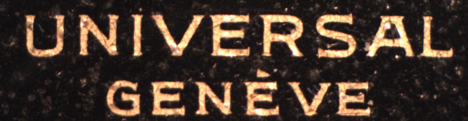

First off, the UG writing with even spacing on the Genève and proper serifs - looks spot on to me.

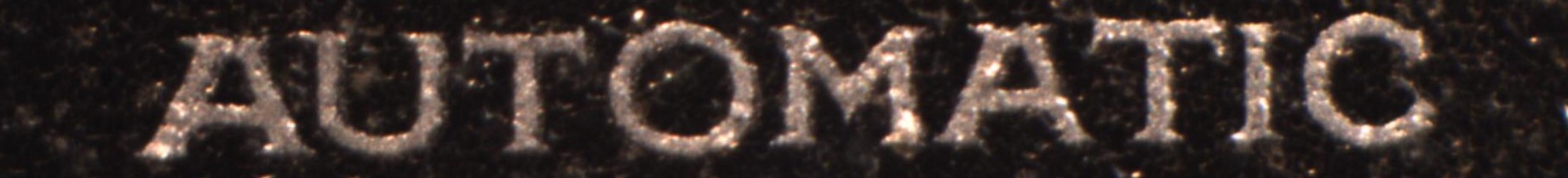

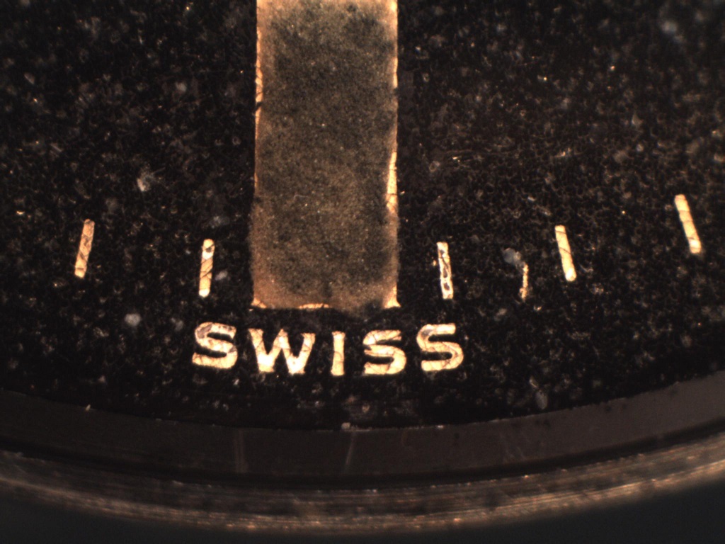

Here’s the Automatic and again, looks fine to me -sharp and with serifs - note it’s a different colour but same serifs as above. The colour change doesn't concern me based on this comment in this thread

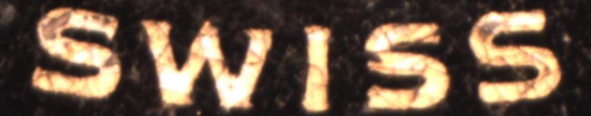

And the Swiss text. Again, this looks absolutely fine to me.

I've owned four good original examples and still have hi-resolution photographs with which I've compared these.
The text above is entirely consistent with the text on the dials of my watches. I have owned examples where the Automatic text was in gold and others where the Automatic text was more silvery as above.
So based on my experience, I would have little doubt about the text above.

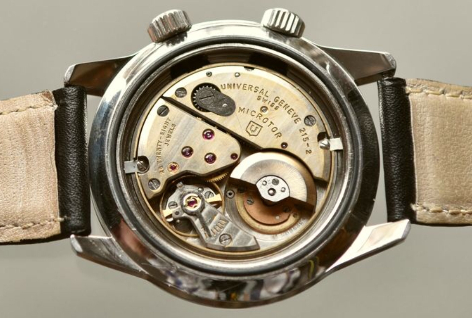

I've come to the conclusion that it's this watch from last October. This guy enjoys the hunt more than the catch! By the way, he's not a member here but I'll point him to this thread later. I think these comments have really helped me @Mazoue , as well as the interest from @georgetownhoya 👍
The serial is 2'034'xxx (not stated or shown on the listing), which is probably too early for Polerouter Subs but could possibly explain the absence of the Polerouter Sub text on the dial. It does have the 20369/1 case reference that we would expect on a first gen Sub.
The Cal 215-9 is unusual but there are other examples with this movement.
The lumed triangle on the inner bezel is uncommon. I think it is more common to have scruffily applied lume up to the 20 or no lume at all. The font on the bezel looks correct though.

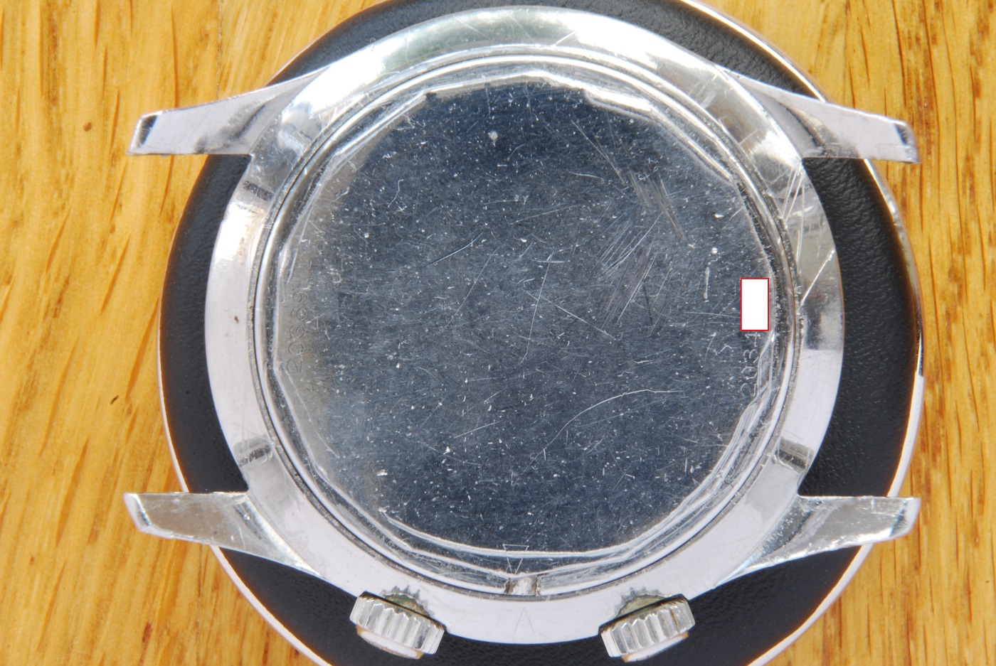

The case back does not seem to have the gap in the screw thread that we see on genuine examples. The cross hatched crowns with lip look ok. I don't like the drilled lugs.
It doesn't have the lume dots that we would expect to see on the hour markers of a first gen Sub. Based on these relatively low resolution photographs, the text looks ok.
There are too many red flags for me but it's not totally without merit and does not have the usual hallmarks of the fakes that we see.

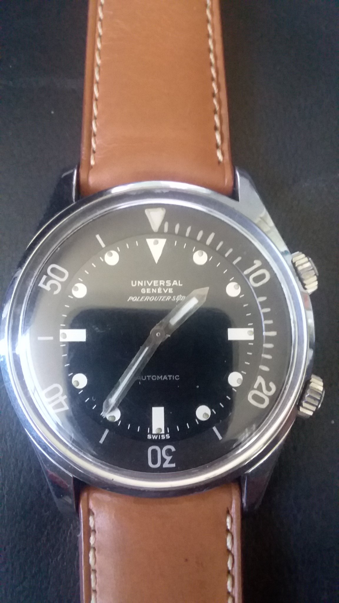

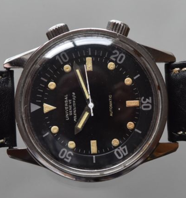

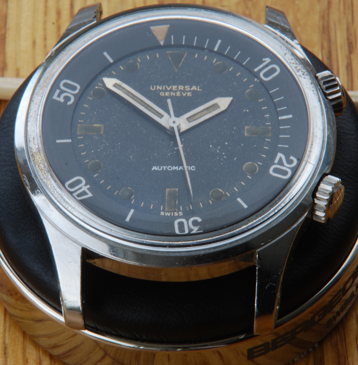

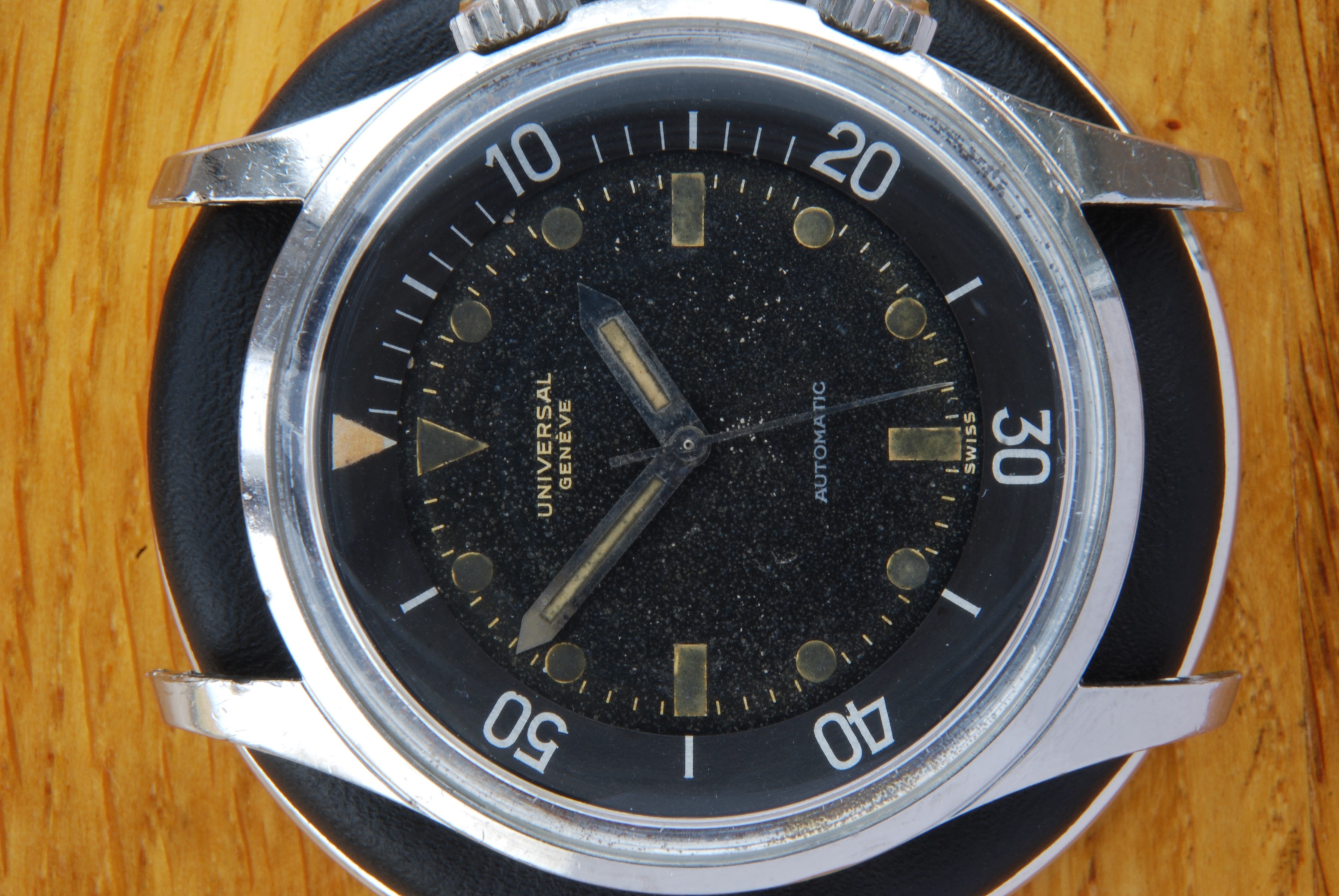

Whole watch:

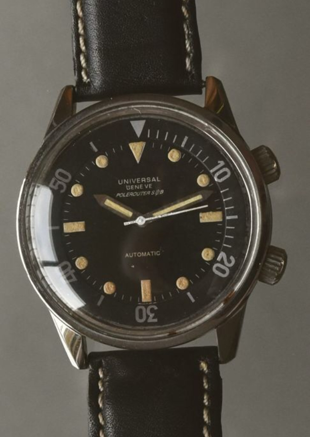

Close up of dial and bezel all the ticks look original and equally spaced to me. Hands lume looks consistent with the dial lume.
So, we see full lume on the markers which is not typical for these but, seems to agree with this advert - thanks @Woops. Here are some close up microscope pictures of the lume. To me all of these look like typically aged radium from this period - a bit grainy and with "shrinkage"..

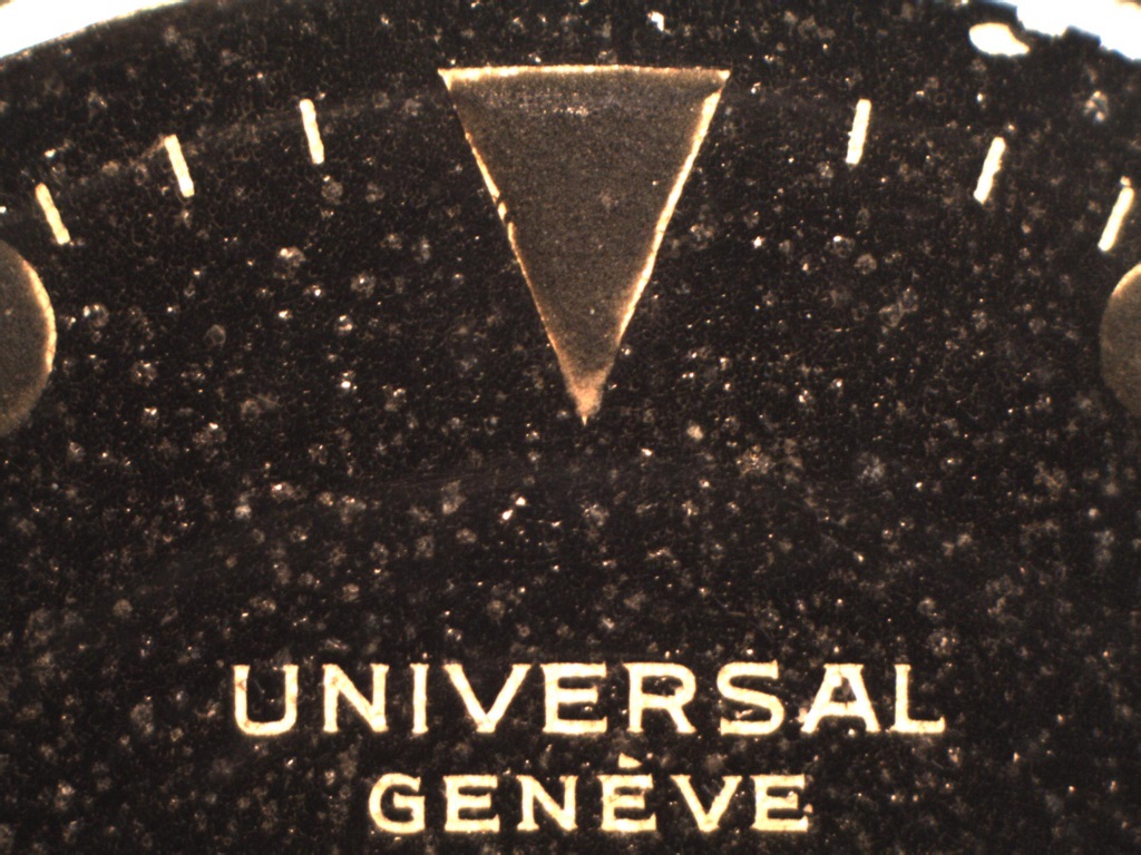

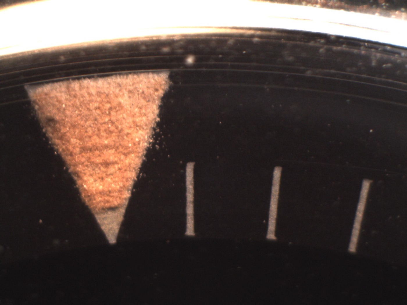

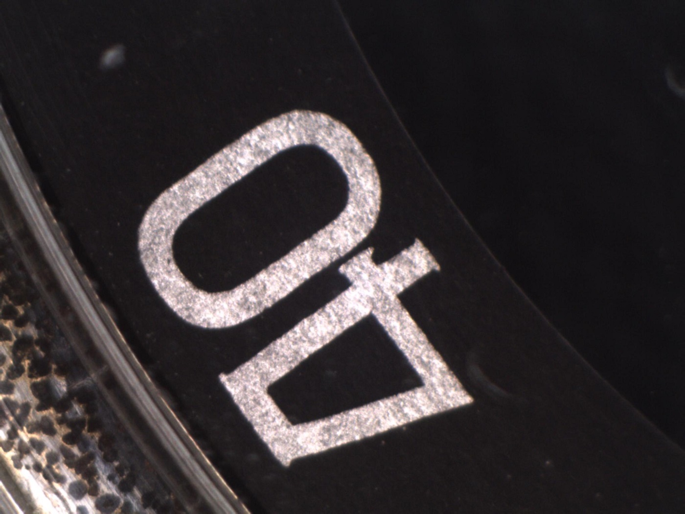

Moving on to the bezel, I usually look at the 40 marker as this seems to be where the font is most obviously correct or not. Microscope of the 40 but, through the crystal. This appears to be exactly the same (looking especially at the droop on the horizontal leg of the 4) as the one on @LaurentBxl watch shown here and others. That's a very nice watch by the way!
The tick marks on the bezel are sharp and well defined. Only the triangle is lumed which does seem odd. It's the same as the Tiffany watch which Lou thinks has a 1st generation bezel. This is definitely decades old lume but it seems to me that it may have been added a little later, as it has aged a little differently. I'm probably mistaken and it has just aged differently because it's in a different place on the watch...
At the moment, I believe there are no red flags with any of this information and it looks like another variation in these - it's possibly an early watch as the quality looks right to me, but your thoughts would be appreciated.

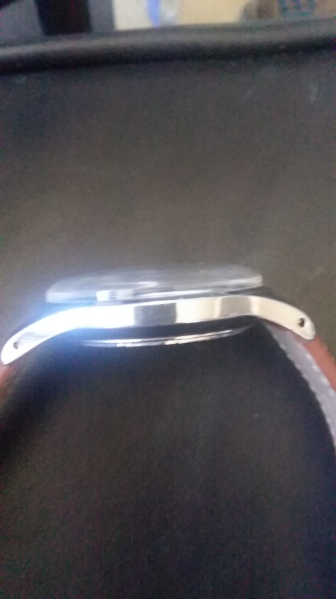

Based on the 2,034,xxx serial number, this would make this watch the earliest known example and it would seem to be earlier than 1961, when the model was thought to have been introduced.
I've also not seen an example with drilled lugs before although this could have been done after the watch had left the factory.
I think we can be fairly confident that it is not one of the Australian fakes that we have seen in recent years. What is uncertain is whether it left the factory like this or whether it has been amended in some way.
The unusual aspects for me remain:
- On the bezel, only the triangle has been lumed
- The fully lumed hour markers
- The missing 'Polerouter Sub' text

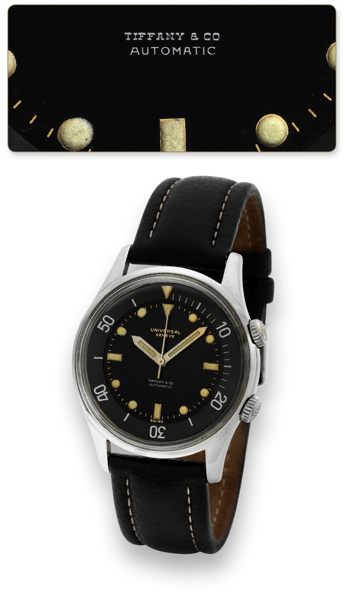

In my opinion, the only possibly genuine example that displays any of these characteristics is the Tiffany's example (pictured below for convenience). That is perhaps where the similarities end though. The lume on the hour markers looks very different in texture and also the Tiffany's watch had a later 218-9 movement, which does not suggest it was a particularly early example (I don't know the serial number). I've not seen any other images of the Tiffany's watch and so couldn't comment on its originality.

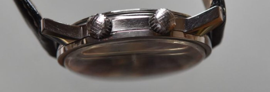

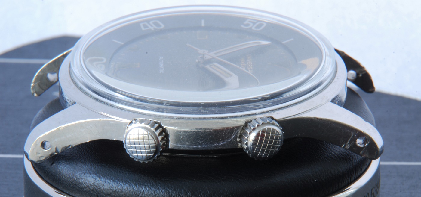

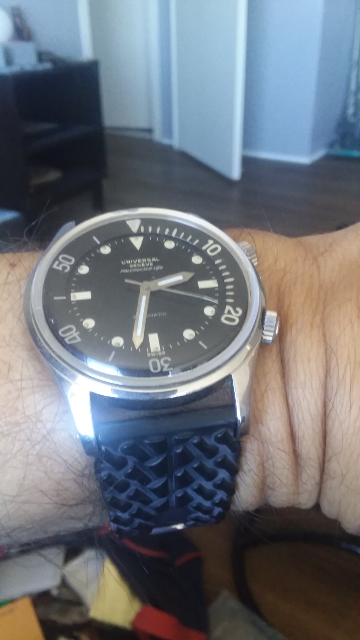

Mine has holes on the lugs. These are beautiful watches ! Installed dive band for a change.
Interesting. Thanks and a gorgeous watch.

Moving on to the next details for review as noted in bold here.
I'd love to see the rest of the watch and in particular I would want to scrutinise the rest of the dial including the hour markers, the bezel, the crowns, the case and the case back (inside and out). It would be very helpful if the serial and case reference numbers were still present too.

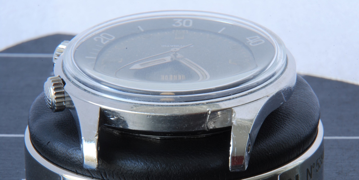

Crowns look good to me with the correct hatching style. No UG symbol on the upper one though and it's not significantly bigger like some of those above.

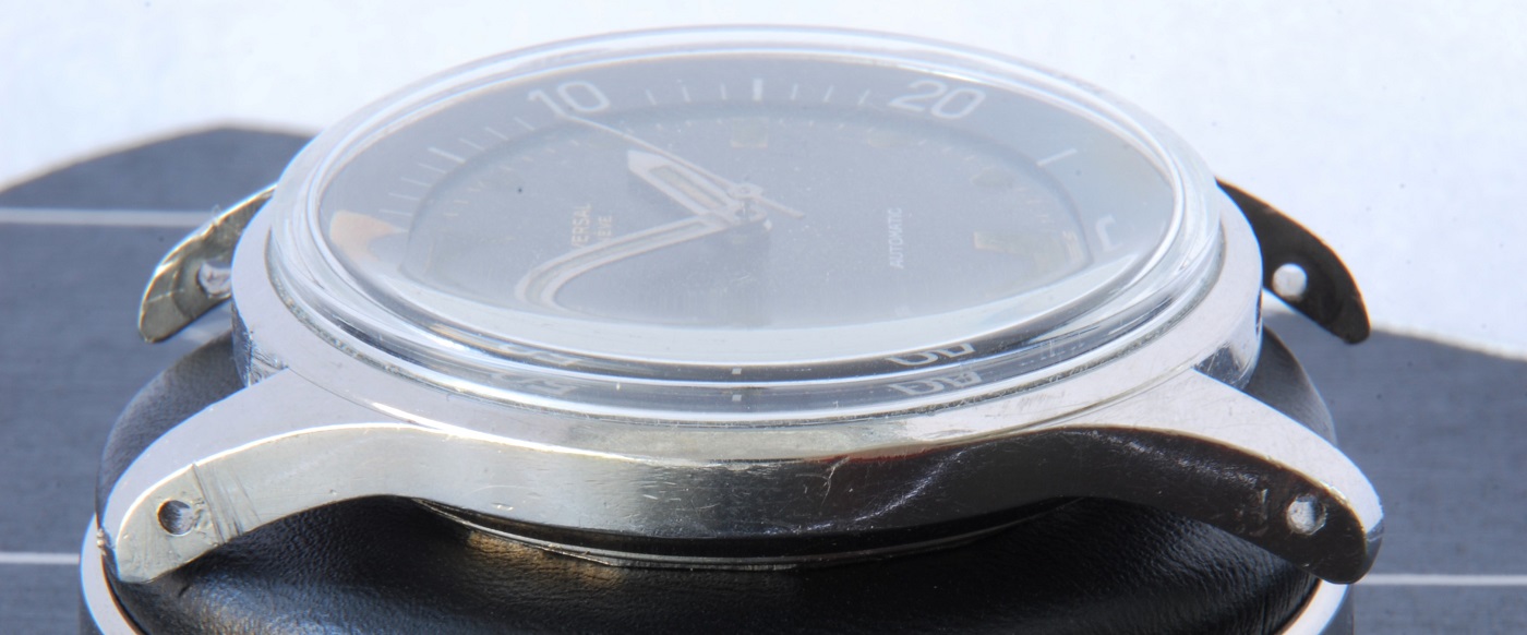

Drilled lugs as the @rolokr example above - this seems to be a valid variation and I think I've found another with drilled lugs.

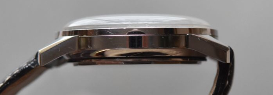

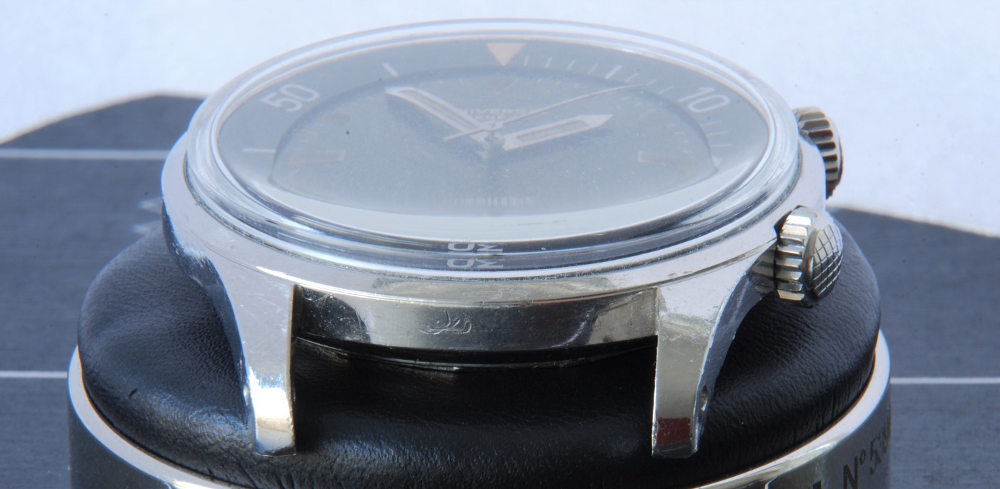

Case has a quality finish but it's sixty years old so has some marks obviously... If it has been polished, it was lightly and decades ago so the slight blurring of the edges may just be wear.

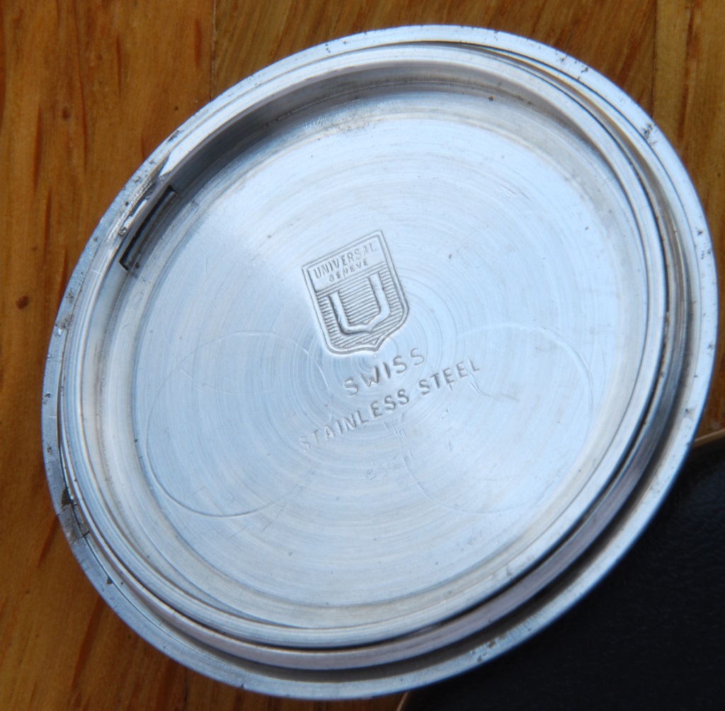

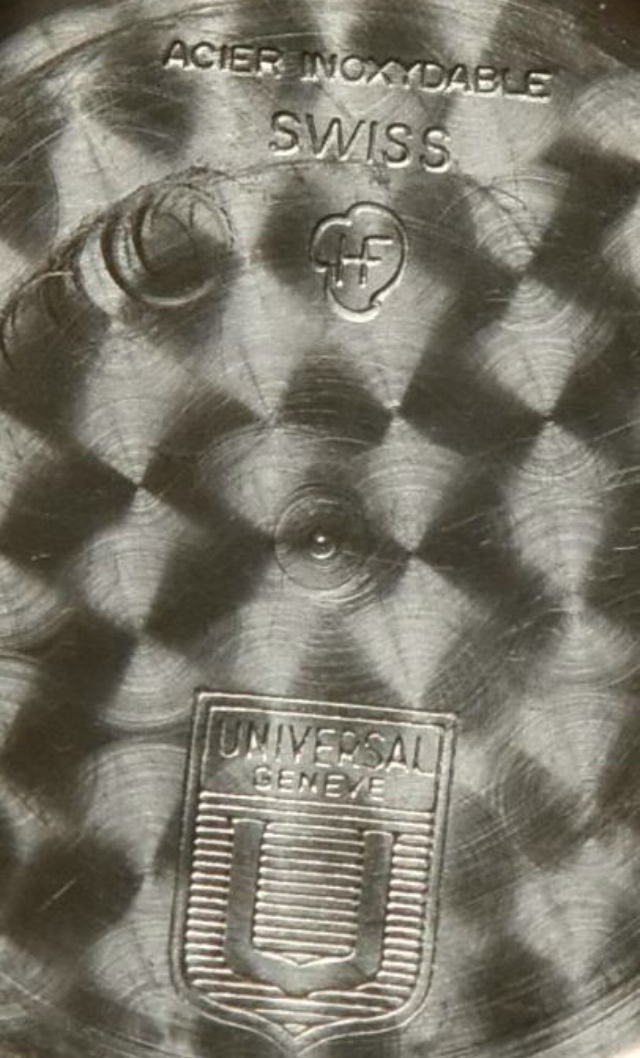

Rear of case back and this also looks well finished plus has the case number 20369/1 and opposite that the serial 2034xxx. There is a very clear triangle on the case back and on the case (directly between the crowns and just about visible). It looks as if someone saw those triangles lined up and thought that indicated where to put a case knife to remove a snap back... There is a little damage to the case back there because of that.

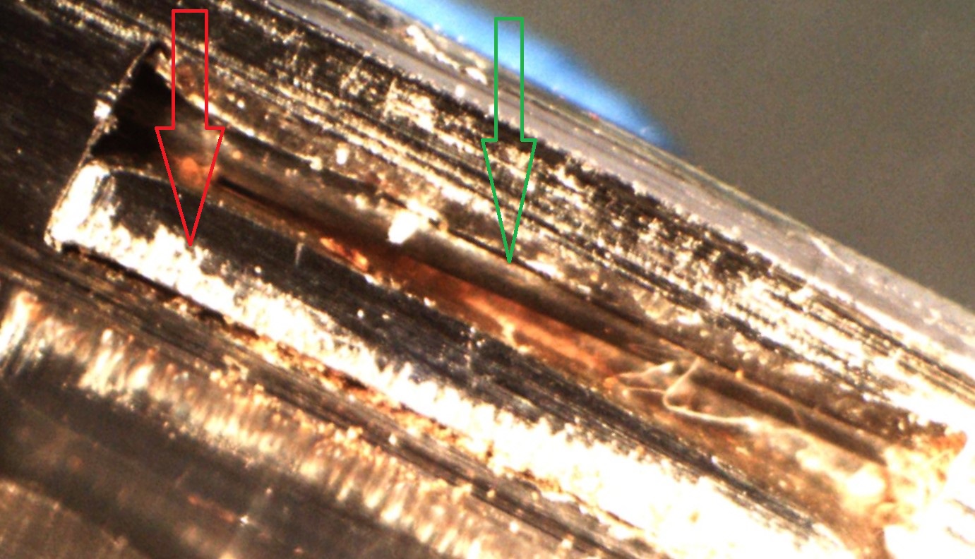

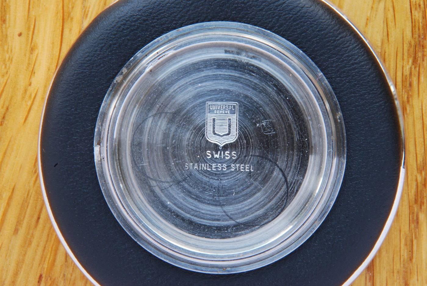

Inside of case back and I reckon this is the same finish and symbol as these ones from @Mazoue . Note the extra ring marks so I suspect it has had rotor issues🤦
But, you don't see a gap in the ring... It's very hard to see the gap in the photos of other watches but it seems to be there because in those cases the threaded portion of the case back is a separate piece, and it has a tang that fits in the slot, plus you should have a spring so that the case back is compressed against the case as that is part of the super compressor design. This one also has a separate screw ring and if we look in one area, we see this in the top left:
Zooming on on the top left and we see that it's not a gap on this case - it's a slot and it has a retained wire spring (green arrow) with the tang shown as a red arrow. This is a much nicer design than having a gap (if I understand those photos correctly) but far more expensive to make for both the case, screw ring, spring and the assembly. To me, this indicates that all the cases with a gap are after a "production easement" to save money and this is just an early case with a more expensive construction (but the same style and function of parts).
Well, I'm not sure there is much more I can show and it's been interesting to see some of these variations from the norm. Enjoying this investigation and I'll do some more, out of interest.

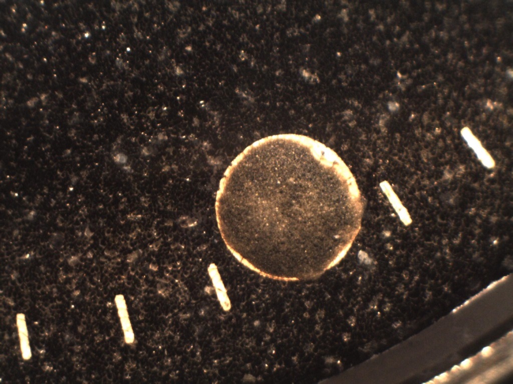

I looked again under the microscope and I can't see any indication of the small lume dots having been replaced so, as that's an outstanding question, I think the lume was full size on these early batches. Let's see if there are any other examples with full lume but with a correct dial, case, bezel etc (that is, not one of those Australian watches which this is clearly not👍).
Thanks for the help, Chris

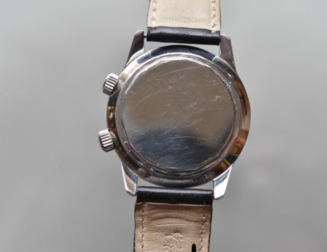

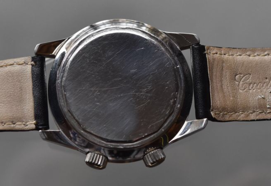

Hi guys!
I just finished to read this very interesting discussion, but there are things that are not so clear to me.
I have seen this piece on auction in Catawiki:
https://aste.catawiki.it/kavels/23539105-universal-gen-ve-super-compressor-uomo-1960-1969?
And I am not sure about it. I mean, watch appears to be relumed - this is quite clear - and dial appears to be an "Australian" one.
But what about the perlage finish of the caseback? And case appears to be in good health, with not "black signs" on the lugs. Movement is a 215-2.
What do you think guys? Thank you for your help.
Some pics:
