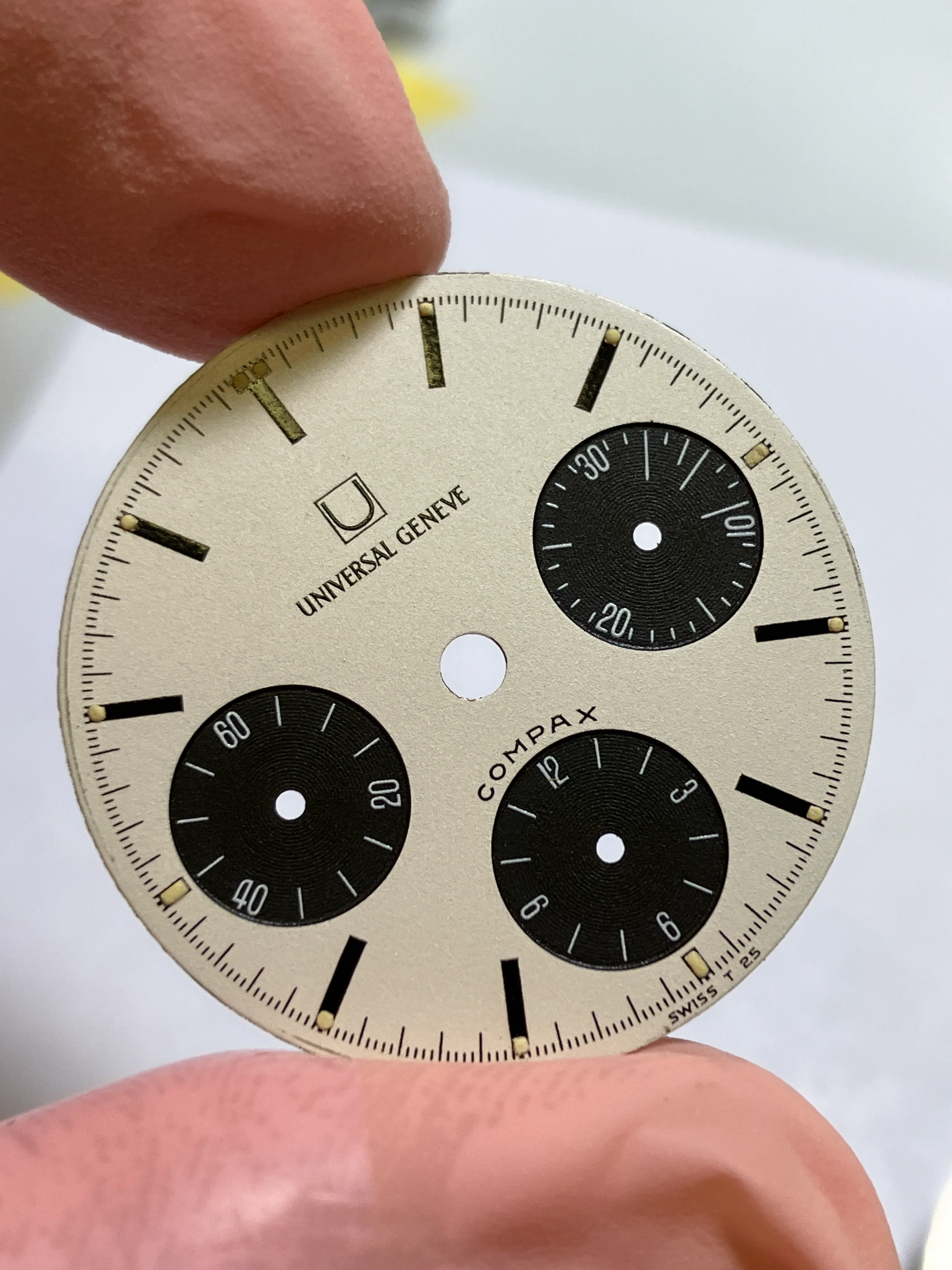

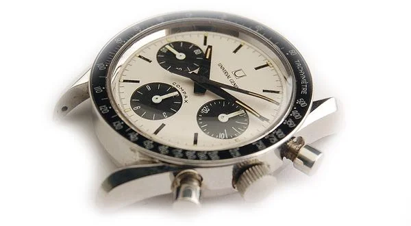

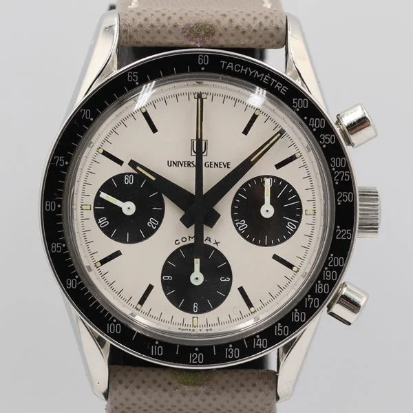

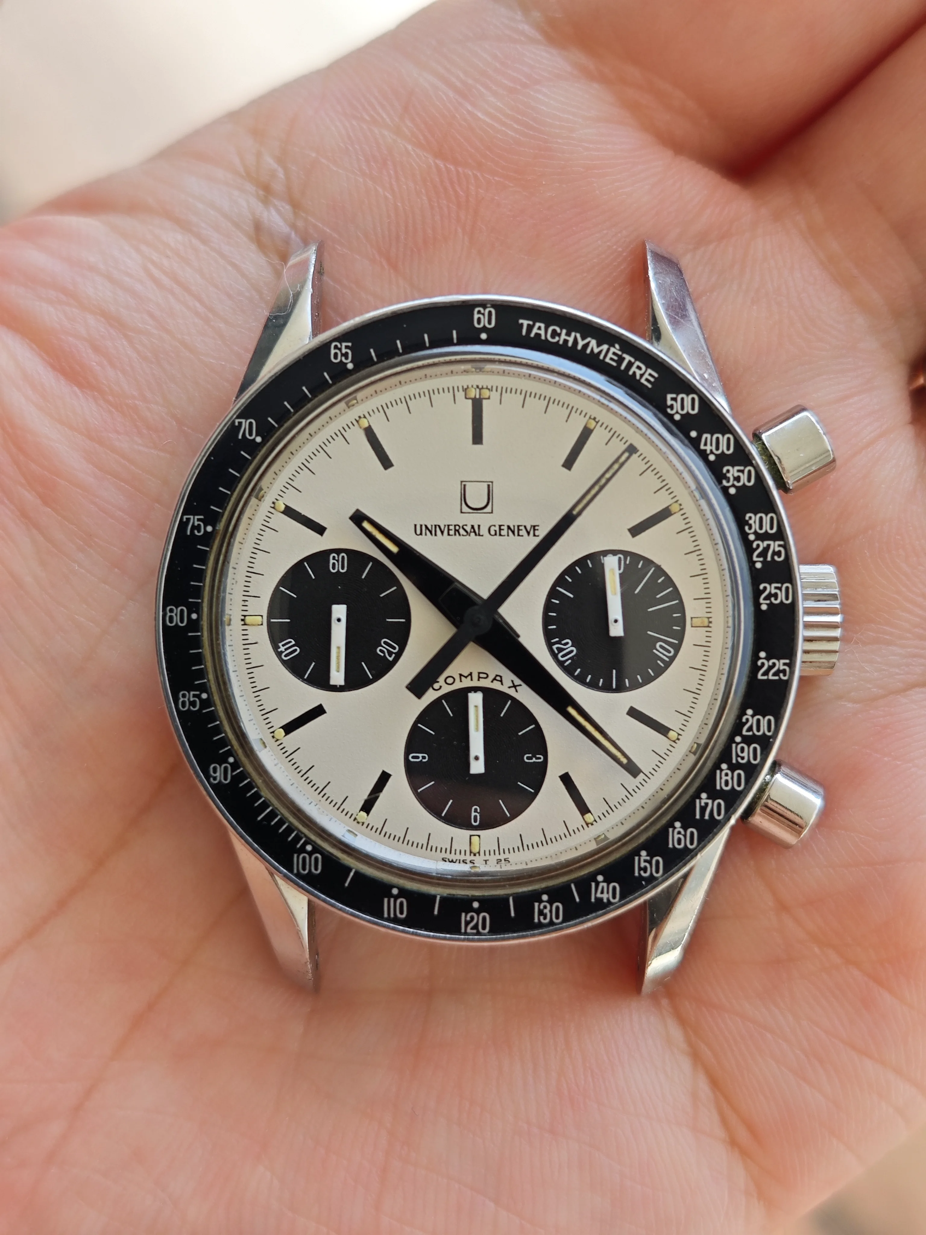

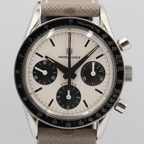

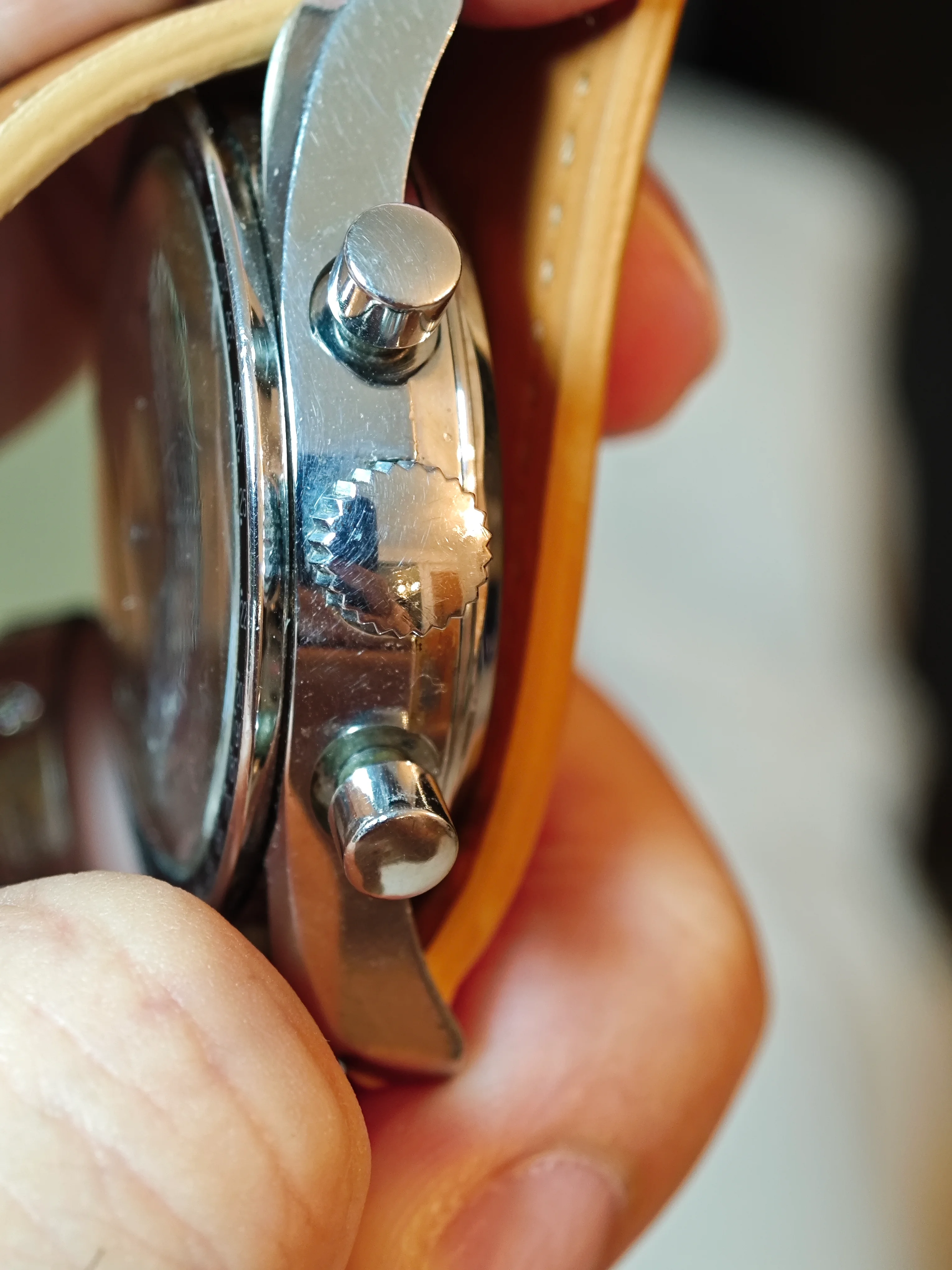

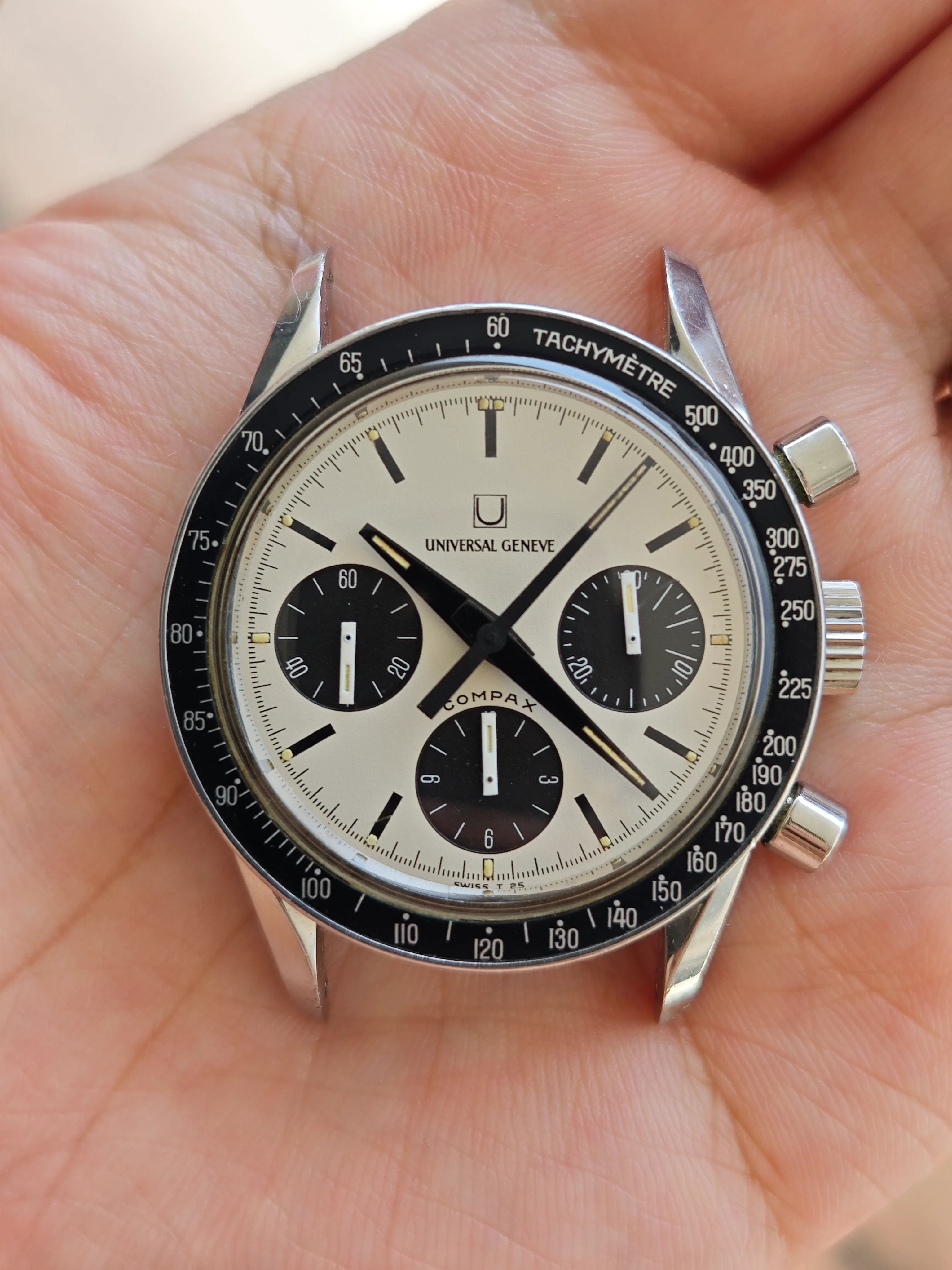

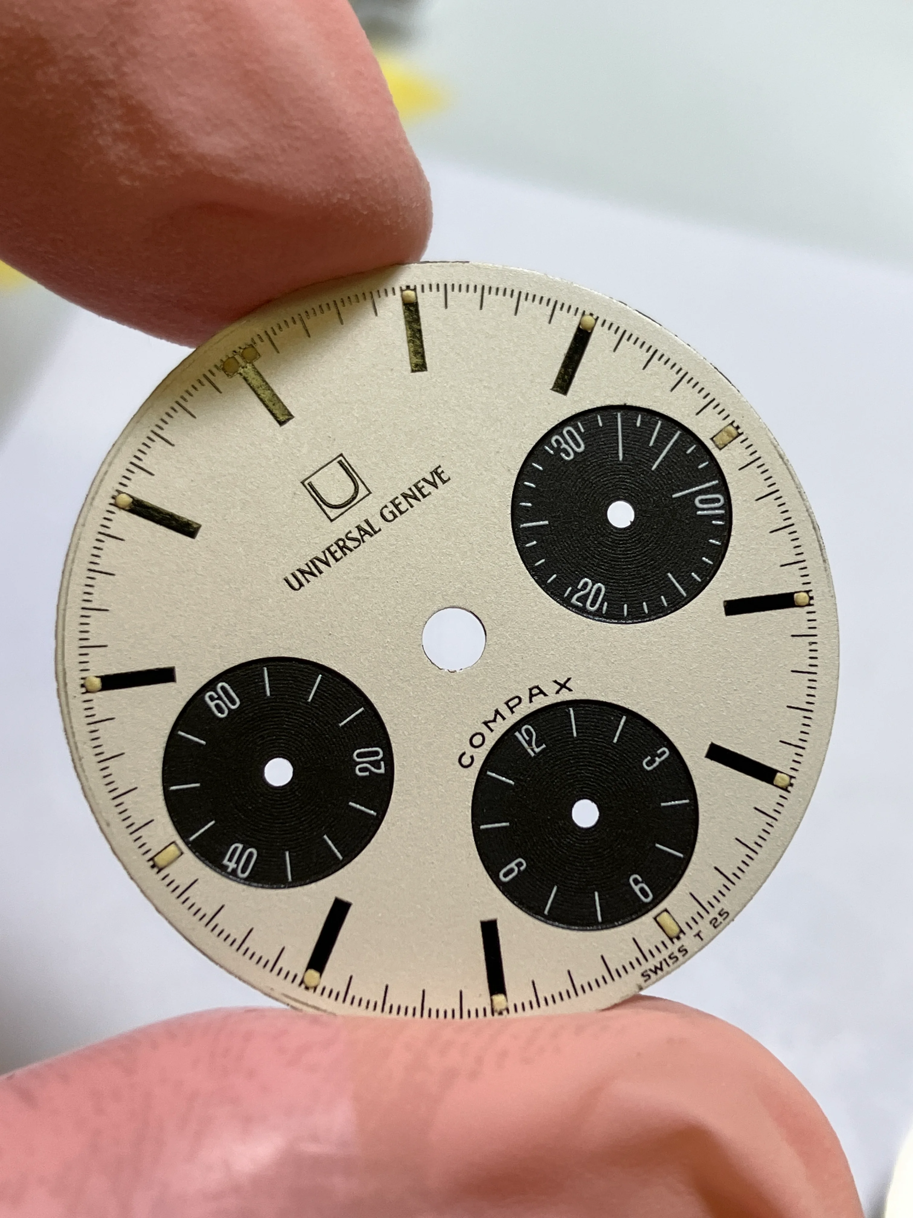

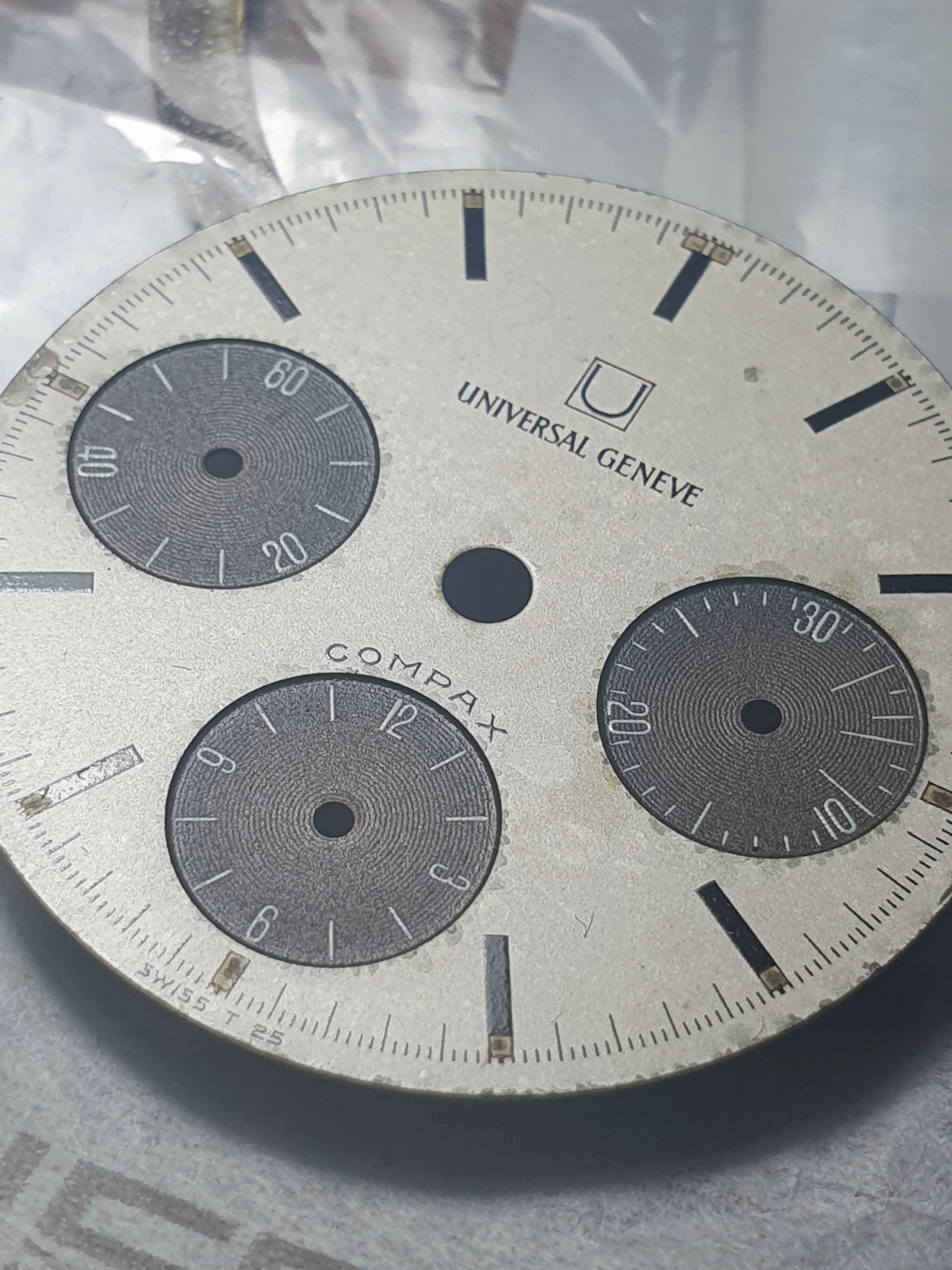

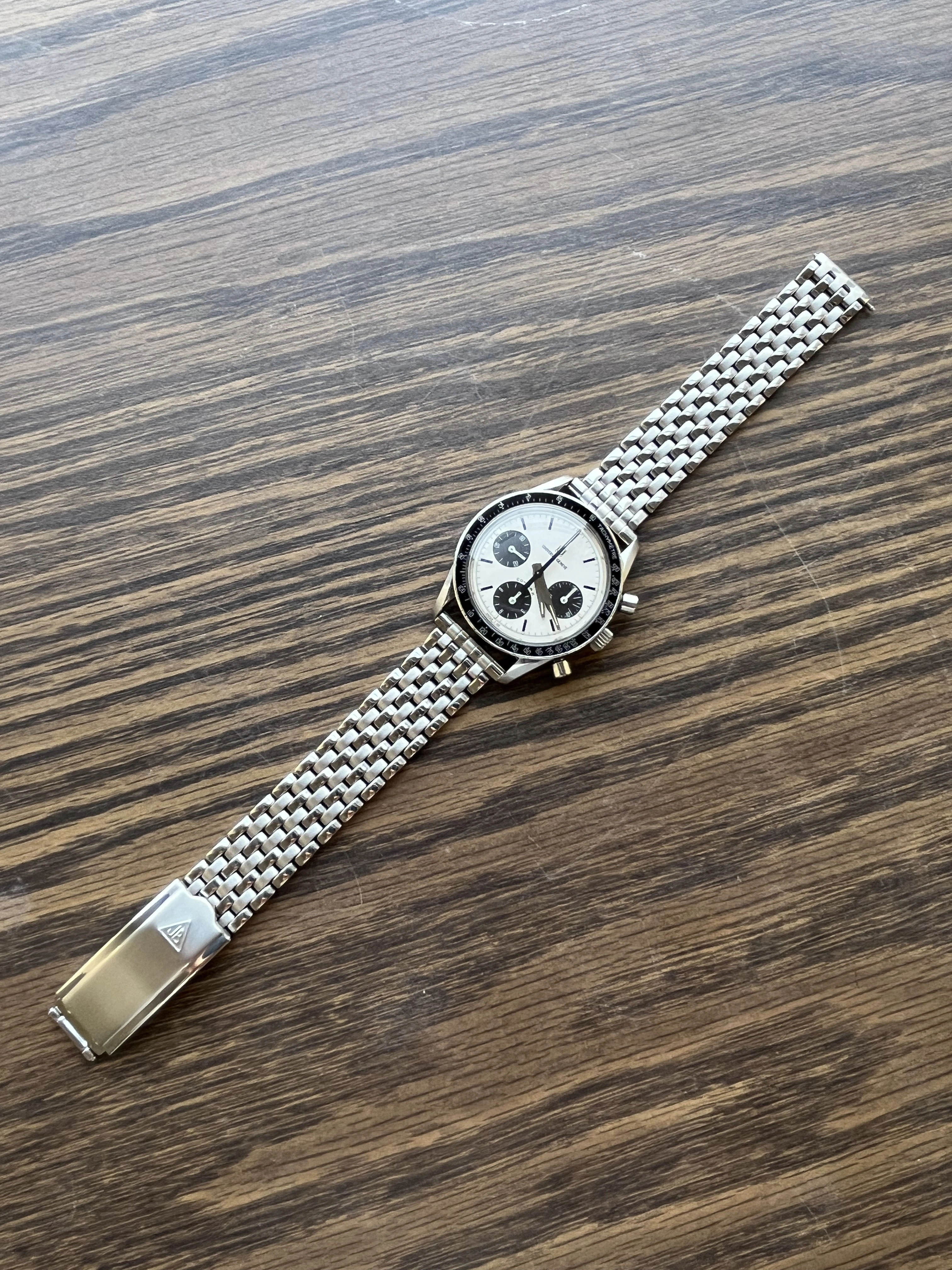

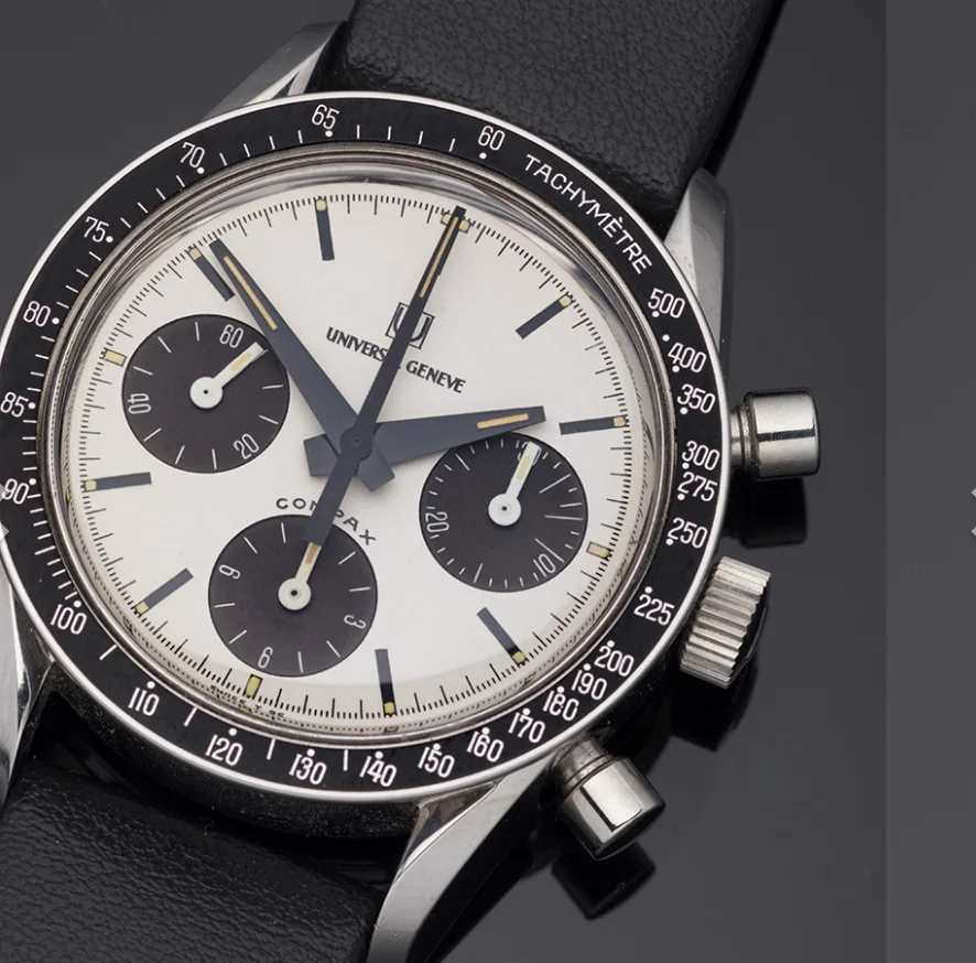

Recently, I acquired a very beautiful Nina, with incorrect /01 case back. It reminds me of several examples I saw in Japan, so I did a quick research online and would like to share the result here and gather more information.
The Nina I acquired is also from Japan according to the seller. Below are the pictures.
Key highlights:
Origin: Japan

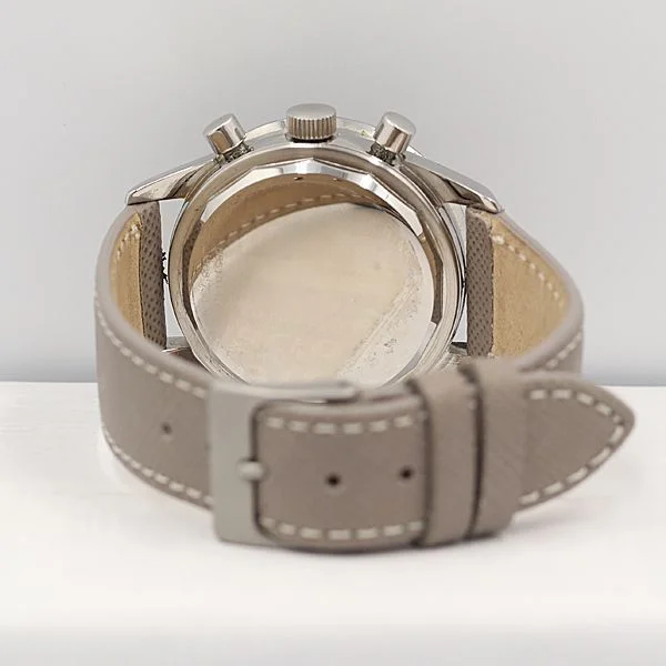

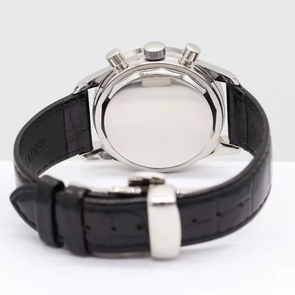

Case back: Incorrect /01 case back.

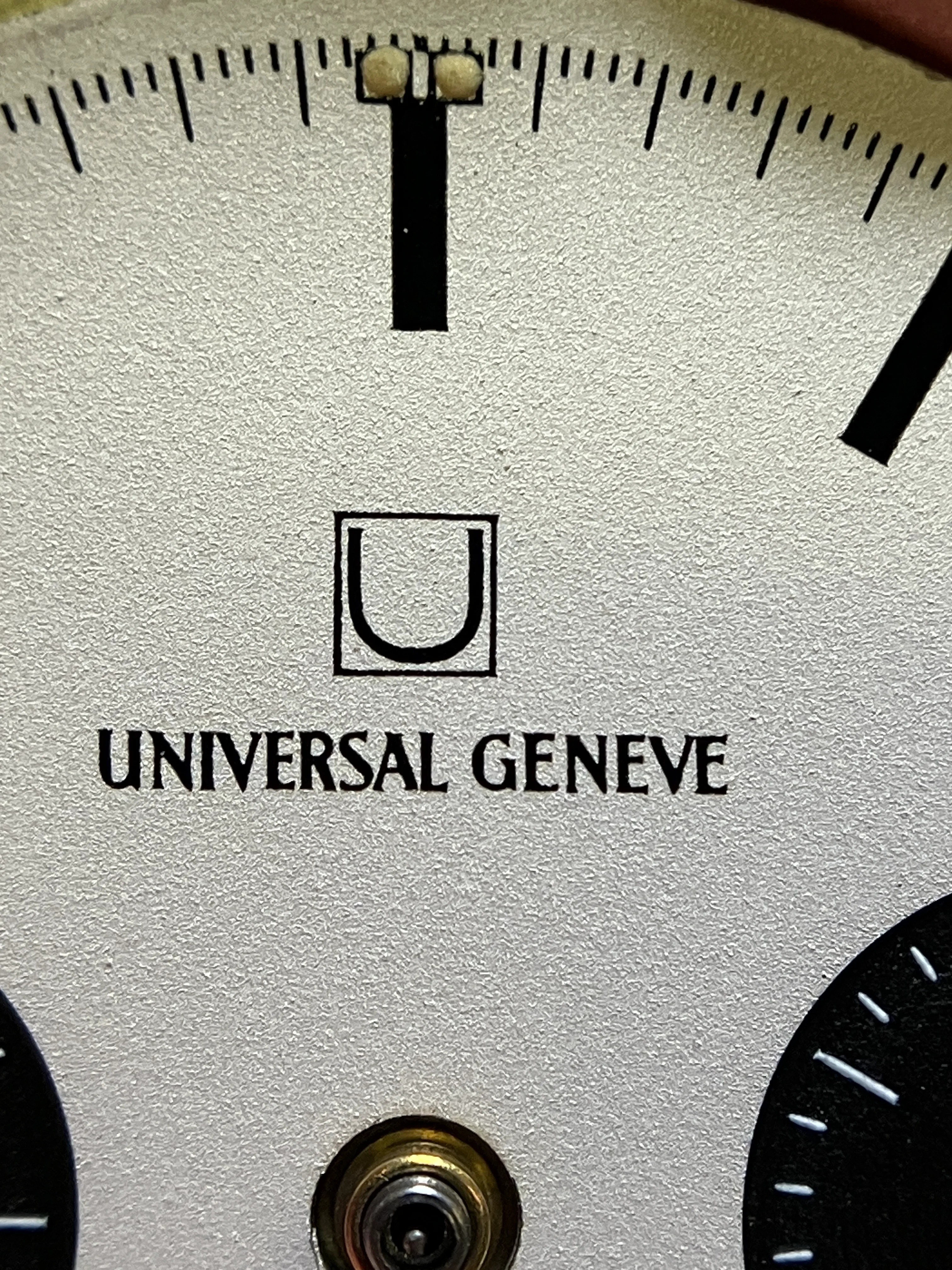

Dial: Printed Logo + Mid sized sub register hands.
Crown: Unsigned crown.
Serial number: 2568xxx
So I searched online and found several similar examples:

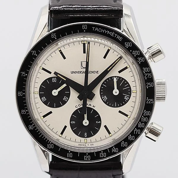

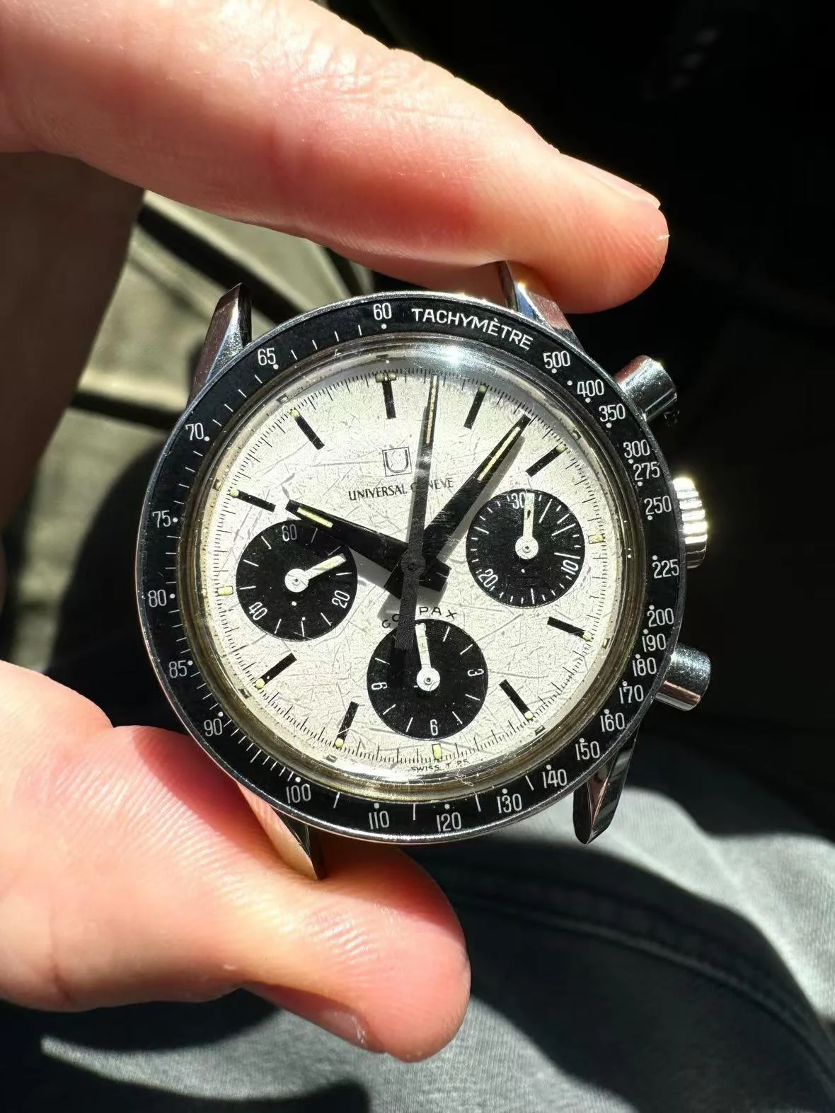

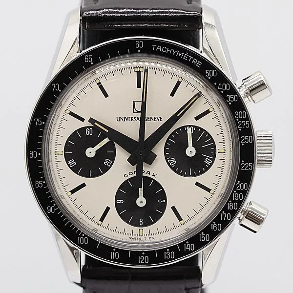

Sample 1:
Link: https://jp.mercari.com/shops/product/xgAwP6qcA9Vj3ndVnjU7D4
Images:
Highlights:
Origin: Japan
Serial number: Unknown
Remarks: Exact same configuration as mine. Serial number unknown.

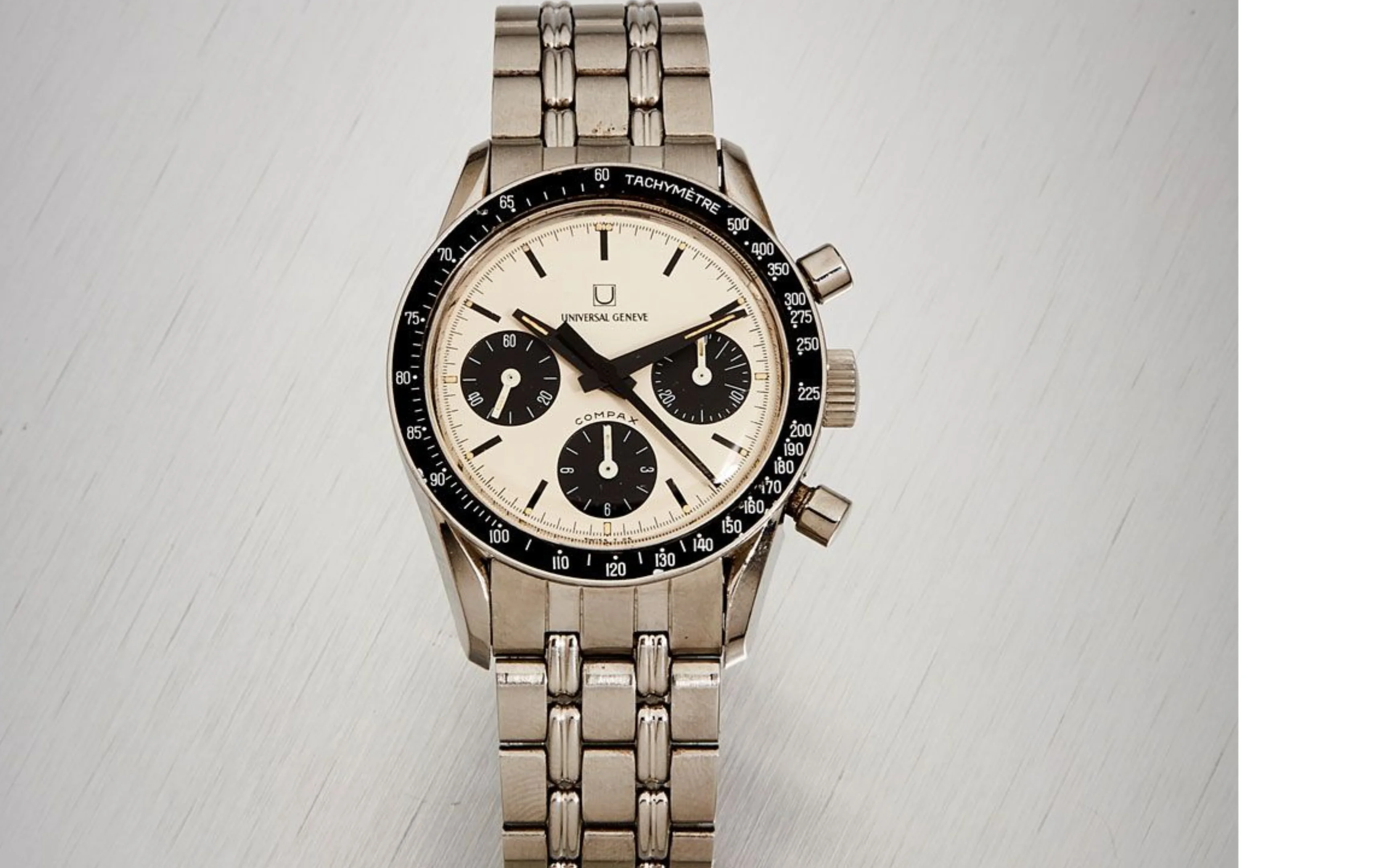

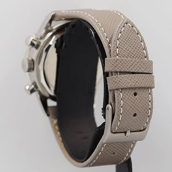

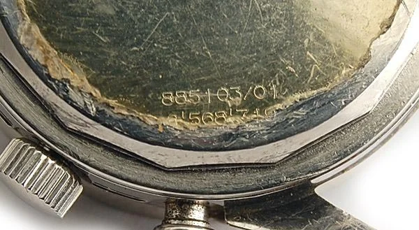

Sample 3:
Link: https://www.hasegawa78.jp/onlineshop/products/detail/3596
Images:
Highlights:
Origin: Japan
Serial number: 2568719
Remarks: Exact same configuration as mine. Serial number in 2568xxx range.

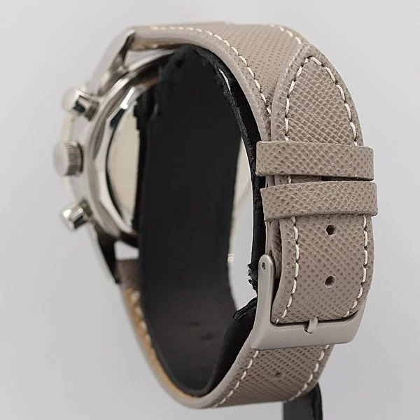

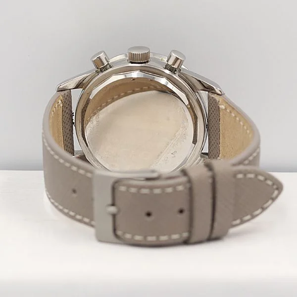

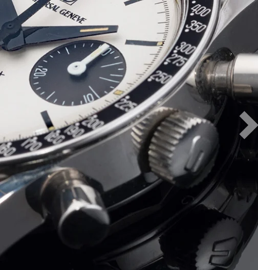

Sample 4:

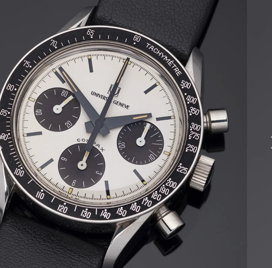

Link: https://www.gazette-drouot.com/en/lots/15557468-universal-geneva-compax----
Images:
Highlights:
Origin: Unknown
Crown: Looks like unsigned.

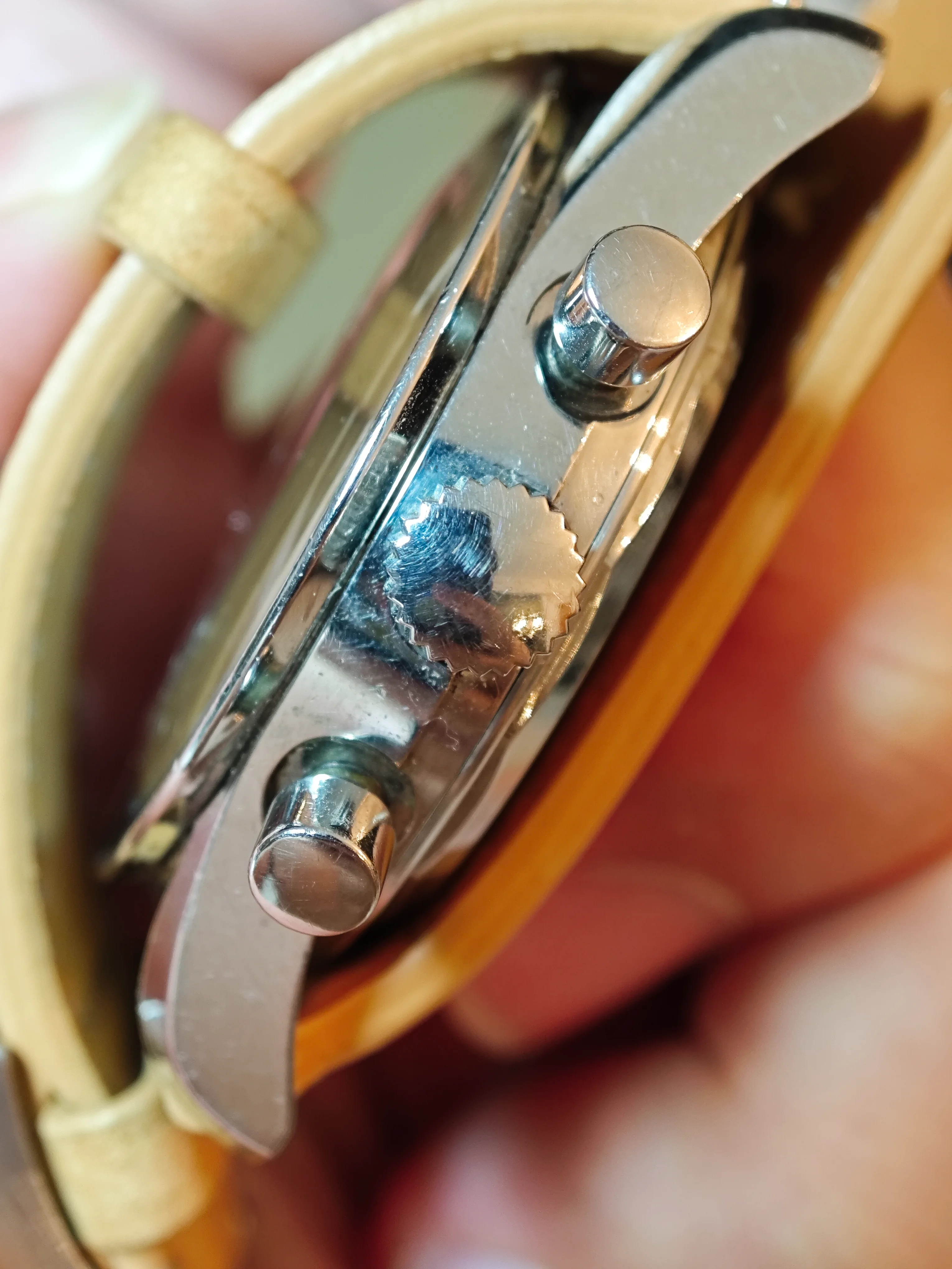

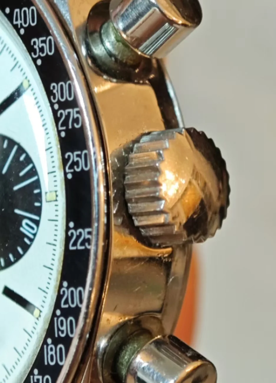

Sample 5:
Link: https://omegaforums.net/threads/a-01-non-evil-nina-with-unusual-crown.96371/
Images:
Highlights:
Origin: Unknown
Case back: Correct /02 case back.

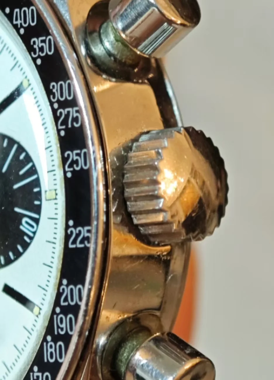

Crown: Incorrect crown.
Serial number: 2568881
Remarks: Almost the same configuration as mine, crown might be changed to a period incorrect crown. Serial number in 2568xxx range.

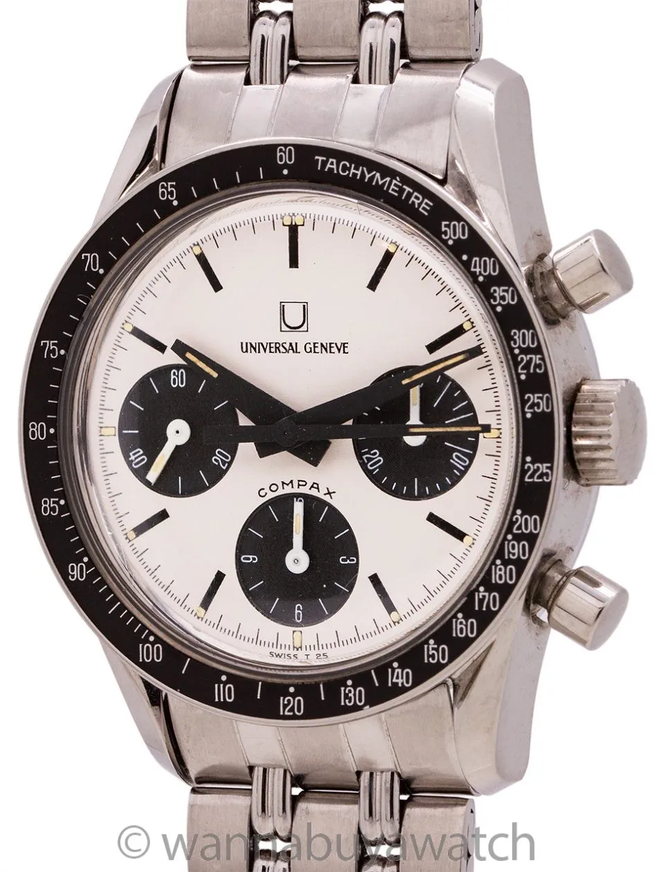

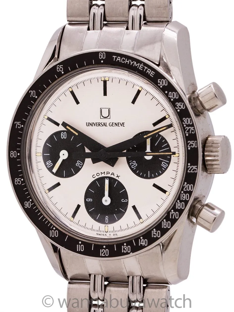

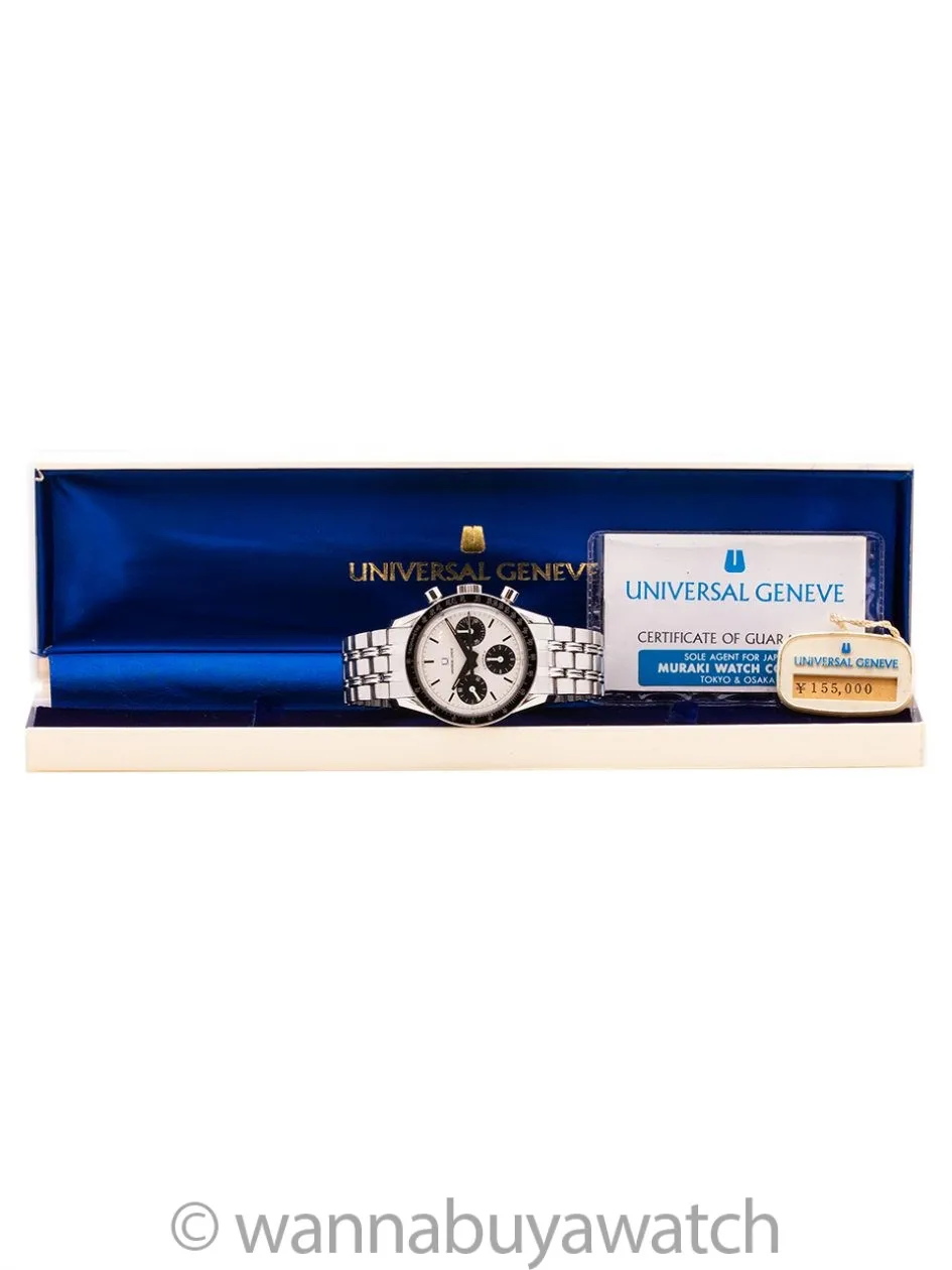

Sample 6:
Link: https://wannabuyawatch.com/product/...ina-rindt-chronograph-circa-1960s-box-papers/
Images:
Highlights:
Origin: Japan
Serial number: 241XXXX
Remarks: Exact the same configuration as mine. Serial number is too early for this dial, so the case back might be changed, or the Japan distributor just use available parts to assemble these watches. This watch comes with certificate of guarantee from Muraki, the UG distributer in Japan.

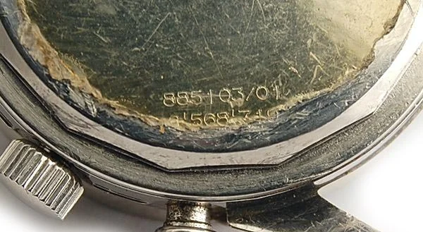

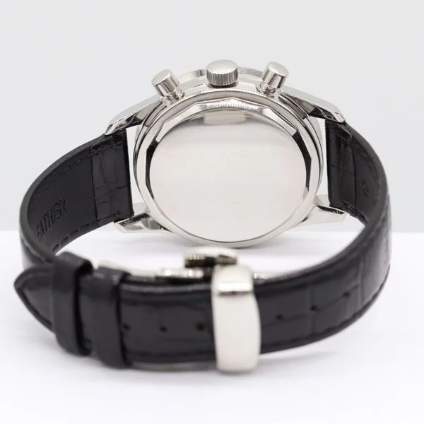

Interestingly, I checked https://alphahands.com/faq/universal-geneve-nina-rindt-serial-number-project/ and all of the 3 examples recorded in the 2568xxx range has the same characteristics: /01 case back, printed logo on dial, midsize sub register hands.
I would like to gather more information on this topic, so if you have a similar watch, please share. Actually I would also like to see whether there is a Nina in 2568XXX range with correct /02 case back.

What is the working theory here, that later Ninas were sometimes fitted with /01 casebacks from factory?
edit to add: that's a real beauty you've found. I bet that dial is pristine under that scratched crystal.
562
2,738

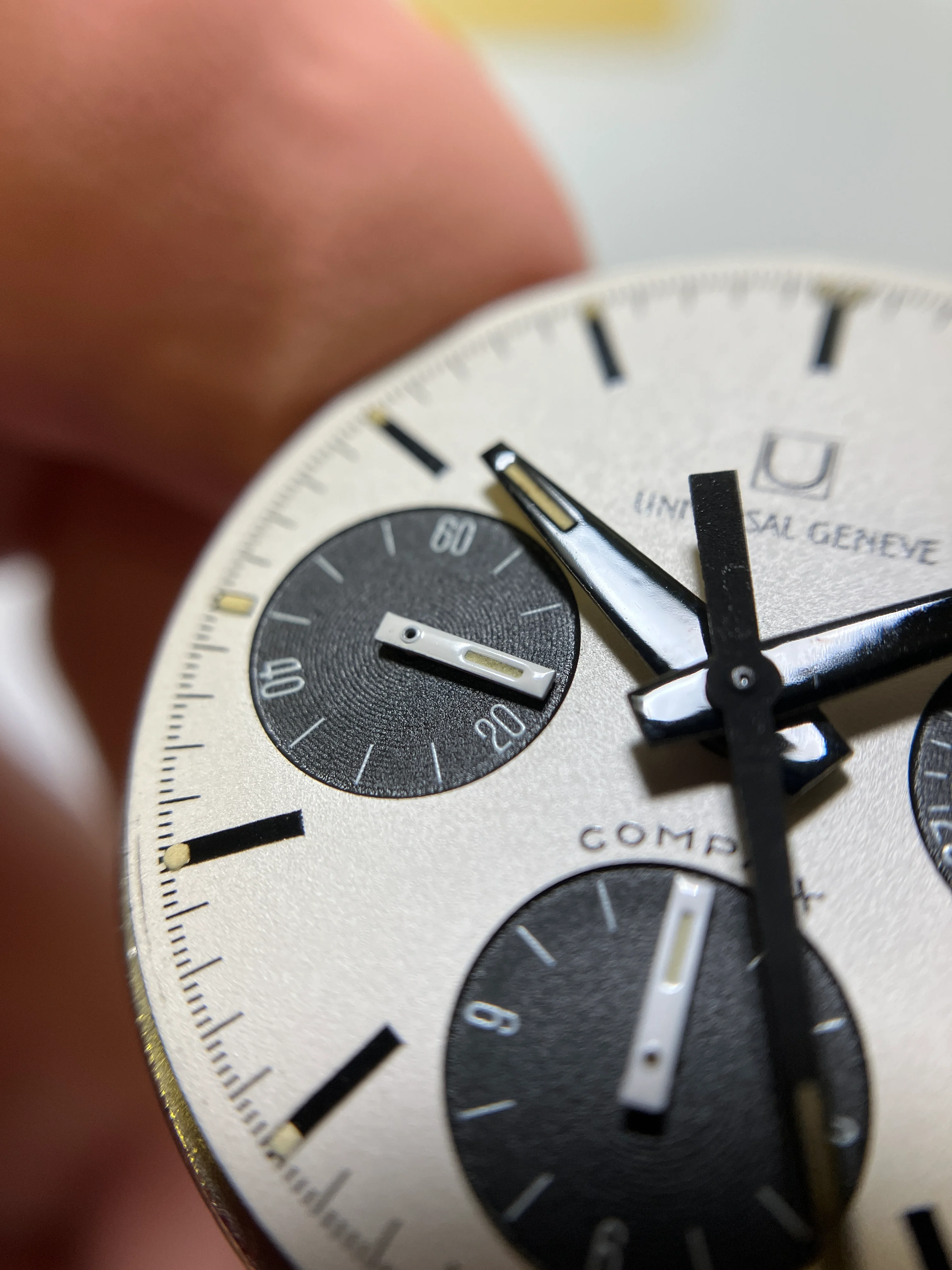

I'm guessing that the Japan distributor MURAKI assembled and sold these Ninas. The main purpose I posted here is to gather more information. I'm very interested to see if there exist any Nina with correct case back (/02) in 2568xxx range.
Yes, the watch is very beautiful. One of the sub register hands lume is cracked, so it is now installed with the later square hands, but I do have the original hands with me.
1,165
1,492

2569xxx Nina with /02 case back is very common, but I have not seen a 2568xxx Nina with /02 caseback.

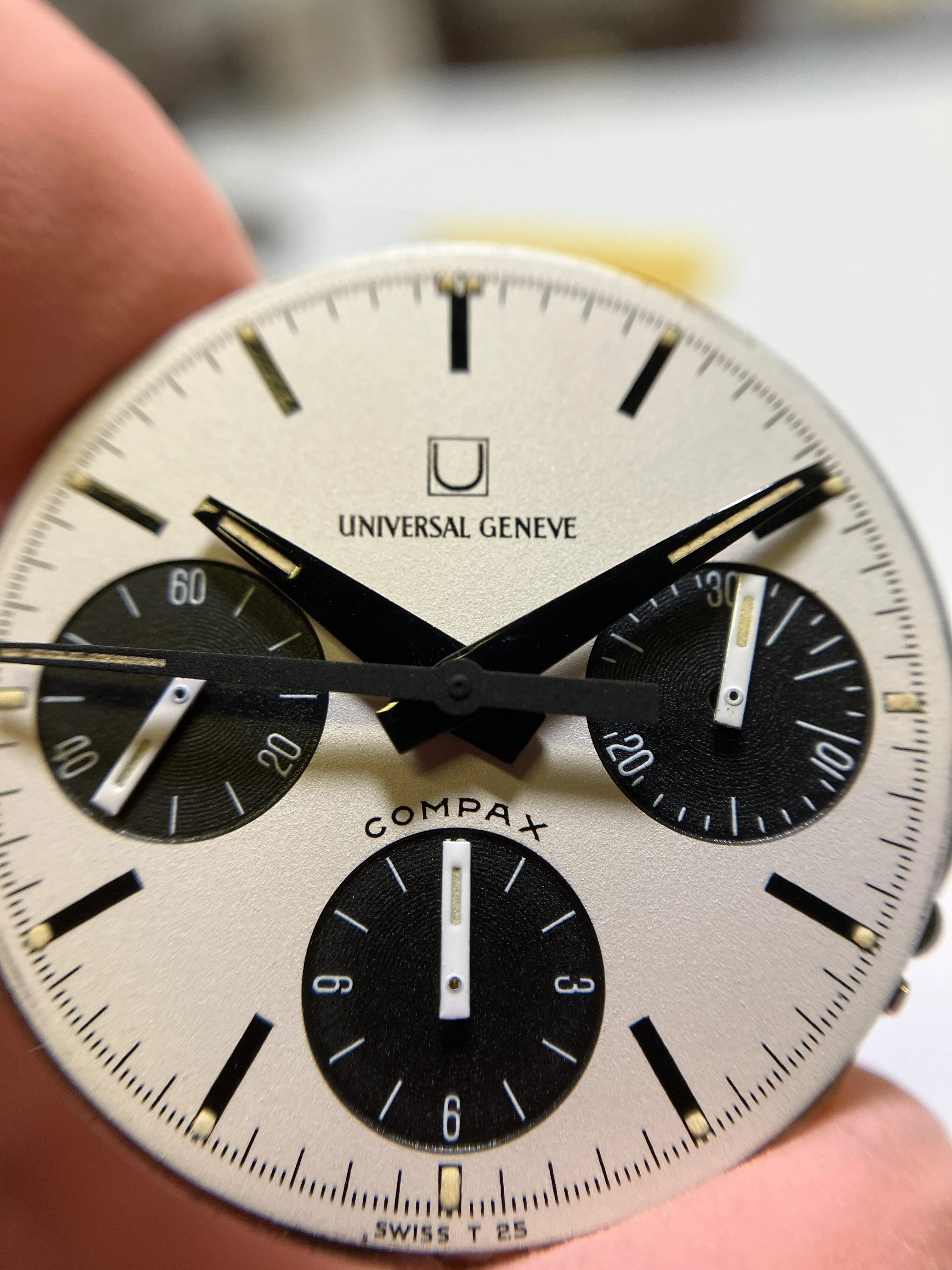

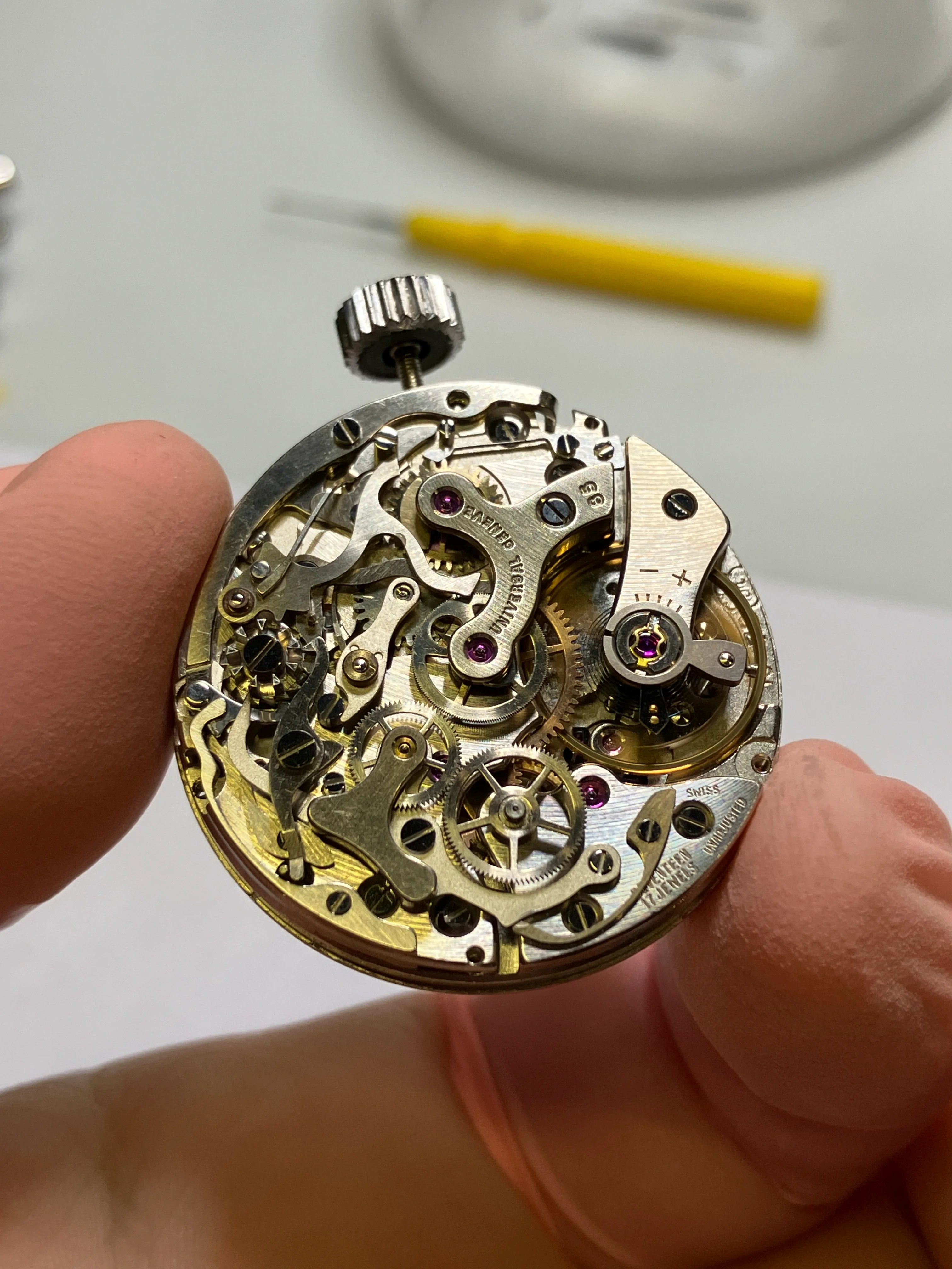

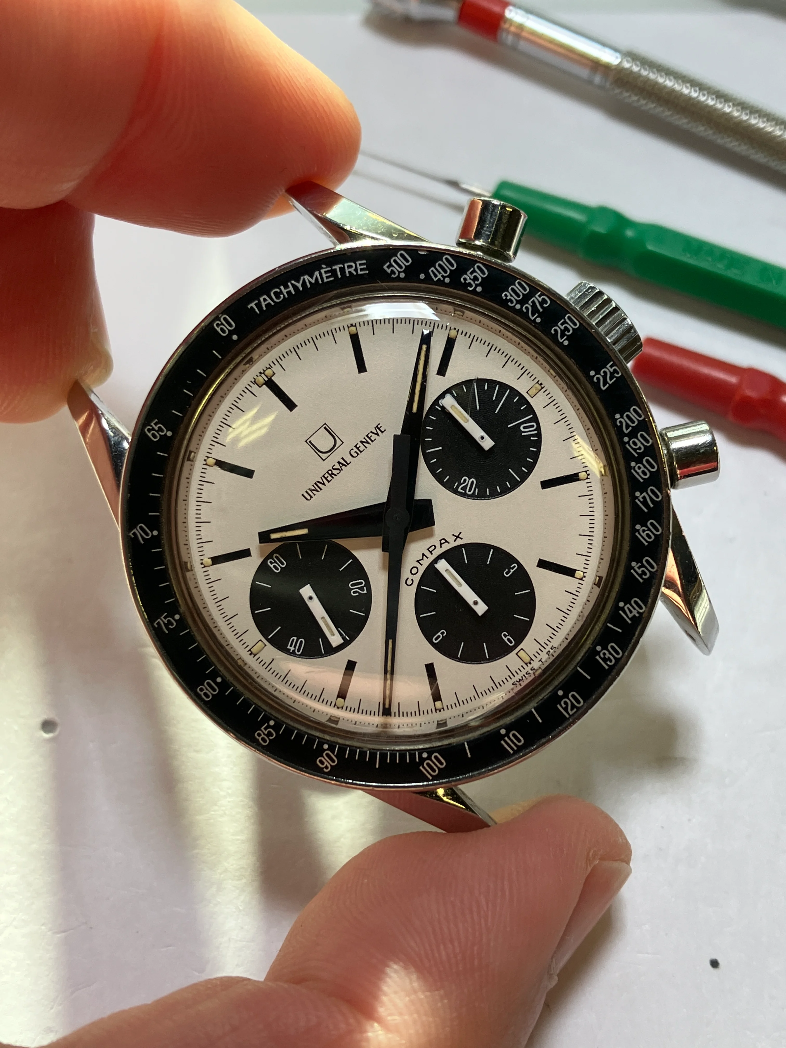

This is the first time I have a UG watch in my hand. I was stunned by UG's meticulous attention to detail. As you can see the chrono hands are not reset properly now. I've sent it to my watchmaker for a full service.
1,165
1,492

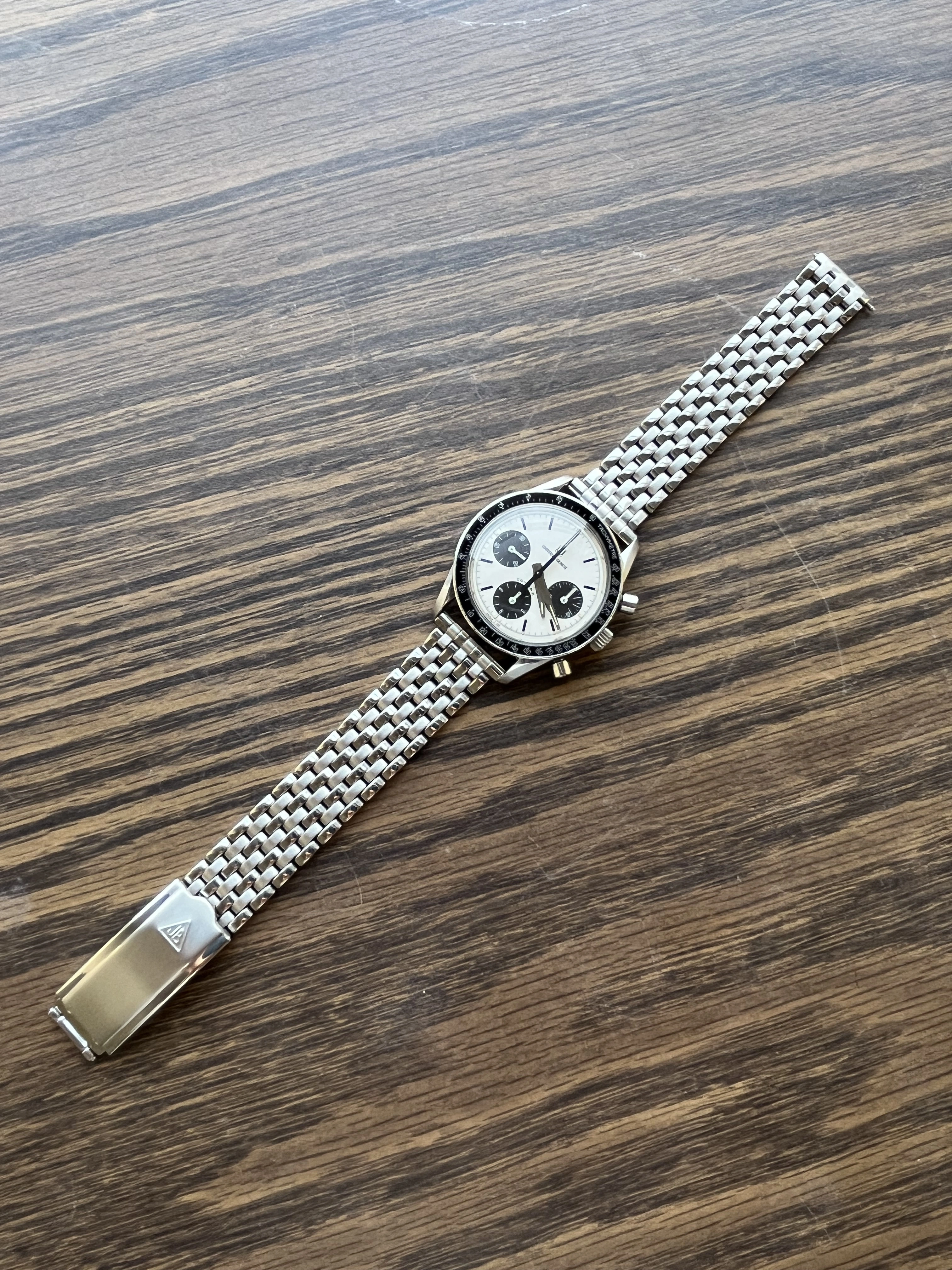

Best of luck to you. I hope your watchmaker can sort it out and get it running as new again. If you don't have a bracelet for it, I found that JB Champion makes some that are very nice, comfortable, and easy to size (and fairly priced!). I chose a BOR with straight ends.
562
2,738
I immediately placed an order from Fostner after seeing your picture...
1,165
1,492
Post up photos when you get it mounted. It’s not the quality of an original, but I felt is was good enough. The watch is just so perfectly balanced; you will love it.

You made a great decision grabbing this. I was contemplating it as well and spoke to the seller. The price was compelling and his honestly in disclosing all the flaws made it more tempting. While it may be hard to get an "original" /02 caseback its on the side of the watch that is rarely viewed except during inspections. The Compax (and Tri's) of this era are notorious for their reference/serials rubbing off completely so who knows how many there might be that don't have their serials visible but which may have been /01 and period correct. We can only guess....
562
2,738
I immediately pulled the trigger after I saw it, because I've seen several Nina with 01 case back and they were all priced with almost no difference as if they were with 02 case backs.
1,536
3,177
The correct reference is /02 for the Nina and there is plenty of documentation to support that. It was not as popular as the evil Nina and fewer numbers were made. What May explain the presence of /01 cased Nina’s is that in order get around import and customs restrictions as well as tariffs, some countries imported movements and material (dials, hands and cases) separately and used local suppliers for bracelets and in cases (a good example of that is the denison cased omegas). It may explain why some UGs of the era may have incorrect case backs. Just down to using what was available.

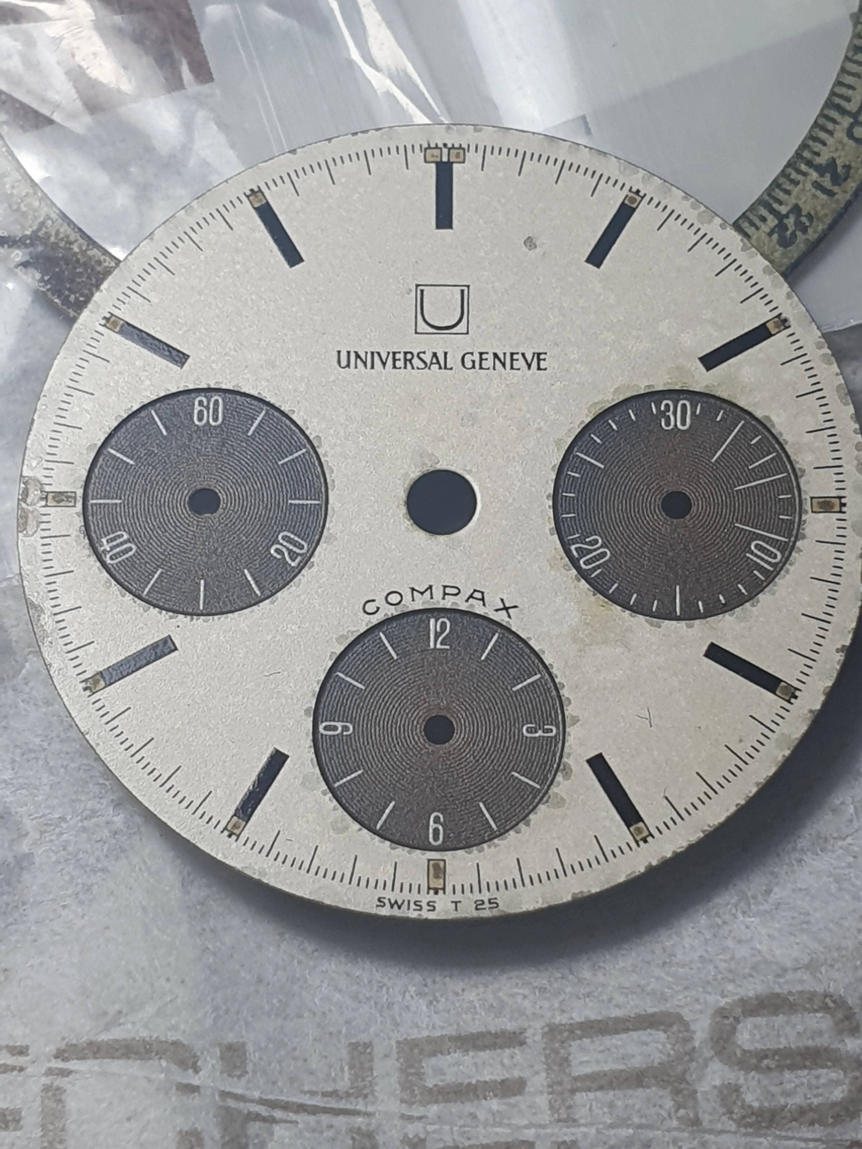

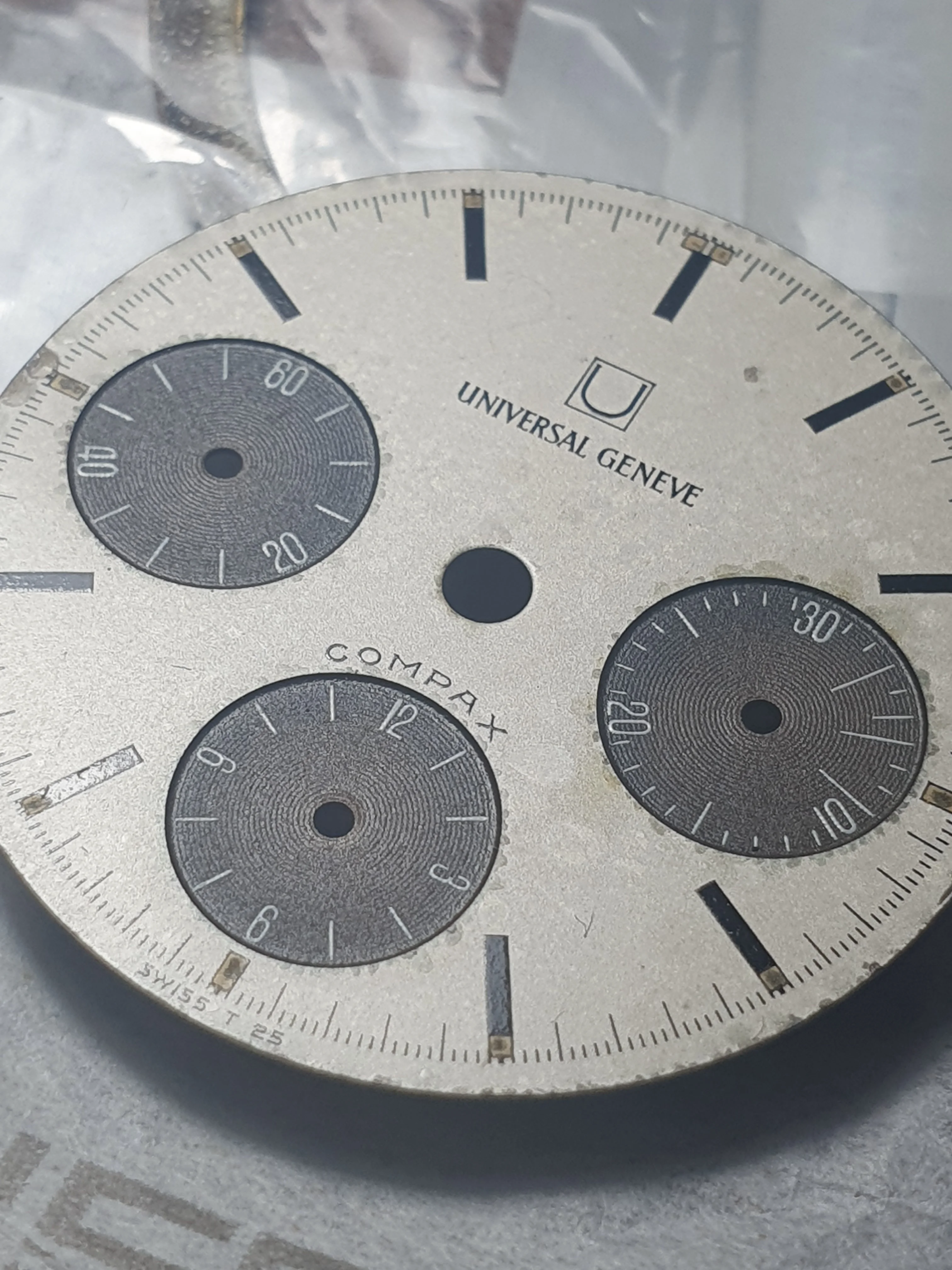

They change after decades ... the subdial/registers go a brownish tint ...

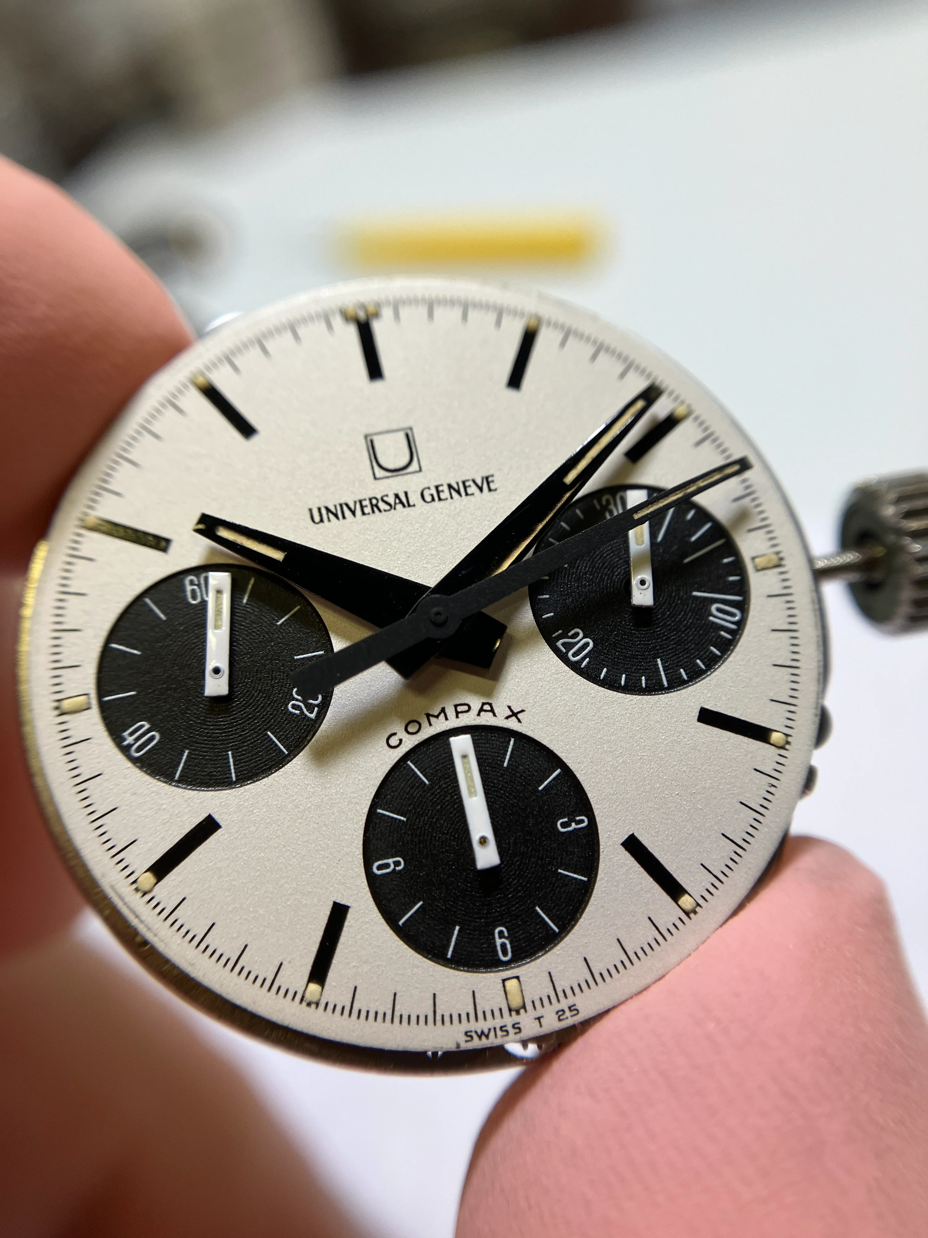

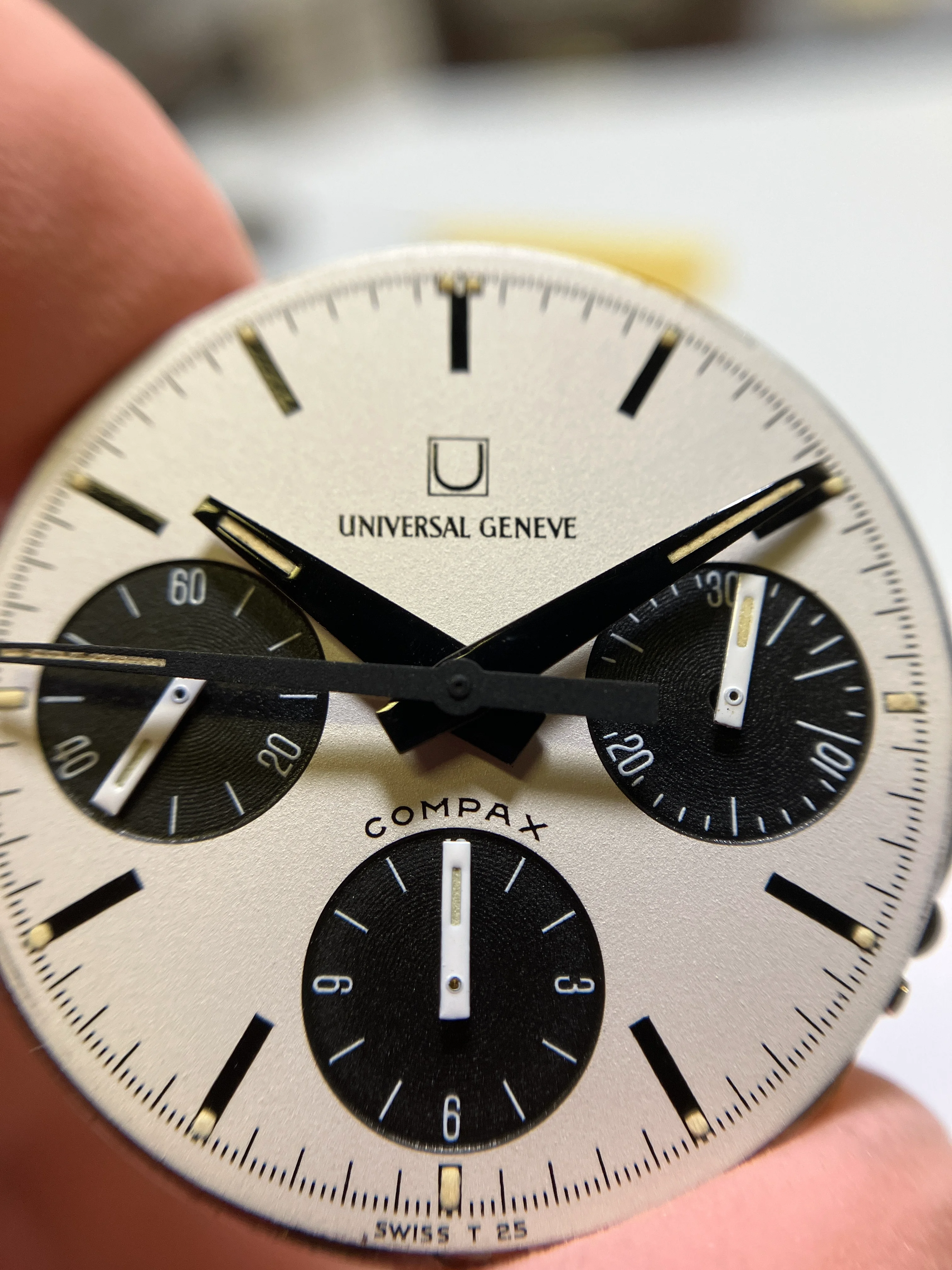

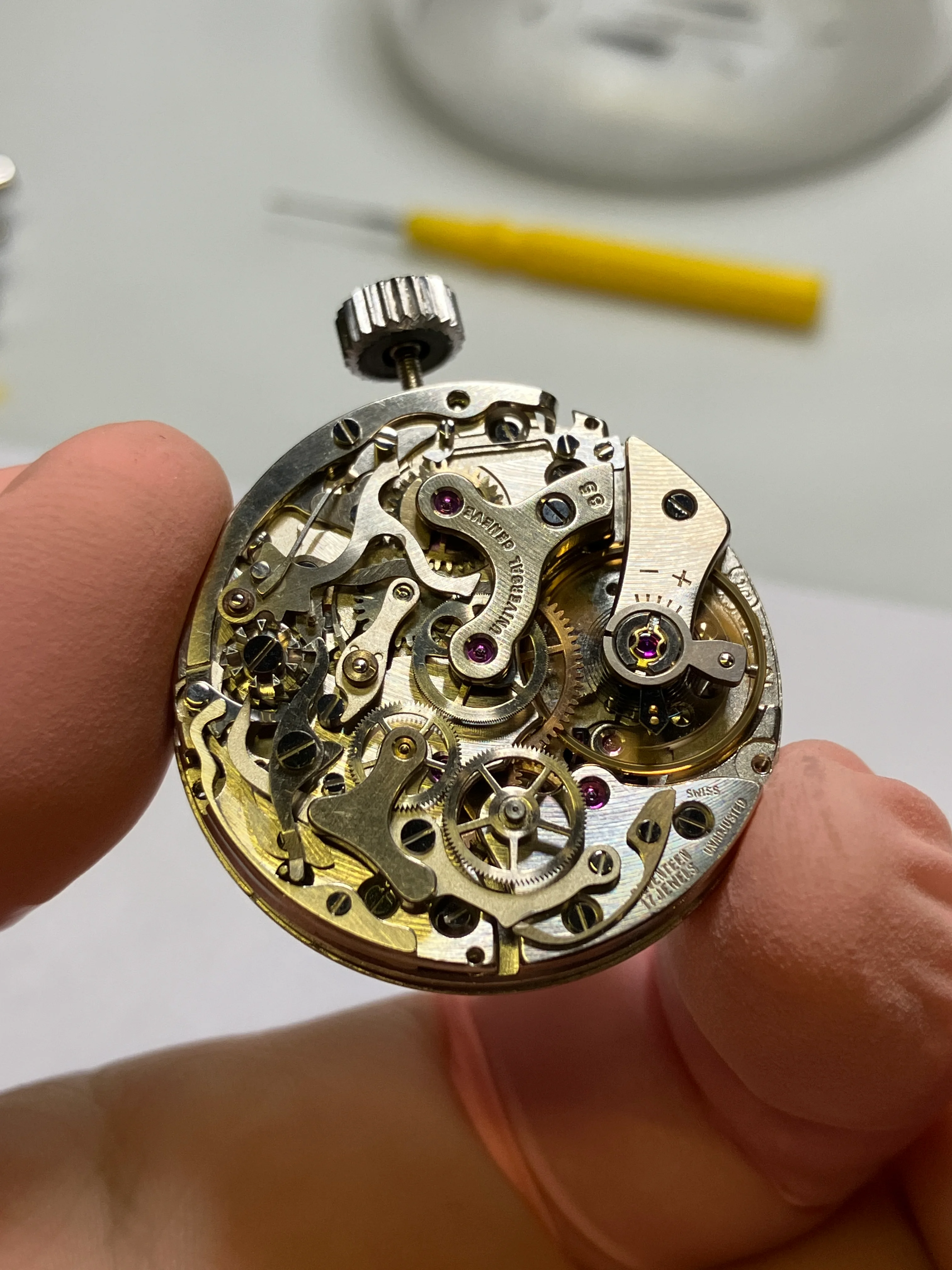

469
6,311

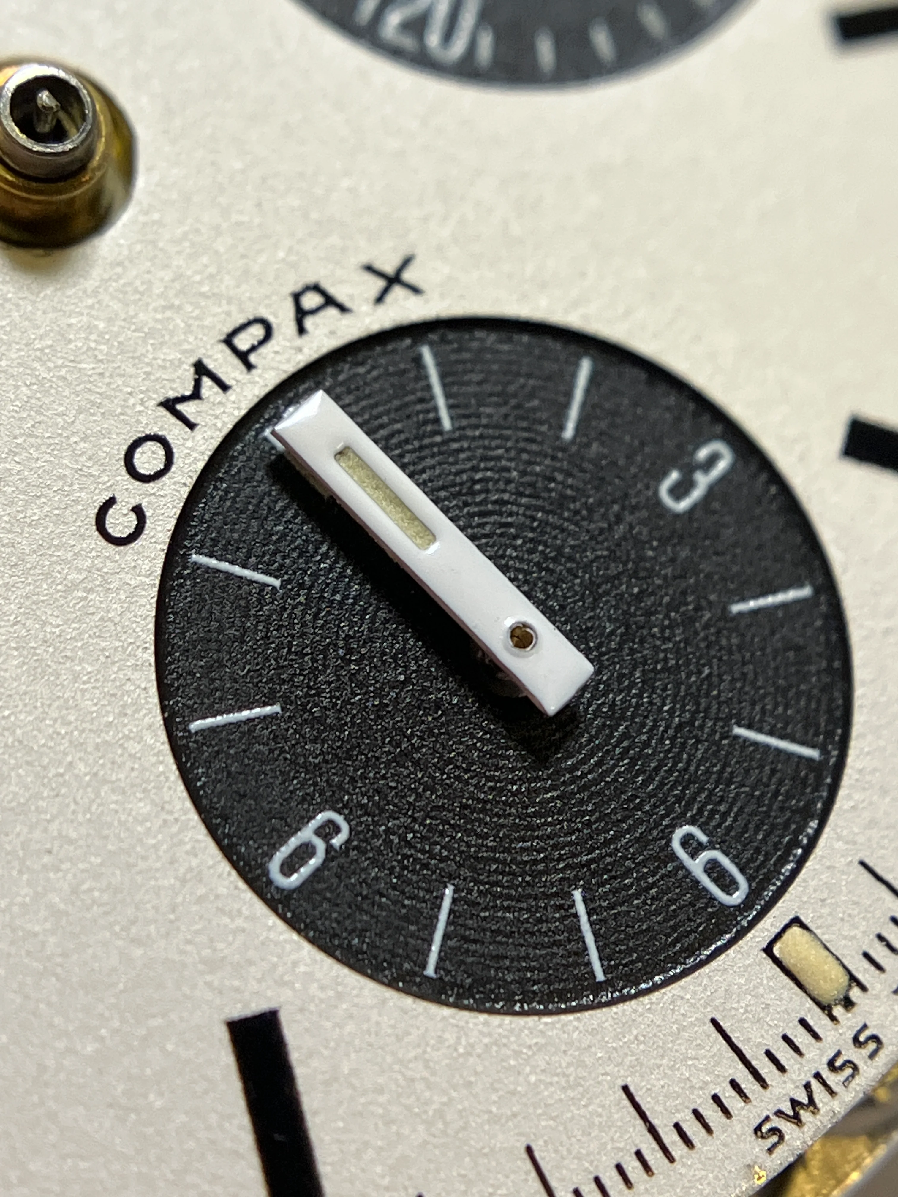

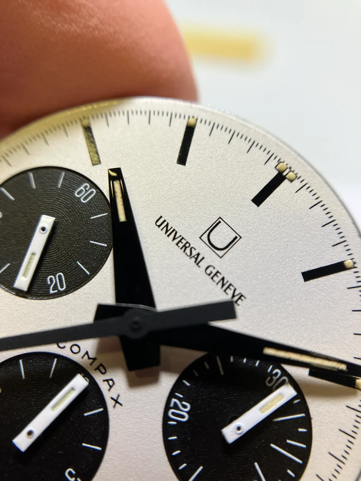

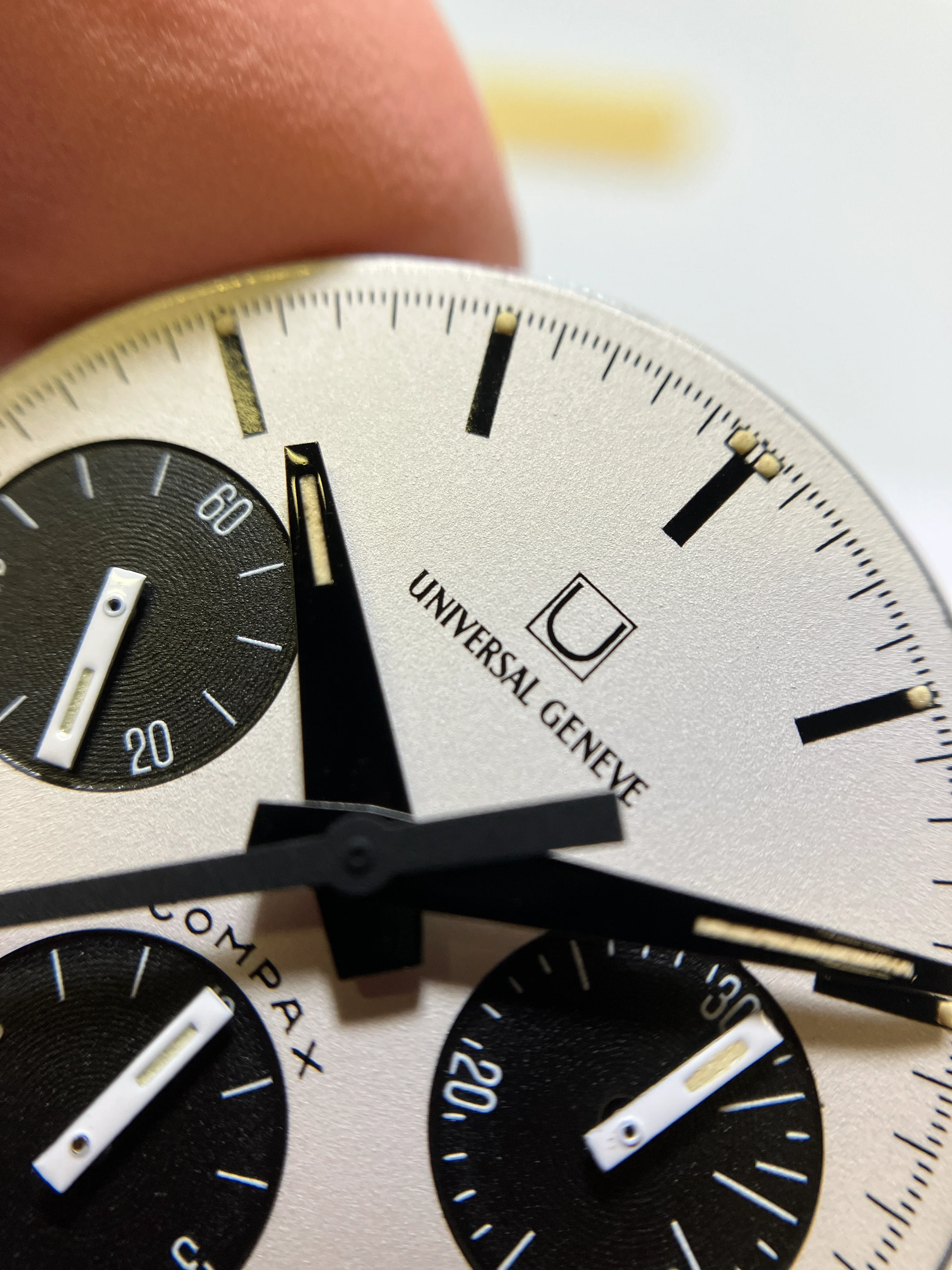

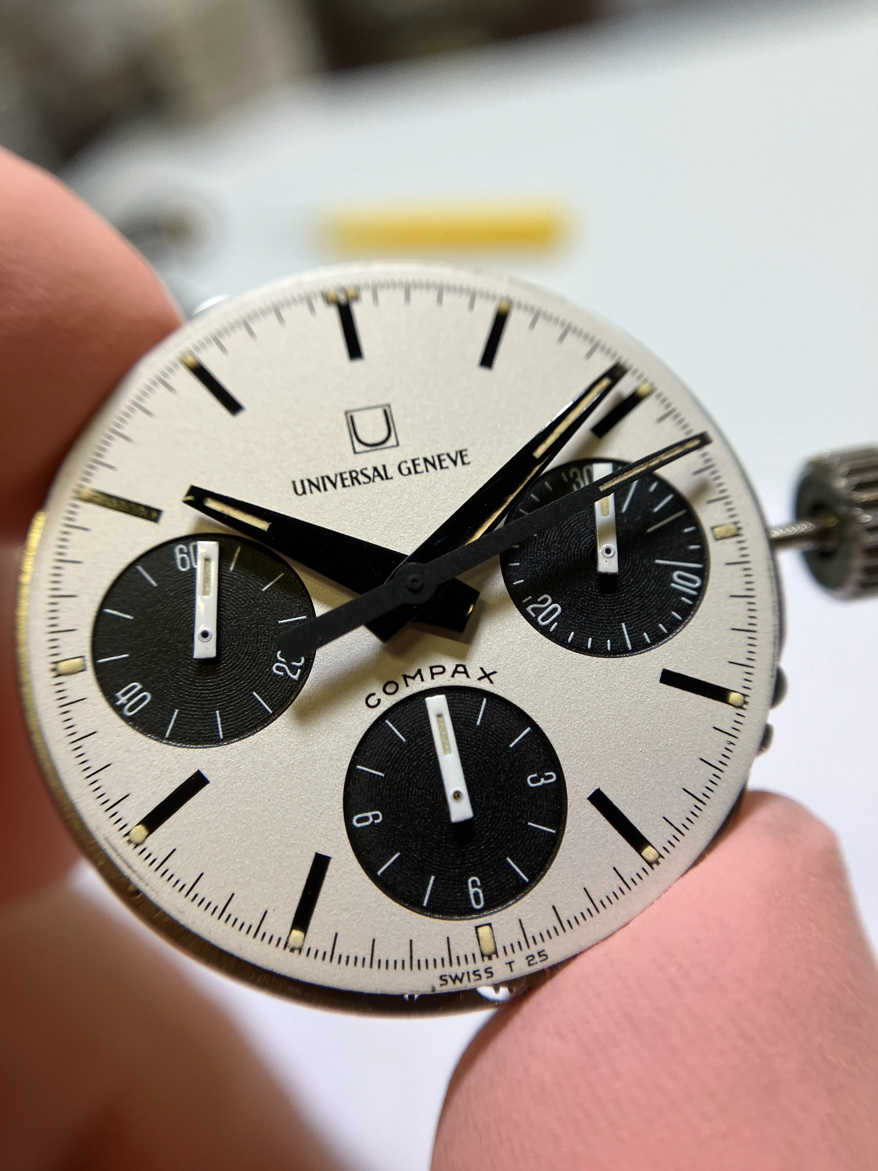

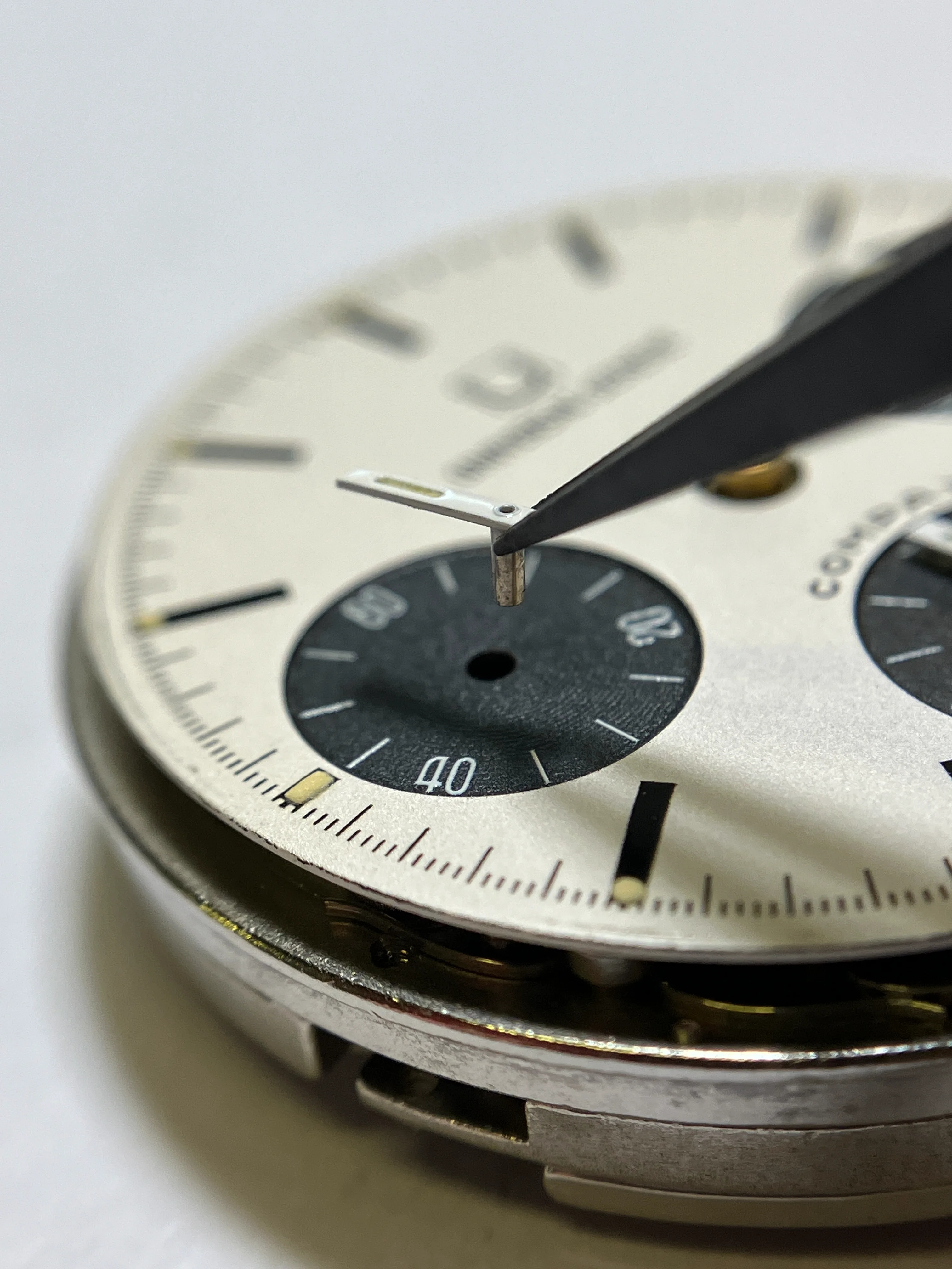

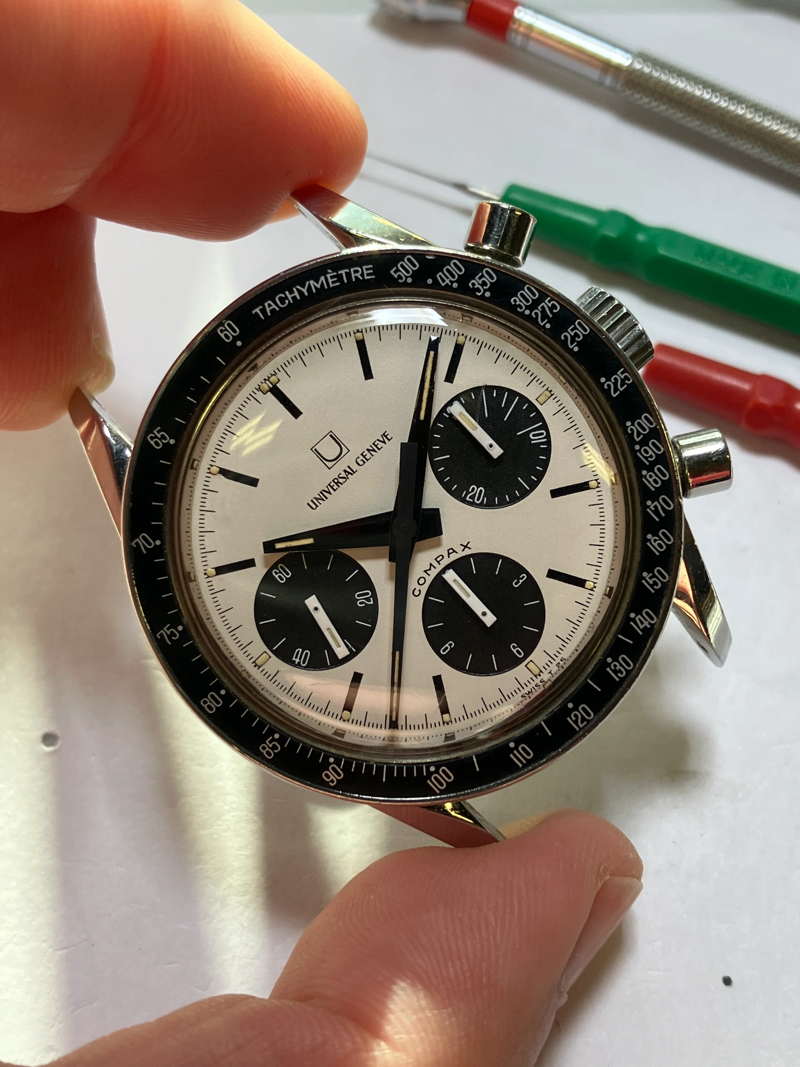

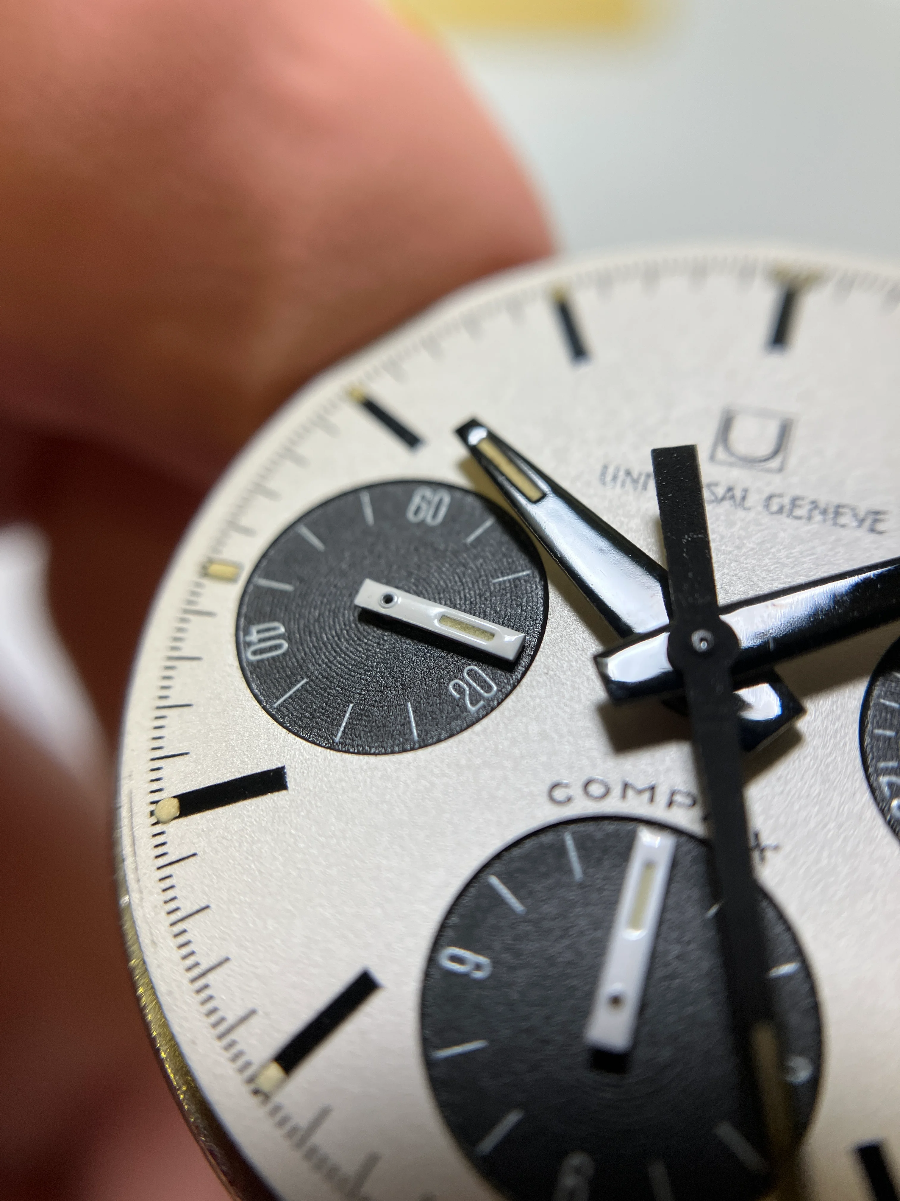

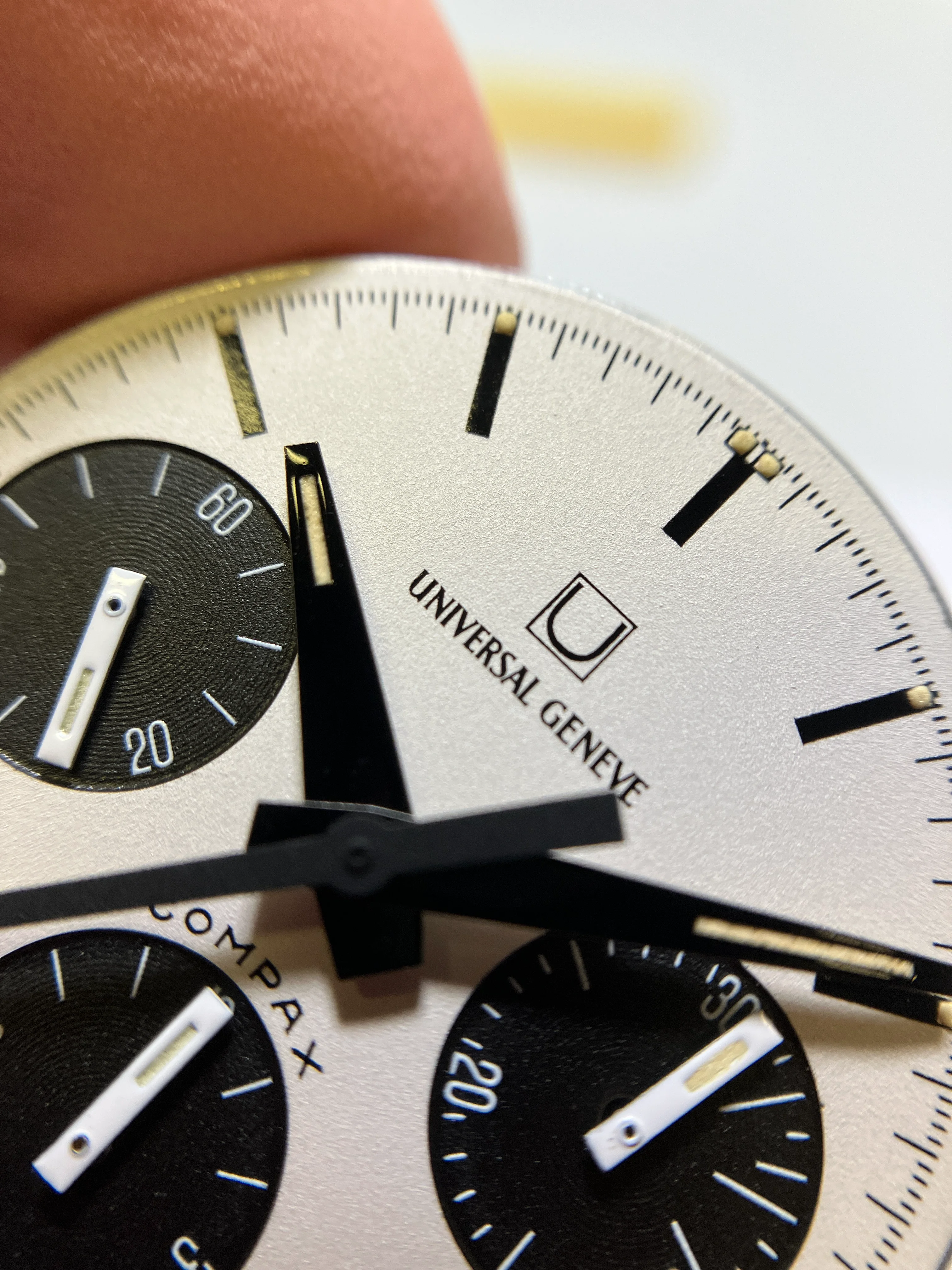

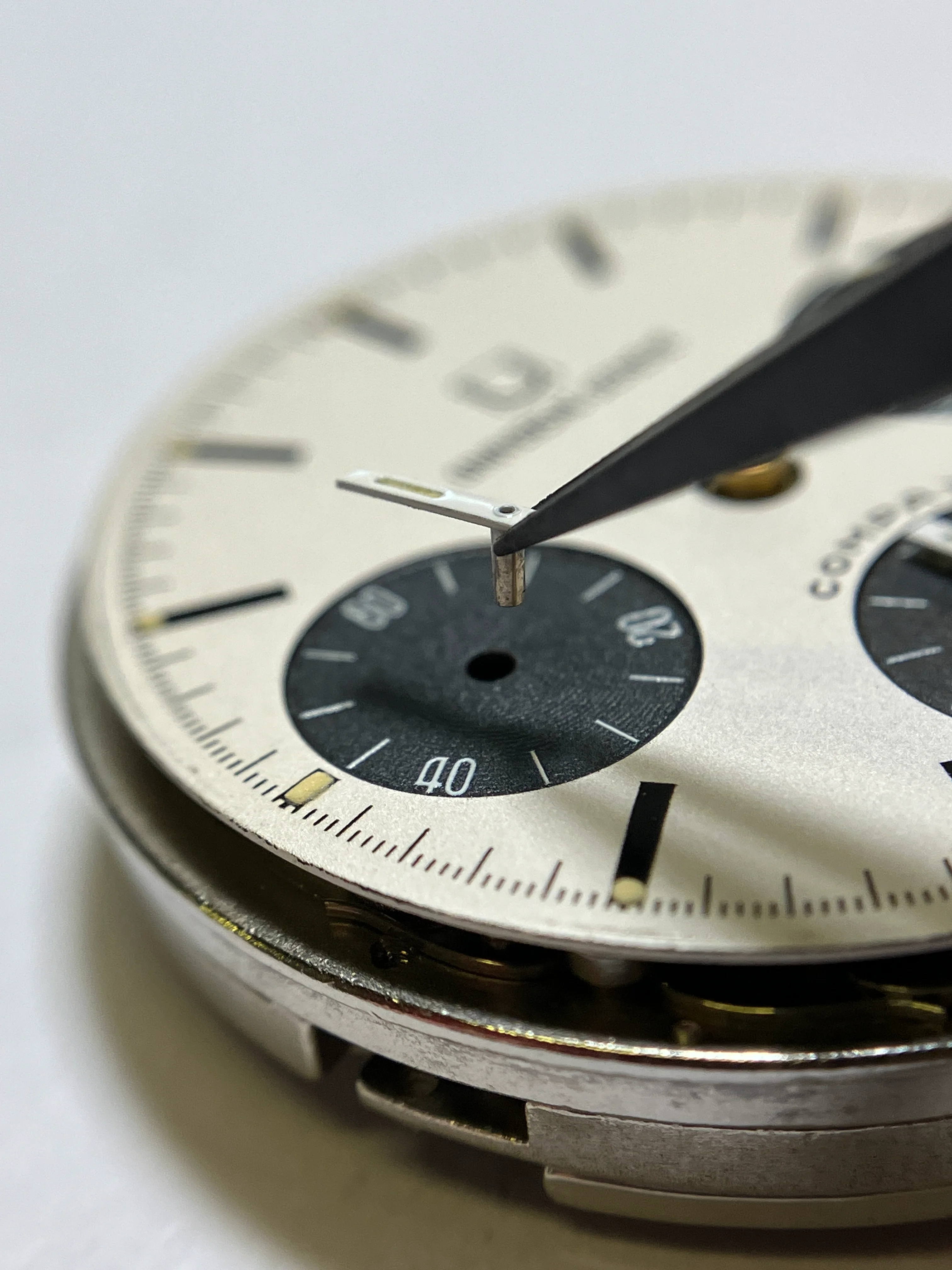

Got some pictures from my watchmaker, cannot wait to have it.

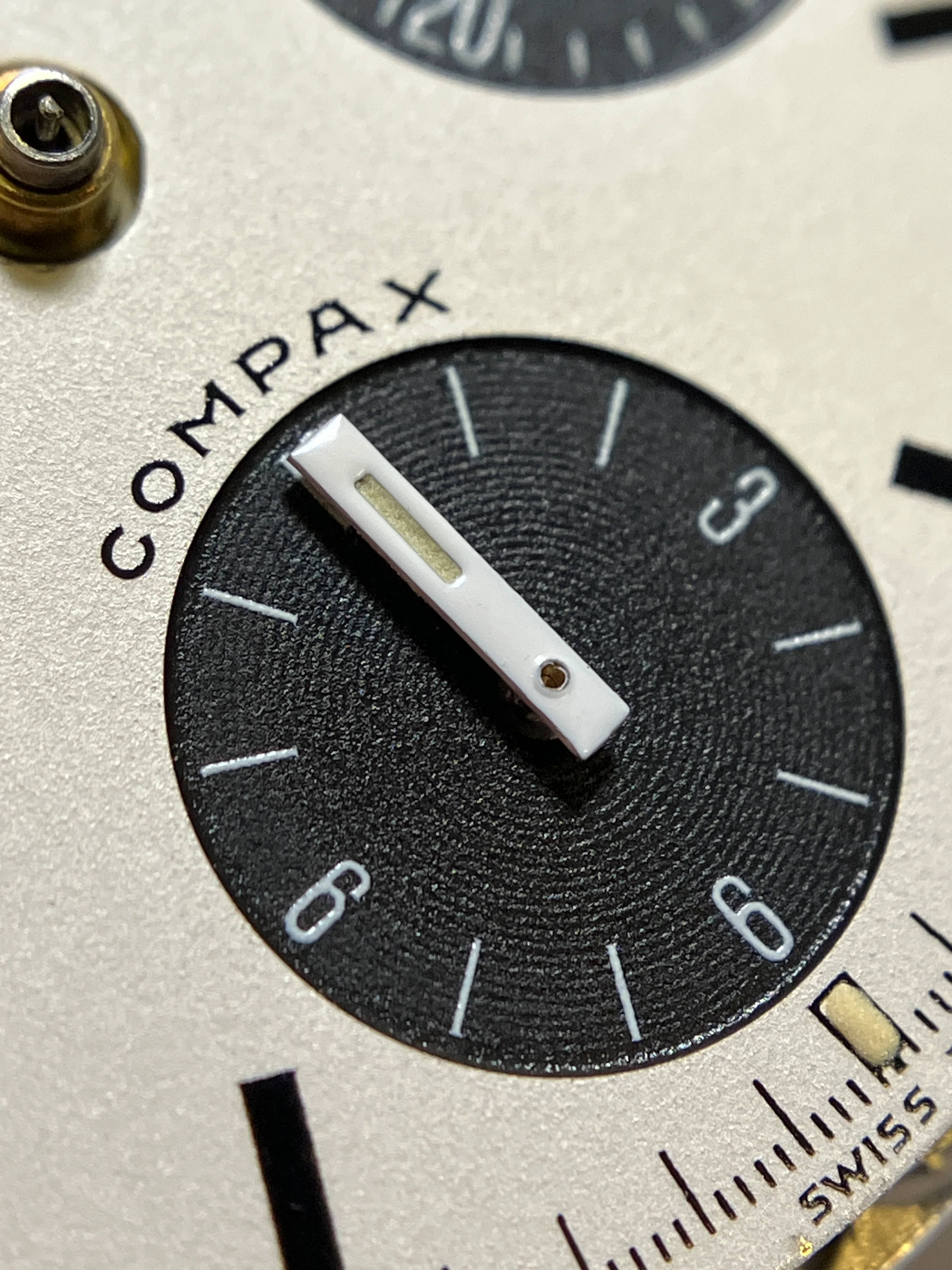

You changed the chrono hands? Did you also freshen up the dial lume?
562
2,738
When I bought it, the previous owner already changed the chrono hands, but he sent me the original hands as well, I decide to keep these square hands as they look better to me. I did not touch the lume, it is just perfect.
469
6,311
Good call. I like the square hands better as well (I have an Evil Nina with them). Lume collar looks very different from your original post. Must be the lighting and lack of crystal.
