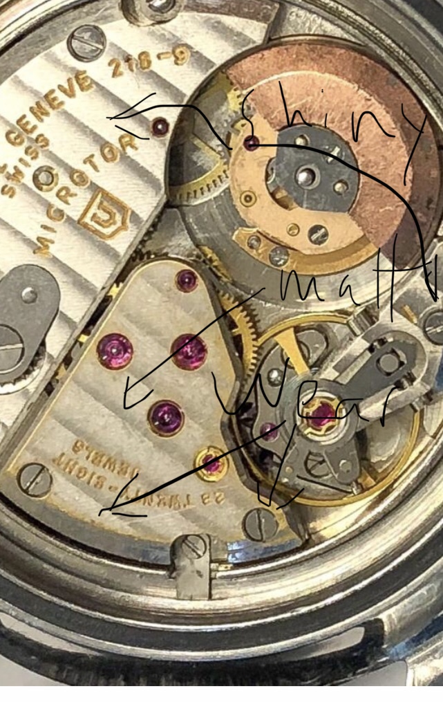

To me it looks like a rather tired watch, case back looks to have been highly polished and the movement is no good and makes alarm bells ring. I don’t like that it has the MicroSet balance adjustment and the train bridge has completely different ware markings from the barrel bridge. This makes me think that it’s a bittsa movement from a drawer.

Mazoue I agree that the case, dial, hands and crowns look legit from the not ideal pictures. I don’t particularly like the rotating bezel as the numbers don’t look sharp enough (eg no gap between 4 and 0) and it has no lume anywhere.
My biggest problem is that if you look carefully at the bridges they just don’t look like they match. The plating on the smaller train bridge is worn right through to the brass yet the larger barrel bridge looks almost perfect.

Sorry about the terrible annotation but hopefully this shows what I mean.
You can see the train bridge where I’ve marked wear that the plating has gone and you can see the brass underneath, this bridge is also Matt in appearance.
The barrel bridge and balance cock on the other hand have no signs of ware and are a different colour/ shiny showing that it’s not just a trick of the light.

you are right, the train bridge looks tired and some screws are too. I still would want better pictures, and would be more concerned about the bezel. cheers
