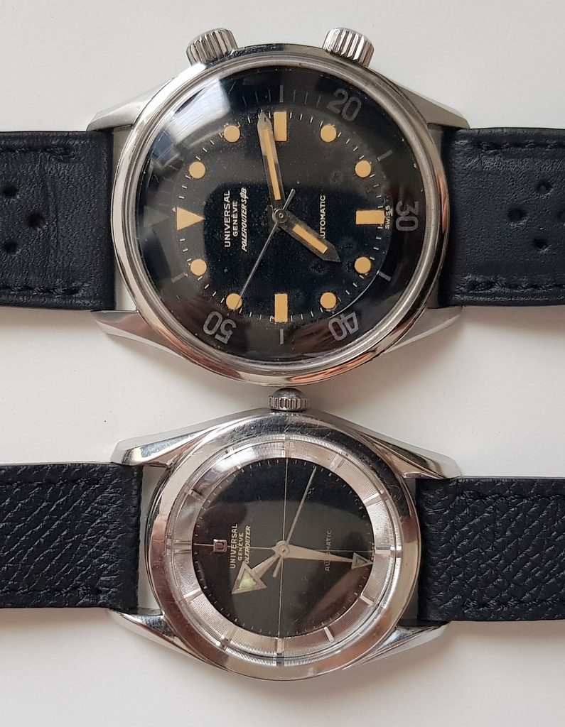

Just to add more food for thoughts, below the paint job on the indexs, I have just used a 10x loupe and I can see the real lume and the tritium dots behind the paint... 1st exec dial then! Could the 2nd exec be only different in the case shape and the rest being identical to 1st exec???
PS: do you think it is possible to get rid of this paint without damaging the dial?
1,211
3,071
That is interesting. I was going to suggest that this may have been a 1st exec dial because most 2nd execs usually have the space between 'GEN' and 'EVE' but I thought it too unlikely.
I'm not sure I go along with your 2nd exec theory. In my opinion, this watch is more likely to be a mix of parts that did not leave the factor this way.
Close up those lugs do seem to have the dull grey scratched look that many of the fakes do.

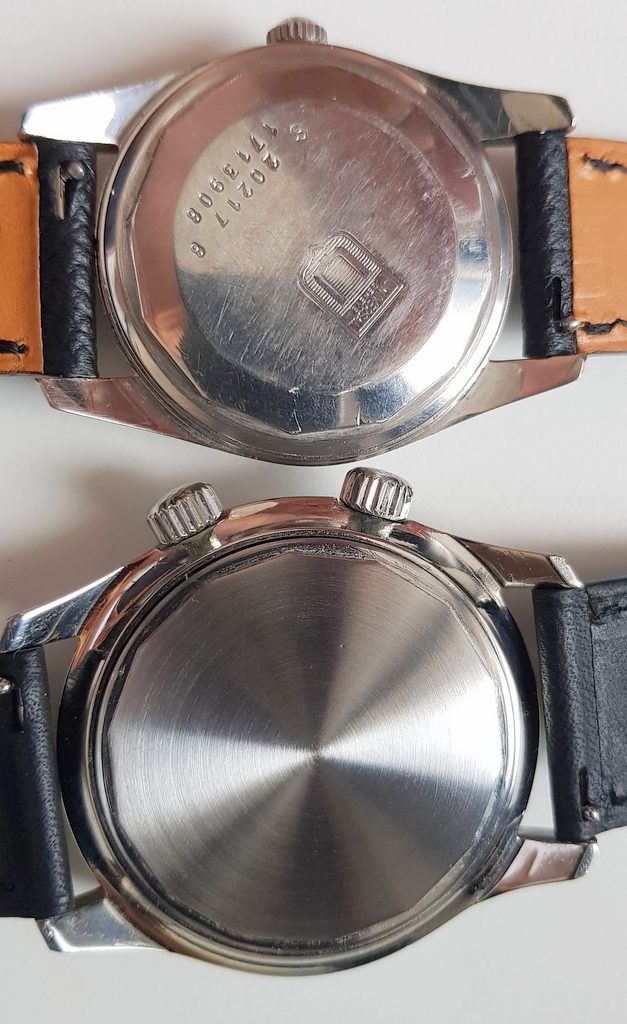

I don't like that polished case back either. I also do not accept that the numbers have simply been worn off. Assuming they were present, then they were removed by the circular polishing on the case back. I have handled four 1st execs; all have displayed wear but all had both serial and case reference number present.
57
114
I reckon it is quite difficult to appreciate through photos but I do not agree with your conclusion:
There is another example in this thread with case back numbers worn off
I have seen tons of legitimate UGs (not specifically this model) with numbers invisible due to wear and polishing

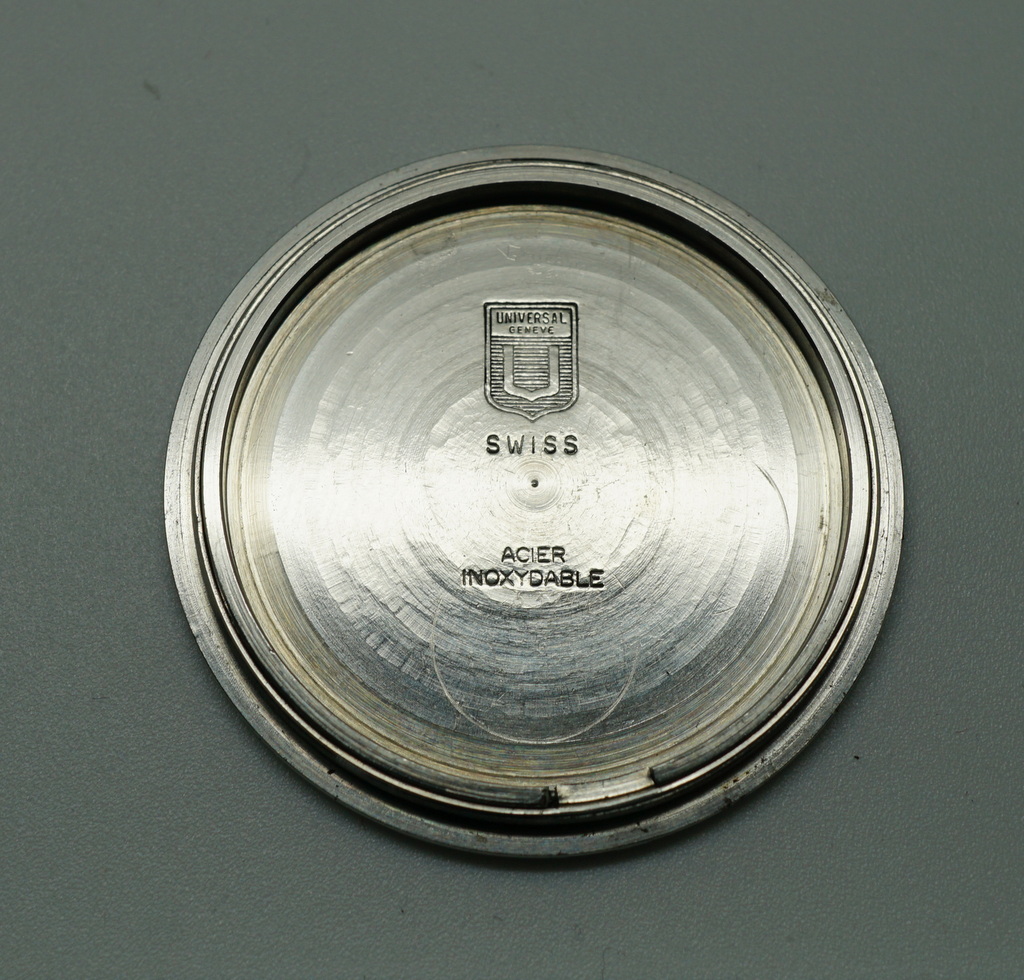

Mine has most probably been heavily polished to get rid of scratches on lugs, case back etc... This watch has probably be worn a lot in the past. This is why it has now a "refurbished" look to it. Nothing comparable with the aussie fakes in terms of steel quality. Moreover, my case back is 100% original unless you can prove me wrong, look at the inside of the caseback, the hallmarks , the space in the screwback I was refering to earlier etc... Nothing to compare with the presumed fakes. The exact same case back with french writing ACIER INOXYDABLE can be found in this thread on a genuine 1st exec.

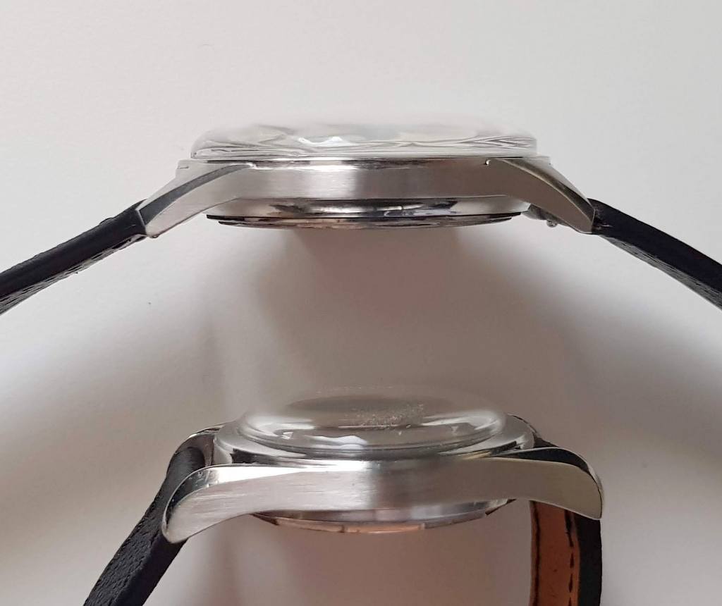

Just to concentrate the discussion on one thing: has anyone ever seen a beveled case which seemed to be genuine, that is to say with "genuine and consistent" markings, properly shaped with quality steel apart from mine (even if lacking the numbers on the back)? If yes, I would be grateful to get some feedback, pictures, anything 👍
Many thanks in advance.

If i decided to post in this thread, it was exactly for the purpose of trying to understand why my model does not fit with the 2nd exec poor standards. I am not a fresh starter in watch collecting, many years behind me also, I have owned (way too) many UGs in the past, however no 1st exec Polerouter Sub. I have handled Longines and JLC Divers from the same era though.
I would never have bought this watch if I did not have the "proper feeling" about it (after having done my research before, which was unconclusive on 2nd exec models...)
It is a pity the pictures don't do justice but my case, I am quoting you, is following all these principles :"The quality of the first execution is a very high quality gloss case with the normal UG swiss case numbers. Very precision made solid water proof screw case with seal. Remember, these are a divers watch ! " apart from the serial and ref number on the back which is once again not conclusive of a fake case. On this specific models the engravings were very lightly engraved...
Just look at the inner case back, do you spot any difference with a 1st exec caseback???
High quality steel is there, correct markings are there. So why this case could not be genuine???

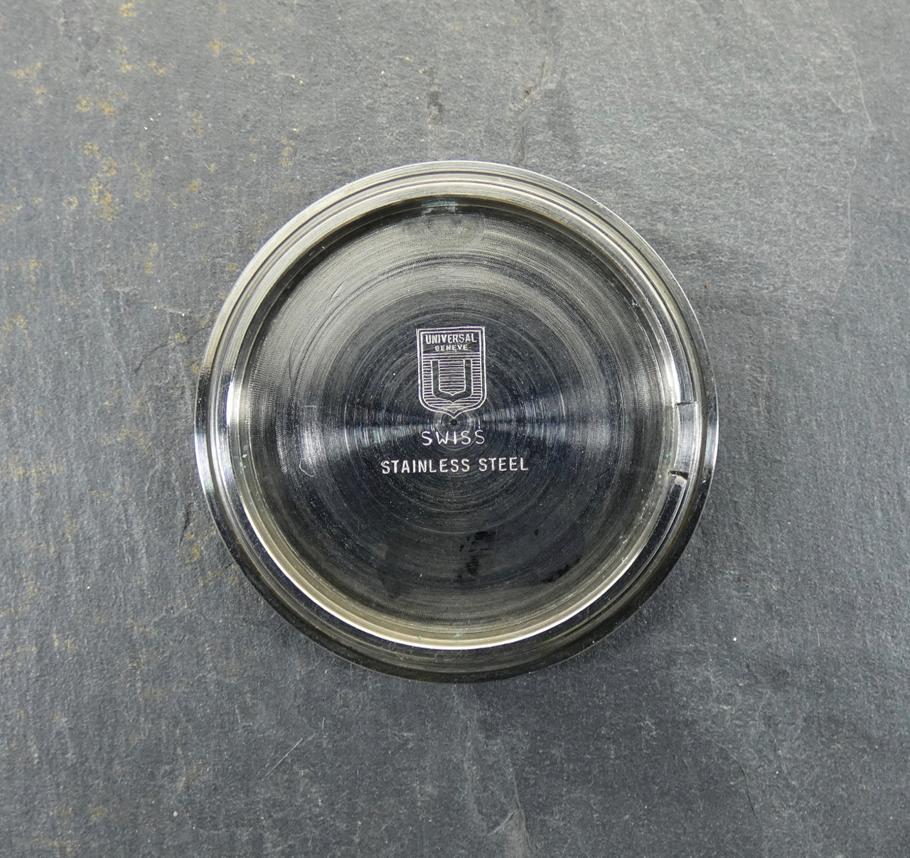

Rolokr, I do have the swiss marking on the inner caseback as per the pictures I shared earlier in the thread. My inner caseback is identical to many 1st exec Subs with the french Acier Inoxydable wording instead of stainless steel. 3 grams with the different shaped case, the fact that i do not have any lume on the inner bezel is not that much i think.
I share the inner caseback again for you.
Inner casebacks with HF (Huguenin Freres) mark are specific to the aussie fakes.
1,211
3,071

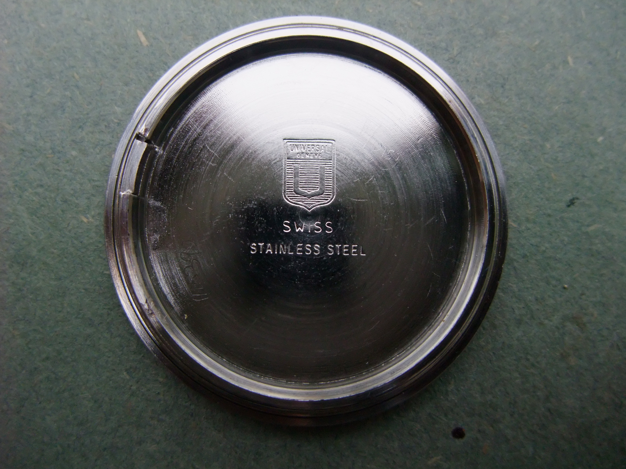

I can't find photos of all of the the case backs for the first executions I've had but the two that I have found have "Swiss" and "Stainless Steel" along with the UG shield logo and the gap. Presumably the language just depended on what market the watch was headed for?
If I was splitting hairs, the circular polished finish inside your case back looks a bit less refined compared with the two below. These two have an identical finish which looks a little less clunky. On its own, I would not suggest this is significant.
