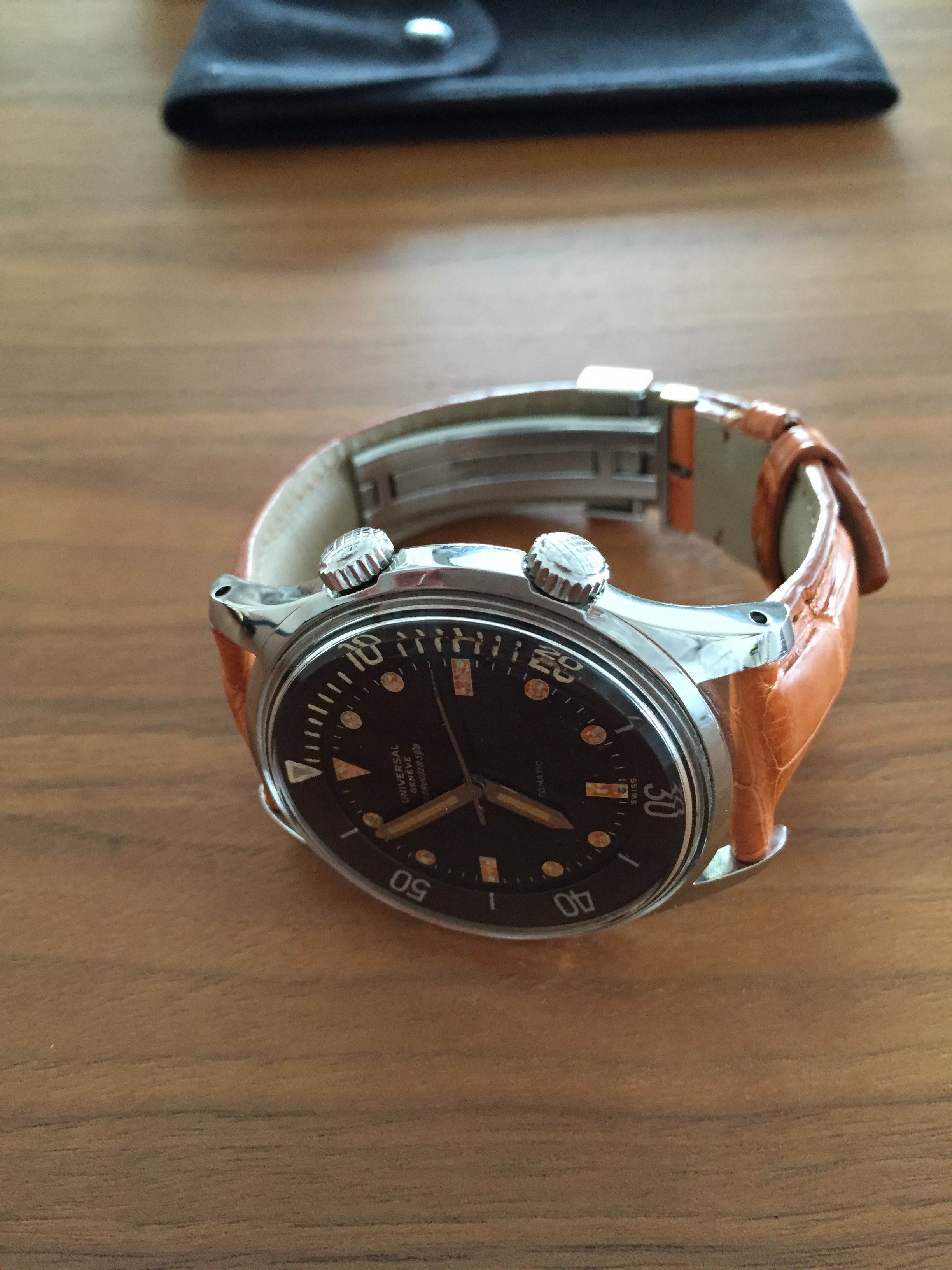

Mazoue,
Thanks for sharing. It is not every day that a good one is offered for sale.... Is the tension ring original? It looks like a replacement to me but I might be wrong. Is the inner bezel rotating freely. Also what was wrong with the original Chrystal? I'm asking because those chrystals and inner rings are nearly impossible to source...

The inner bezel is rotating freely as you would expect and the tension ring is original.
I understand that in order to incorporate this ring with a new crystal, it required some lathe work by the watchmaker on the new crystal.
The condition of the old crystal was not too bad and it could certainly be used if someone wanted the watch to be all original, which is why I have kept it. It has very few scratches but it has one small chip on the edge which you would not be able to polish out and what looks to be very small cracks on the sides.

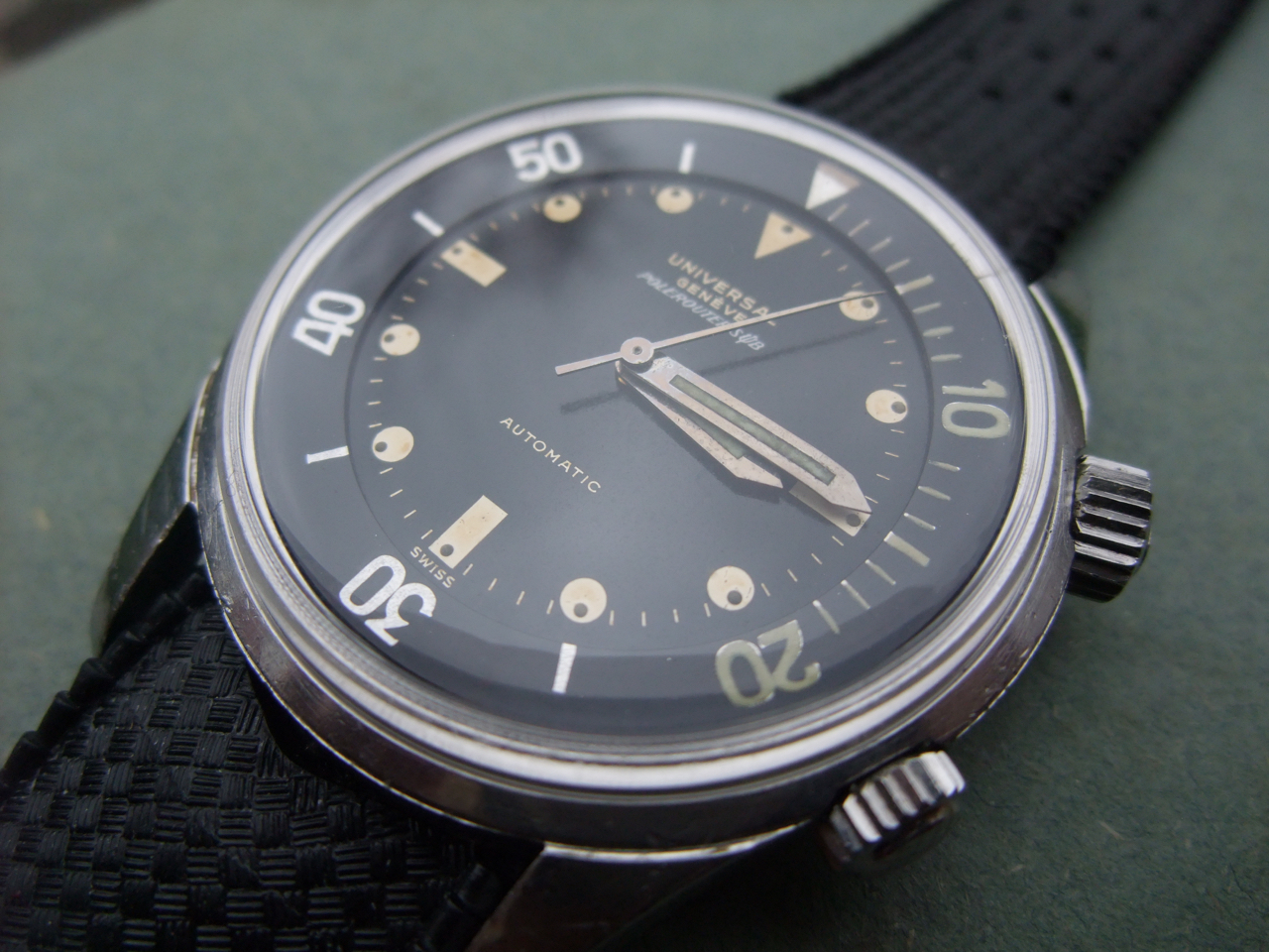

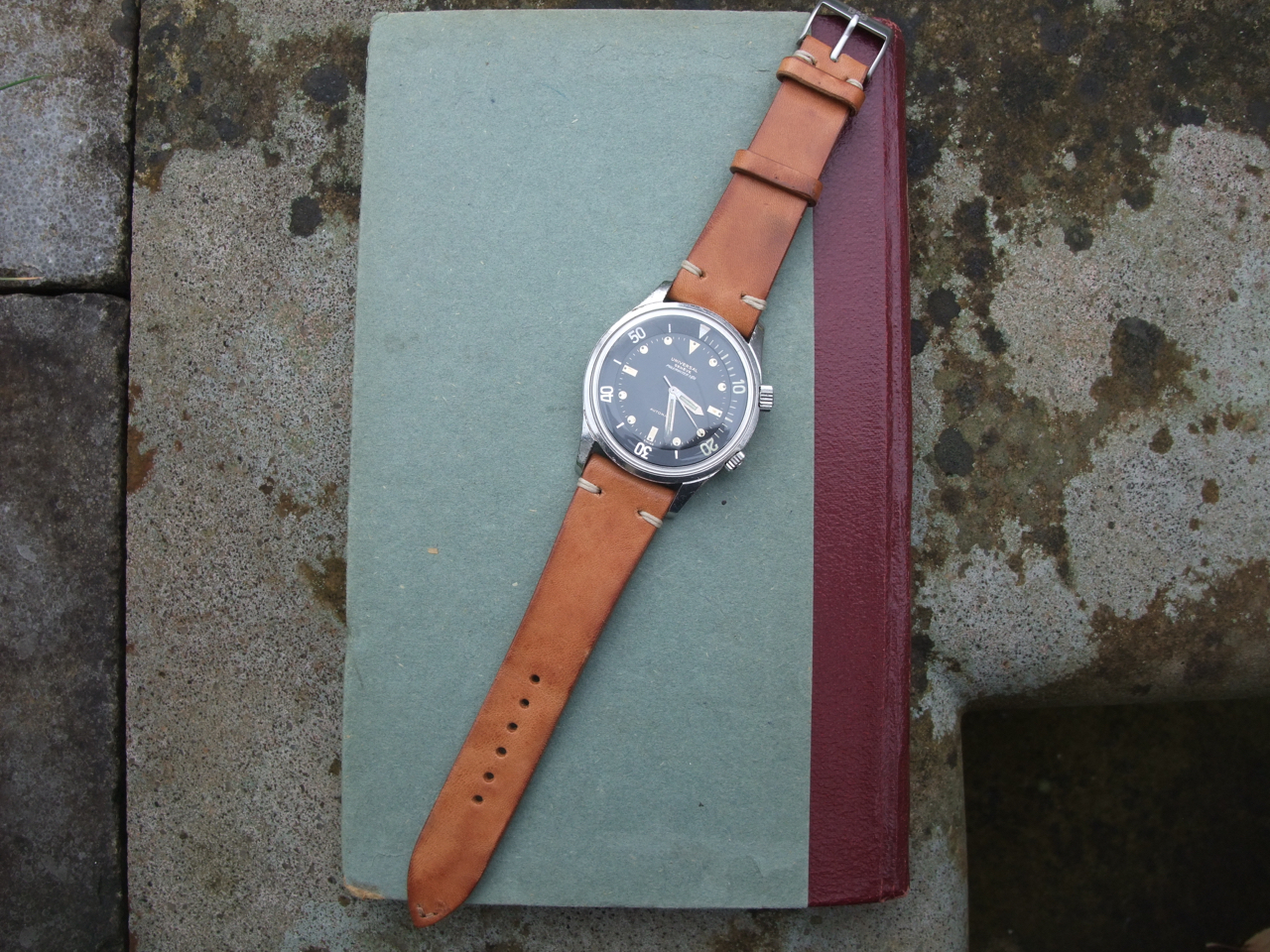

At the 8,000 GBP (or 10,000 USD equivalently) mark, did I pitch this at about the right level?
We've seen numerous dubious second execution examples recently but very few, if any, first executions have hit the market as far as I'm aware and therefore it was not easy to determine an appropriate asking price.

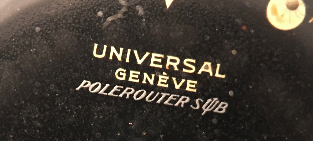

It looks like the Universal Geneve text is gilt or yellow compared to the Polerouter Sub text. Not seen that before.

You are absolutely right. The ink on the dial for the Universal Geneve text is more golden and looks to be the same as the ink used for the Automatic text and the hour markers on the dial. The ink used for the Polerouter Sub text is more silvery in tone and similar to the ink used for the 30, 40 and 50 on the inner bezel.
I have absolutely no doubt that it is genuine however. When viewed under a loupe, the text is all crisp and clear and the different fonts with their serifs etc are evident. Below is an extreme close-up photo of the text on my watch taken hastily using a macro lens and an iPhone in my shaky hand.
I do agree that not all first execution models seem to have the text in 2 different colours although from what I can tell this example, owned at the time by another forum member, looks to be the same: https://omegaforums.net/threads/early-polerouter-sub-discussion.3630/page-2#post-166711

I understand how you might have misunderstood my post. Your dial looks fine - I just stated that I had not seen one like it before.
