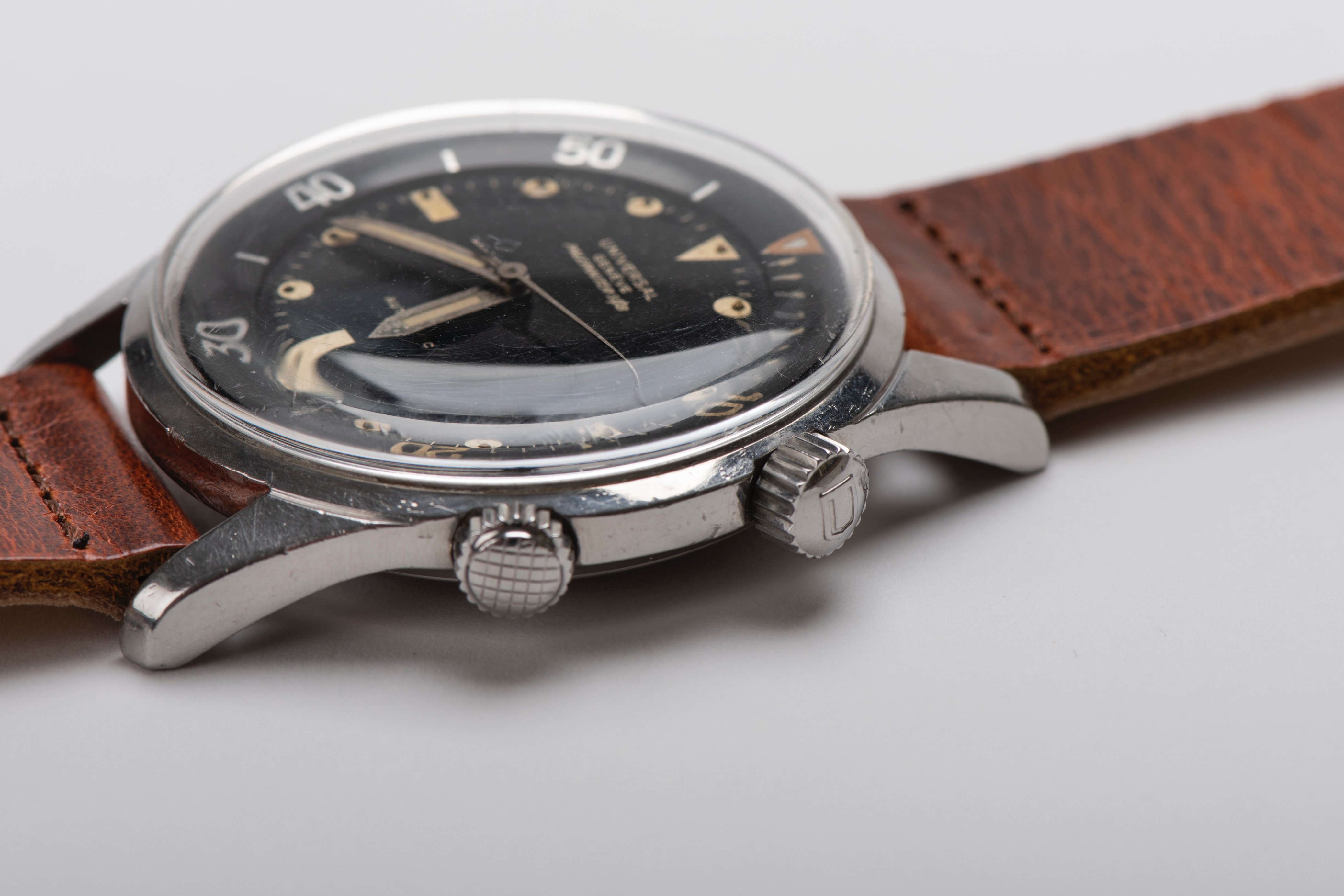

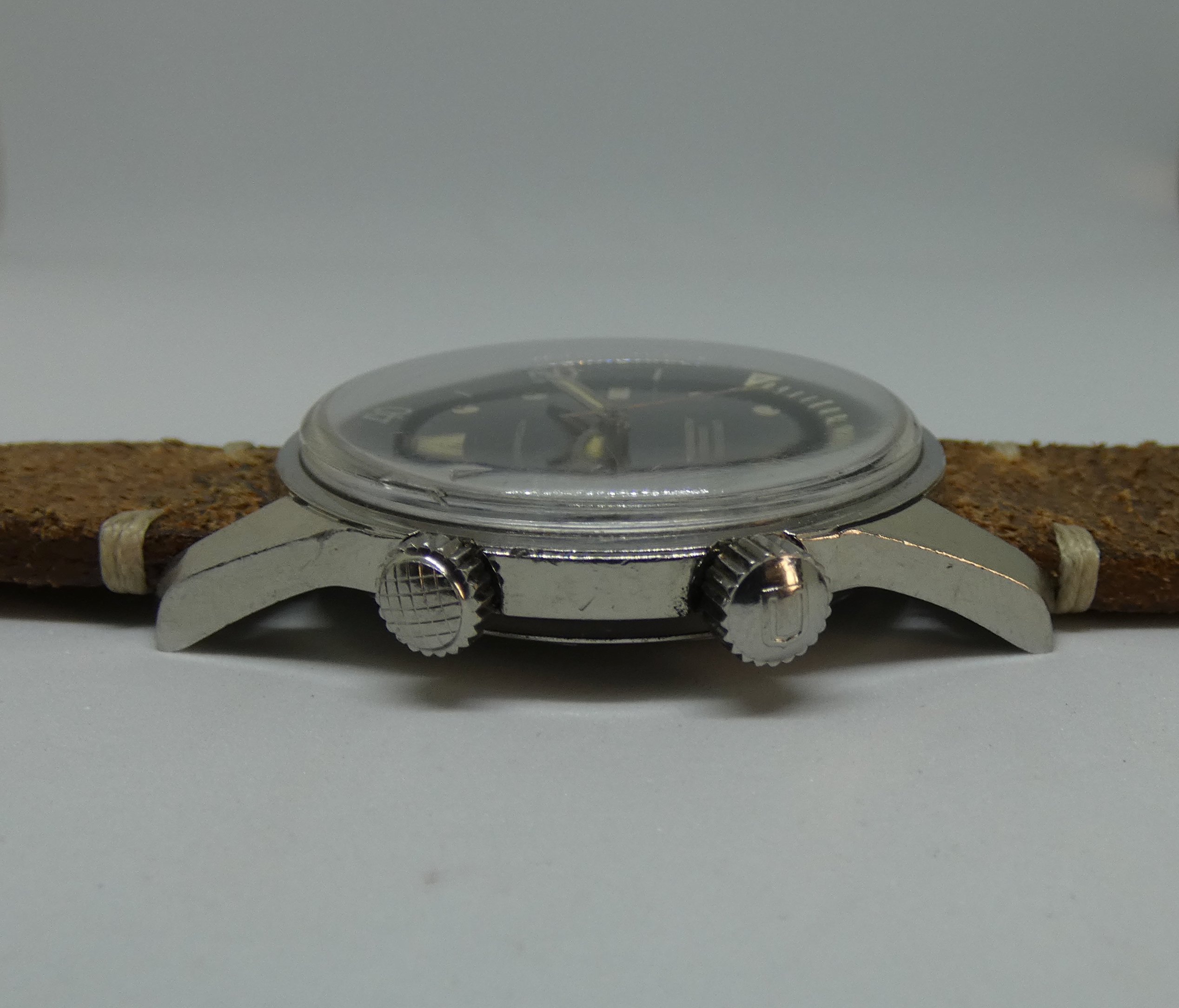

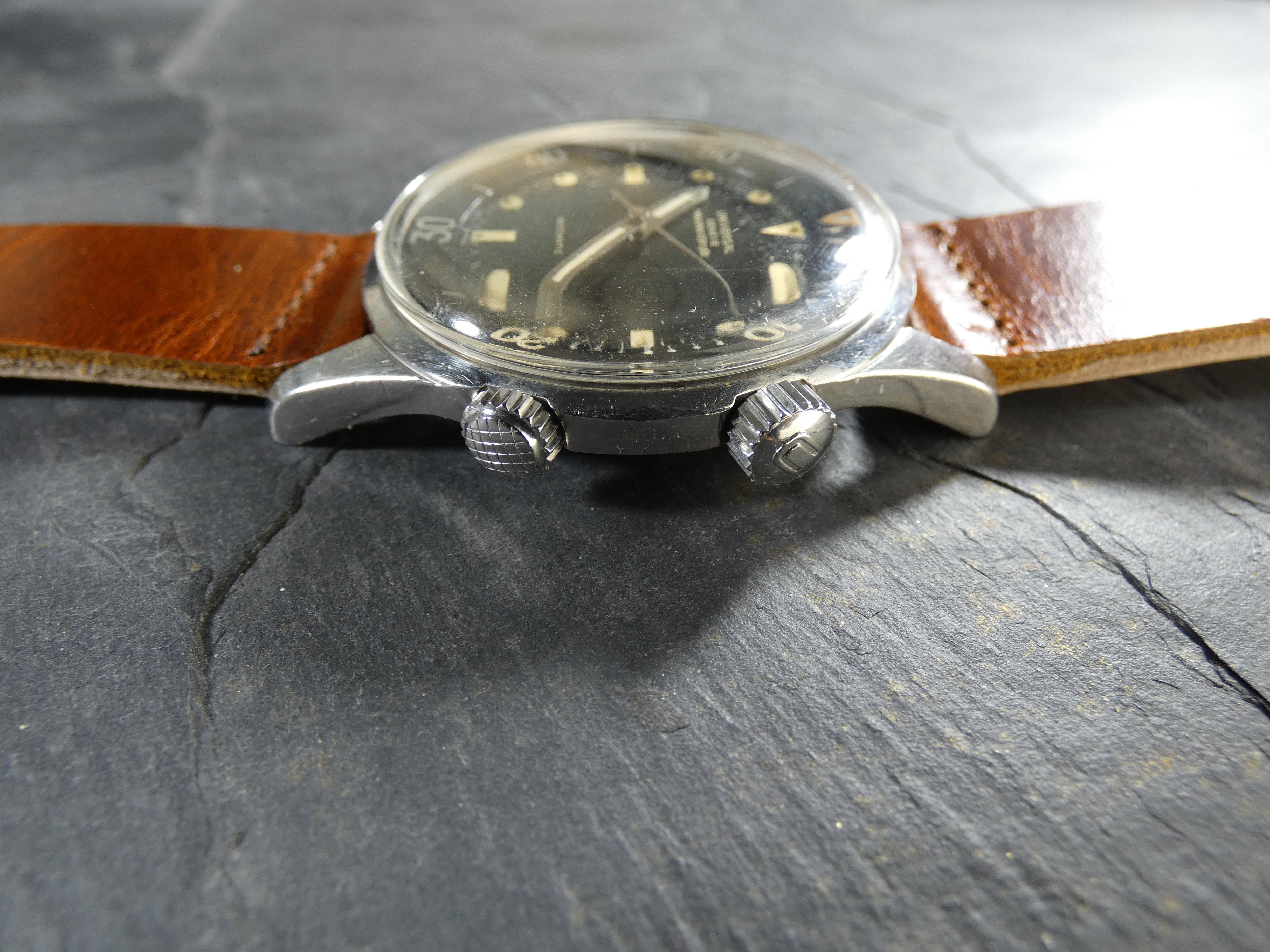

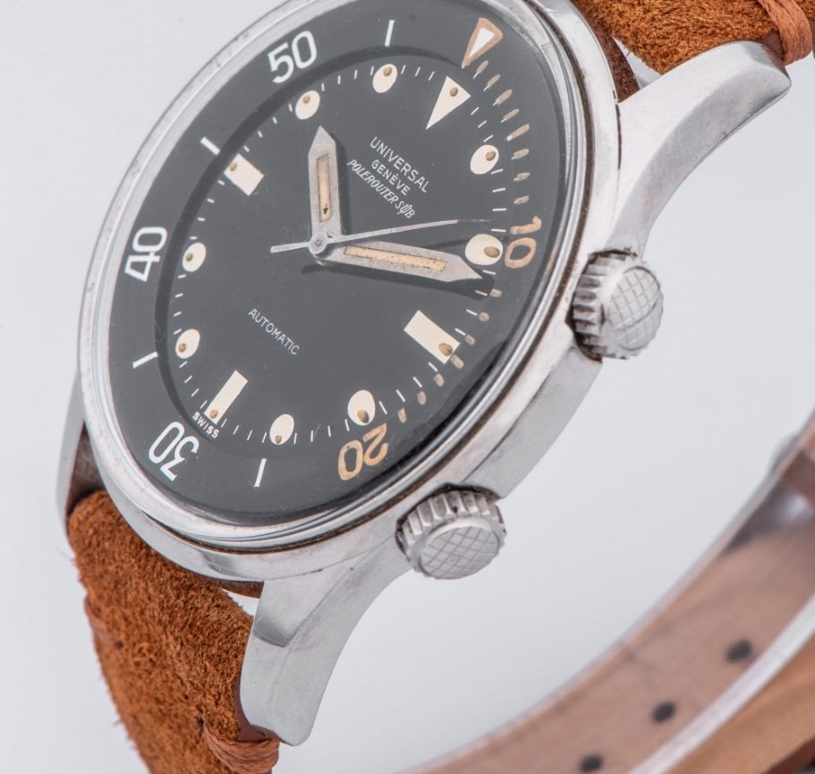

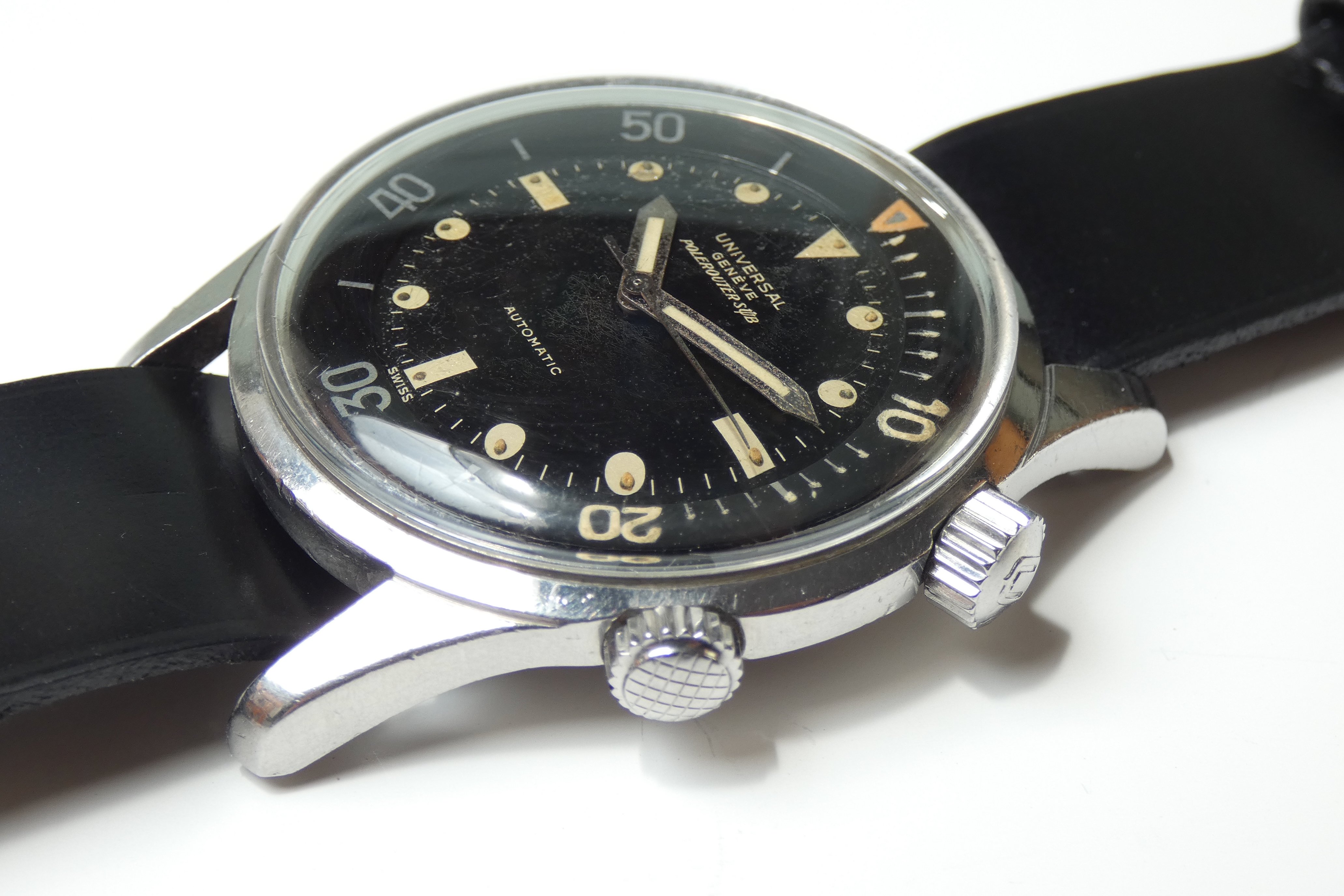

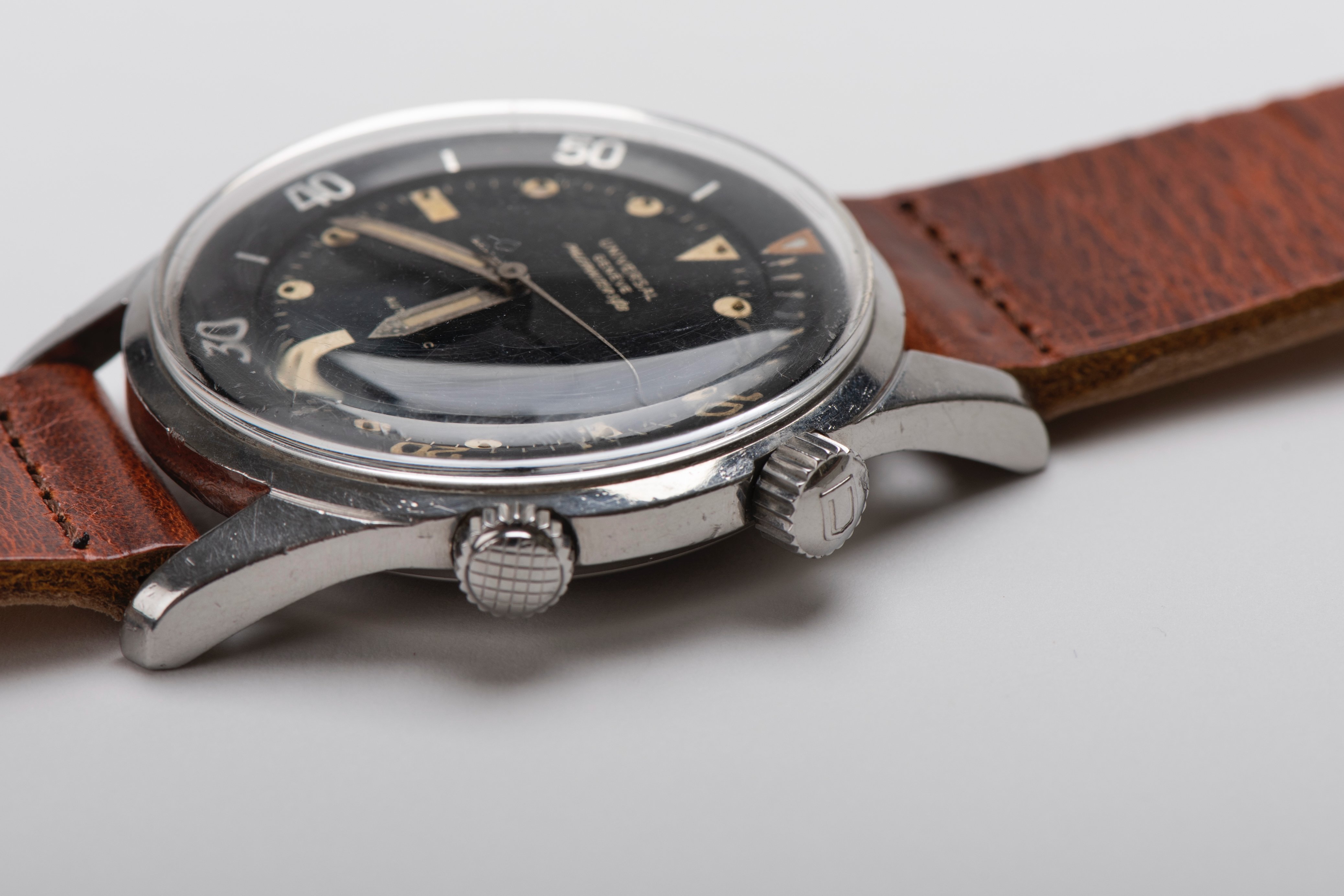

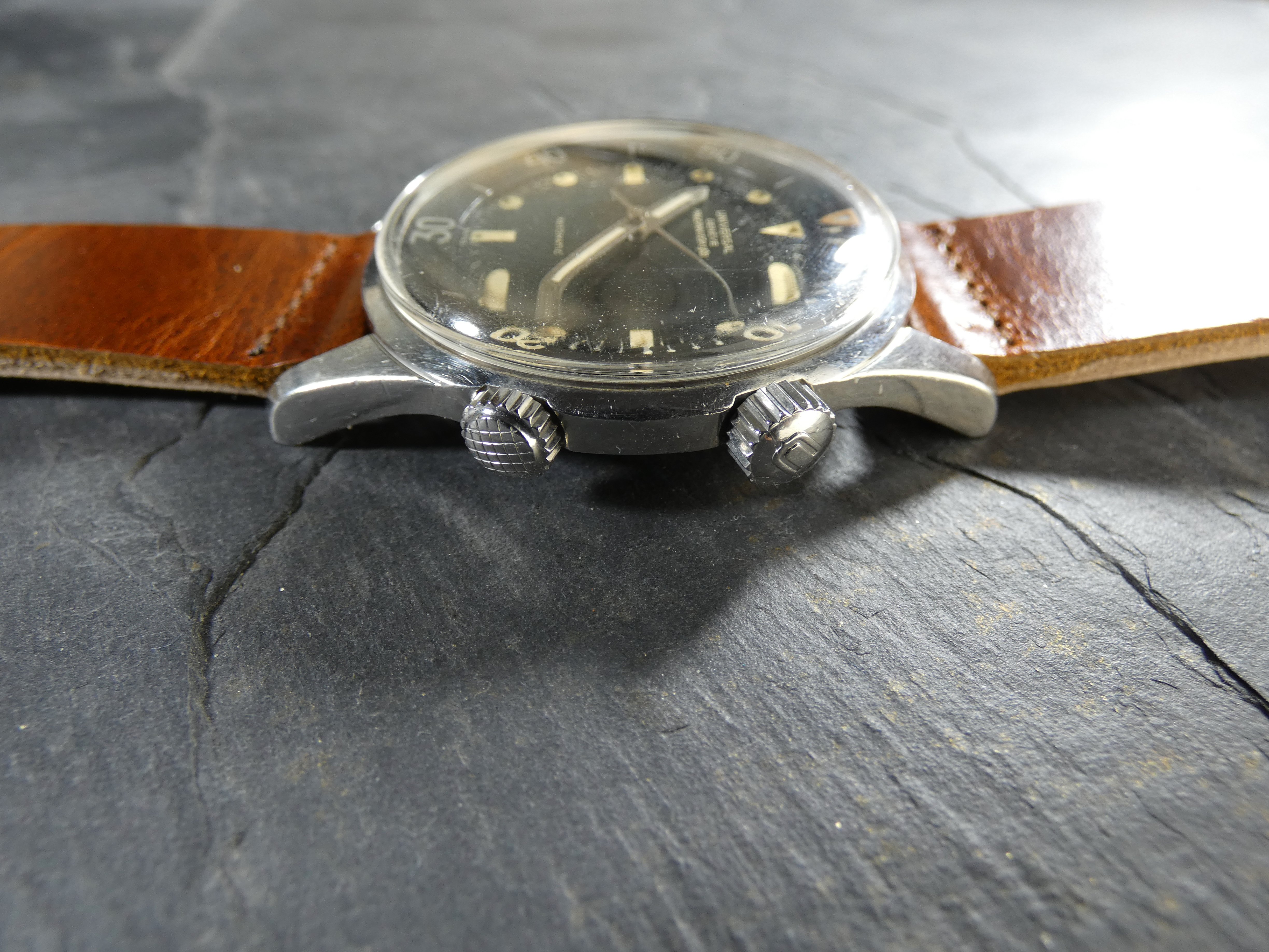

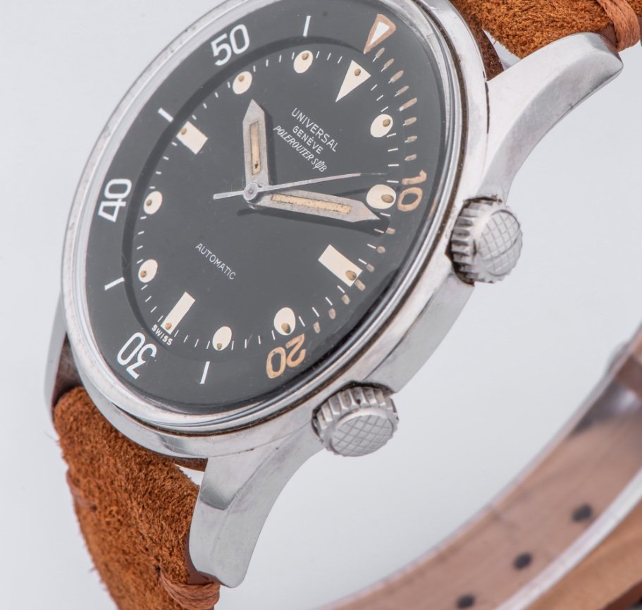

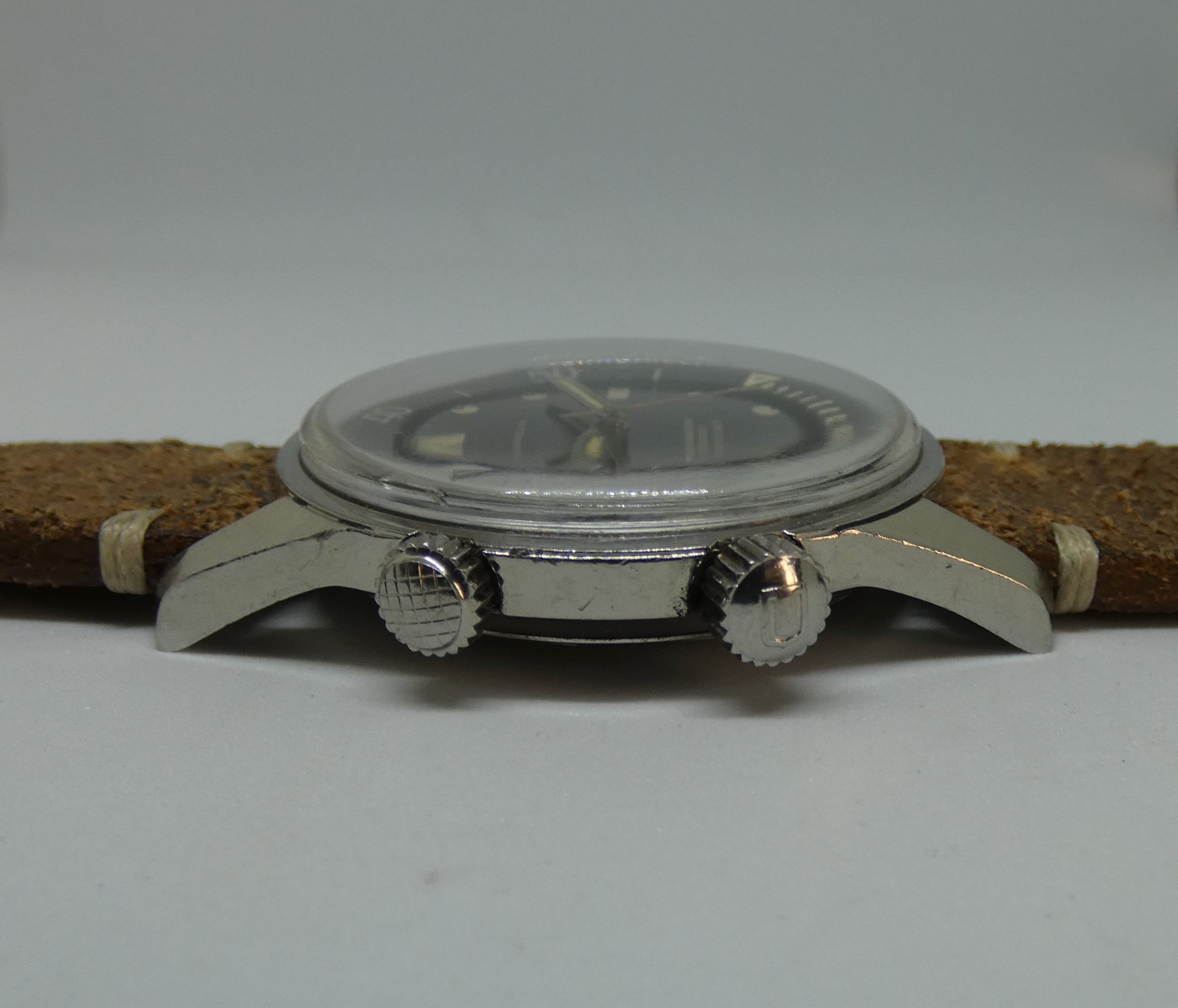

To my knowledge, the UG Polerouter Sub has an EPSA Super Compressor case although it does not display the typical Super Compressor helmet logo on the inside or outside of the case.
The UG crowns are slimmer than most typically found on these cases, although some other brands such as Enicar also used slimmer crowns (albeit those were signed I believe). It's also noticeable that the hatching on the UG crowns does not extend to the very edge of the crown.
I attach some photos below of examples I've owned where the top crown is signed. The final image with two matching crowns is courtesy of Roy & Sacha Davidoff. I believe that all of the UG hatched crowns, whether two matching or single with a larger signed crown, were identical.
Would love to be corrected on any of the above. I've handled a few examples but if I'm honest, details such as crown size, hatching etc sometimes pass me by.
