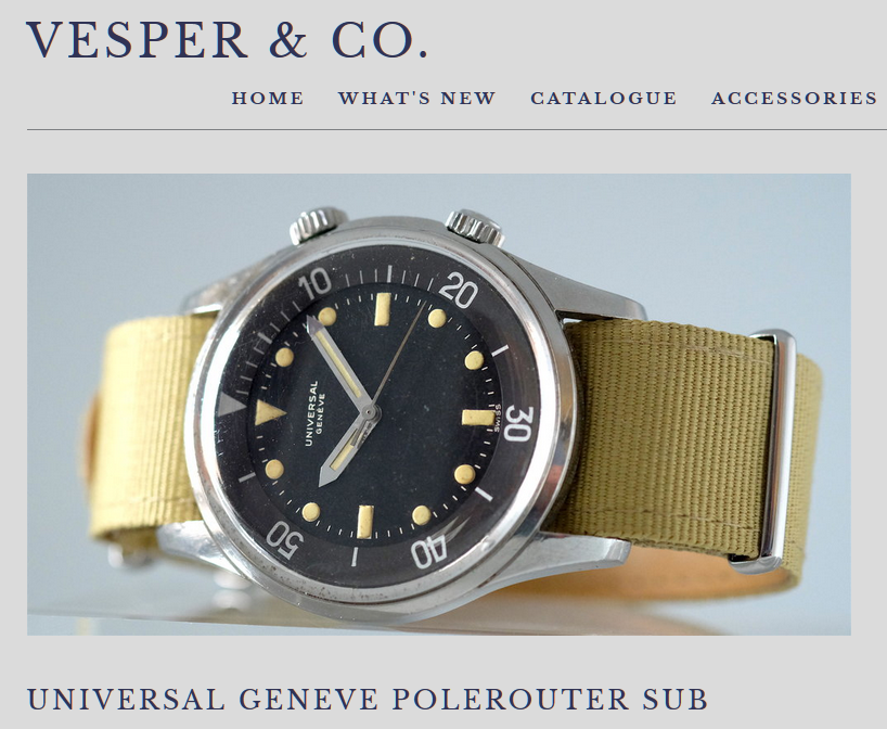

First execution case with curved lugs but with a second execution dial i.e. full lume (or relumed?) rather than lume dots. Dial also missing "Polerouter Sub" and "Automatic" text. The case looks ok but there look to be some signs of the lower quality steel you see on the Australian fakes of the second execution. I think the original top crown would usually have been signed on a first execution. What else have I missed?

It is a redial for sure as explained above, I don't think the crowns were signed on those first gen (at least not on mine).
Are the spring bars fixed on this one? Not sure I have seen this before.....

The more I look at it the more I find it a miss match.... case looks ok to me at first sight, as crowns (2 identical crowns have been seen before), but:
- the redial is poor quality, look at the relume of the indexes
- bezel insert if from second generation on a first generation case
- I don't like the black spots around the bezel, sometimg looks wrong to me

@LaurentBxl - Out of interest, why do you think that the bezel insert is from a second generation?
