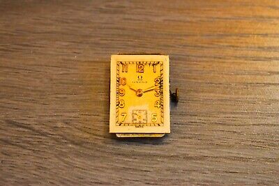

Hello all,
This will be my very first post on this forum, and with that being said, I look forward to learning from the members.

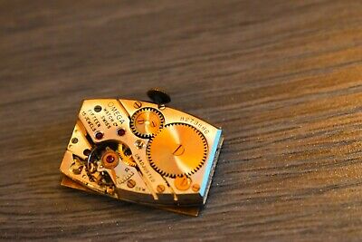

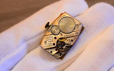

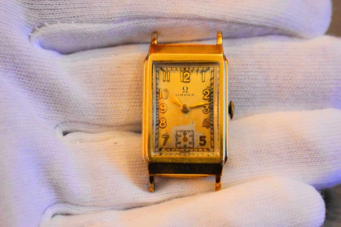

I've recently purchased this 14k gold filled , OMEGA Tank with the T17 15 Jeweled movement.
However, my Googling skills have not born any fruit and I am unaware of the model name. I was hoping you (the members) could help identify it so that I may be able to research it (the watch) more in depth.

Interesting watch, early 1930s I believe. I don't know if it will have any particular model name, however. Most didn't.
2,680
3,158
Google using the keyword "Tank" it will enrich the results

Thank you both for your feedback.
In my research I haven't been able to find a TANK with the engraved 14K Gold filled on the back case. I've found very similar dial faced watches all within the twenty years of eachother (30-50's Art Deco style), but they're all either stainless steel or silver and not 14K gold filled. Which has me wondering what the rarity of this watch could be.
I purchased the watch on eBay as I have grown fond of the idea of leaving various heirlooms to my kids after my time has come. Something about having a great timepiece that's almost 100 years old on the wrist "now" and adding potentially another 50 years to its time telling story is very romantic.
My daily tool watch for work is the Marathon Jumbo Search and Rescue, 3 Jewel high torque quartz Swiss made Red Maple leaf. With three straps and two bracelets It's been on a few deployments with me and its just a rugged piece of kit, however, I have been leaning towards luxury time pieces for a while now.
I was bidding on a Large Cartier Tank & a Santos when I came across this Omega tank. It was slightly larger then the two aforementioned watches and looked more masculine to me. I'm very excited to take delivery of it and have it serviced/ restored.
Anyway,back on topic. If anyone has any information, please share as I am very interested in pursuing the origin story of this watch.

I like more modern tanks, around 1960-1970 - but I research earlier ones as well when I come across them
Almost all of them are one of a kind as far as online matching goes, I don't ever recall finding an exact example of an old Omega Tank I was looking at
You could order an Archive Extract from Omega for 120 CHF - it's quite costly but it's a fun piece of paper that shows where the watch started its journey

From your description of the case and the pictures, I can see your watch is a U.S. national production model from the mid-1930’s. At that time, this was done to save on customs duty.
There is a 3 letter US import code on the movement, which meant that the movement was made in Switzerland and exported here. The case likely has a case maker’s name and the Omega logo on the inside.
The only thing that Omega can tell you about the movement is the production date. They will have no records on the case or when it was sold retail within the US. IMO, the archives extract would be a waste of money for this watch.

I've noticed the 3 letter hallmark, and now understand its nature. Thank you.
It's sad that much of this watch's history has been lost to the sands of time. Well, I guess I will have to put together something for my blog at some point. I'm searching online for 14k gold filled tanks and I have found a few solid white and rose gold tanks, but nothing resembling the watch I purchased.
Once in hand I can take better quality pictures and videos. Hopefully the local watch maker will be able to tell me more about it.

Other than the fact that the ad is about 10 to 15 years newer than the watch, it’s pretty close.

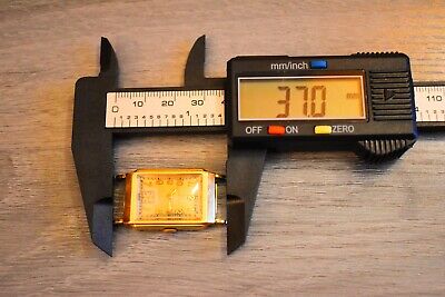

I appreciate all the feedback and support; it's been a pleasant experience seeing as this is my first thread.
I did notice that the numbers, the hour, minute and second hand are also made of some sort of gold like material metal as opposed to being printed.
I found it funny that I had said in one of my previous posts that I found the Omega tank more masculine than the Cartier Must or Santos and that was one of the key words used to describe the watch in that Dec.1947 advertisement. I guess the styling still evokes the same feelings and thoughts some 92 years after being created.
I wonder if it'll handle daily wear, as it would be a shame not to enjoy the watch regularly. UPS is in the process of delivering it, and upon receipt I will make some videos and take some hi resolution pictures to share. Does anyone on this forum have a similar watch that can tell me what the servicing was like for them?
You will want to avoid moisture (e.g. even high humidity or splashes), since the watch is not at all water resistant. Also, you should be extra careful to avoid dropping the watch or any sort of impact, since the movement is not shock-protected. Otherwise, after a service, you should hopefully be able to wear the watch fairly regularly. Regarding the service, you will just have to contact a watchmaker and see what they find when the movement is disassembled. There's really no way to know the condition of the moment beforehand.
I see, it's not like a car mechanic who has set rates for services, like changing a turbo is between 5 - 8 hours at an hourly rate of $90-$130/hr.
I have much to learn.
There are some high end repair shops that will give you a fixed price in advance, but those quotes are often astronomical in my experience.
More typically, you may be given a base price for a full service, but if replacement parts are needed, they will be charged extra on a case by case basis. You will have to hope that replacement parts will not be necessary, since they may not be easy to find for a watch of that era. Sometimes a watchmaker will make do with existing parts, even if they aren't in great shape, because replacements are hard to find. In that scenario, they will generally get the watch running, but performance may not be optimal. Other watchmakers will make more of an effort to find parts, or even fabricate them. But it also depends on how much you are willing to pay.
