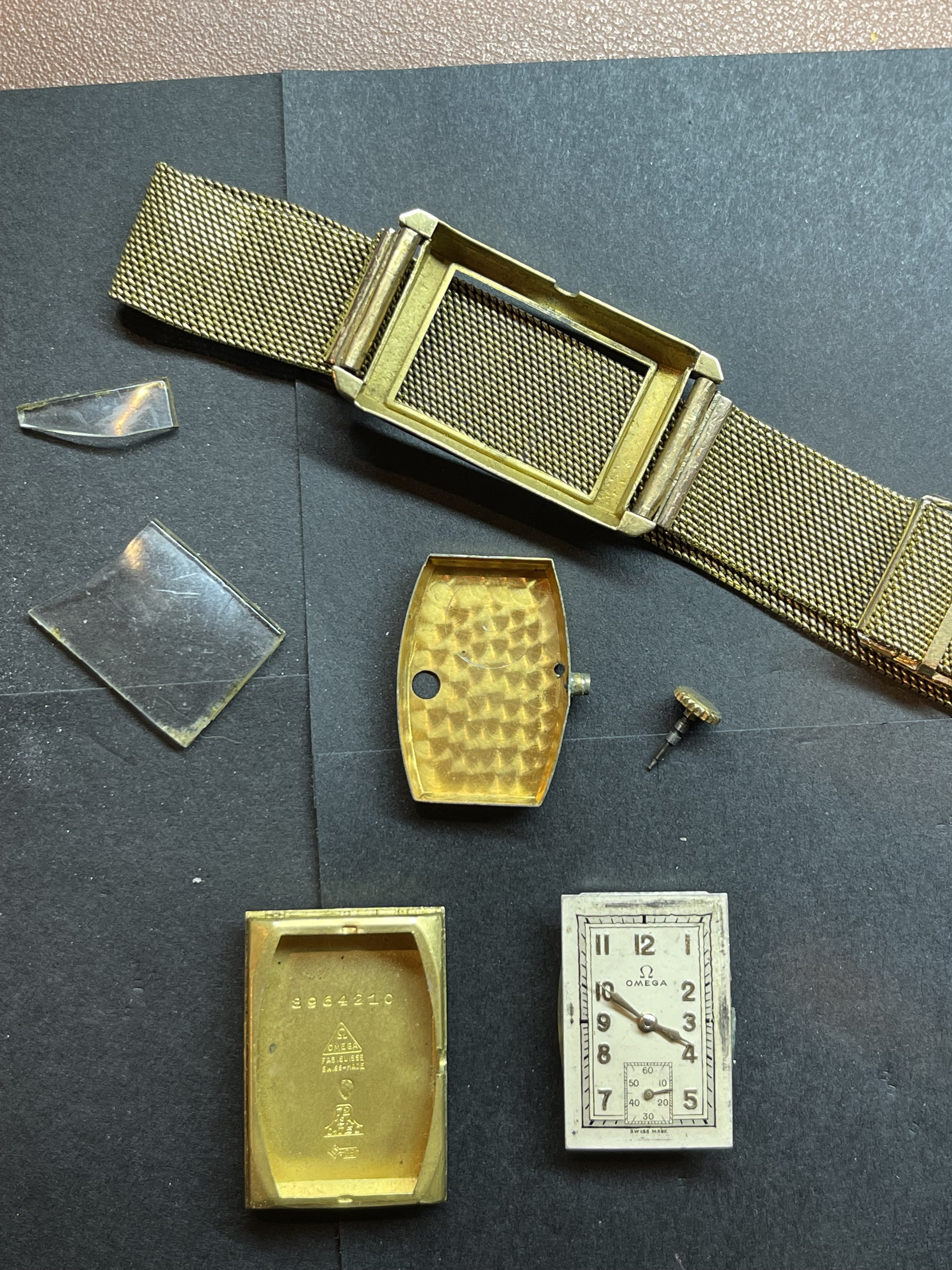

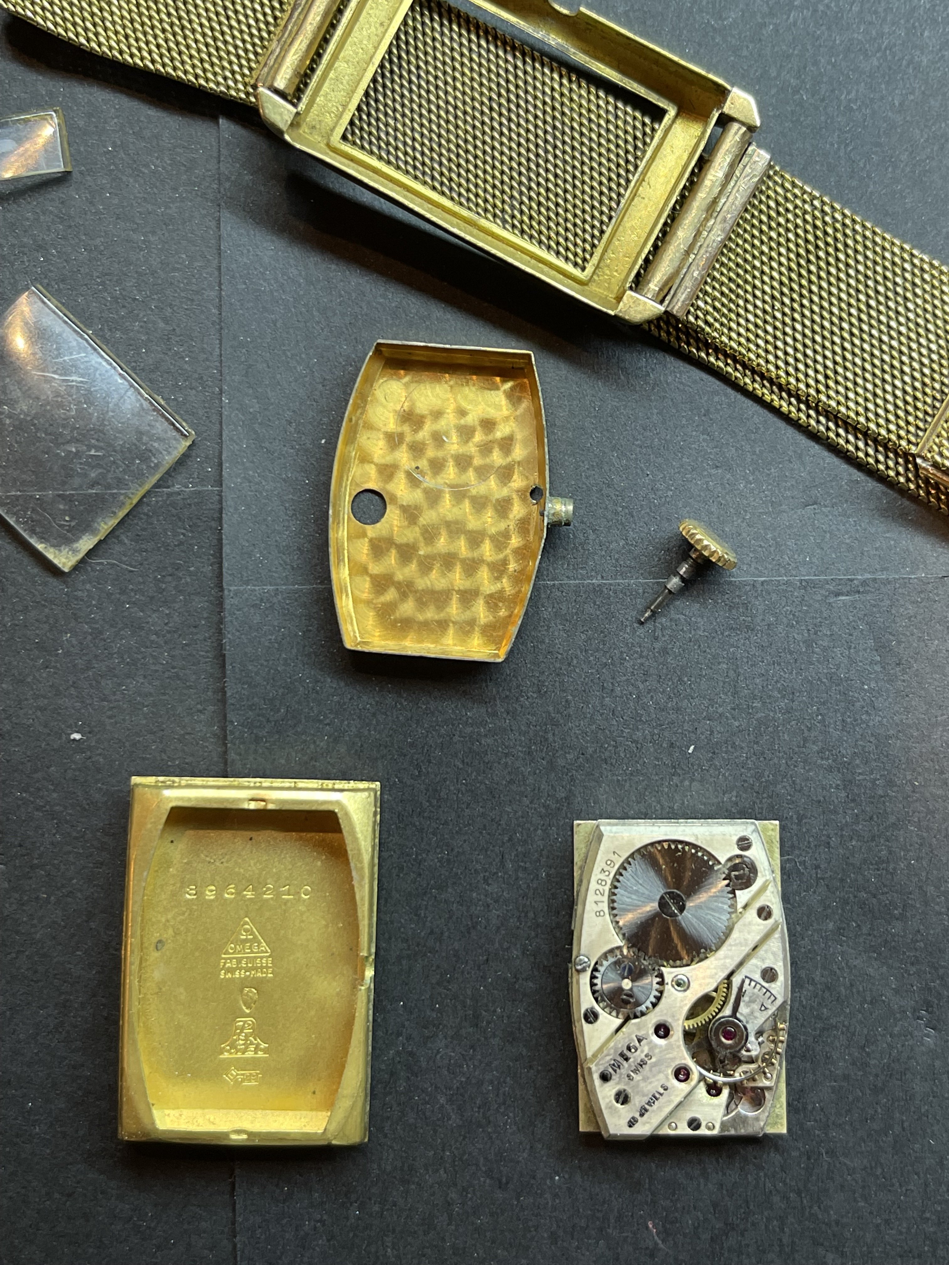

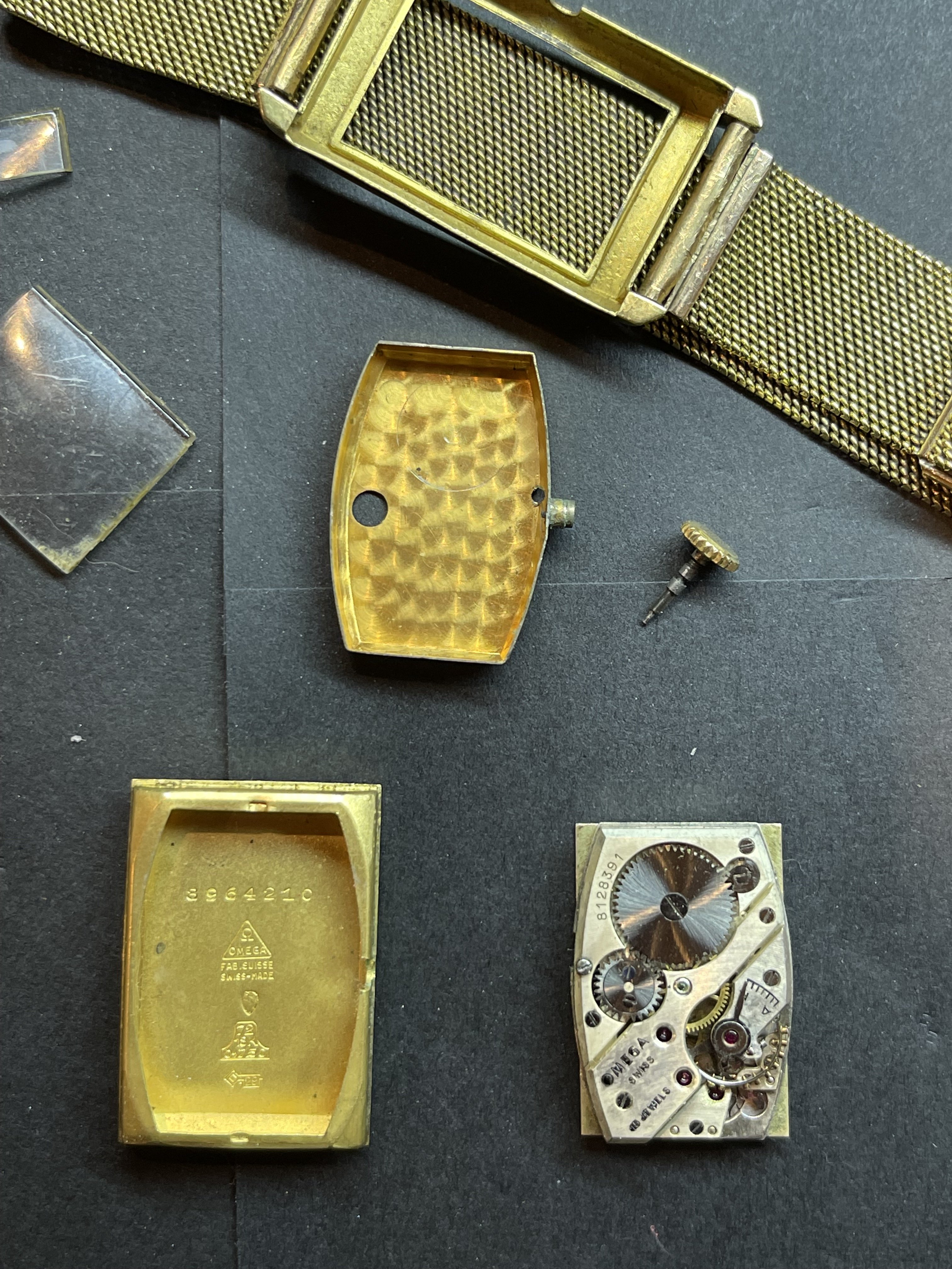

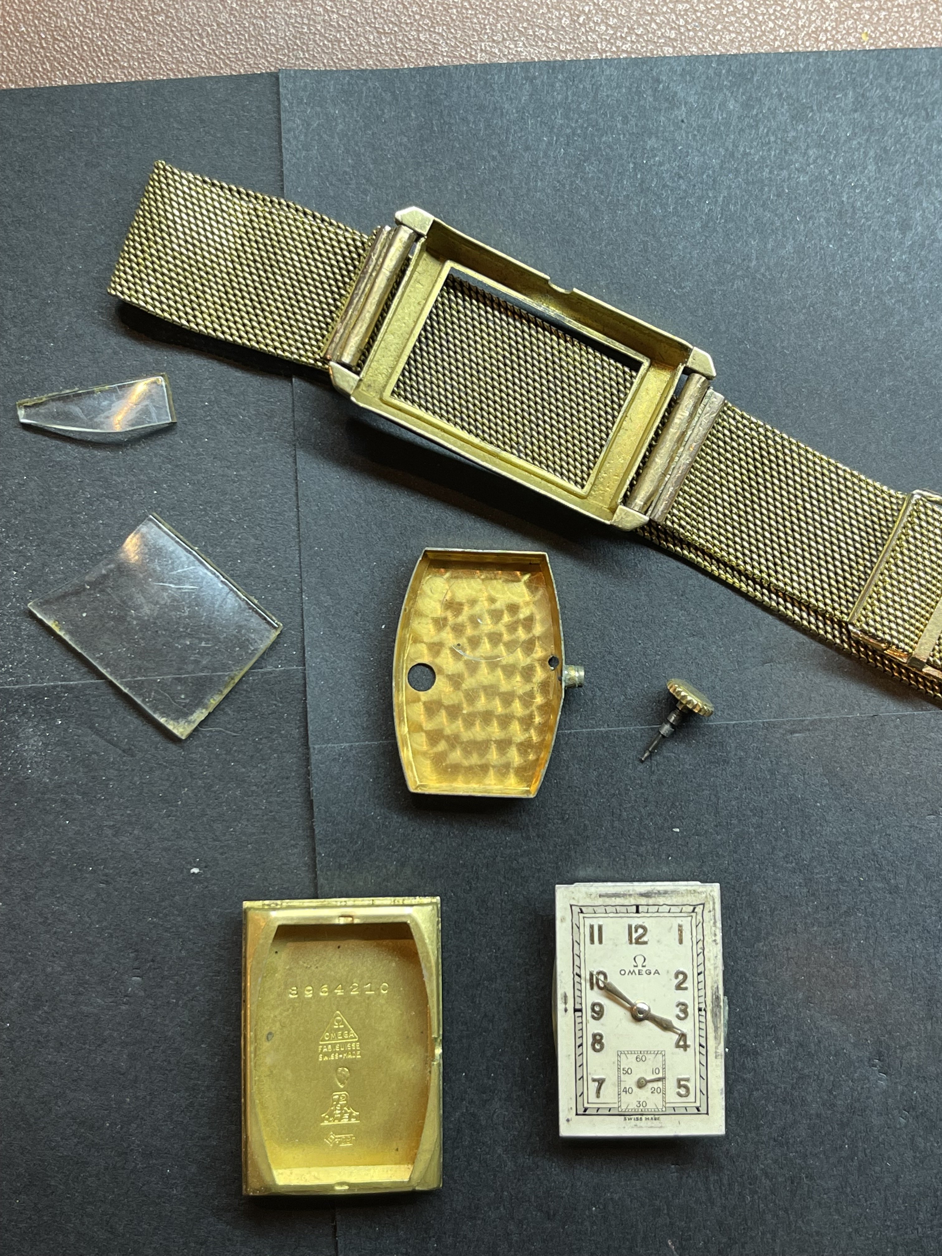

Hi All,
Newcomer to the forums, and I have reviewed the guidelines to make sure this post doesn't violate the rules but I can't be sure I am not breaking convention so please let me know if I have posted in the wrong place or otherwise incorrectly. I recently returned home to Chicago from Russia where my grandfather gave me this T17 that he received as a graduation present in 1940 from his mother, who purchase it in Tehran. I believe, based on the serial/model, it was manufactured between 1930 and 1936. I have read every single thread on these forums about the T17 and I understand that other people have had similar experiences with receiving this watch passed down through family in eastern europe, but I wanted to post again to see if there are any updates or new insights since the last post like this. Though the watch was working well for the first 24 hours or so I looked over it, something has broken in the mechanism after the first winding. I took it apart and inspected every piece but couldn't pinpoint the issue exactly--I know it's not the mainspring, which was in perfect working order, and all the gears are intact and functional. The jewels seem fine, as do the lower parts. Something is off with the ("balance") hairspring and maybe also the crown area (where the tightening screw secures the jacket). Also has a cracked crystal and some normal cosmetic wear issues. Images of the watch pre-disassembly below:
I would like to have the watch reassembled to functionality, to replace/upgrade the crystal, and to make only minor cosmetic improvements to the face and the bracelet. My question is whether anyone on these forums has experience using the S.G./Omega restoration procedure in Switzerland (based on their FAQ and a conversation I had with their customer service) in terms of ultimate price points, timing, and customer service? Money is not an issue and not super sensitive to timing, but I would very strongly prefer not to have it botched for sentimental reasons. I am located in Chicago and to date haven't really been able to identify a master around here I like and seems like would have the wherewithal to complete something like this very reliably (not to say there isn't one, I just don't know how to know for sure and haven't felt a great vibe anywhere). Though this isn't really relevant, one consideration I'll raise is that I'm a younger woman and I have found several masters I've approached about this somewhat dismissive of me/the watch and unwilling to talk details. I would welcome any recommendations anyone might have for a friendly, talented master that specializes in vintage Omega (can be anywhere in the US if they accepted shipped jobs)? I would even be willing to pay premium to a private enthusiast, it's just a matter of feeling comfortable that it will get done with care and attention.
If I botch a job like that and buy a donor movement, would a master be able to help me get it over the finish line, or would that be verboten?
If the watch was working well for 24 hours, then it doesn't sound like you need a donor movement (which will probably have worn out parts as well) unless you damaged something when stripping it. The hairspring issue may very well be recoverable, it depends on what the damage is.
I think that the best is to get it to a watchmaker even though it is in parts. It may cost more as the watch arrives disassembled but leave it to the watchmaker to advise and most of us won't take on a small "get it over the line" job so, expect to pay for a full service. Ask the watchmaker for advice on how to send it as you don't want all the parts rattling around and damaging each other.
Good luck and I'm sure it will be a lovely reliable watch at the end. If you can get Al (@Archer) to look at it, that would be a bonus.
