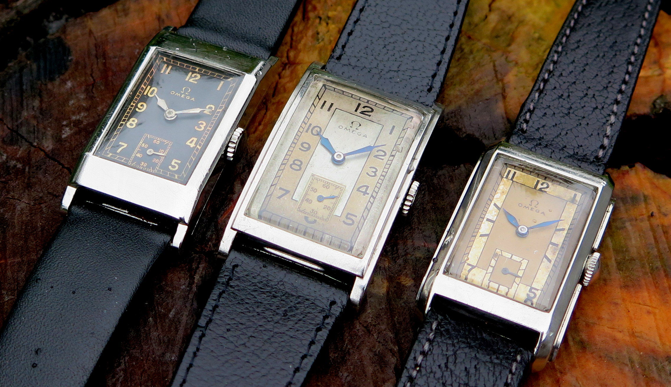

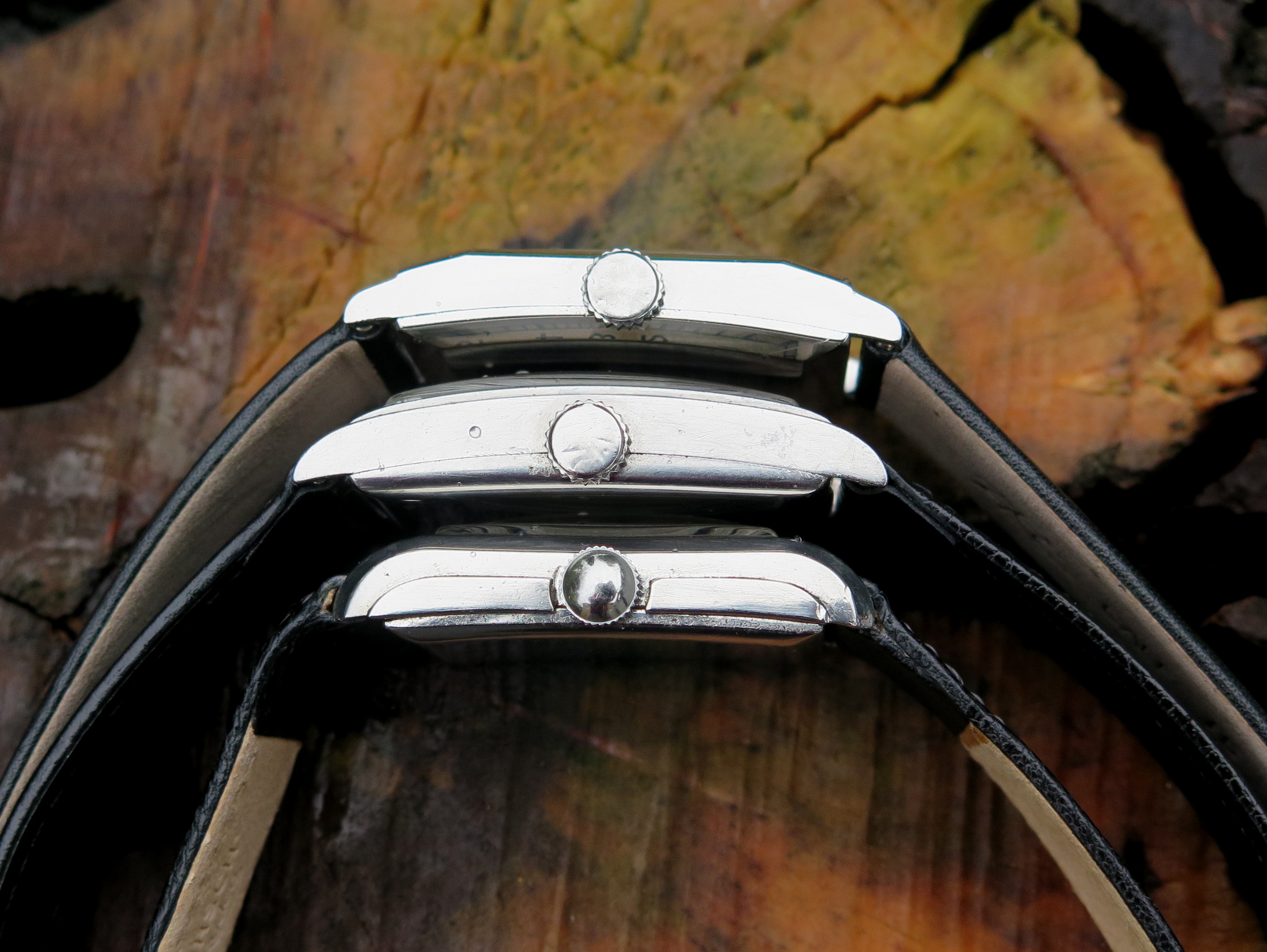

    I think this caliber deserves a thread.
    This small caliber from 1934 had a 60 hour power reserve, not beaten by any mechanical Omega calibers until the caliber 8500 from 2006.

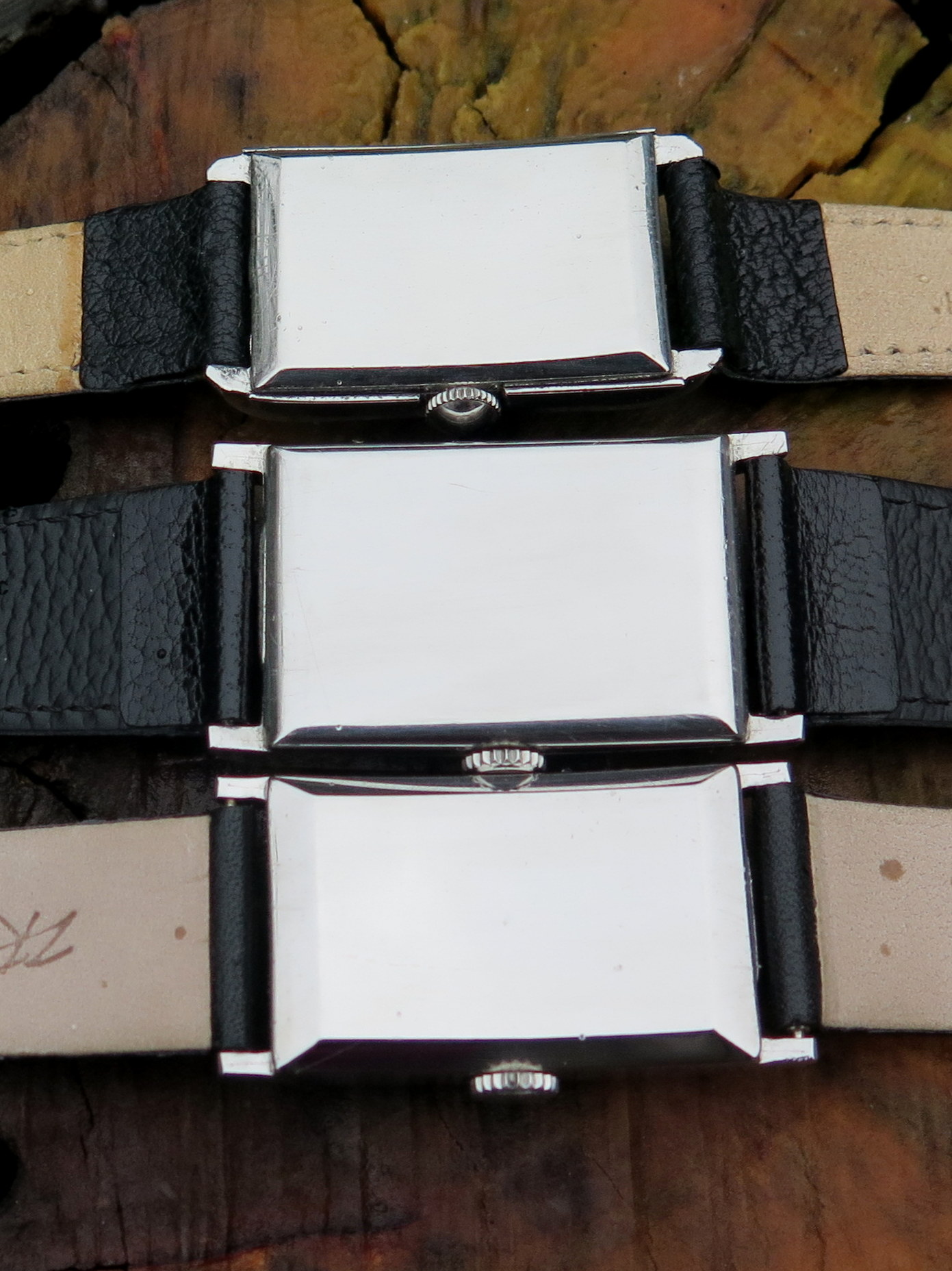

    I will start with mine:
    CK 3516 - CK 891 and CK 921

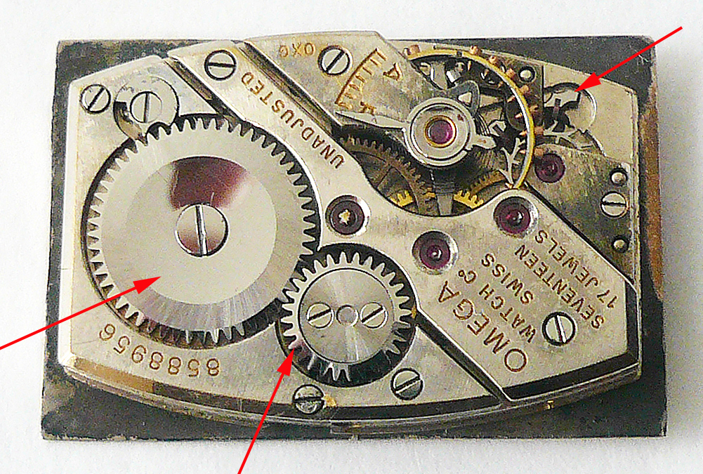

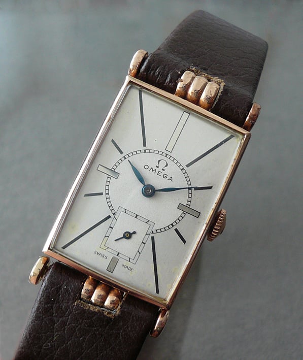

    Here is mine with an "unknown" movement version:
    It is cased in a 14K pink gold art deco body.
    The "special" is the movement:
    It has 17 Jewels opposed to 15J commonly found and it has special finishing to the crown- and ratchet wheel and also to the pallet fork.
    The latter is angled and polished.
    This watch had been delivered to the US hence the inscription "unadjusted" on the movement to save on import taxes/duties as they were imposed related to the number of jewels...
    This movement is believed to be a chronometer version due to the special finish although the inscription does say differently.
    SERP, nitediver, Dug and 30 others like this.

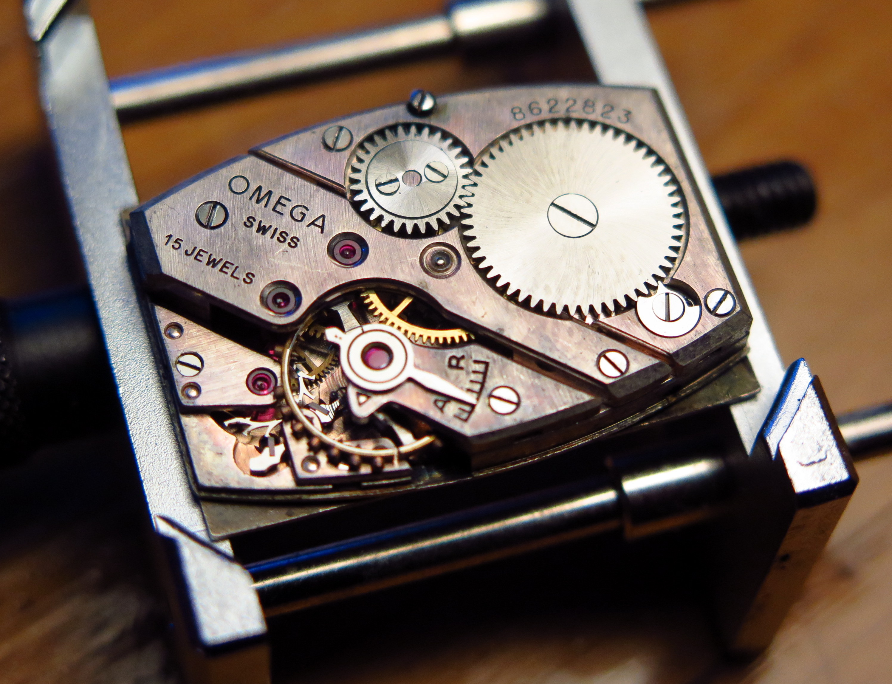

  12. Tire-comedon First Globemaster Oct 27, 2016
    1,314
    3,639
    Here is the picture showing both finihes for 17jewels side by side.
    [​IMG]
    nitediver, Dug, mac_omega and 13 others like this.

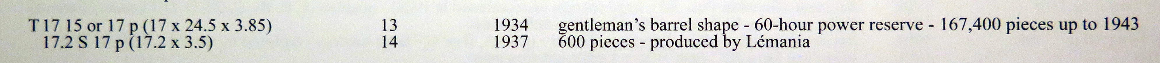

  19. tdn-dk Oct 28, 2016
    1,717
    14,548
    My T17's is in the 8.657.xxx-8.826xxx range around 1937 and 15 J movement
    Maybe @mac_omega 's is one of the rare 17.2 S 17 p :)
  20. OMTOM Oct 28, 2016
    511
    1,306
    Sorry but I don’t think there is any connection between the T17 and 17.2S – apart from being adjacent in the listings (the 17.2S is not a ‘tonneau’). And that’s why DON’s comment is interesting – we are given no breakdown of the variations within those 167,400 T17s.
