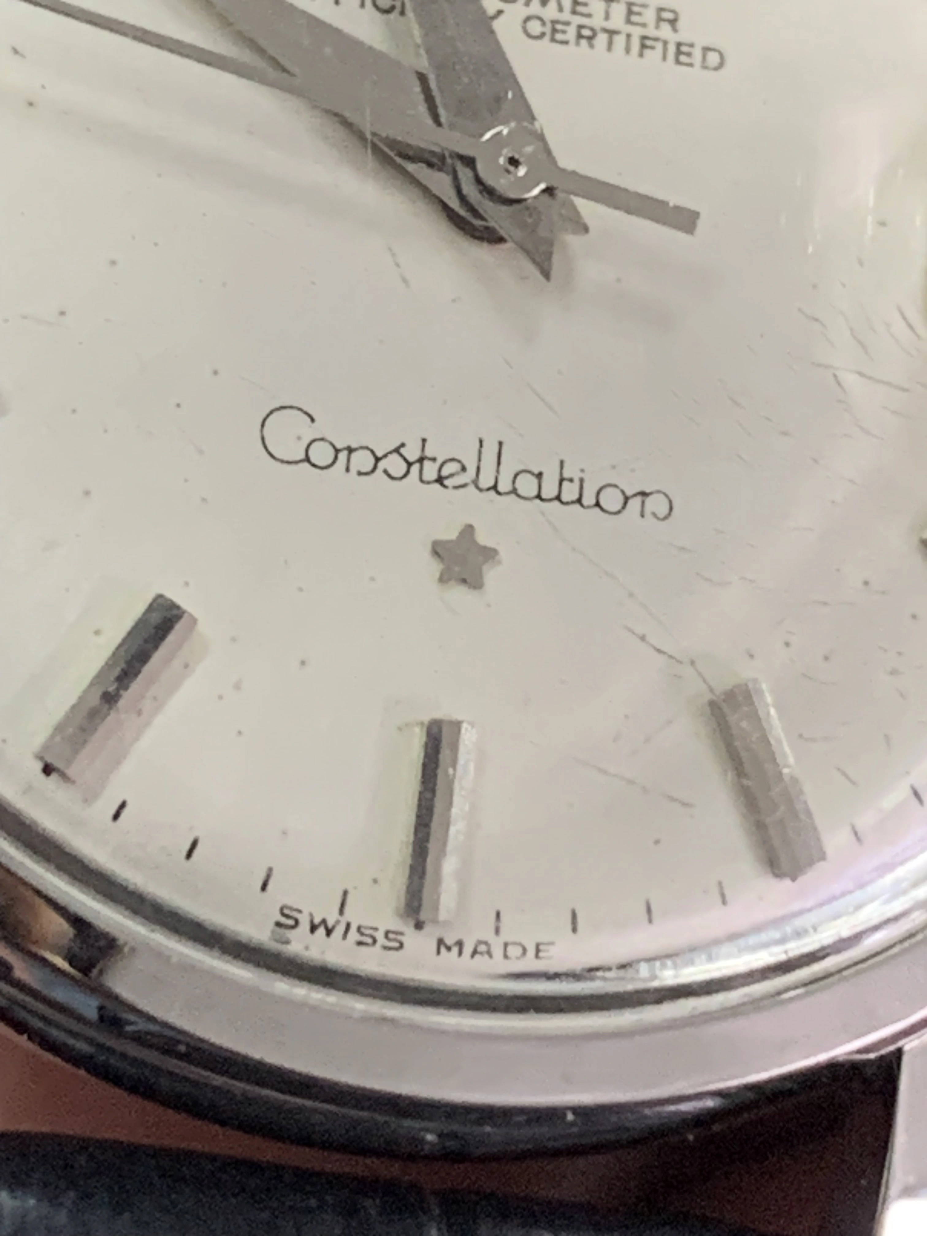

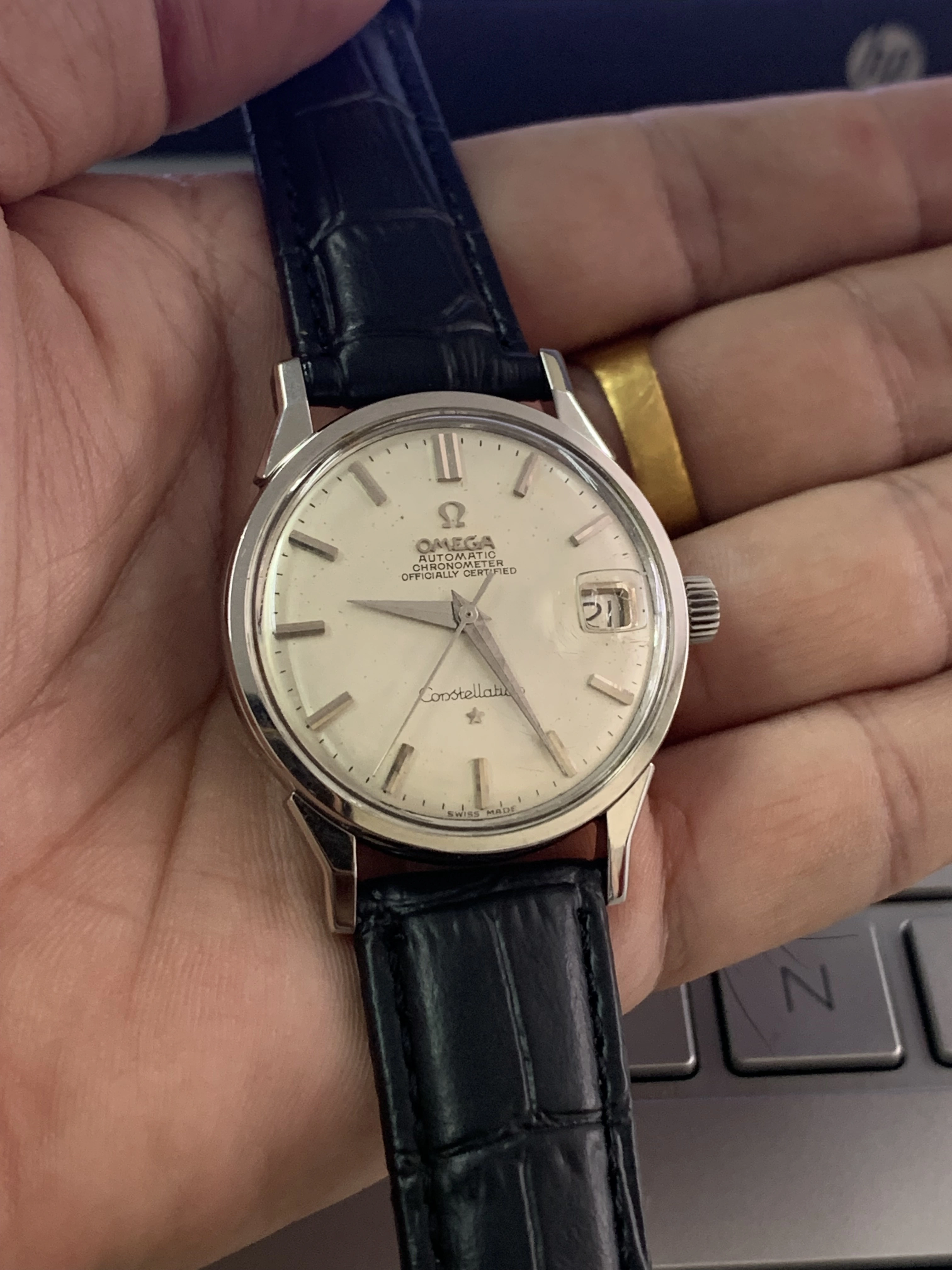

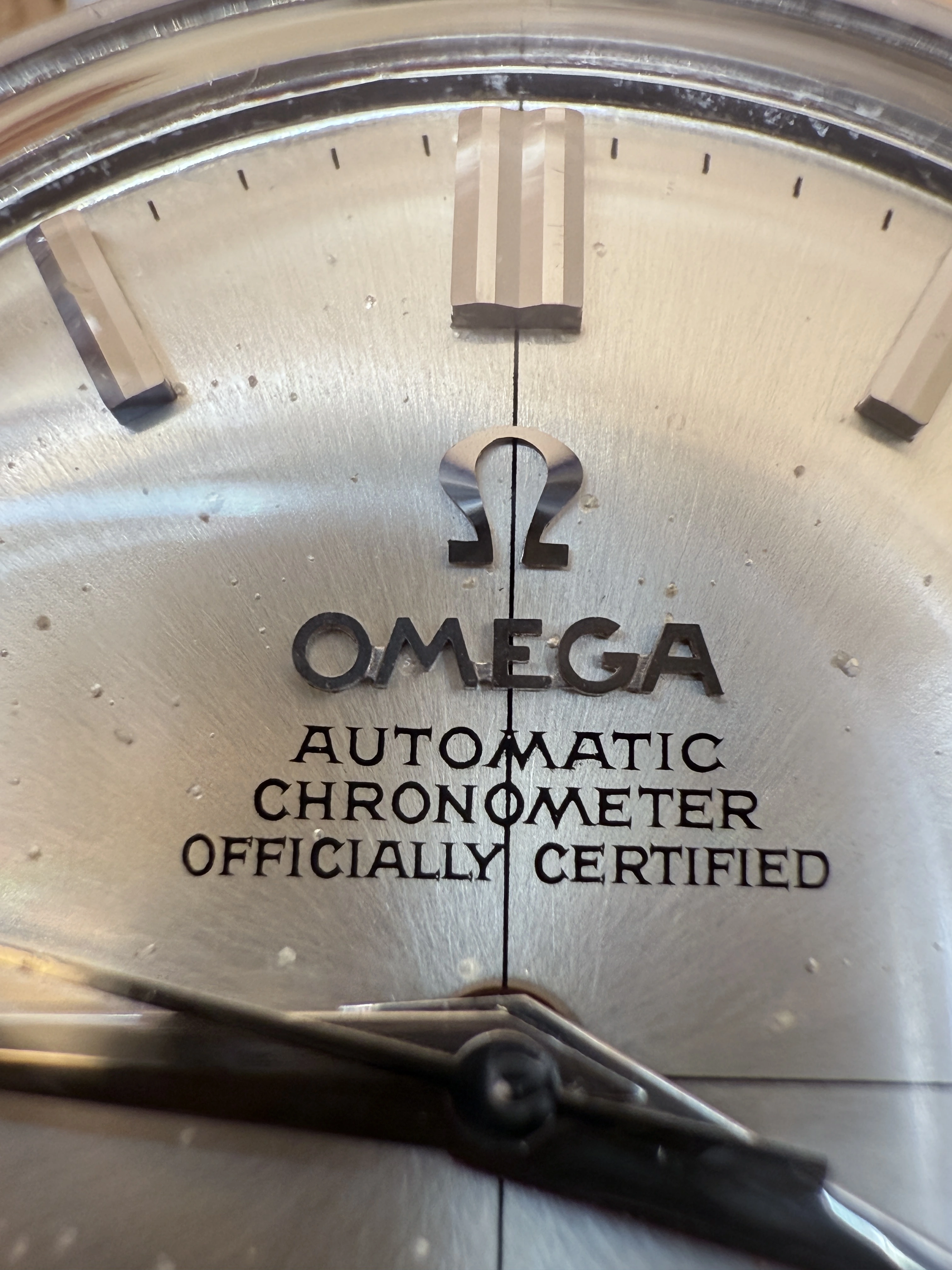

This is the watch I bought before knowing about this community. Many of the lessons here make me suspect this is a reprint.

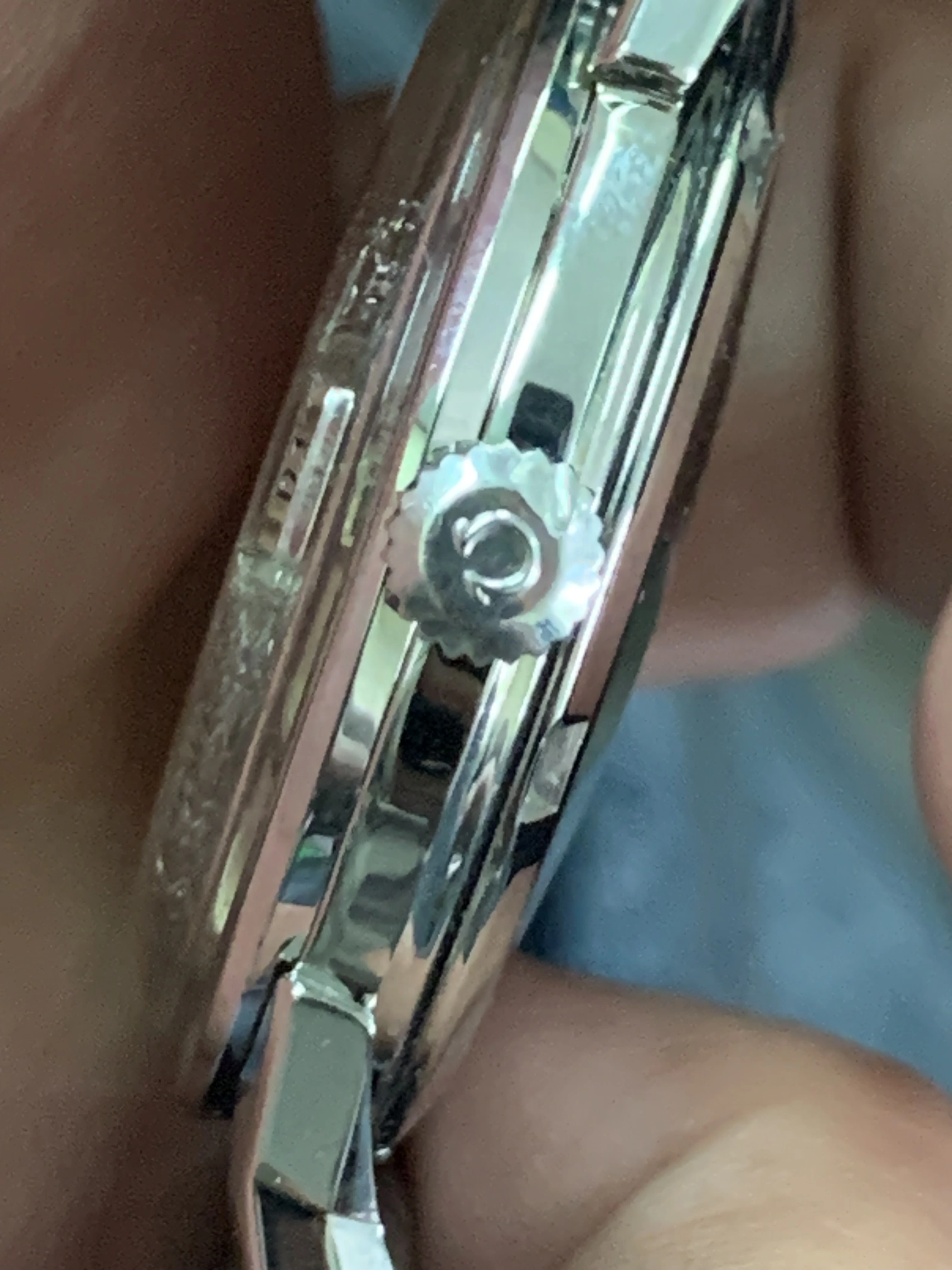

The Automatic lettering is too close to the horseshoe logo, the "C" in the text is a bit different, the case is polished. I want to know your opinion on the things I just mentioned. Thank you, it would be nice to receive a review.馃檪

Yes, I agree that the dial has been repainted. The font doesn鈥檛 seem right.

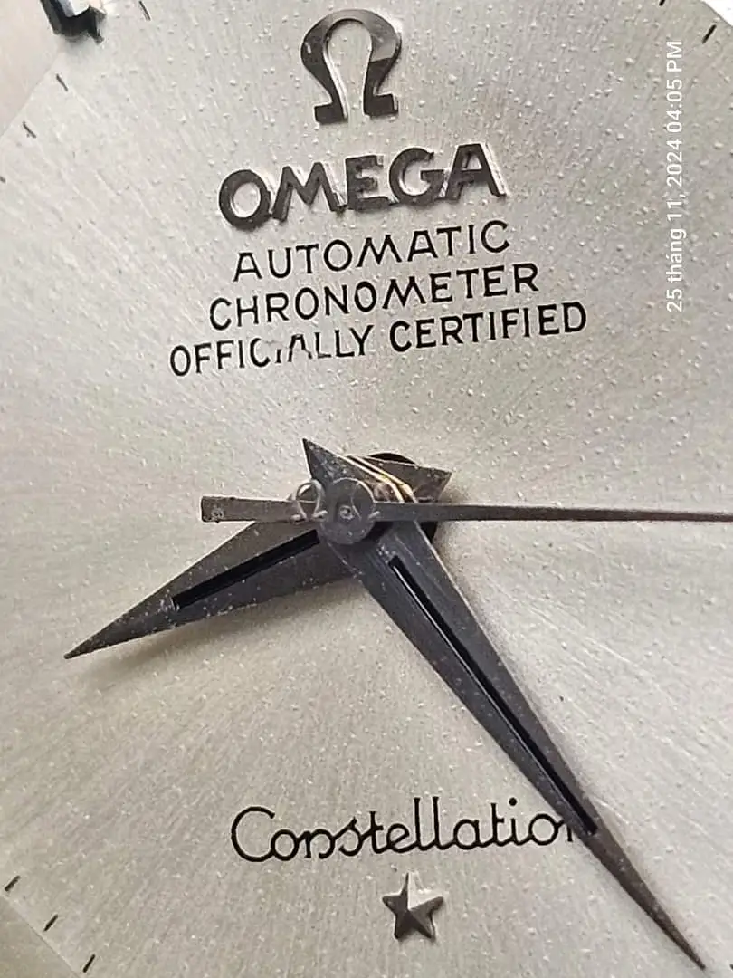

Your illustrations are beautiful. I wonder if the diagonal doesn't seem to go through the center of the "O" and the base of the logo or is it because of the shooting angle.

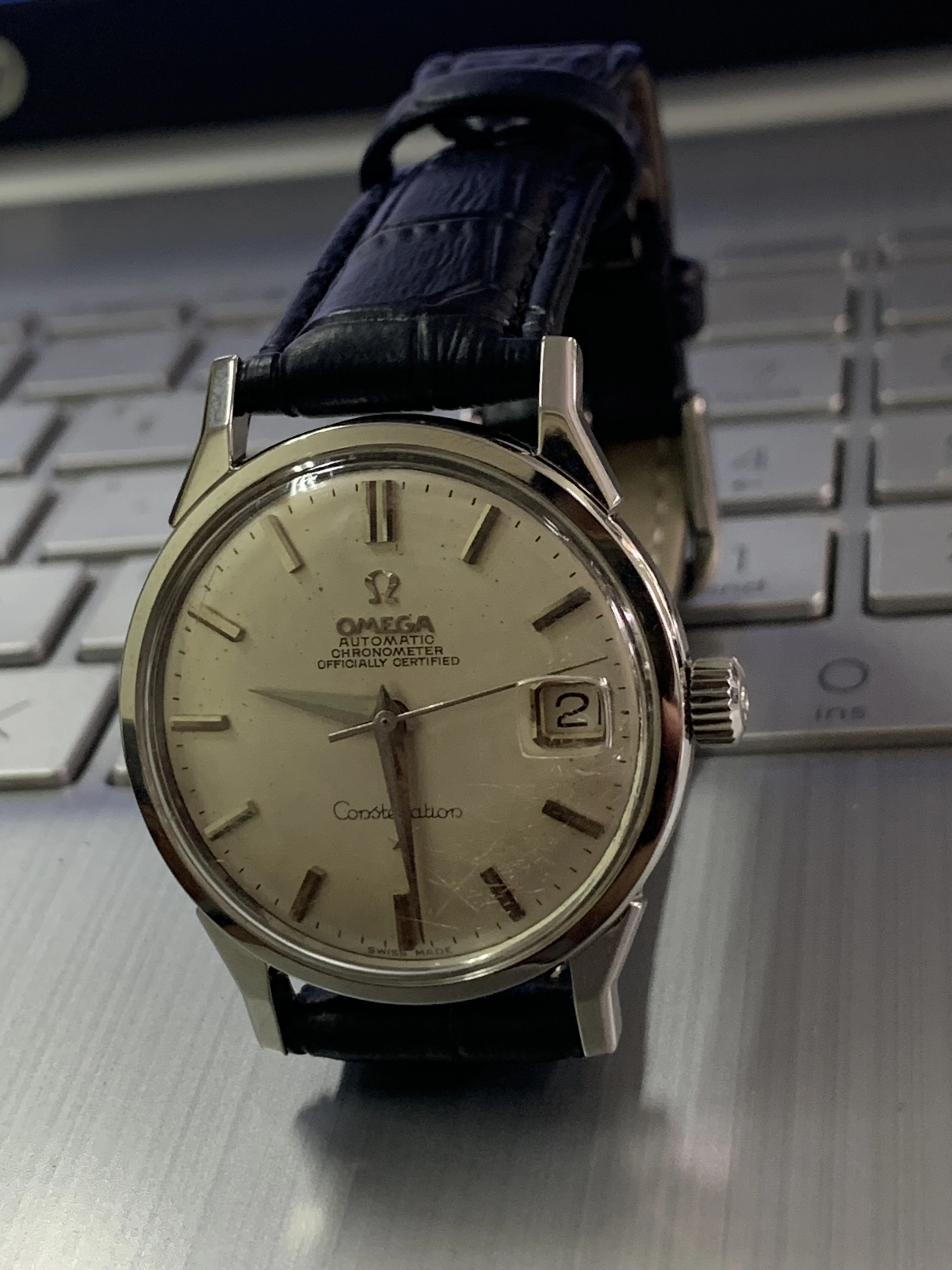

Compare yours with this. If they look the same, you are ok.

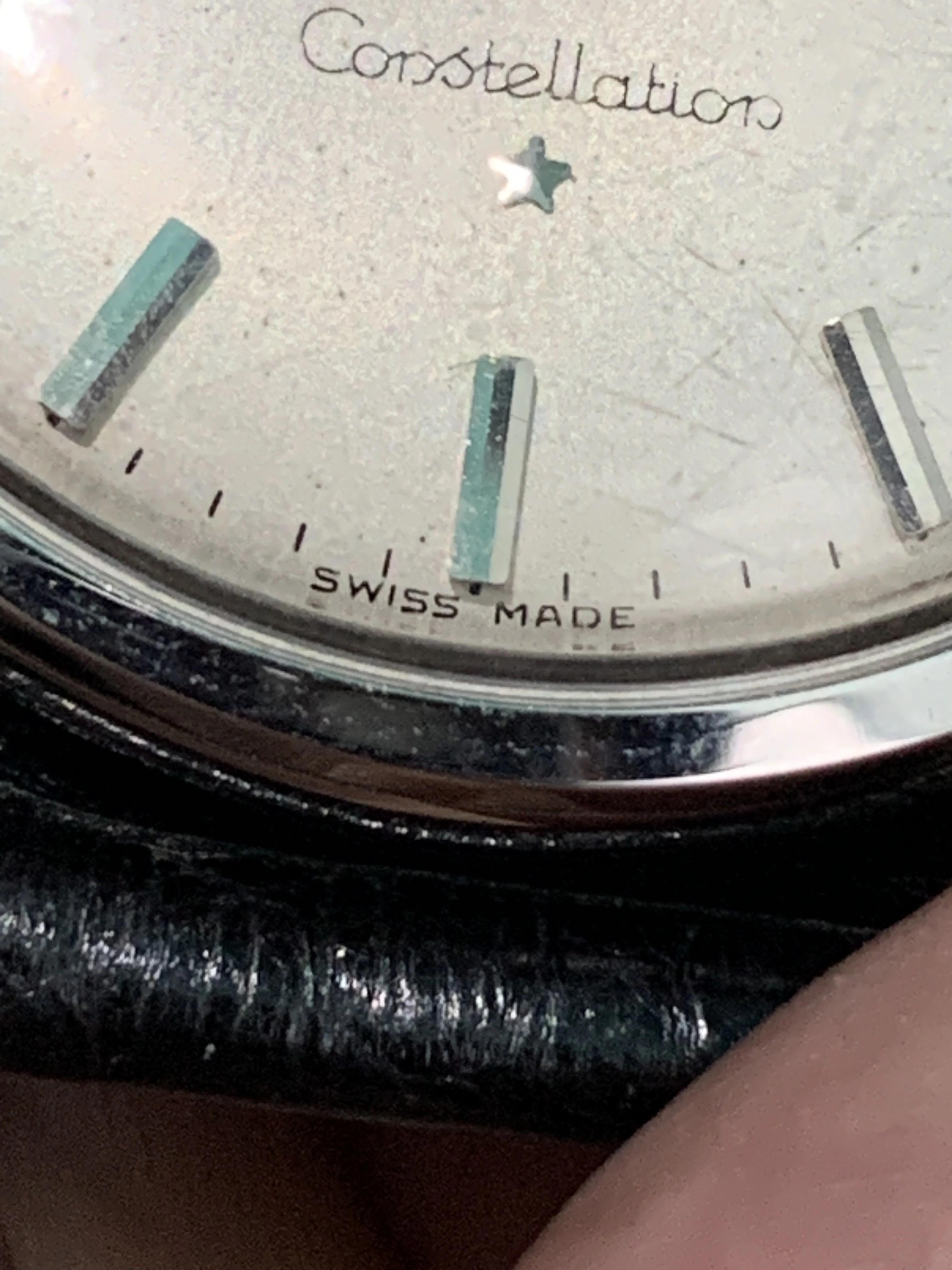

In my opinion the dial is off. Look at these tick marks next to each hour marker...
add the shooting angle, is the 7 o'clock position right as you said, what should I do? Can you give me some advice?
