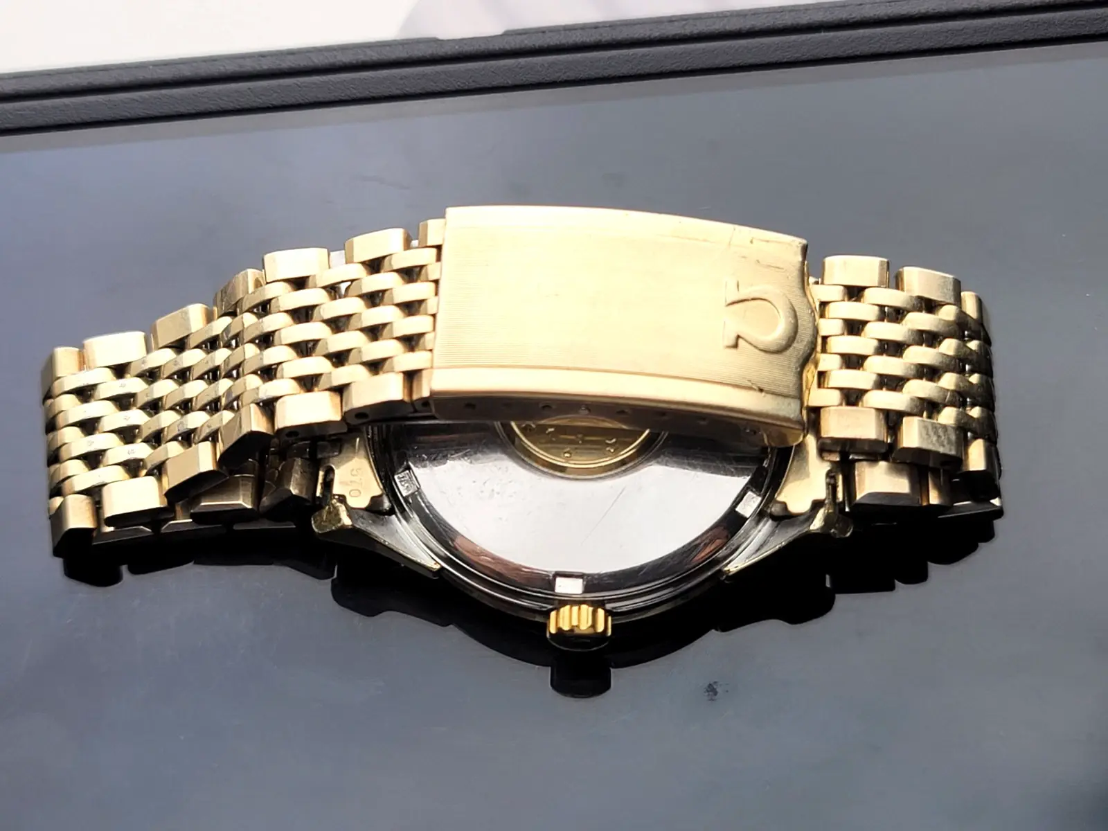

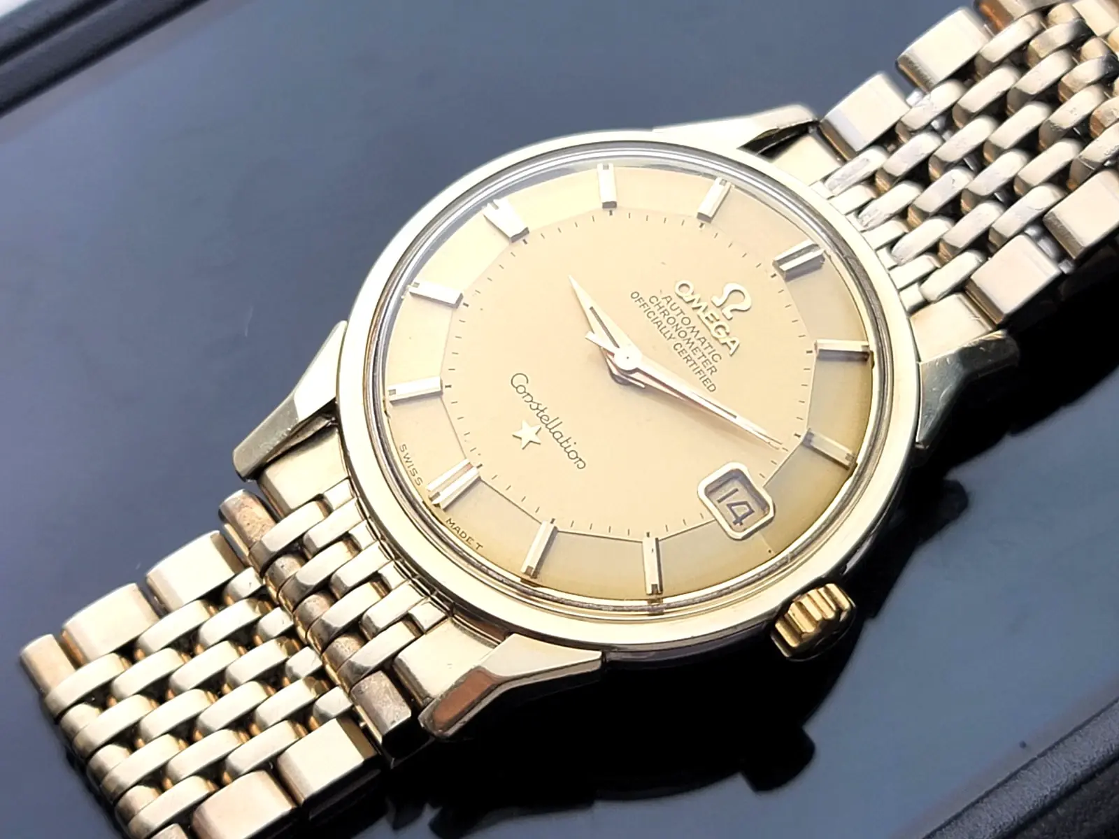

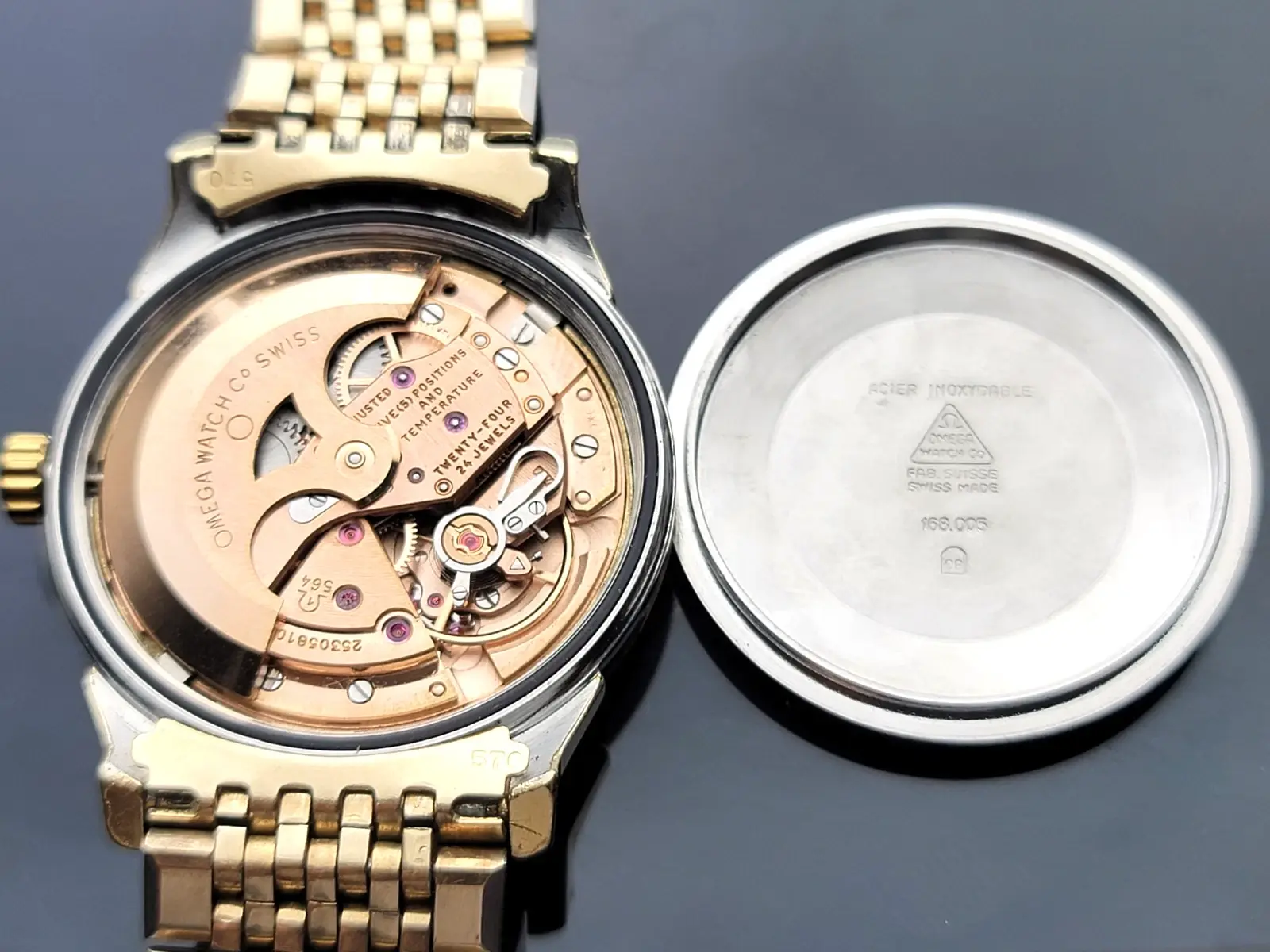

I know almost nothing about dress watches. Can you Constellation lovers tell me if this is a good choice and how over priced it is?
I don't know if I am allowed to post the listing, so I'll just include a few photos. It's on ebay now. Thanks for any education you can provide. The listing calls it gold capped and ss. It's listed for 3750 BIN. No offers. I like the gold in this one as 18k is too yellow for my taste. This is more subdued.
202
176
The lugs look heavily scratched and appear to have been polished. My guess would be that its worth about half the asking price.
Someone will probably buy it though, so you can't blame the seller for pitching it high.
Unless that bracelet is solid gold...

Please wait for a more experienced member to opine before acting. Or rather, not acting!

I saw the lugs....someone was not very gentle with it. Thanks
If that bracelet were solid gold, I'd say it's worth 3 to 4 on its own. Almost certainly not solid.
3,592
13,544
Assuming the 3750 is €/$/£ and not ¥, it’s too much in my book. Certainly not the worst example, but the lugs are indeed pretty soft and that’s kinda what doglegs’ appearance lives of.
Also, they aren’t particularly uncommon, so why settle for a mediocre example.
Really sharp, nice steel pie pans are reaching the 3k mark, but certainly not gold-capped ones and not heavily polished ones.
The incorrect crown isn’t the end of the world but it’s another 100$ to fix.
If you have just a little bit of time I’d suggest to wait.

I’m going to be a little harsher.
The lug facets are none existent and the inner edges are chewed.
I agree dogleg pie pan prices have gone mad but anyone who knows what they should look like should run a mile from this one.

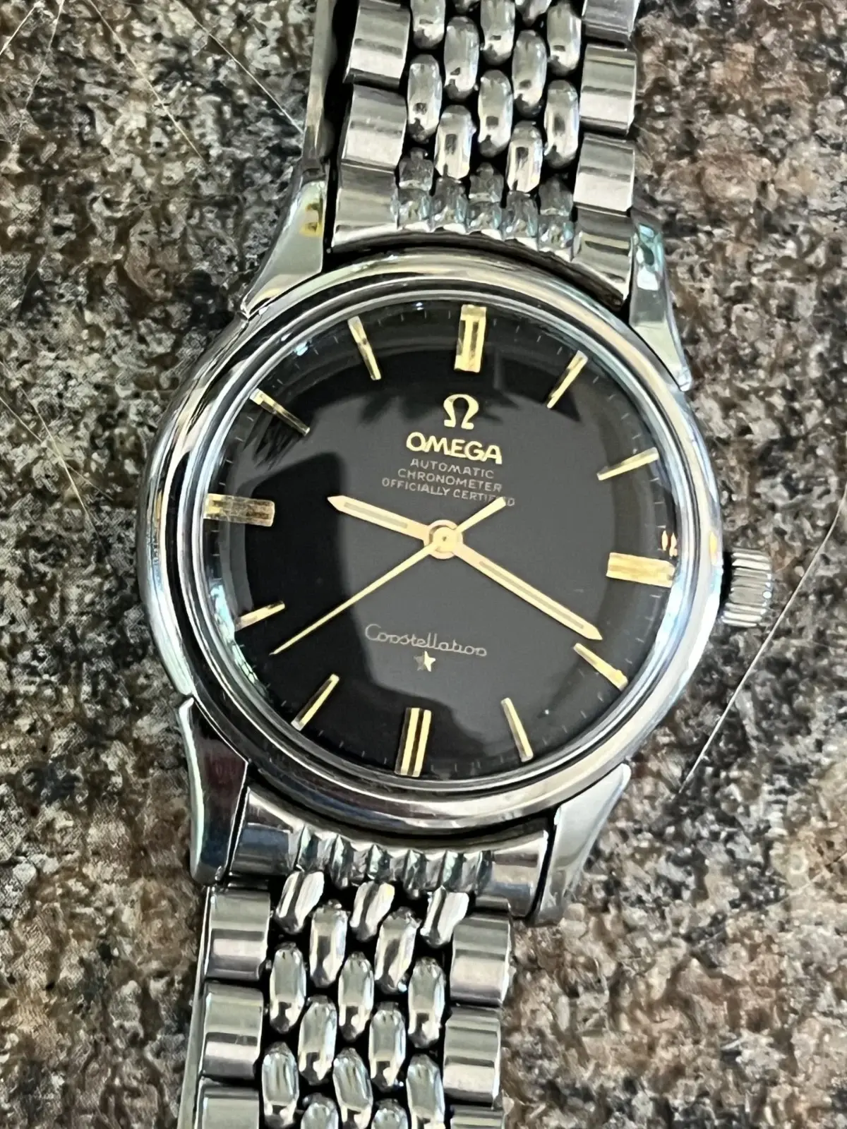

I like this one, but it's in Japan...and I am not good at seeing re finished dials on these.

With a terrible picture like that even the best of us would have difficulty in spotting a redial.
6,824
10,496
With any vintage watch clear in focus pics are essential but with black dials they are even more important.
This is a heavily polished lyre lug watch which has a black dial and entirely wrong hand set with a fuzzy pic.
Big red flags all round.
6,824
10,496
If you want a proper assessment of a watch you need to provide really good pics and lots of information - lots of pics inside and out.

Well, if I get beyond the preliminaries, I'll find more photos, but no point in diving into a watch that has several problems right up front. And to be clear, I've been collecting Speedmasters, Daytonas, etc. since the 80s. I'm not just off the turnip truck, but these are much more likely to have re finished dials...probably just avoid them.

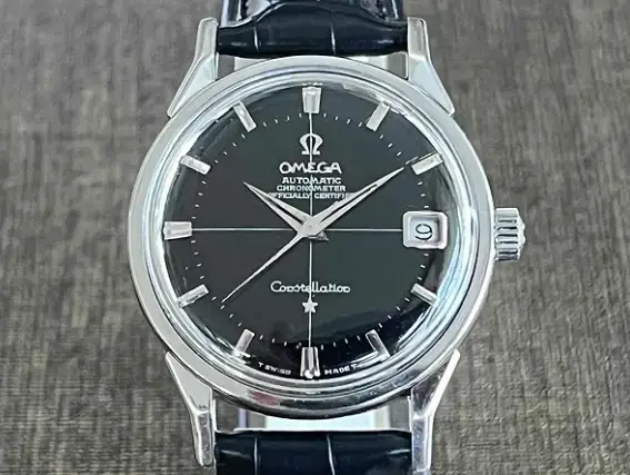

445
1,106
These are also 3 very different Connies: Date, no date, lyre lug, dog leg lug, pie pan dial, non pie pan dial, stainless case, gold cap case, stainless furniture, gold furniture, crosshair, no crosshair, leather strap, 7 row BOR, 9 row BOR.
I'd recommend deciding what you like and making your world smaller.
