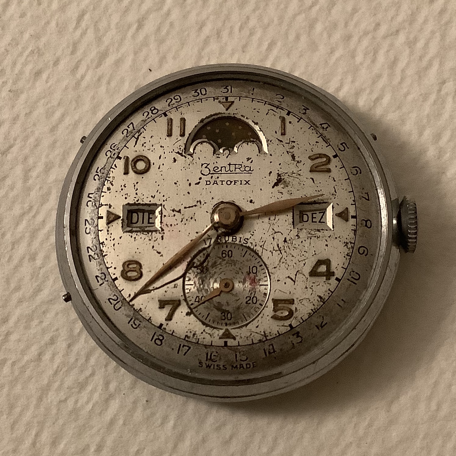

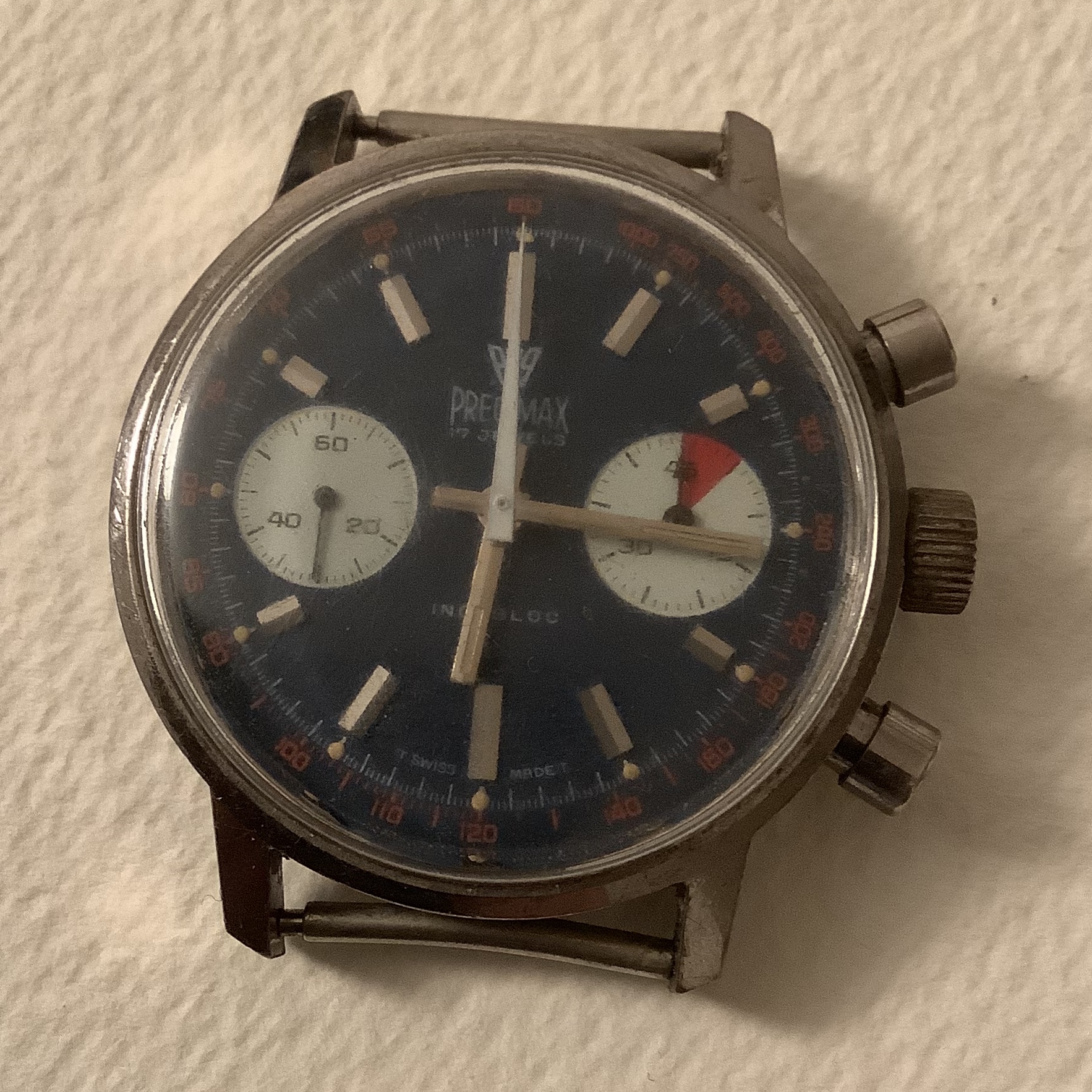

There’s a big flea market in my town once a month. I never thought it likely to find anything there, and you have to pay an entrance fee and parking, so I never went before. Decided to go today. Found these and asked the guy how much. He was a general kind of dealer so I figured he’d want too much. This one’s 5 euros and the other one’s 2... I figured no harm asking if he’d do both for 5 to which he agreed 😁. I just paid and ran. Back at the car played a little with the chrono and it seems to work. Might even be a Val. 7733 according to similar I could find online and the tick is certainly loud enough for a 7733. I think I’ll be going back next time !
