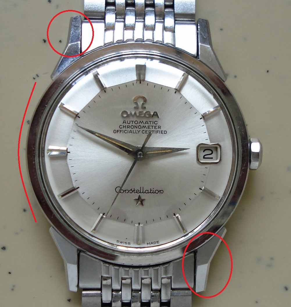

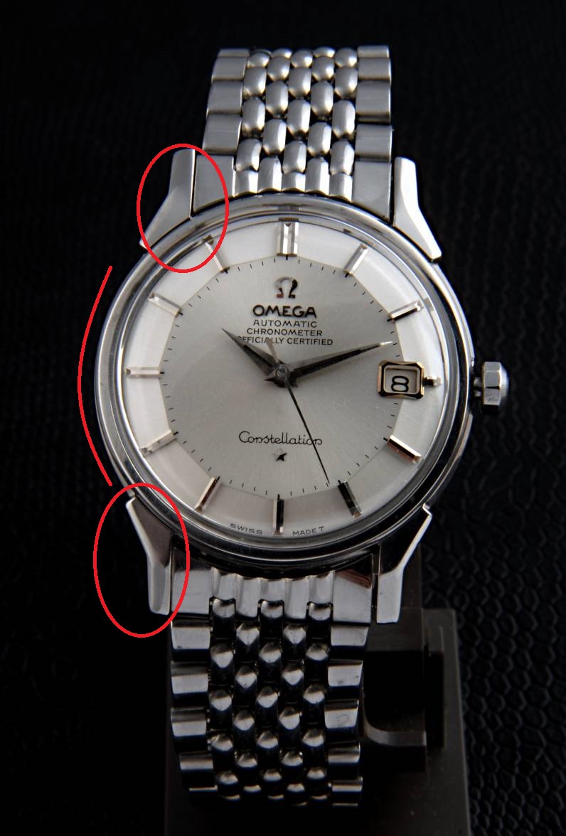

1. Case: This should be in a condition where the original facets are still clearly visible. The original brushing on any brushed parts should still be visible too. Places where this is very visible: Bezel, lug chamfers, case back medallion (if any).

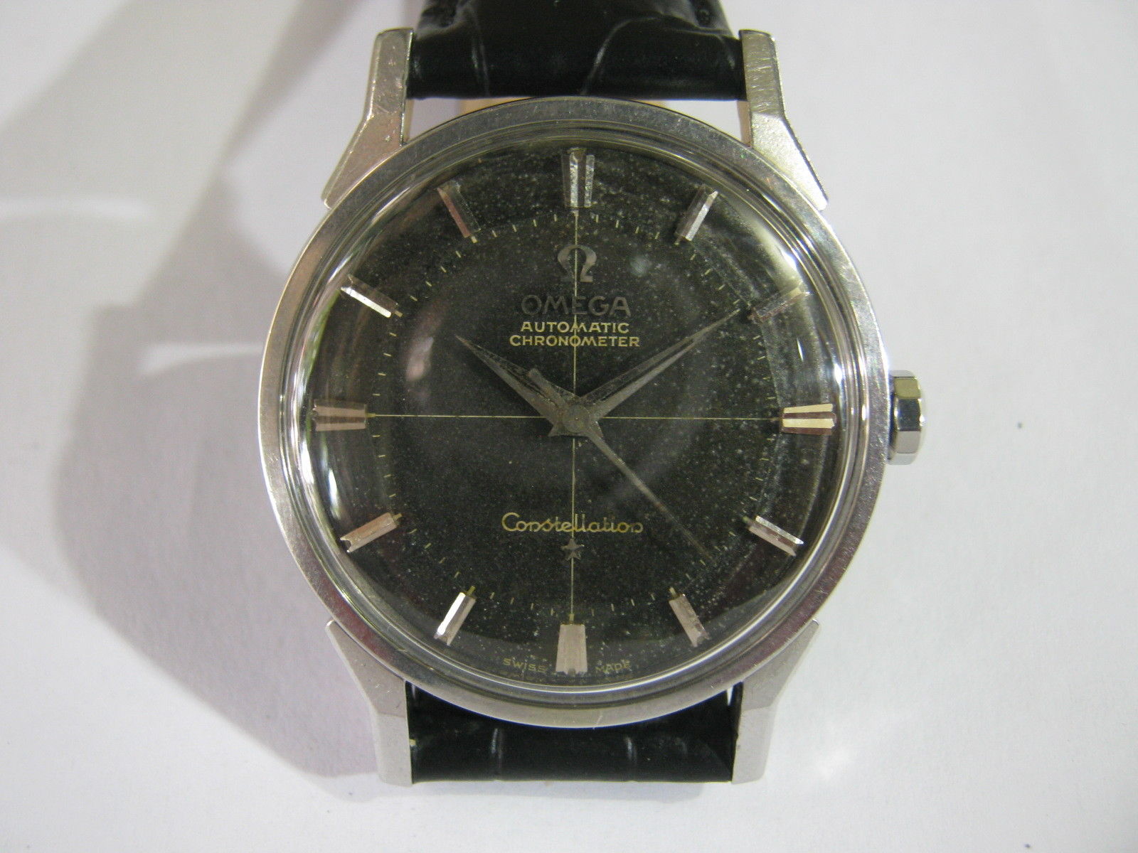

Consider these two Constellations:
The first one has razor-sharp edges on the lugs and the bezel is perfect too. On the other subject, the lugs have lost definition and the bezel has been rounded by polishing. This greatly reduces the overall impact of the design and should be taken into consideration, were you to consider a purchase. Note that most old watches have been polished at some point, so while having an unpolished specimen is great, one that has been polished could just as well be a well-maintained, old watch.

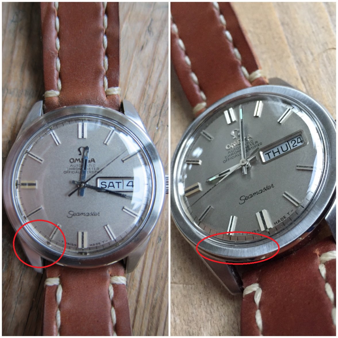

Here is an example of how correct brushing can affect the look of a watch:
This is actually a before-and-after photo of one of the members' Seamaster 168.022, which had been incorrectly brushed at some point. Look into how the polished and brushed parts of the watch you are looking for are supposed to look like and this will help you uncover no little amount of attempts to cover up bodge-jobs.

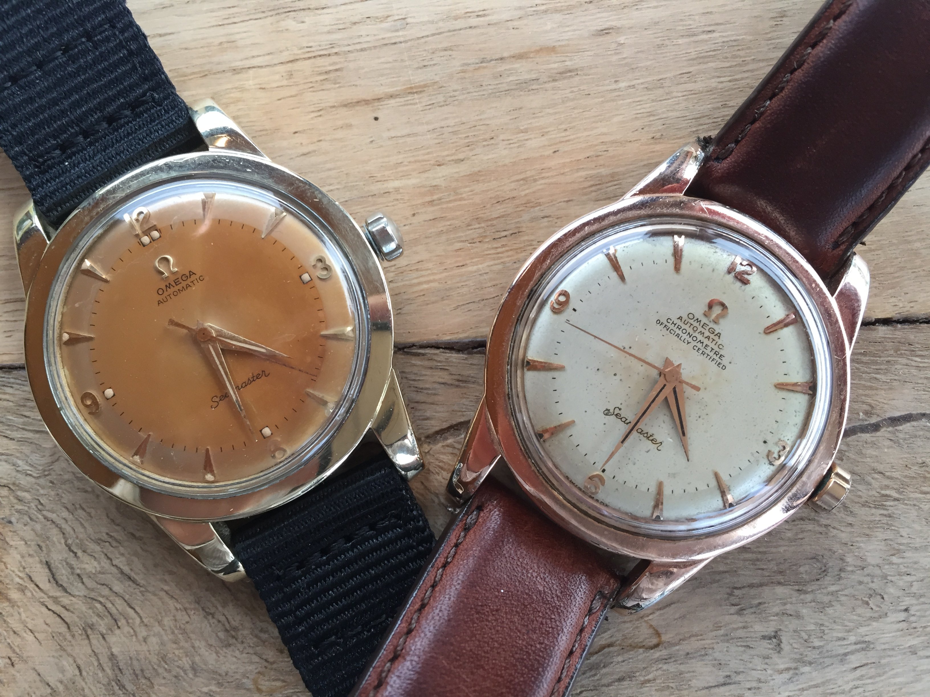

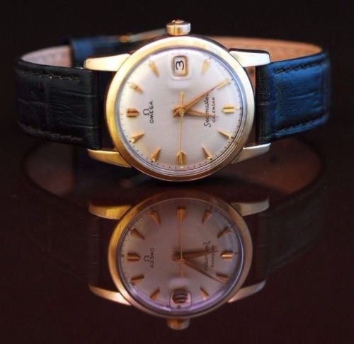

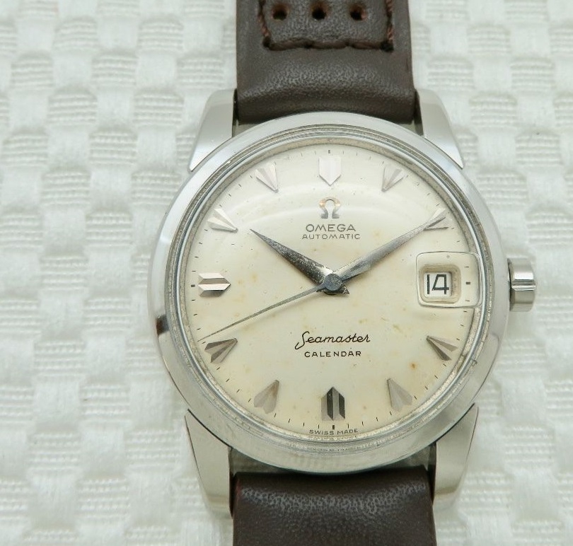

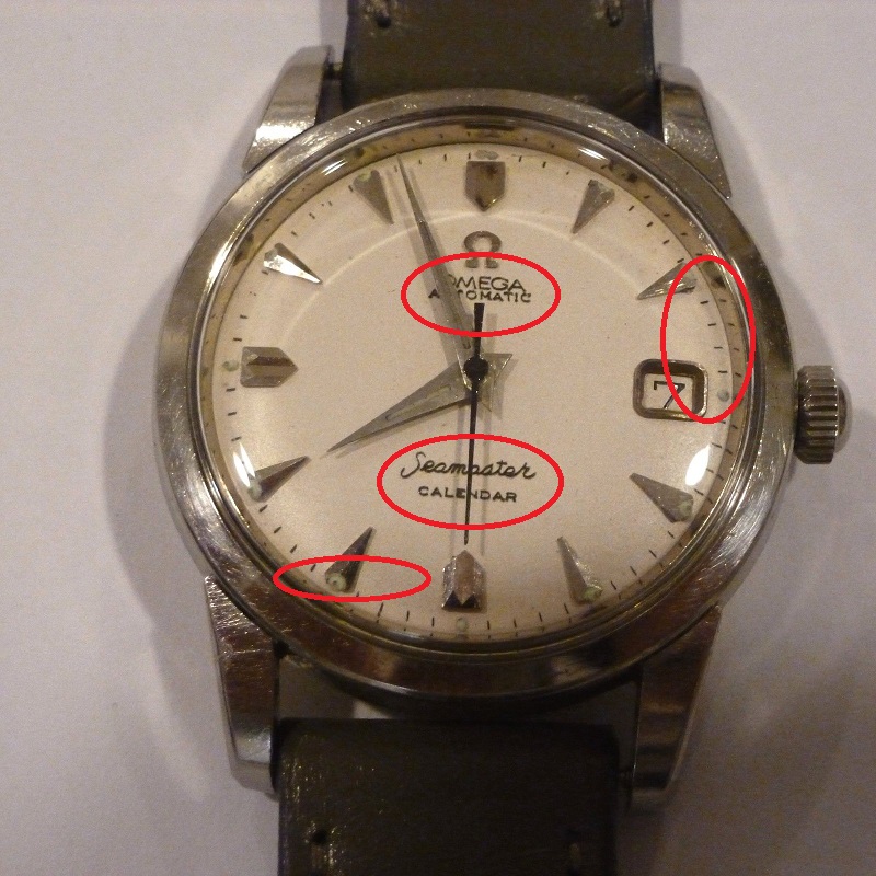

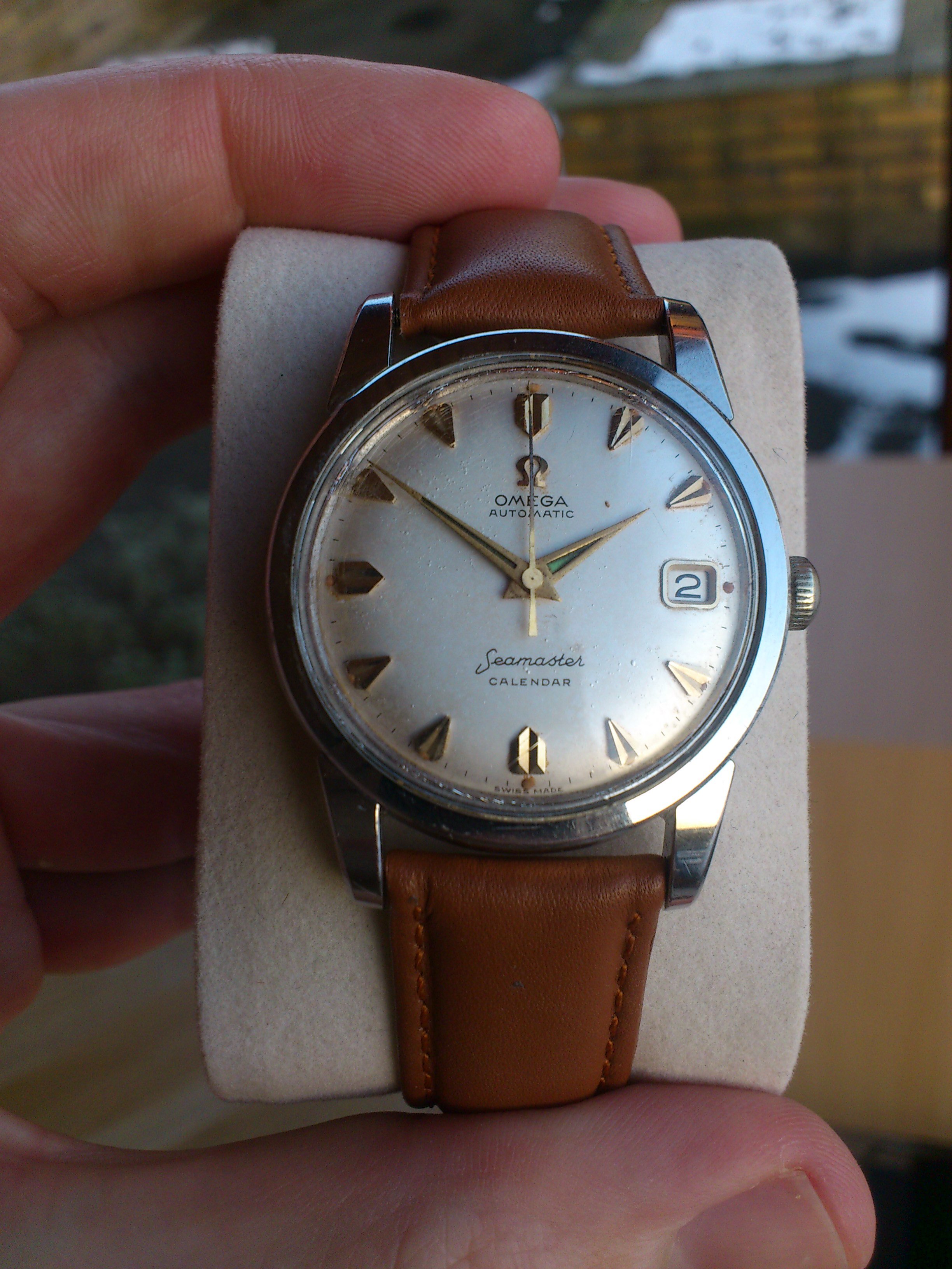

Here are two Omega Seamaster Calendars for your enjoyment:
Notice how fine the text on the first dial is and how it... isn't on the second one? That's because the second one is a cruddy redial. Knowing how the font looks like on the reference you are researching will help you quite a lot, especially on Seamasters. Where can you find this info? On Omegaforums, naturally. Do a search and spend some time smarting up. Other tells on the second example are the minute marks that are of varying thickness and length and the light green lume plots. The original radium lume would have been washed off when the dial was cleaned. A final - and really rather obvious - tip: If it's an old watch, there is little chance that the dial will look as virgin white as the lower one. The light, rather even spotting "suffered" by the top one is typical of this particular reference and a good sign of authenticity. Get to know how your targetted watch usually patinates and it will help you in your assesment.

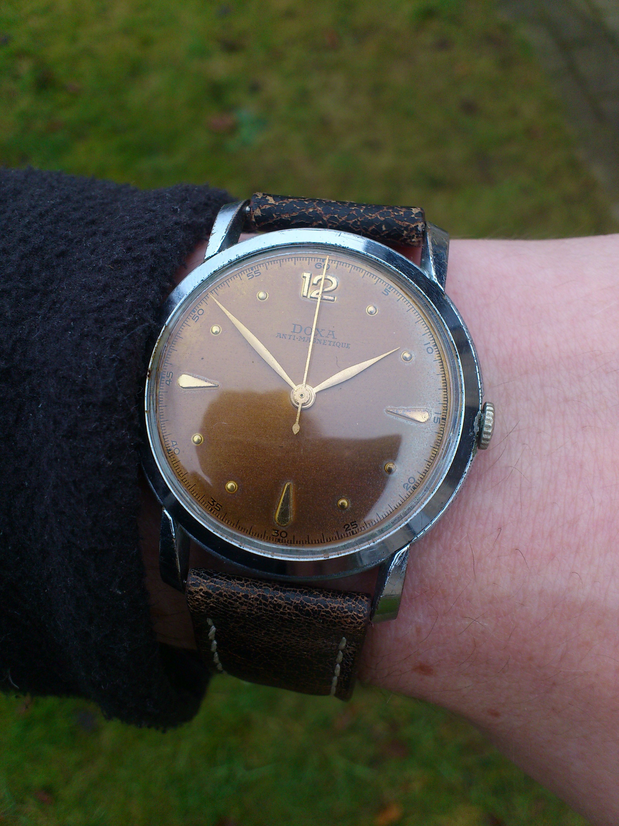

Patina should be even on a dial. No matter if it's light spotting or the orangey-brown film of tobacco smoke residue from a long period of exposure to that particular element, you do not want random blotches on the dial, but instead an even spread. If the dial damage in question is pronounced at 3 o’clock on the dial there’s a good chance that the cause of the damage is a leakage around the crown, letting in moisture to the case.
Two cases of heavy dial patina, probably from tobacco smoke exposure*. Note that the bottom one is next to a very similarly dialled Seamaster that's also patinated, in this case more light and mostly in the middle of the dial:
(yes, they both were the same light colour to begin with!)

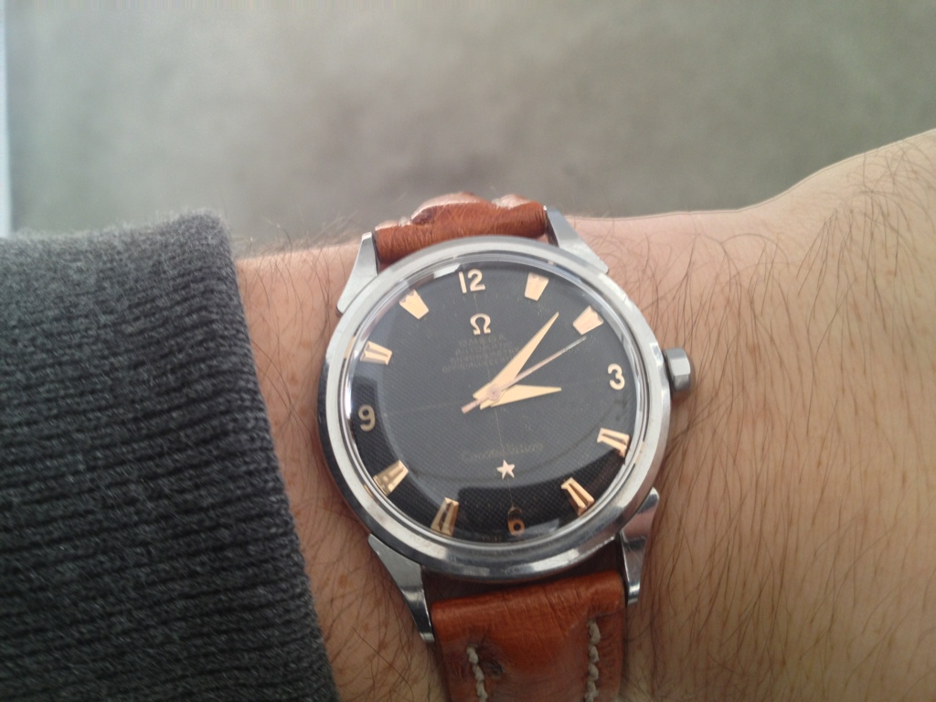

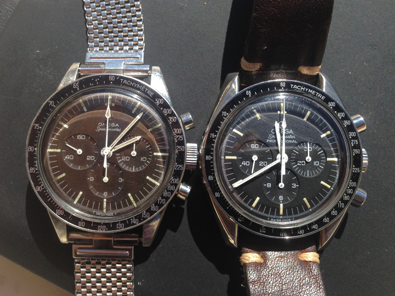

Black fading to grey:
Link
Link
In both cases the black colour is slowly losing its lustre and turning slightly grey. The text changes too and will, typically end up like the "Seamaster" text on the upper model and be hard to read.

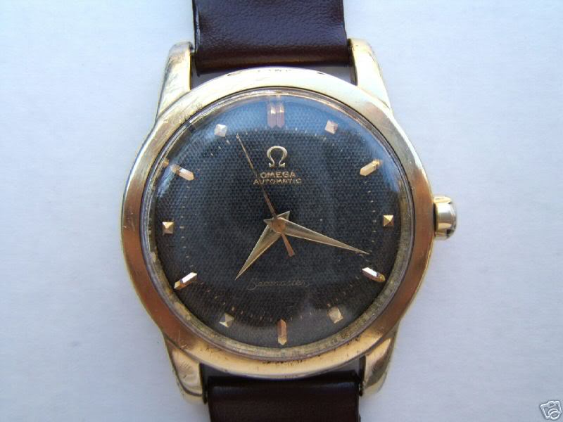

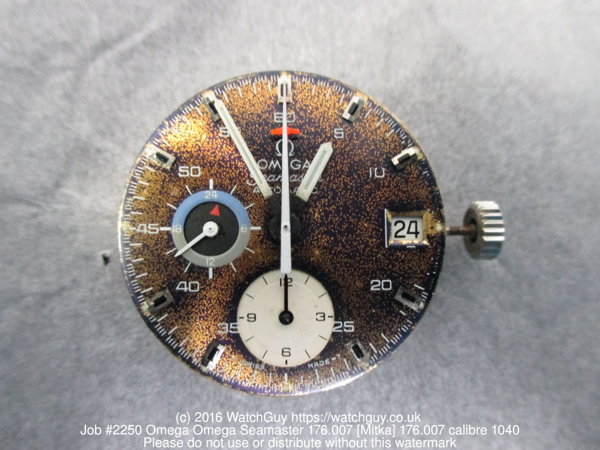

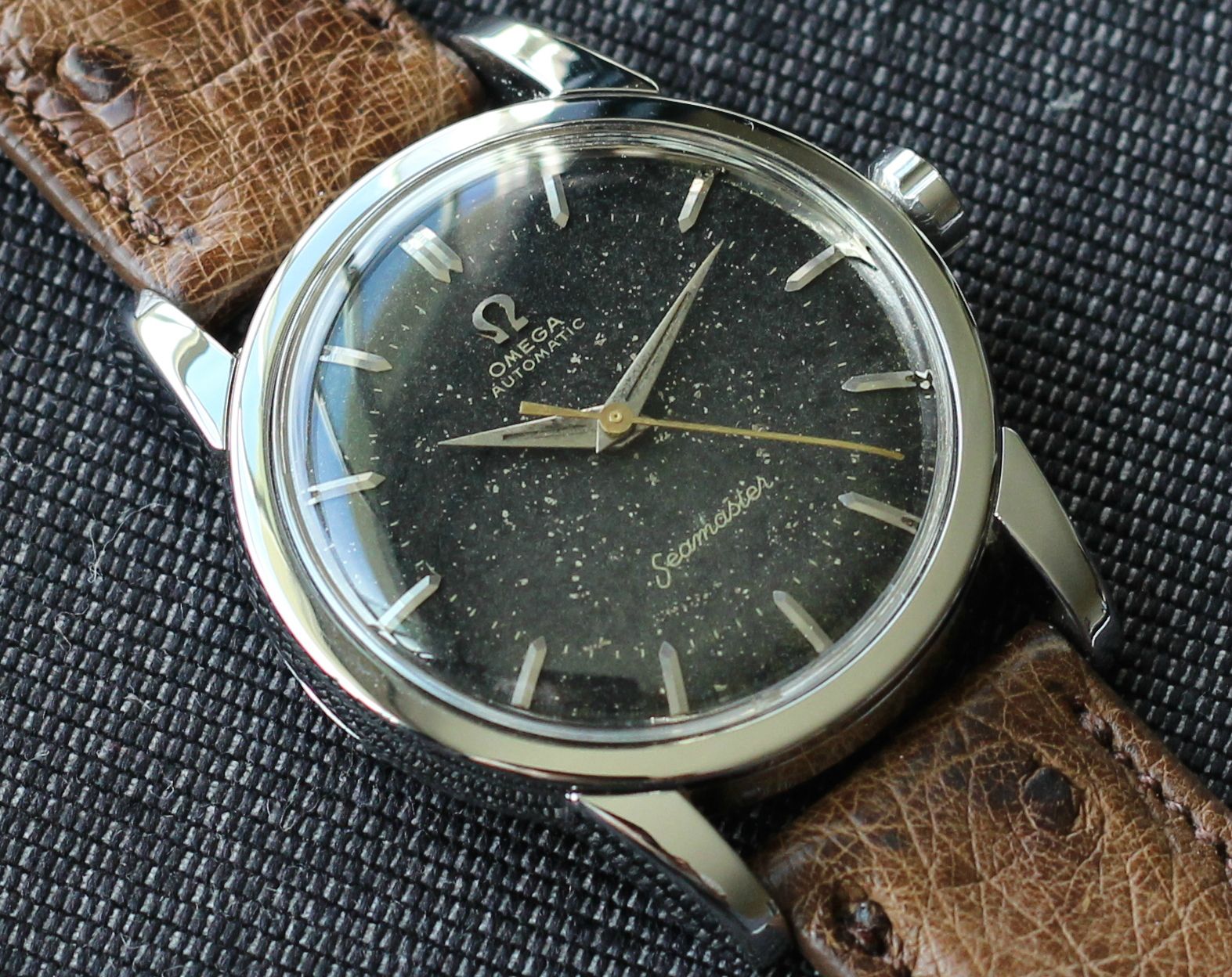

A pretty common variety of patina on a black dial is the "gold speck" dial, or the "starry night", where a number of golden stars dot the dial:
Link
This is due to the way the dial is produced: a layer of black paint is added to the brass dial, letting the brass appear where there is text. Eventually, the paint starts to flake and the brass peeks through. Simple.

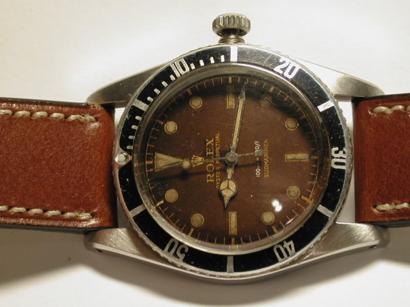

Probably the most widely liked type of patination of a dial are of the "chocolate" or "tropical" variety. It is my understanding that to begin with, the "tropic" moniker would only be used on a black dial turned lighter brown, but now I seem to see it all over the place. Oh well. As mentioned, patina is a subjective thing and you'll have to make up your own mind whether or not you like it, and if you like it enough to pay a premium over a ordinary specimen. Most brown dials are due to paint defects and the effect of UV and/or moisture ingress.
Link
Link

Both of the orangey-brown specimens in the post are my own and for the Seamaster at least, the layer is clearly a thin film. It has an oily sheen to it. I could well imagine that a clumsy finger could smear it out or that a tiny bit of soap and water would remove it completely.

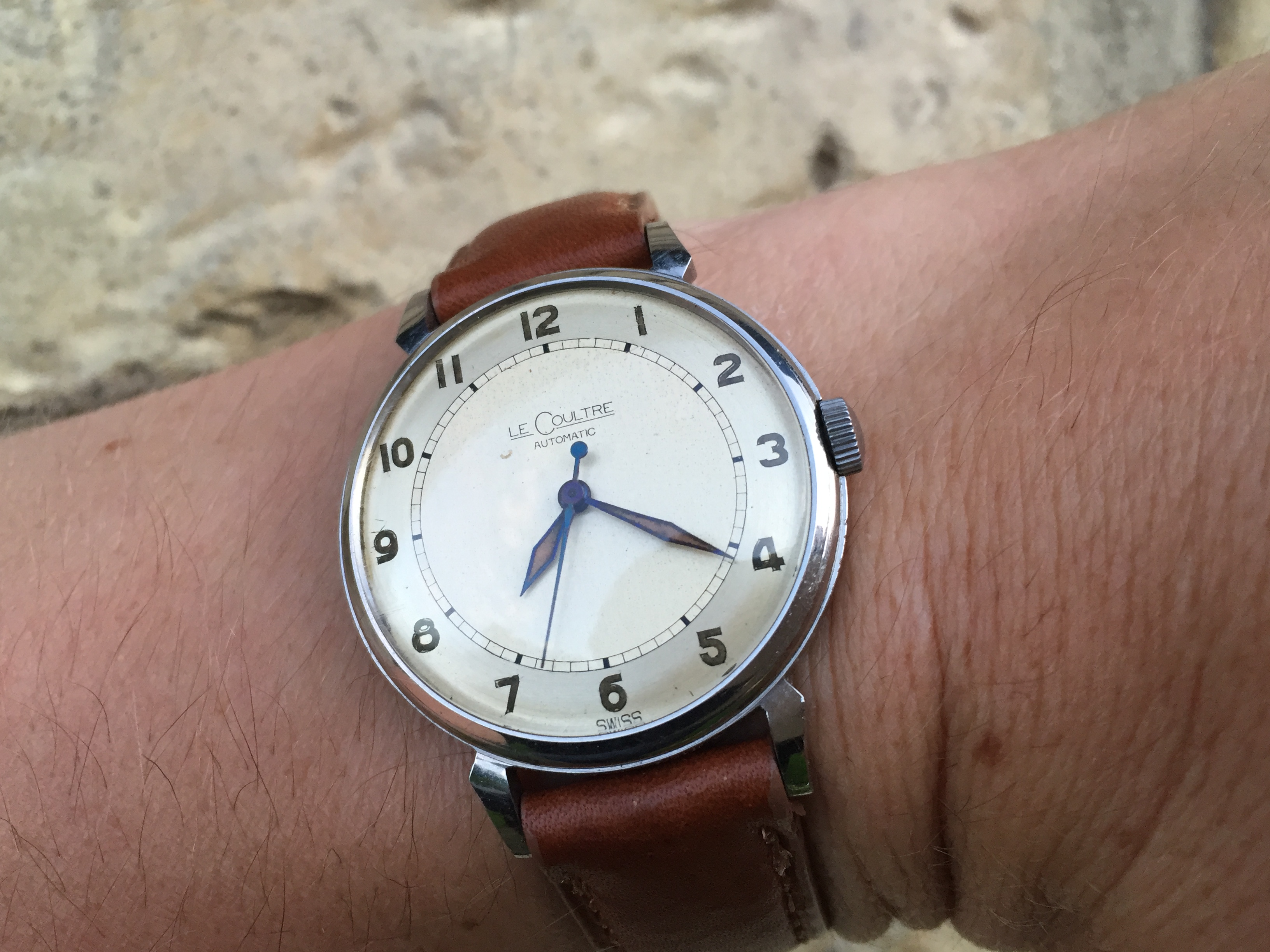

Mid-forties LeCoultre with radium in both hands and on arabic markers. Note how they have aged differently compared to the lovely Jaeger-LeCoultre in the beginning of the post!
