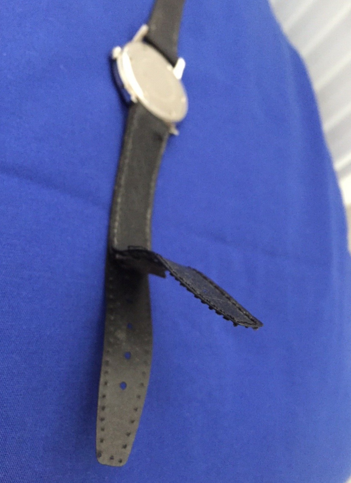

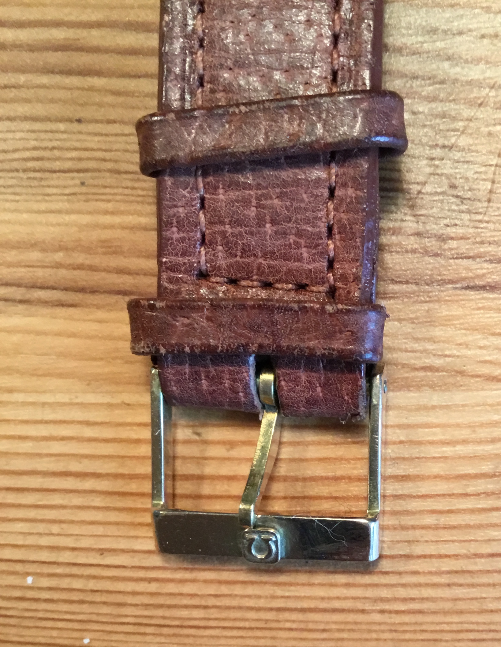

If you see a watch on eBay that might be what you’re looking for, and at a price within your budget, my practice is to spend a little bit of time looking at the strap, particularly if it’s leather (which is my preferred choice).
In my limited experience, the 'professional' eBay seller often puts on a new strap, and frequently adds a faux (Omega) buckle. This, I’ve assumed, is intended to entice the prospective purchaser to look to buy a ready to wear nice looking watch, with a nice strap and buckle and, possibly pay a little less attention to the watch face, case, movement and hands.
Apart from the fact that I like to choose my own strap, nearly all my 'finds', and I only venture into the sub-£400 market on eBay, have come with used (in some cases very worn) old straps.
In fact, the older and more disreputable the strap, I’ve surmised that it’s more likely that the watch hasn’t been the subject of the doubtful cosmetic practices that we read about and may well have been in someone’s sock drawer for the last twenty years.
In both the attached photos (attached to the seller’s particulars) the watches were significantly better than the straps.
