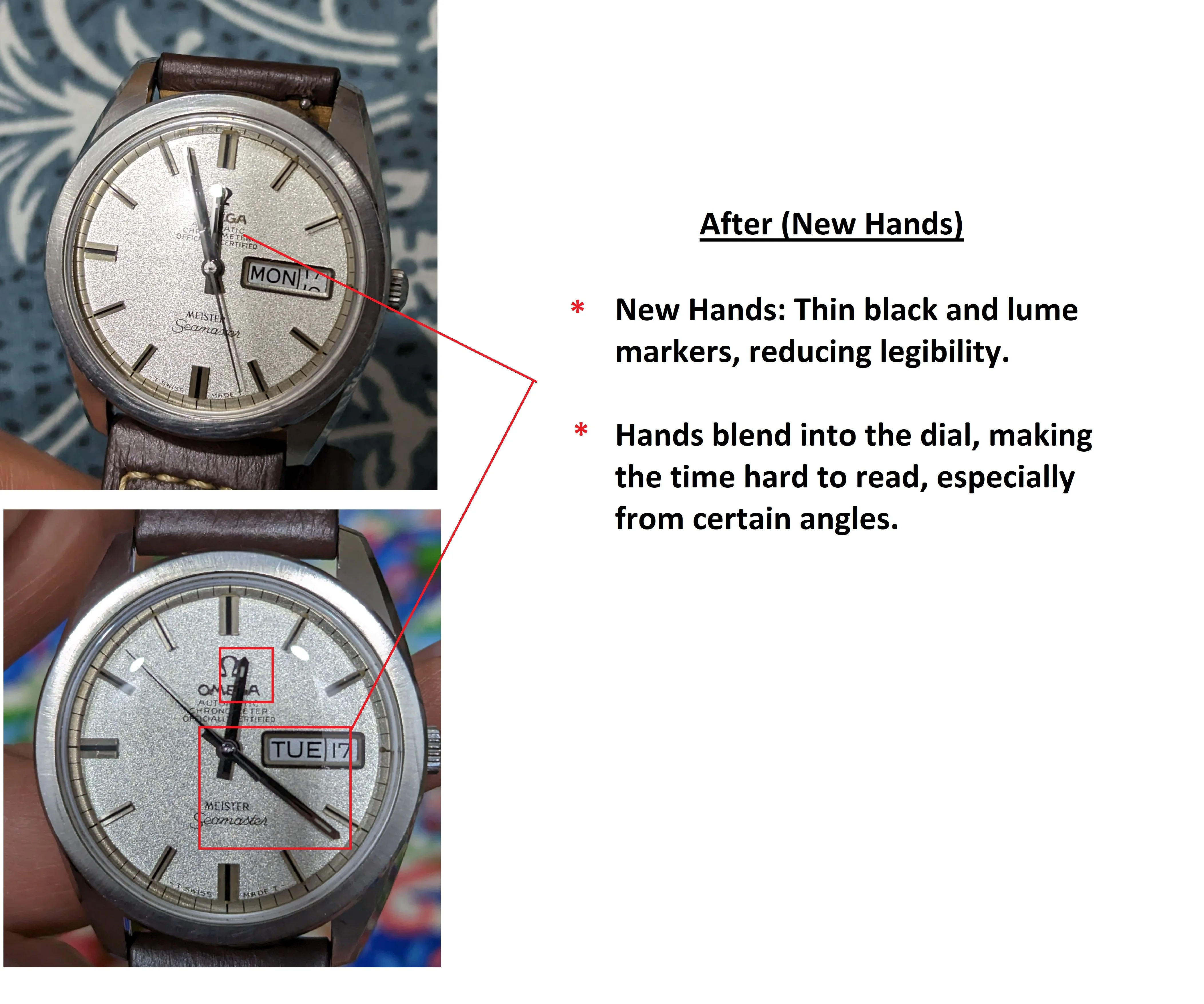

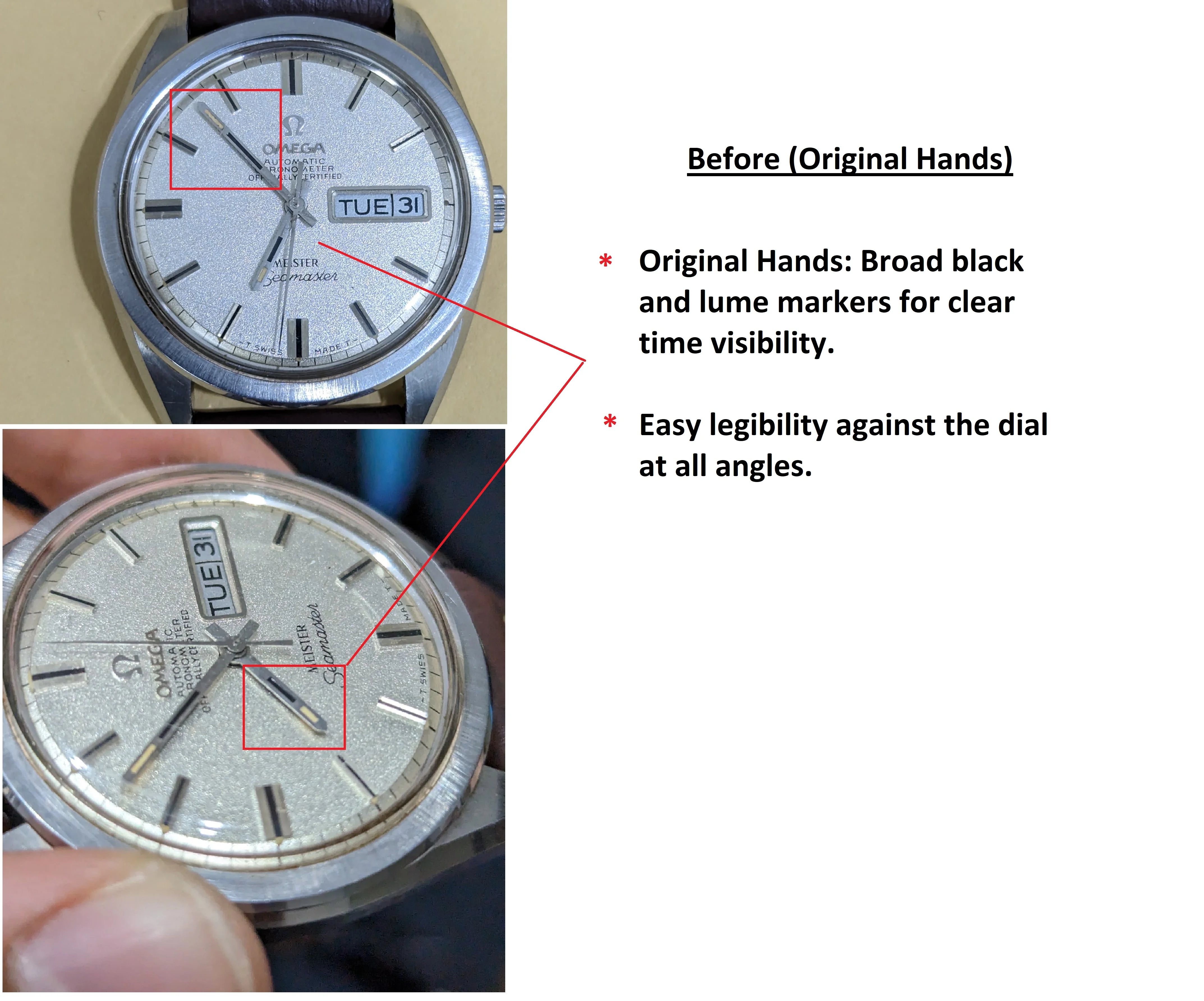

Hello everyone,

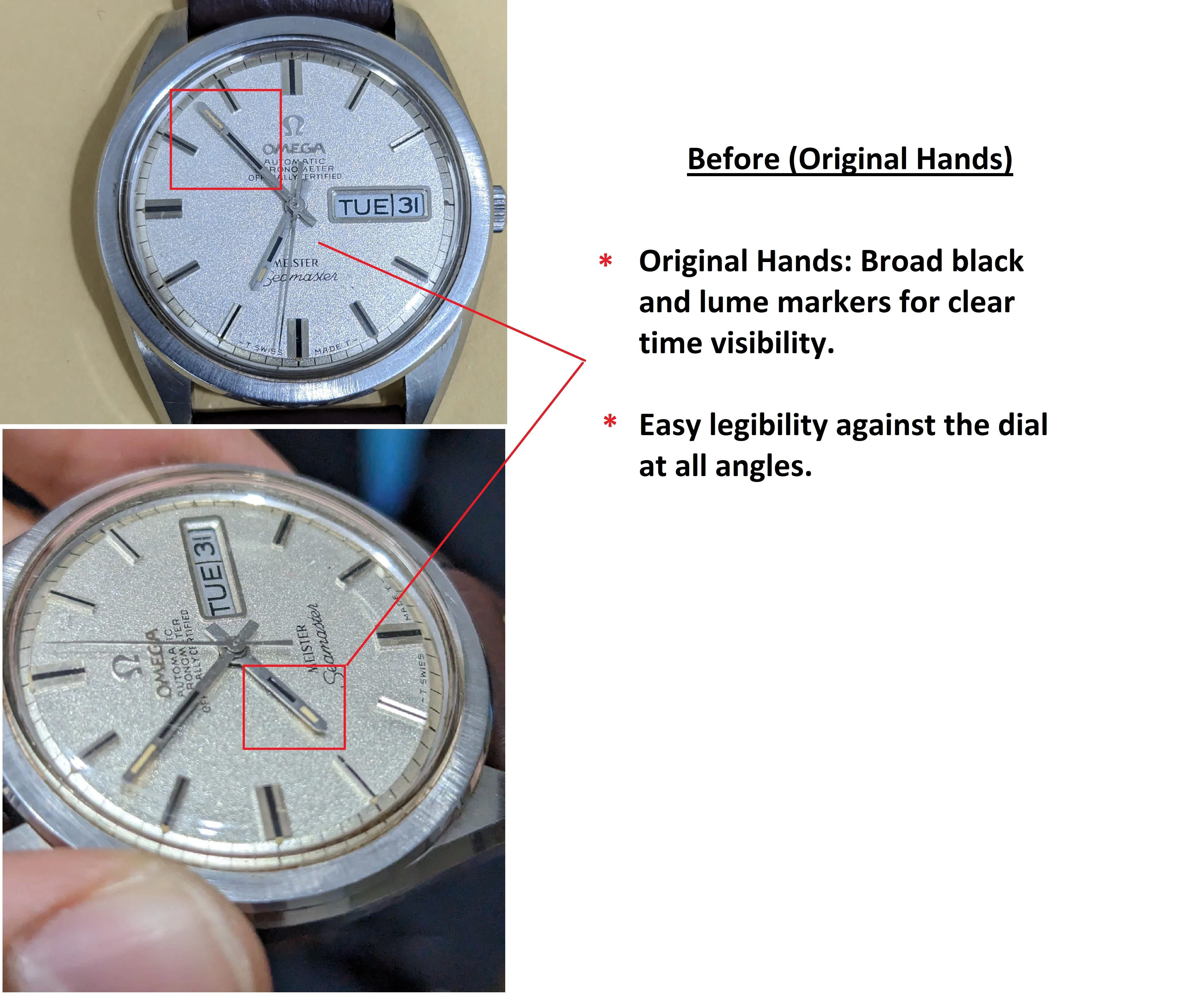

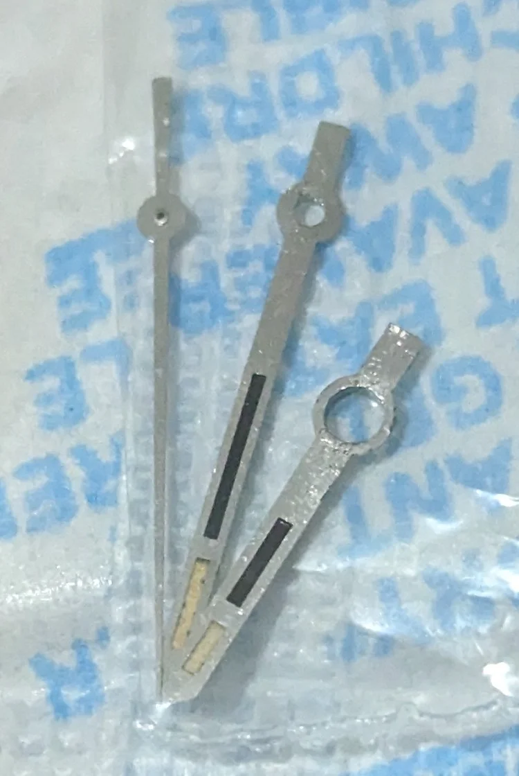

I recently got my grandfather's Seamaster 168.023 officially serviced from Omega.
Unfortunately they replaced the hands of the watch (attached pics). But have agreed to change back to the original as I have them with me.
Before I ask them to replace the hands - i thought it would not be a bad idea to clean them a bit, and possibly stabilize the lume, especially because I suspect the Omega service in India might not do the latter at all while cleaning and replacing the hands.
Here service tools are not common, so I'll have to import them.
My question is -
1. Looking at the watch hands (attached), do you think stabilization is required
2. If yes, what should I use - i was thinking the lacquer in a bergeon lume kit. Can this be used directly or does it need to be thinned?
3. Should I attempt to clean the hands (and how)? I was thinking to get leather buff stick and pith wood as suggested in this video -
Thank you for answering a noob. This watch holds a lot of sentimental value, and i don't want to message it up

IMO The original hands look fine as is, I think you can only damage them if you start scraping them without experience.
I would simply have the old hands re installed by watchmaker and enjoy the watch.

The only sensible options are to leave the service hands in situ, reinstall the original hands as is or have a watchmaker improve and reinstall the original hands.
If you attempt to them yourself then send to Omega for reinstallation, there is likely a high likelihood you’ll damage them. The lume can be very fragile and these hands will probably be plated rather than solid stainless. If you try and remove the oxidation you may well take the top layer off.

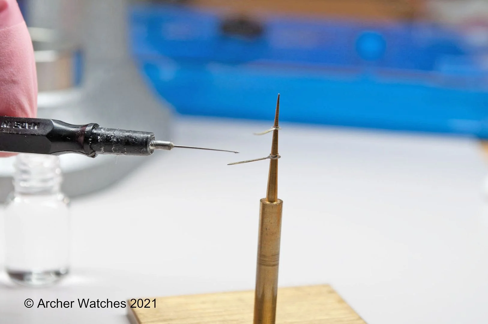

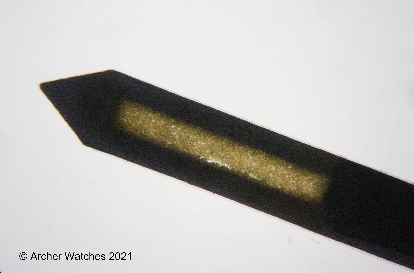

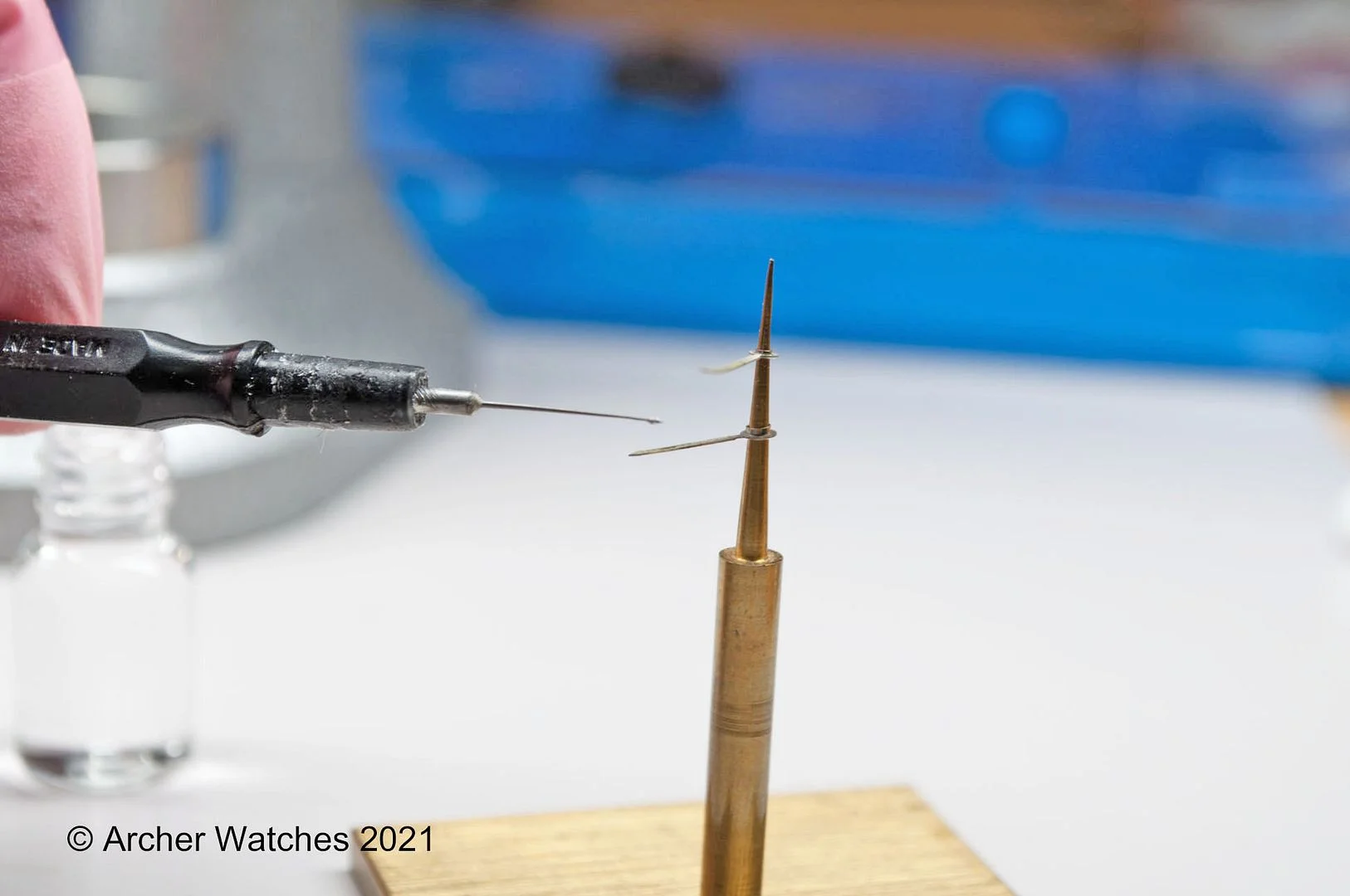

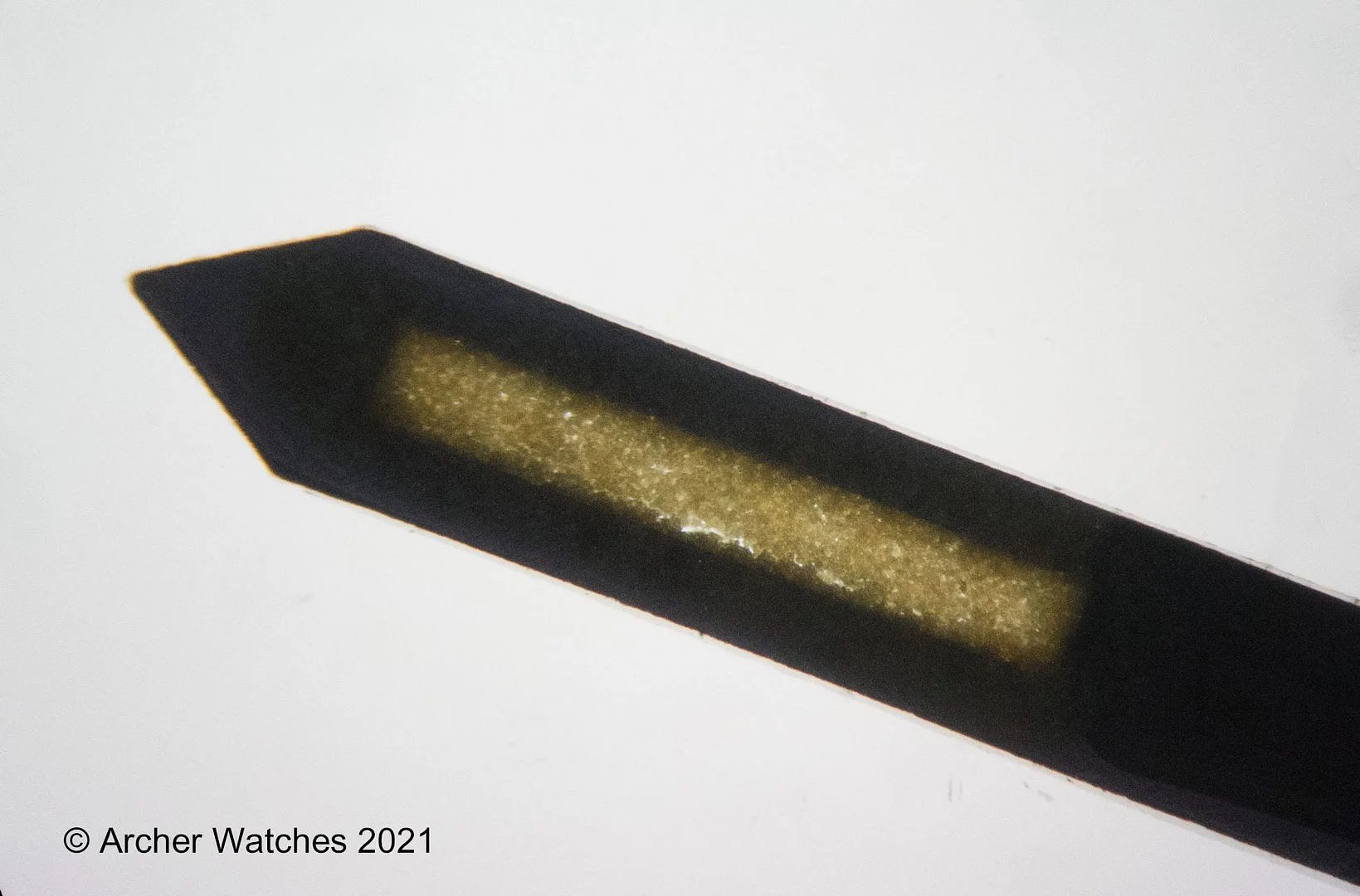

To determine if the lume needs to be stabilized, I put the hand under the microscope and light them from underneath. Sometimes that is the only way you will see small holes or cracks…
To stabilize the lume, simply apply clear binder to the underside of the lume, and let it dry before installing the hands.
