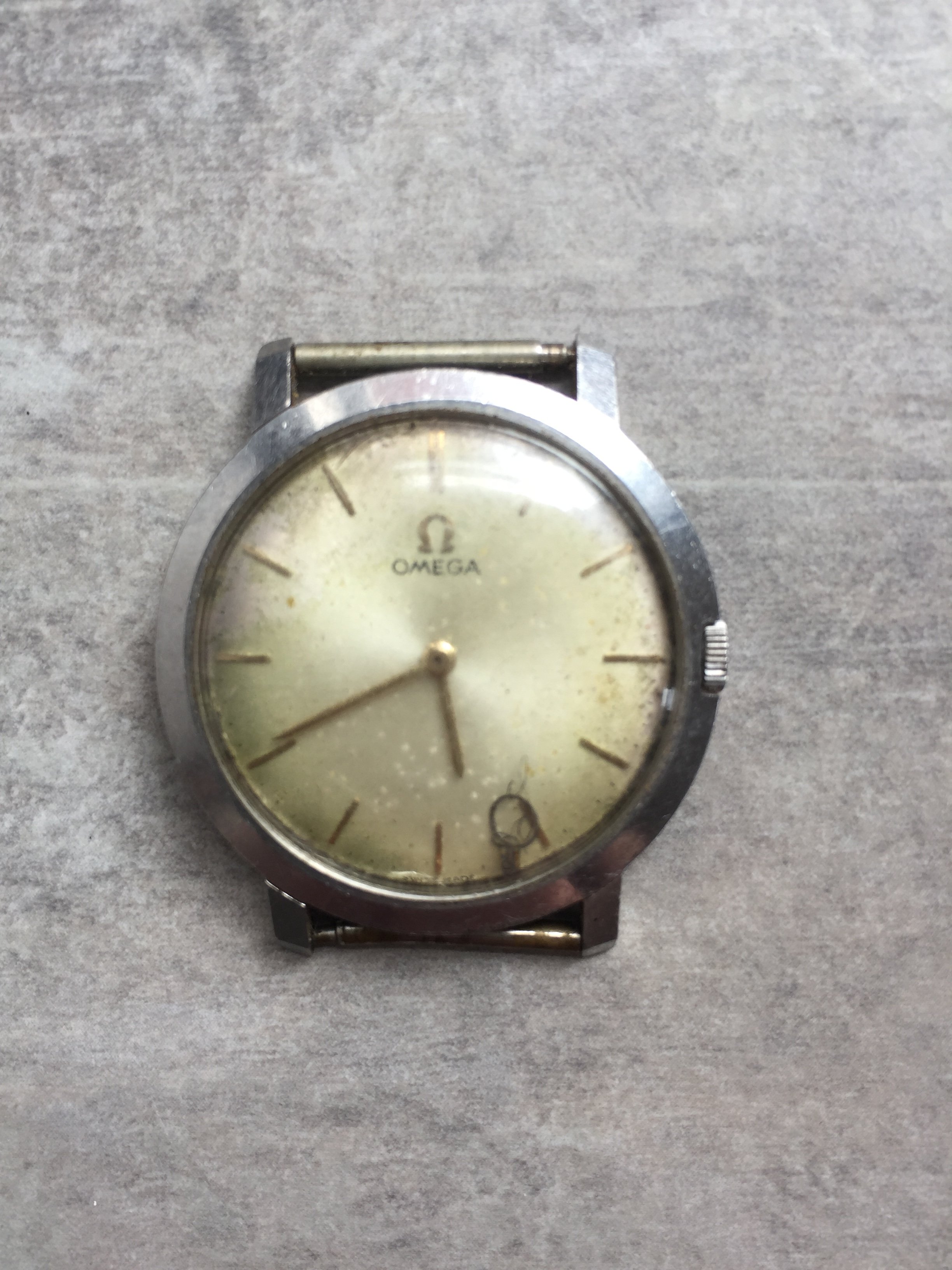

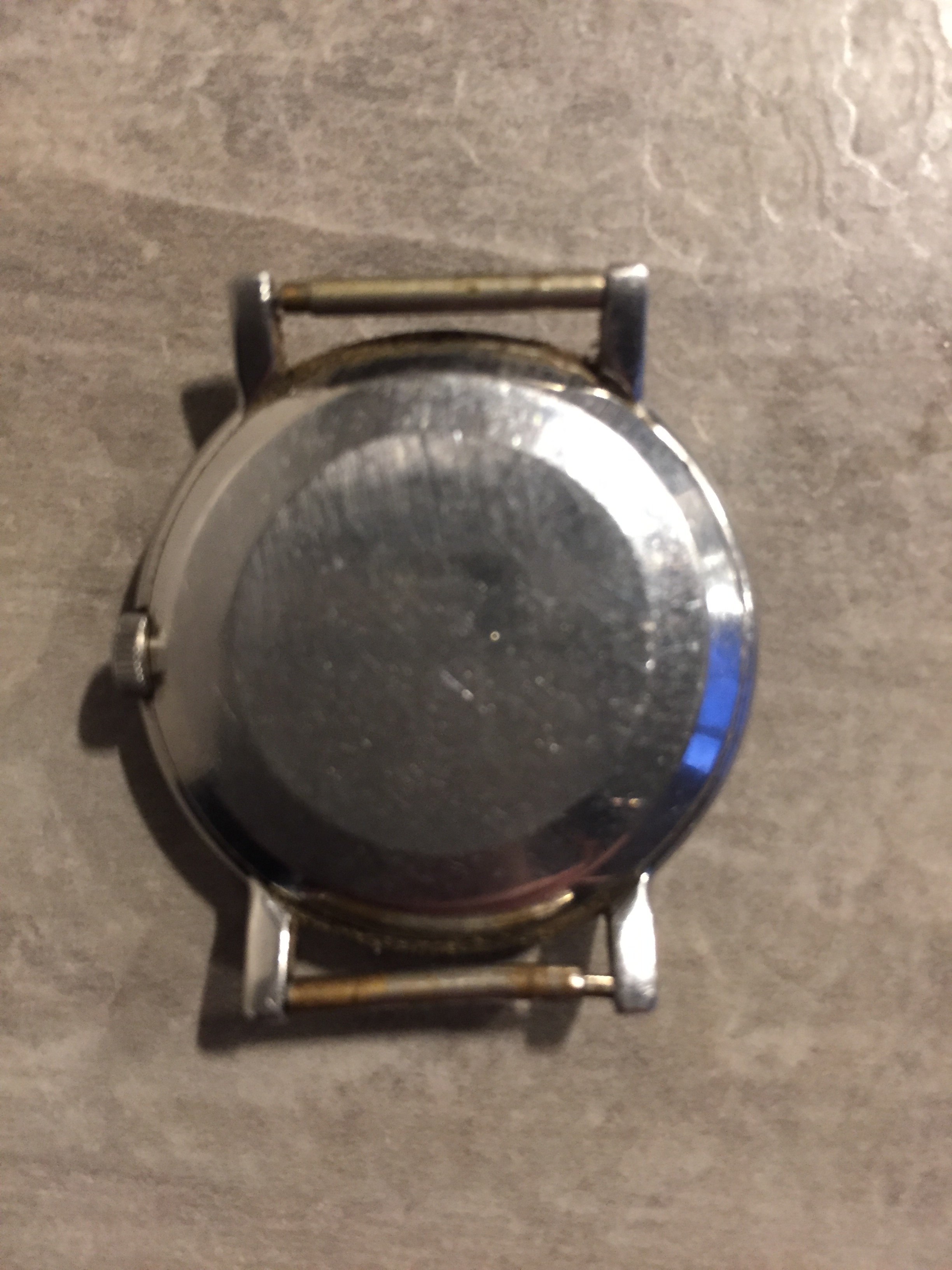

Hi guys, new to the forum and would like an opinion on this, just found this rather old looking Omega watch.
Welcome to the forum.
I think that you need to start a new thread - go into forums, click on 'Vintage Omega watches …..’, choose the wording of a new heading, and post photos and questions.

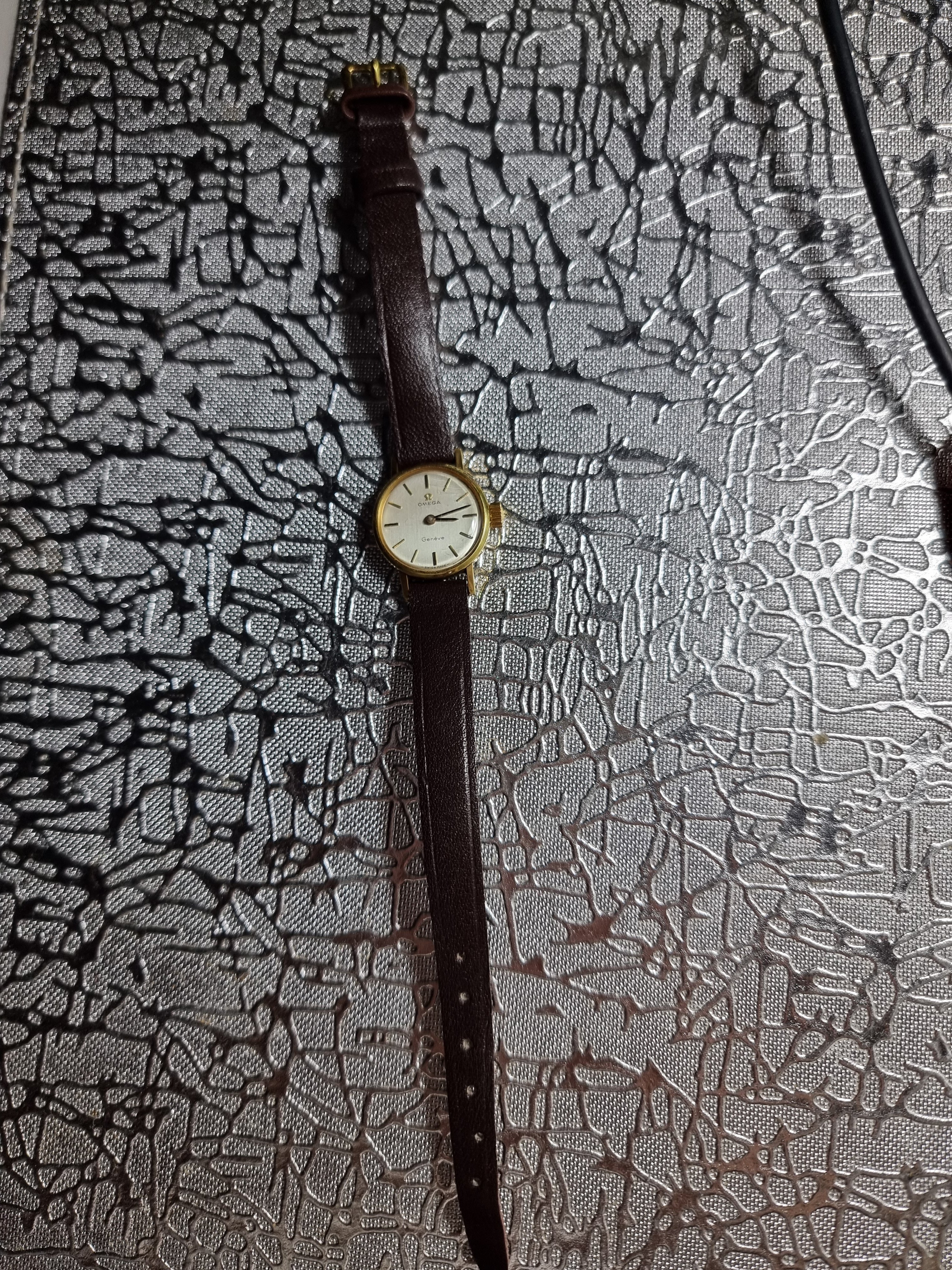

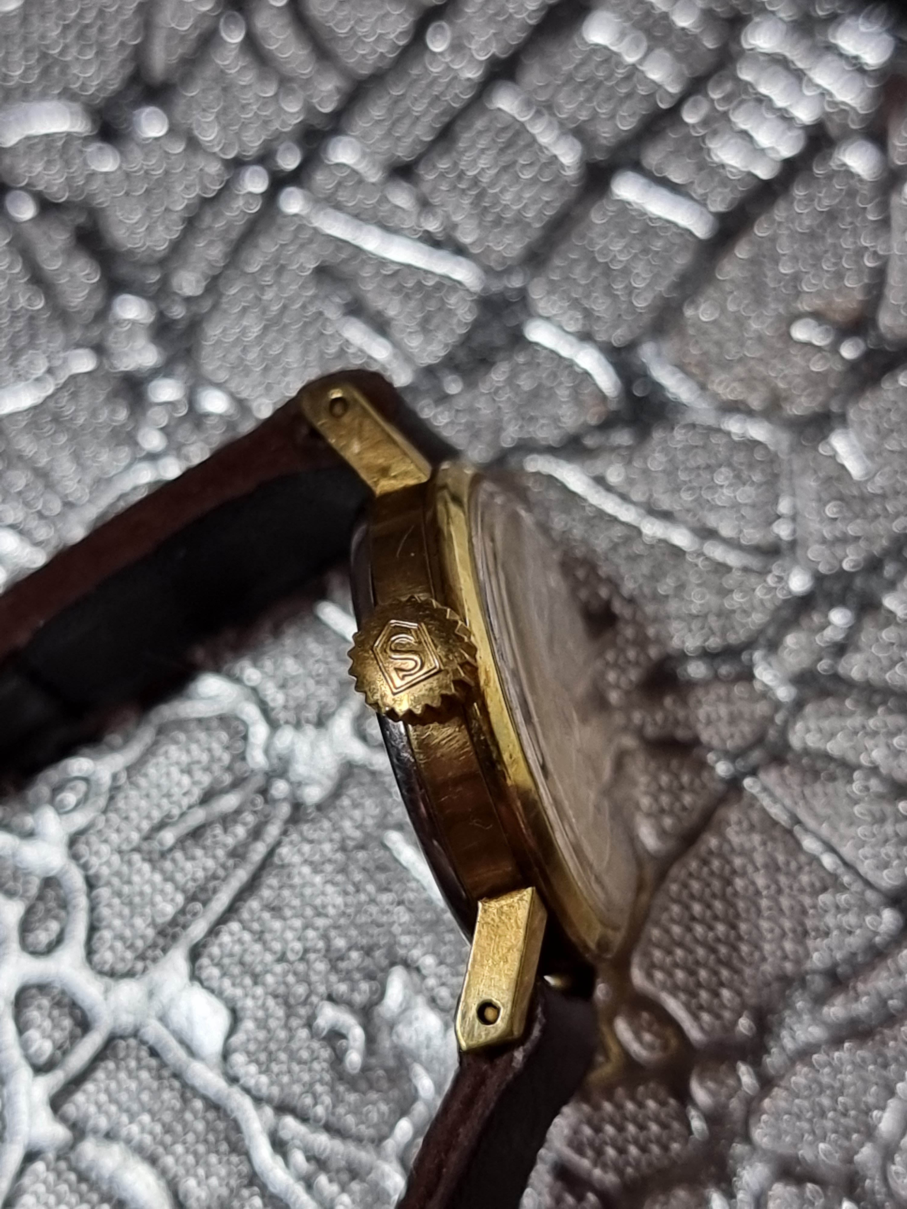

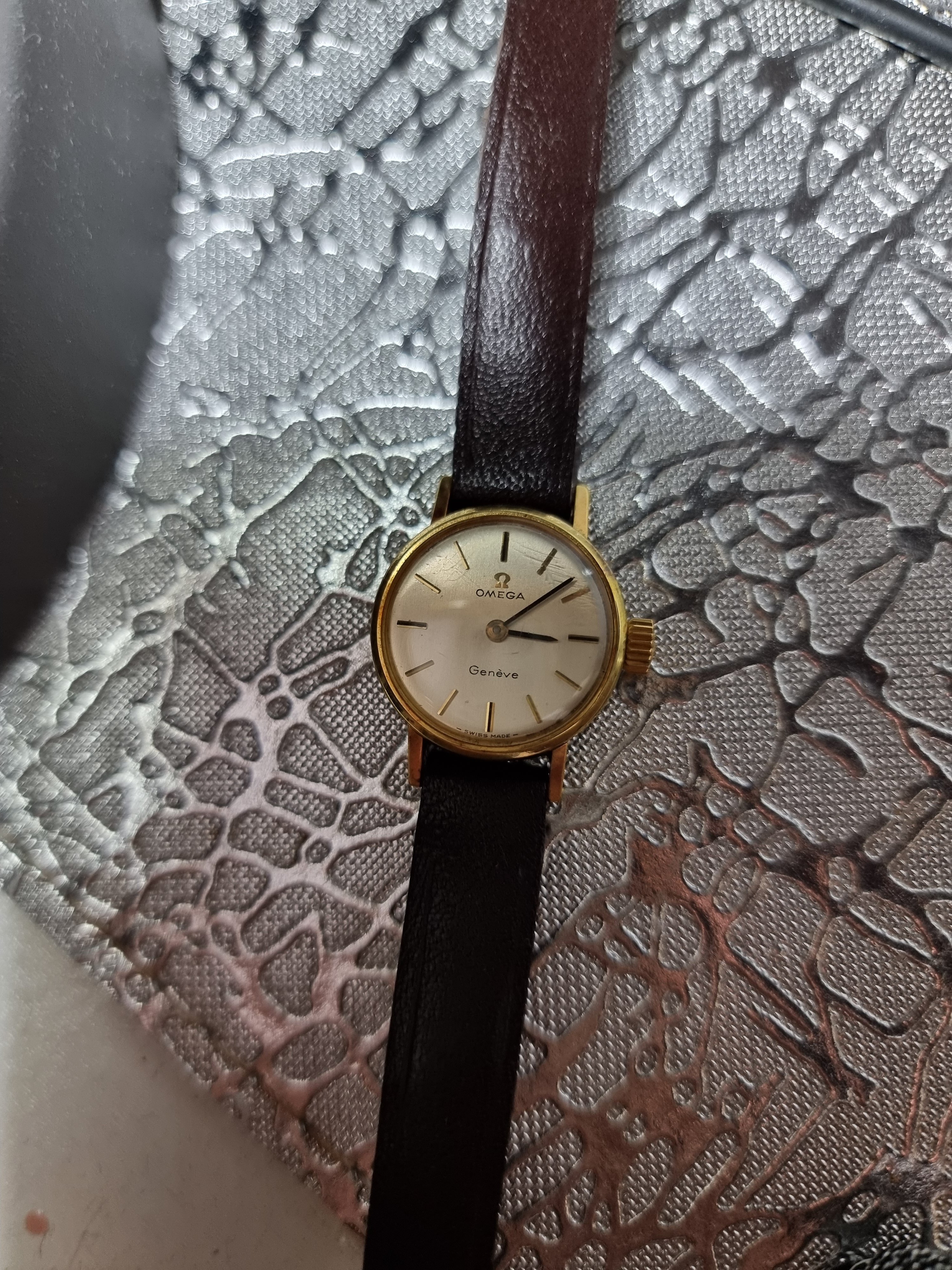

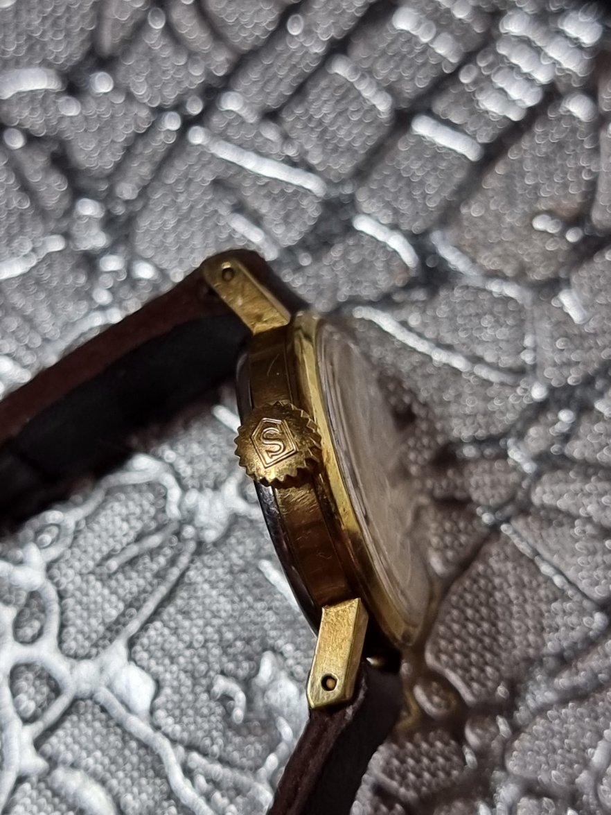

what omega watch is this and why does it have this s on the screw
