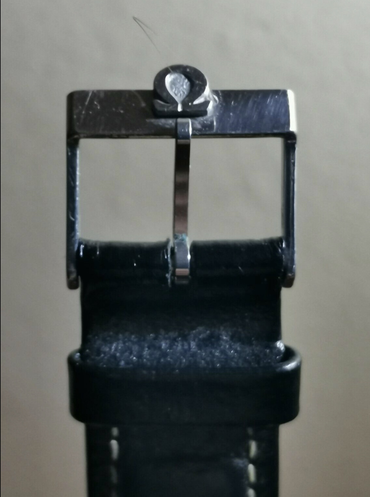

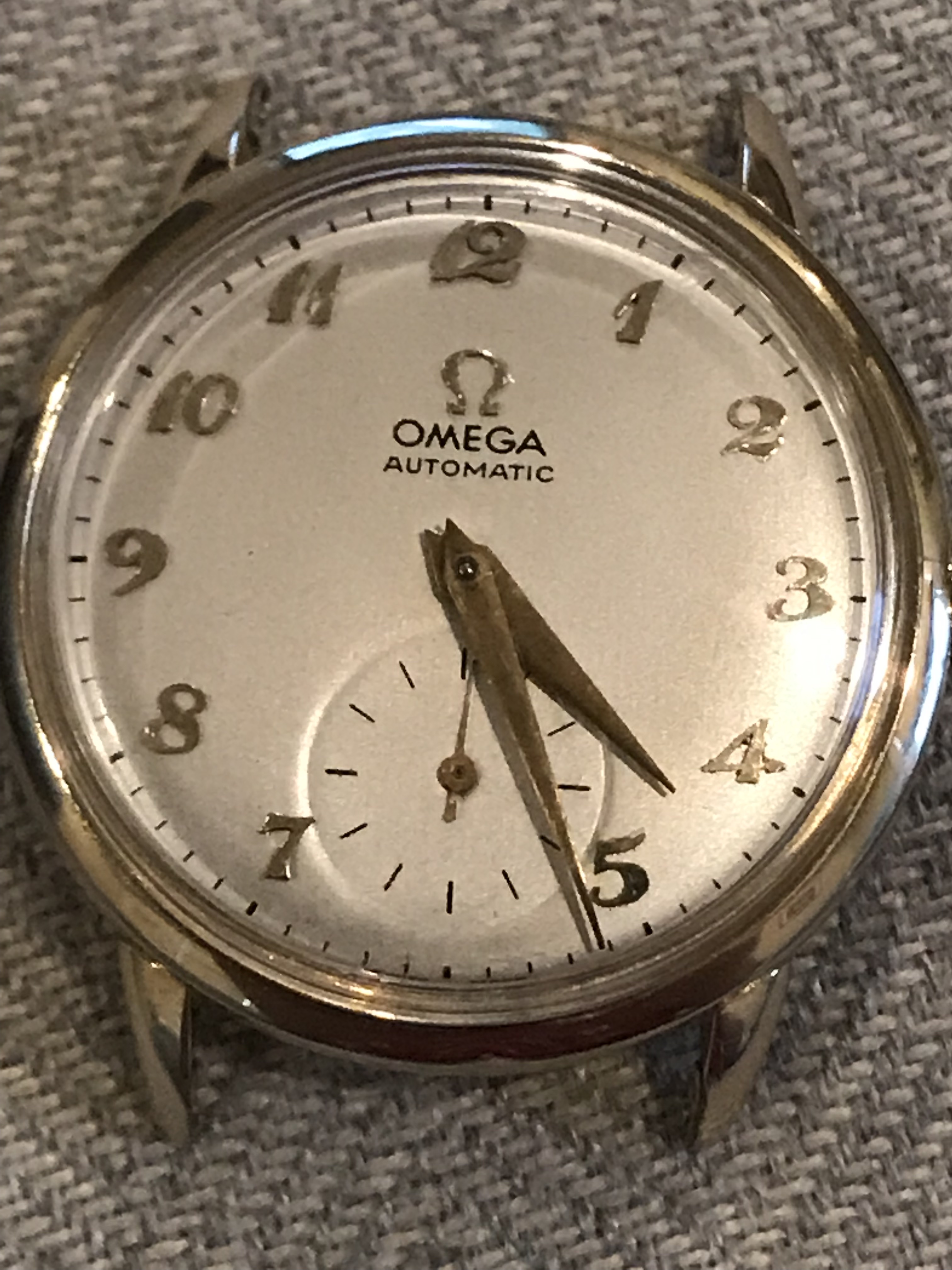

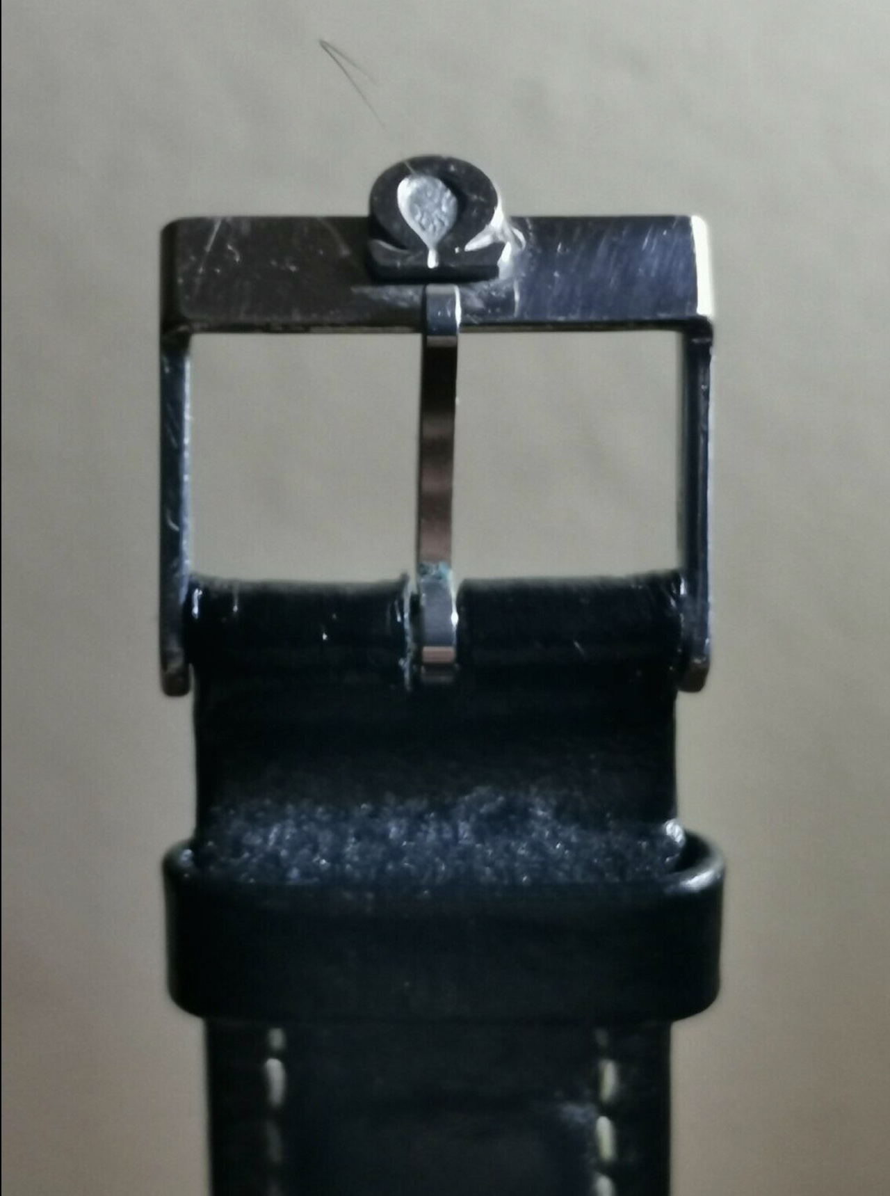

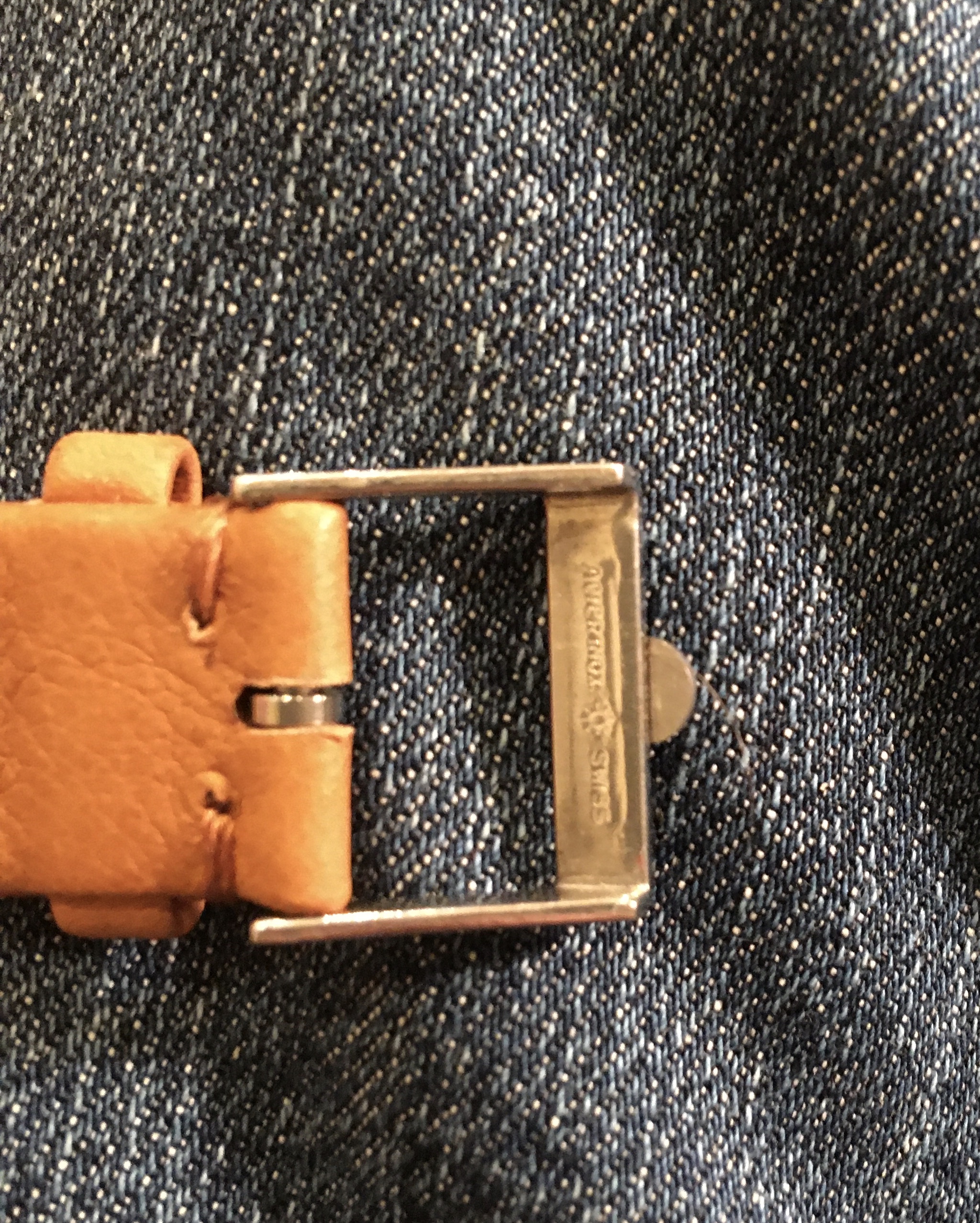

I’ve posted about straps previously. Recently I saw this stainless steel/gold indices and hands Seamaster 165.003 as a BIN or offer on eBay. I like this version but wasn’t entirely sure it was genuine. I posted the seller’s poor photos on OF seeking reassurance, which I didn’t get.
So, entirely down to me. Two things persuaded me to take a chance. First, the seller also lives in the UK and offered a 14 day return. Second, one of the photos showed the face of what I hoped was an original strap buckle.
So, I made an offer and was right about both the watch and the buckle but, if I hadn’t been, I could have returned it.
Hope this helps.

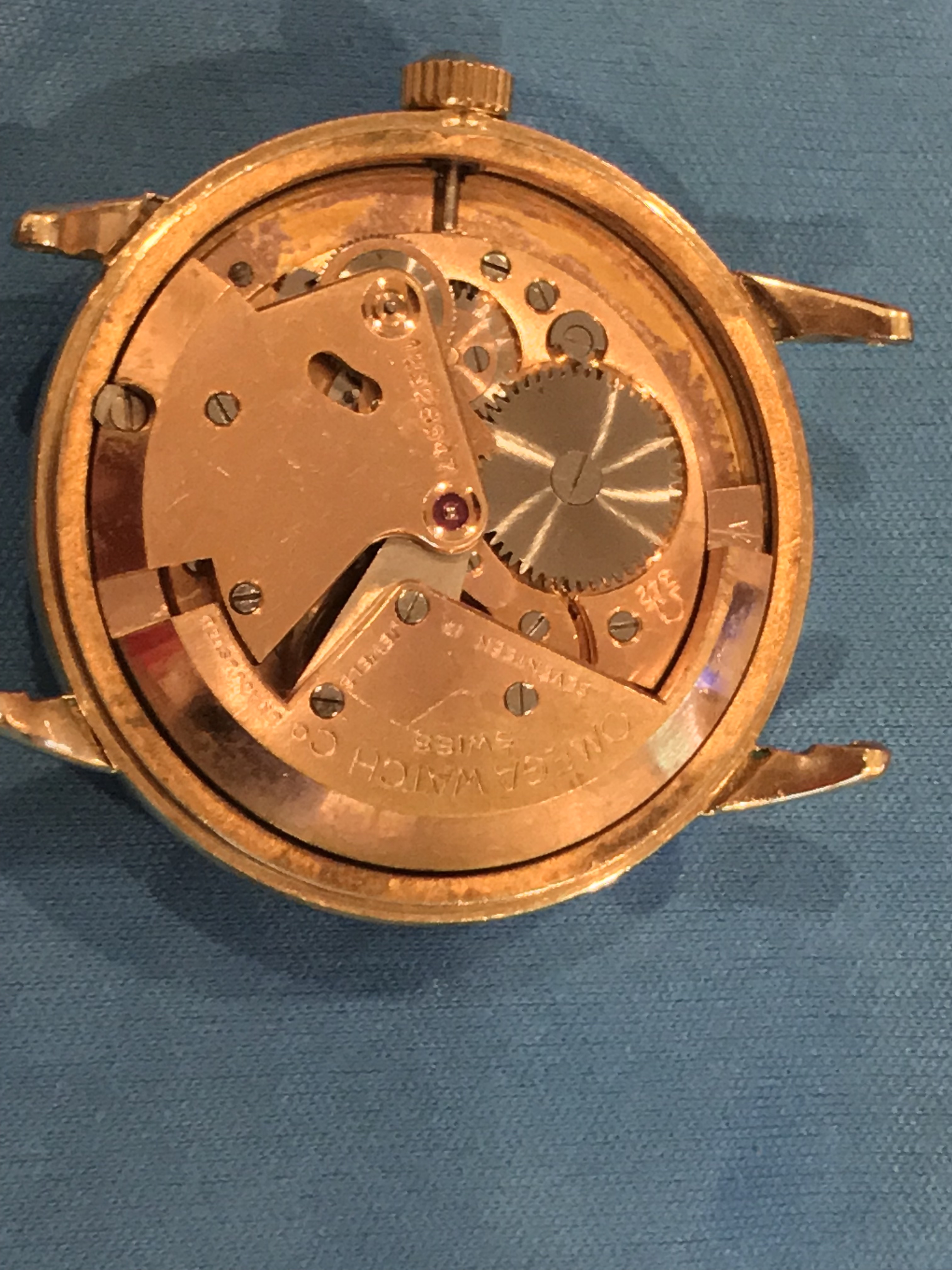

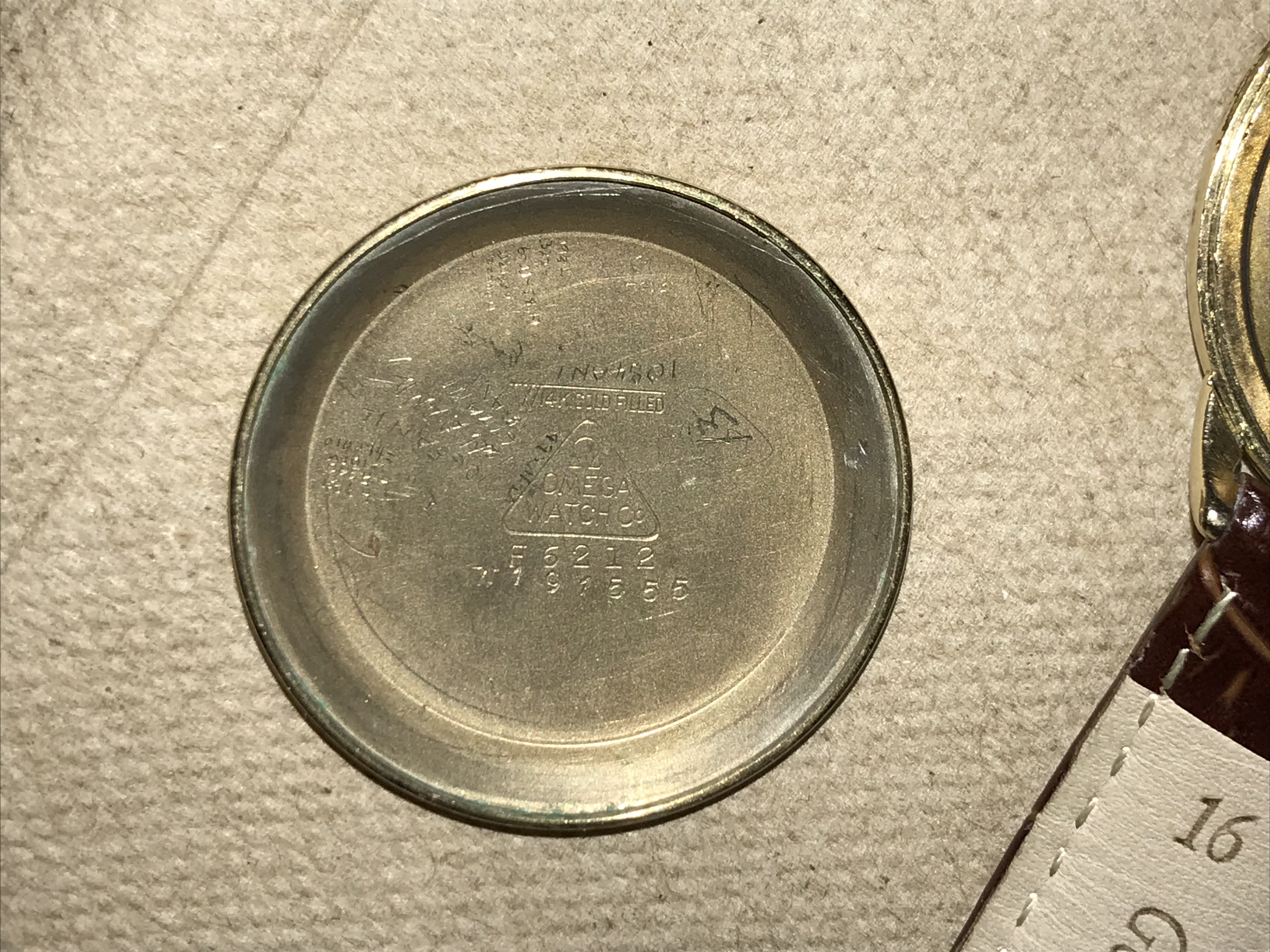

i wish i had read this before buying my first vintage omega (cal 342 bumper gold capped dress watch) which turned out to have a redial as far as I can tell now and is a American imported watch from the 50's which as I understand now were imported as movements to be cased by American made cases for tariff reasons? This is still kind of unclear to me.
In any case, thank you so very much for sharing your expertise.

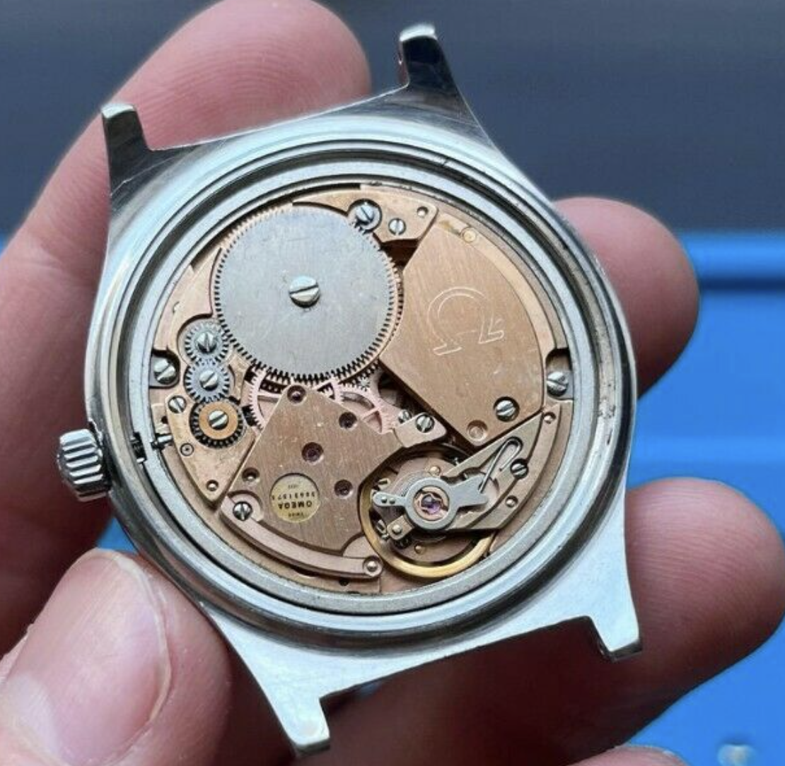

https://www.the-saleroom.com/en-gb/...0167/lot-a6fbab3d-ee51-4202-92fa-ae070112bf29
Not sure if i should be posting this here, but it looks like something you'd not even want in your Christmas cracker. The dial, the hands, the movement all make me want to cringe. 9a73ae2f-29a0-4edd-aa6f-ae070112bfe9.jpg

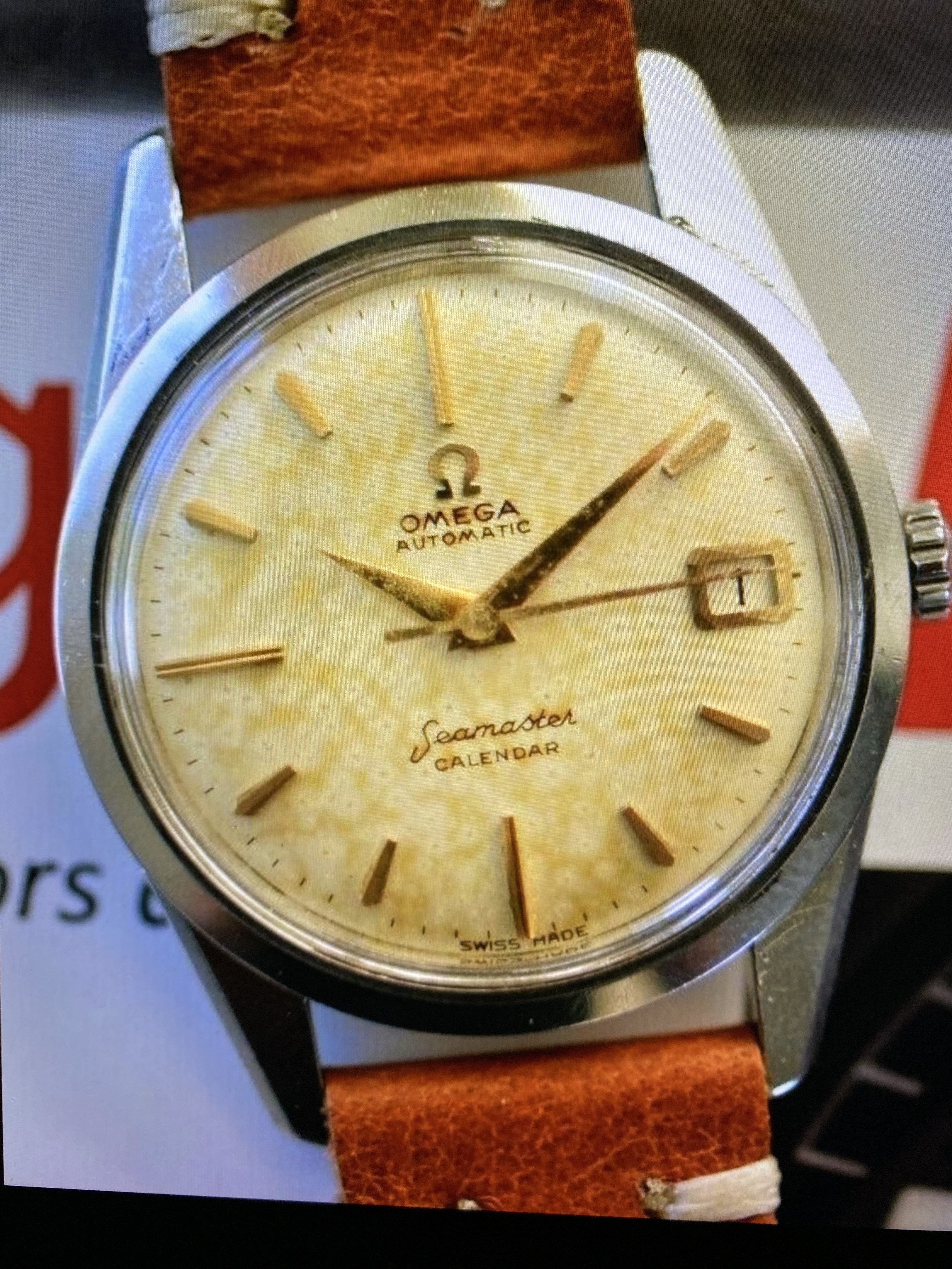

2.1. You may love patina, but for a lot of people it is still damage/decay so unless it's a special case, a patinated dial will lower the value of a given watch. As this subject is very, eh, subjective and a case of what one finds attractive take these points as mere guidelines.
Patina should be even on a dial. No matter if it's light spotting or the orangey-brown film of tobacco smoke residue from a long period of exposure to that particular element, you do not want random blotches on the dial, but instead an even spread. If the dial damage in question is pronounced at 3 o’clock on the dial there’s a good chance that the cause of the damage is a leakage around the crown, letting in moisture to the case.
Two cases of heavy dial patina, probably from tobacco smoke exposure*. Note that the bottom one is next to a very similarly dialled Seamaster that's also patinated, in this case more light and mostly in the middle of the dial:
(yes, they both were the same light colour to begin with!)
As "patina" could just as well be called "damage", this raises another issue - how about the movement? If you find a heavily patinated watch to your liking, you must inspect the movement. Chances are that whatever caused the damage on the dial side has affected the movement too. Funnily enough, the word “patina” is rarely used on damage below deck...

*EDIT: I have now, some time after writing this post, come to the conclusion that correlating this particular type of dial aging with tobacco smoke ingress is probably false. It seems to be more likely to be a manufacturing defect in the lacquer, seeing that it often occurs in the same references and isn't spread evenly across several different refs.
