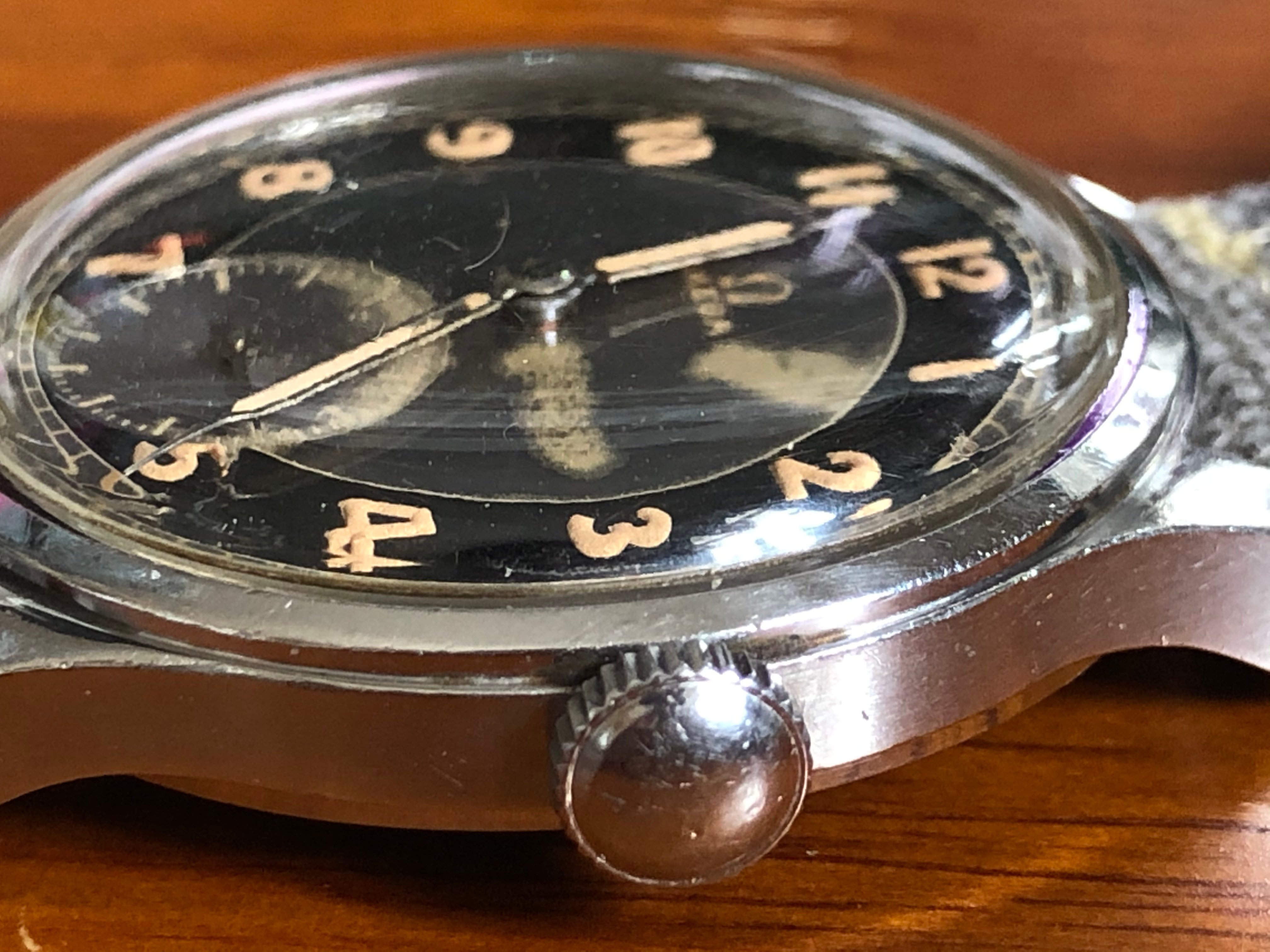

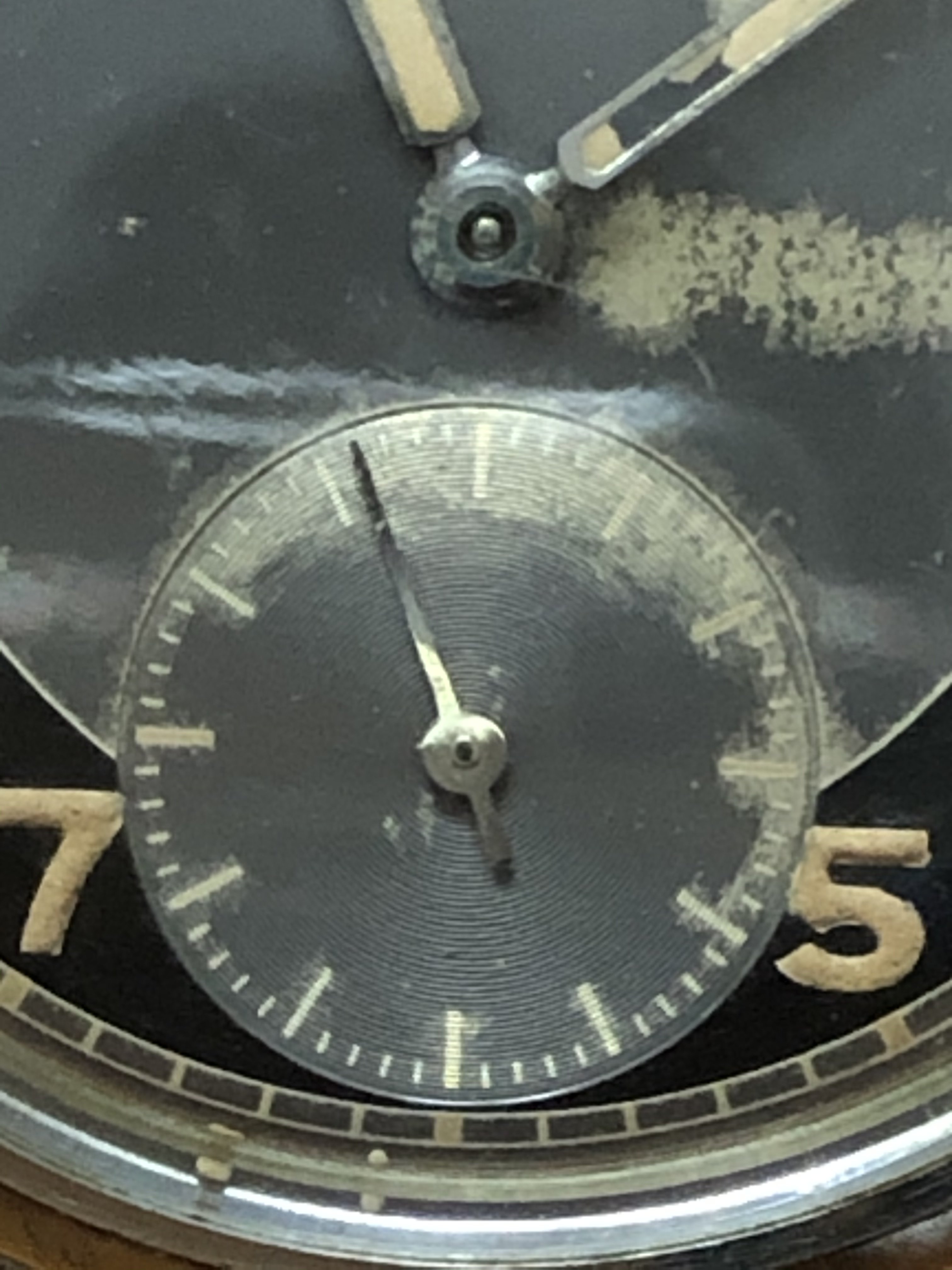

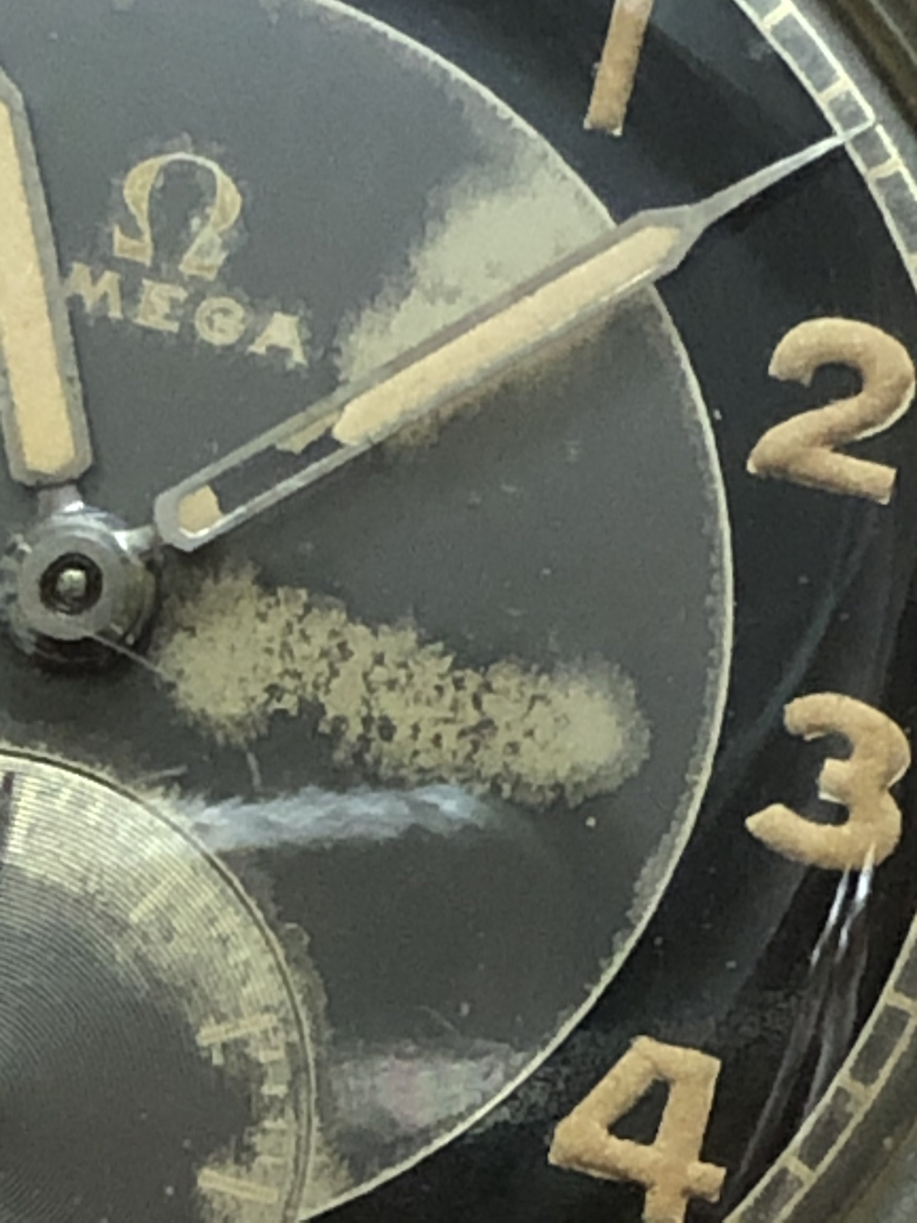

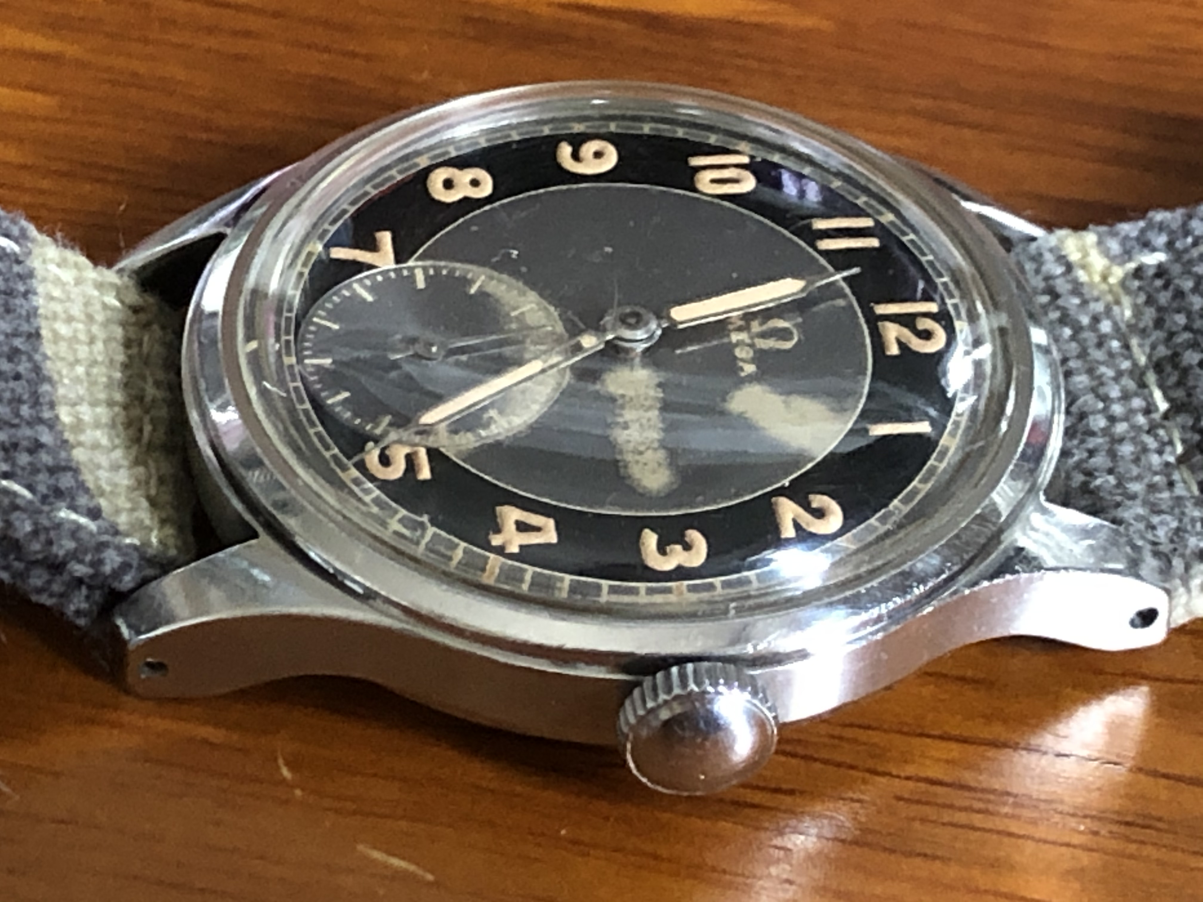

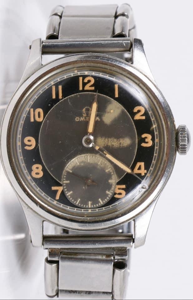

Is this dial burned by radium on the minute and hour hands when left inactive for a long time at 3 o'clock 7 minutes?
Maybe. Need to see a couple of other angles. But yeah, more likely than not.
Thanks, what angle do you need to see? I will try to clearly zoom it...
30 degrees up from the plane of the dial.

Well, considering none of these are "30 degrees up from the plane of the dial"....
How to shoot 30 degrees?I do not understand? Can you guide me? thanks

Hm, hard to say. Really hard to say. The lume in the hands and the numbers do not match. That stuff on the dial looks like it came off of the hands, not that it was caused by burning. It also appears the same stuff got picked up by the second hand and smeared across the top of the sunken seconds track.
I don't know where you are (can you share?) but it seems to me that a relume expert might be able to get the gunk off the dial and then relume your hands in the same color as the numbers.
Let's see what the others say.
But I am reasonably sure that's not radium burn.
This I won the auction in a Swedish village.The seller says it's been in the drawer for a long time and that the dial seems to have faded with time. Anyway I thank you very much for sharing my knowledge👍. Thank very much
