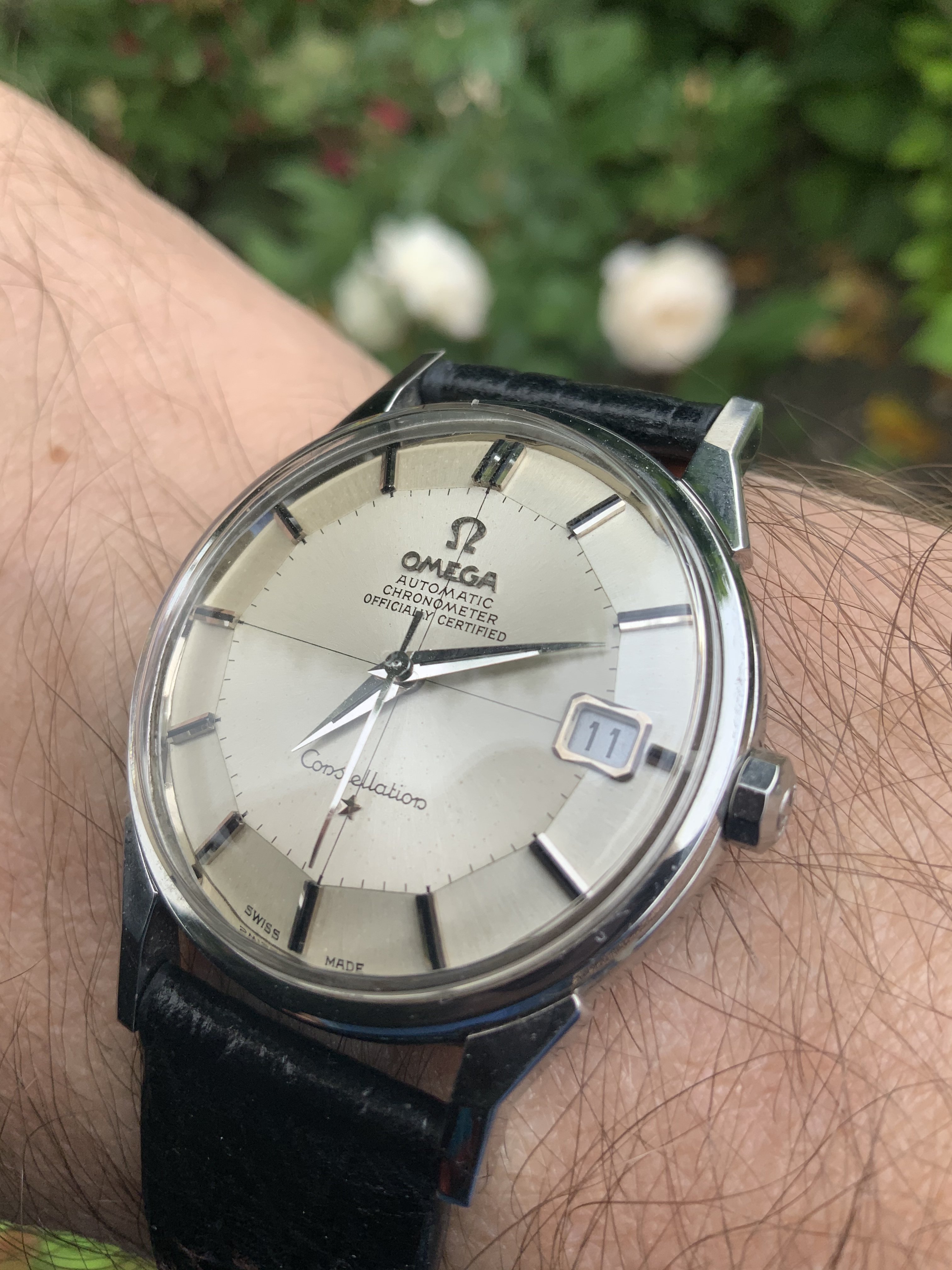

B o R for my constellation?
496
677
Any help appreciated Is there a ref for the bracelet and links I would need for an appropriate match?
Is B o R correct for this?

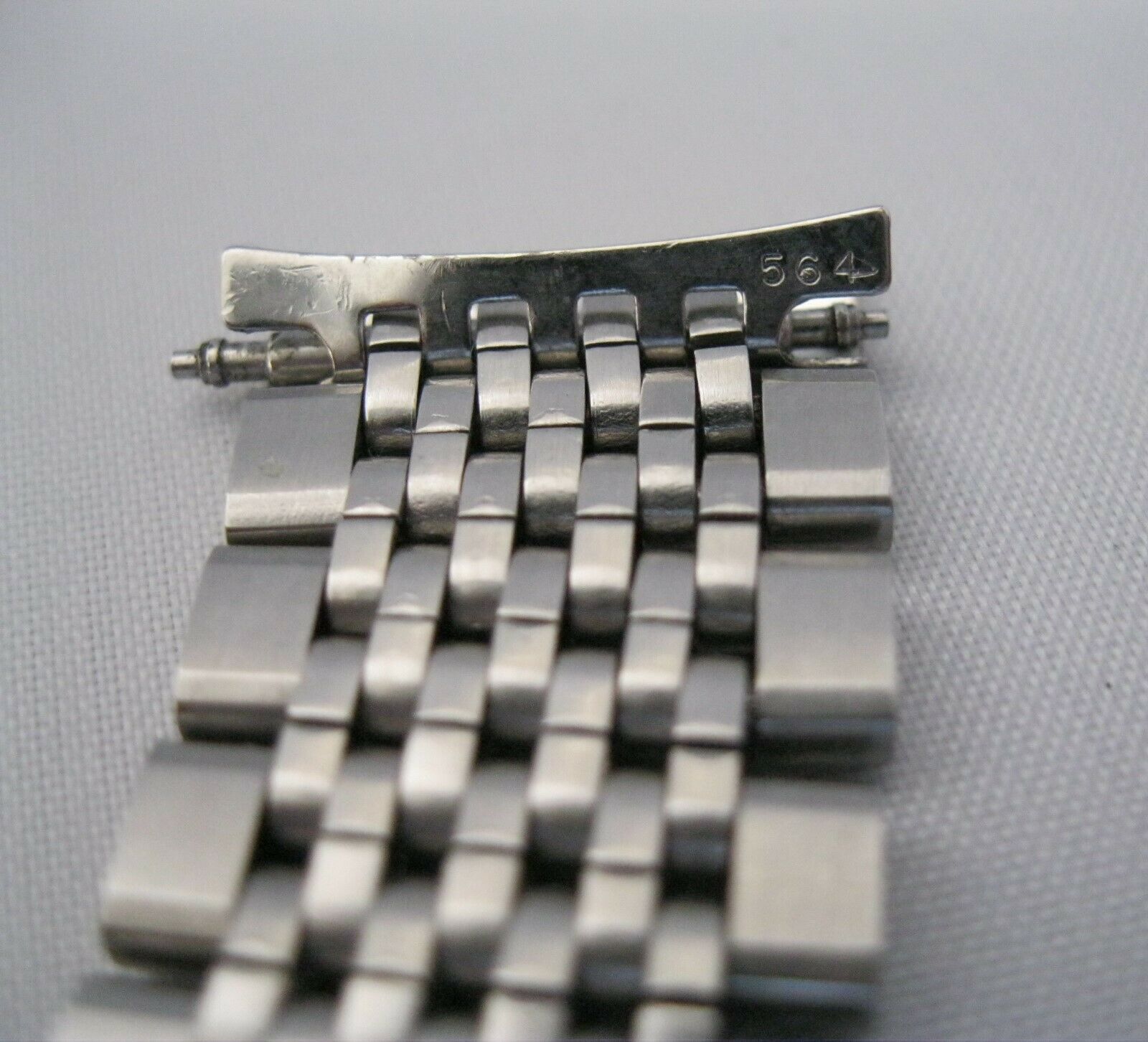

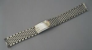

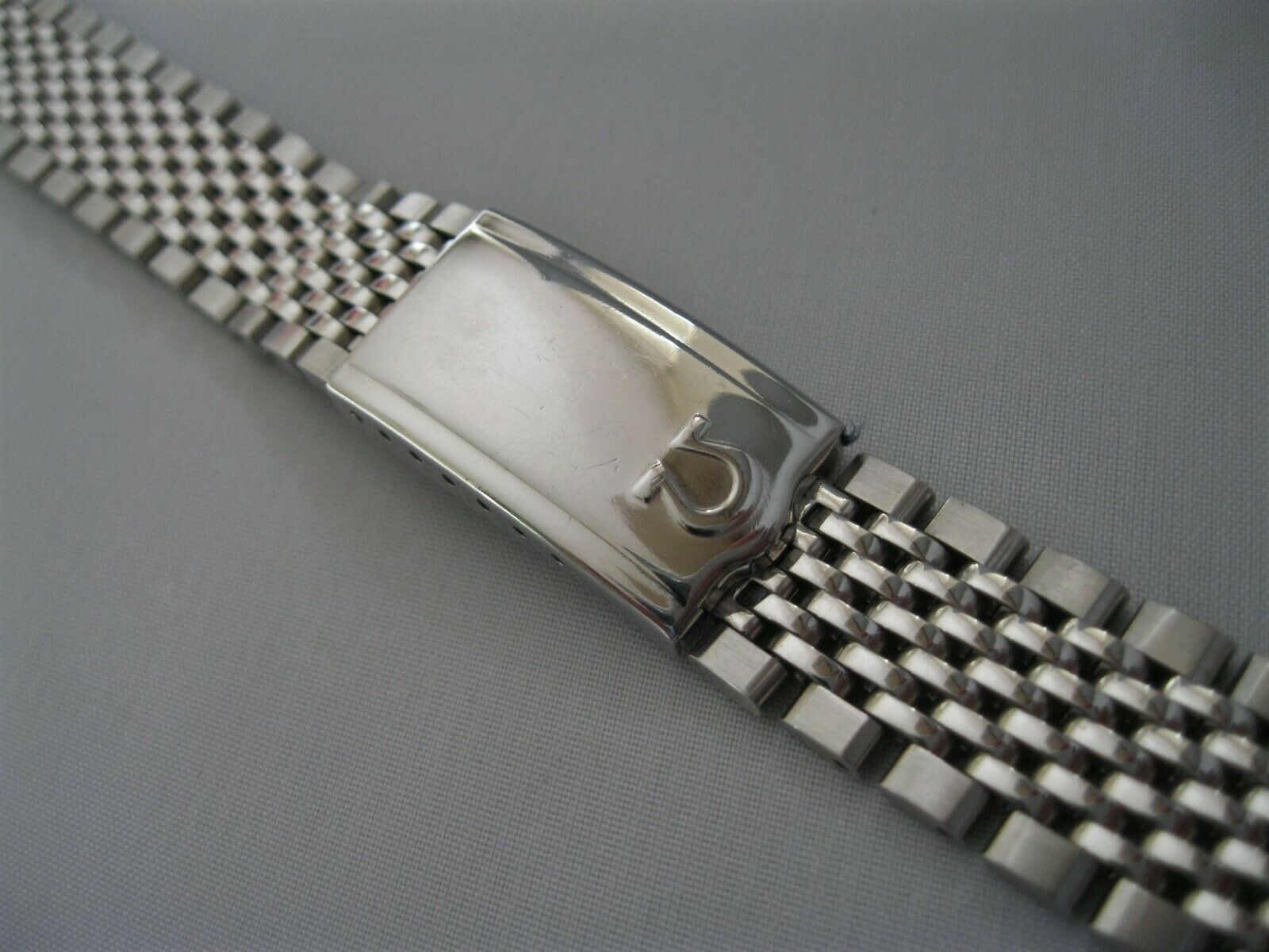

18mm lug width? If you want period correct vintage, a No.12/1037 with 70 or 570 end links should work. They pop up for sale on eBay (beware of fakes) and on OF from time to time. There may be other vintage options as well. I believe that Omega makes a modern BOR bracelet that may fit, but I can't remember the bracelet reference or the correct end links.

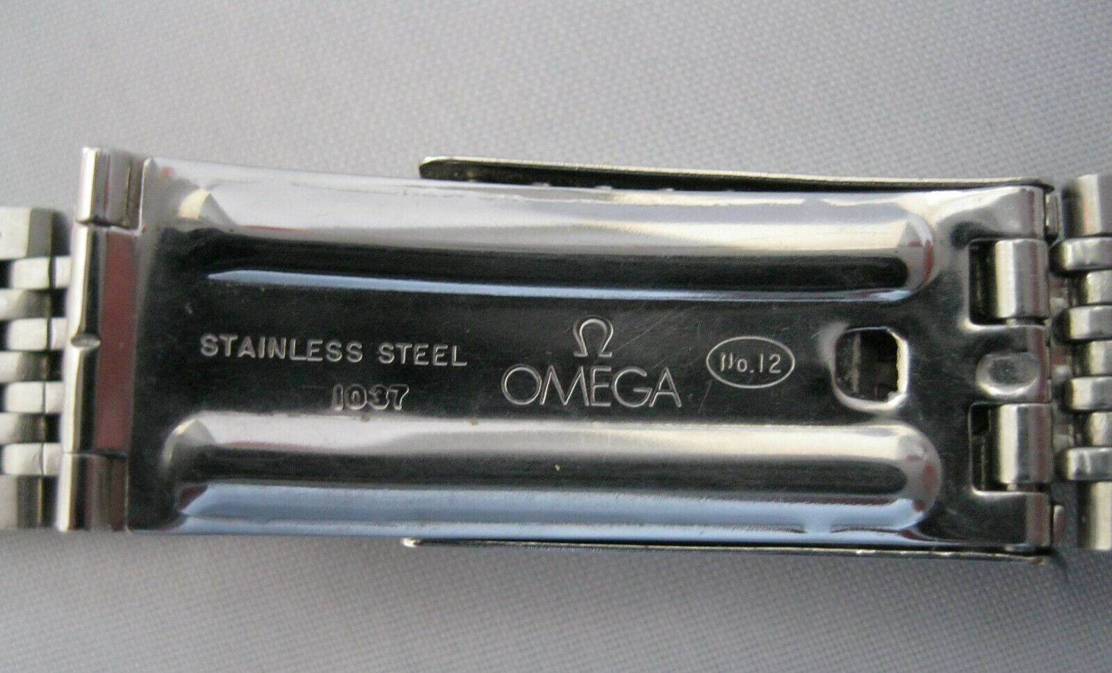

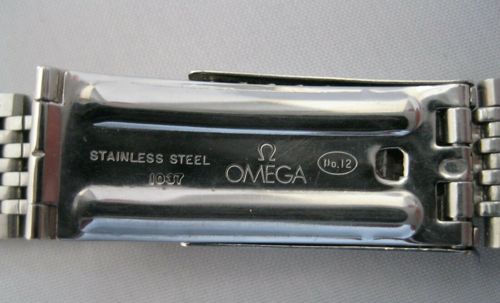

I was a little anxious about that. What are the telltales ?

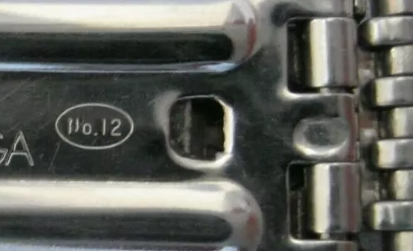

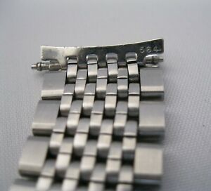

On the inner side the ends of the links should be beveled like here
the ebay ones are straight
The "1037" also looks off
I have never seen a 60s BOR for dress watches with this:
496
677

I think it is not obvious it's a fake. Remember these things change over the years. For example, I've seen three different versions of 633 end links.
Just my personal point of view, you may well be right... Seller seems to offer authentic stuff...
On the other hand the features I pointed out are strange...
