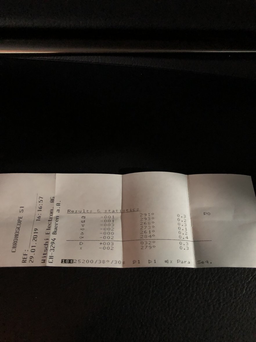

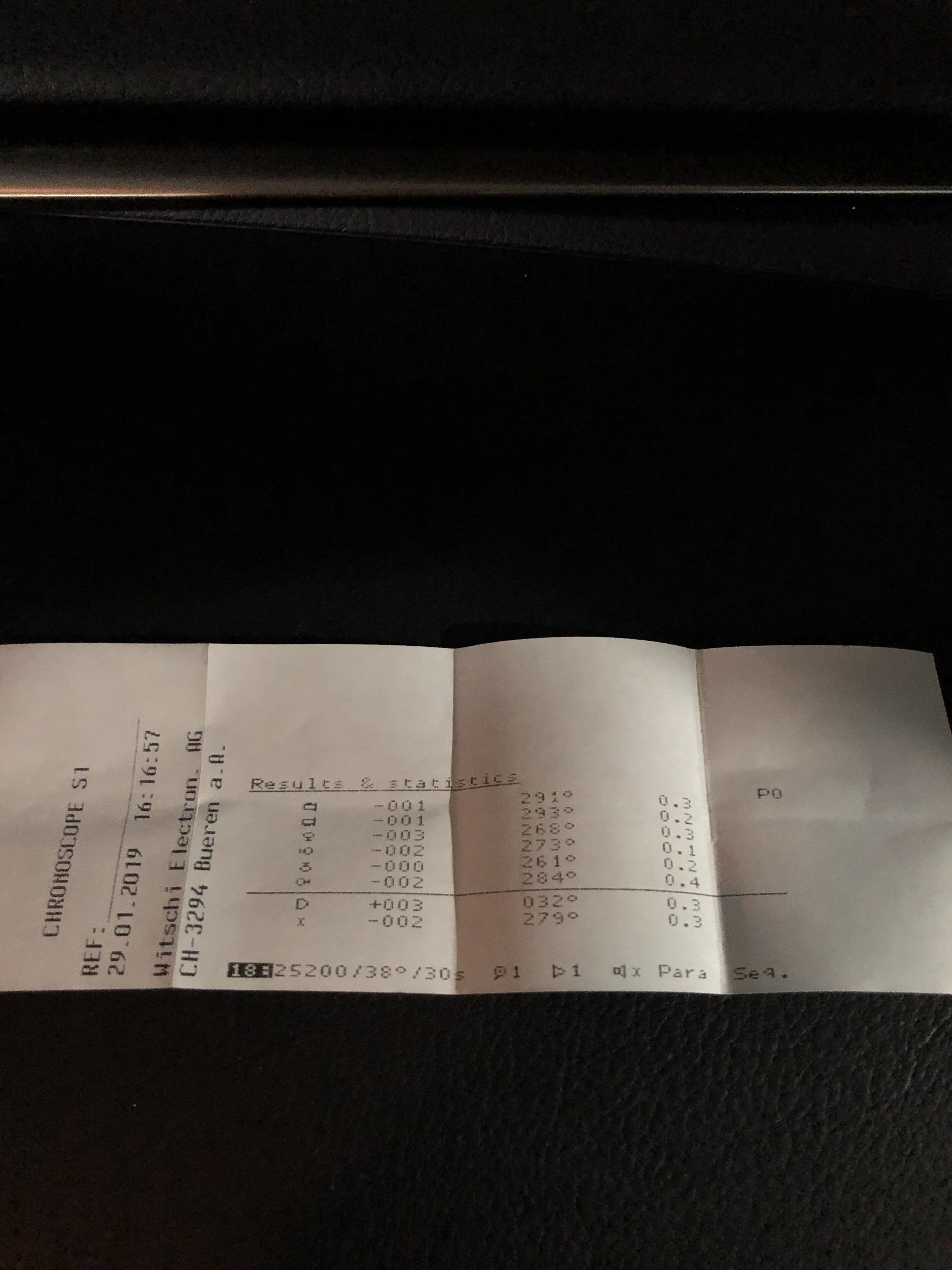

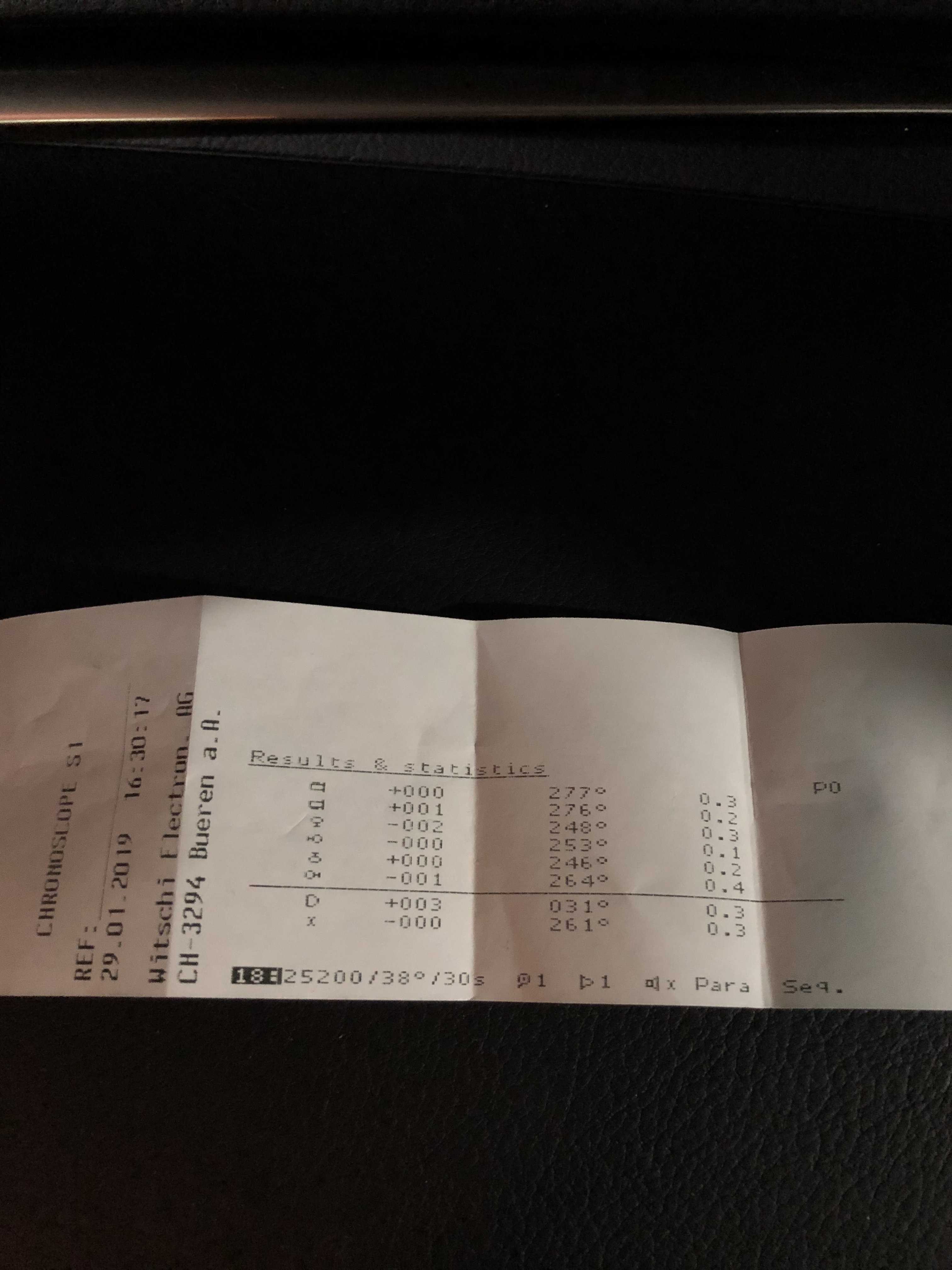

I just went to the Omega boutique and the technician did a timing test. Please see attached. There are two slips. The first test she did not wind the watch and it was previously fully wound 48 hours proper (Sunday at noon). This shows a -0.2 second loss. Then she fully wound the watch and it shows a -0.0 average rate. Does anything stand out when you see these?

Your description doesn’t match the slips. The first slip appears to be not fully wound based on the lower balance amplitudes, and the average rate is spot on at zero.
The second slip appears to be fully wound (higher balance amplitudes) and is showing an average rate of -2 seconds per day.
The Deltas on both are 3 seconds over 6 positions, which is very good. The watch needs to be sped up, but when they do this make sure they don’t introduce a poise error, which would increase the Delta...

Maybe the arrangement of the pics came out wrong when I posted.
1st slip - fully wound
2nd slip - tested 48 hours after a full wind, but I was wearing it for those past 2 days. This was the first time the technician tested it, and then she fully wound it (1st slip)
When the technician fully wound the watch, the average went from -0.2 to -0.0. Hopefully that clarifies it.

Just be clear, there is no “-0.2” rate anywhere on those slips. One slip has the average at zero, and the other at -2 seconds.
It makes no sense to me that the balance amplitudes would go down when the watch was fully wound, so at this point there’s not much I can say...

Correct, -2 seconds... my mistake.
Hmm... would that point to an issue with the movement? I know it's hard for you to say without seeing more information, but i'm just debating whether or not it's worth me sending it in to Omega or just living with it. I hate having a new watch opened up.
Could it be a faulty diagnostic machine or possibly that it's not in spec?

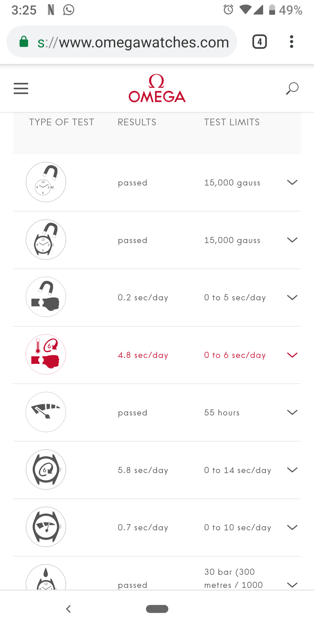

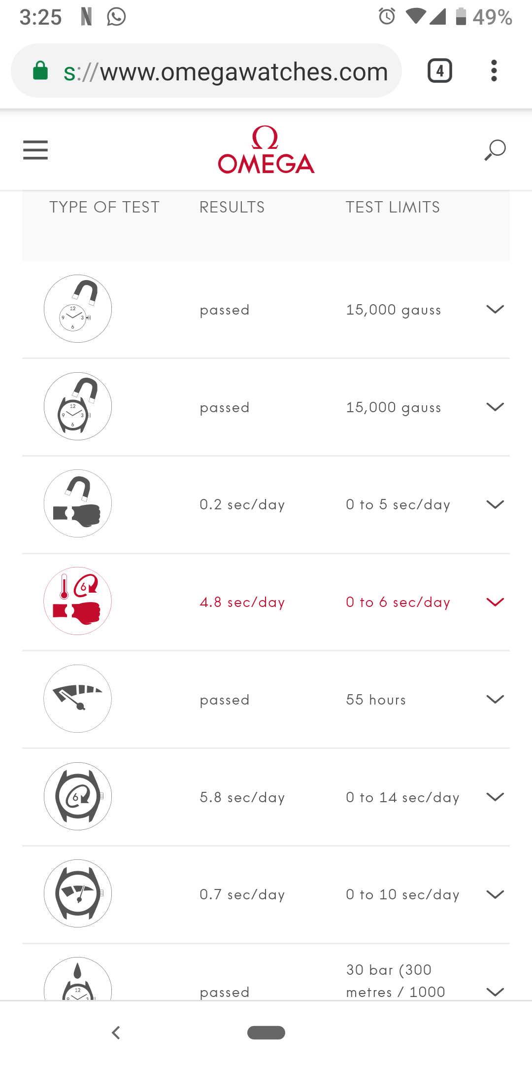

Just checked my new SMP300 8800 and the METAS is saying 0 to 6s/day. I thought it's supposed to be 5. Did they change it?
It’s not the same spec for every movement...
Oh I see so the 8900 is up to 5s but the 8800 is up to 6s?
