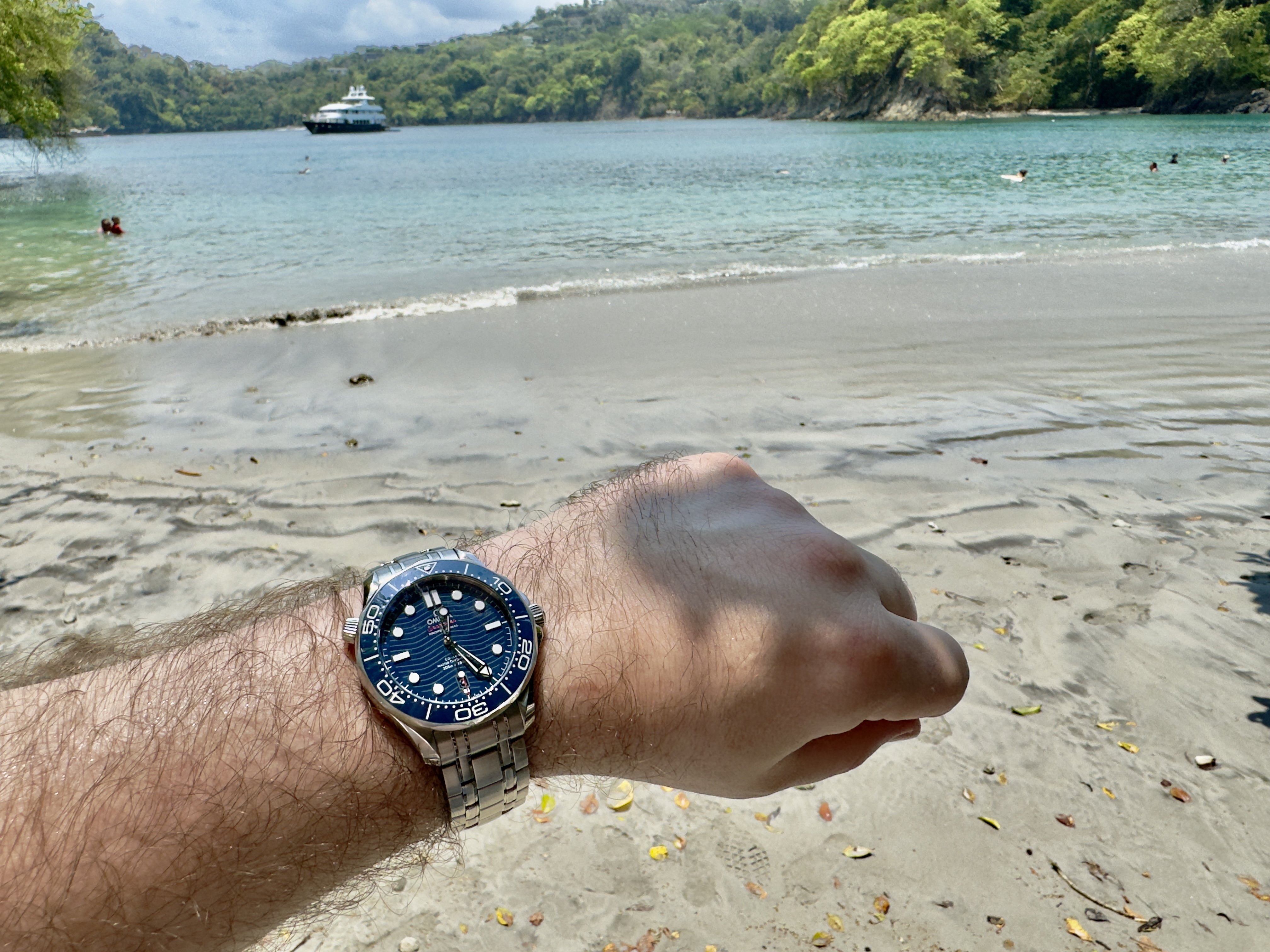

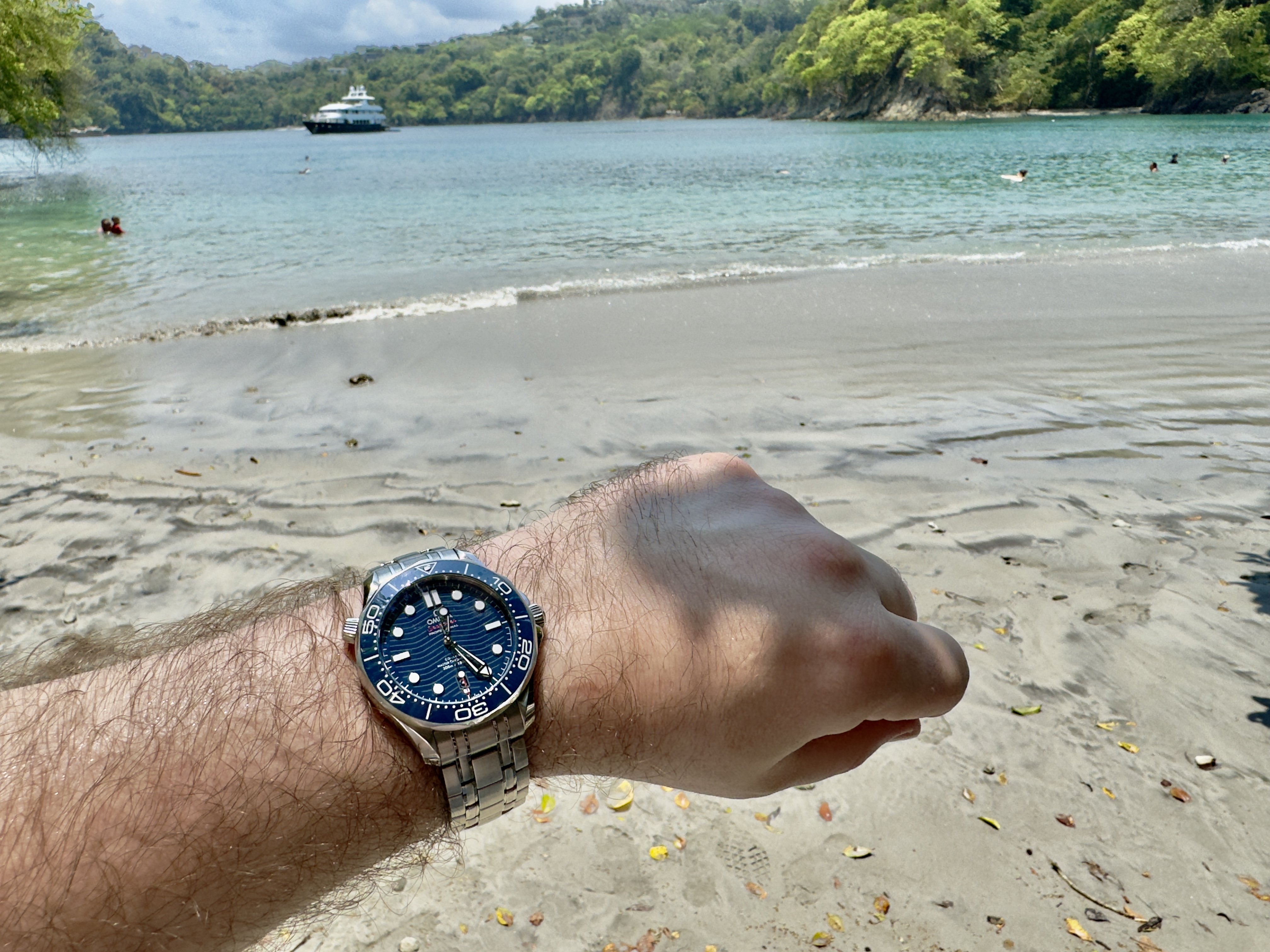

For reading through my insecurities, here’s a picture of the SMP in its natural habitat
