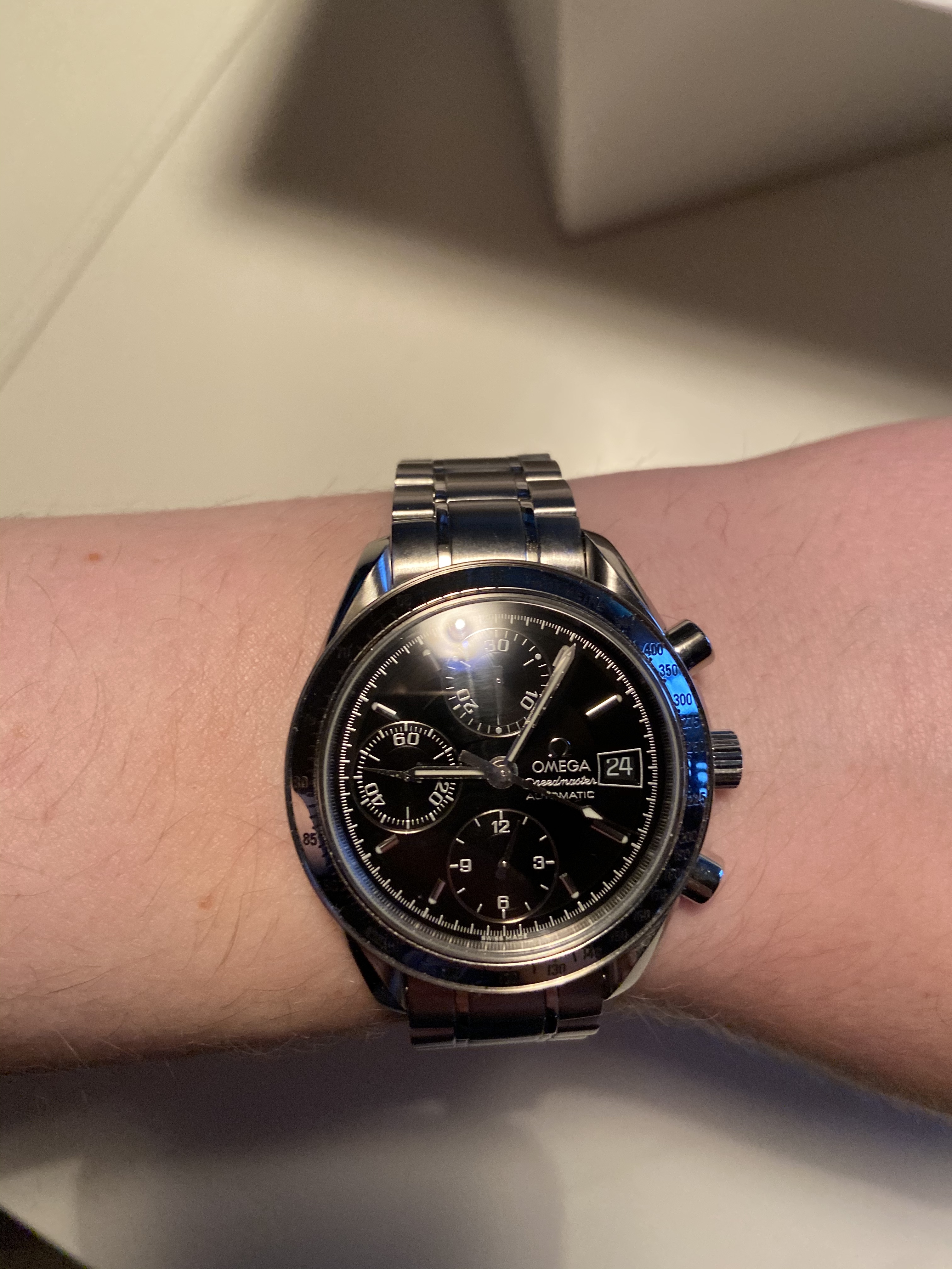

Hi guys,
Just bought a Omega Speedmaster 3513.50 online from a guy. Received it three days ago.
Certificate says bought in 2001.
So today I just started to watch how accurate it is.
What I can see, it has lost about 5 seconds on 6 hours.
It is almost bedtime in my country, so maybe I could lay the watch down with glass up to make it gain time, and check it again tomorrow?

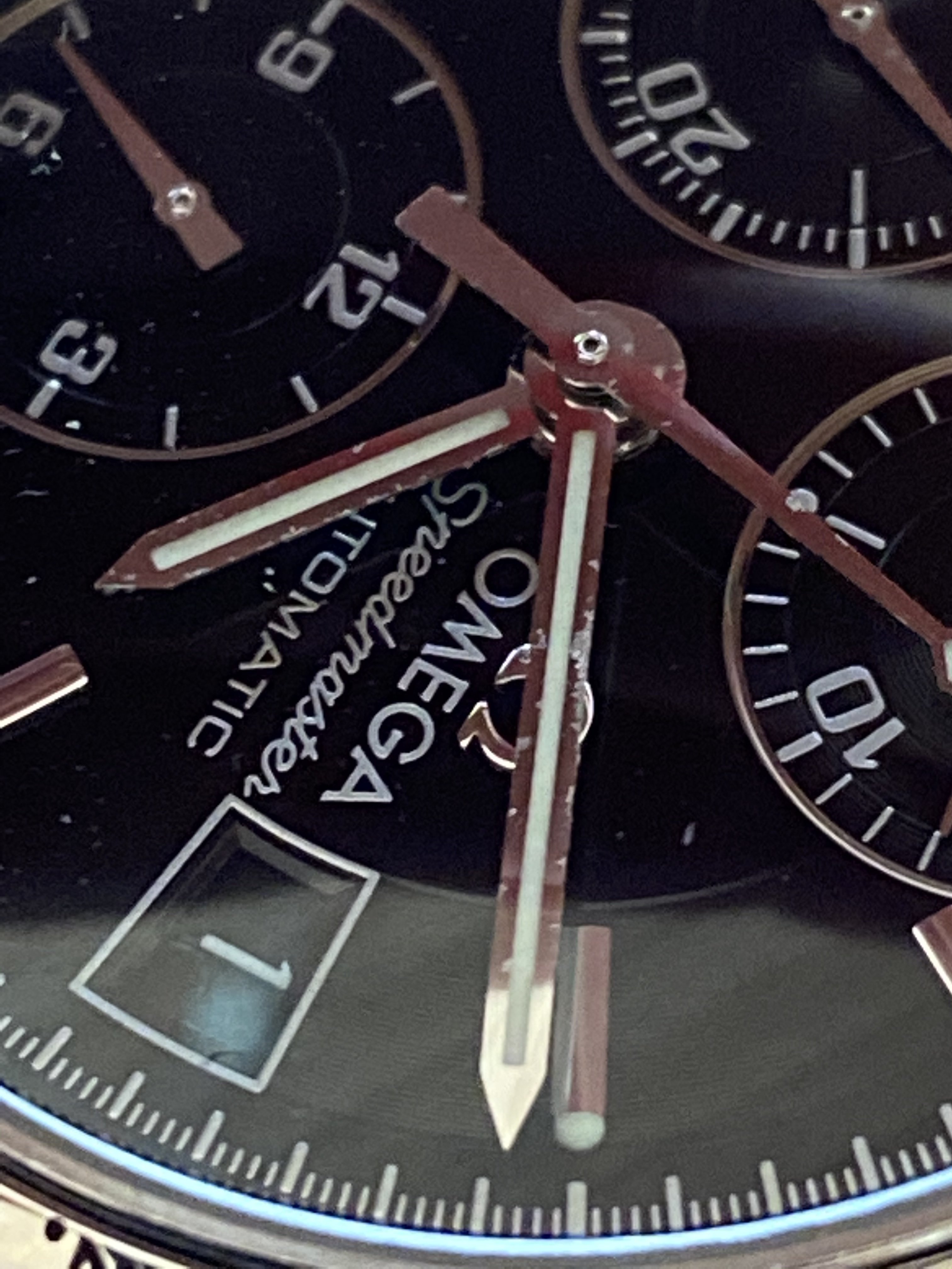

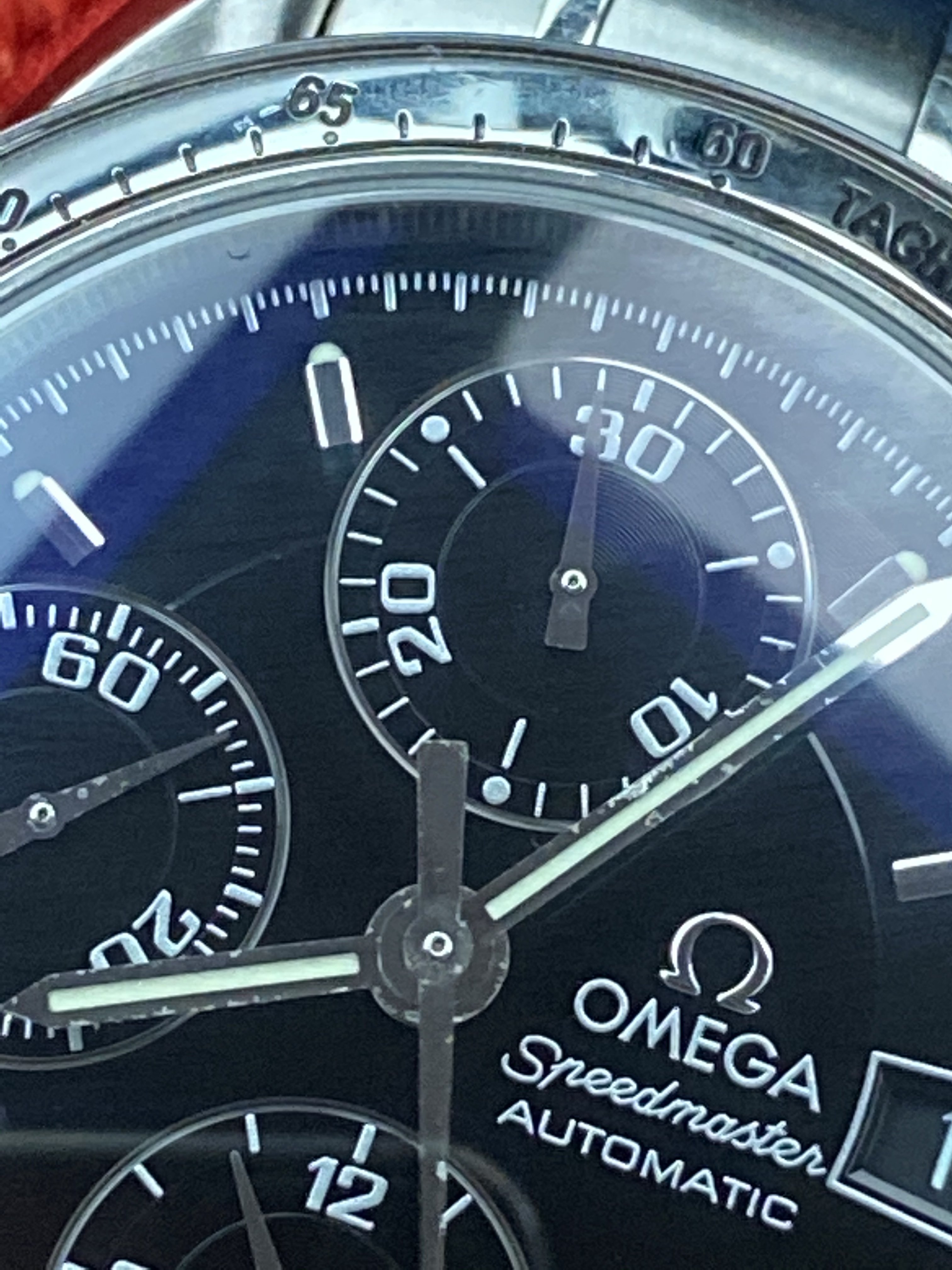

And after I bought it I notice some, first I though was scratch on watch hands, but someone told me it may be mold. I’m not sure if that has anything to do with accuracy.
I’ll add some pictures. And the watch is in very good condition with no scratch, so maybe it have been on service not long ago. Not sure, the previous owner bought it on chrono24.
So, Is -5 seconds in 6 hours alot? Is it normal? Should I wait longer to see how accurate it is? Or should I return it?
sorry for my bad english, its not my foreign language.
thanks for accepting my invite on omegaforums, and thanks in advance 😀

so it's about -20/day, it's not too bad if it's consistent but since it's an old watch, it might need a service.
Perhaps other more knowledgable members can help you as i'm not an expert but the finish on those hands and something feels off.

I don’t think that’s mold, I think it is corrosion. Regardless of which it is, in indicates moisture inside the watch which is never a good thing. That definitely means a full service to check for rust in the movement AND to replace all seals. Don’t go cheap on this and don’t wait, or it could get worse and more expensive.
I also wouldn’t send it to the seller to have “his guy” service it for cheaper, because you never know what they will do - possibly they wouldn’t replace all the worn parts in the movement nor replace the seals, which would make the “service” worthless. A good watchmaker will do it properly, but it won’t be cheap. They will very likely charge close to what Omega charges.

Honestly, I feel sorry for the seller in situations like this. They sell a nice watch at a fair price, and then after the fact the buyer comes back with unrealistic expectations. The watch is 20 years old, the seller didn't claim it was serviced, and it is actually keeping reasonable time for an old unserviced watch (apparently measured only in one position). The buyer is also complaining after the fact about minor corrosion on the hands, which is readily visible in photos. 🙄
I definitely wouldn't recommend returning it. You got what you paid for, which is a nice watch in expected pre-owned condition.
