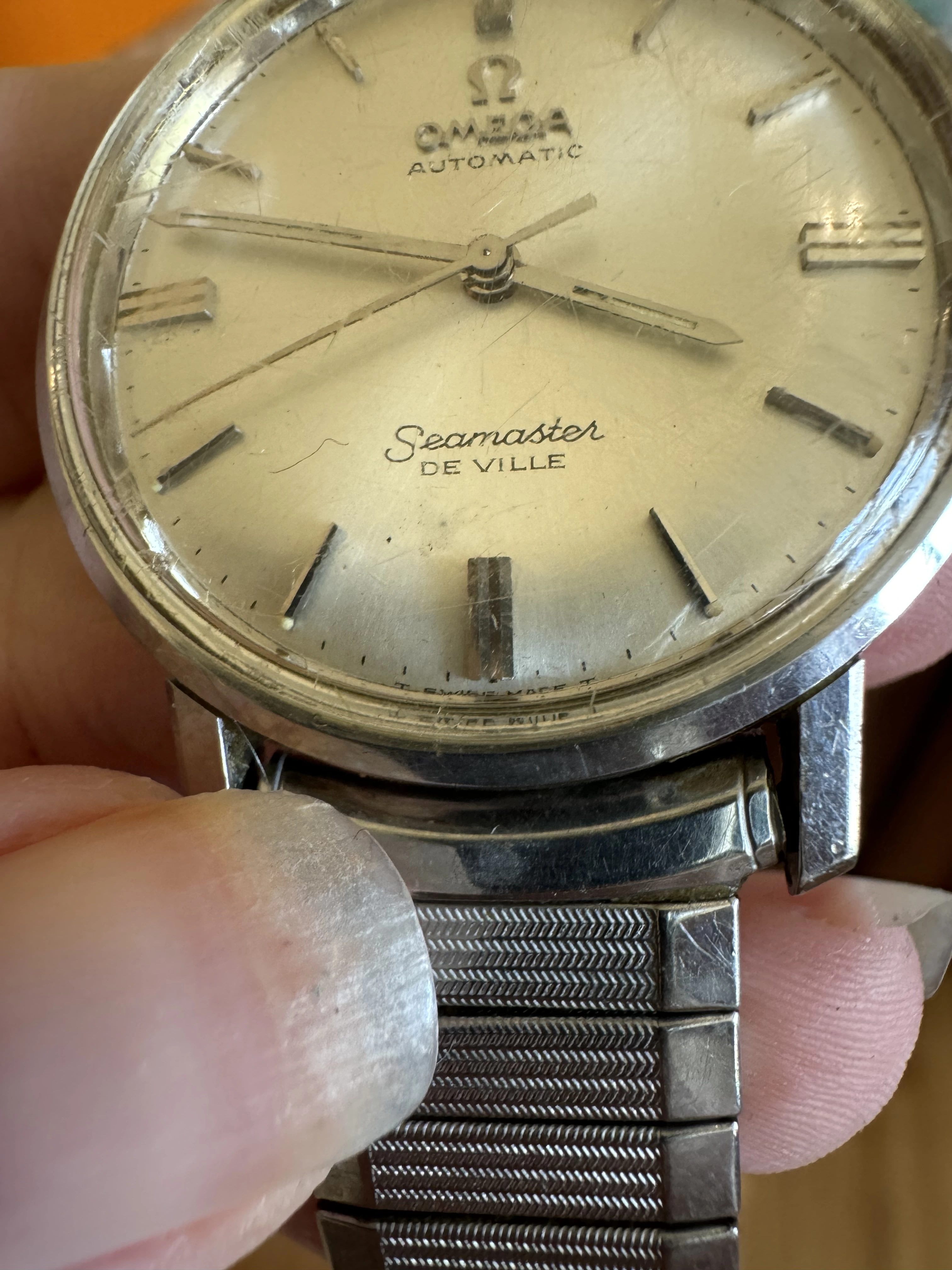

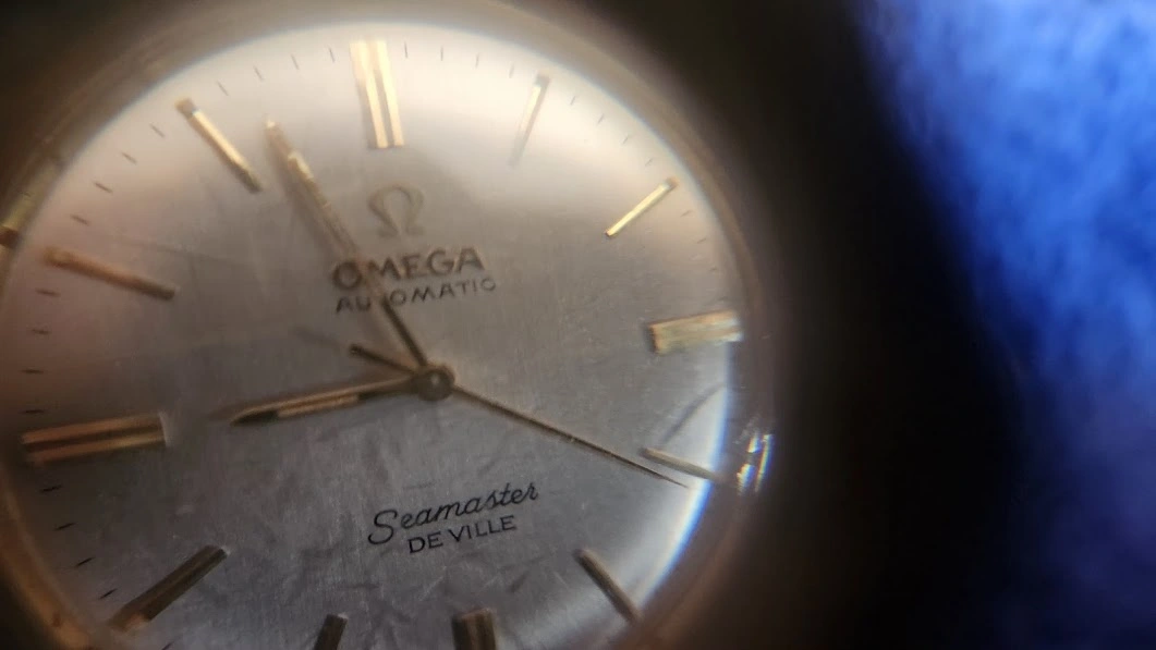

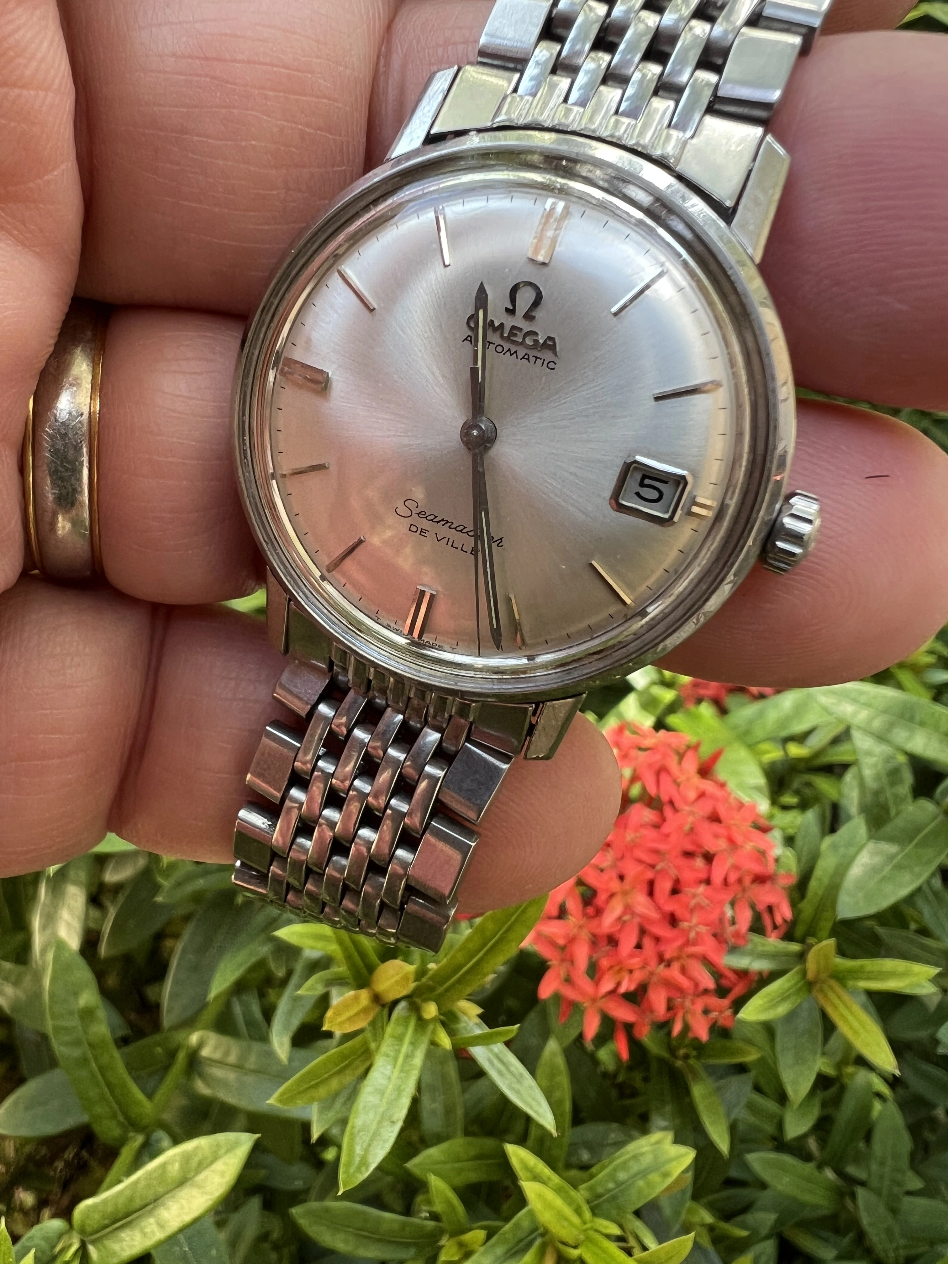

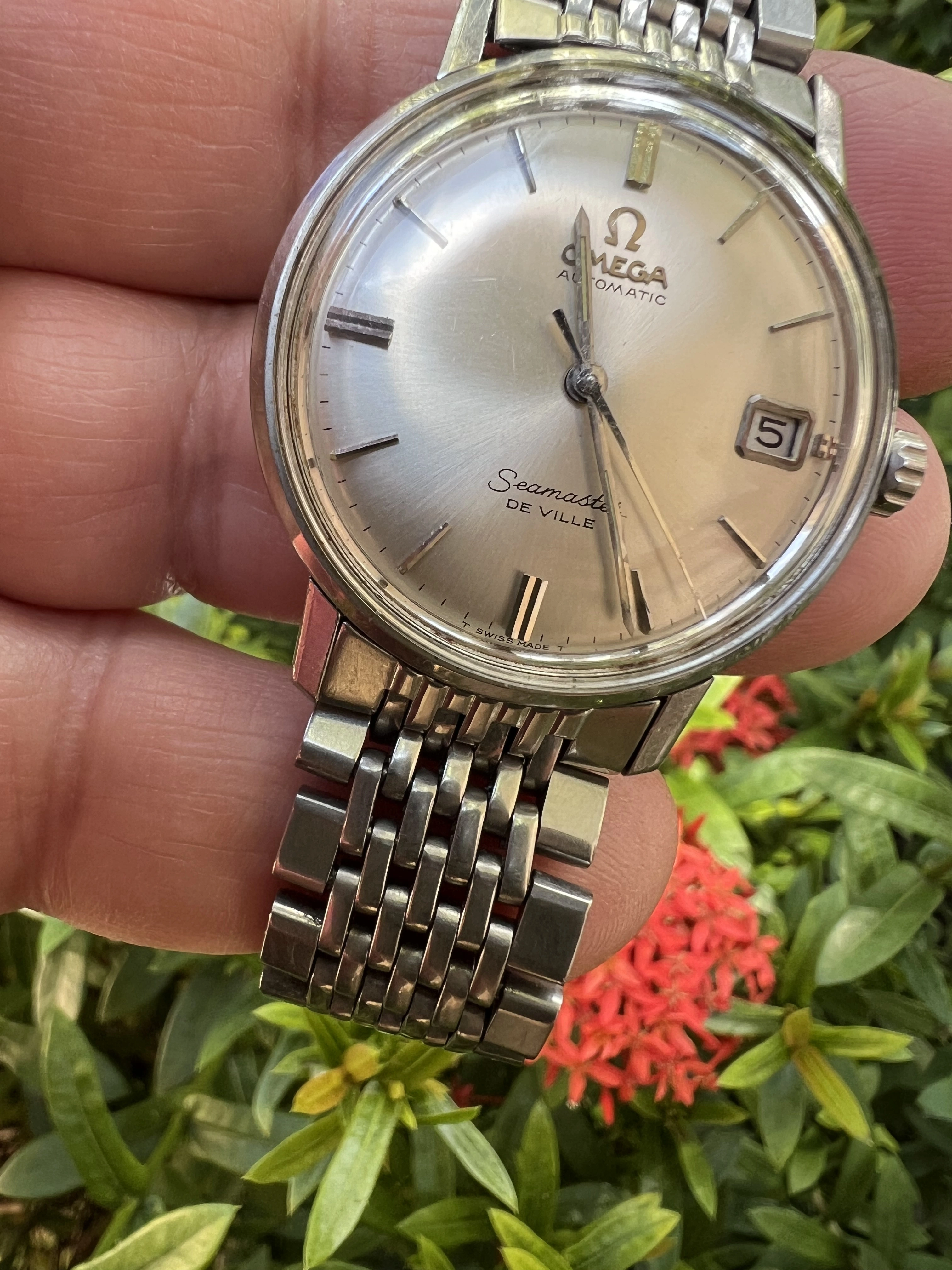

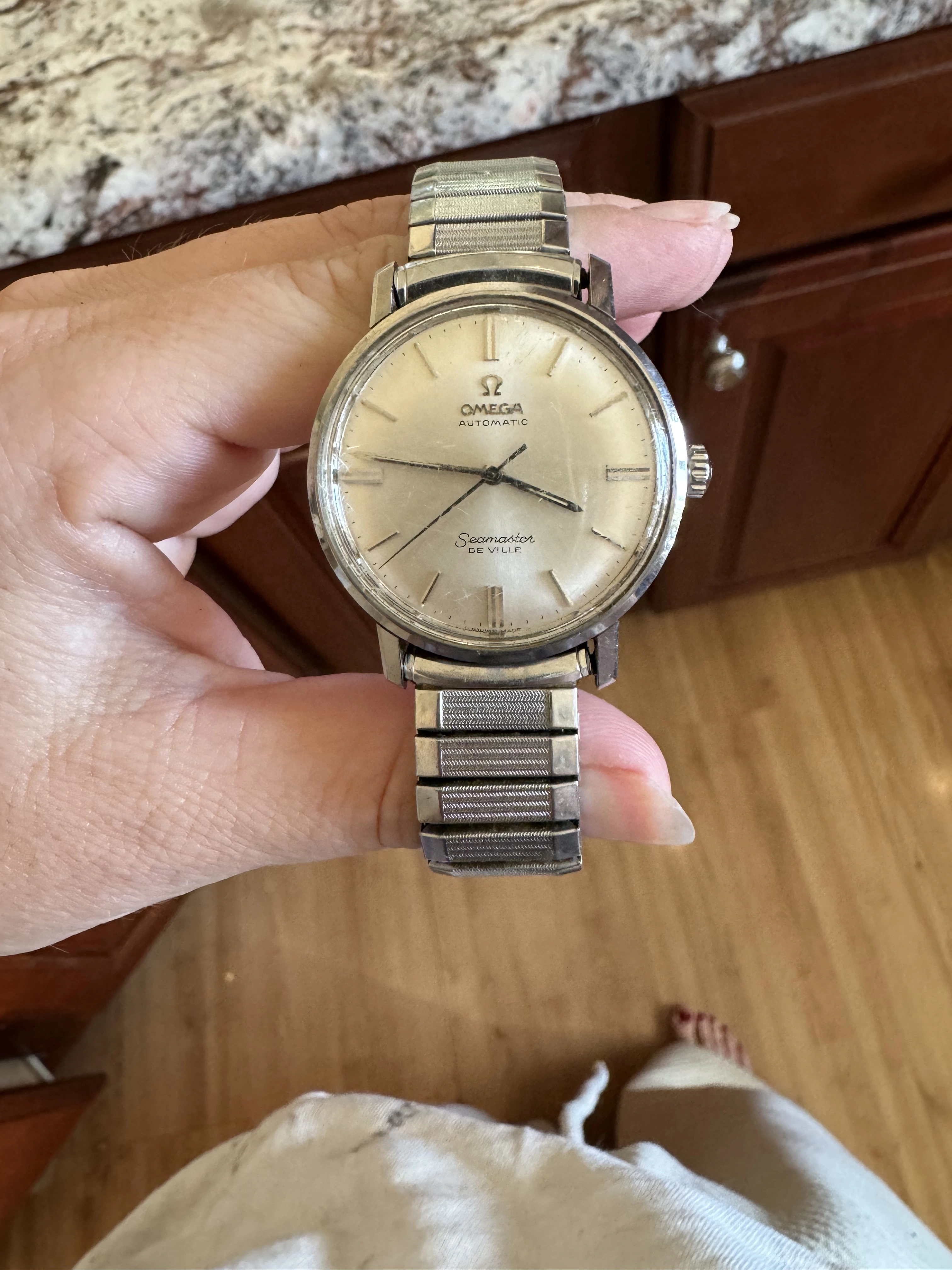

Hello!! I recently inherited this watch. It was my grandfathers and he wore it every day, so it has been well loved and not the greatest of condition. It is very sentimental to me though and I would love to know more about it. I plan to take it and have it cleaned up and serviced soon, but am too anxious to wait for it to be opened. From this thread, I believe it has to be from the year 1964 (correct me if I am mistaken). I do know the band is not original.

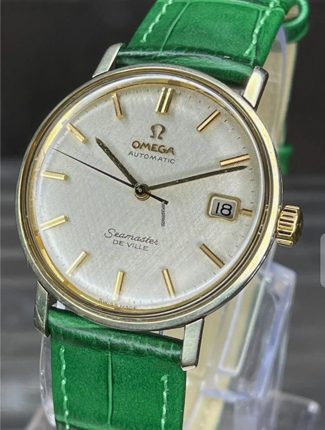

Here’s how mine looks after I had it serviced and refurbished. Take a look a couple of posts above yours to see the before pictures.

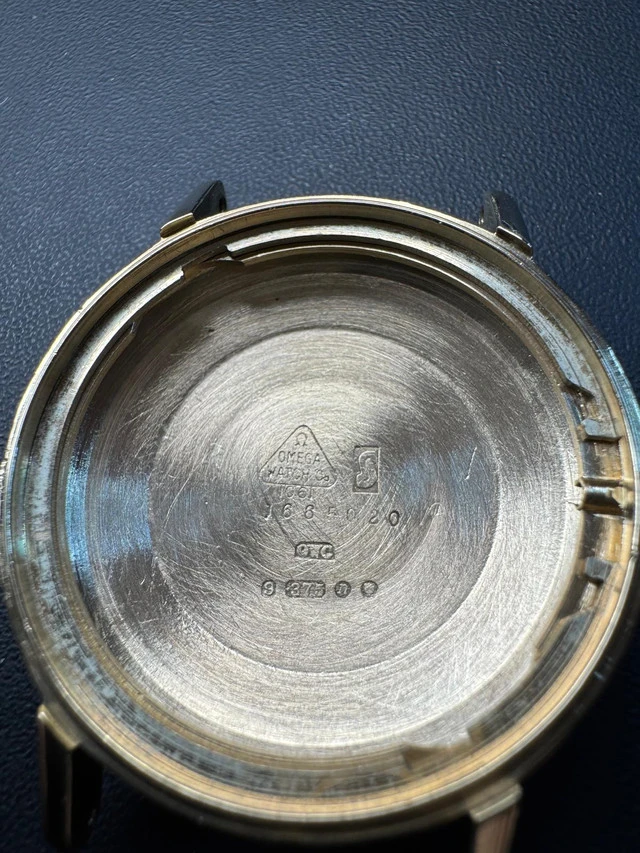

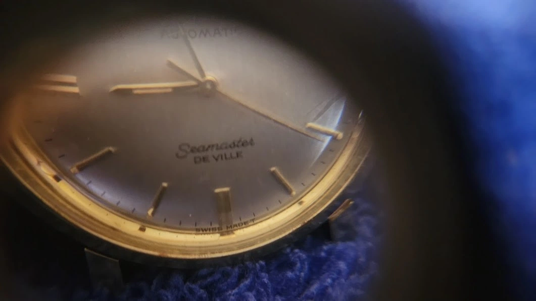

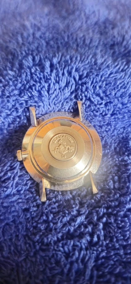

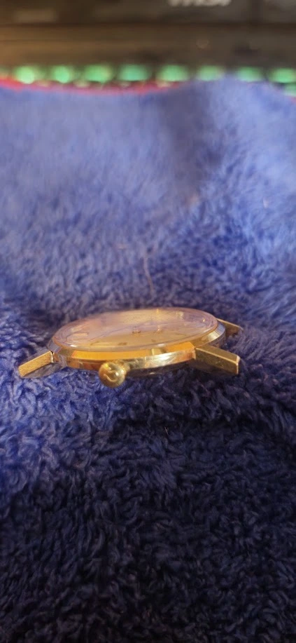

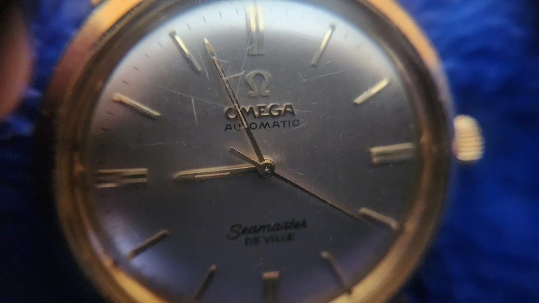

I found this in my grandfather's basement after my father had passed away.
My grandfather was very involved in his local government serving for many years as the county controller here in the Poconos in the late 50s and 60s.
I really would like to identify this watch and maybe find the correct strap for it. I've been reading articles and watching videos for weeks on and off.

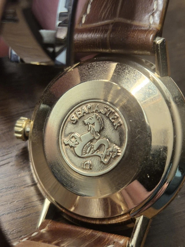

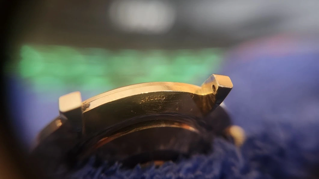

Other than opening it how can I identify it any help would be so greatly appreciated. Also, I'm in the northeast corner of Pennsylvania any trusted suggestions where I can have this serviced. I'm sure it's never been opened up before.
Thanks!
Hello! This is the American reference B6308.
3
That's not it, the one I have is not gold filled it's solid 14k yellow gold with one T after SWISS MADE . I also forgot to mention my grandfather LOVED Golf.
884
1,750
B6308 exists both in 14k solid gold and in 14k gold filled. I'm pretty sure this is it.

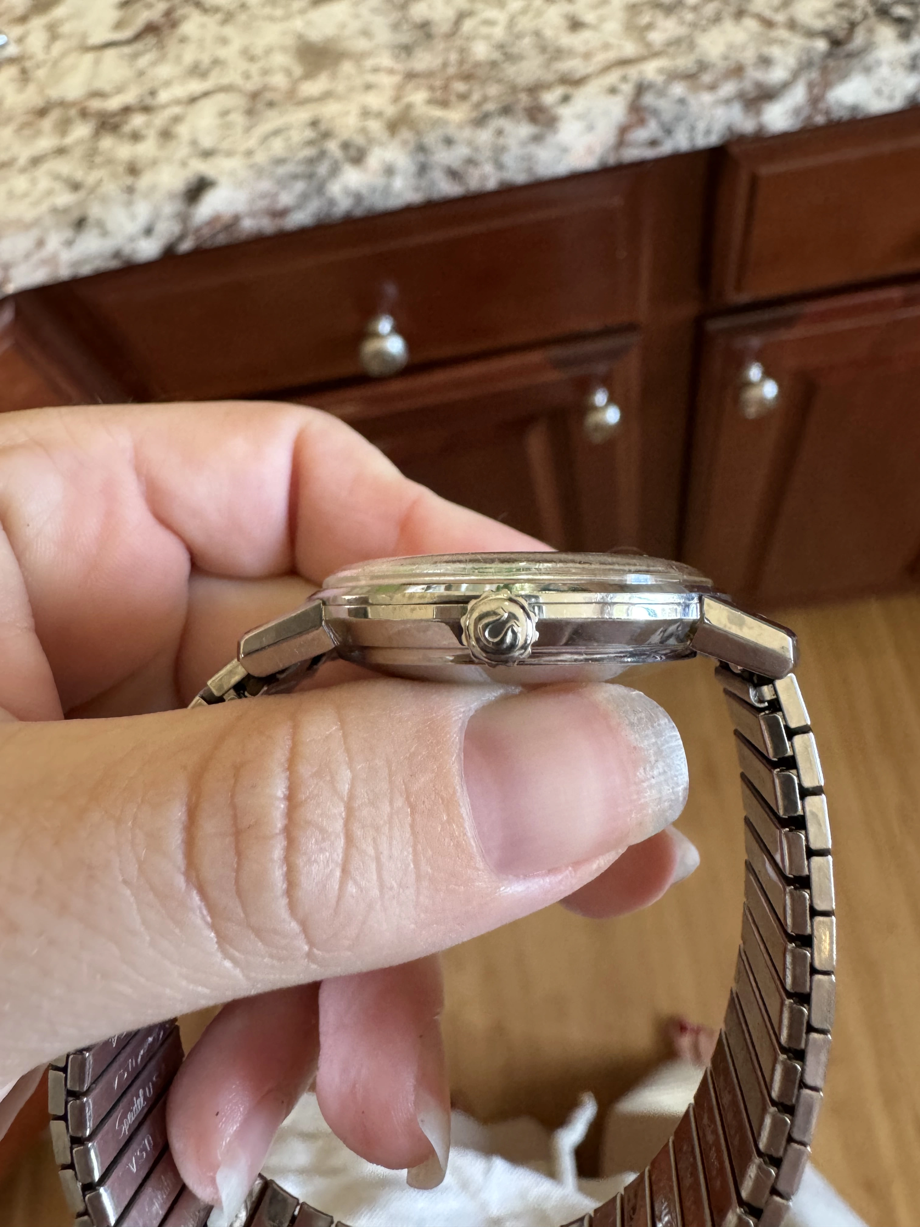

Hi, I'm new to omega watches and collecting in general but I am keen on buying this Omega Seamaster DeVille. The only issue I have is that I'm not sure what the model is and year of production as the seller hasn't listed it so was just wondering if someone could help me roughly identify it before I consider purchasing. Any other things to watch out for would be greatly appreciated but thanks to any help in advance.
Kind regards,
Rory.
3,056
6,536

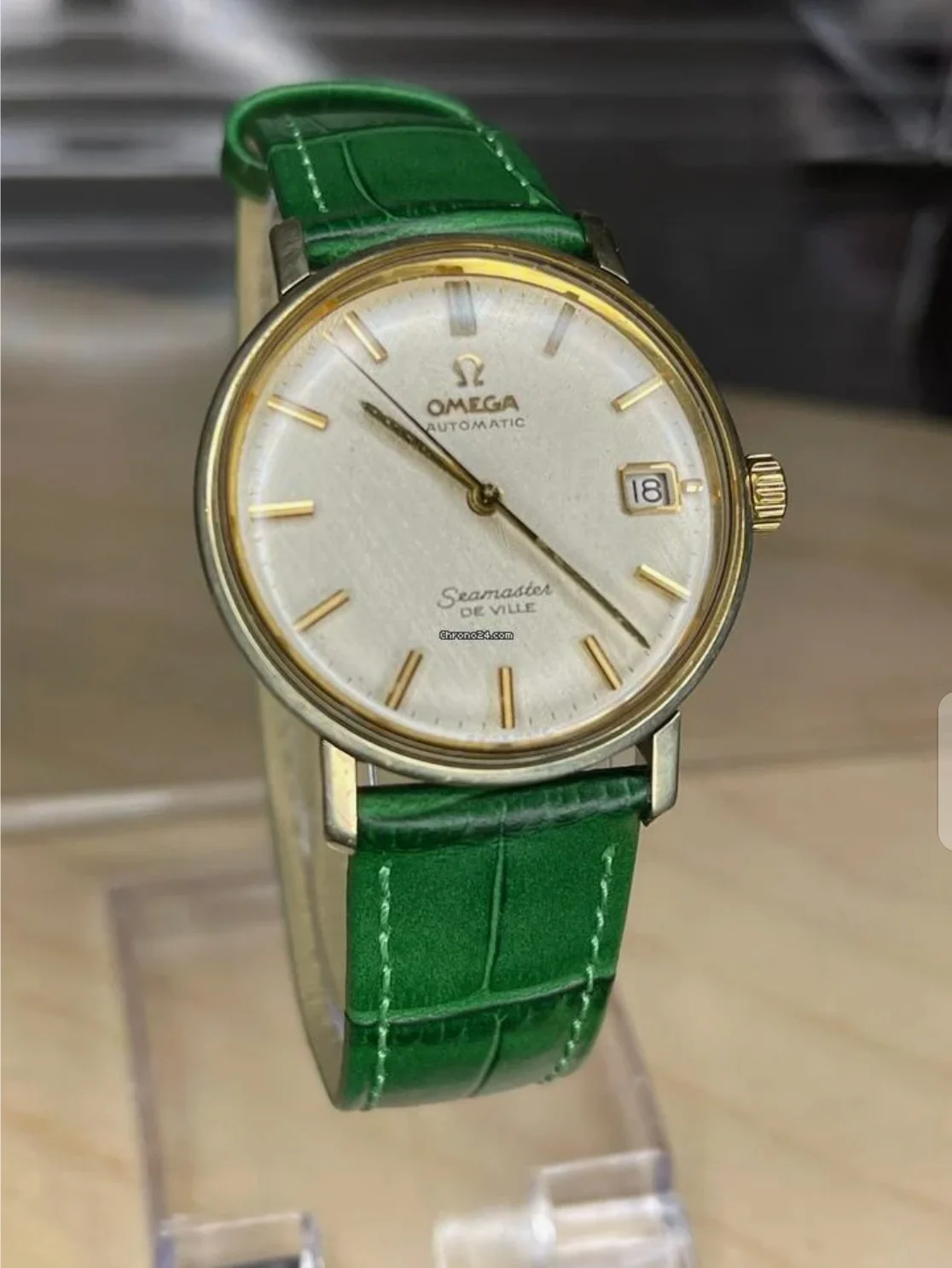

Looks like 166.020 mid late 60s, gold plated. It opens from front all details of reference inside case back and serial number on movement will provide date info
Dial looks nice
Bottom photo concerned about Right upper lug looks like plating has worn through need more photos to make sure
What is asking price ?
For future inquiries better to start your own thread in vintage section “looking for help please on this Omega listing” or similar as you will get more responses rather than attaching to existing thread.

Hi, thanks for the information and about the tip for future enquiries I will do next time. The asking price is £650 ($810) but as you said some of the plating appears to have worn. The price is listed as negotiable but as I have not dealt with vintage watches before I am a little daunted by the fact that you could buy one of these watches and they stop the following week. Is servicing/upkeep of vintage watchers generally more expensive or about as fair as a modern automatic watch?
3,056
6,536
Servicing this watch would cost in range of $ 300-400 plus parts if needed. Best option is independent watchmaker with Omega parts account. A stainless steel example is actually more desirable than gold plate
If you are patient you can find one for $500 range. Search for 166.020 they are nice watches and look good on steel Beads of Rice bracelet.
Here’s an example this is good vintage entry level watch and many around stay patient and follow OF Private Sales thread for reliable sellers and fair prices
7

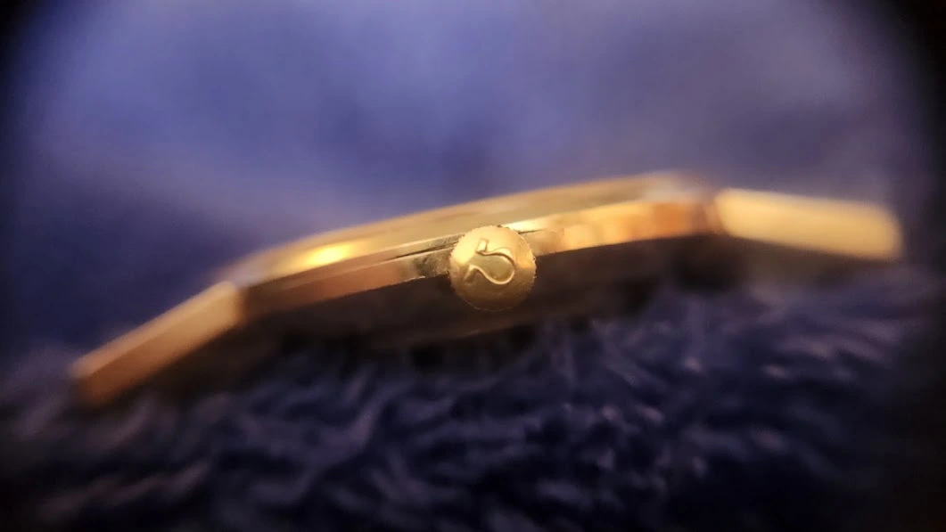

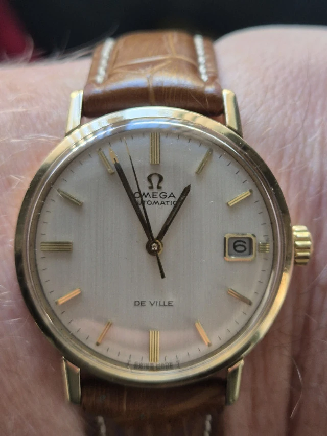

Some photos of my late father in laws English reference 1665020 in 9 carat gold. The watch was gifted to me on my wedding day (many years ago) and has just been serviced and I was delighted to discover that it still has the original crystal. The watch was made in 1968 and purchased new in 1971 (I have the original guarantee booklet, but unfortunately no box)
4

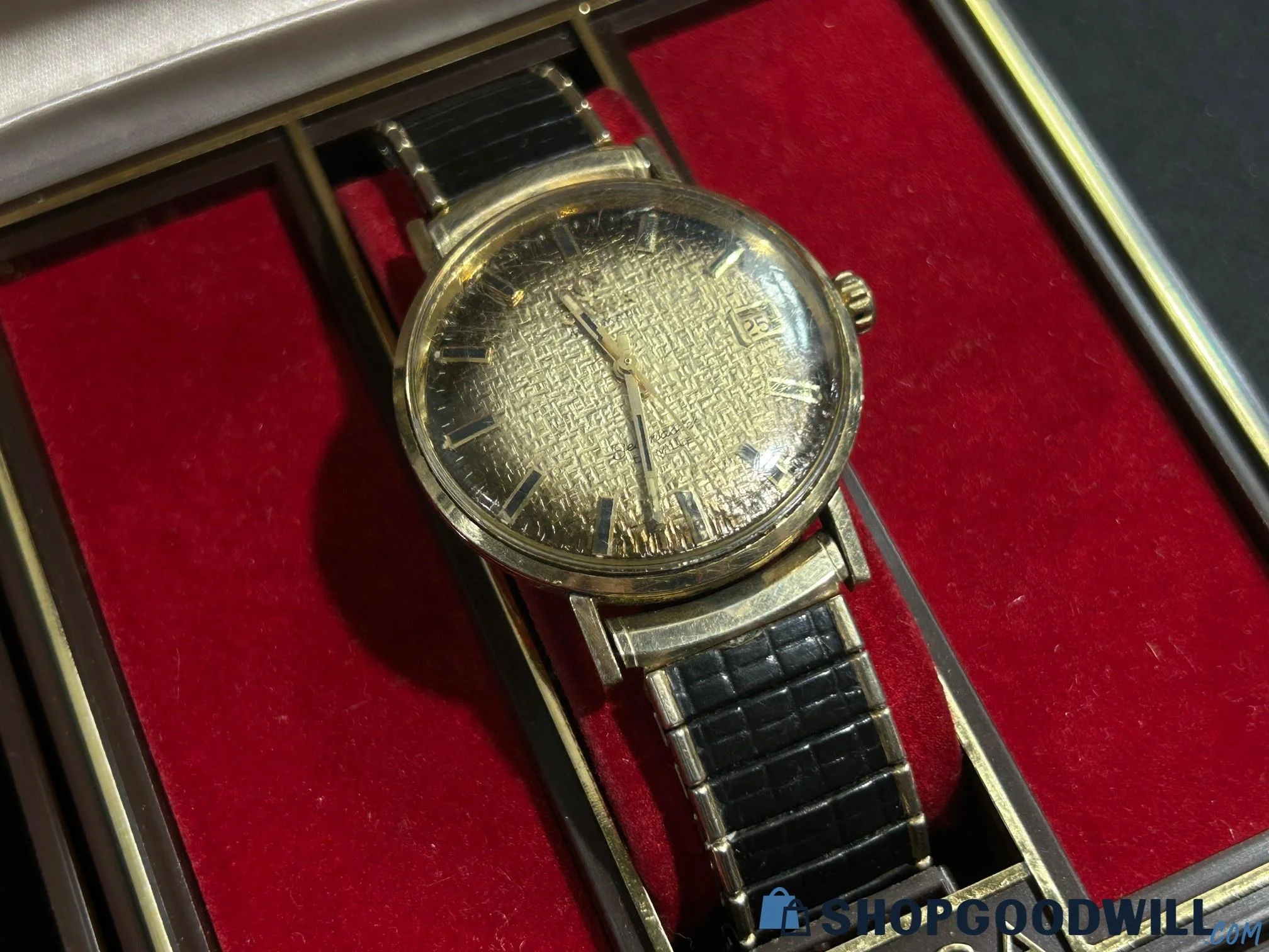

Hey Guys, how much is a 166.5020 cal 565 9k gold worth nowadays? Literally asking for a friend.
1k GBP?

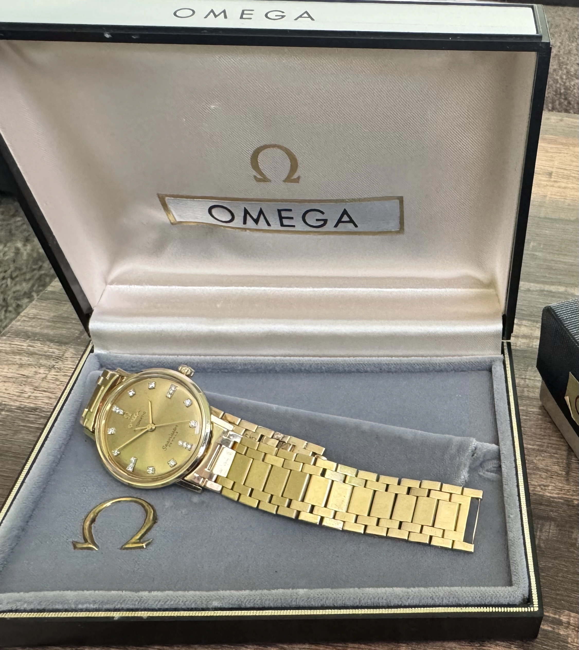

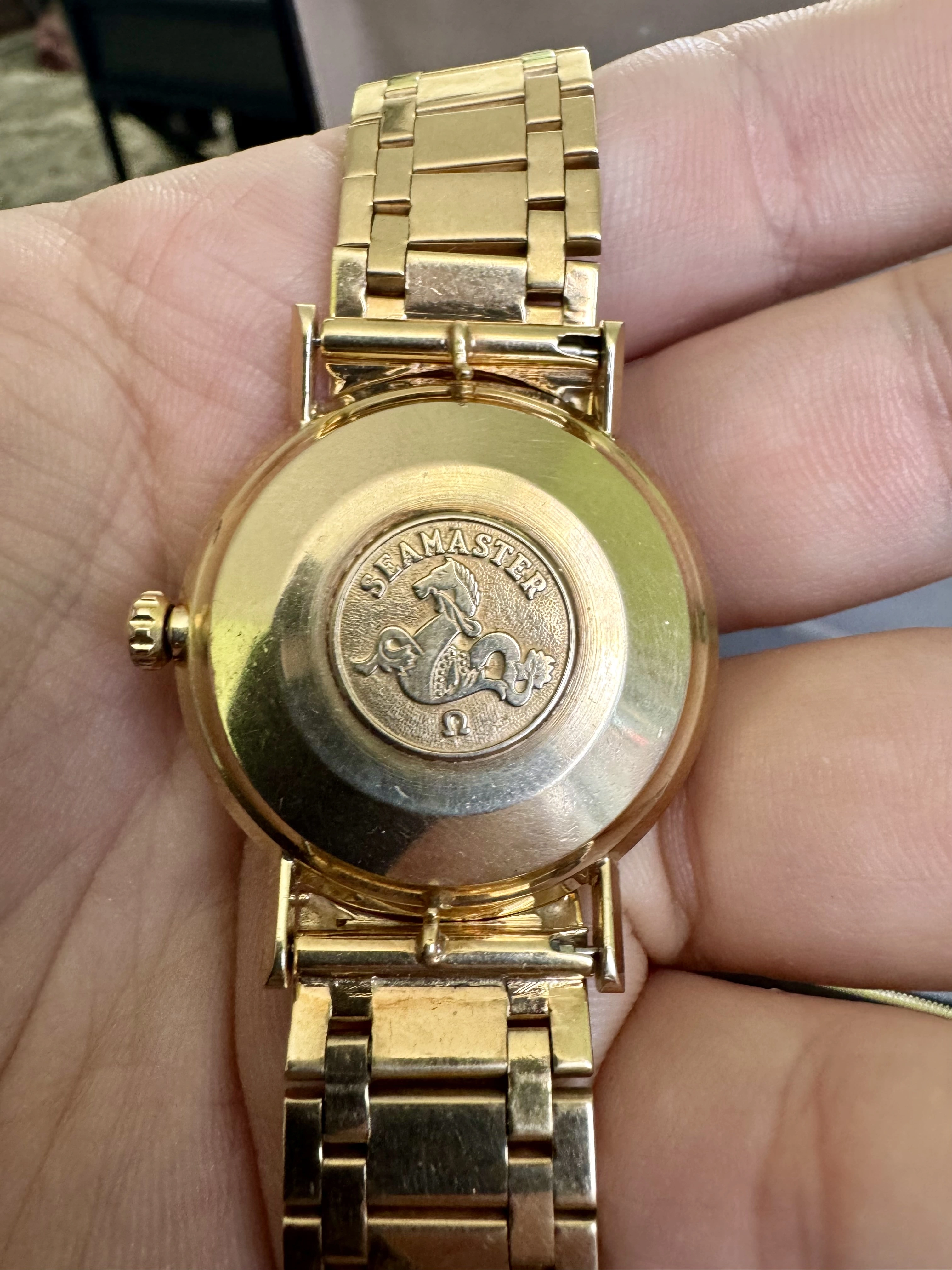

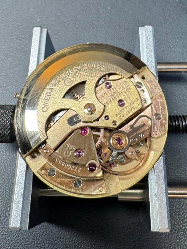

I need your guys help figuring out how to decipher this. What caliber movement is this? What year is this from? It’s an American watch. Bought in 1970 according to the paperwork but I’m fairly certain this was made in the mid to late 60’s.
From your guys’ research I still can’t decipher what I have here.
I bought this from the grandson of the original owner.
It’s a full set.
1,547
5,317
It’s a full set.
Assuming the serial number in the paperwork is accurate, the watch was assembled in 1968/9 so a purchase date of 1970 seems reasonable. Fairly common Seamaster model with a diamond dial that has been refinished. Aftermarket bracelet. Movement is likely a cal. 550/2. Paperwork suggests the case is 14k gold, and the bracelet may likewise be solid gold so there some value there.
