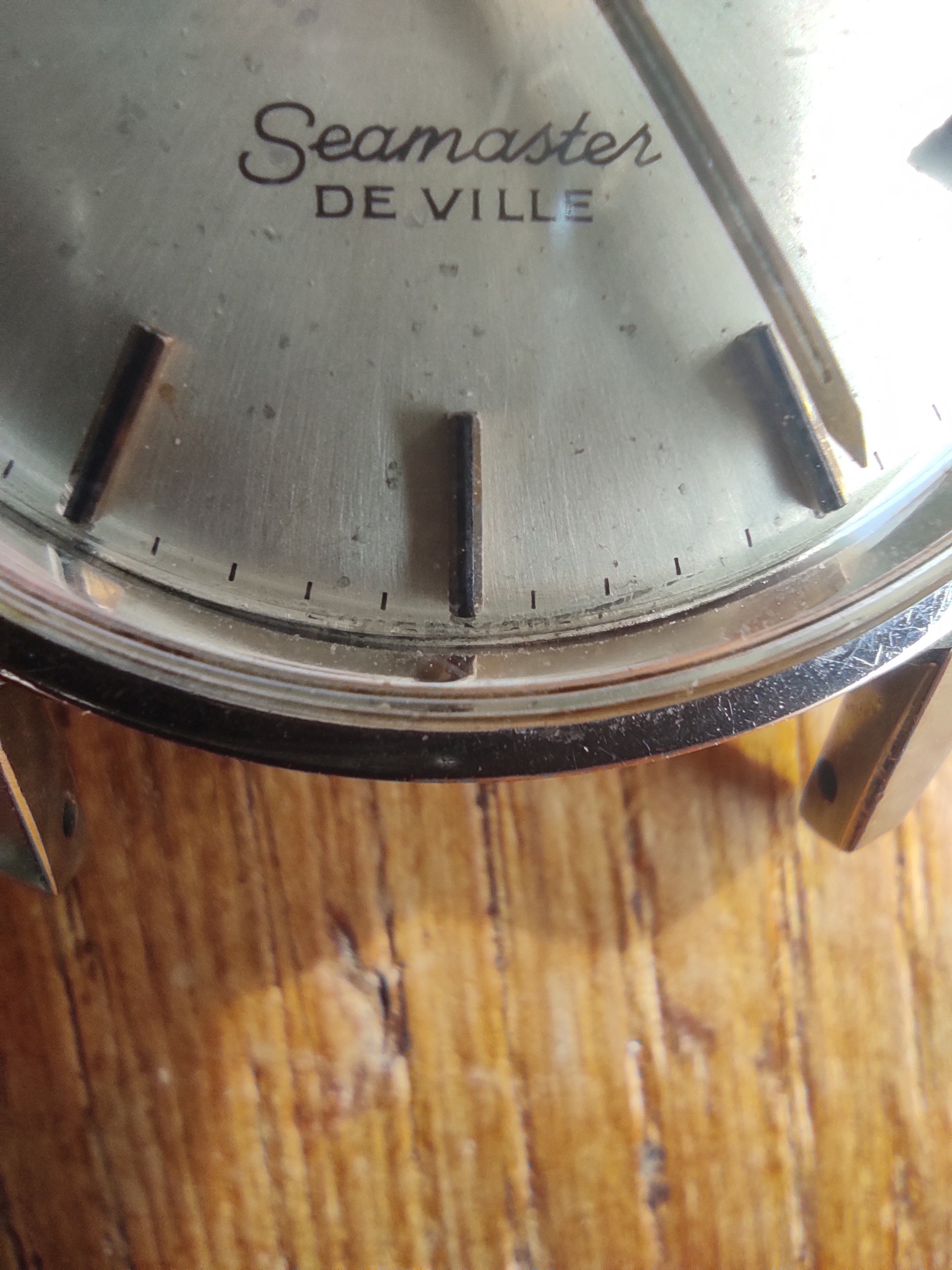

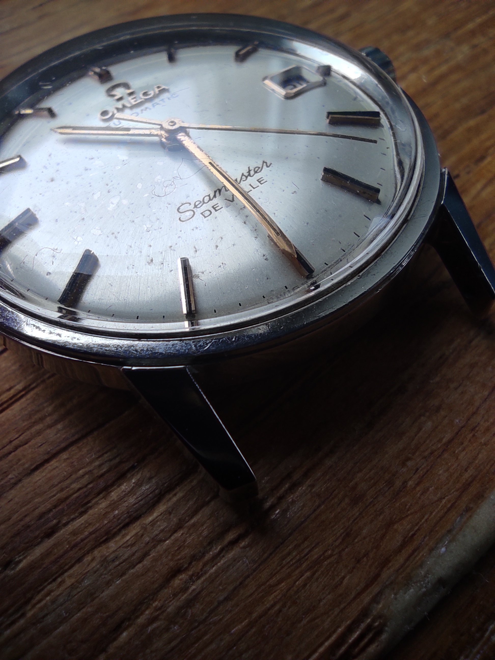

I would love to have your opinion about an Omega Seamsater de Ville which I just acquired. From the serial number on the watch caliber (cal. 562), it seems to have been manufactured in 1965. The crystal is not an original one, and it partially hides the "Swiss Made T" marking at six o'clock.
After doing some more research, like I should have before the purchase, certain details seem to be a little off. I bought the watch in a hurry since the market is relatively quiet here, and the seller had organized a limited time discount offer.

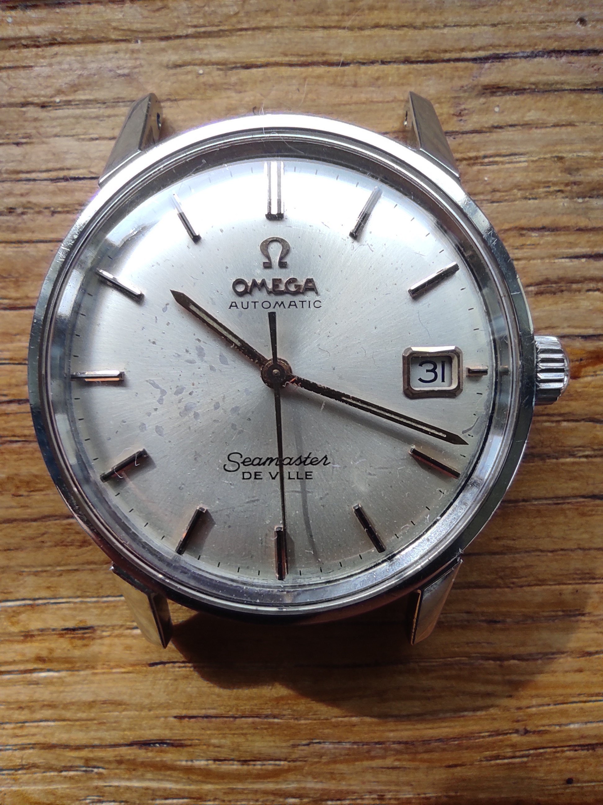

Here are the details which appear strange to me, pictures following. I know I should have done my homework before buying, but the excitement got the best of me...

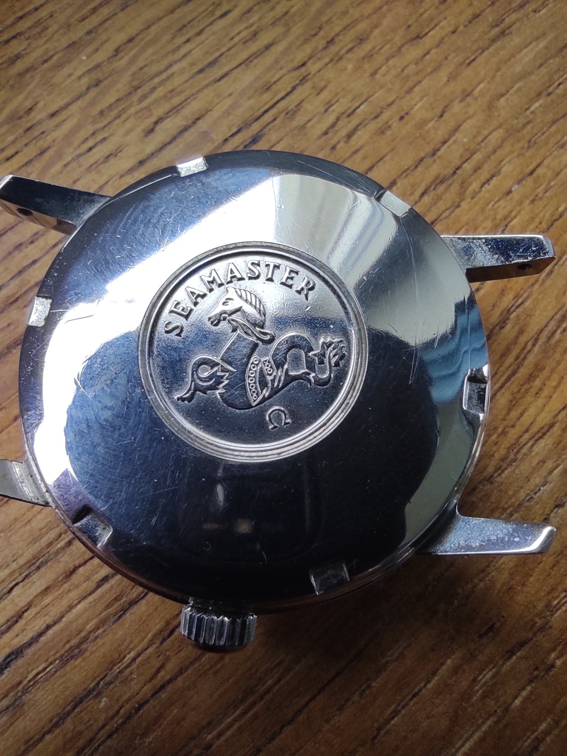

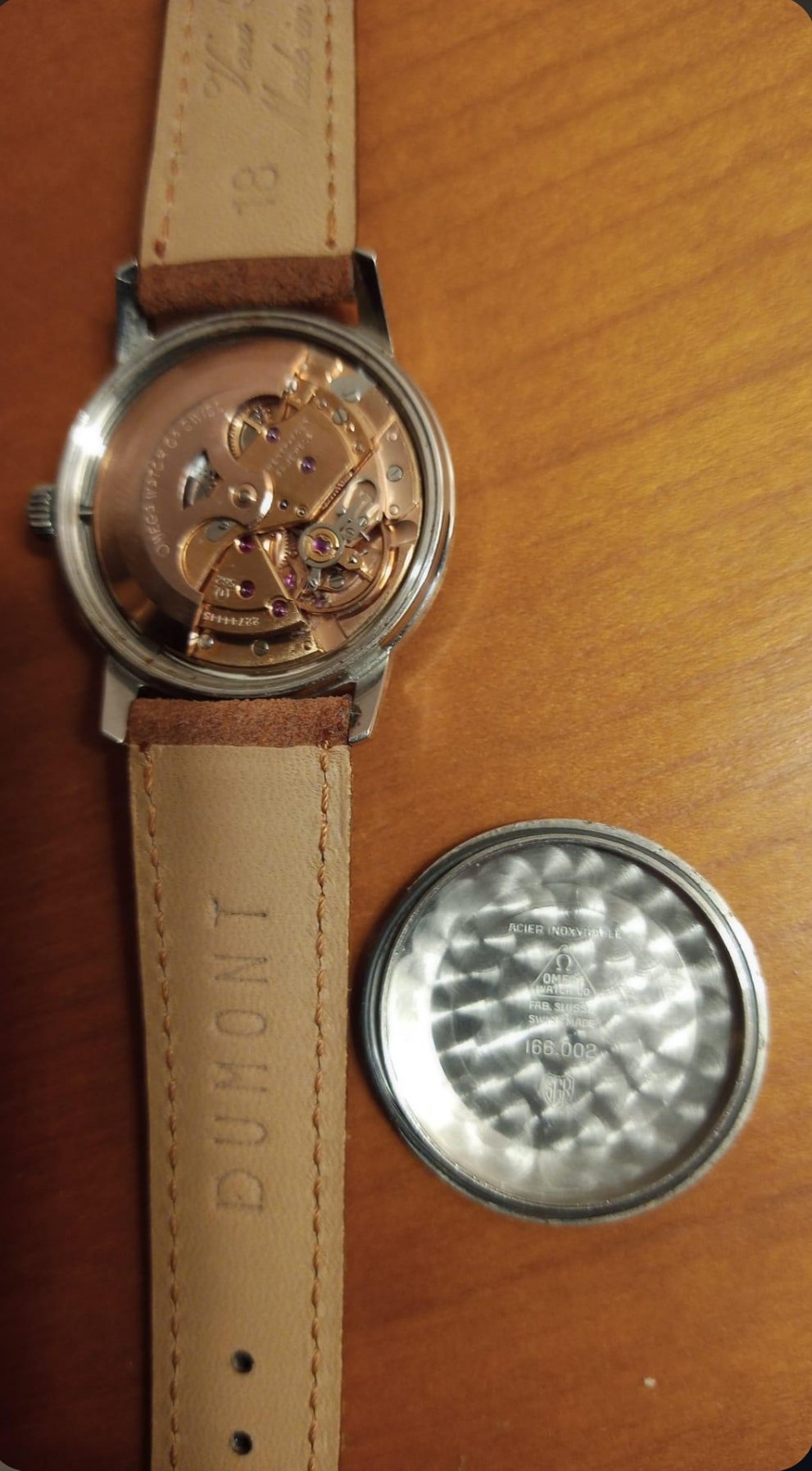

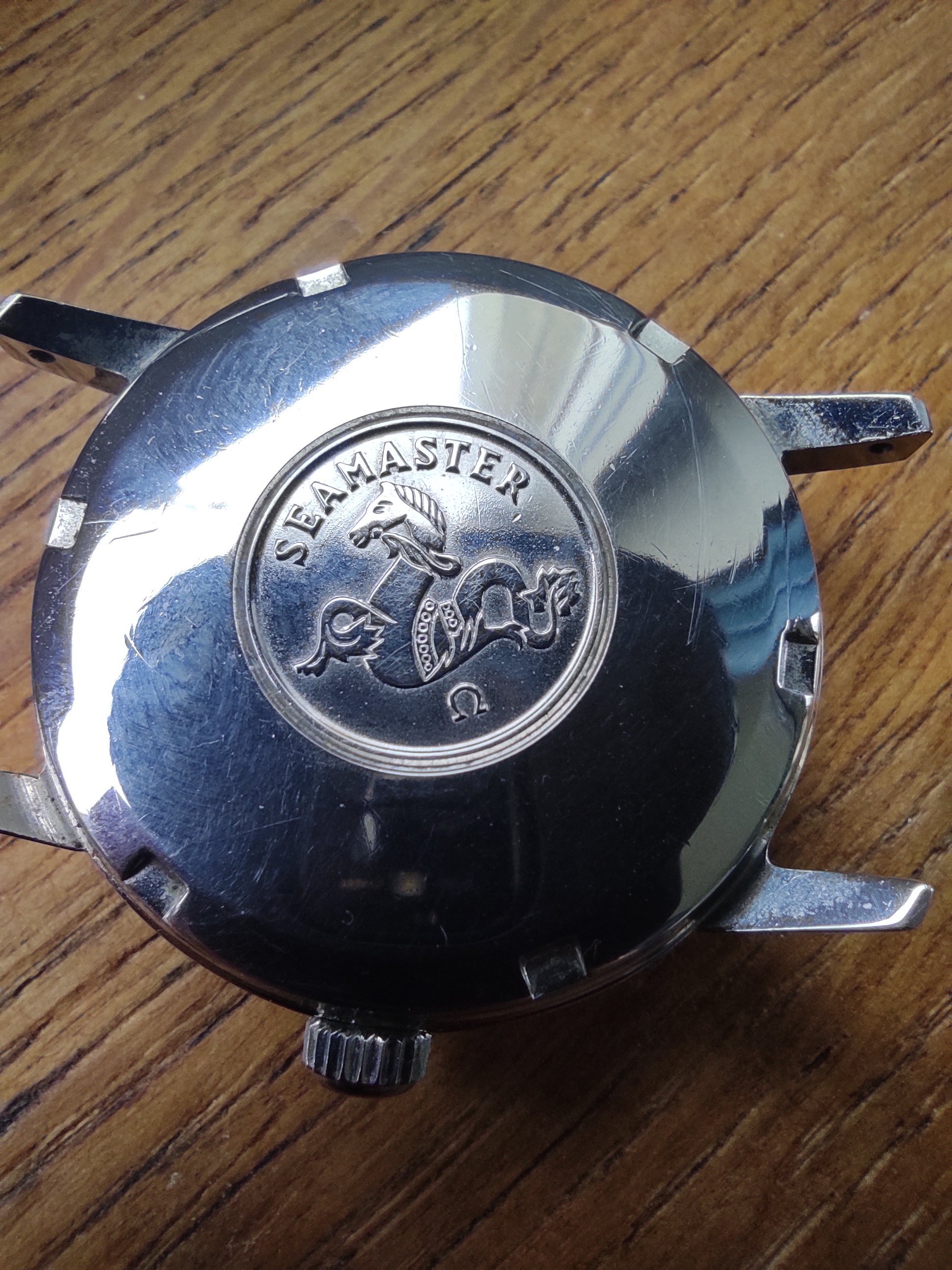

The watch has a screw-in back and not a monobloc / unishell case like all Seamaster de Villes I have seen online. Is it just unusual for a Seamaster de Ville, or completely impossible ? The back has the 166.002 reference code, and not 166.020 which is usually associated with the model.

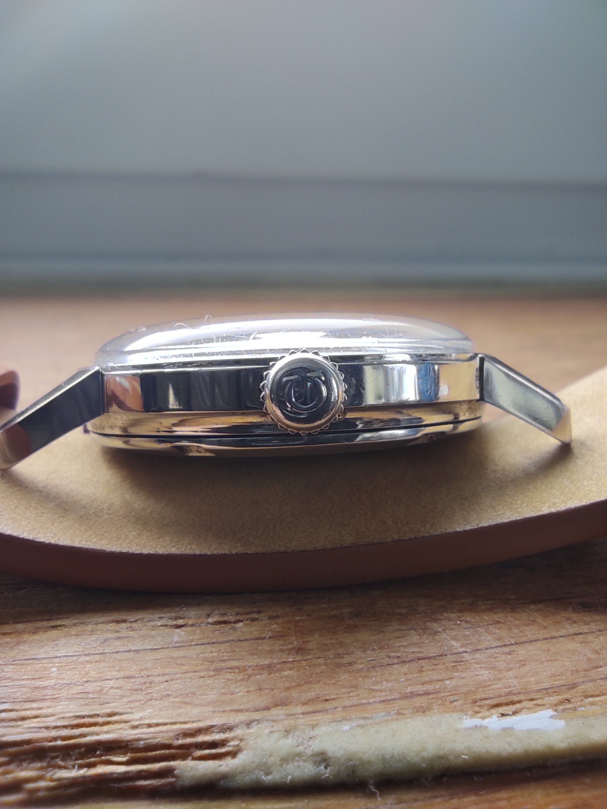

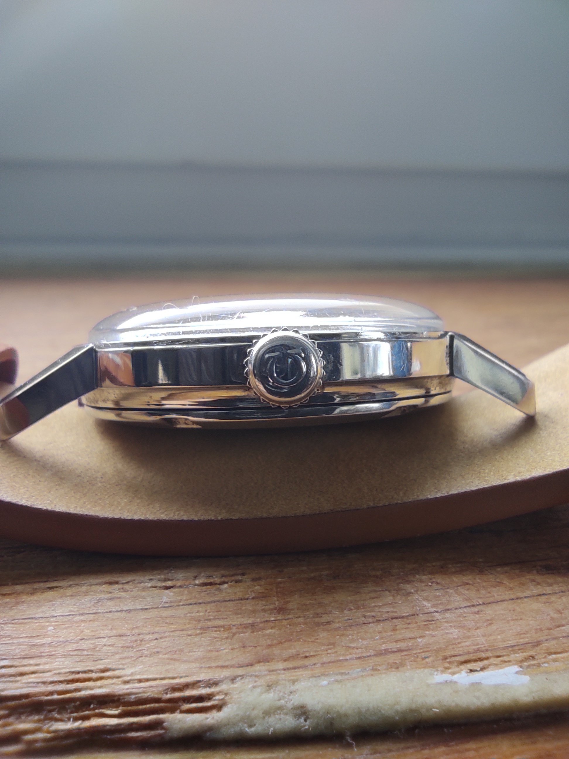

Then, the crown doesn't look like any other I have seen on a seamaster de Ville picture. It appears to be a genuine Omega part, but it seems too big for the ridge and the watch is hard to wind manually, even when it stopped.

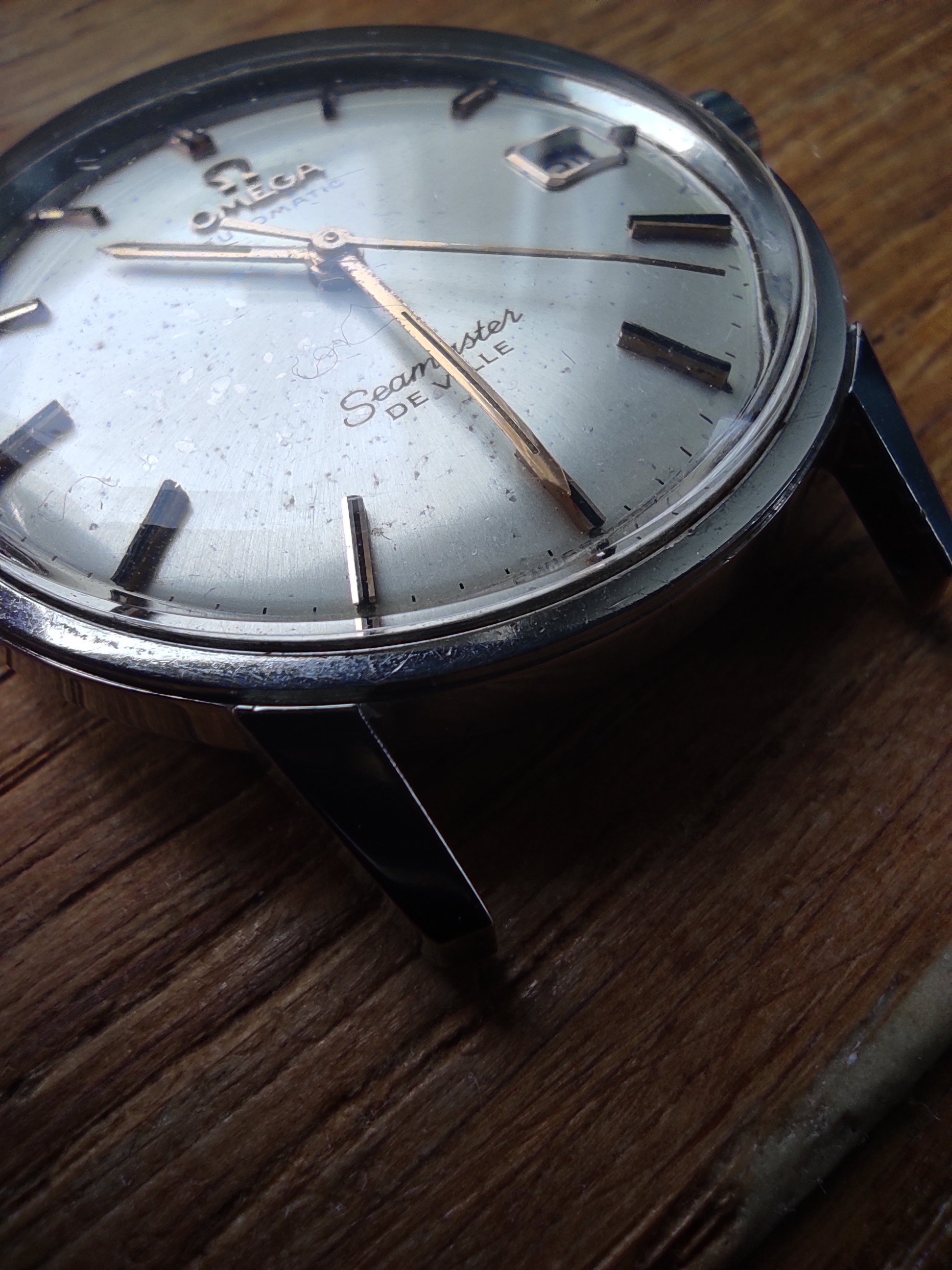

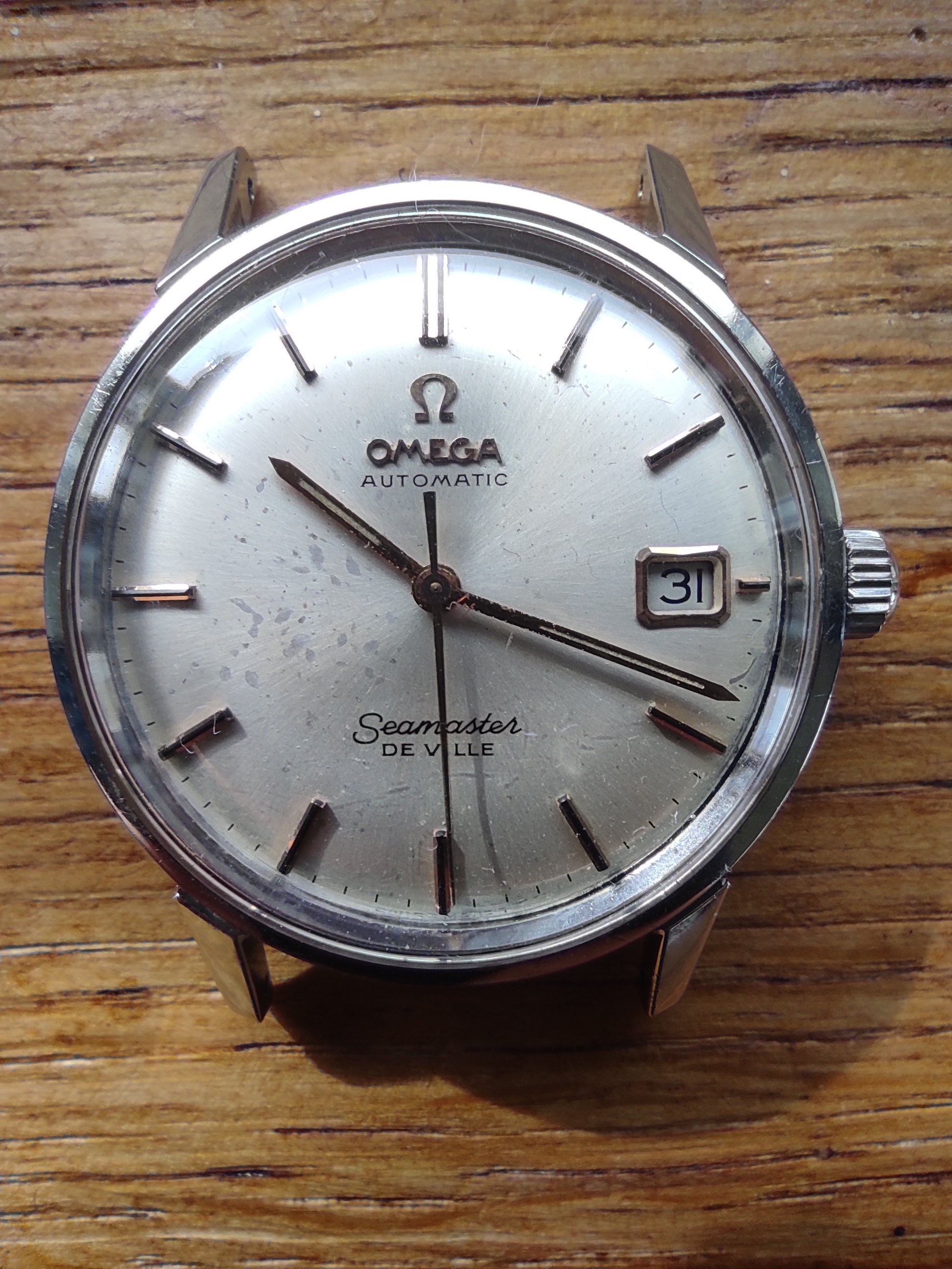

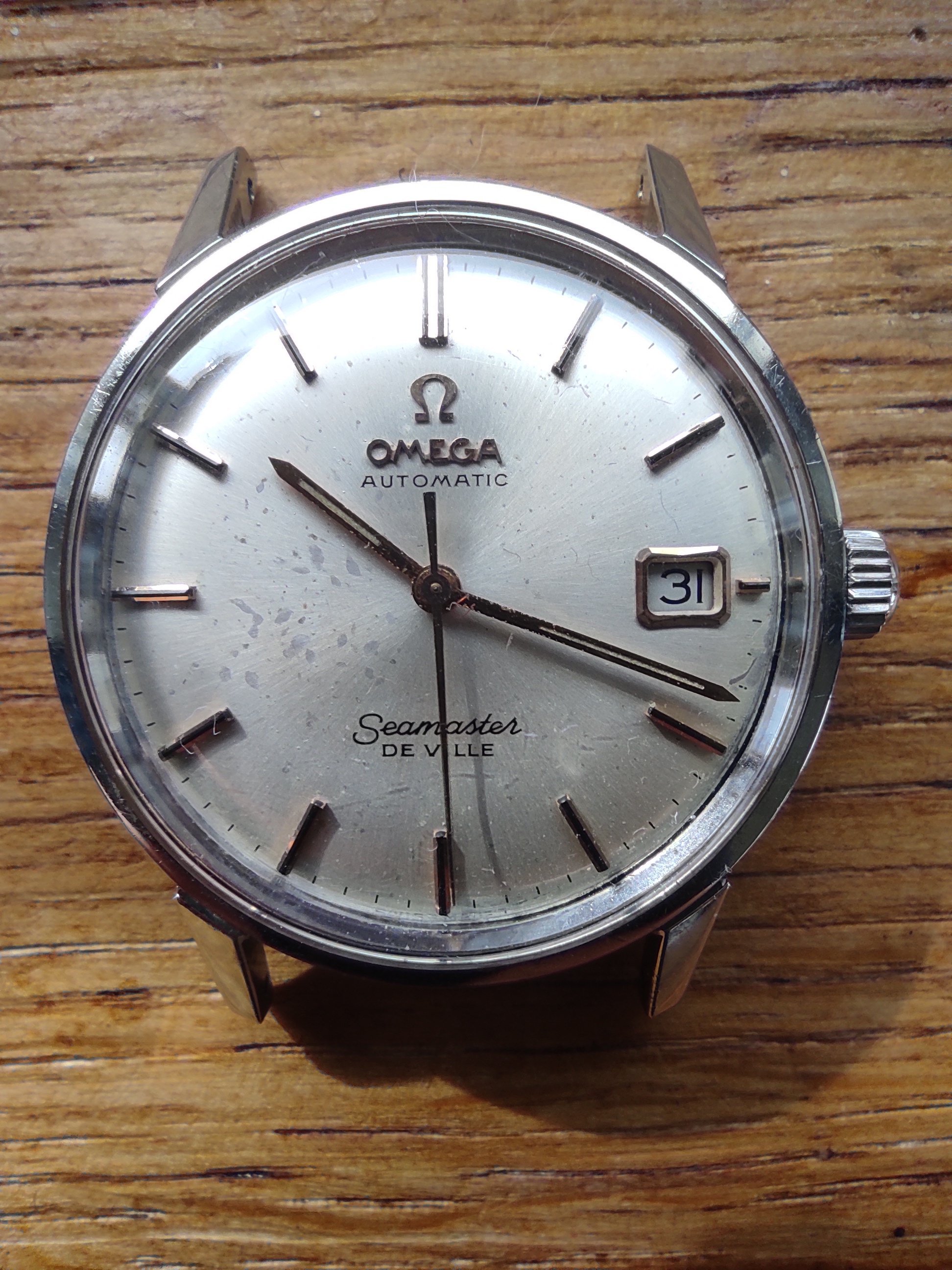

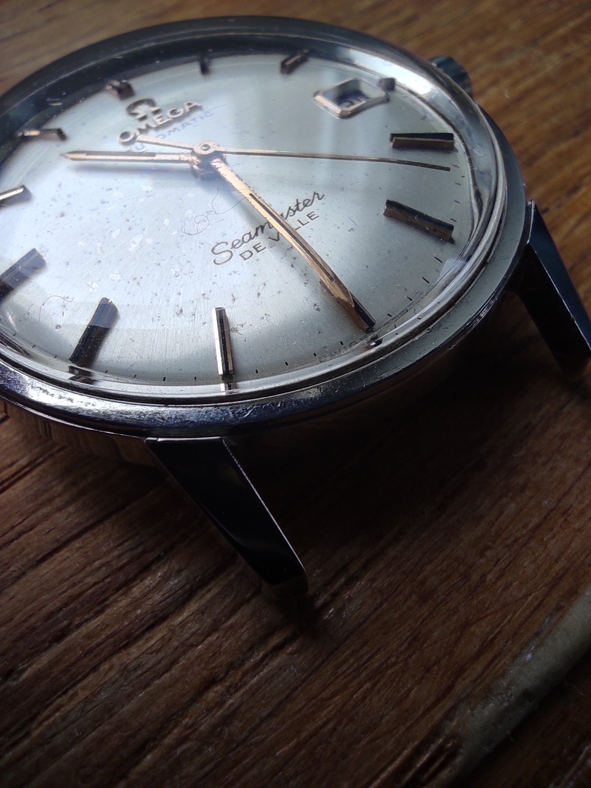

Finally, the hands and dial go well together in aesthetic terms, but I'm not sure these gold hands are usually seen with this gold and onyx index markers...
Thaks in advance for any advice, remarks or insight. I am new to this hobby and will certainly appear ignorant to you. I'm just hoping to get more knowledgeable in the future.

It’s a Seamaster DeVille movement and dial transplanted into a 166.002 case.
7
Thanks for the quick answer Davidt ! That's what I suspected but the seller denied it vigorously...
So the movement, dial and hands may be original, but the case isn't ? Could it be just the back, or is it the whole case ? Are the hands original or salvaged from another watch.

The case back and mid/main case are correct for a 166.002.
Hands look like they are original to the dial.
It’s impossible to know whether the movement is original to the dial or case as the 562 came in both the 166.020 and the 166.002. An extract from Omega could confirm but a) they’re not currently available and b) it’s costs £100 and it wouldn’t be worthwhile spending that on this watch.
I’d return it if you can unless it was say £150.

What about the crown ? Does it look original to you ?
Could I maybe get a New 166.020 case on the cheap ? Or maybe a replacement seamaster dial ?
Being stuck with the watch (wich runs rather accurately at -8s/day, IS there anything I can do to minimize the loss ?

Crown isn’t correct for either ref. It’s likely service replacement.
How much did you pay? Personally I wouldn’t throw good money after bad. I’d use this as a daily beater and put additional money towards finding a better example

Given the condition of the dial, I would not invest any more time and energy into restoring this watch.
