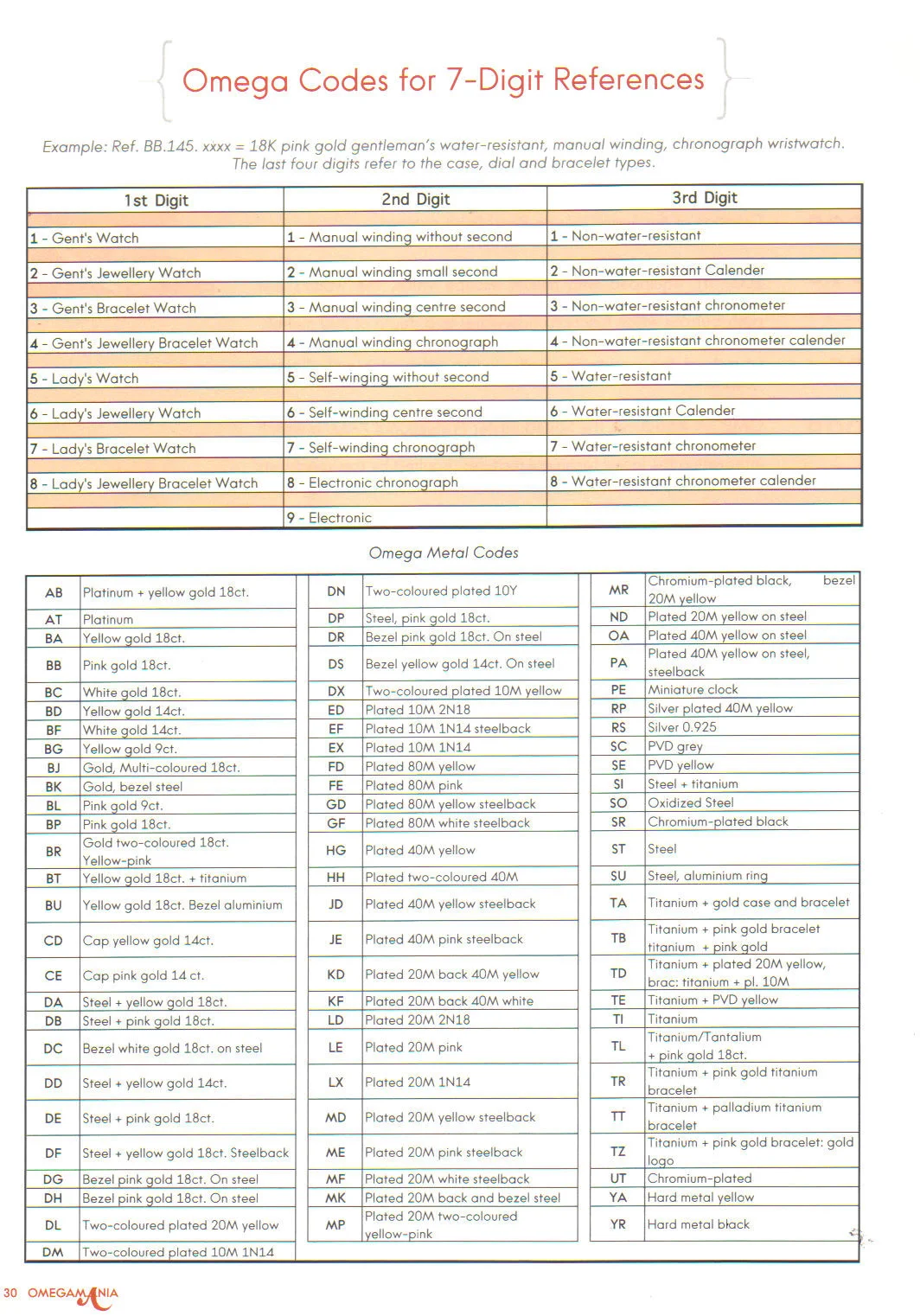

Due to the heavy taxes and importation fees imposed by some countries on precious metals, Omega and many other watchmakers had cases made of precious metals manufactured directly in several countries by local manufacturers.
SMDV Swiss references:

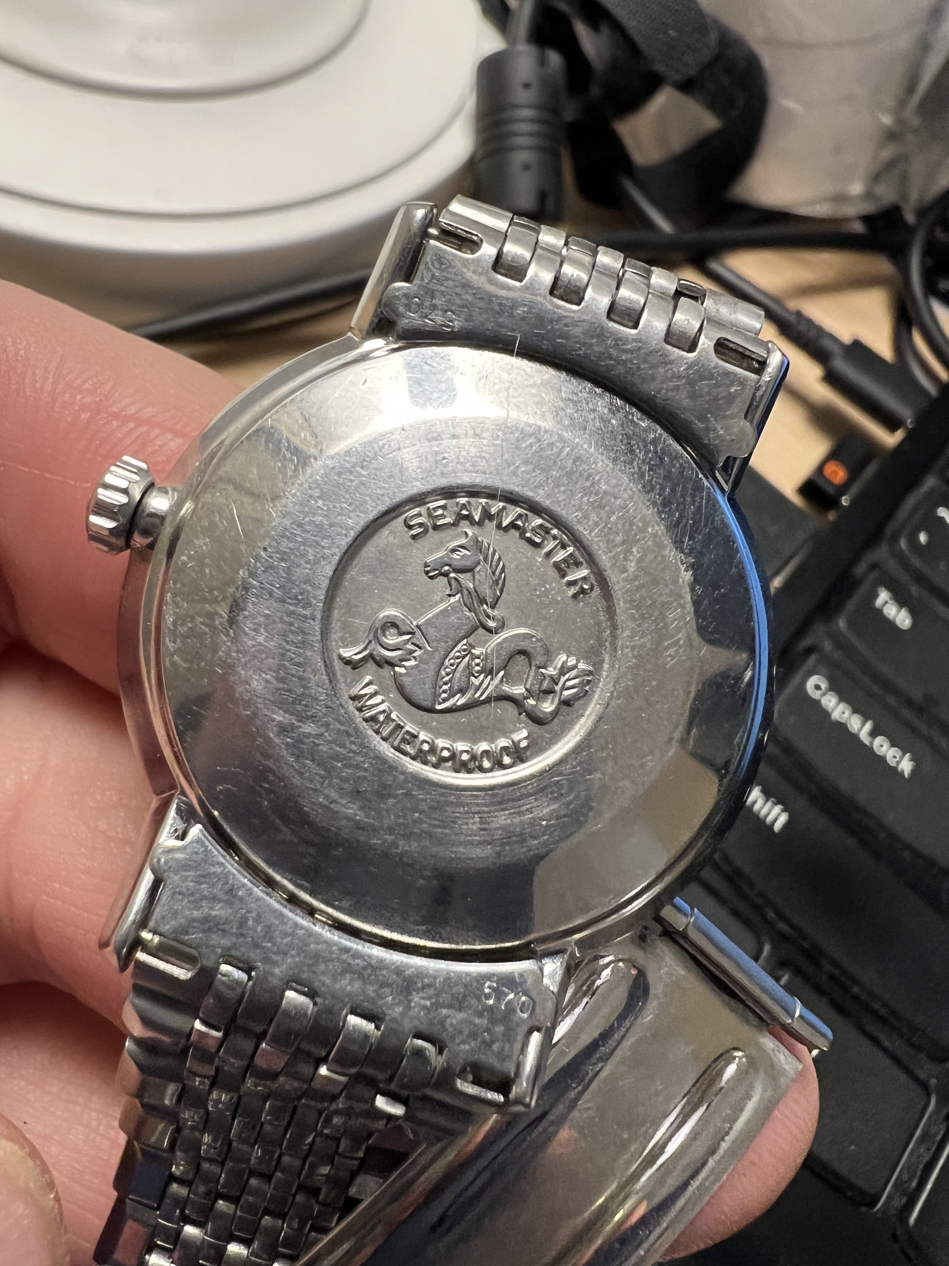

Bracelets and end links
Proper end links for Omega Seamaster de Ville watches should be #70 or #570. They are the same product but with different reference numbers.

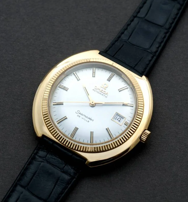

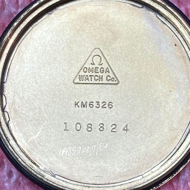

The unusual reference KM 6326

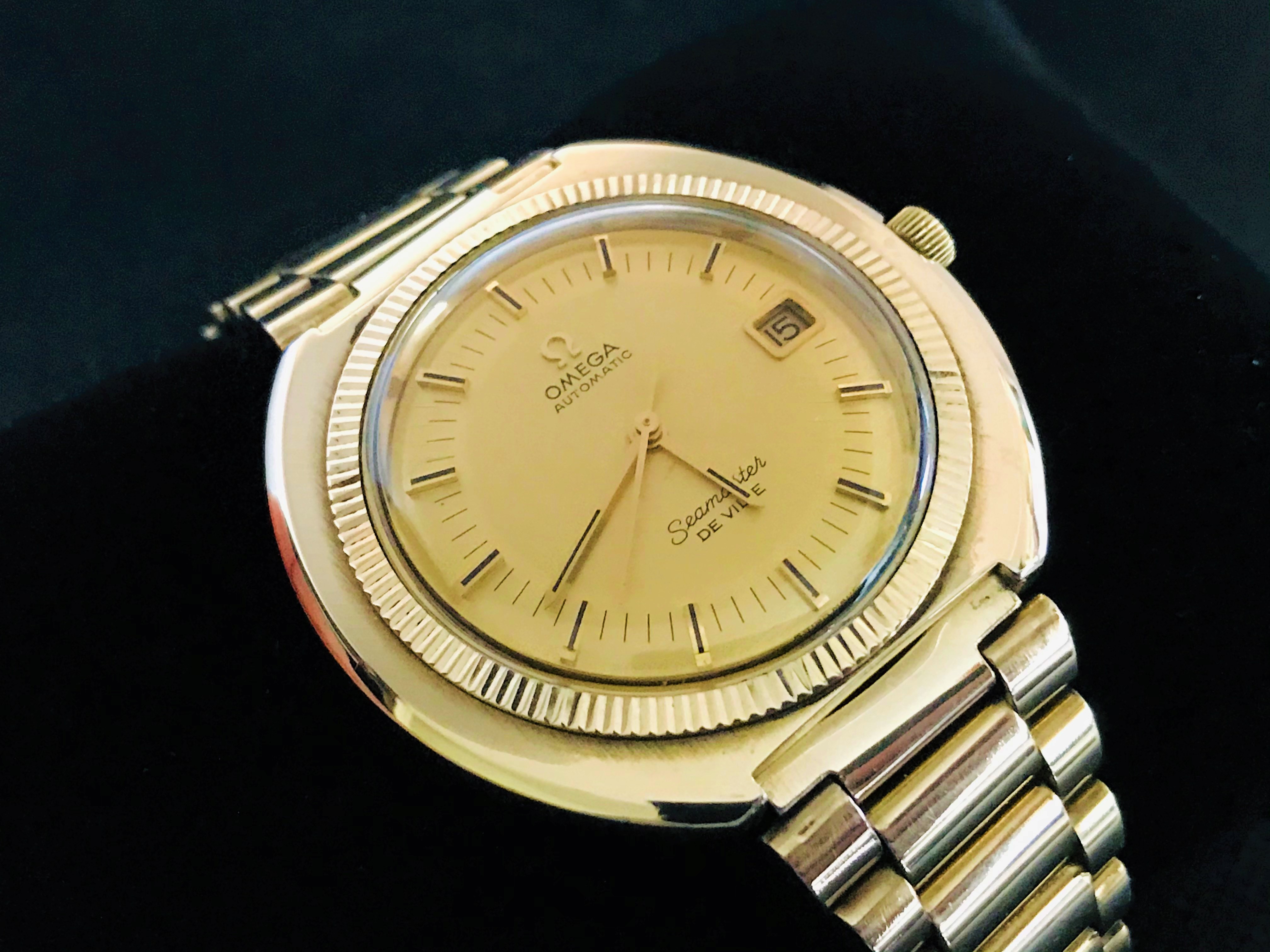

Introduced in the US catalogue in the late 1960's, reference KM 6326 features a different case design than the usual unishell case featured in other Seamaster de Ville watches, with an oval-shaped gold filled case housing the Omega calibre 563, and a fluted bezel. The correct reference for the 14K gold filled bracelet for that model is #9804.

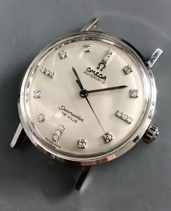

Special dials
The Omega Seamaster de Ville featured many special dials, mainly (but not only) on American references. Special dials were meant to take this model a bit further and are getting more and more sought after. The more common ones on SMDV watches are the linen, the clamshell, the cross and the sector but the most famous and sought after certainly is the Don Draper.
More on special dials here

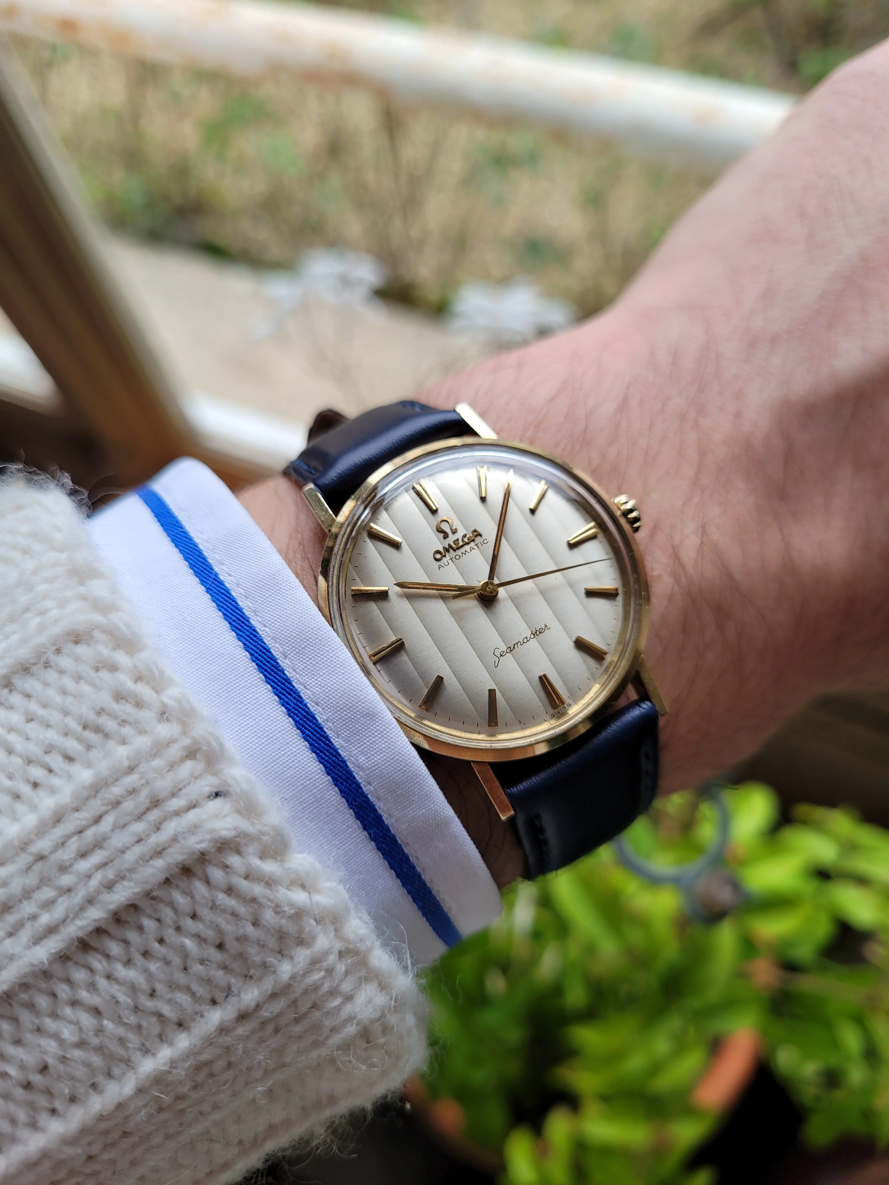

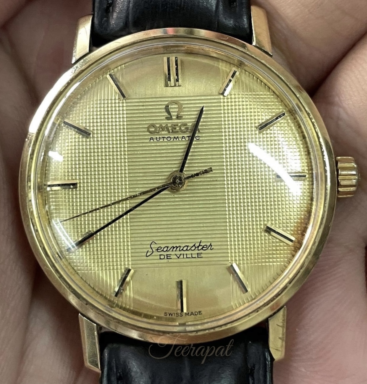

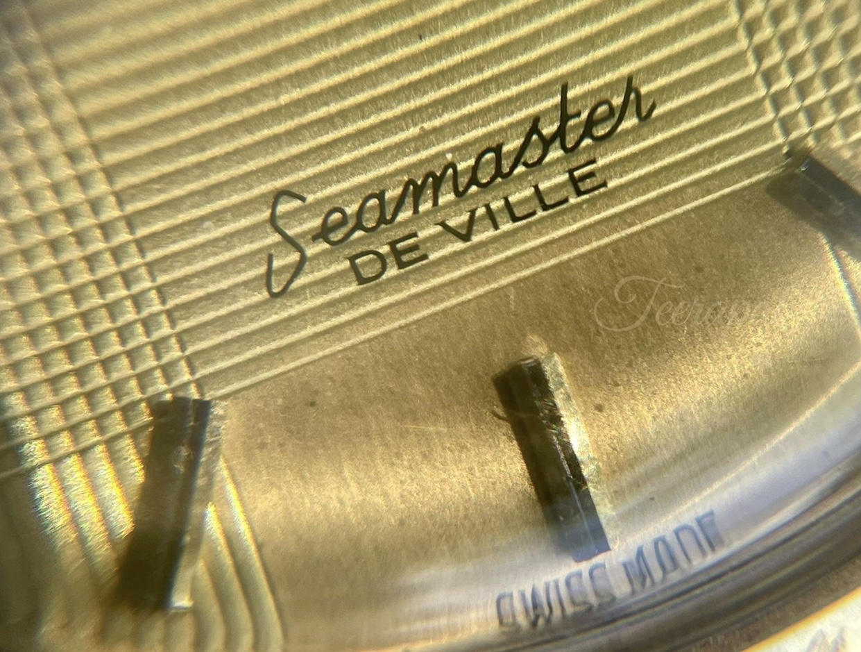

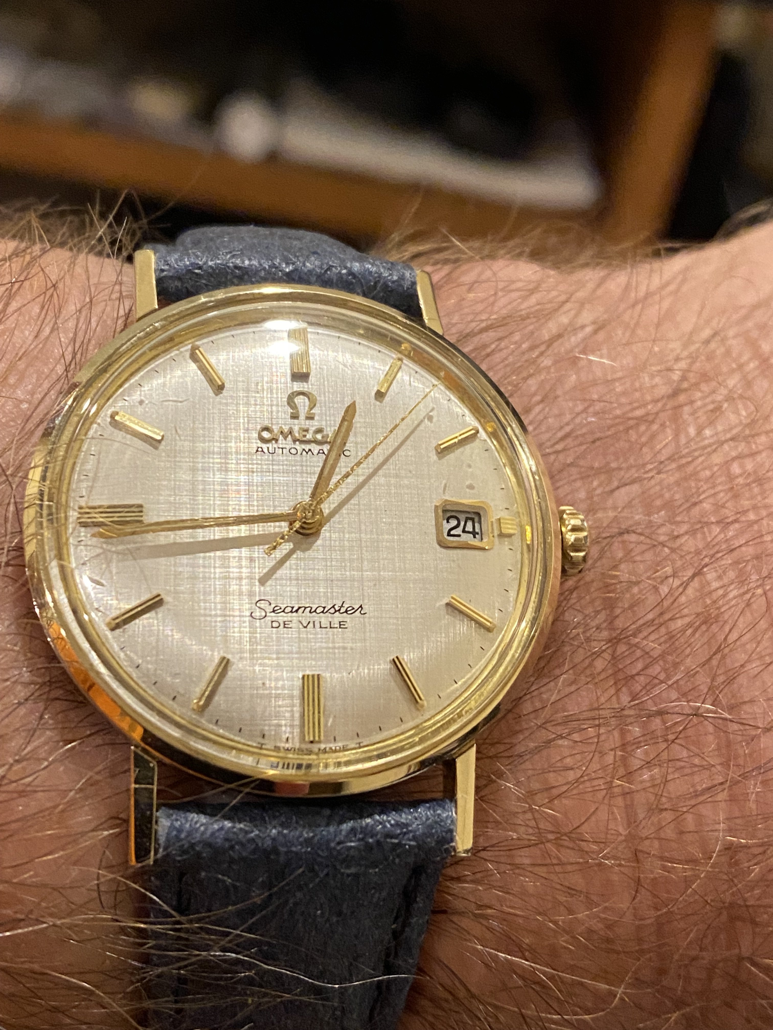

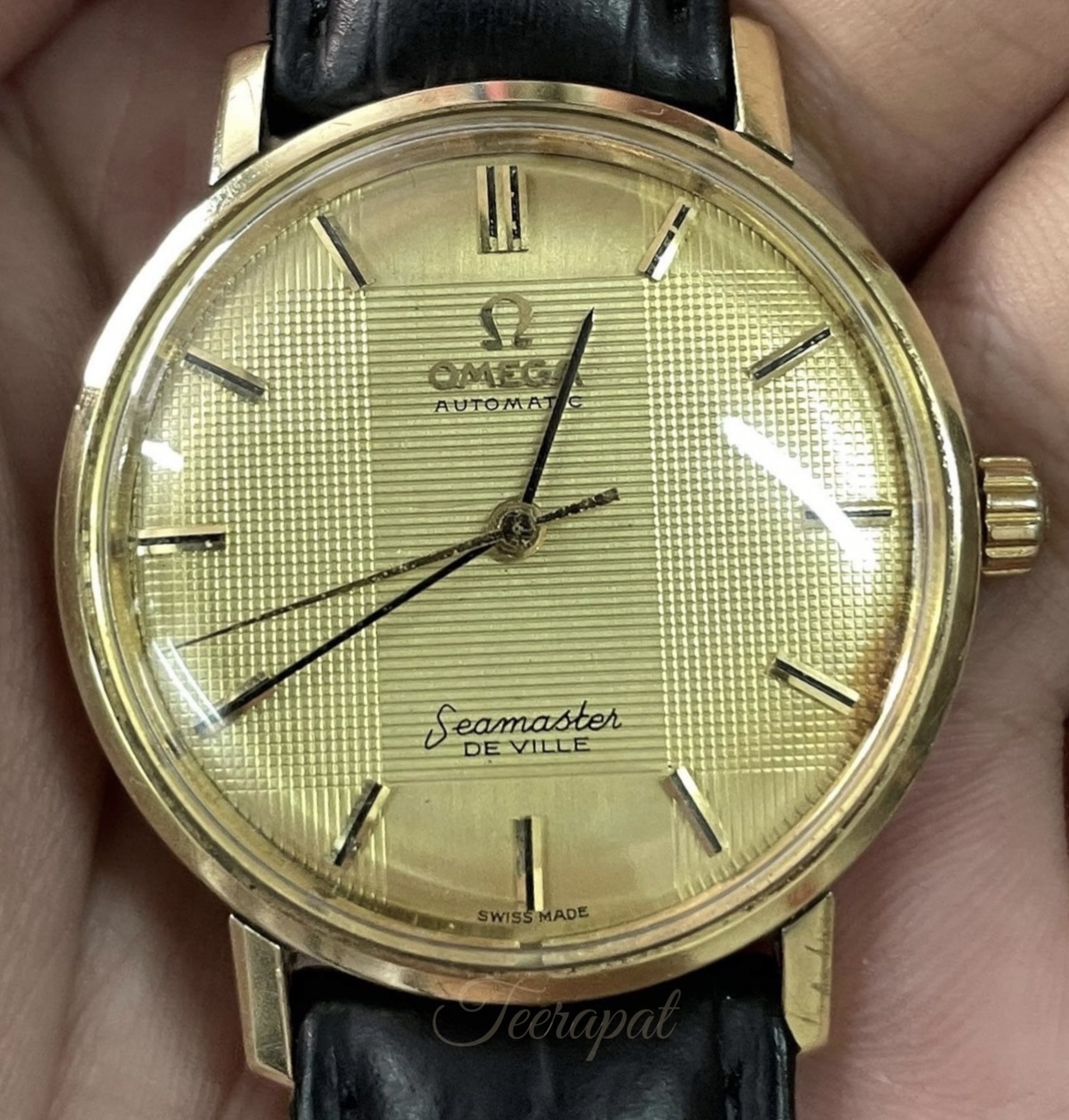

Here’s my KM 6068 with linen dial. Thanks for writeup on the history of the model!

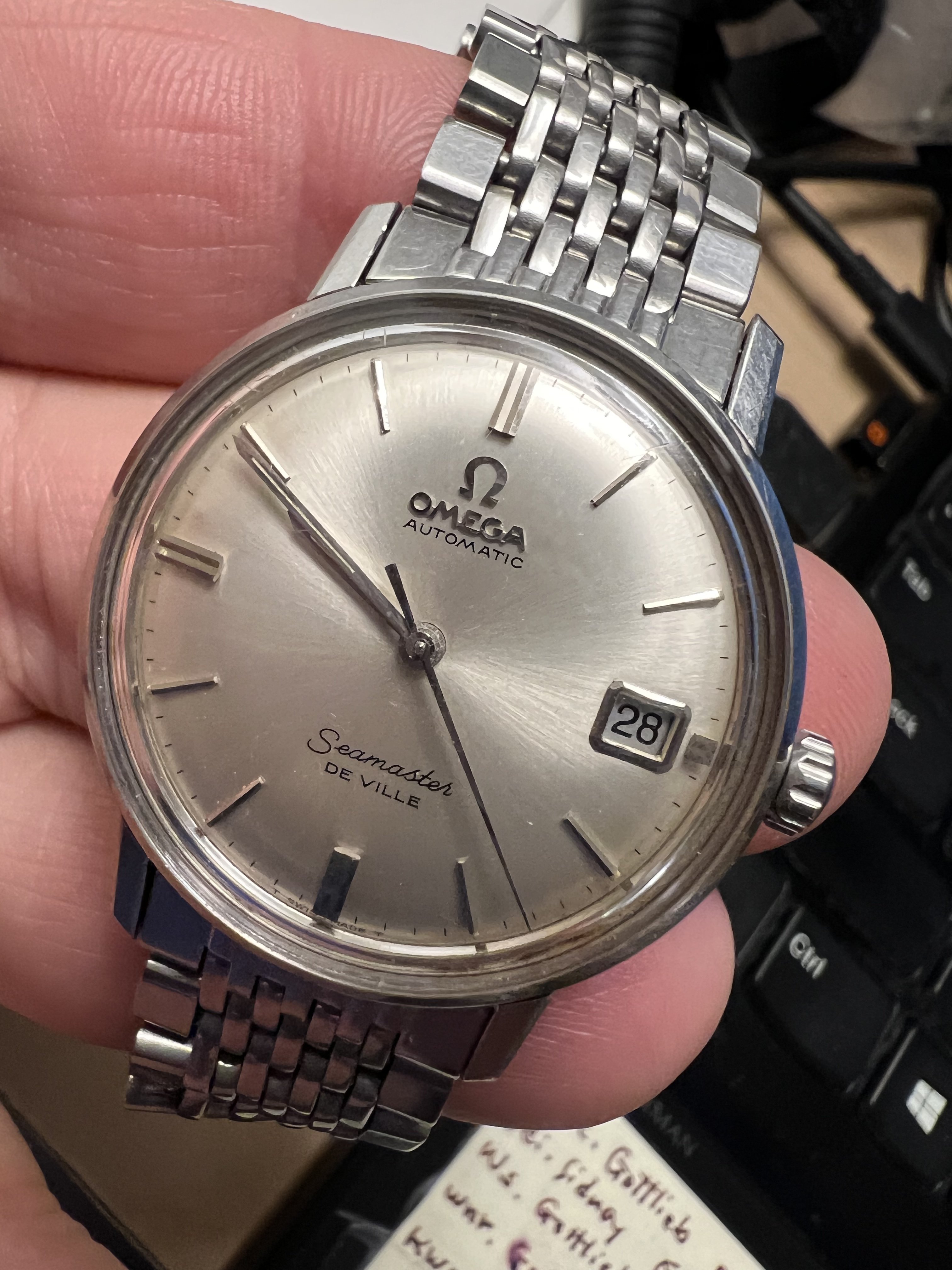

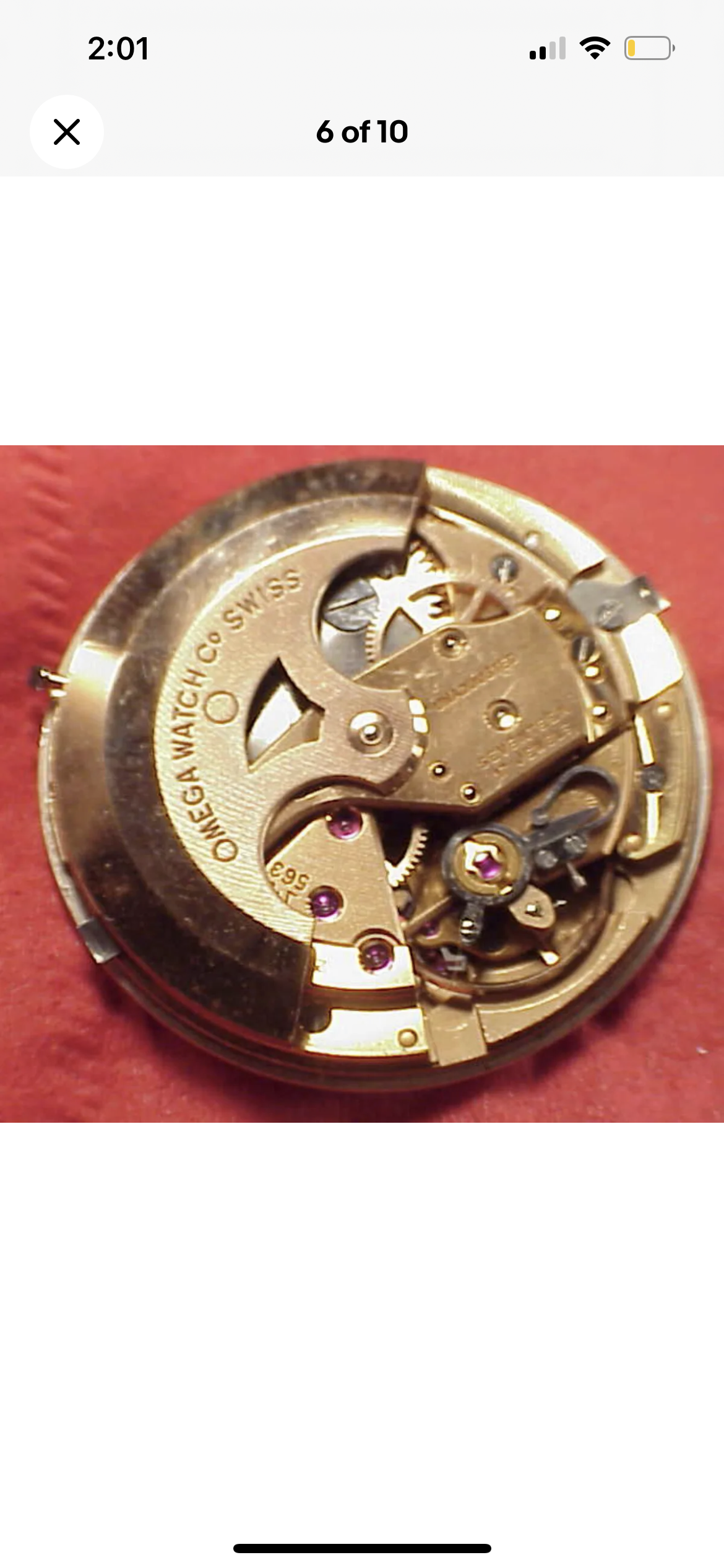

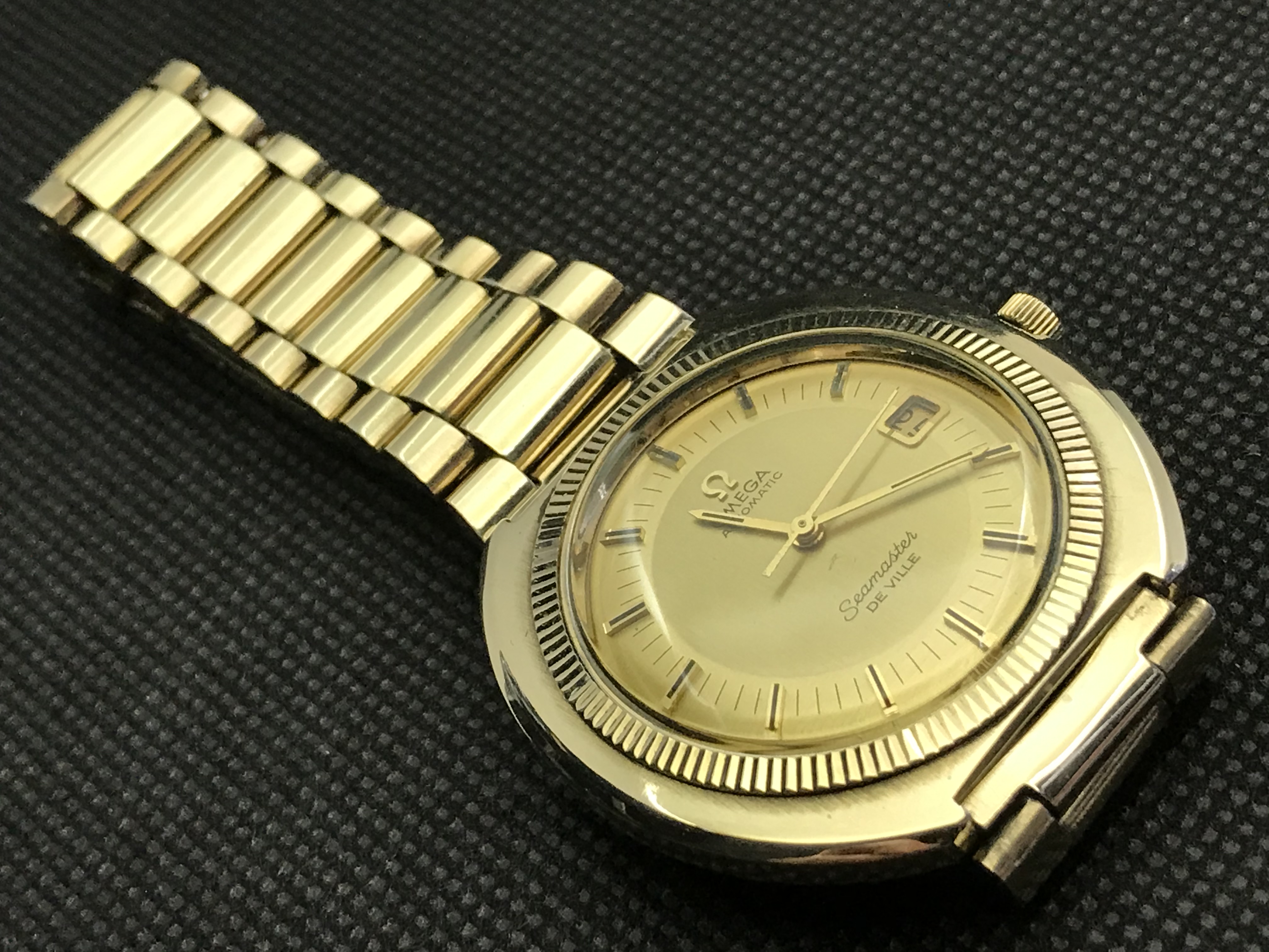

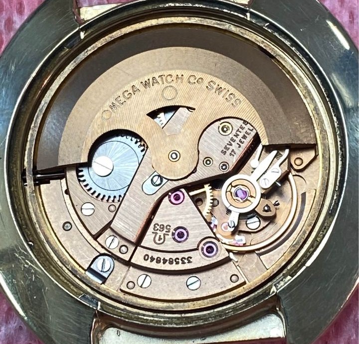

Here is mine. I don't have any model/movement info unfortunately. It does have its original crown and a nice sharp case

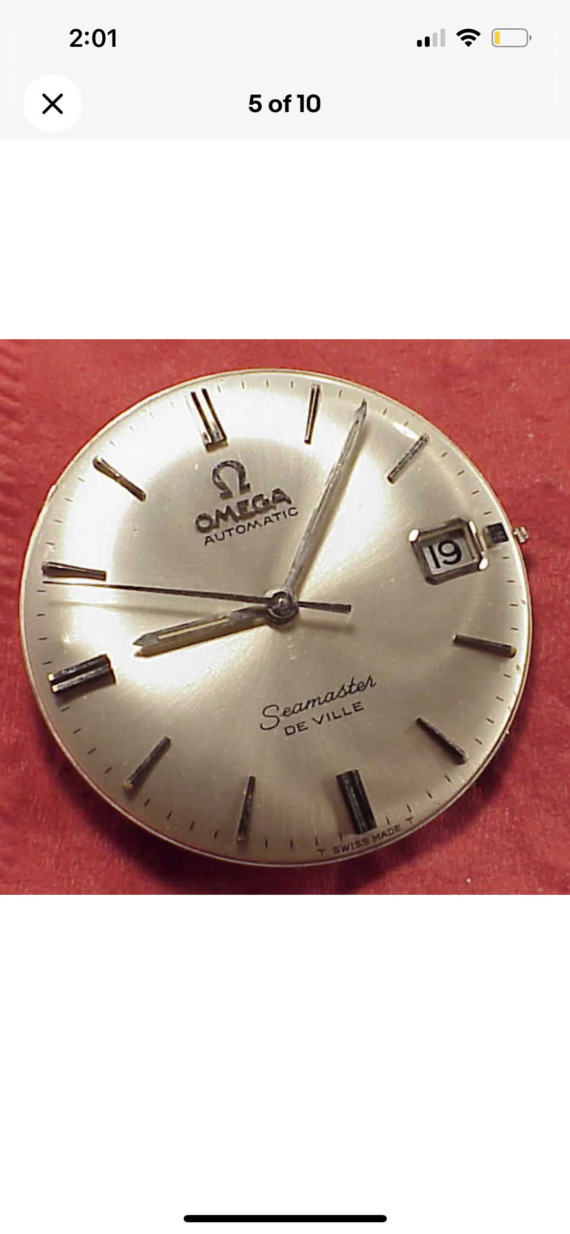

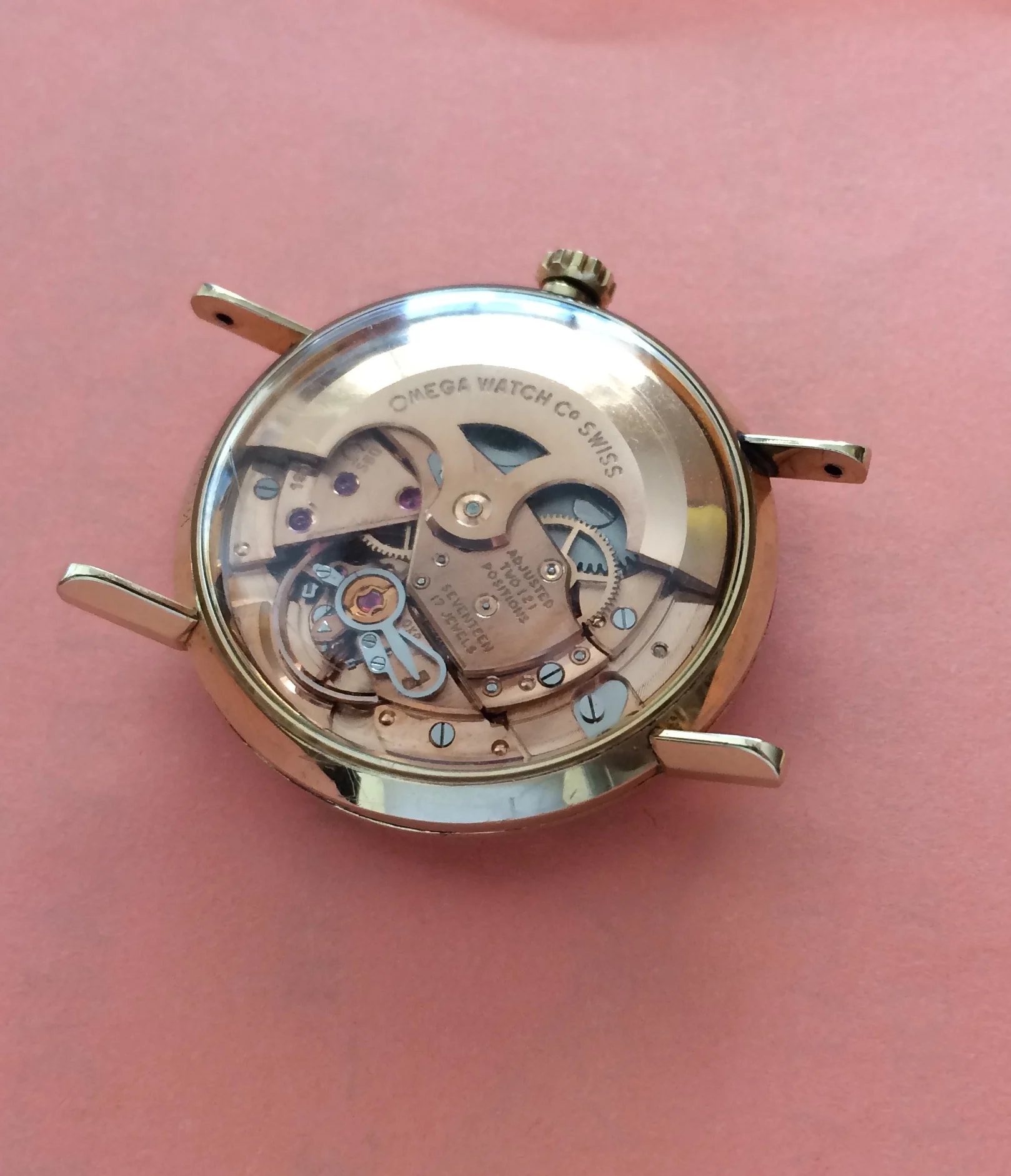

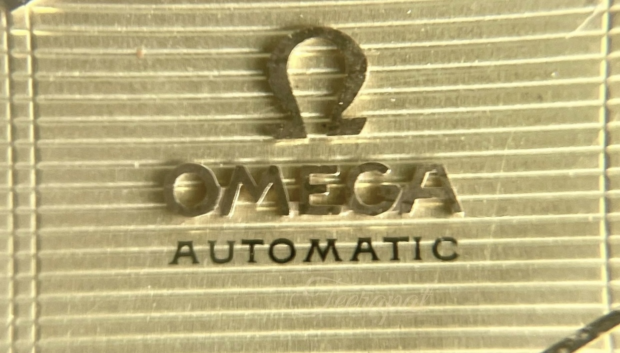

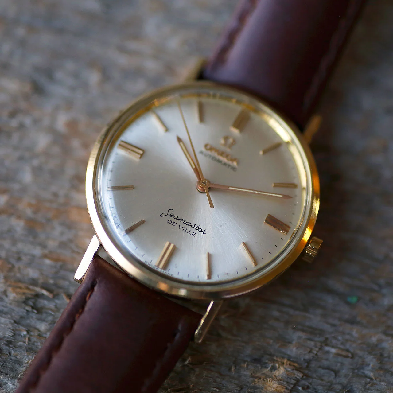

166.020. 😀

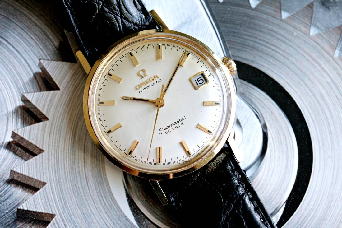

Here’s my 1968 166.020 cal 563 EB find couple yrs ago 570 endlinks on BOR

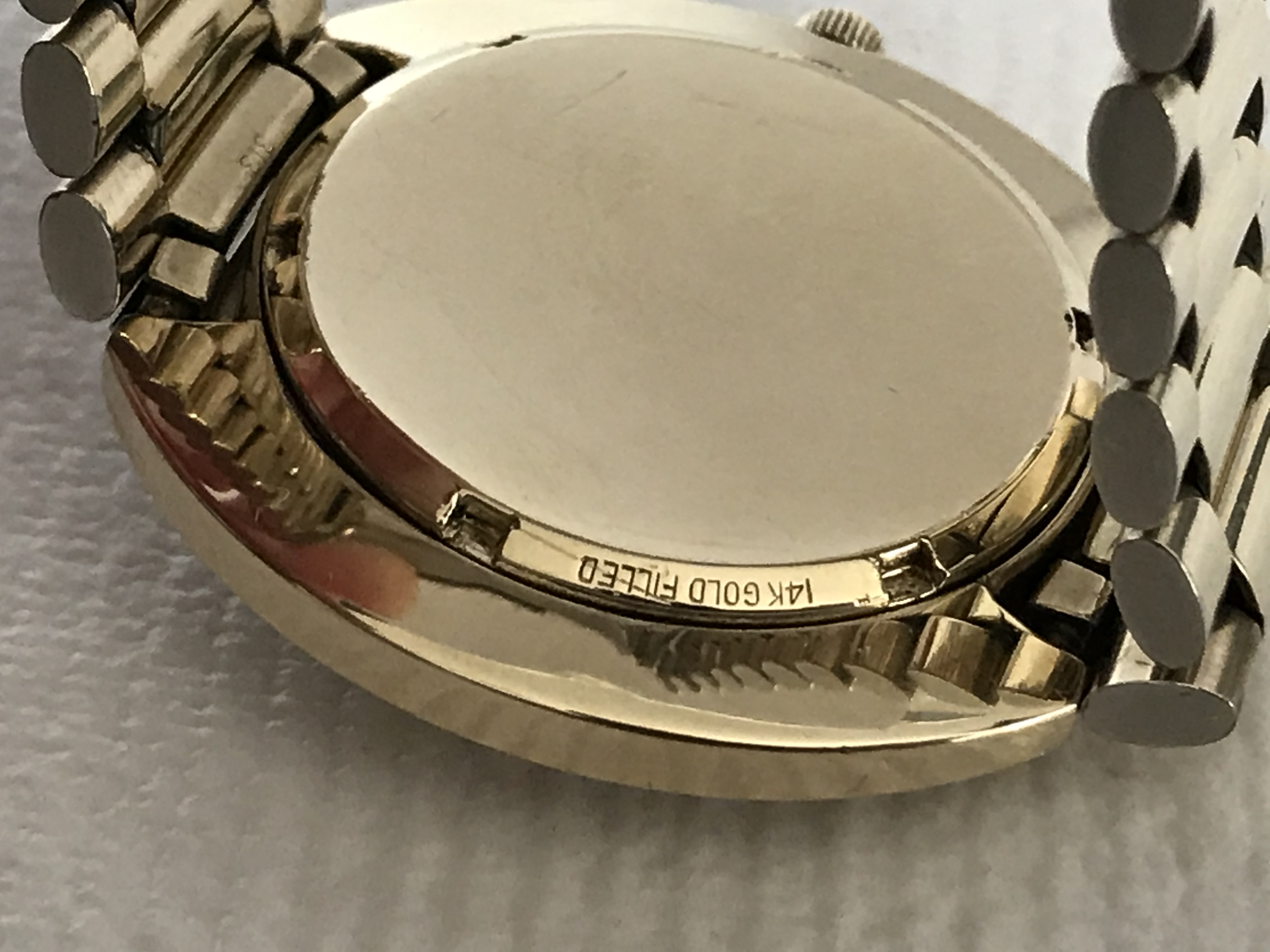

A more unusual American SMDV KM6326 cal 563 from 1971. 14k GF. Also has 108.324 on inside Caseback

Reference added to the main post, thank you!
