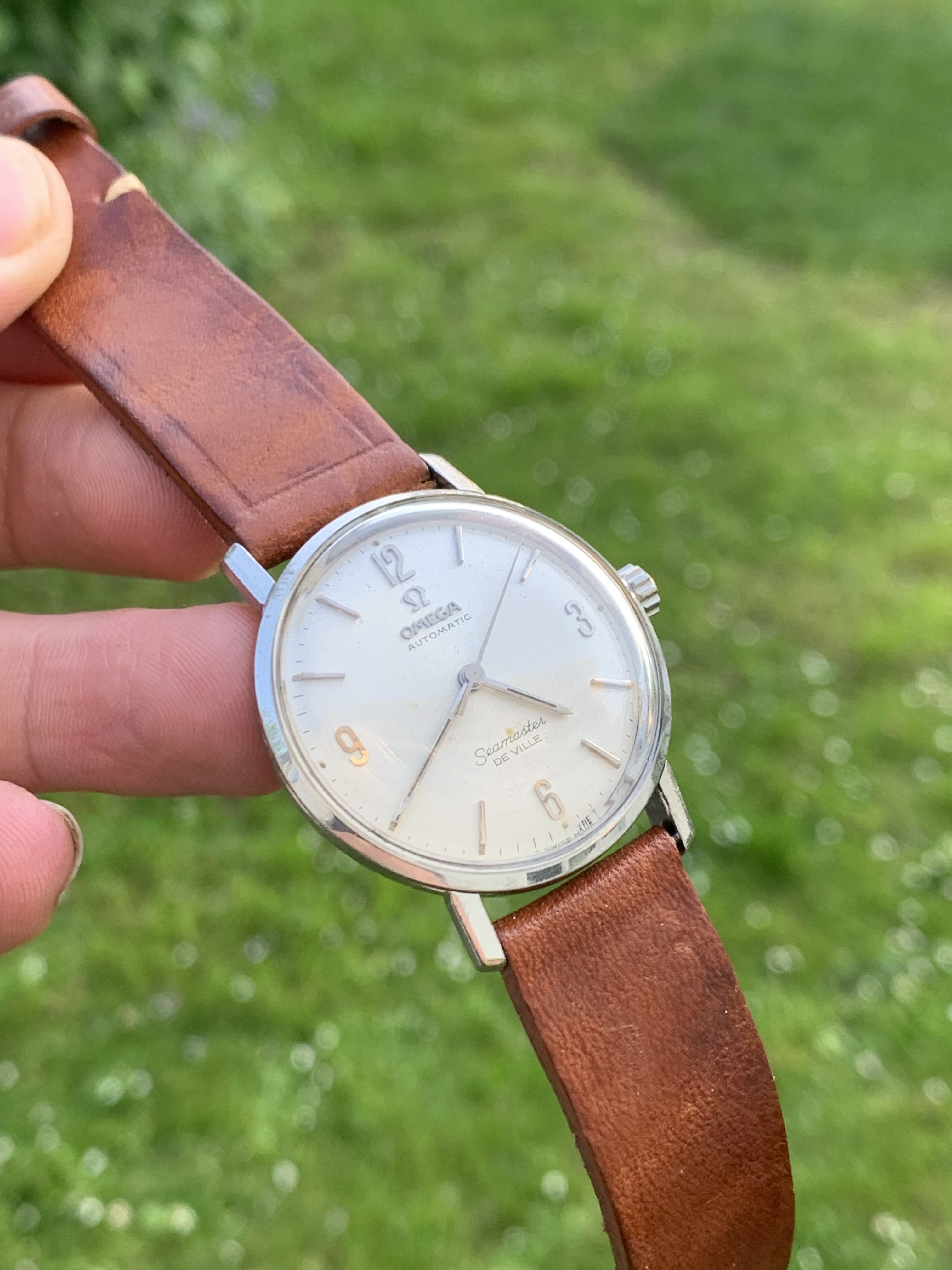

My rather special ( well to me anyway ) 165.020
1,452
3,023
Here’s my 165.020 also with a somewhat unusual dial, not yet shown above under this reference… 😀

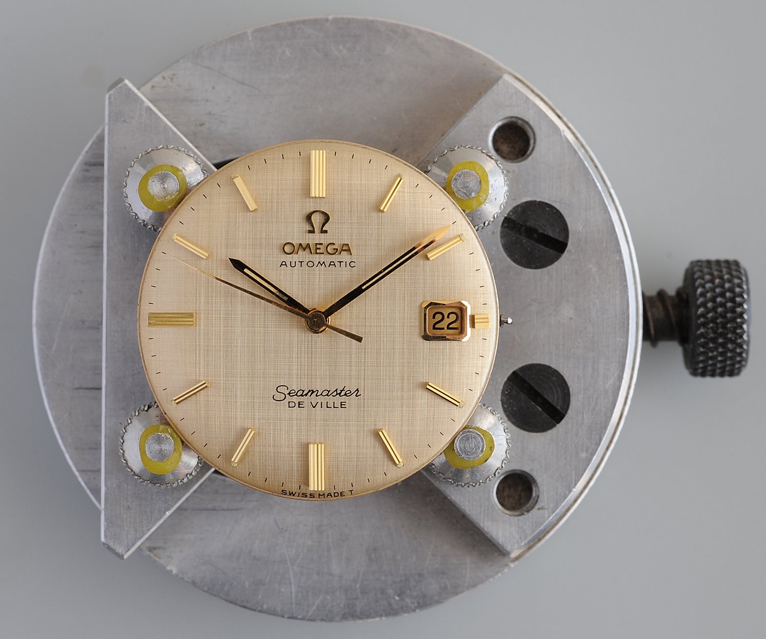

3,651
7,766
Here is the dial of a US market ref. KL6292 (goldfilled) SMDV with the well known linen finish but with only one "T" for tritium.
Has a cal 560 and keeps time within few seconds/24h which is amazing for a 60 years old watch...

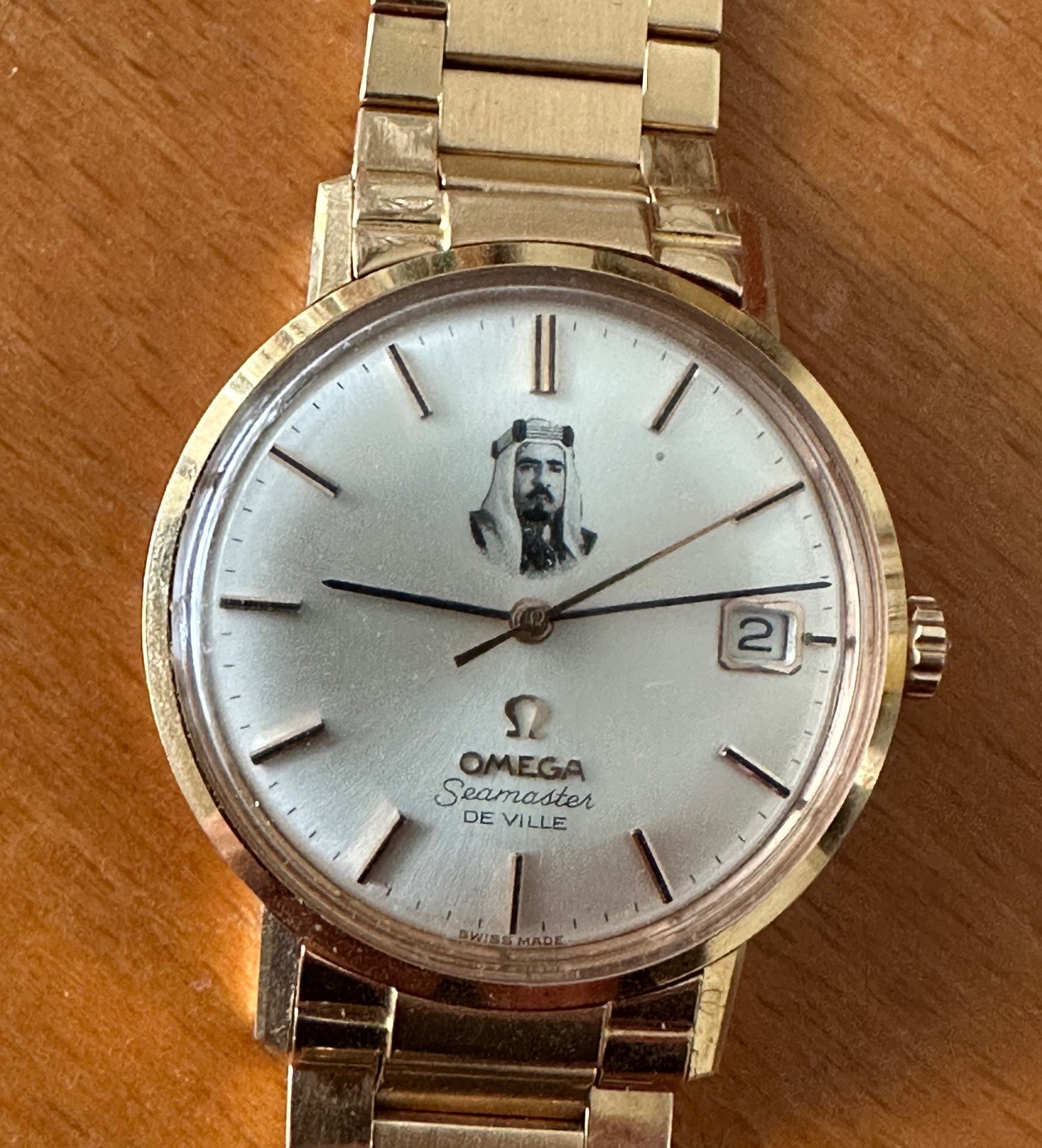

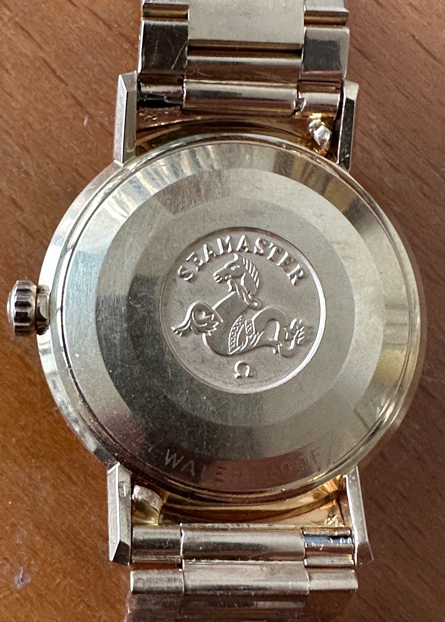

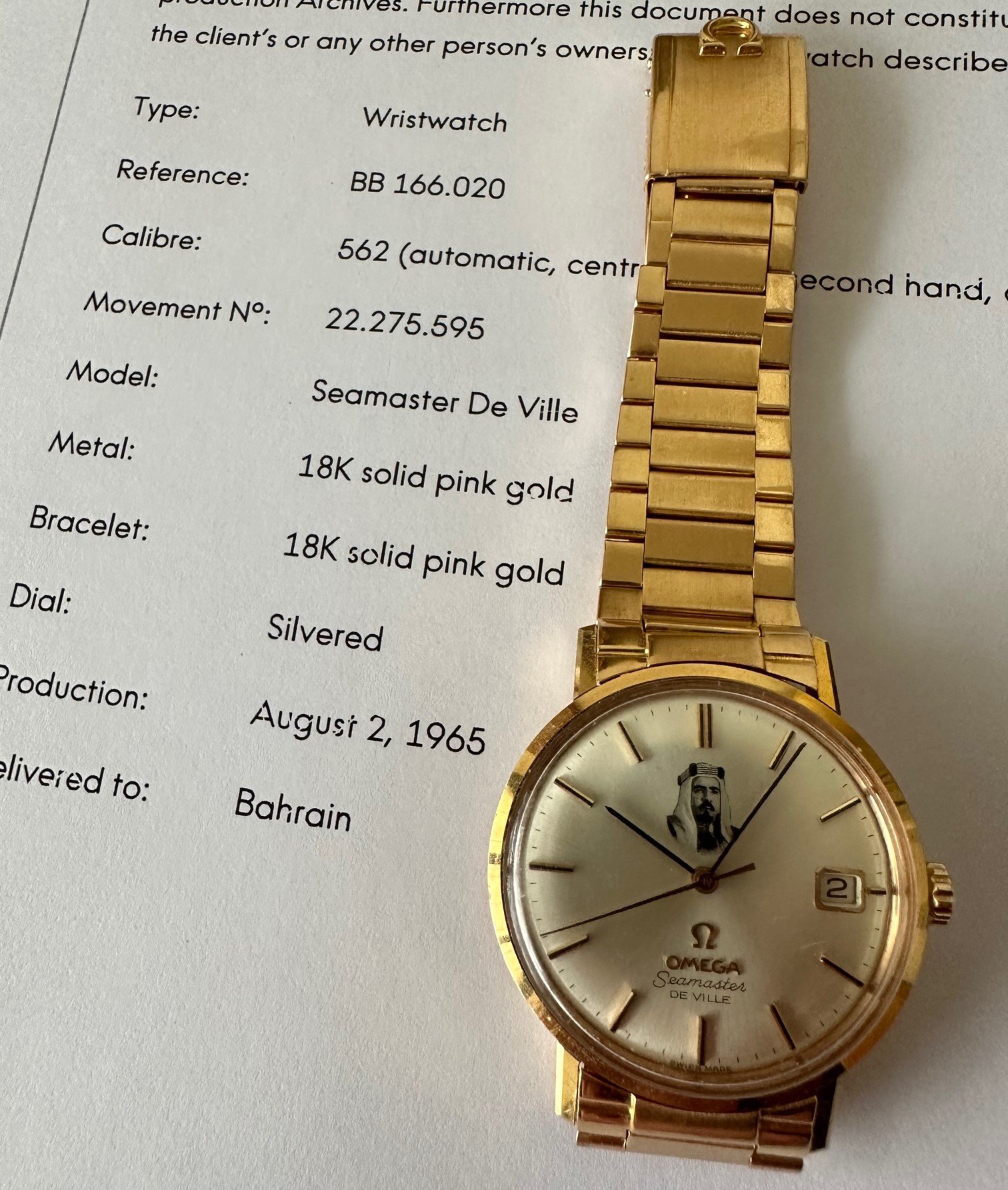

This is an excellent thread, thanks @PlainVanilla for the diligent work.
I'll try to contibute with an example of the non-mainstream Emir-of-Bahrain watches. This is a 166.020 in pink gold with a 7077 bracelet dated 65-1 (with 5 double expandable links). Case manufacturer is, as expected, Serva S.A. I've included the EoA, which is interesting, because it mentions the bracelet and the metal designation BB which apparently stands for 18k pink gold. (So I think the metal code BG mentioned in the main post could indeed stand for 9kt yellow gold, as explained in the table from the Omegamania catalogue posted by @gatorcpa in this thread).
883
1,770
I'll try to contibute with an example of the non-mainstream Emir-of-Bahrain watches. This is a 166.020 in pink gold with a 7077 bracelet dated 65-1 (with 4 double expandable links). Case manufacturer is, as expected, Serva S.A. I've included the EoA, which is interesting, because it mentions the bracelet and the metal designation BB which apparently stands for 18k pink gold. (So I think the metal code BG mentioned in the main post could indeed stand for 9kt yellow gold, as explained in the table from the Omegamania catalogue posted by @gatorcpa in this thread).
Beautiful watch!
Thanks, I've added the table to the main post.
