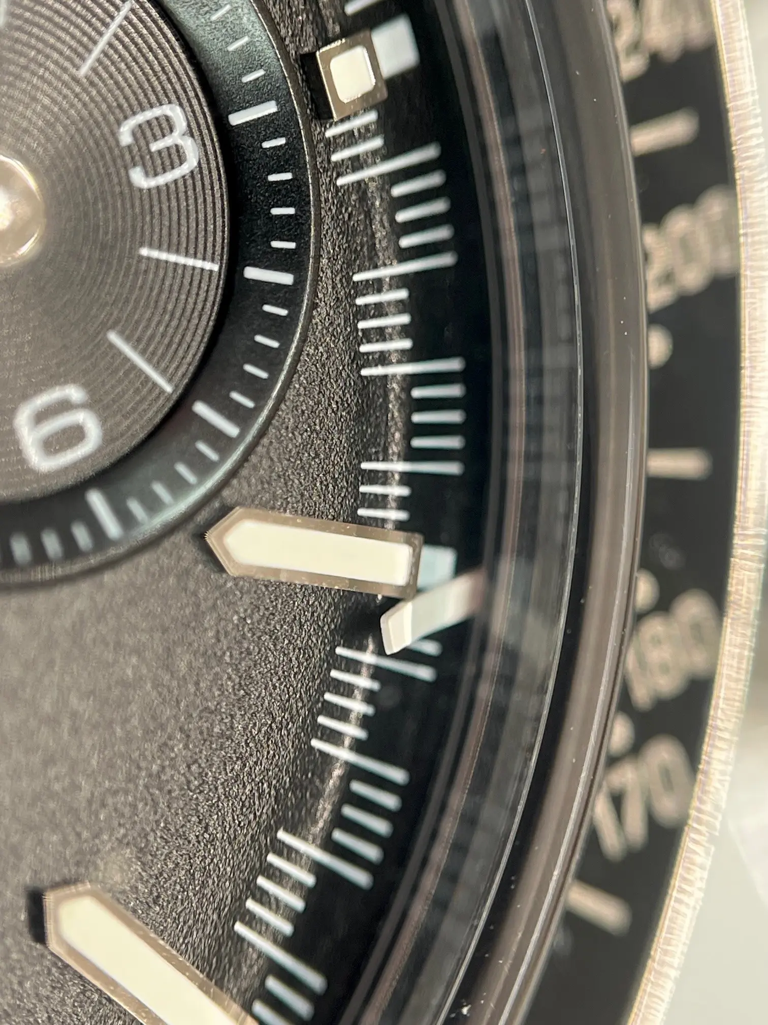

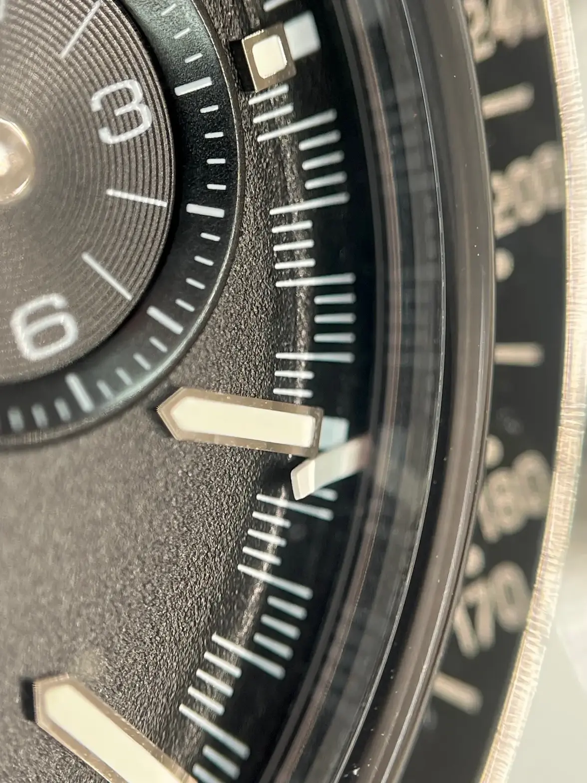

Ok so they sent me this picture:
I asked which hour marker the detached piece came from so I could compare it with my own photos and see whether it was already starting to lift before the watch was sent in.
They replied that since taking the photo, the lume strips at 2, 8, 10 and 11 o’clock have also fallen off - all while the watch was just sitting on a shelf with the case closed. I genuinely don’t understand how that can happen.
To me, this can only be one of two things:
  • a long‑term issue that would have started years ago and therefore is within warranty, or
  • something that happened during handling or cleaning at the service centre.
I might be wrong, but the dial looks mint, I can’t see how this is “oxidation” issue. It looks much more like the adhesive under the lume strips has failed. Wouldn’t the logical fix be to glue the markers back onto the dial? I appreciate Omega’s authorised solution may be to replace the whole dial, but the failure mode doesn’t look like "oxidation" to me.
Please tell me if I’m going mad here?!. What would an independent watchmaker normally do in a case like this?
29,797
77,134
The applied markers themselves have not come off, just the lume. This makes much more sense than what they told you previously, because applied markers just don't fall off.
When luminous material gets wet, it can affect the bond that holds it in place. This is likely the result of repeated exposure to moisture. You could argue that because the watch has been wet and repaired under warranty this should be an extension of that.,
It's not really glued in place - the luminous material is a liquid slurry when first applied and the marker is filled with it. Omega wouldn't relume it, because they get the dials fully completed from another factory in the Swatch group, so they would just replace the dial. An independent watchmaker can relume, but they would have to match the colour exactly, and the affected markers may not look 100% the same.
