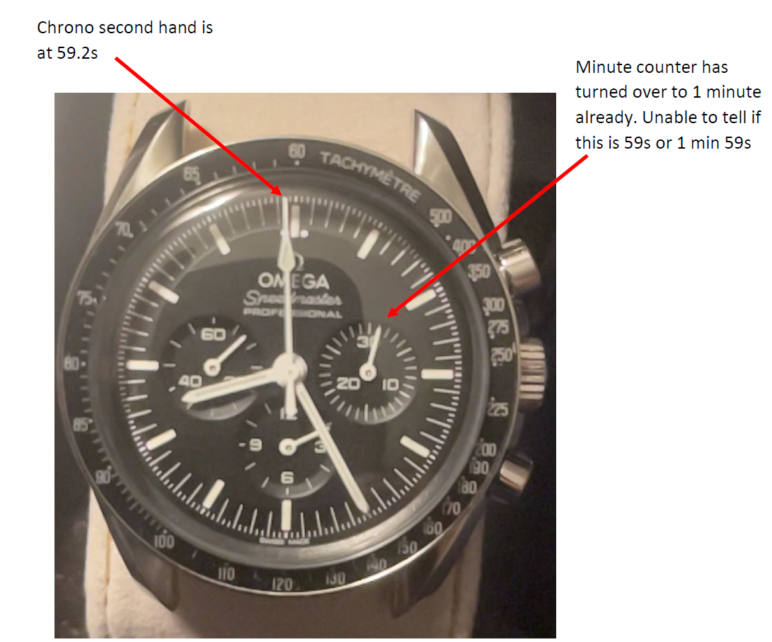

Hello everyone, I would like to start by apologizing right off the bat for presenting issues with the 3861 Speedmaster that have been listed in countless forums and posts before. I know I am not unique in seeing these problems, but as a first time owner of a watch more expensive than $100 I could use some advice 😀
Last month I had an opportunity to purchase a 3861 on the nylon strap for a good price from an OB while in Istanbul. I have wanted a Speedmaster for 20 years so this is my grail watch. I took a quick look at it and then packed it in my carryon for my trip back to the US. It was not until I started sitting and admiring the watch for a few days that I realized my watch has a lot of the problems I have now seen posted in many forums. Unfortunately I did not know about these issues during the purchase, so I never thought to look for them.

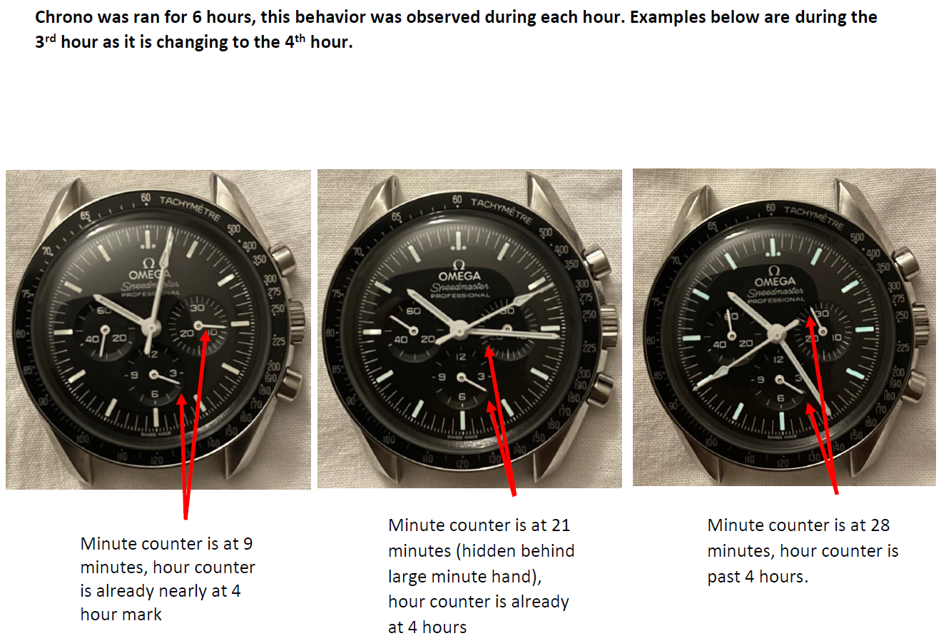

Firstly, the hour subdial on the chrono function of the watch is misaligned and is too fast by around 10 minutes. I have seen the description from Archer on why this may happen so I tried to let it go, but mine seems like it's off by quite a bit. I have tried the trick of holding the reset button and slowly releasing, but this does not fix the misalignment. Pictures below:
Additionally, my chrono second hand is activating the minute subdial about 0.8s to 1.0s too fast, which I have also seen as a problem before in the forums. When it is reset it is slightly off to the left, so maybe this is contributing too. Pictures of the issue below again:
The reason I ask about these issues is because I am unsure if they warrant a return to Omega to be fixed. I know that many people will have different opinions, but as a first time owner of a nice watch I am a little upset that there is this much off on my piece. I am not really a watch guy, just a huge fan of the space program and heritage of the watch, so for me this is a really special and unique purchase that I might be holding to a higher standard than I normally would. I have heard horror stories of returning the watch for service, and I guess I am also a bit upset that I need to risk that with a brand new watch. Since I bought it in Turkey I can't go back to the original OB and request a replacement, and my closet AD is about 3 hours away and told me they would just be sending it back to Swatch anyway.
Anyway, I appreciate anyone reading with some advice. Maybe my OCD and how much I notice little things like this makes me a bad candidate for a watch, but I just feel like it's casting a dark cloud over what should have pretty a pretty fun purchase.

I wonder if the second problem could simply be a misaligned sweep hand. The OP says that it doesn't reset to a vertical position.
Still, the watch is under warranty, so in practical terms, a warranty repair is the only plausible option IMO.

Your observations aren't that much different from other Speedmasters.....1861 or 3861. The hour hand is often not quite aligned when the chrono is reset, either being to the right or left of the 12 index by a smidge, and when the chrono is subsequently run the hour hand will either be slightly ahead or behind the elapsed time when it passes the hour marker. I've long ceased being upset at the slight misalignment my Speedmasters show, it doesn't affect accurate chrono reading, it's just the way they are set up and how they function. The same with the clicking over of the central second hand, I've just never observed when it clicks over, it would only be an issue if your elapsed time is right before or after an elapsed minute.
If it really bothers you send it in and see what Omega says, just remember there is ALWAYS the possibility of dirt, dust or a mark on the hands or case being the result of a service intervention. I tend to leave these things alone unless it actually affects the functionality of the complication.

I put it down to the vagaries of mass produced mechanical Chrono ownership, though I appreciate something can be done about it. I will wait until service time to get them to have a look at it as it doesn't affect the function of the watch how i use it to time cooking👍
Interestingly, I have periodically run the chrono on mine continuously for an extensive number of hours on purpose, just to see if the overly advanced hour hand sorts itself out and it has👍
I just thought I'd try it and see how it goes and the advancement has come back enough for me to discount it as an issue altogether😀
The hour register hand always aligns perfectly when set to the re-zero position as do all the other hands, so that's all good.
The way the minute register works is close enough to be good enough😉
It doesn't affect functionality at all.
