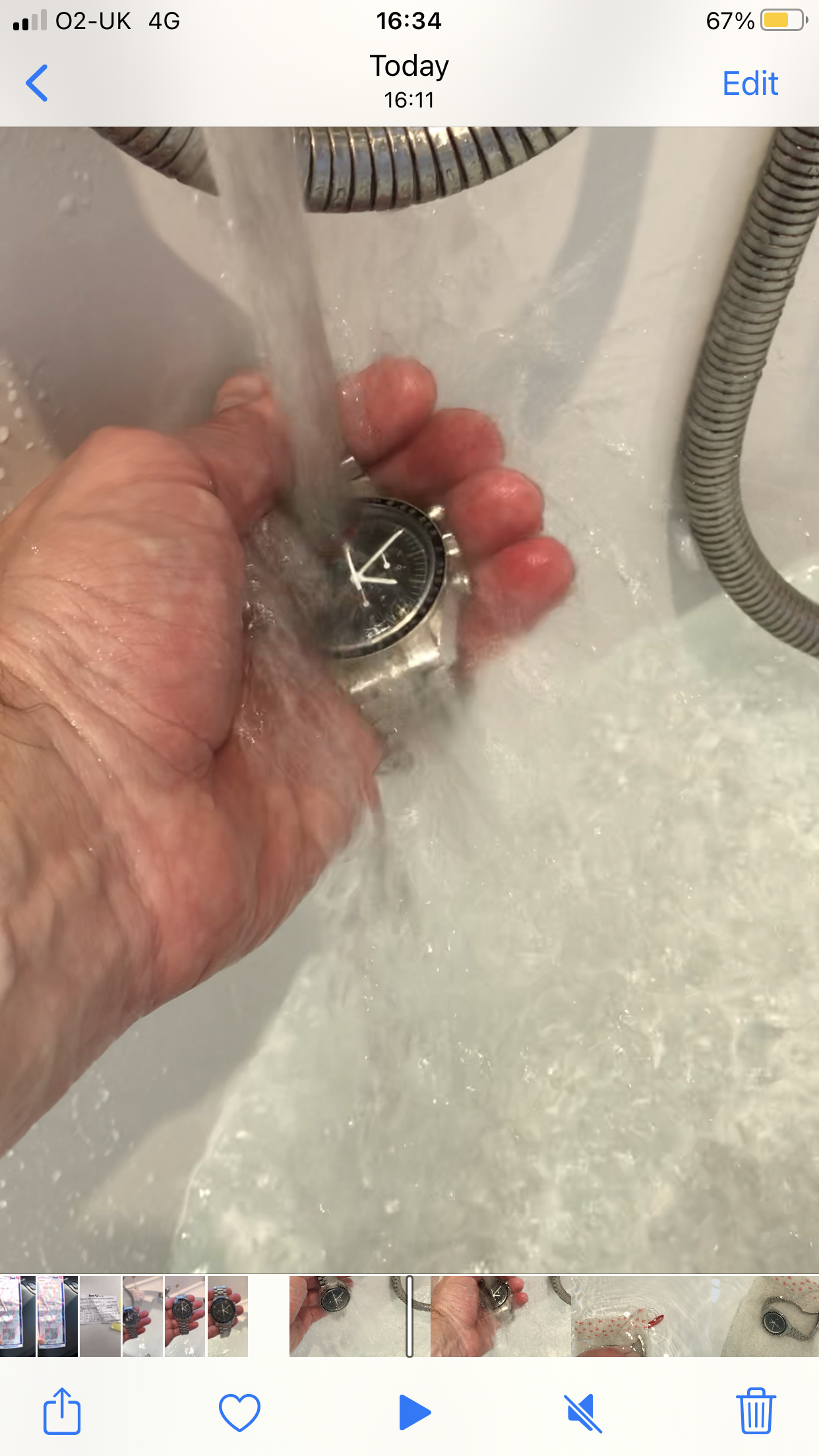

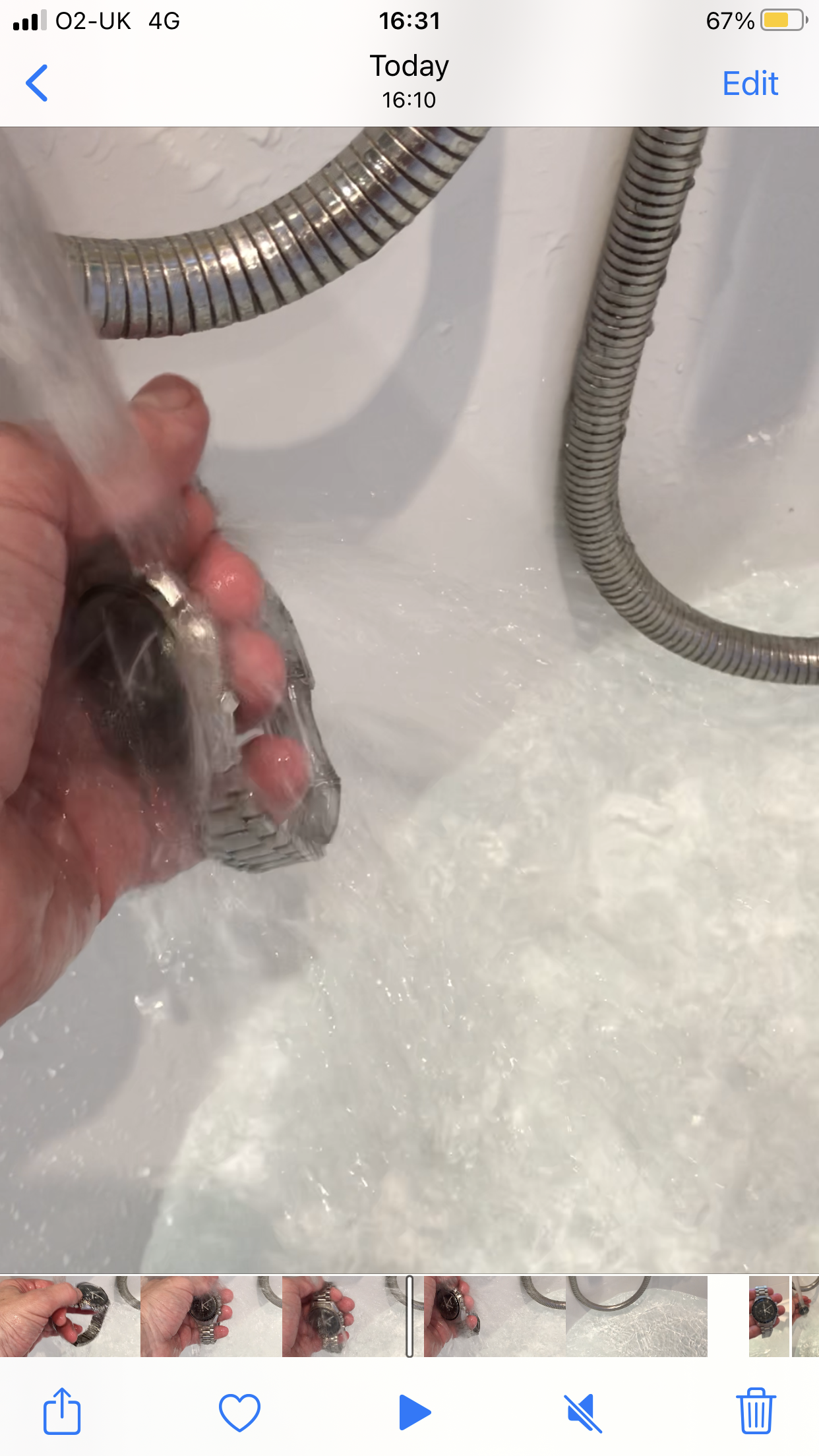

I’ve had a Speedmaster Moonwatch for almost a year. Here is my take...
1. I give my speedmaster a bath about every 2 weeks. Put it under running water, sometimes dip it in water for half a second to rinse, that’s it. That being said, there is never any fogging, and your watch, if I’m not mistaken should be water resistant to 100m. Meaning you should be able to swim with no fog at all, and submerge the watch with no fog at all.

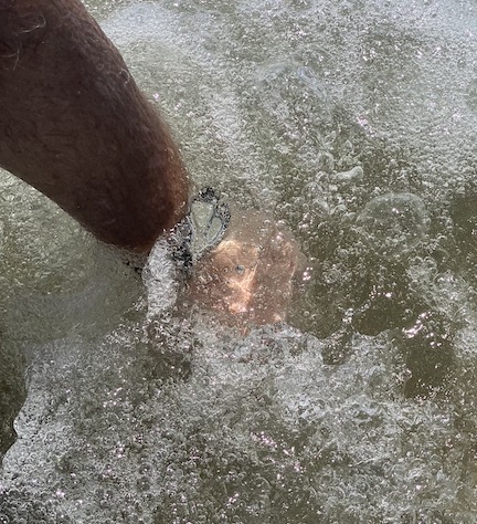

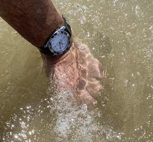

Hello,
Speedmaster and water…
All ok, can take it easily…
Emil

I just don't think a Speedmaster's design and specs lends it to swimming and dunking it in water, but many people do it. Some pass fine, some don't. There are better watches designed for this type of activity. Personal choice.
I agree, I just wanted to show that if you need and have to, it could take the swimming, etc…

seamaster chronographs are intended for more robust water related activities i presume
Sure, I agree but Speedmasters are ok to swim as well
