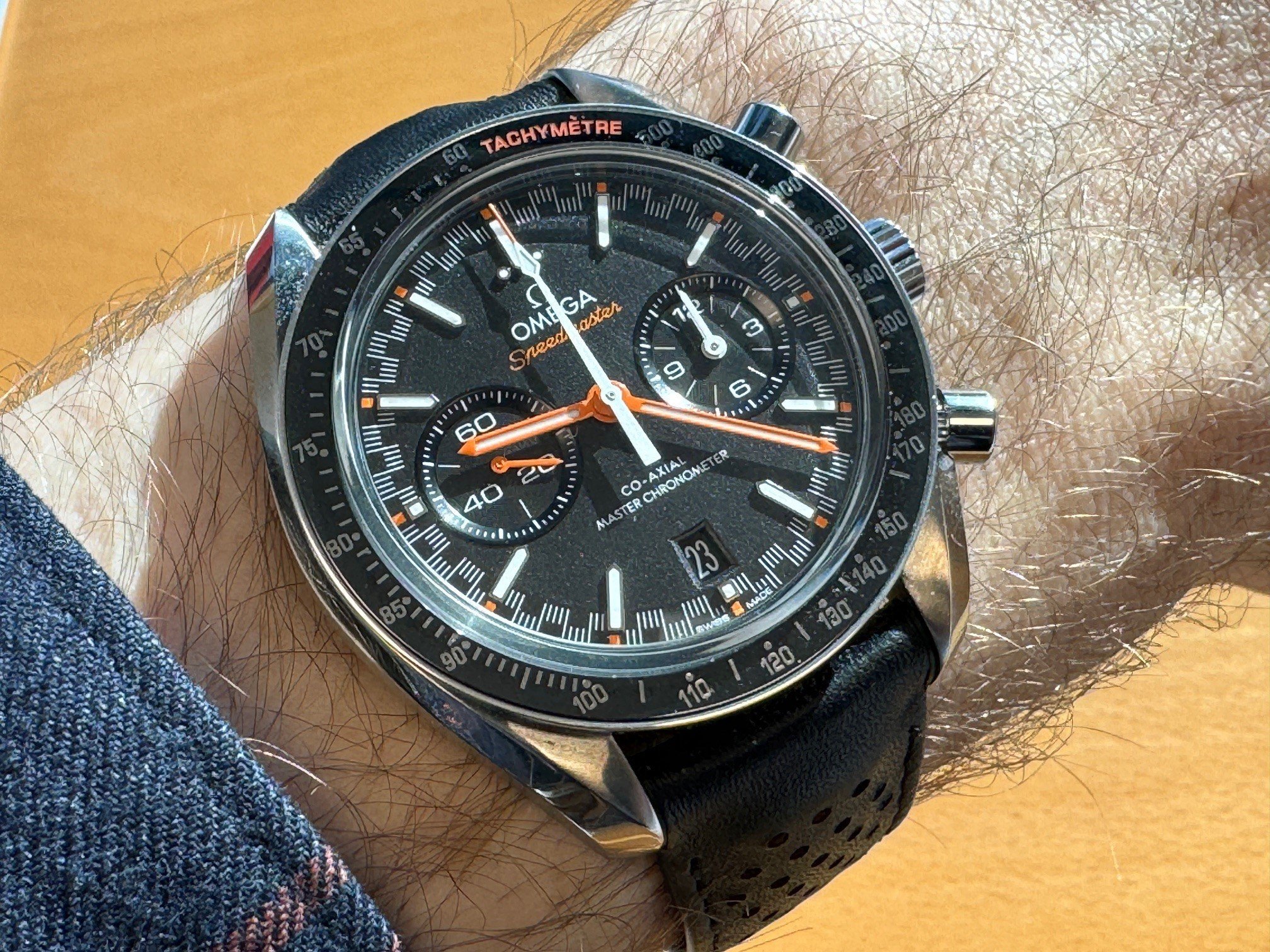

After owning Omega Speedmaster Racing for already about half year I thought to write a small user review, maybe someone can find it helpful.

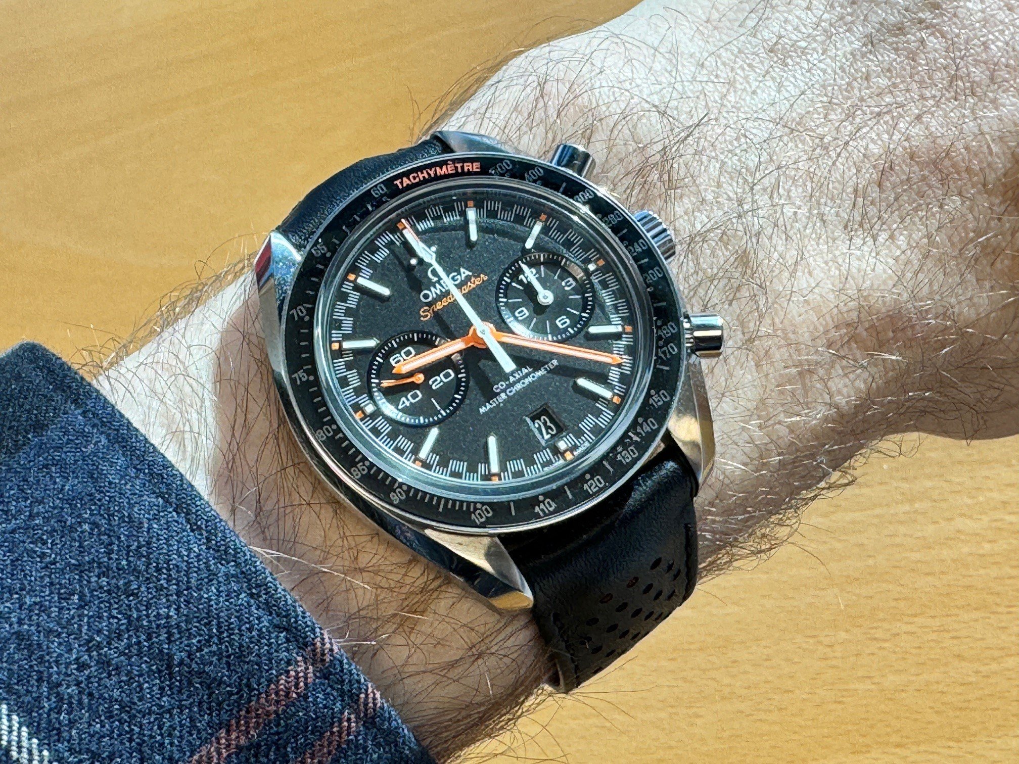

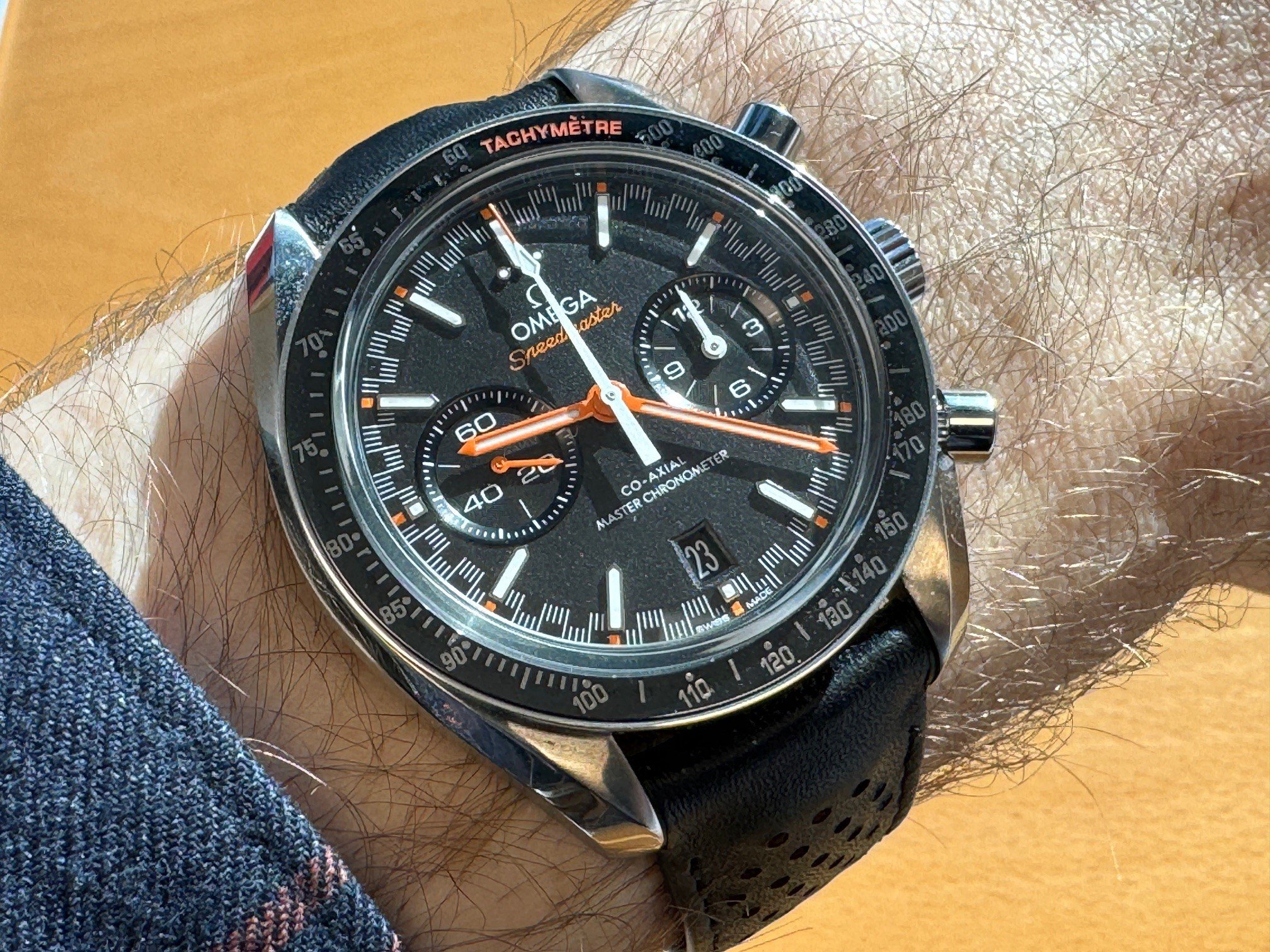

This is how it looks on about 17cm wrist plus few more pictures.
All the time before purchasing I was afraid that it will be too large.

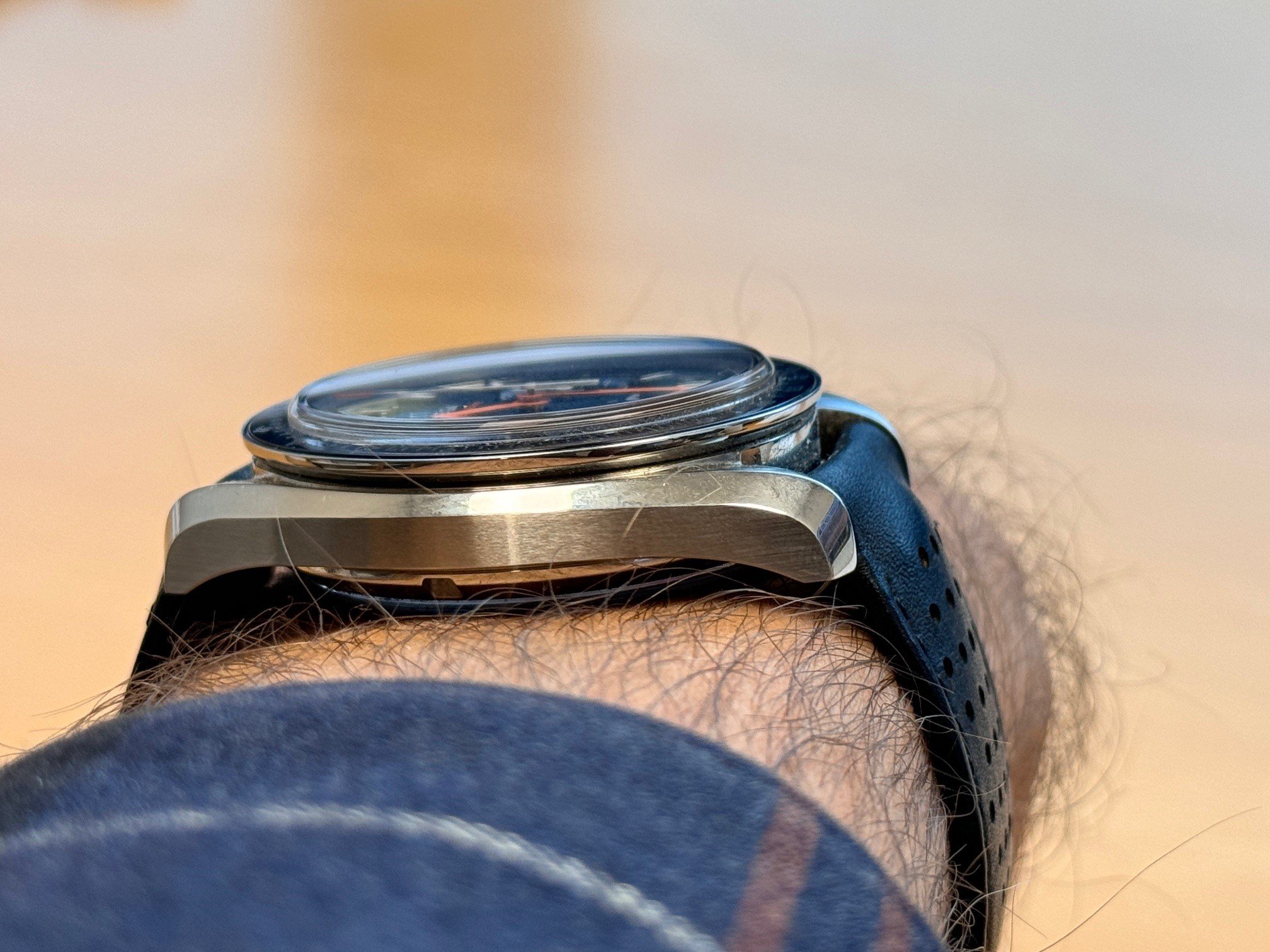

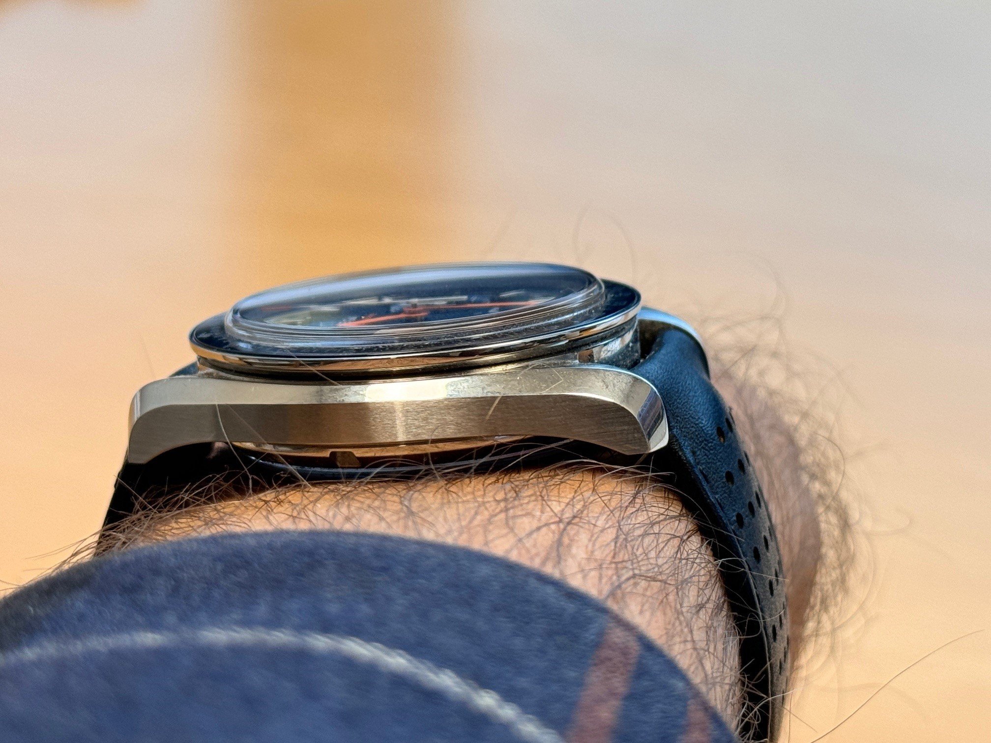

It is indeed large, and I would not recommend it for a smaller wrist. Maybe 16cm will still be ok, but anything smaller than that will not be good. It will just be a bit overwhelming in size, but it is also personal preferences.
For me it sometimes look a bit on an edge of mine size as well.
It is also quite thick, but fits under normal clothing. However, if I have bit tighter shirt, it is not going below (but why it should, it is so nice after all).

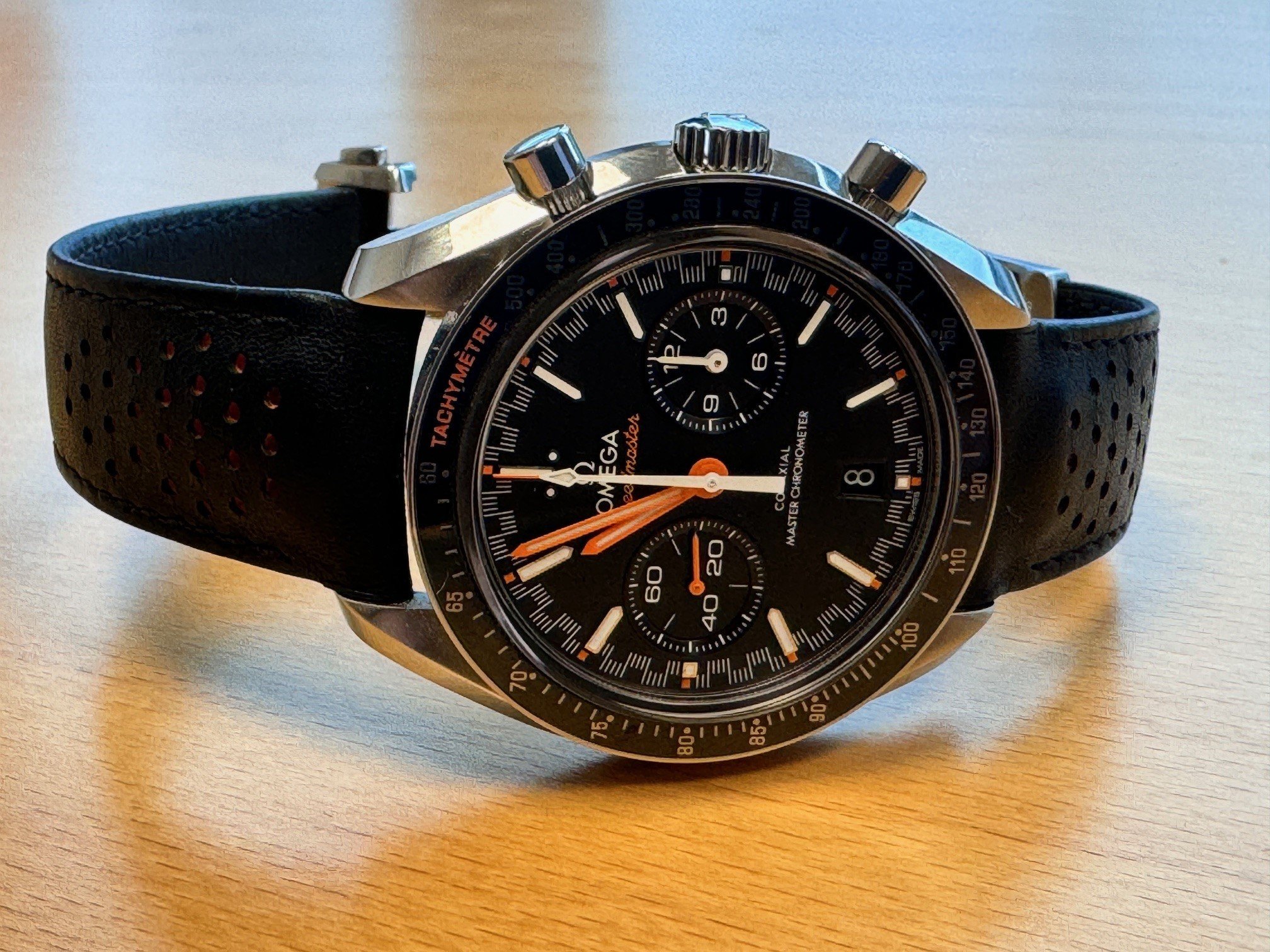

But I ended up with the automatic Racing with orange accents that fits apparently in color to some of my clothes as well.
The black version on black strap looks smaller than white version. It is only illusion of course because they are exactly same size.
As of which is nicer (white or black dials) is up to personal opinions.

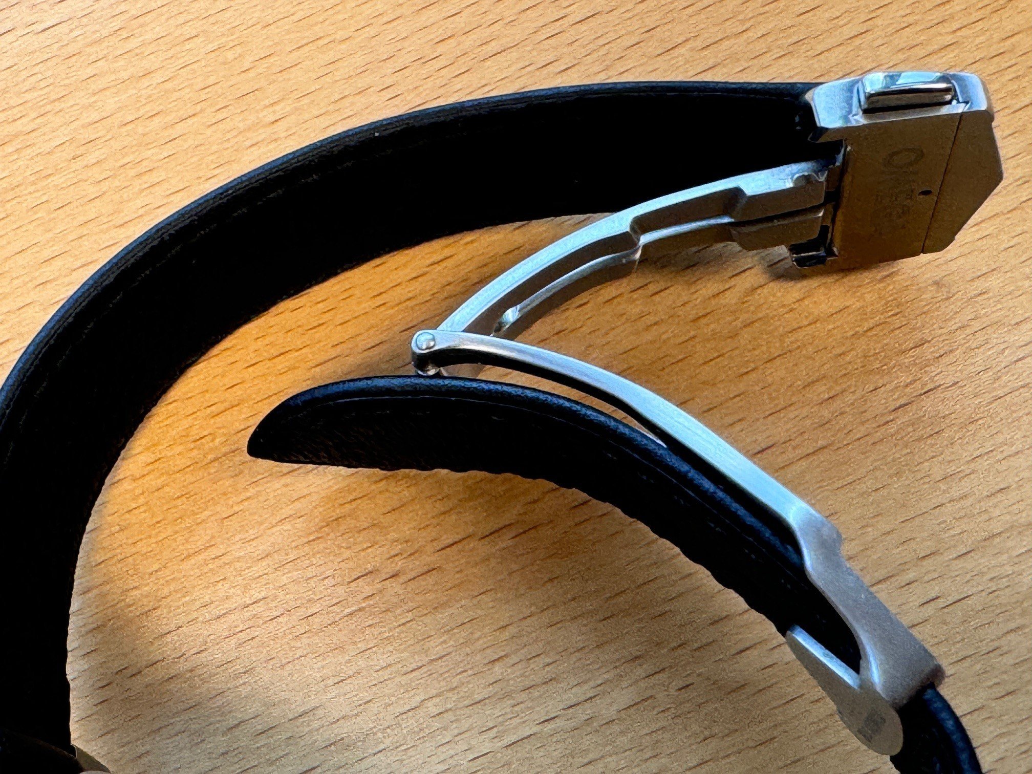

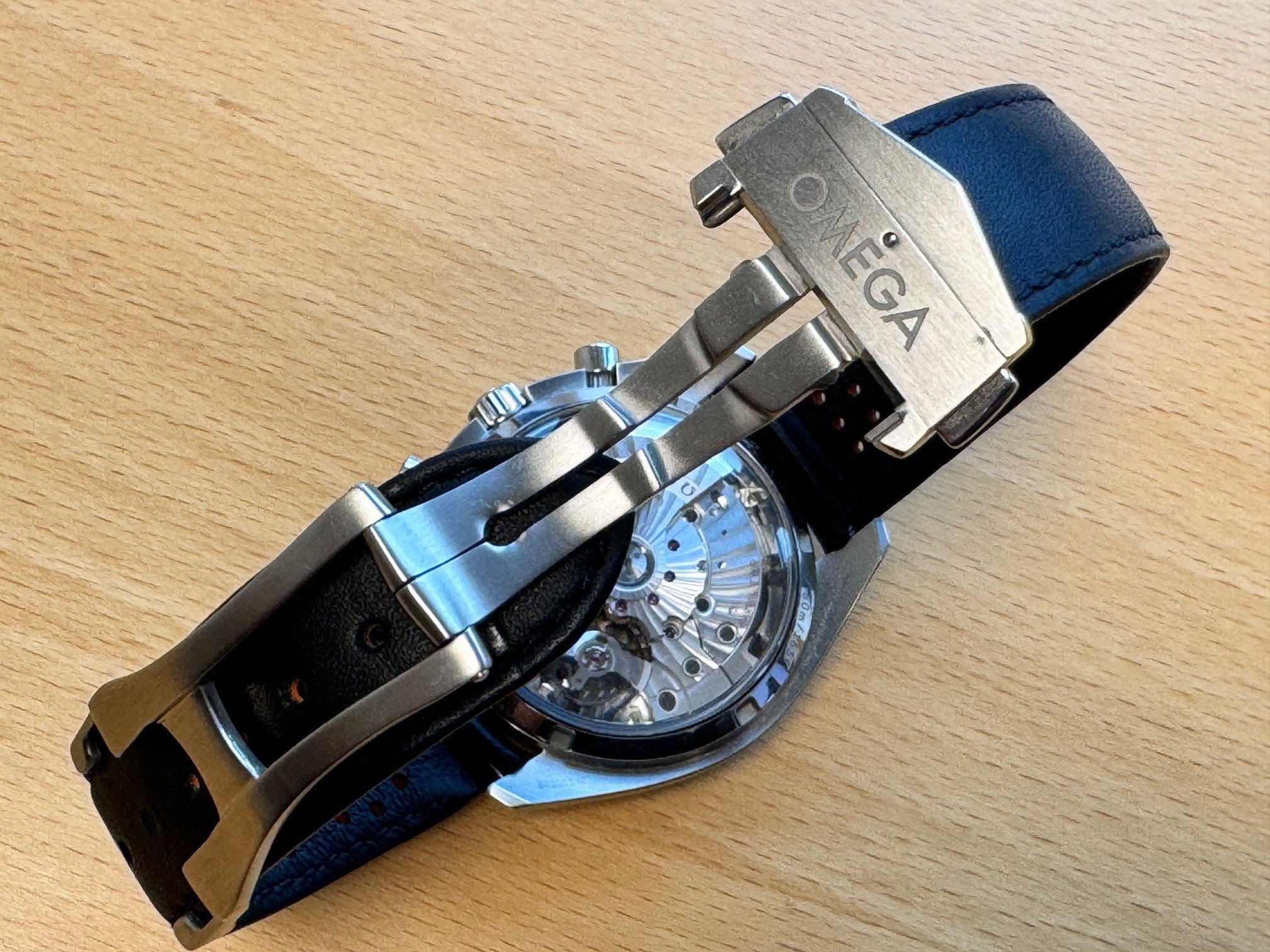

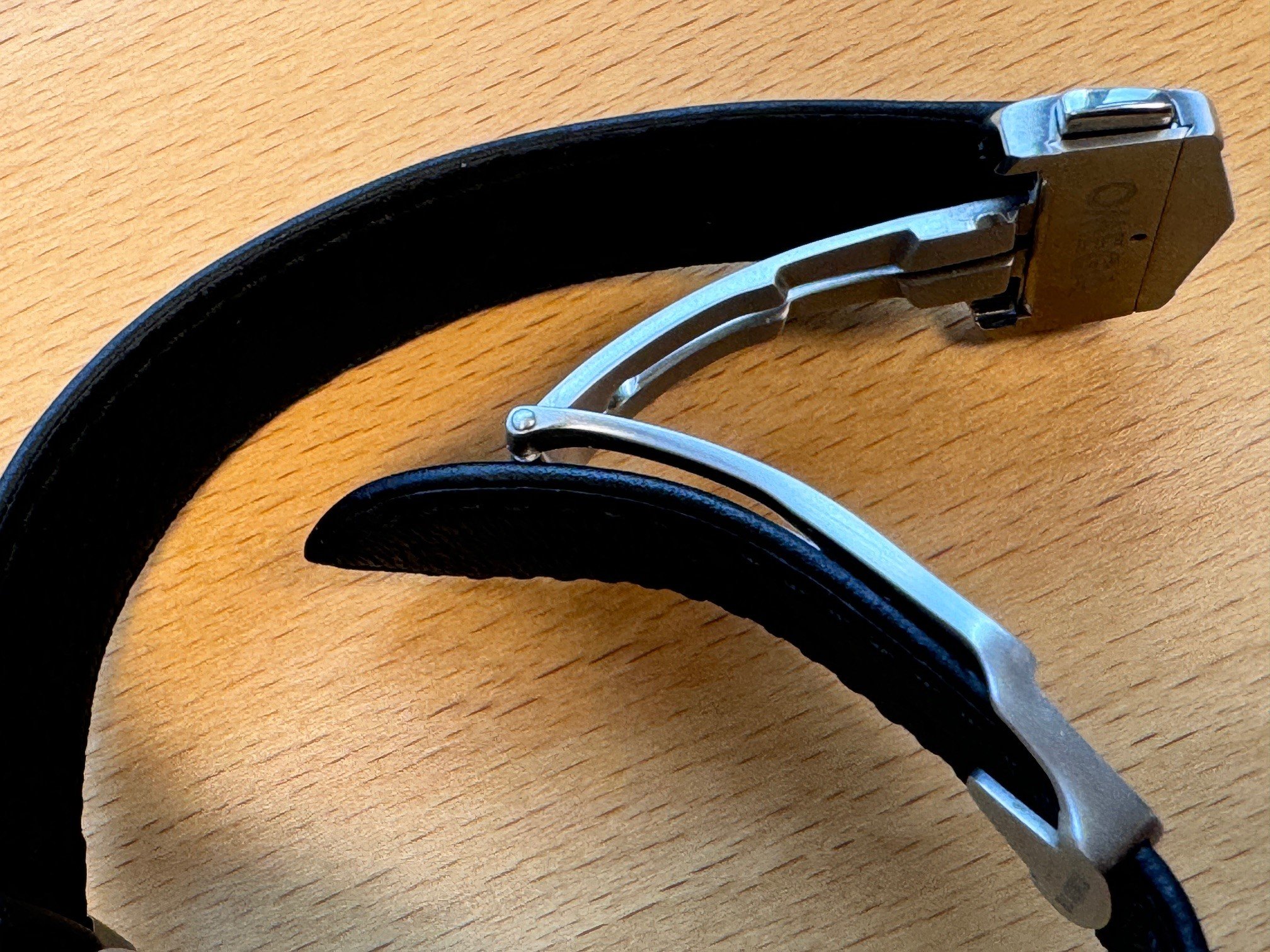

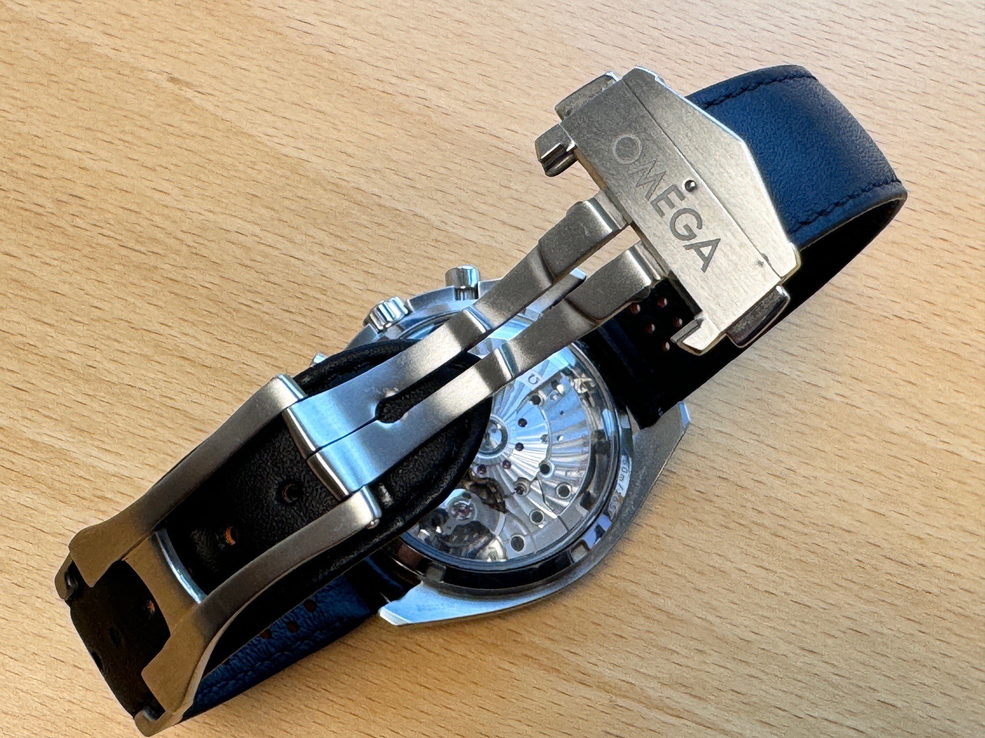

As you see it is not on steel bracelet but on black leather with clasp.
I though it will be a better choice since all the steel bracelets that I had were always tearing hair off hand and I could not stand it anymore.
Advantage of bracelets is their superior adjustment possibilities. Especially if additionally, to just removing the links you have extra “micro” adjustment in the clasp.
Well, if you take the leather version you can forget about any micro adjustments apart from the holes on the strap.
They are of course as well made for it and working fine but adjustment goes in larger steps and cannot make this final small adjustment.
Someone can wonder why I use so much effort for this particular detail but apparently on my wrist the last hole is bit too tight while the next one is bit too loose. Coming back to wrist size, less than 16cm will make it completely loose on original strap/clasp.
So, for sometime I was wondering and trying which one is better and I ended up using the one which is bit too loose. Reason was that if it is warmer then more loose fixing seems working better for me that tighter. Maybe hands are expanding in heat, don’t know.
But if it is cold I experience that it is a bit hanging down on wrist. So perfect would be for my part extra holes in between the current ones or that all holes are moved.
Who knows, maybe I will end up in having summer setting and winter setting after all.
Otherwise, clasp is working fine and I enjoy using it as this is a very quick on/off way top put a watch on wrist.

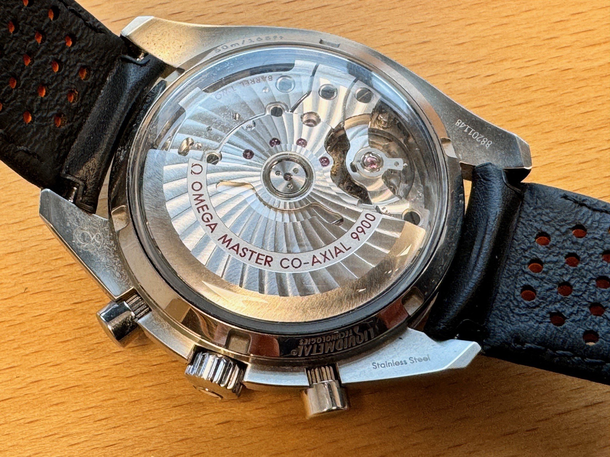

Interesting thing what I noticed also is that apparently when you just have it on a hand and walking (so hand is just slightly swinging back and forth) then winding mechanism is not really picking up this movement. It needs more dynamic moves like running or lifting hand up/down for something. I checked it by holding it in hand and simulating movement back-forth - mechanism stands still in lower position or moves very little. This is question of forces/physics, not really any watch related issue. I just often hear that you just need to wear it. Well, it is not completely truth, because if you just take it for a walk tour and your hand will be just swinging back-forth slightly, it will not be charging apparently. This applies to all this type of mechanisms.
About manual winding. It is relatively easy in beginning (I guess when power reserve is small) and then it becomes more and more hard pretty quickly.
What I noticed that it can be a pretty “finger shredder” as some call it.
I also like the possibility to adjust hour without stopping seconds (useful for traveling and when time changes between summer-winter).
It has date, which you have to set manually few times in year as the clock does not distinguish between months that have 31 days or less. This is not really a problem as you have the possibility to fix it per above described function (but need to of course remember to change time by 24h and not only 12h).

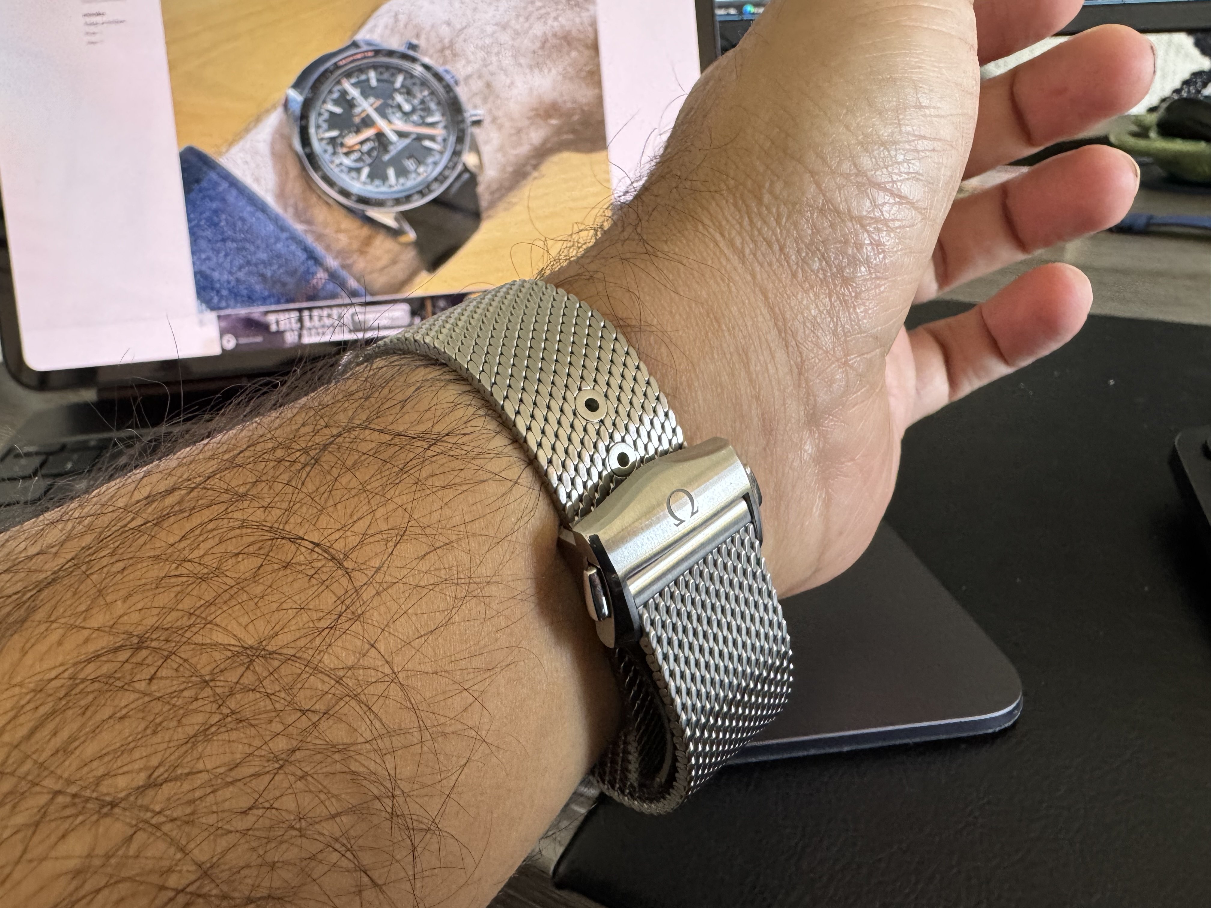

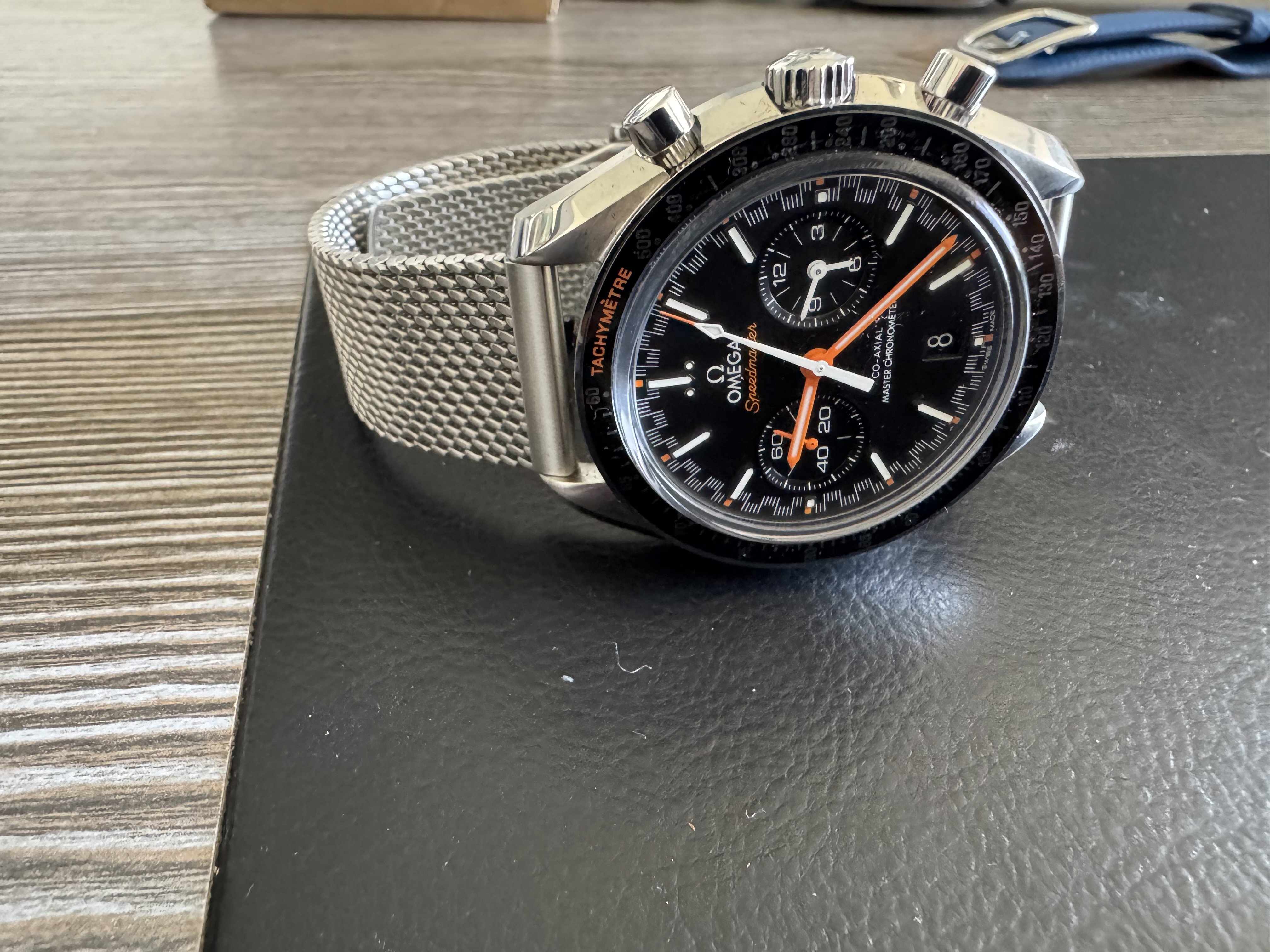

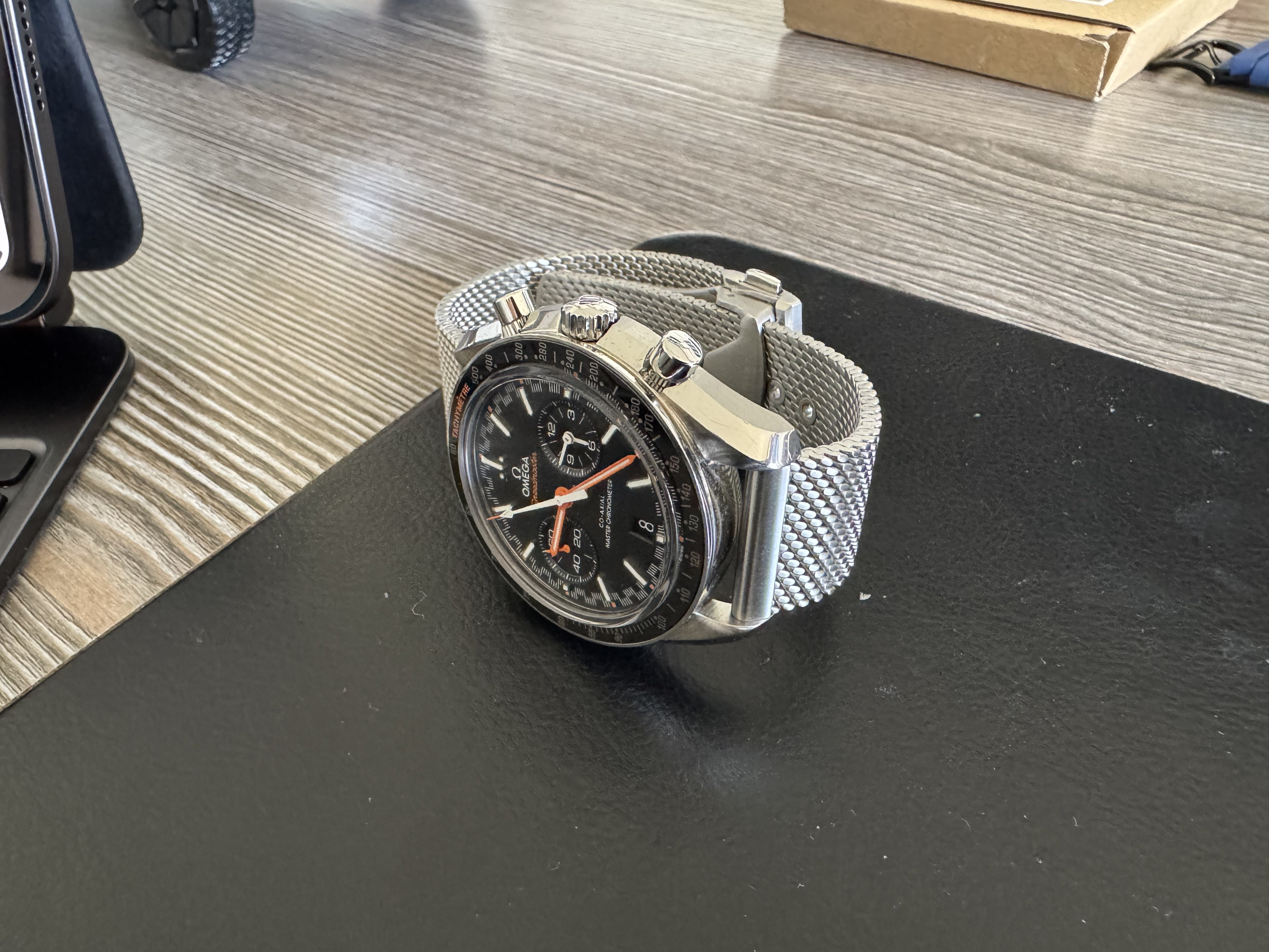

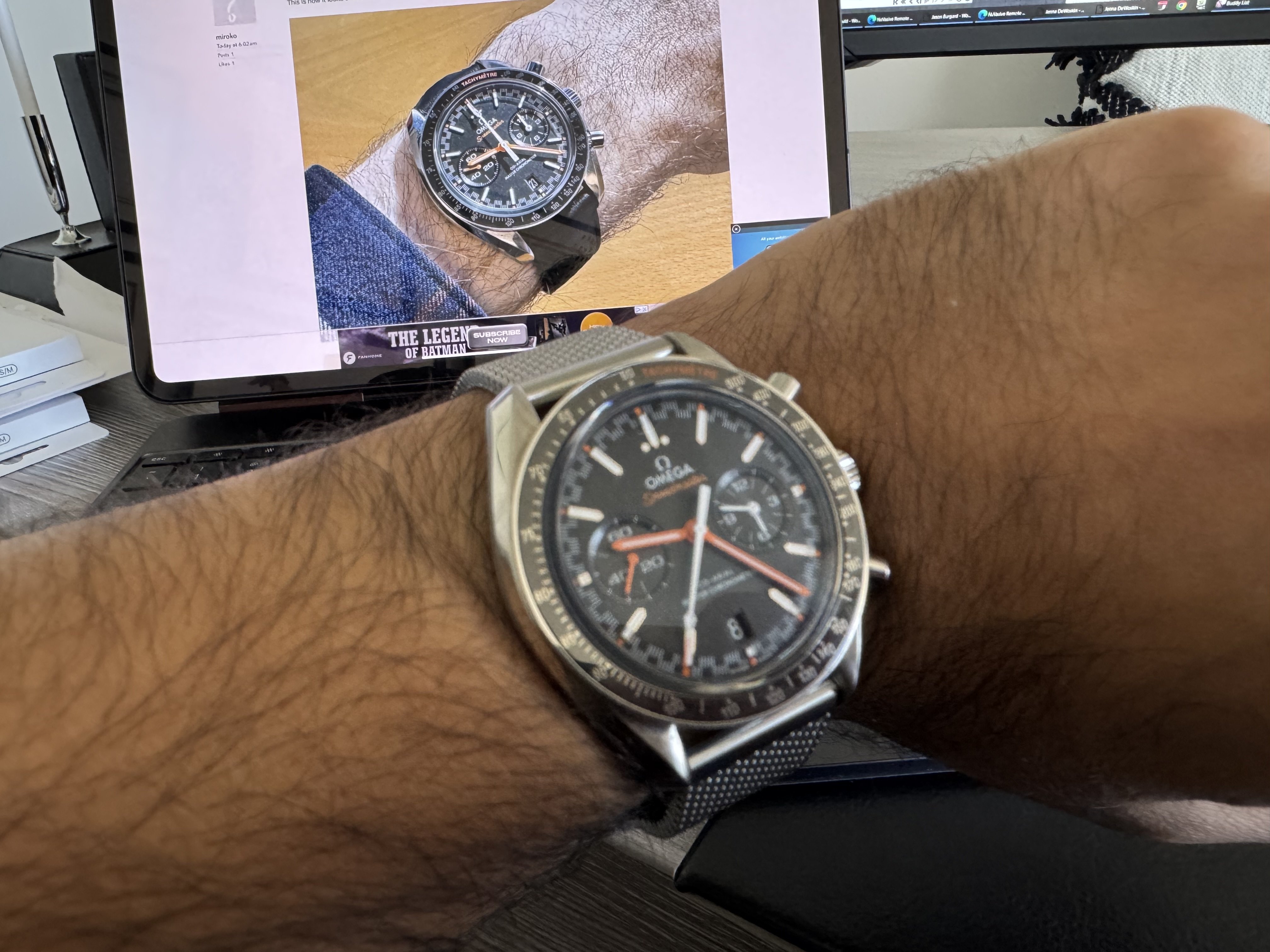

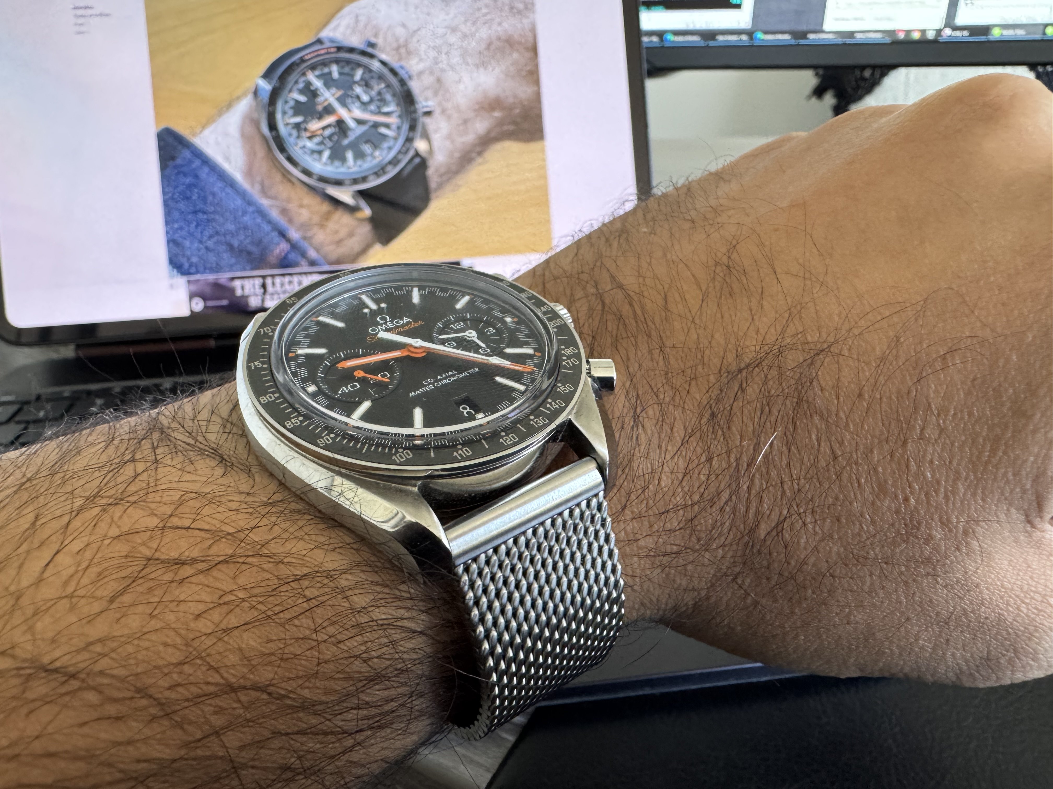

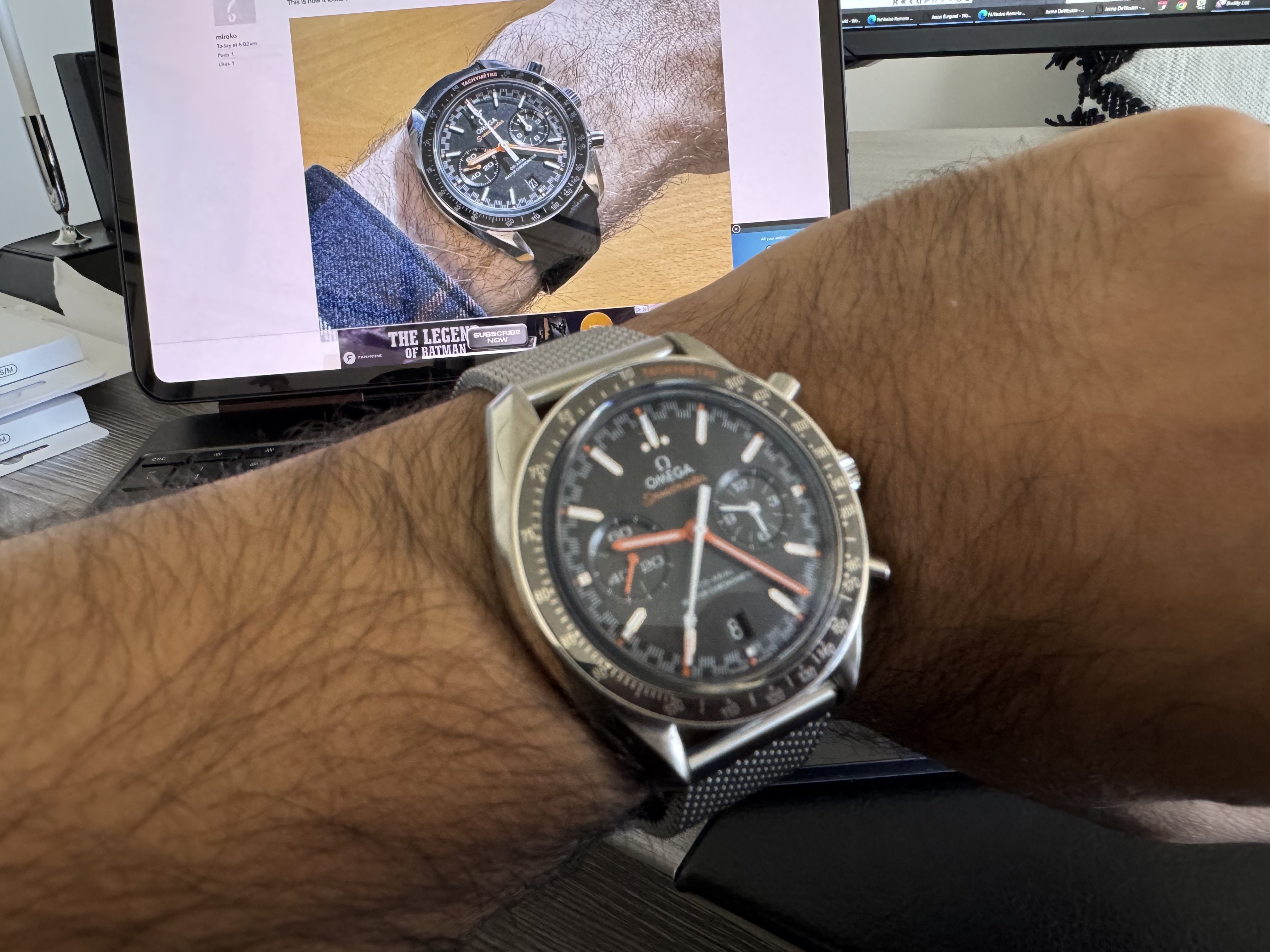

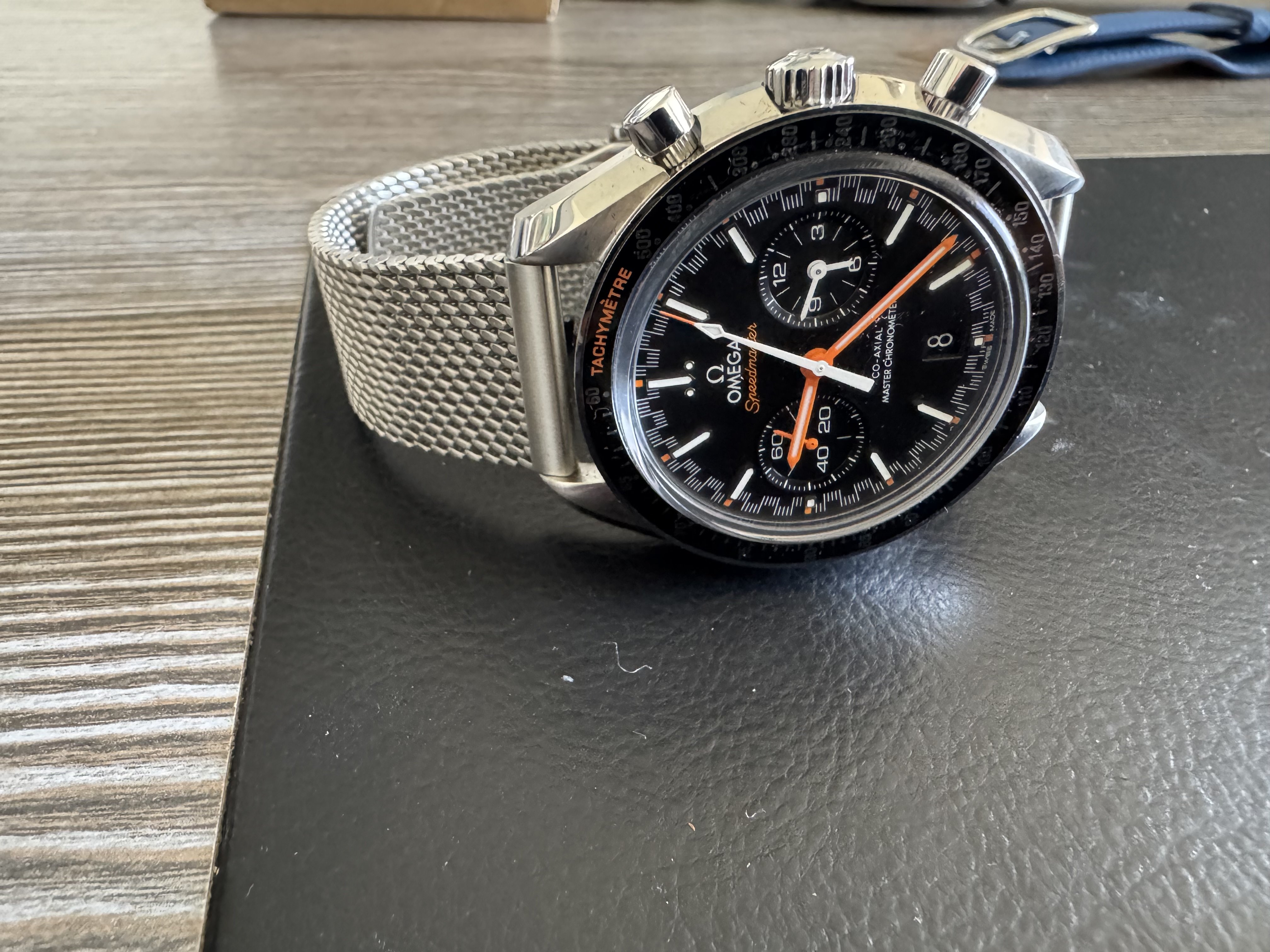

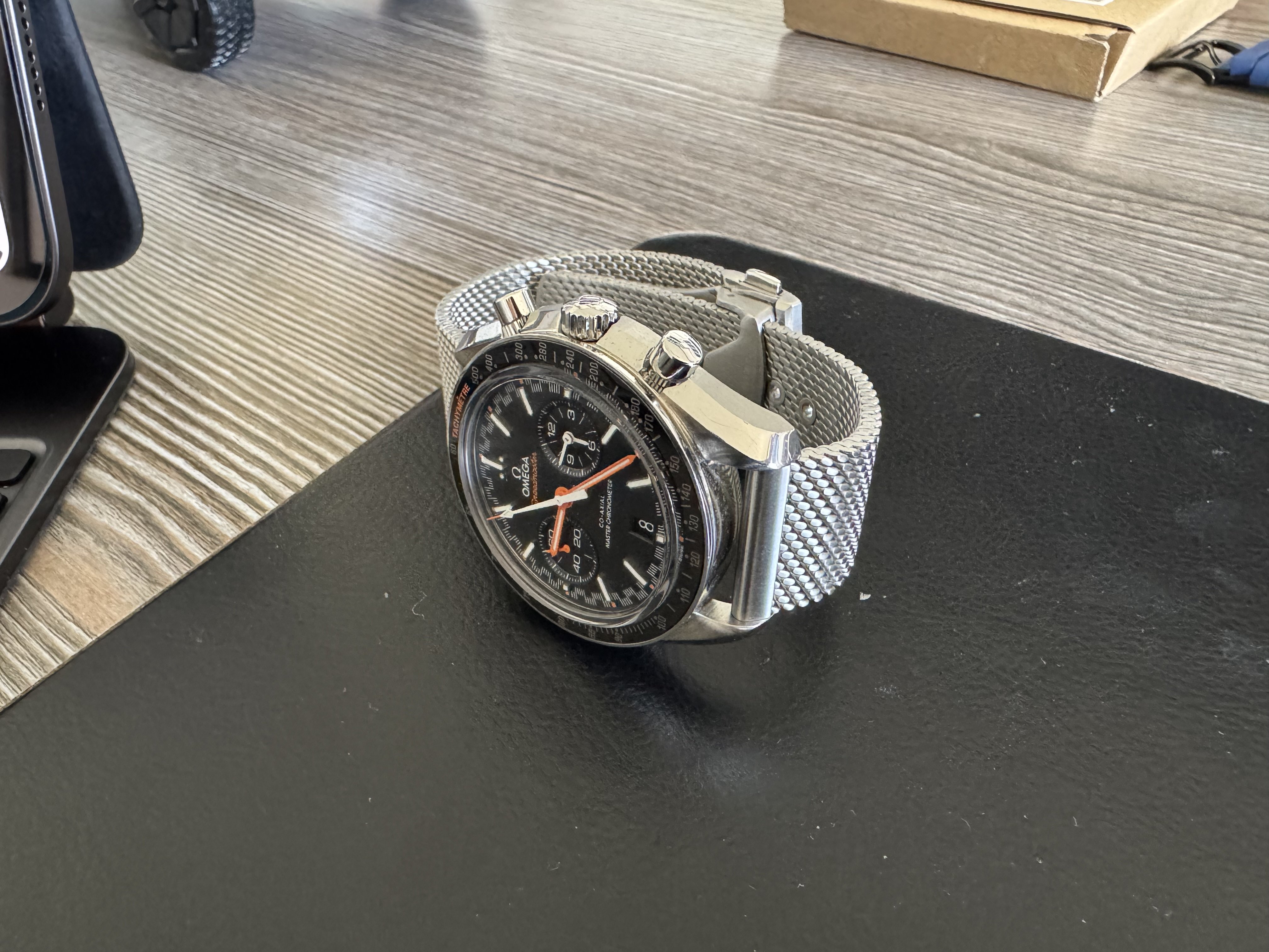

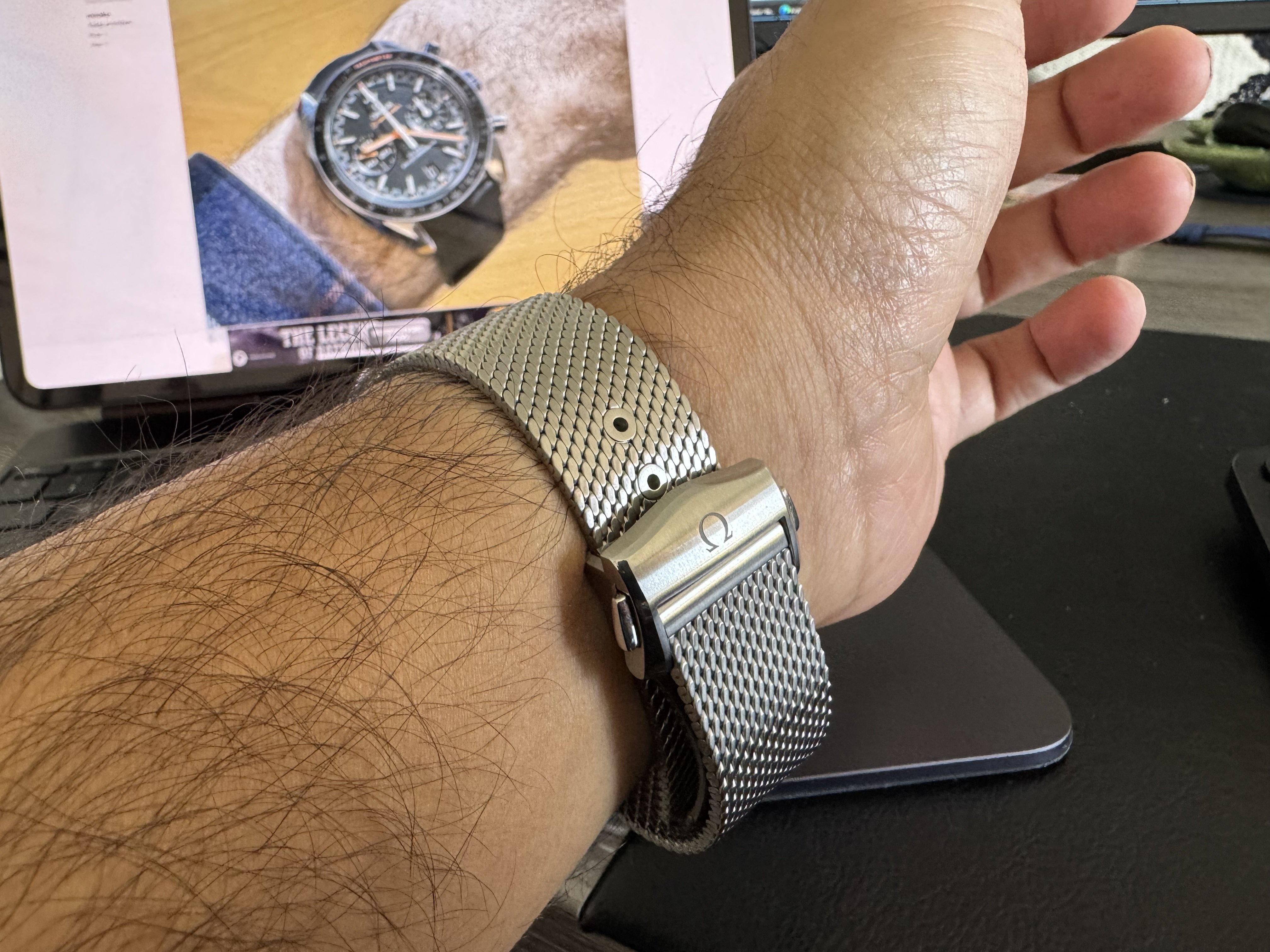

Nice very detailed review! I also recently bought this watch with leather band as yours, and an NTTD seamaster with the mesh bracelet (as a completely unexpected purchase which my wife was a bit shocked by). I loved the mesh bracelet on the NTTD so much that I bought the omega mesh also for the speedmaster. I love the look on the speedmaster with mesh, elegant yet sporty, and I typically dislike the traditional metal bracelets that most watches come with. My wrist circumference is around 7.5inch and quite honestly the watch size has been perfect for me. The orange and black color scheme is what sold me on this (and the brown tone on the NTTD seamaster). My first omega timepieces (a newbie here) which I’m really happy with. 😀
Here are some pics of the mesh bracelet on my speed master racing in case anyone curious re: this and the Omega mesh.
