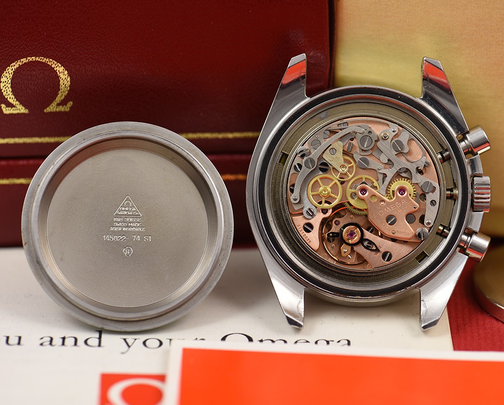

All credit for these photos to @ndgal. It's another -74 with a 31x/1971 extract issued before the 2019 changes to the extract process. Still yet to see a post-change extract for a -74 with this combination of serial and production date. Or an older extract showing 31x/1975-6. But then again, I haven't been looking very closely lately. If you have either, I'd still be interested to see it.
Considering the caseback is after the date the watch was made... I think you can argue the caseback was swapped at some point.
I think Omega was swapping -71’s to make them more sellable. Either by being shipped back( later extract date) or by sending out CB’s to retailers(original extract date).
But I think we've discussed this before: Check the dial. Also a -74, yes? Would you hypothesise that these fairly common 31x/1971 -74s all had both dial and case back swapped? Remember, these are the ones with the early production dates, so if we go with the explanation above then this is also supposed to have happened en masse at ADs?
It seems more parsimonious to hypothesise oddities in the way these have been documented, wouldn't you agree?
Nothing was swapped at any point.
This particular watch came to me from the original owner. The watch was untouched and never even opened before it got to my hands.
Came with Original papers with no serial number filled in but with a UK AD stamp. (sure enough, extract came back with delivery to the UK so you even know the papers were original to the watch).
The 31.XXX.XXX serial range with the 145.022-71/74 references is full of oddities.
Threads like this one put things in order little by little as more info and more examples with similar "Inconsistencies" (or should I say consistencies) pop up and documented.
Cheers @ndgal. This watch does indeed appear to be a great example of how these early-serial -74s with 1971 extracts likely left the factory in exactly the configuration that we find them. 👍
