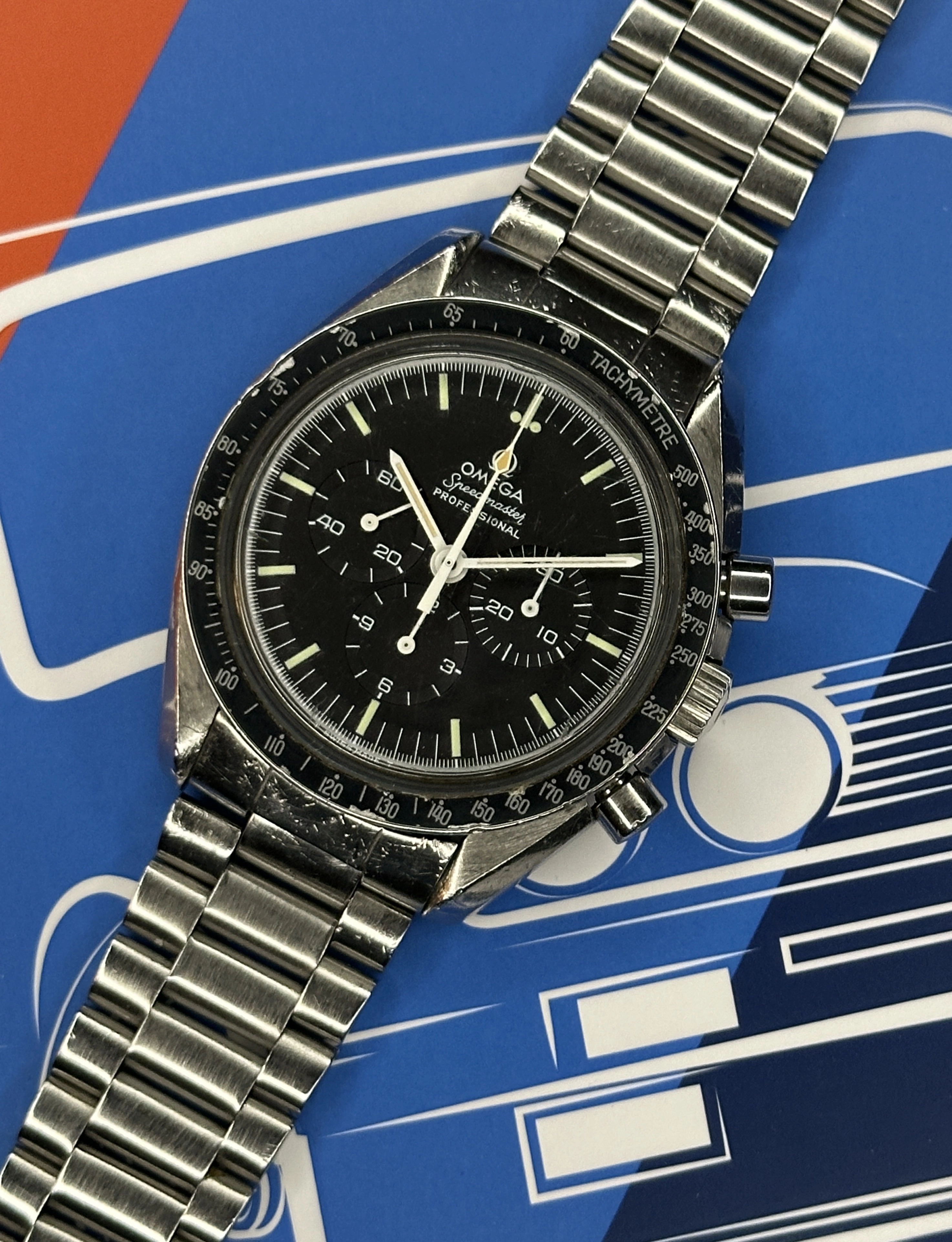

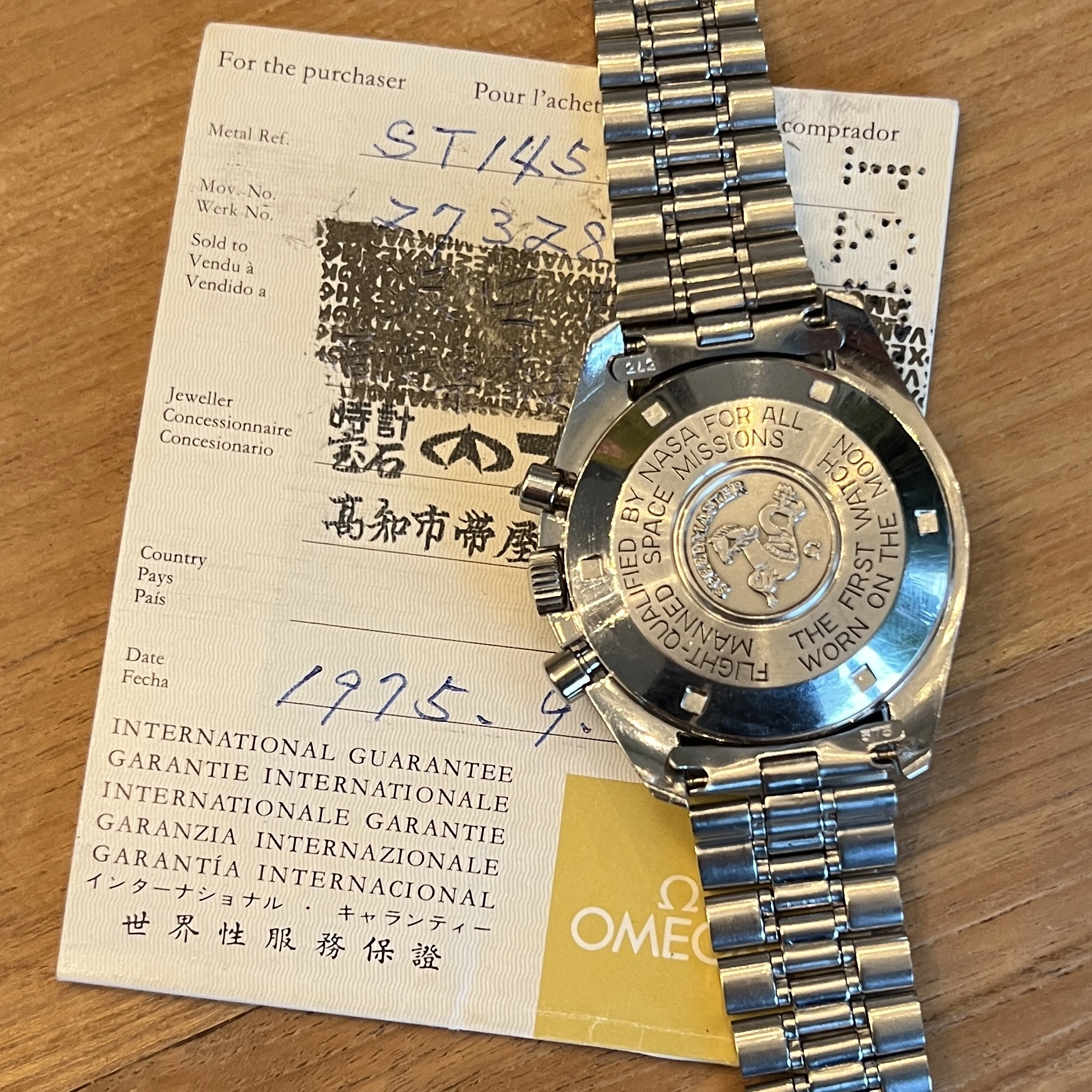

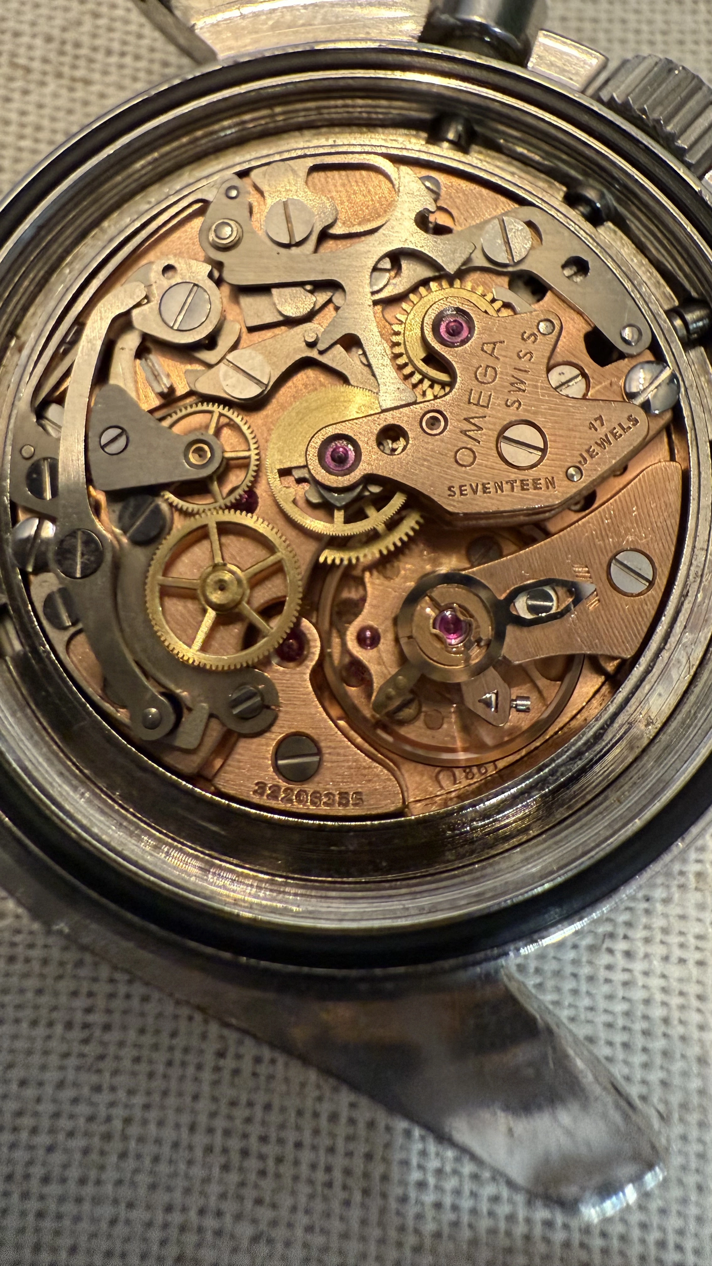

New example

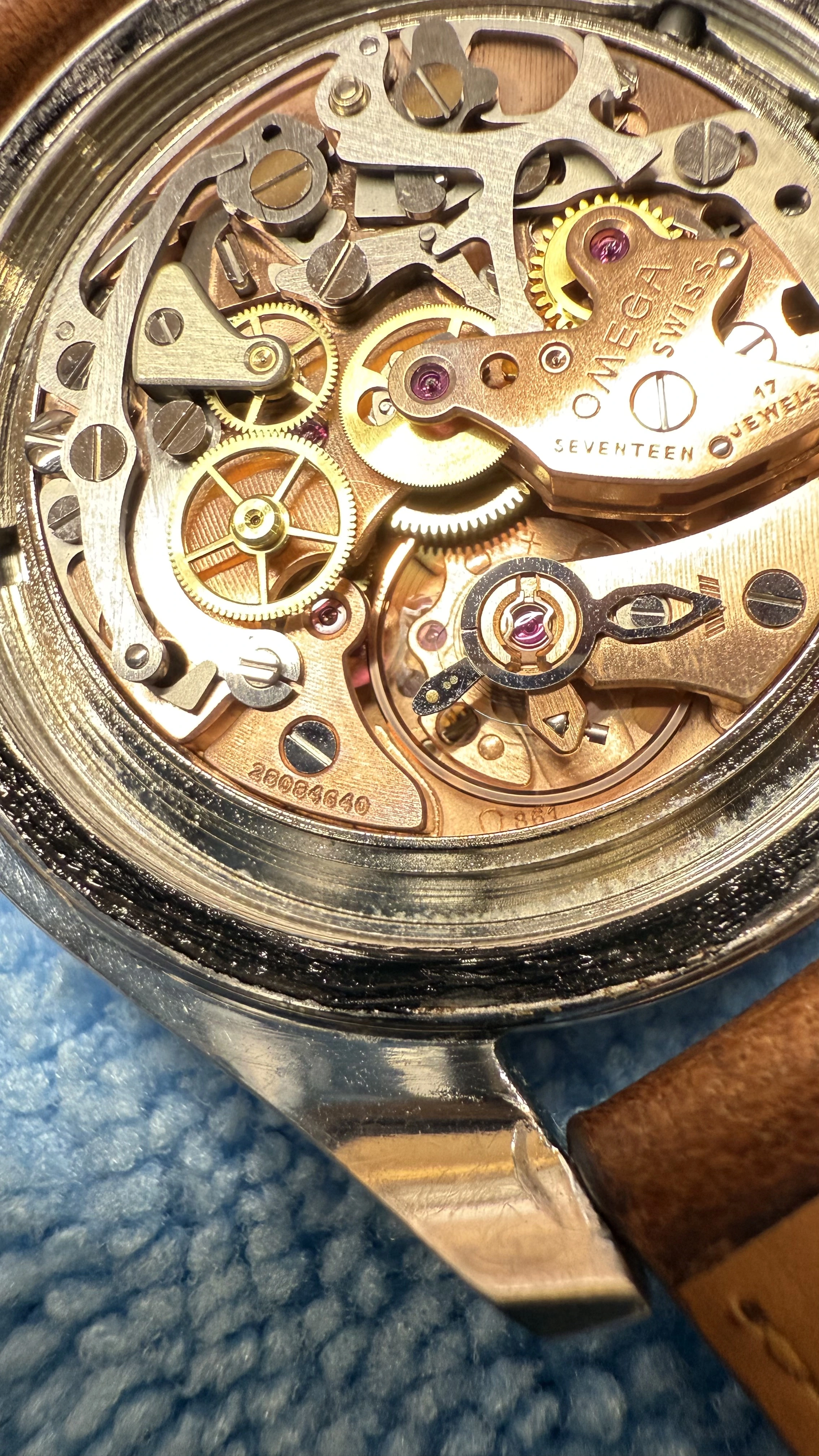

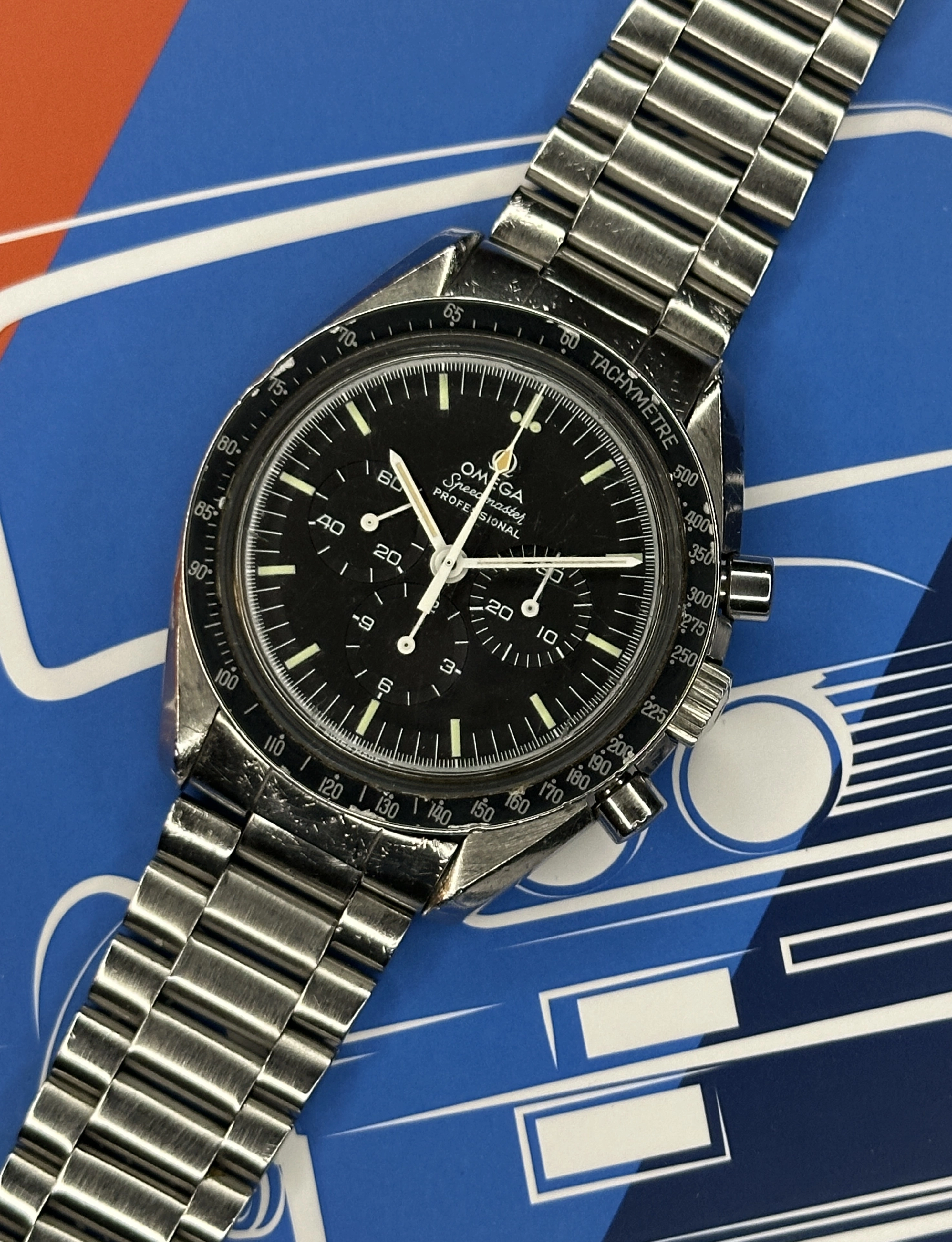

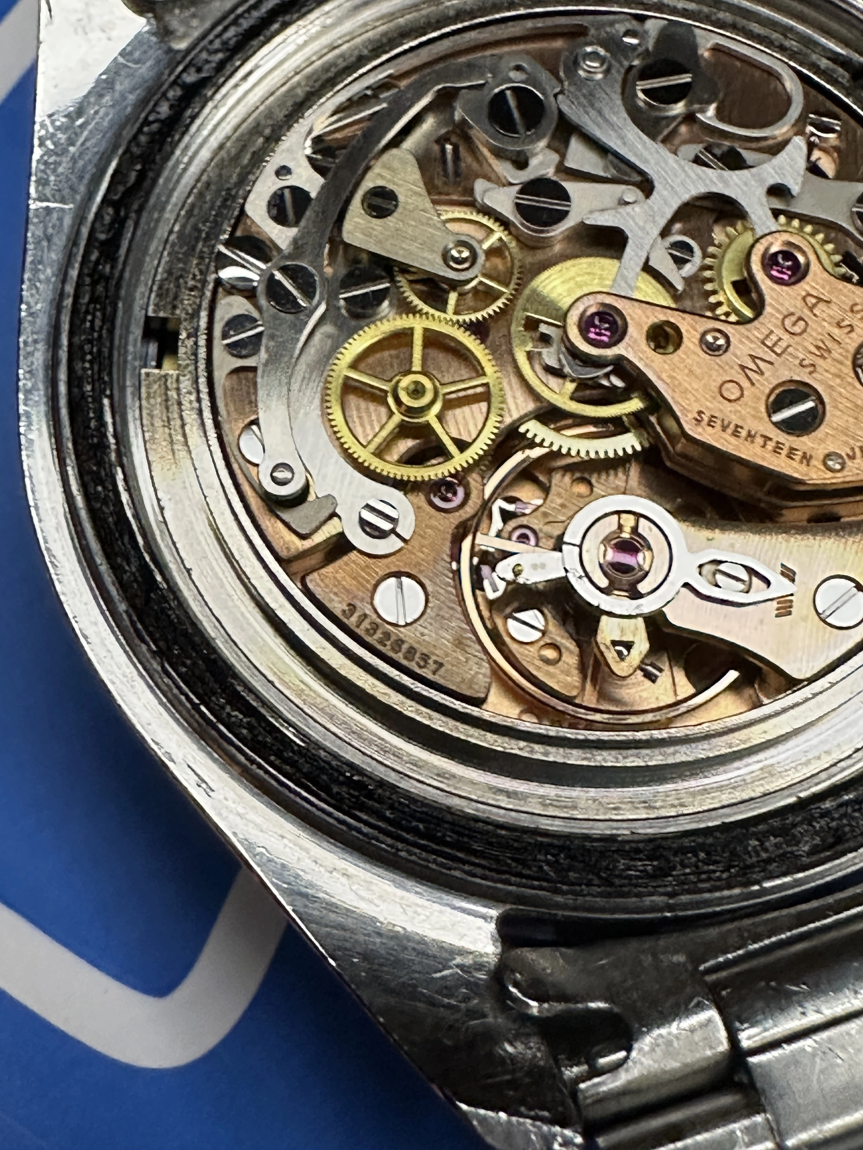

At the very close of 2024, this 145.022-74 landed on my doorstep, which could provide a further data point towards the originality of early serial 145.022-74's. In this case, the serial is 27328xxx Apologies for the relatively poor pictures, daylight is in short supply here at this dreary time of year.
To my eyes, this watch is completely unmolested and almost textbook correct. Sharp correct case and bezel, lovely dome dial and as some of you might have already noticed, rather orange lume in the chrono seconds hand in comparison to the other hands. The latter is actually something commonly seen in this specific reference. The only thing that deviates from MWO is the presence of a very good condition 1116 with the correct vintage 575 end links. This is a bit strange as one would expect this bracelet only up to the 145.022-71, still, no reason to doubt this examples originality, I think.
What is actually new about this example, though, is that I believe it is the first one to turn up with original papers, confirming the early serial and a sale in September 1975...
Preliminary conclusion
Based on the discussions that took place here before and taking this new example as an additional data point, I am to believe that Omega did indeed deliver a number of 145.022-74's with older movements that had been sitting around Bienne for quite a while. I would definitely welcome more discussion and data points to see if we can establish that those early 145.022-74s are actually original and should no longer be considered Frankens. As soon as the EoA service opens again (if ever), I will still request an extract for this watch to confirm the movement started its life in a Speedmaster, but I have little reason to doubt this given the condition and presence of original papers.
Discussion welcome! 😀

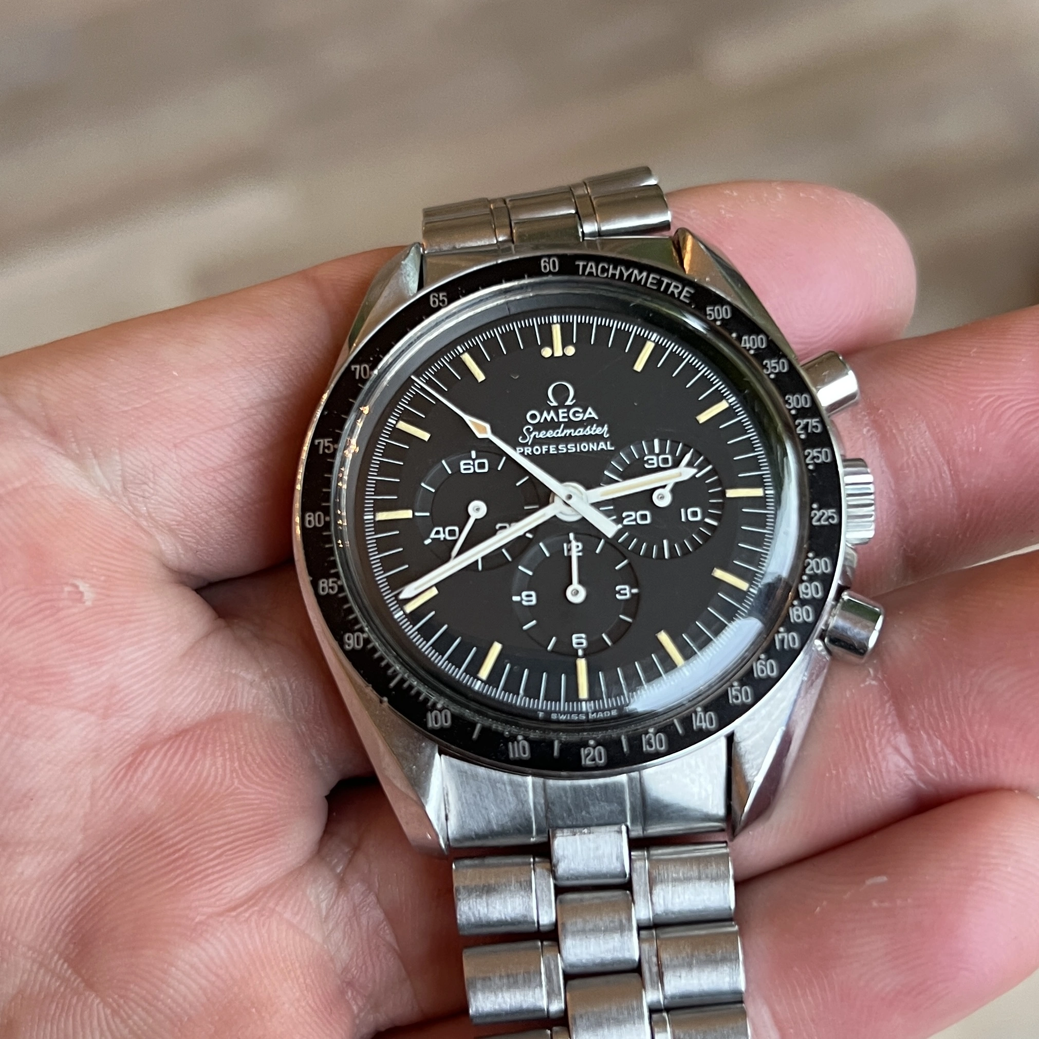

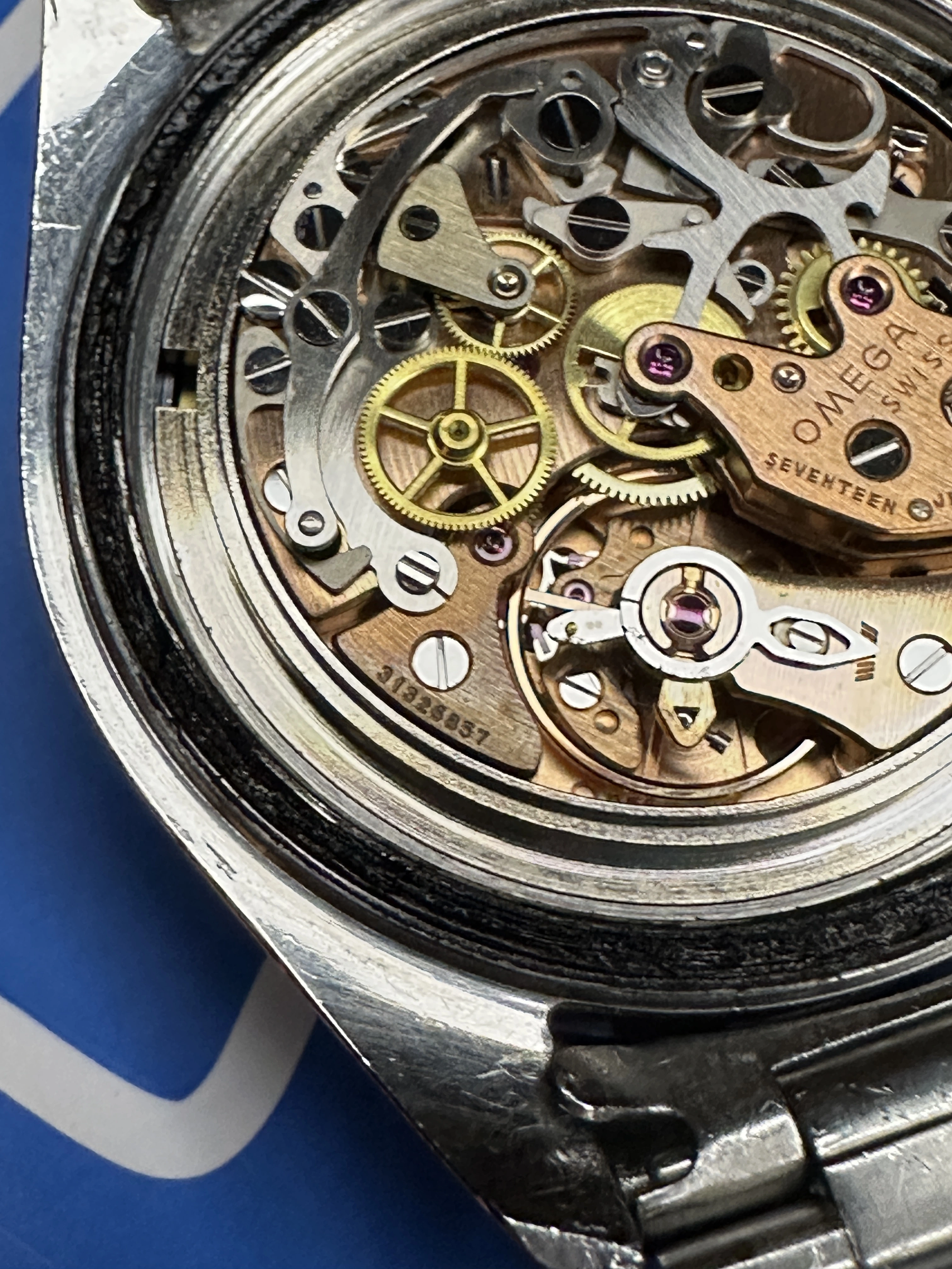

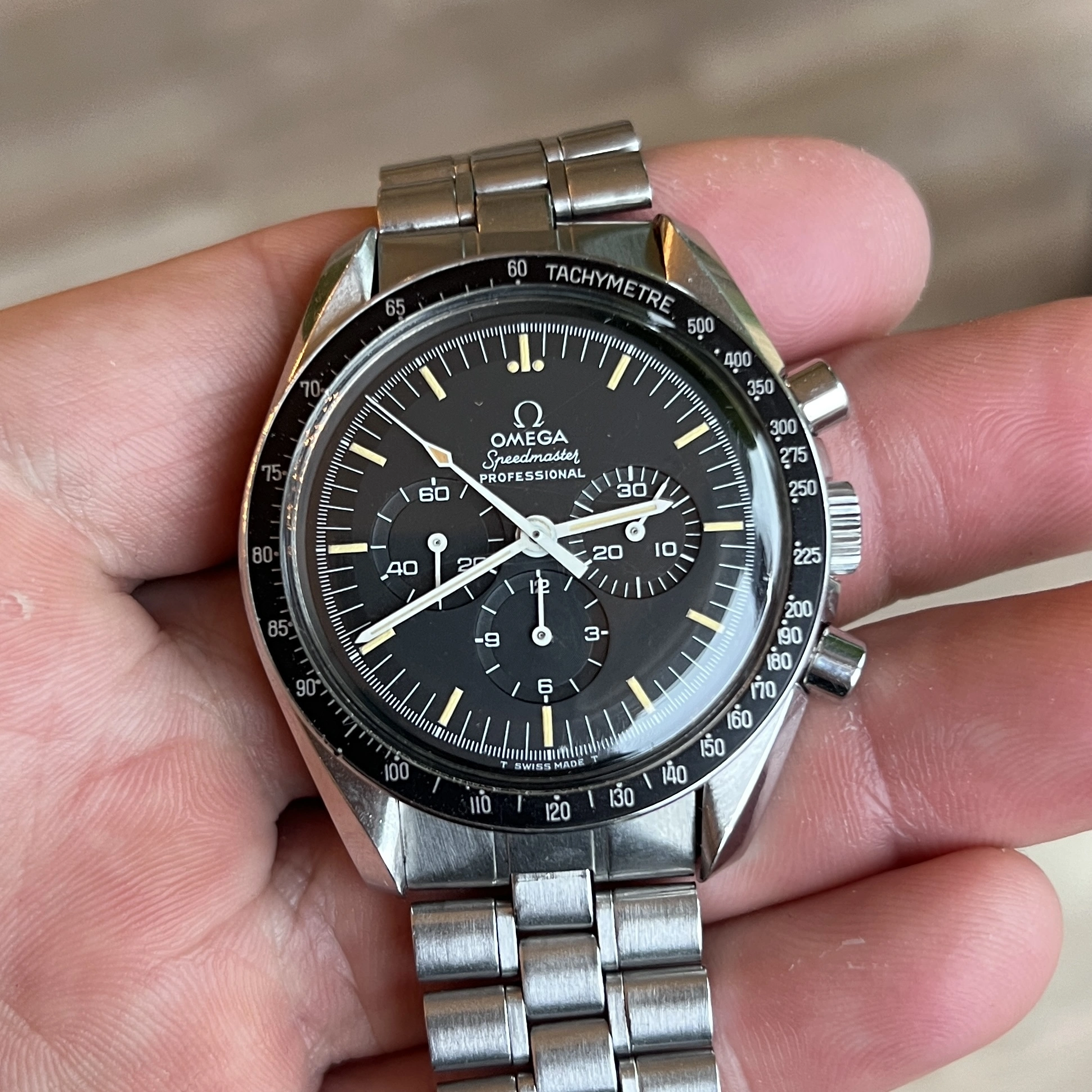

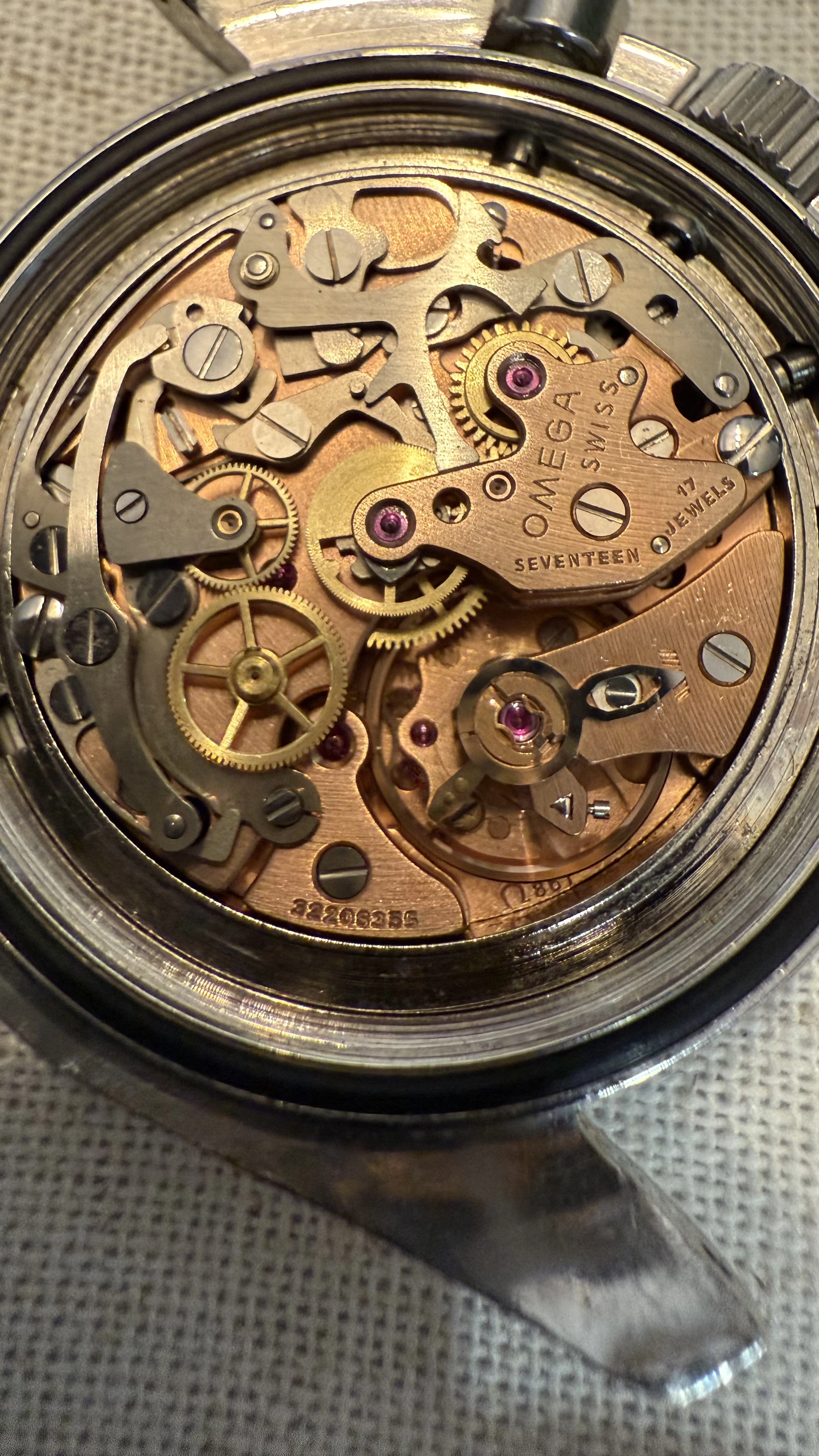

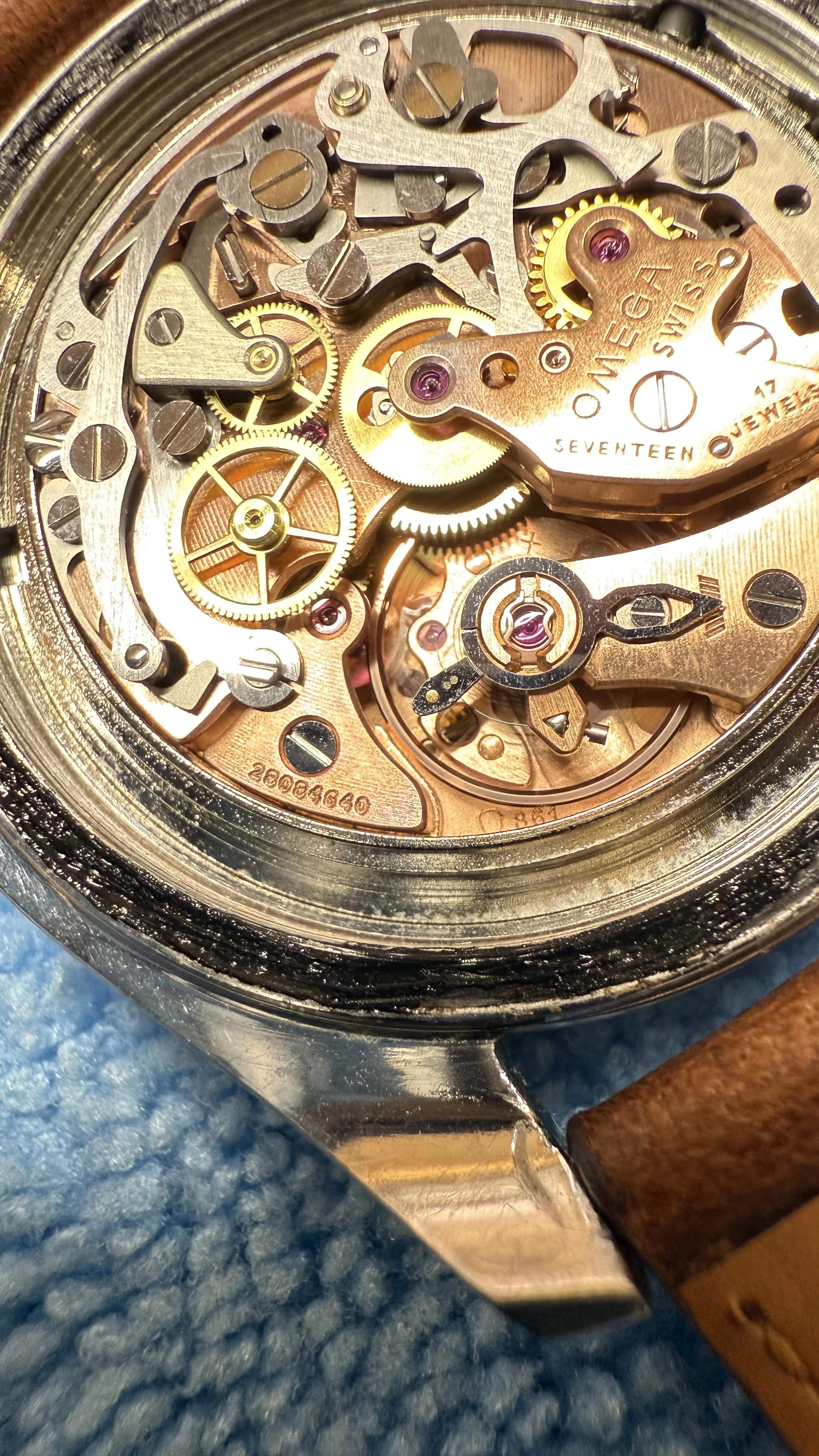

My recently acquired 74ST #3132XXXX:

Possible, certainly possible. In this case that is not very straightforward though, as it would have meant an updated dial (from step to dome) too. Still, possible.
On second thought; I doubt this would really be the case. Because of the case. A 273xxxxx like mine would in the theory of previously shipped and unsold watches have been sitting in a 145.022-68 with a very specific caseband shape and DON. So, that would have meant a conversion of not just a caseback, but also dial and full case.
As much as I like the theory as an interesting hot take, the simplest explanation is usually the best. And the simplest IMHO would simply be an overstock of movements originating from approx '69. No surprise as demand forecasting must have been impossible at the time (as admittedly it currently still is!) given a spike resulting from the moon landing publicity and the upcoming quartz crisis.

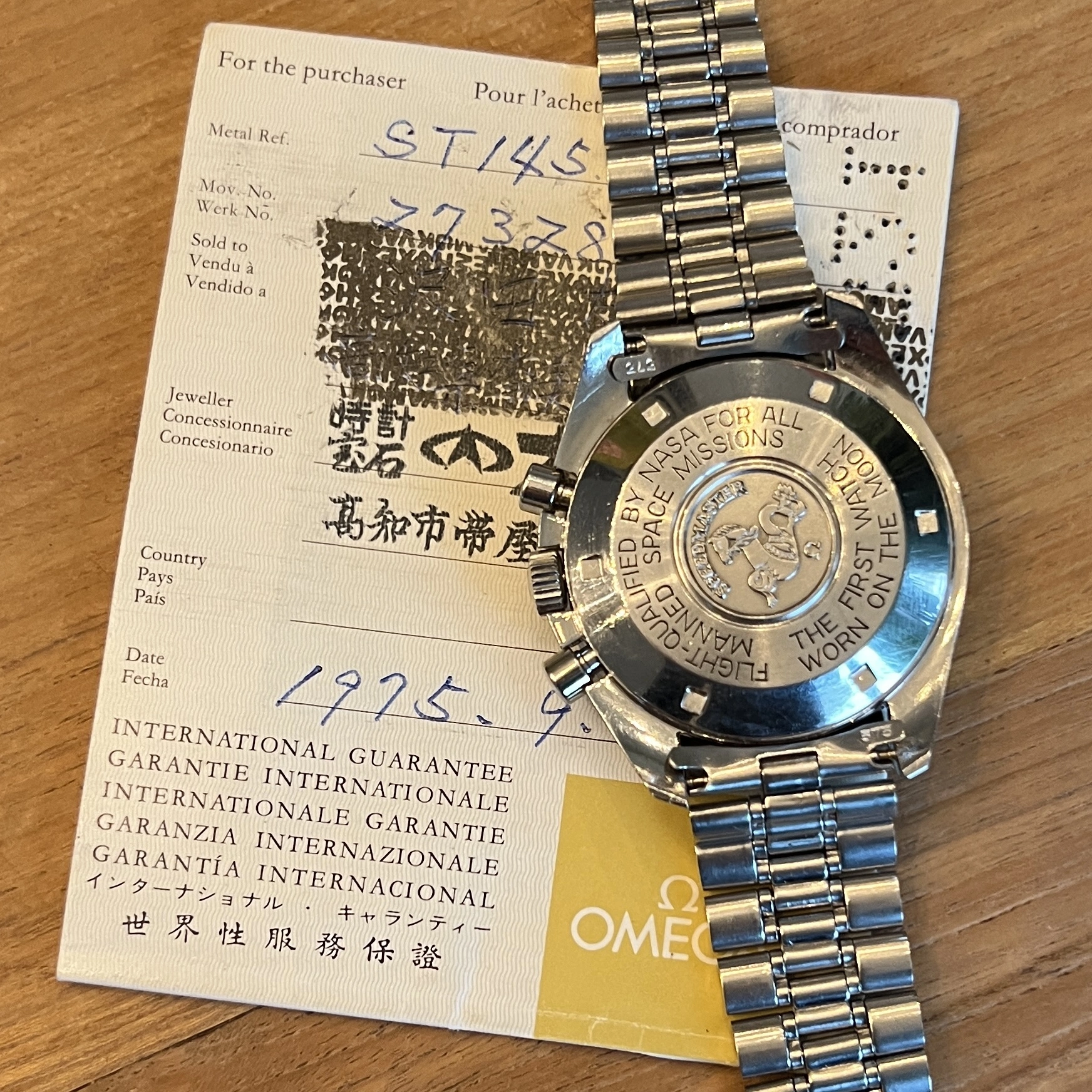

These are the early serials with extracts with later delivery. Not watches with early delivery on the extracts and later casebacks.
I get that. I’m simply saying I don’t think it’s beyond reasonable possibility that dealers, the Omega factory in ‘69 or the early 70’s (or dealers under the direction of Omega) ‘updated’ some elements of older, unsold stock to ride the wave of popularity of the moon landings.

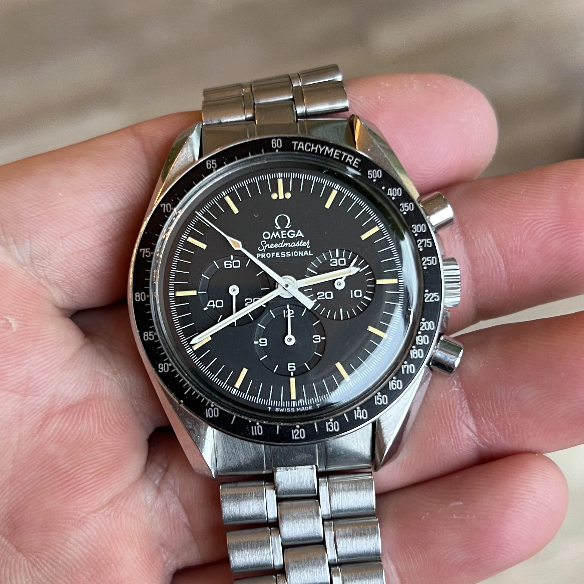

My data did not show this when looking at the extracts.
