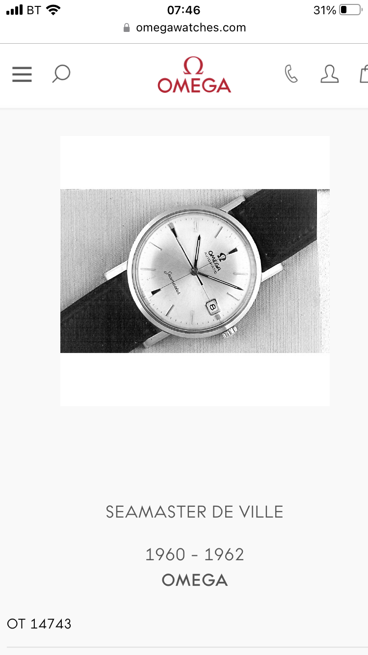

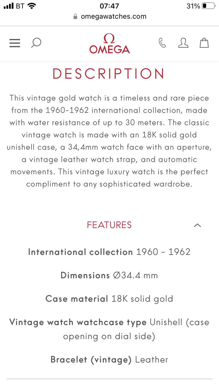

Hi @PlainVanilla , I believe when you originally wrote this you had thought following the same logic, it was 14742 and/or 14743 that became ref 166.025:
I searched omegawatches.com vintage section for 14742 (no results) and 14743: which came up with a photo and description exactly the same as my watch ! 14743 did indeed appear to be a “ 18k gold, rare, 562” watch line 1960-62, that must have changed to 166.025 SC-62 in 1963. See photos from the Omega website below. Regards

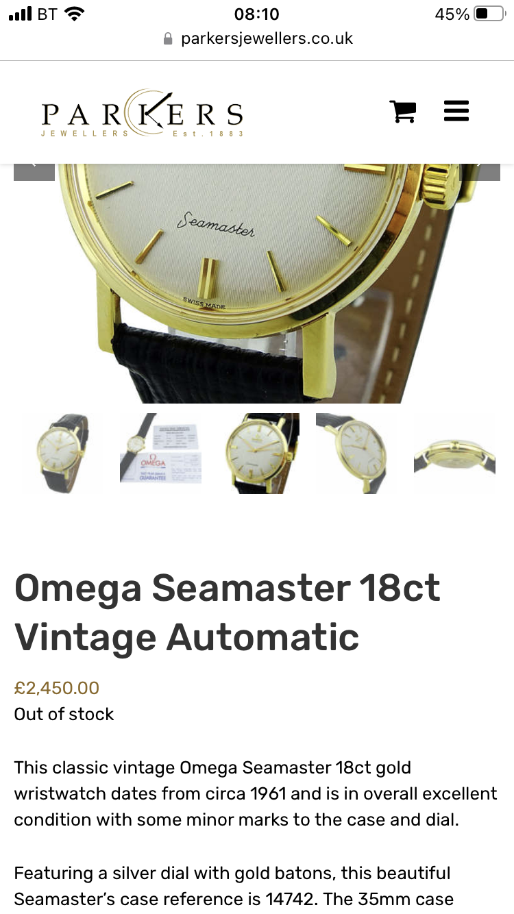

And finally, I found a 14742 on a reputable site which appears to be from of the same 18k only luxury range as the 14743, but without the Date function.
here’s a pic / some description of the 14742 I found. No gold bracelet, not date, and I’ve just noticed the movement is 552 - meaning this is a different watch to 14743 (which has 562 movement). I now believe the 3 watches 166025 SC-62 are all 14743.

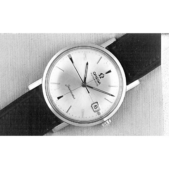

Concerning 14743:
14743 (the big visual) is presented as a 18K solid gold watch on a 18K solid gold bracelet, with BA 14770 being the equivalent with a crocodile strap. I believe that 14742 is the no-date version of BA 14770.
Some additional info:
- 14742 and 14743 were only produced in solid gold,
- 14770 was produced in all materials (steel, gold cap, solid gold),
- The letters 'BA' before a reference number mean solid yellow gold,
- This is an English catalogue, hence the presence of English reference numbers. In reality, the English BA 3665801 and the Swiss 14743 wich are presented as the same watch were made by different manufacturers. They are presented as equivalent references because they are both 18K solid gold automatic date watches sold on a 18K solid gold bracelet.

also interesting to see the BA 1665020 reference alongside the 14770 reference - the former most likely a Dennison gold case.
884
1,749
Absolutely, it is a Dennison case. It is interesting to see English reference numbers alongside their Swiss counterparts.

We should be careful with using the word "rare"
We should be careful with using the word "rare" when referring to Omega Seamaster watches which were generally produced in big numbers. It might be that this reference, which came only in 18k, was more prone to land at the smelters and so relatively few may have survived today. I don't think value is affected. After all, reference 166.020 is quite similar.
As to the extracts, Omega has suspended that service. It is supposed to be temporary. So we'll have to wait and see.
My bad; for using the the word ‘rare’. As stated early in I’m new here, and new to Omega ownership. I’d only found one reference (yours, here) to 166025 on the web, followed by much conjecture rather than facts about this reference number. Seemingly, ‘we have only found 3 examples of 166025 in the universe. Others on here have said “low production run”, “produced in low numbers”, “equally scarce” (ref 14742/3), and even on the official Omega website 14743 described as “rare”. I also find it difficult to believe that “relatively few may have survived” (of these ‘high end 18mm watches - am I allowed to say high end?) because they’ve been smelted down.
