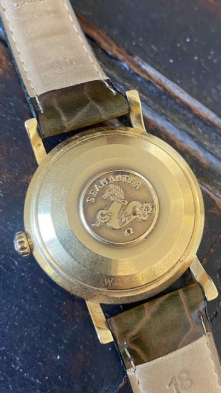

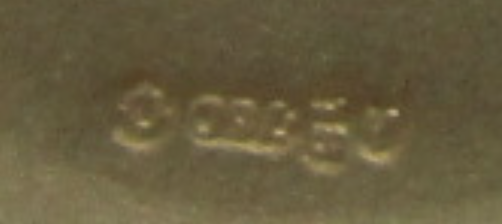

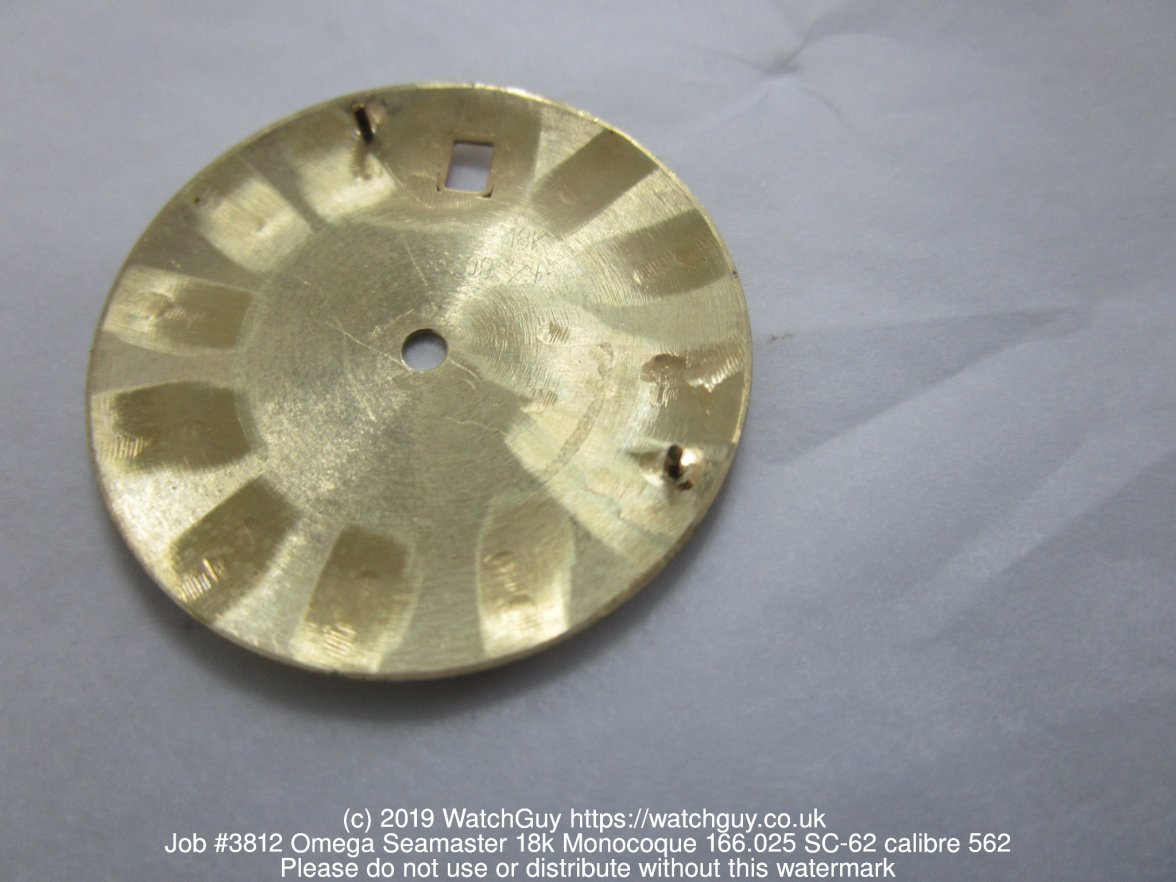

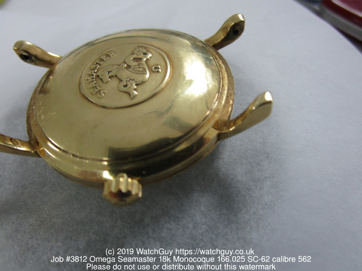

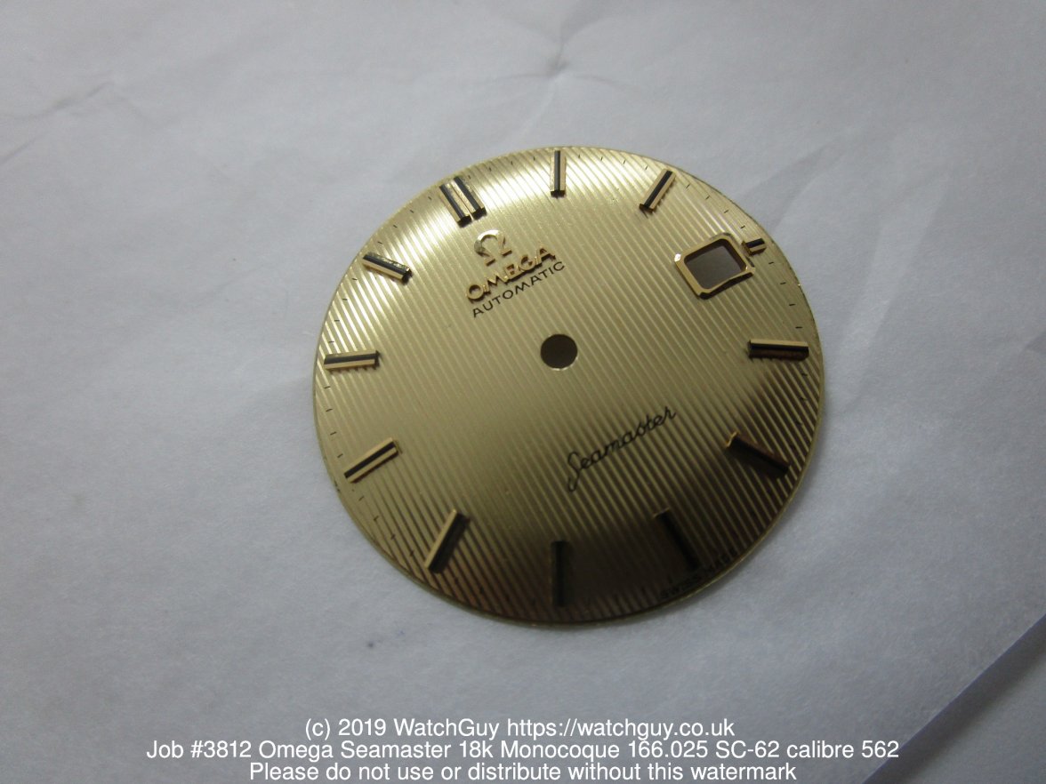

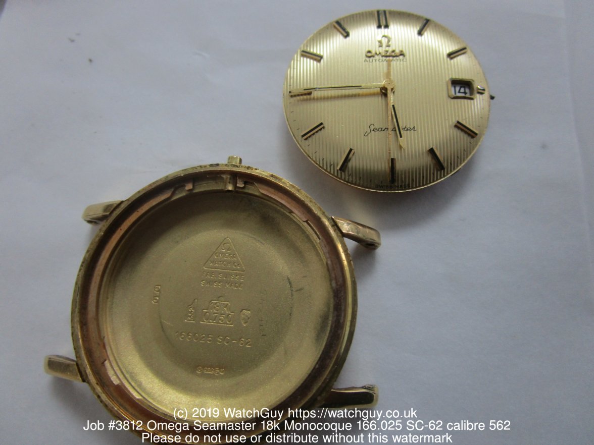

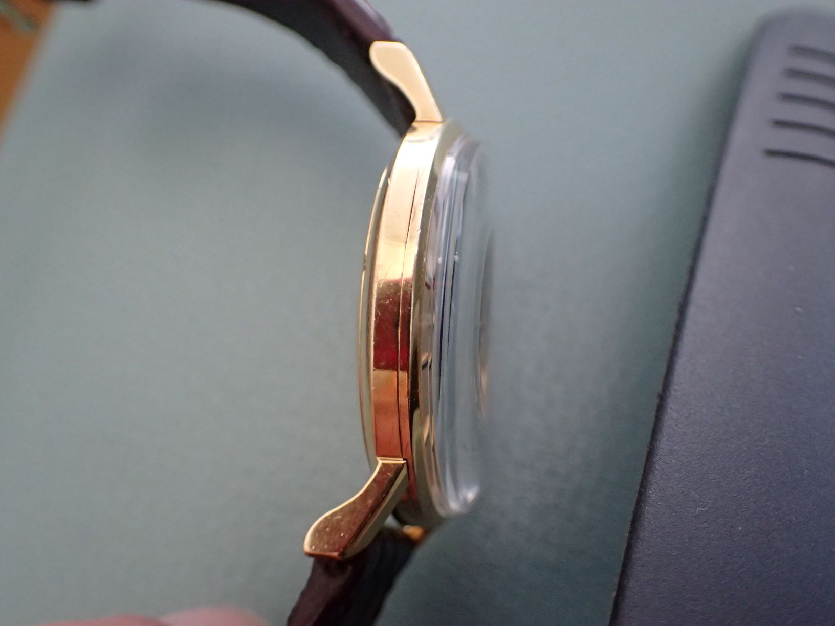

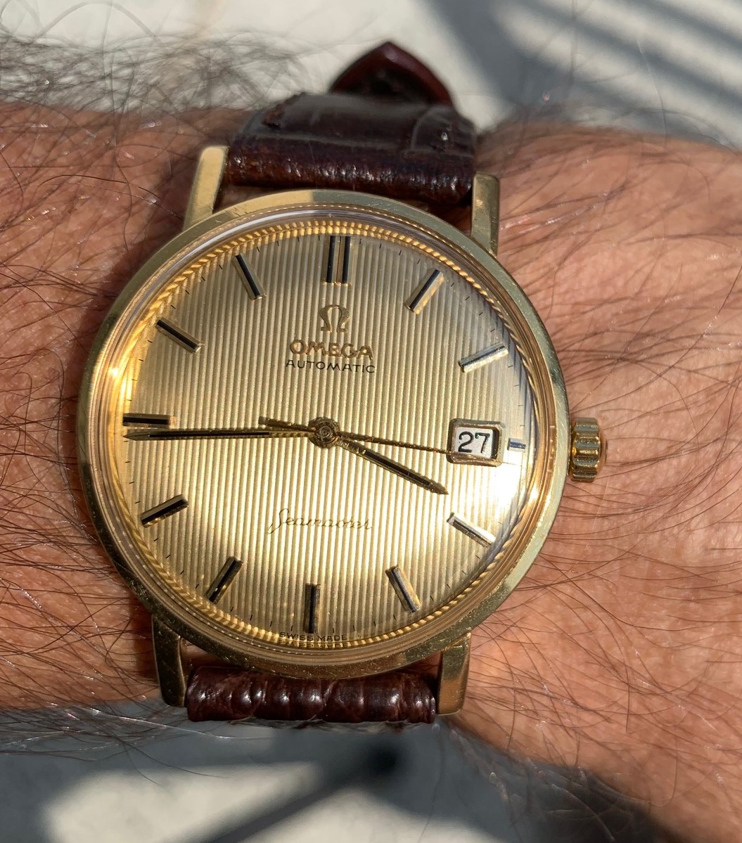

    Would like to show you a watch I bought at auction a few weeks ago with a most magnificent (IMHO) dial and a mystery case reference. It looks like a 166.020 Seamaster with the expected cal. 562 and has a 18k case with english import hallmarks in addition to the usual swiss ones, but is engraved at the back 166025 SC-62. Reference 166.025 belongs to the Baby Ploprof, so it can't be right and I am wondering if anyone has seen a misprint (?) like that by Omega, ever. On the other hand I'm not quite sure it is a 166020 because the shape of the lugs is a bit different here.
    Anyway, most important for me is this 18k Flückiger striped dial in exceptional condition (in contrast to the case back which is a bit battered and polished). Here's the pics (a number of which are from the Watchguy, my watchmaker):

    1660025 is the right case reference for this watch, so there's no mystery here.
    Cheers, Al

    Thanks @Archer. Couldn't find 166025 or 1660025 in the database and Google is no help either. This seller claims about a similar watch that the case reference was used by mistake and it was really a 1660020. And there is the thing with the Baby Ploprof which has the case reference 1660250.:confused:

    I don’t think the seller knows what they are talking about. This case reference is for a Cal. 562, so it matches up just fine.
    Edit to add case description from the Omega Extranet:
    055BA1660025 | YEL. GOLD CASE 18CT 2N18 CAL. 0562
    And just so you know 1660025 and 1660250 are completely different references...

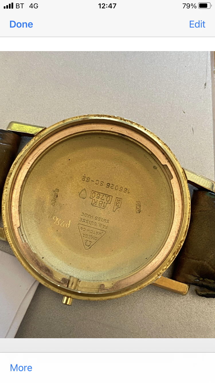

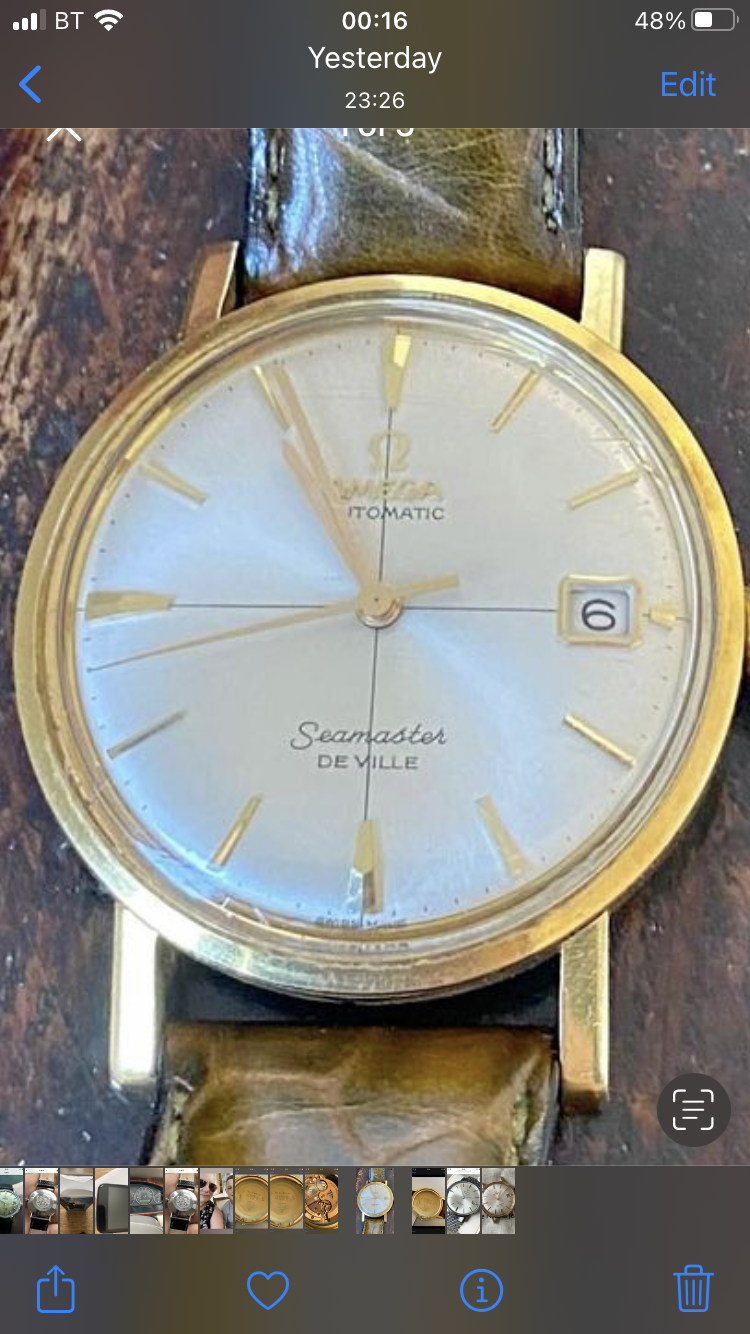

    @Archer regarding model 166025 SC-62
    I have bought an omega with the same model number in the case back, movement 562, 18k gold. This model seems Very hard to find / identify: in fact this is the only article I’ve found on the net!
    How can I find out more - you mention the Onega Extranet ? How can I find / access further information in there ?
    I’ve attached photos - different dial to @aprax (yet both rare?) but very similar stamps in the case.
    Could .025 (as opposed to .020) indicate a ‘custom’ model or production?
    Regards, Neil
    9CEE9736-EA0C-47FA-9D8B-52BA38DBBE20.png FB9611BA-B8D5-41BD-8753-CB9FDC81F2E2.png 60B465FD-A8DE-4175-A969-F8AB581B34CB.png

    The number '5' is the code number for UK. France is 3, Brazil is 9.
    .025 instead of .020 just means that the case was manufactured in UK. This reference was later replaced by 166.5020 with the '5' set at a different place.
    166.020 is a Swiss reference and can only designate a case manufactured in Switzerland by Centrales Boîtes S.A. and not Dennison or Shackman.

    I think you might be a bit off-piste there @PlainVanilla
    If it were English produced, it would have been 166.5020 not 166.025.
    The gold production marks are definitely Swiss
    Both watches appear to have UK import marks (for some reason ) plus the OWC stamp.
    It's possible they were imported by OWC rather than exported directly by Omega
    The left hand symbol is the import mark

    Both watches are Seamaster de Ville watches and have a similar lug profile to Swiss references 14743 and 14742. These two were available with gold and silvered dials, and even with dauphine hands. Reference 166.020 has a different appearance, especially the lugs.
    Although the reference number is close to 166.020, this is a different case shape with quite different lugs from these two. 18K gold 166.020 SMDV are different.

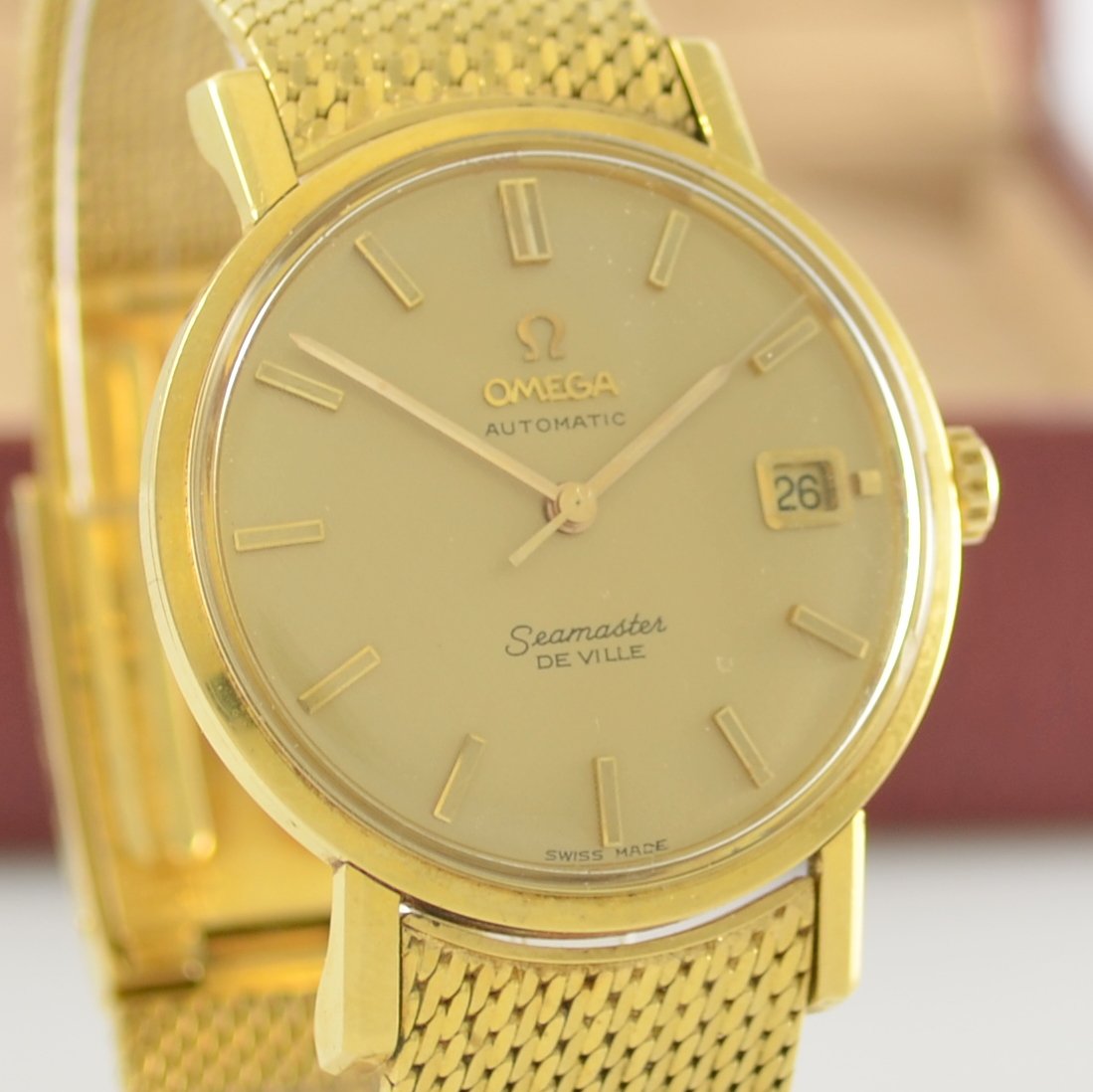

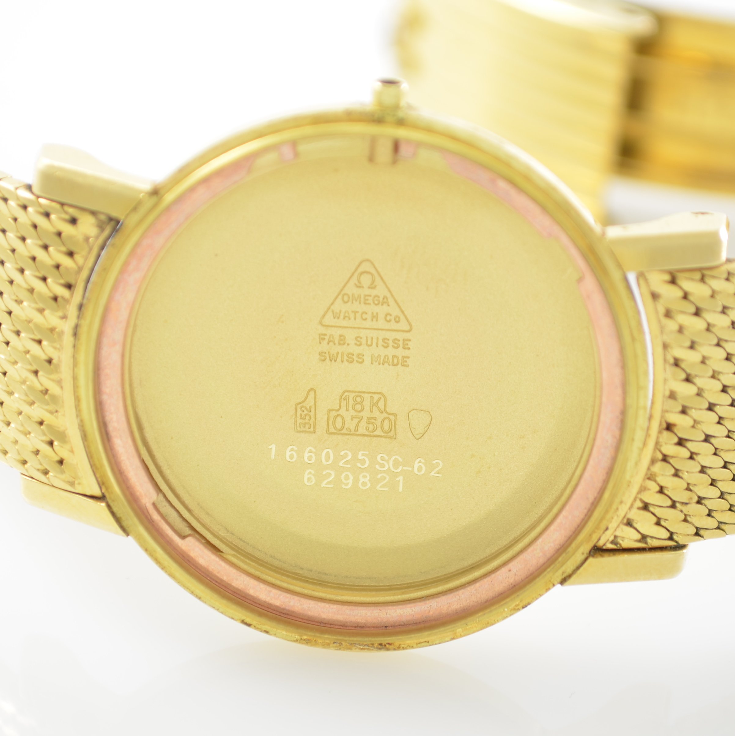

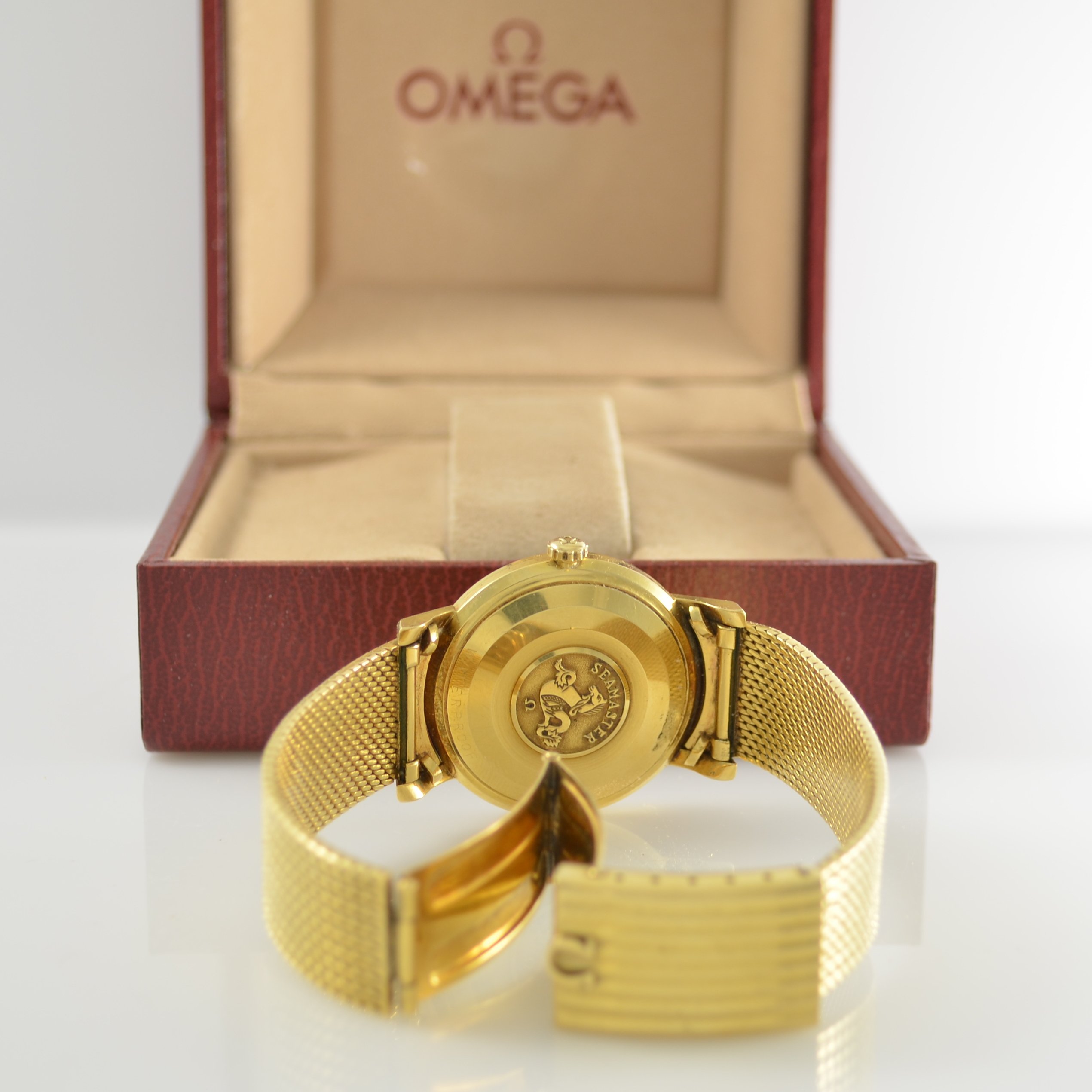

    As mentioned in one of my posts above, there is another example from an auction house catalogue:
    https://archiv.henrys.de/index.php?pc=list&SrchId=25640037
    That one is purely swiss and apparently a deluxe model. Pics from the auction house site:
    I am guessing that nowadays all originally 6-digit references from the sixties appear in the Omega extranet with a zero inserted between digits 3 and 4 and that this particular reference may have been produced in low numbers.
