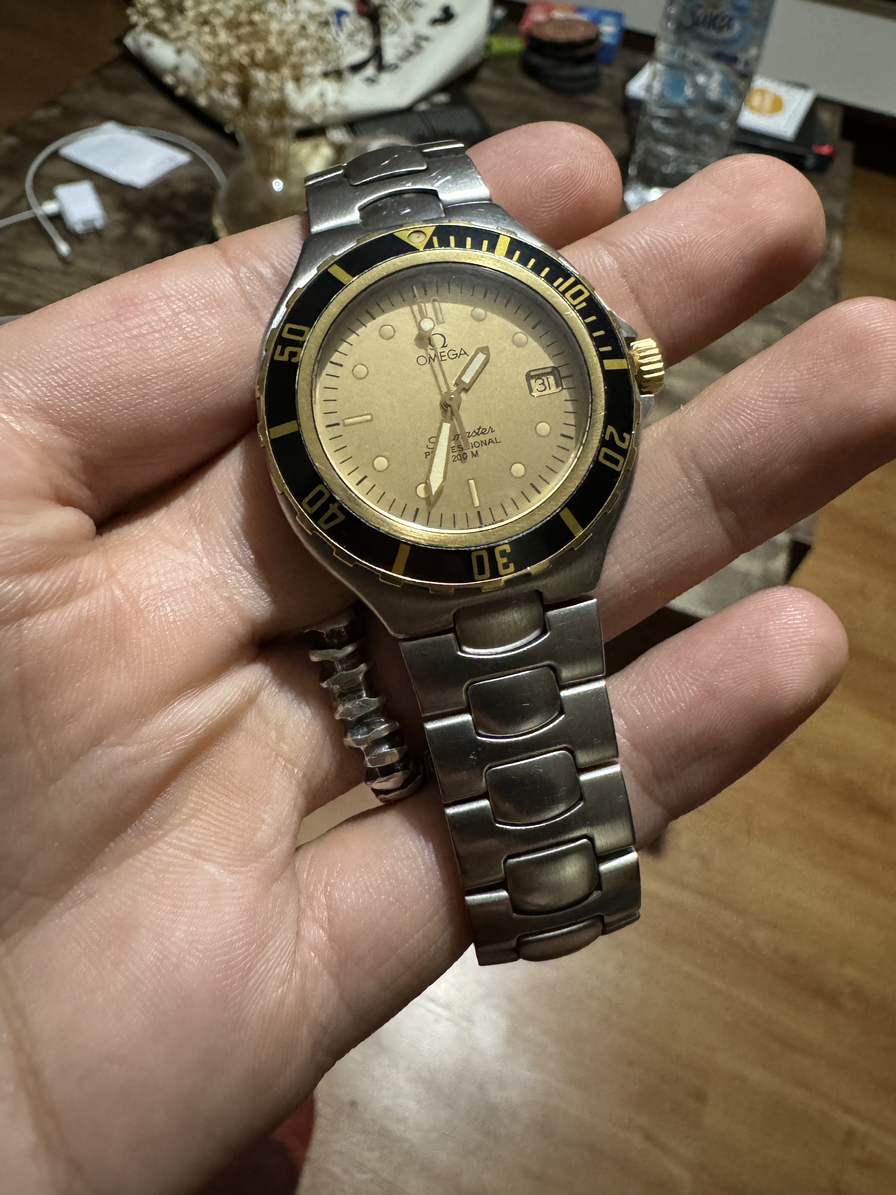

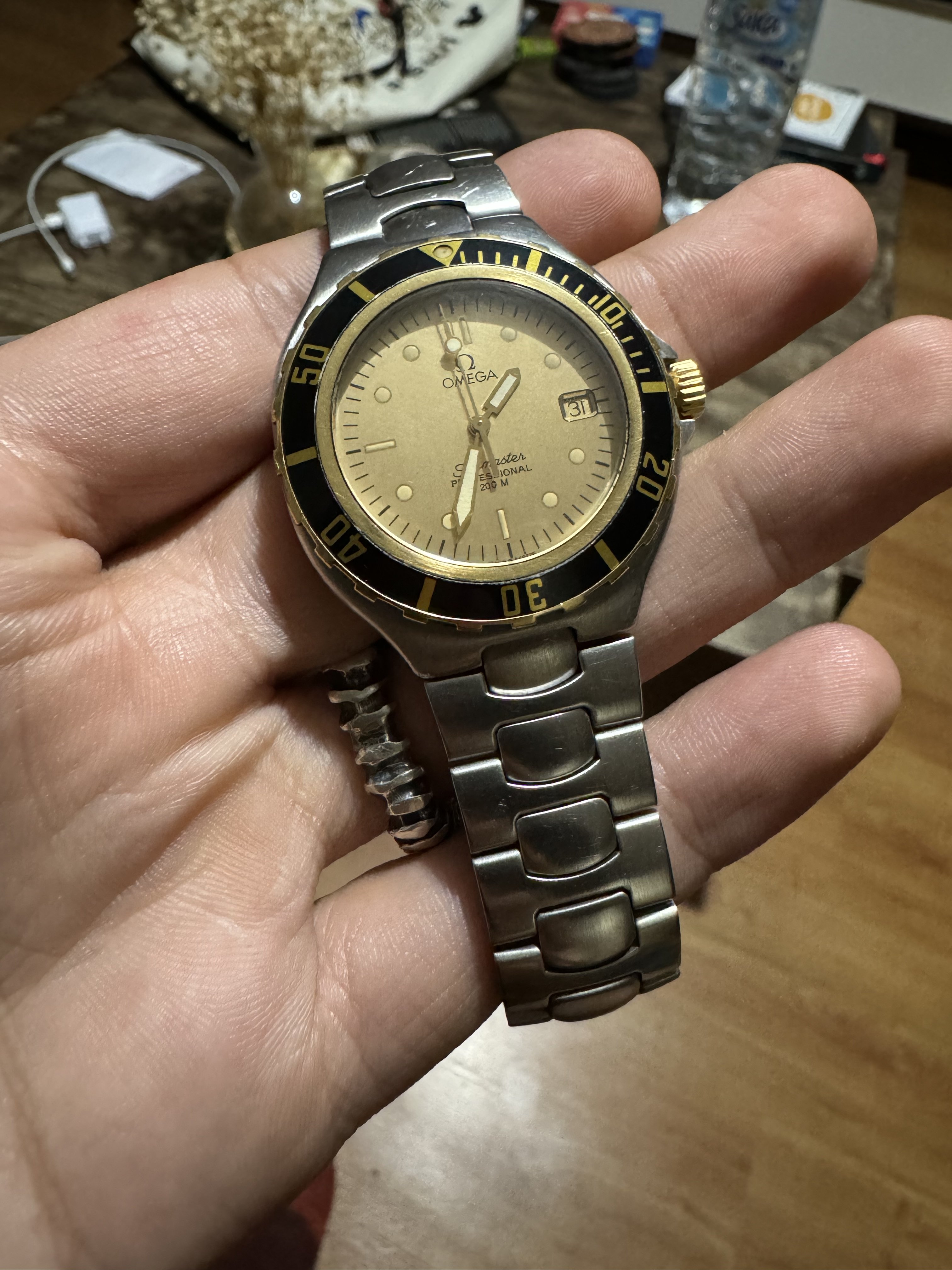

Hi dear OF members, When turning the bezel of my Omega Pre Bond watch, it does not make the sound heard in diver watches and turns a little easily. What's the reason for this? Does he need care? Is this normal? Please help me.

Sounds like the click spring is broken. Not something you can fix yourself unless you know what you are doing, but an easy fix for a watchmaker. Next time you need the battery changed, take it to a watchmaker with an Omega parts account and they can take care of it.

Thank you very much. Because I bought a steel Pre Bond and when I was turning the bezel in it, it was making a sound like it should be in Diver watches and it was not turning so loosely.

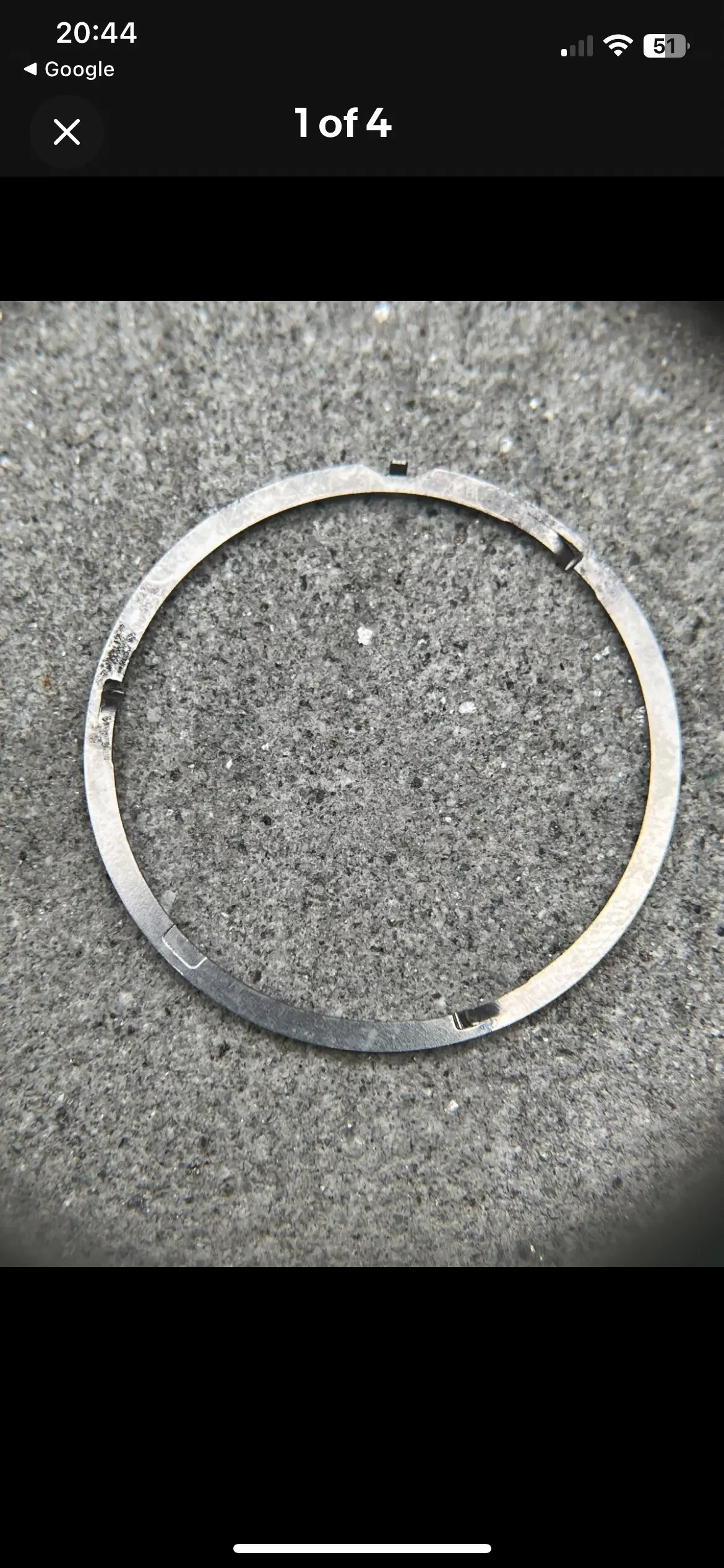

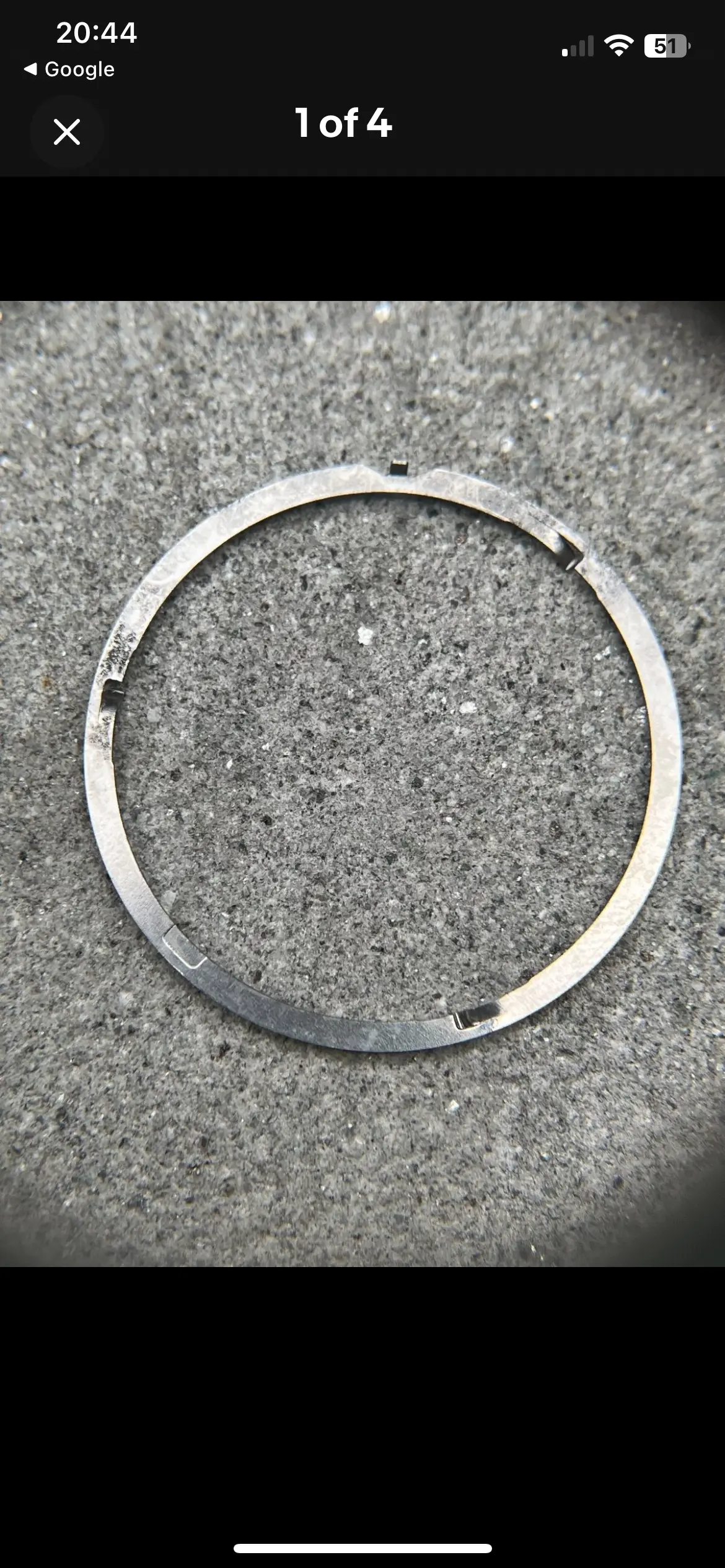

Donn is right, they are difficult to find. I have had a few watches that this has has had this fault, people don’t normally turn the bezel and they seize and a lot of people don’t know they only turn anti clockwise, so people force them and damage the tabs, if they are stuck I normally give them a little squirt with WD40 silicone spay.
I have attached a picture of what they look like, they are fairly easy to change if you have the tool too remove the bezel.
