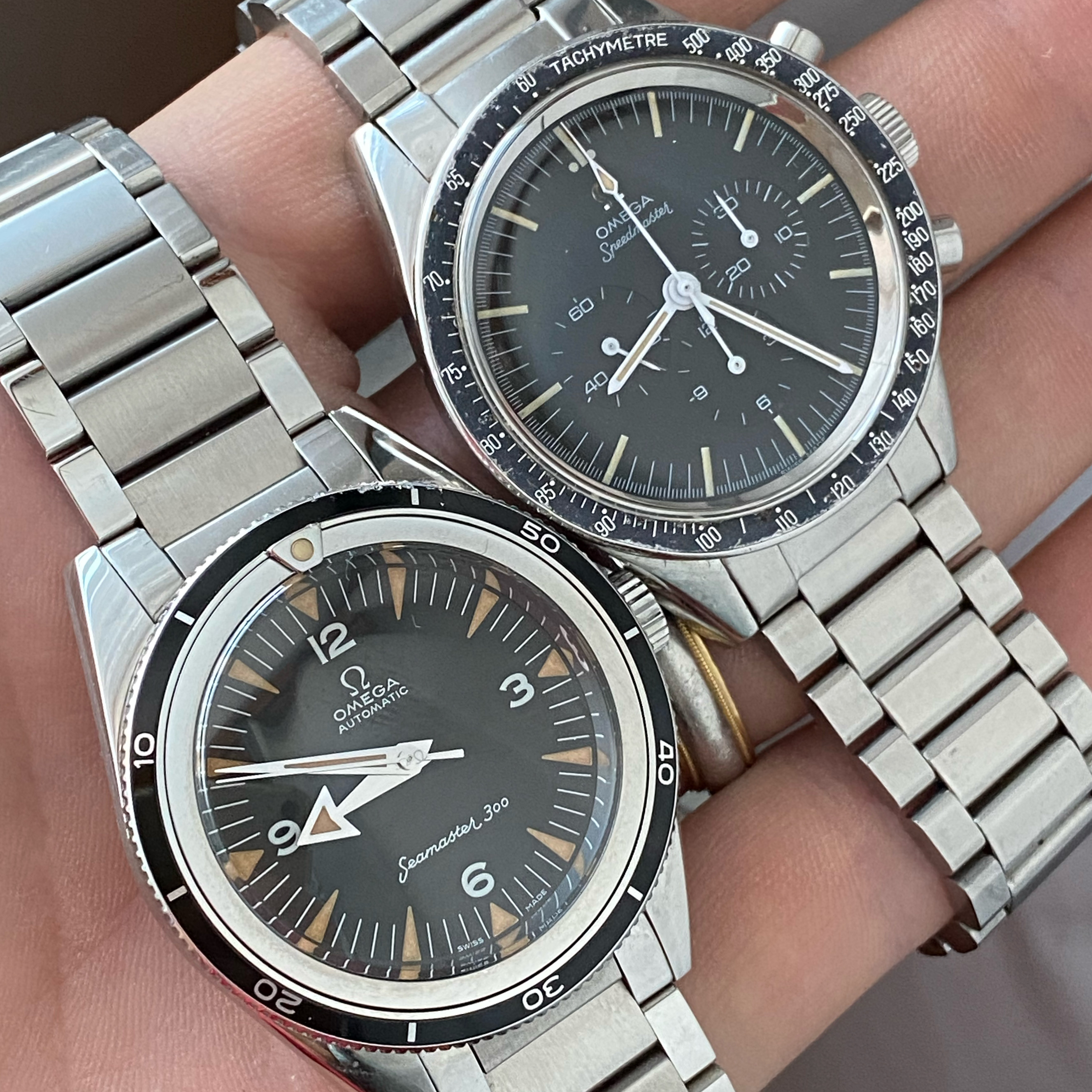

This is a great thread, so I'd like to start off by raising hat to the OP and all responders! I had similar questions/hesitations about reluming so I won't drown the forum with another thread about it 😀
Personally, considering that all hands still contain tritium in the Speedy of OP (and that indexes are still quite ok), my preference would be to leave it as-is. Just like @janice&fred et al., I'd rather the original state of the lumes. I personally don't use the vintage watches on daily basis and don't expect them to keep perfect time or glow in the dark to check out the time in the night (man, I merely look at my watch to check the time!!). So if the lumes are still intact despite losing some glow etc, I'd keep a 60 yr old vintage with its original, cancerogenous, radioactive Tritium no matter what.
With all above being said, I've also been thinking a lot about the pros and cons of reluming lately. As you might know, I've recently got myself my first Omega (an Auto SMDV) for which I'd like to thank all forumers once again for all the knowledge & expertise I gained through OF!
My watch also has some original Tritium content on the hands but unfortunately, the lume on the minute hand is entirely gone whereas the hour hand still stands. The watch is currently getting a full service and reluming is also covered in the charge. So I was considering getting both hands relumed (since, obviously, getting only the minute hand relumed would be pointless). The watchmaker didn't want to touch the dial so there will be no reluming on index pointers etc.
I wonder if you guys would also have different opinions about reluming when the watch hands/dial partially loses the lume/tritium?

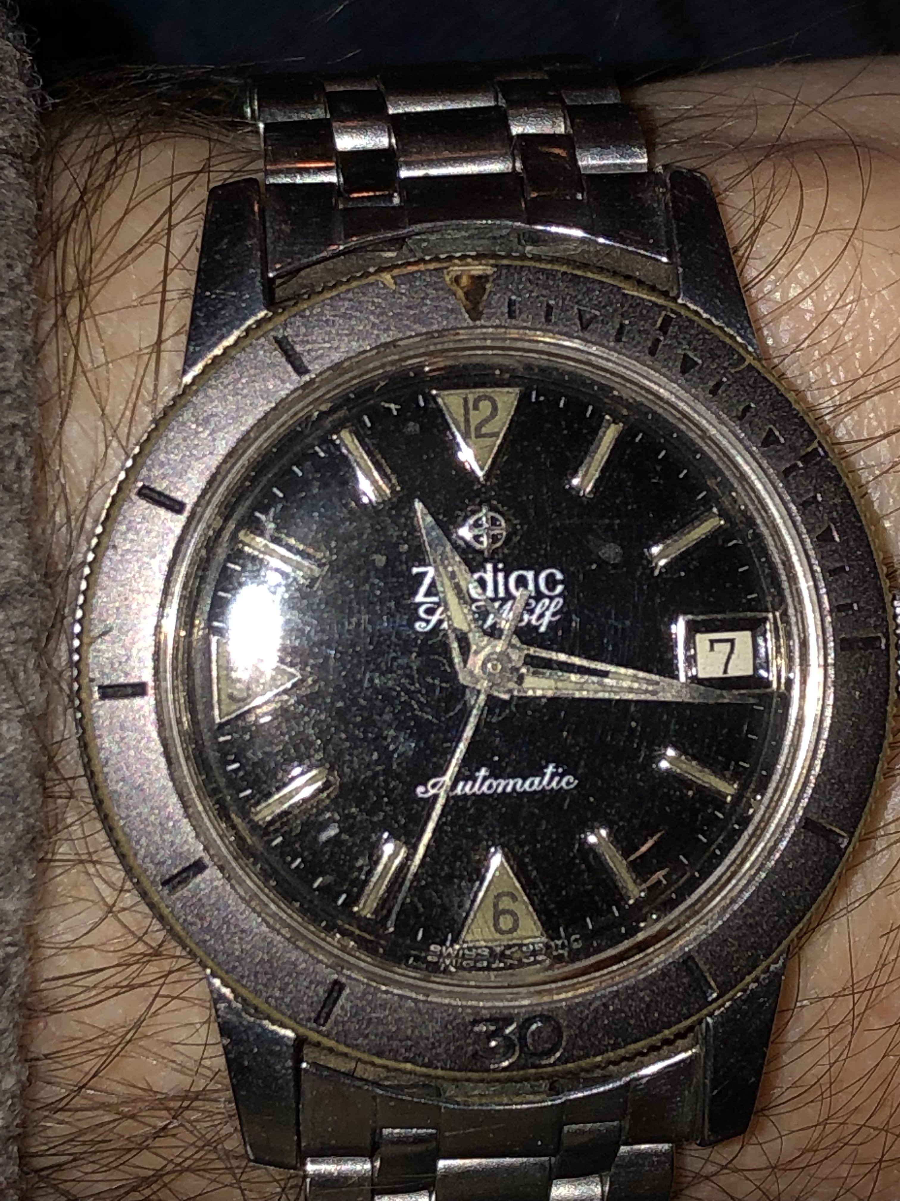

If your watchmaker can color match the hands then IMO it's a no brainer. Missing lume is-missing- it's gone. It can make a nice watch look like total shit.
A sympathetic hand relume can make all the difference.

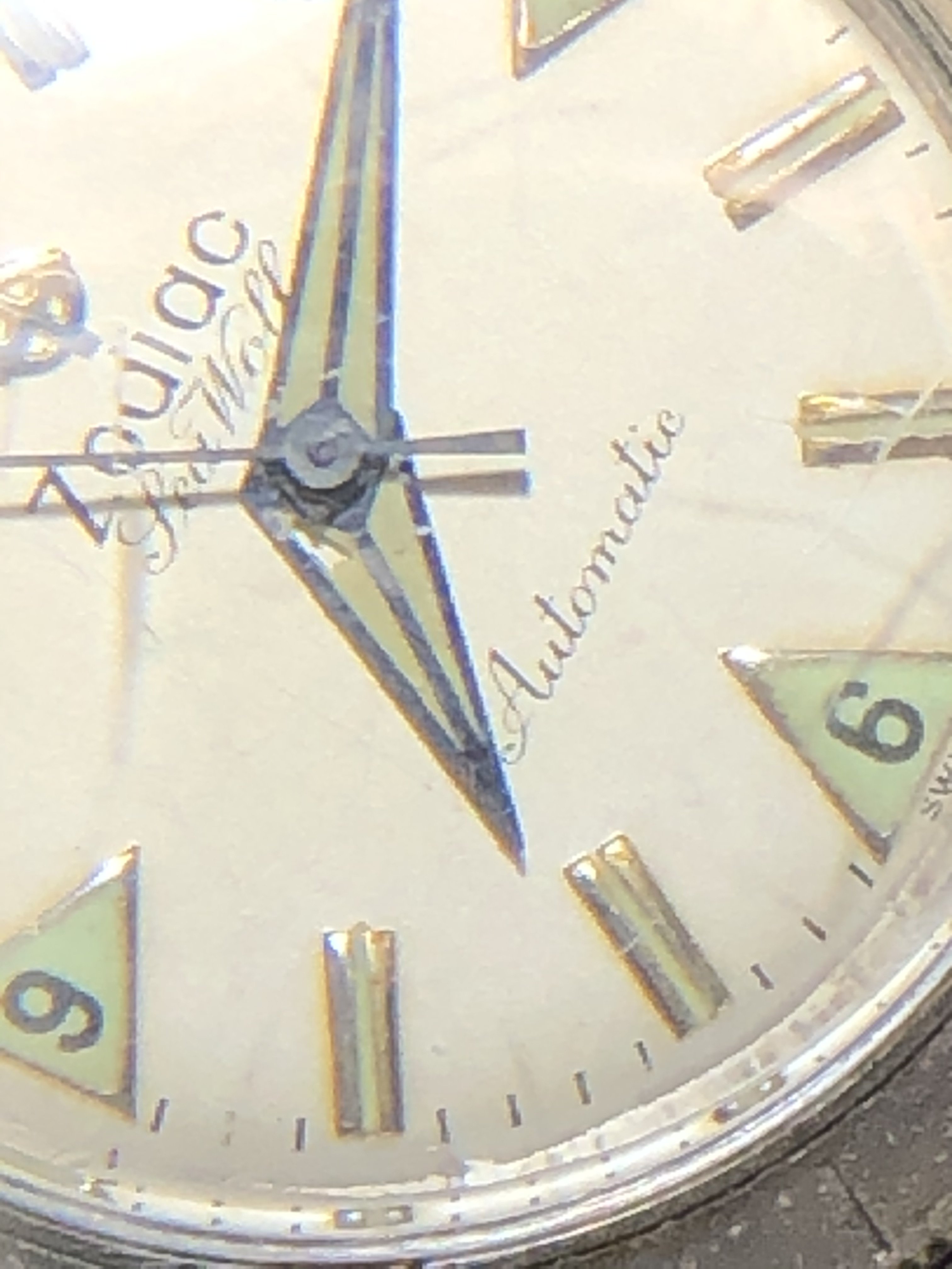

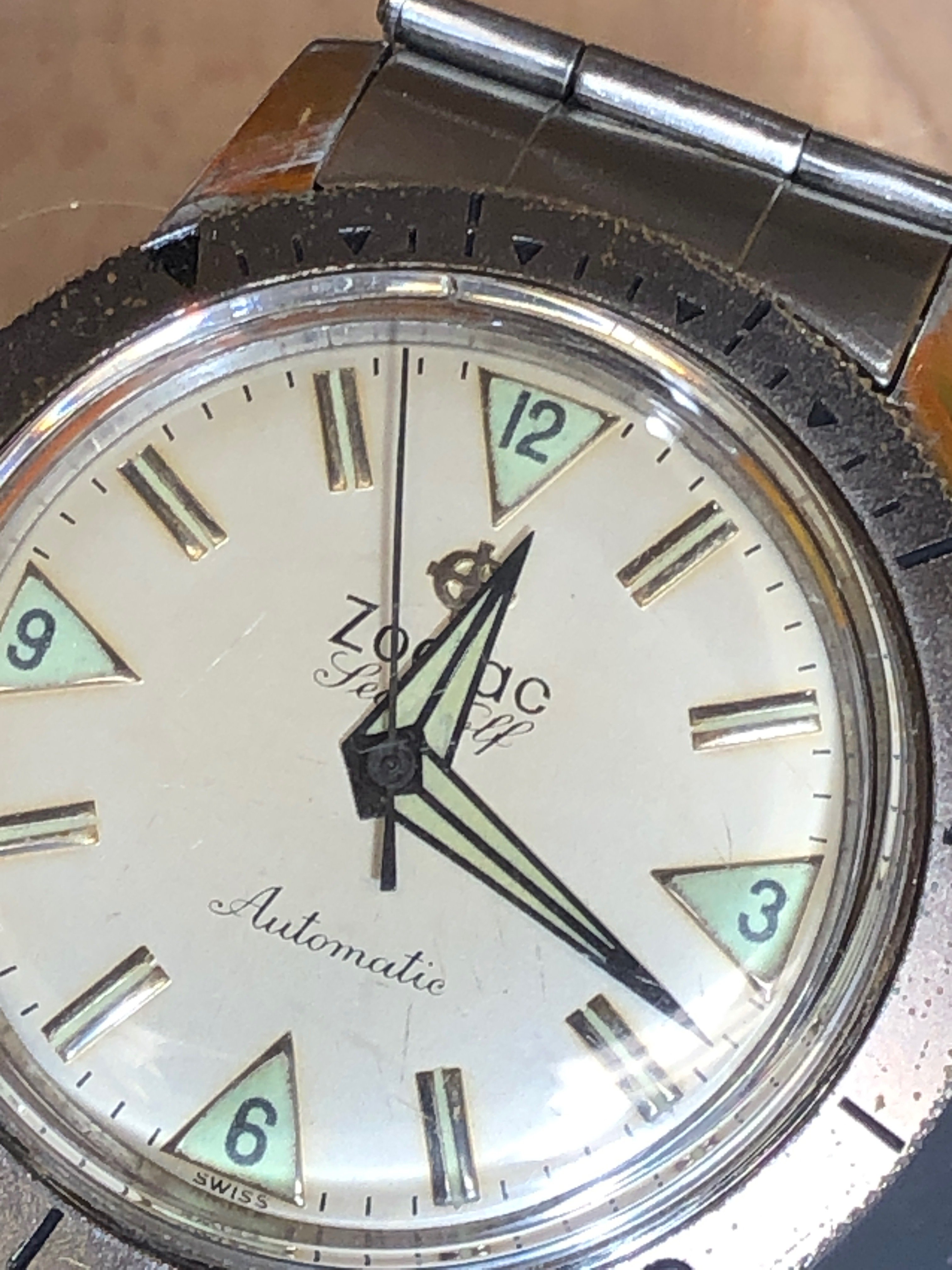

Amazing job out there! I'm wondering though, can vintage Tritium (faded yellow?) colour be matched with any superluminova? That would require an excellent reluming skills which would be quite rare IMHO. I've seen numerous reluming videos on YouTube and I've observed that watchmakers often completely clean all hands regardless of how much lume left on hands, for the sake of matching colours.
SLN can be blended with tritium/radium to patch. Whomever is doing the work needs to have very good color matching skills and know what the dry-down will look like. They also need to have a wide palette of colors to get it right- and it's not always a perfect match, but ca get damn close. Obviously they won't glow the same way under UV (which is good- the intent is not to deceive), but in daylight it looks fine.
This one came with a chunk of radium lume missing but the center
My friend blended the colors to get it right and filled the hole, then stabilized the back of the hand with the same mixture to keep the rest from collapsing
you can see a slight difference at the patch, but it's stable now and I don't have to worry about it falling apart.
This guy came with a lot of lume dust floating around inside the crystal. When my watchmaker took the hands off for service, the lume on the hour hand litterally disintegrated (a hazard with old lume no matter how careful the watchmaker is).
My friend relumed the hour hand to match the minute hand, including the darkening around the edges.

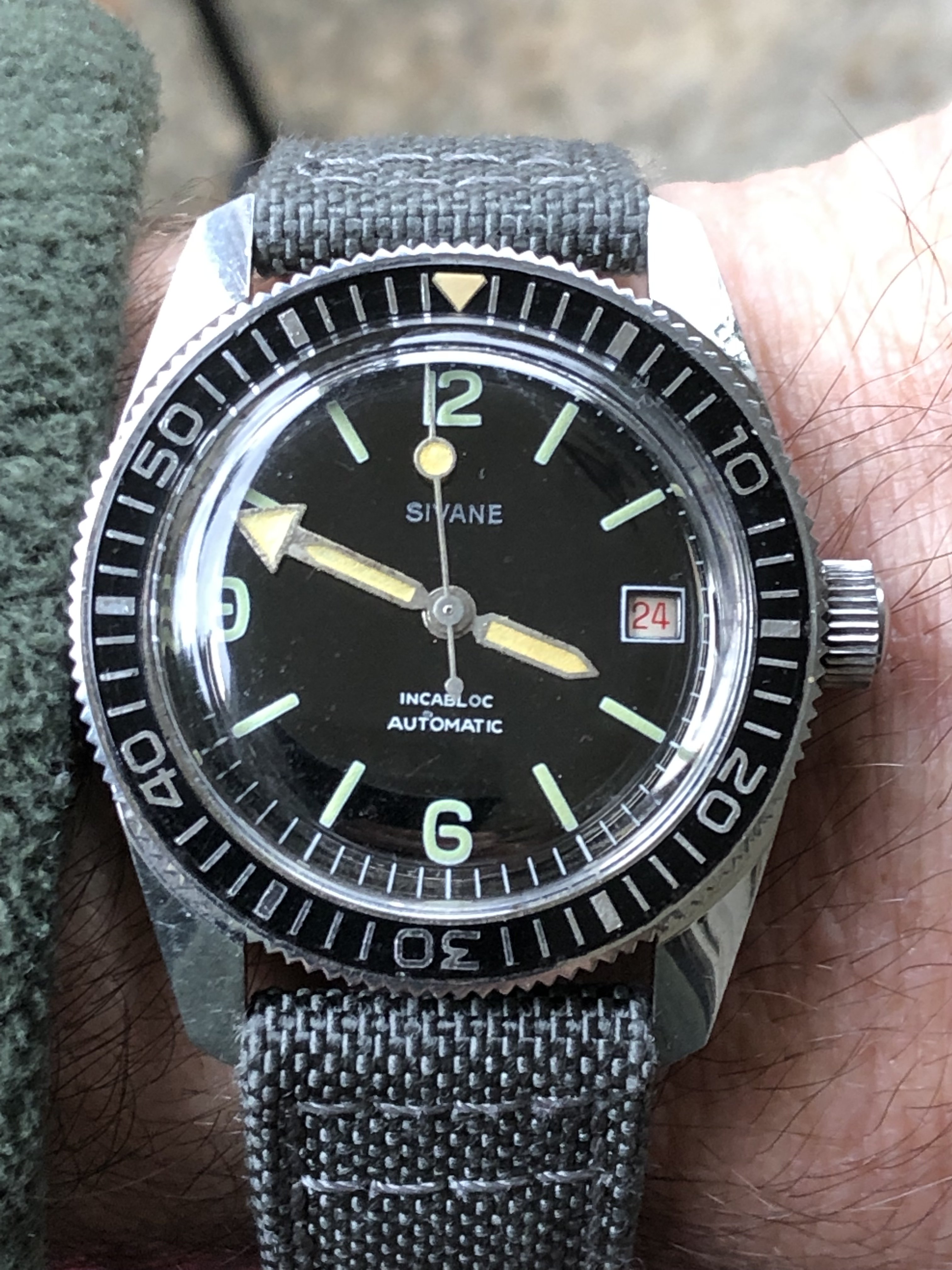

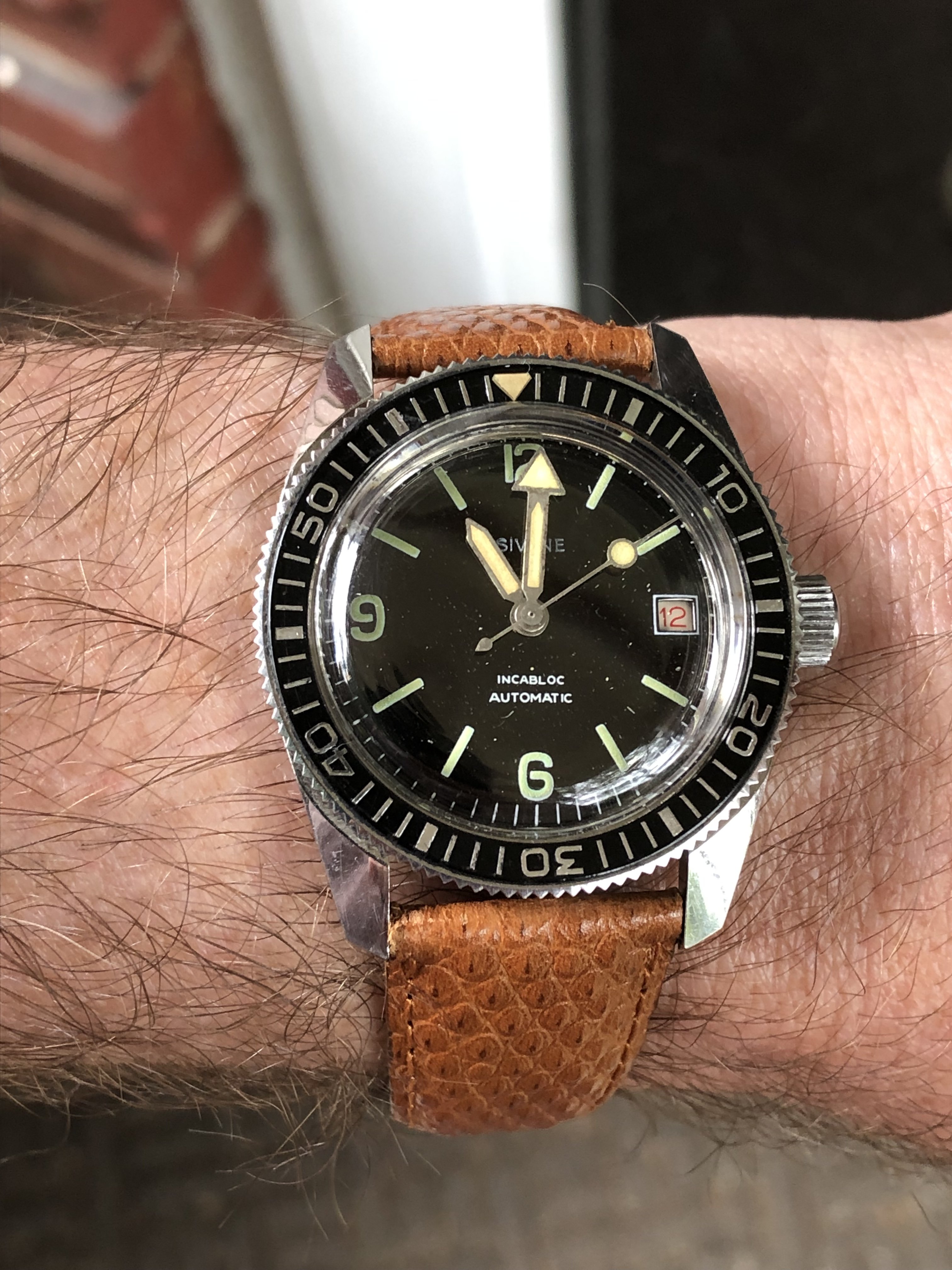

I just want to note- in the watches I have shown- there was nothing to lose. My hobbiest friend is comfortable doing hands and raised dial indices that have a trough for the lume- but he won't do free pips or large dots (like on a Rolex matte dial or a Speedy)- that work is for an expert and he knows his limitations. Although his work is good, it's not perfect. Work as critical as reluming a dial should be left to a professional.
Man, this is top-notch! I know your friend is a hobbiest but I've never met a watchmaker who'd agree to partially repair a missing lume. Obviously, they have some cost concerns regarding the time and money they'd spend for the superluminova material (probably at least two of them to get the right colour mixture!), experimenting right colours and applying a very slight touch of lume on hands. Requires both high level of patience and skills!
I can definitely distinguish two different tones of lumes but considering that this is a large image of what's normally a very tiny piece, I'm sure the new lume drops do perfect job filling dot-size spaces which would look worse in their absence. All in all, 👍👍👍
