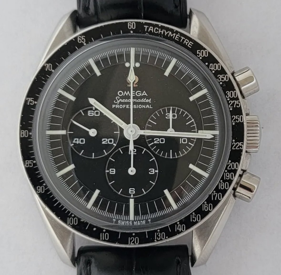

However, I noticed it had a step dial and long indices. I took a punt on it and made an offer…..and it was immediately accepted. It seemed like a bargain! Here is a listing photo:
However, it almost didn’t make it through the ebay authenticators, because the reset wasn’t working properly. The sundials reset but the center chronograph seconds hand does not reset. The seller ended up offering a generous price reduction to help pay for a service. It ended up looking nice in person:
I replaced the 1171 with an original holzer that I snagged on eBay shortly after buying the watch. I’ve reviewed speedmaster101 and MWO, and it seems to be an original dial with the lume cleanly removed. The crystal, hands, bezel, crown, and bracelet are clear service replacements. The serial number is 26,54X,XXX. The case is pretty nice, but has signs of polishing (such as on the caseback). I haven’t done much to the watch since, as I didn’t want to unnecessarily wear the movement especially with the reset issue, but I’d love your thoughts.

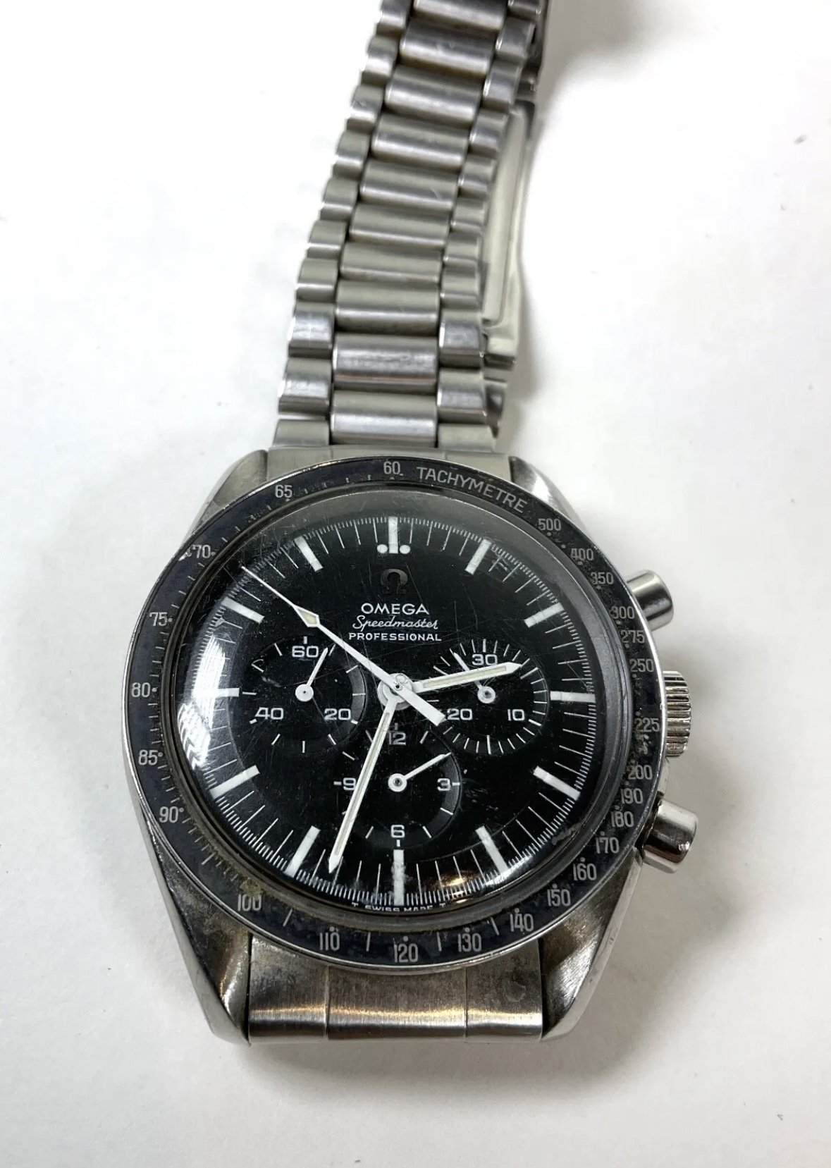

I initally got the idea for option 1 from an ebay auction I saw just after buying this. Although the watch had a nice DON, it also had a washed dial and other service parts. The seller mentioned it was serviced by Omega:
