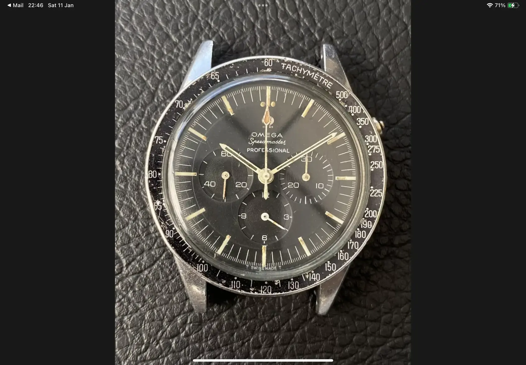

How about vice versa? Like this one? Could that one be factory issued or at least chronologically correct?
yes, dial obviously swapped and wrong for this watch
The PROFESSIONAL script on this dial is not original. It was (poorly) added at a later point.
To answer the OP's initial question; Yes, All dials with 321 'feet' are interchangeable.
