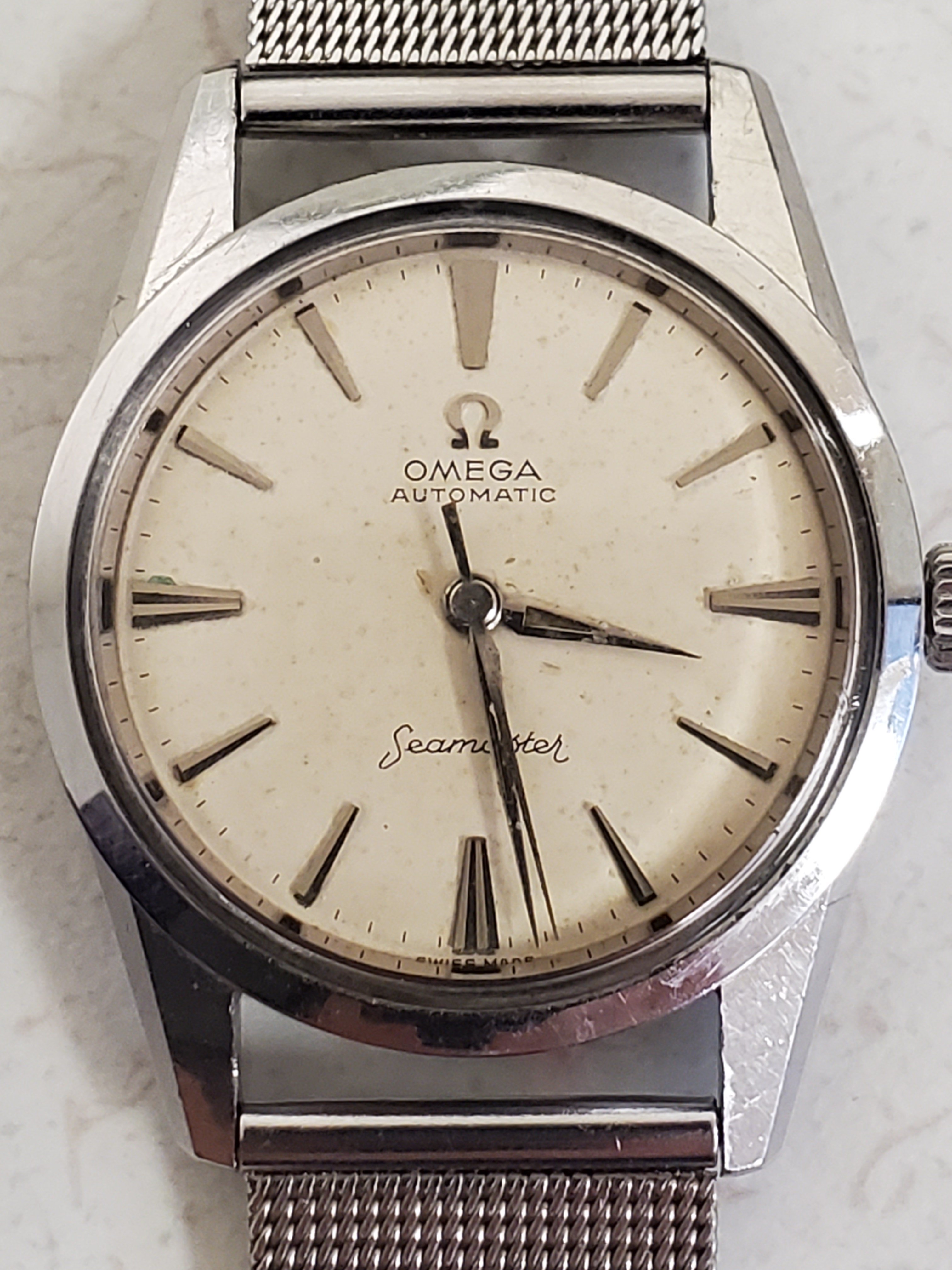

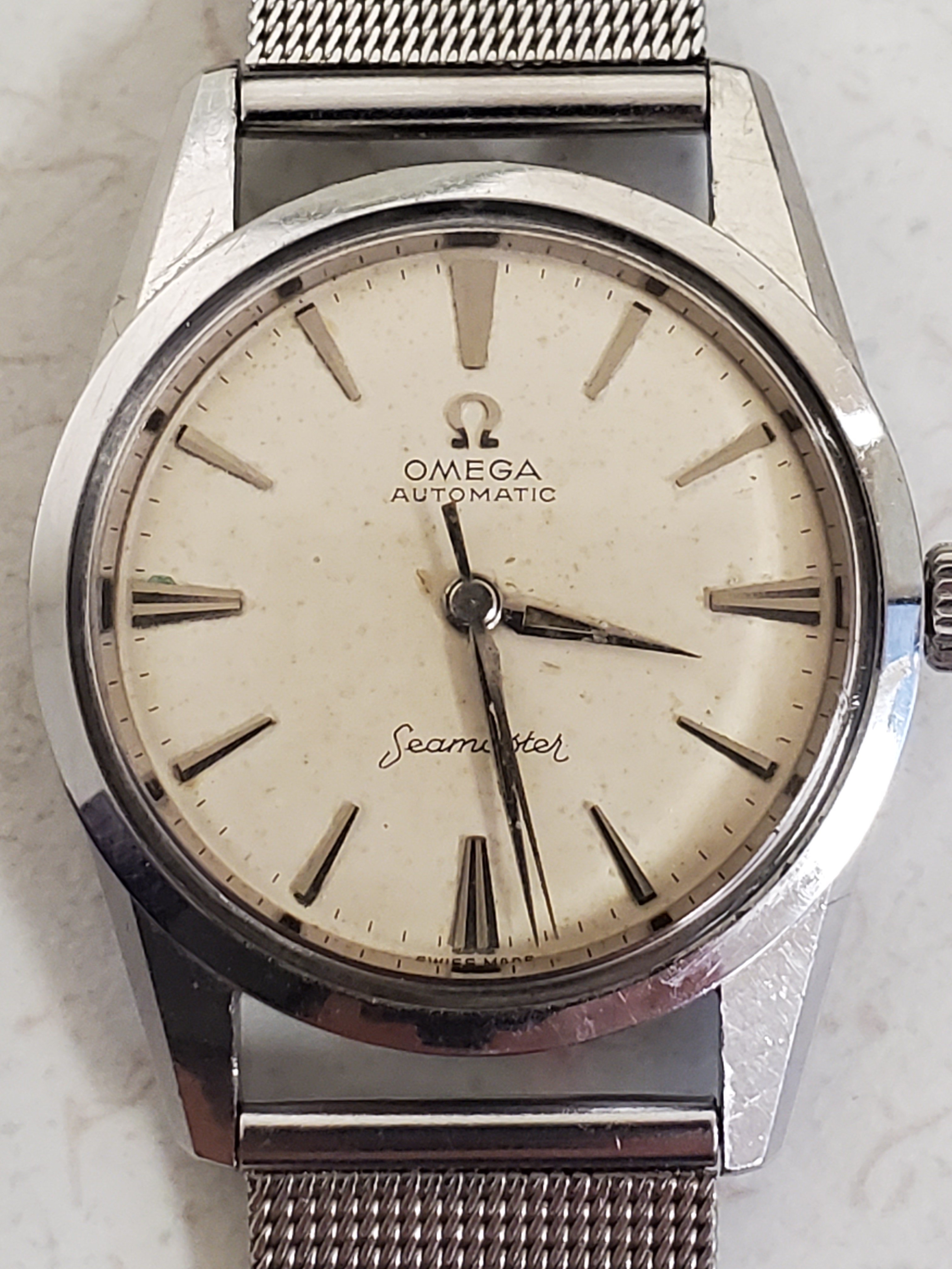

I have had the below pictured Seamaster for a few years now and I am planning on opening the back to snap a few pics of the movement and get the serial number. I've worked on a couple junk watches before so I'm not at all worried about my ability to open/close the watch properly, however I'm wondering if I should be concerned opening it due to the lume on the hands. I'm pretty sure the old (and very crusty) lume on the hands is Radium, though I can't be 100% sure since I don't have the serial number to actually get a hard date on when my watch was produced.
Therefore, I was wondering if anyone had any opinions on whether it seems safe to open the back for a few glamour shots- I'll probably have the watch open for a total of 20-30 min or so...

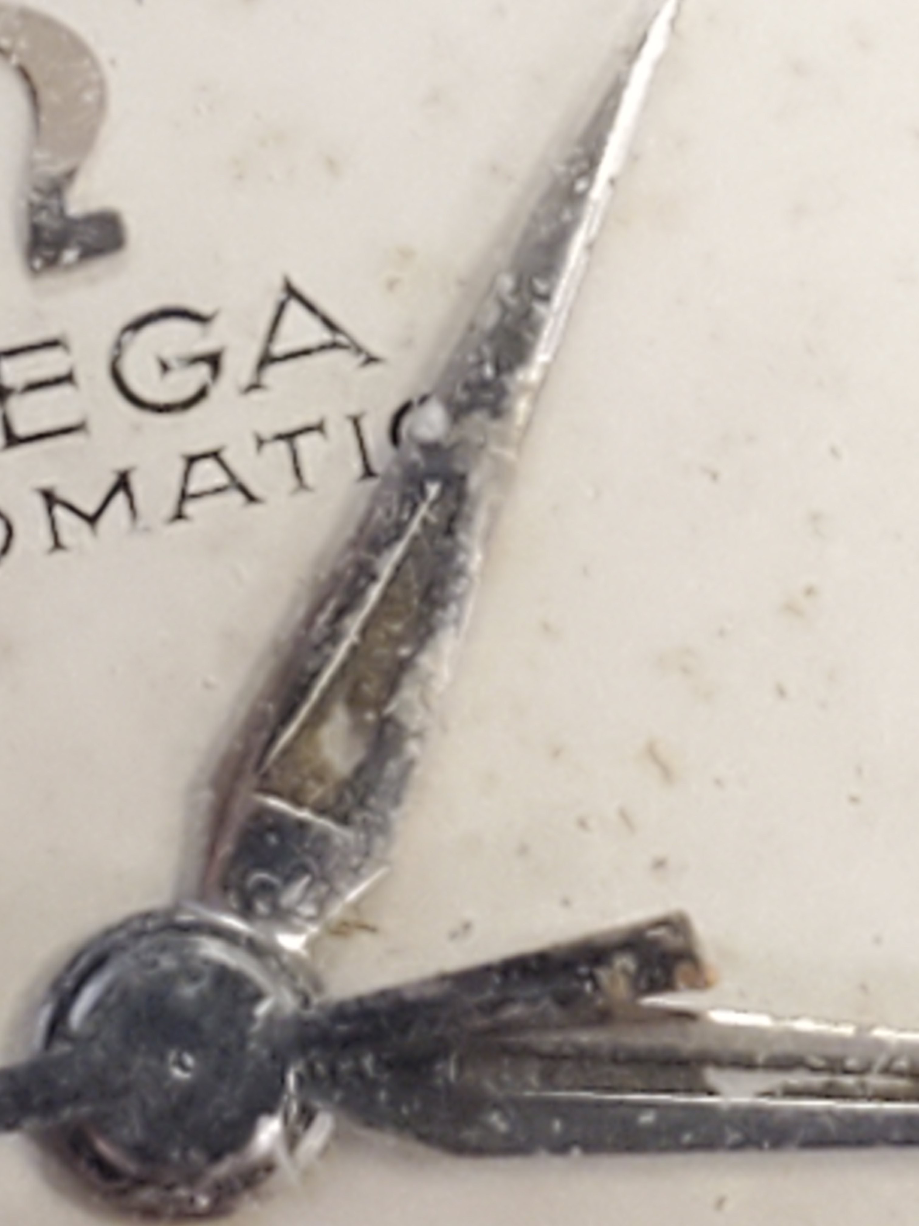

(Crusty stuff closeup)

What is dangerous is mostly the ingestion-inhalation of radium dust. If I was to do it, I would wait for a sunny day and go on a table outdoors, possibly with some breeze away from me. Use disposable gloves to open it. Throw gloves in a bin. Take pictures, close it, wipe it , throw away all disposable.
it may be too much, in my lab I would just do it in a fume hood monitoring surfaces with a Geiger.
Melius abundare quam deficere.
PS: if you have a Geiger that you can borrow, and you see that is not radium, all of the above is nonsense.

I would check it first with a Geiger counter to confirm whether or not it has radium lume. Radium is not tritium. It is highly radioactive and exposure to it is dangerous if inhaled or ingested. It has a 1,600 year half life, so if the lume is radium, almost all of it is still there and just as radioactive as it was when the watch was manufactured. There’s no appreciable danger with an intact case. Opening the case is something else. I wouldn’t take the risk of opening it myself. Why not have a watchmaker who is accustomed to working on watches with radium lume open the watch and take the photographs for you?

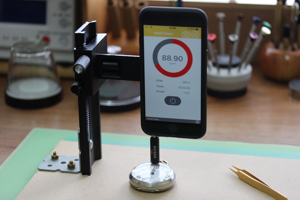

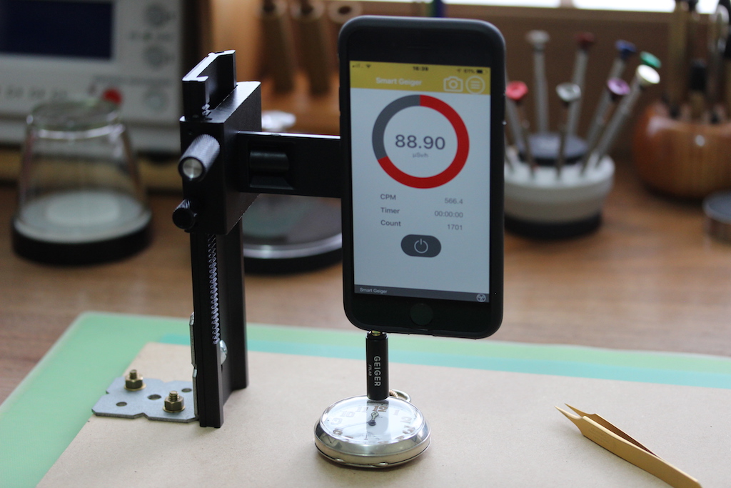

Picture of a geiger reading on my (closed) 100 year old radium lumed pocket watch (courtesy of JiminOz)

Hmm, a lot of things to consider here. I might be able to get my hands on a Geiger at work which could eliminate the problem as you point out @Franco
I definitely don't want to put myself in an accidental exposure situation, but it also seems annoying to me to have to pay someone to do something I can do easily. I may just go with the outdoors breeze scenario.
