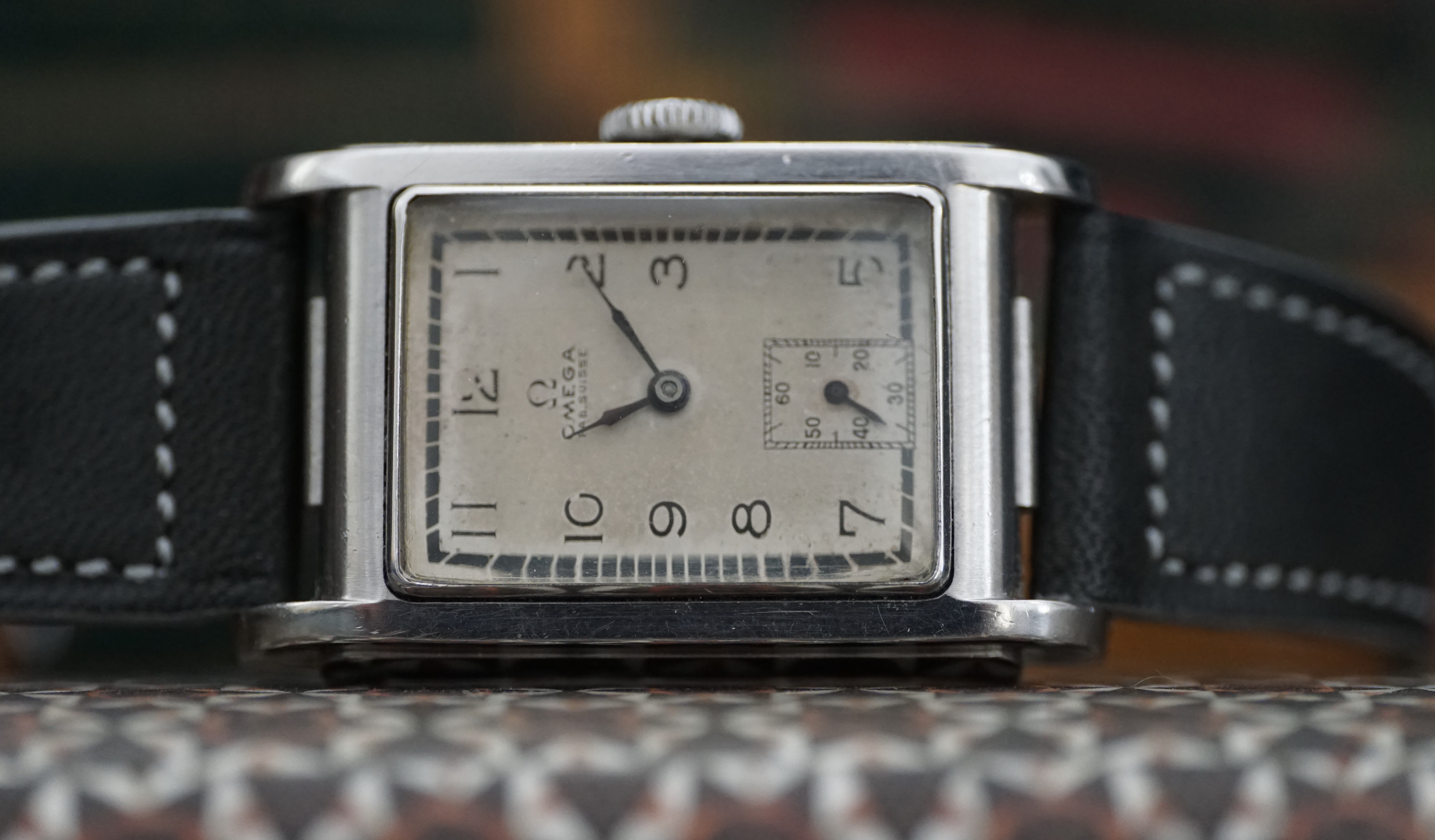

This '43 ref 3635 T17 . . .
. . . was serviced by my watchmaker in Ventura County, Southern California. He was able to source a critical movement part from his usual supplier in the Midwest.

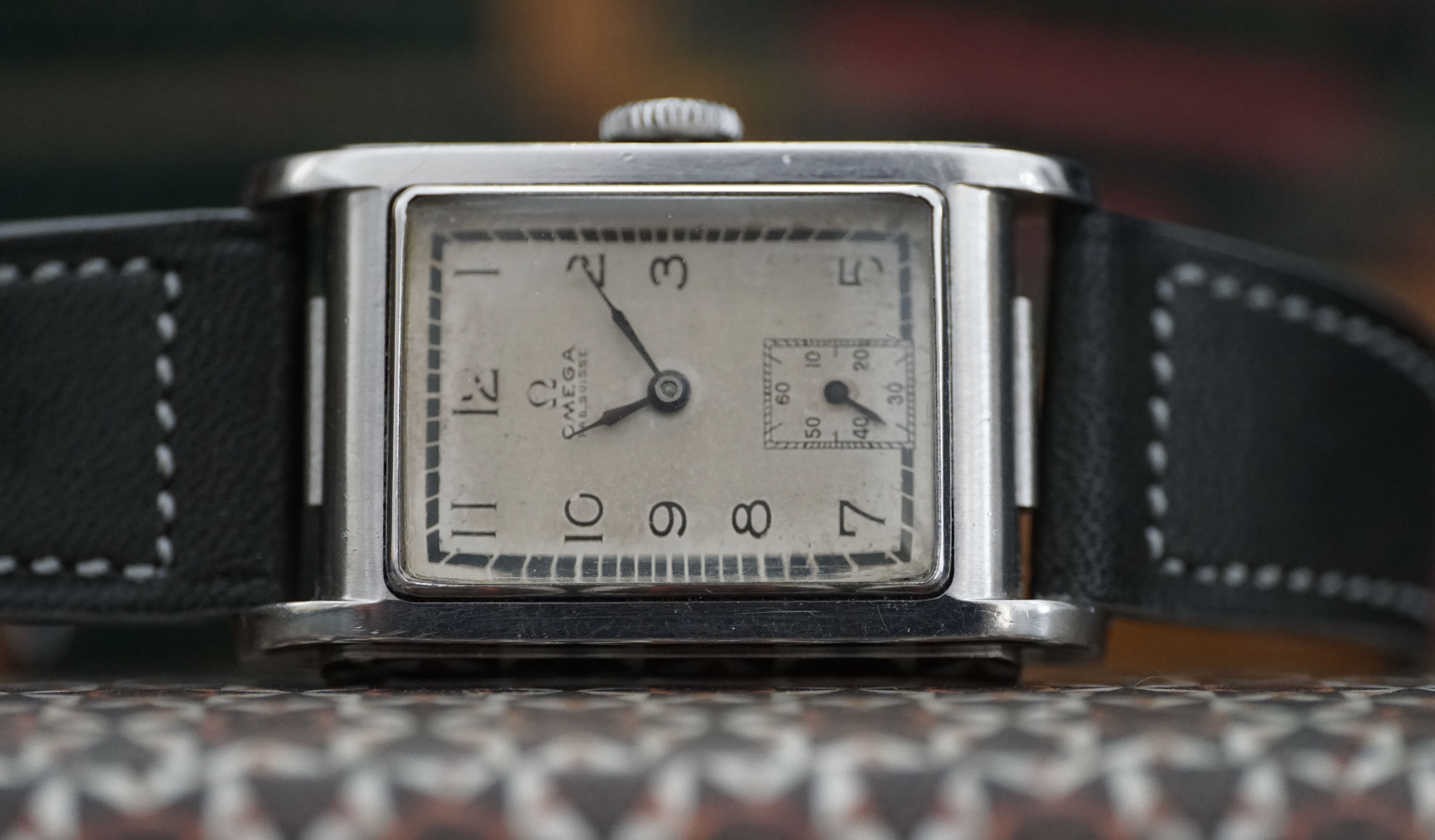

Thank you, this makes sense. I won't look into that unless I'm told by a professional I should.
That is a really beautiful watch. I hope I can get mine to look anything like that.
