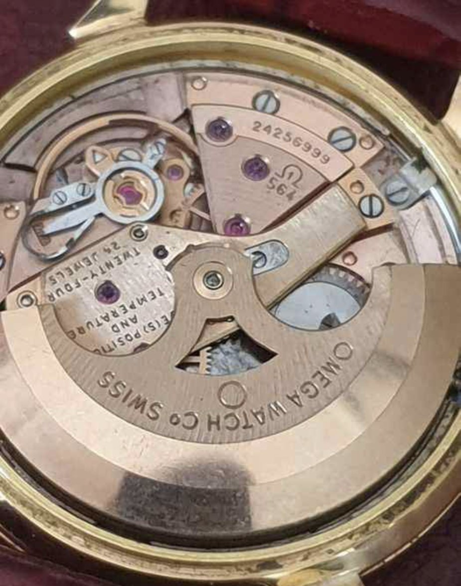

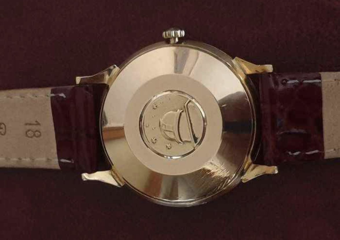

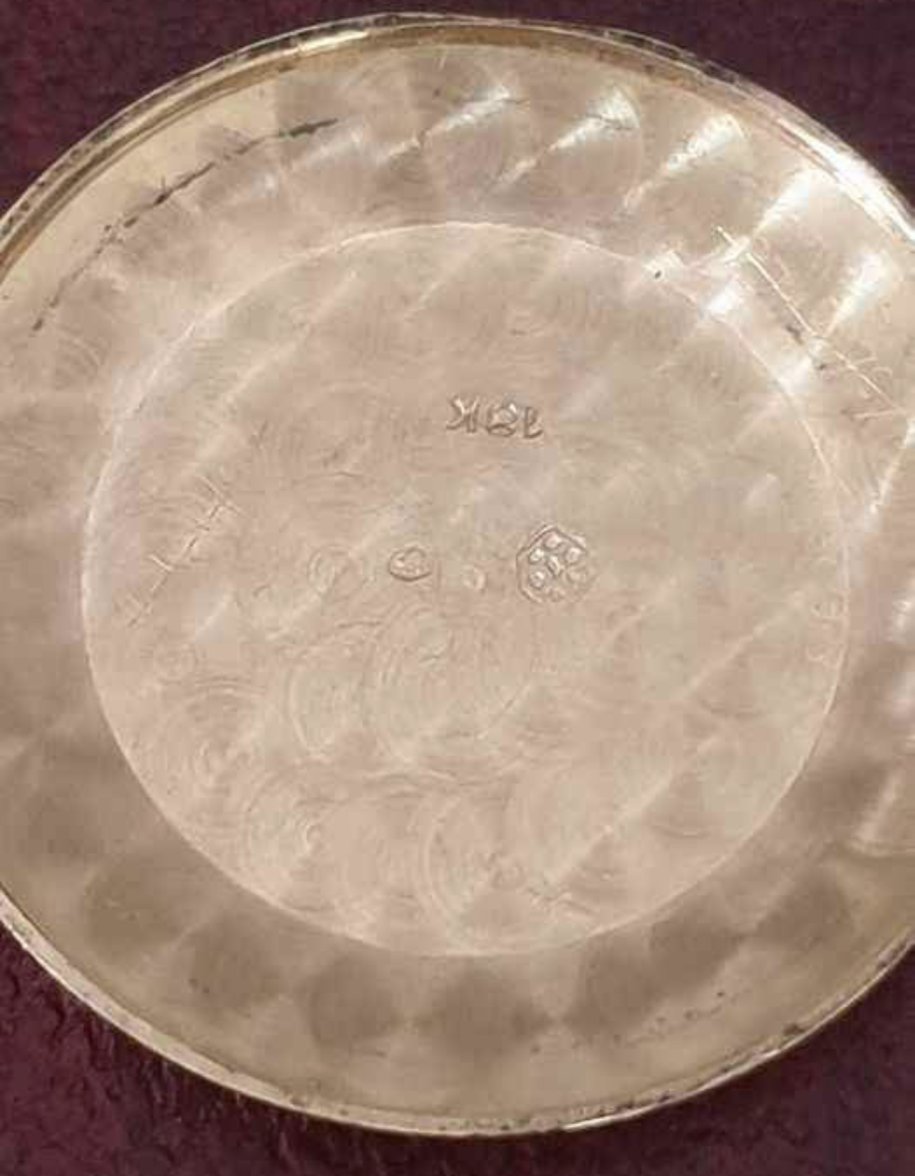

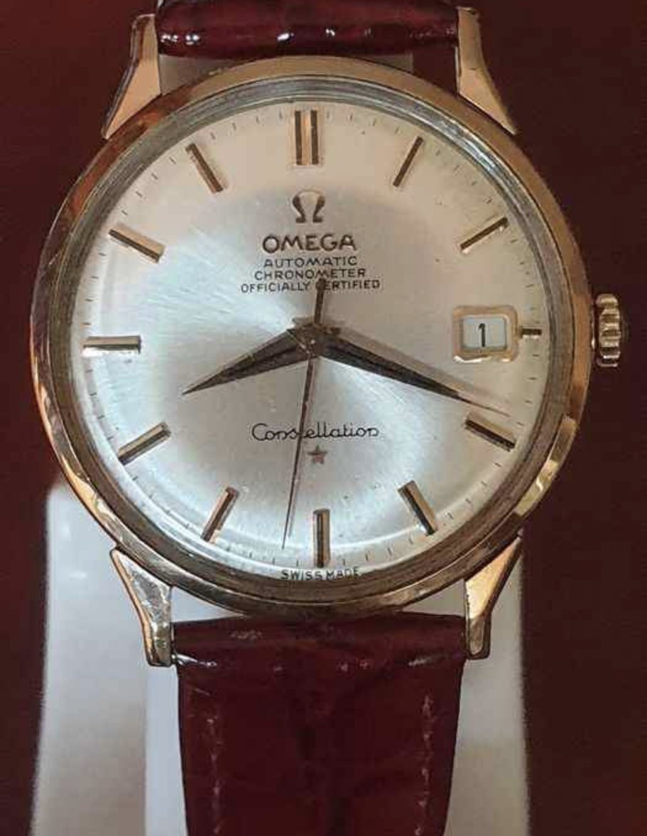

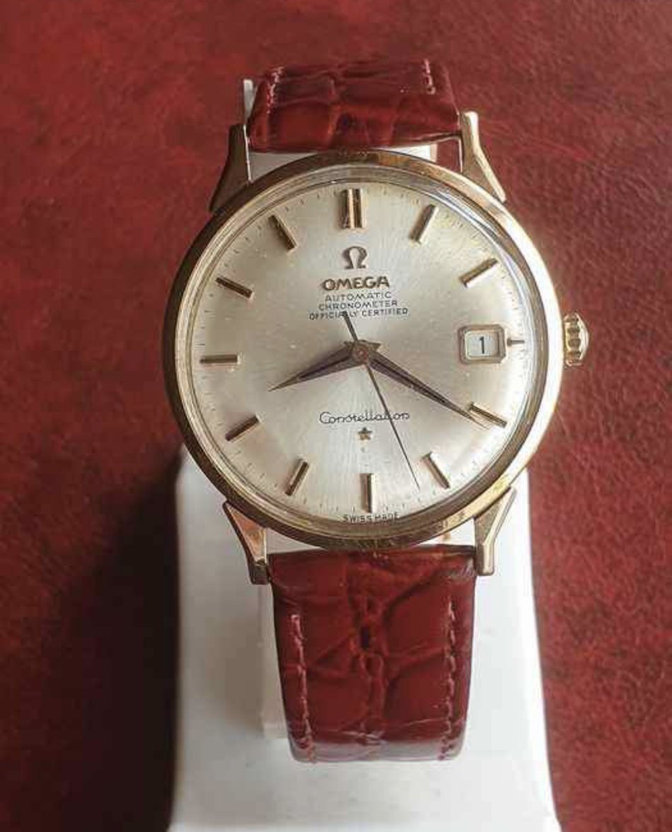

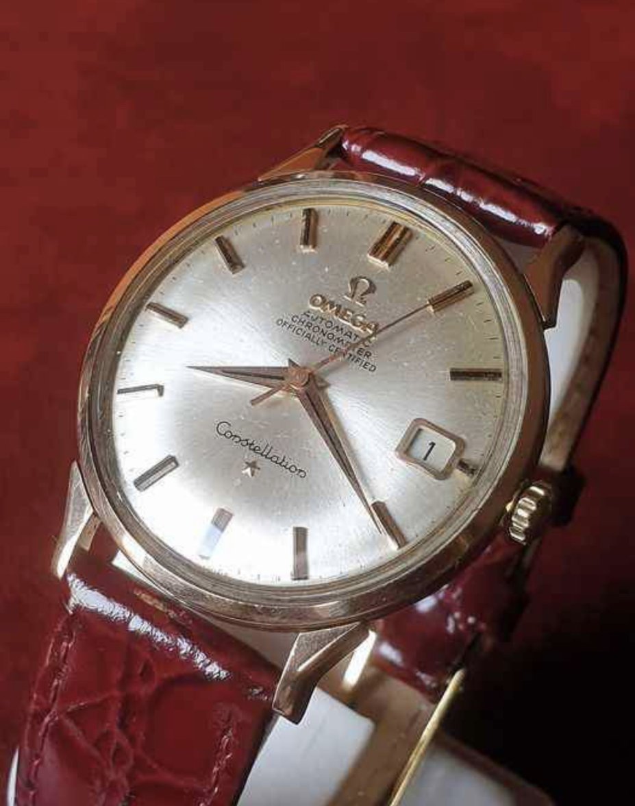

Hello everyone, Can someone provide me some more info about this watch please? I found it at a local store and would like to know what's it worth. I came this far: It's a 1966, 168.005 with serial 24xxxxxx and a 564 movement. But I can't find any references with the same dog leg lugs as mine + the same crown..

The first thing to mention is that it isn't a Swiss Omega case.
Omega didn't do a dogleg with a press-fit back and the lugs are the wrong shape.
Best case scenario is a locally made case
Worst case - a fake case.
Is the case all gold?
where did you find the watch? (which country)
is the dial 'dome-shaped' or flat?

Looks like it might be locally cased.
the case is all gold yes. I found this watch in Belgium!
The dial is kinda dome shaped?

If this is a legit, local case it’s been not only polished beyond recognition but also absolutely unevenly so. Compare the bottom lugs with each other, I’ve never seen anything like it. Boy, is that horrible.

Regarding value, in this condition: Gold value plus whatever the parts are worth. A few hundred $/€/£ total.
6
Thanks man. I’m a total newbie in this scene. So a no for me!
