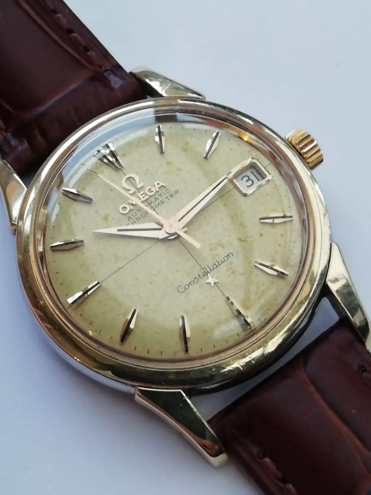

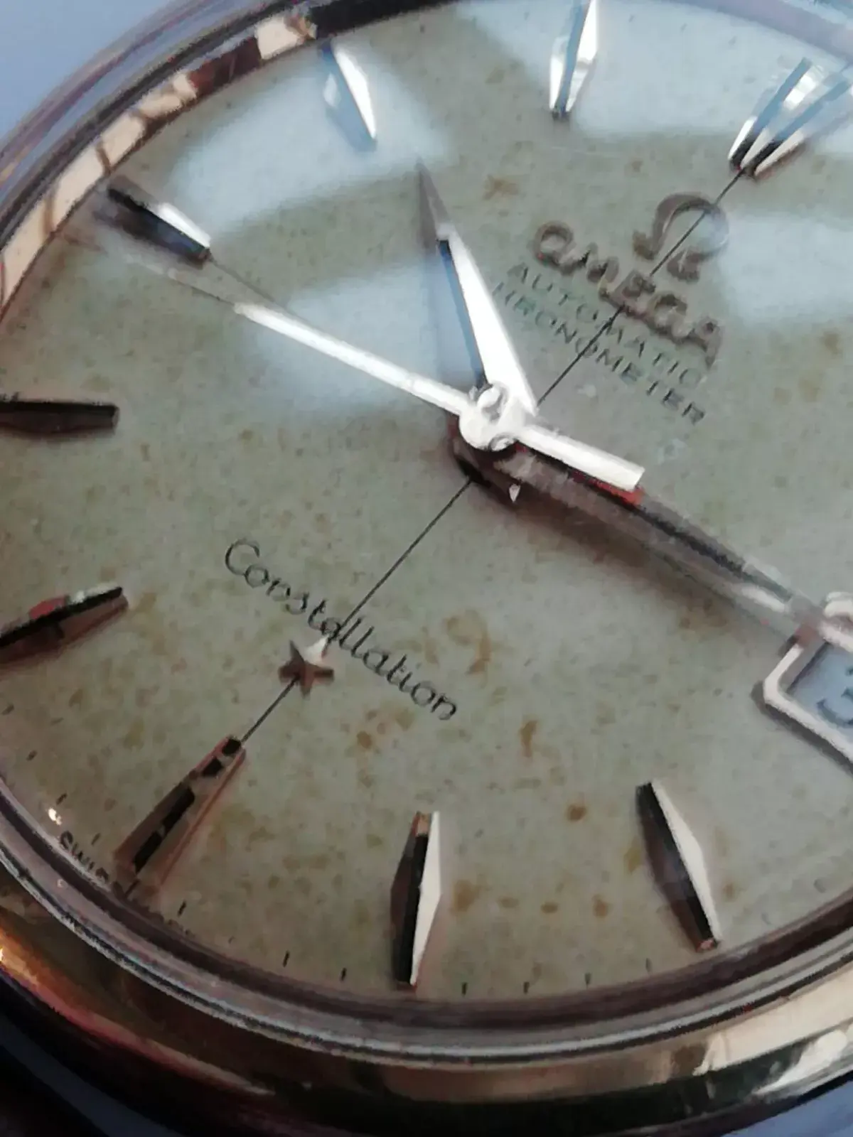

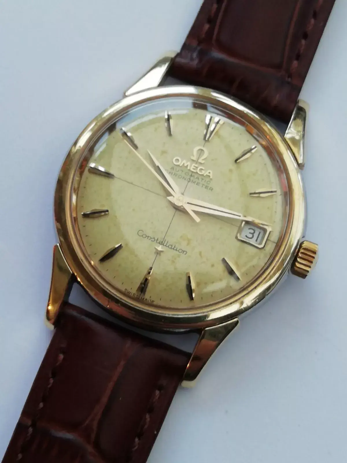

Is this Constellation Ref 14393 dial original or a redial? Also are the hands original?

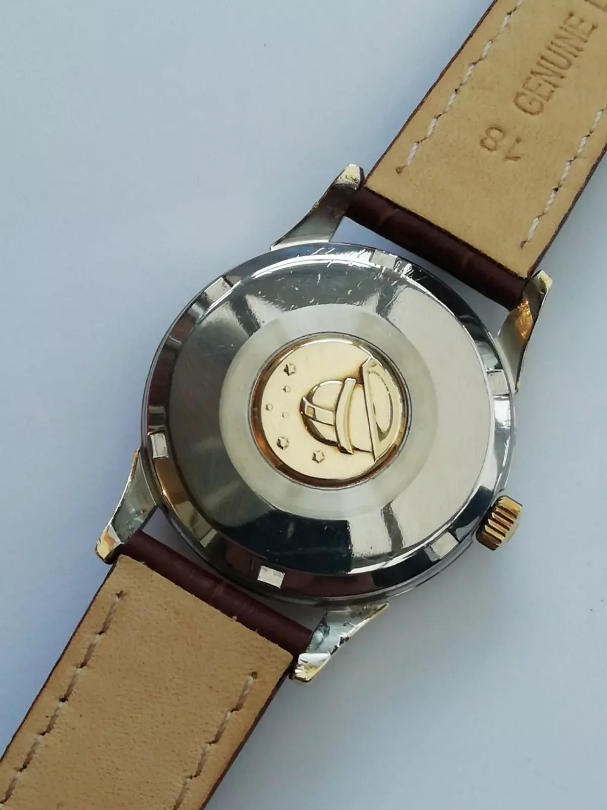

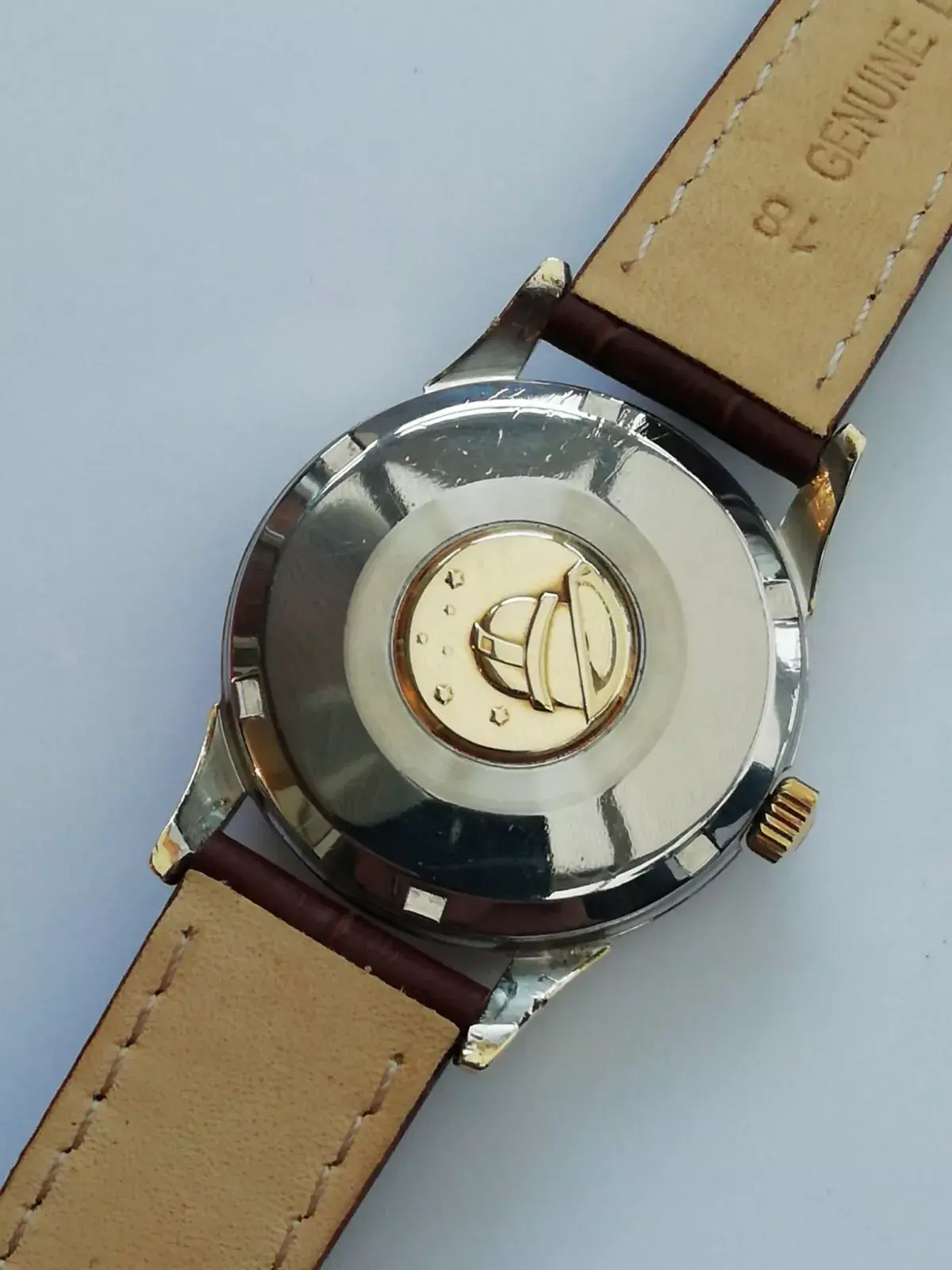

IMO poorly redial, over-polished case, wrong crown

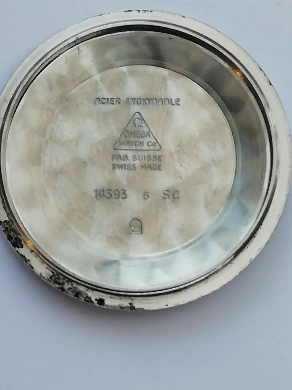

i will do! thank you, i thought the back was overly polished and the "swiss made" looked to close together

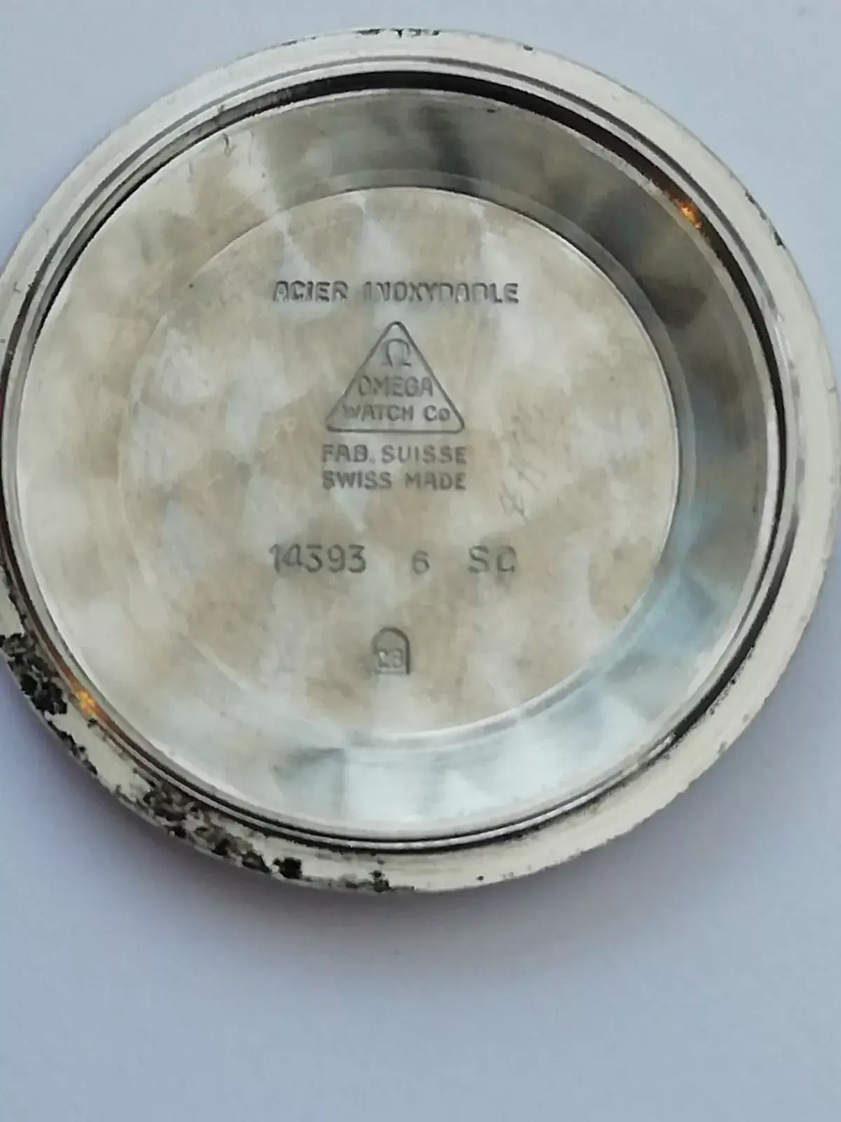

The pitting on the inside of the caseback may also be deeper than it looks.

@ash9988777

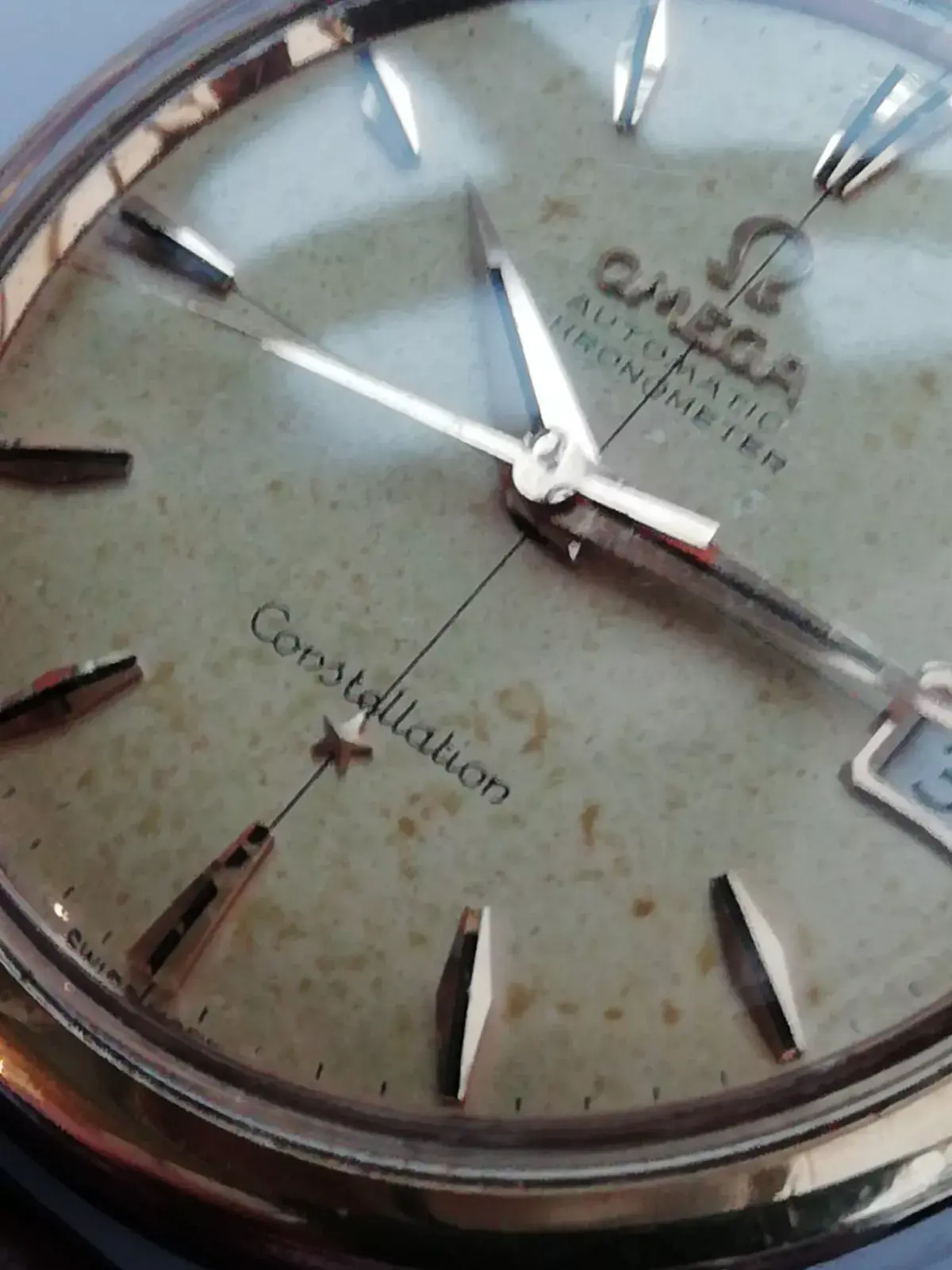

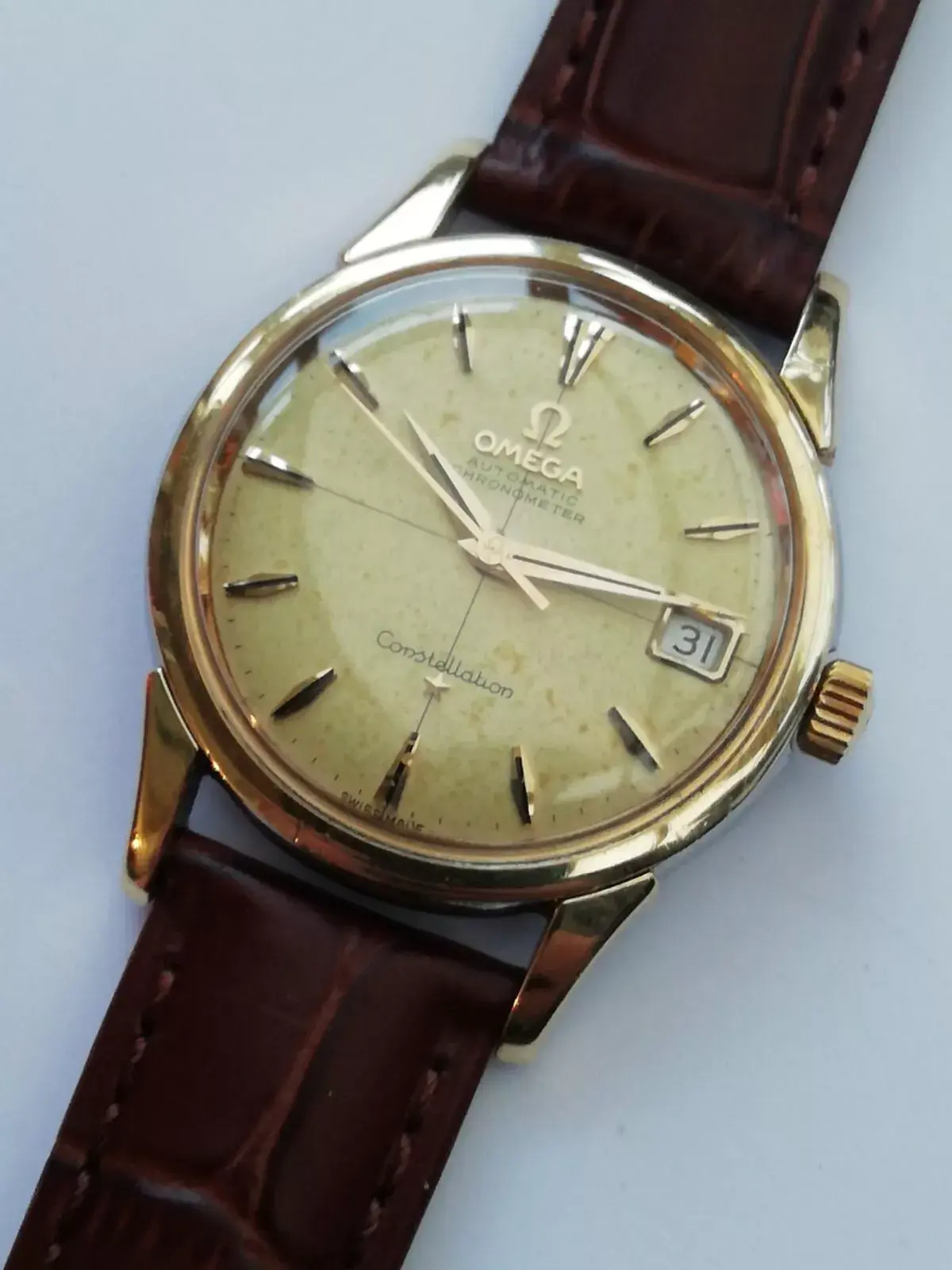

The pics are poor but a couple of questions:
Have you seen another Constellation with coffin shaped indices?
What do you think about the relationship between the star and ‘Constellation’?
As above, the case is heavily polished and the crown and rotor have been replaced.
The hands look like new replacements.
The dial has heavy ‘foxing’.
For future reference - We really do need better pictures to assess the dial on watches properly.

thank you! SO hard trying to find something decent!

You’re welcome but as @Scarecrow Boat suggests - try and scrutinise a watch yourself and share your thoughts.
If a detail looks wrong, it probably is.

If you're finding decent (and better) Constellations hard to find, it may be because your budget is too low. They're not rare.

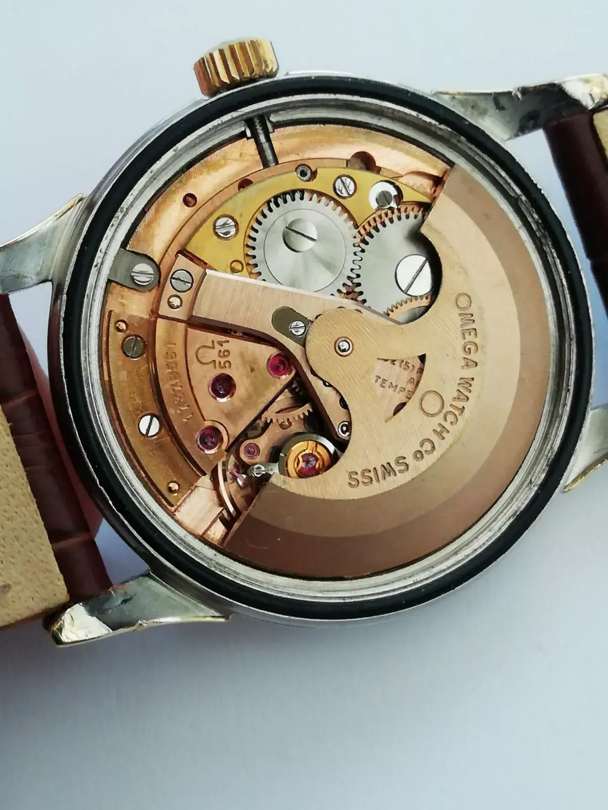

On another note, the bridge that houses the mainspring, ratchet wheel and crown wheel is a completely different colour and most likely from another movement.

The rotor is from the late 60s/ early 70s but is also a different colour to the bridge.

Normally from what I have gathered from the forum members, a colour mismatch signifies the part is either from another movement of the same calibre or a service replacement part.

You’re quite right - I was agreeing with you - and whilst the bridge and rotor may have been replaced at the same time, even they differ in colour from one another.
Indeed there are a number of different colours on this movement.
(Sometimes different lighting angles can make it appear that parts are a different colour and harsh cleaning can make parts look different too but I suspect , in this case, the movt has had replacement parts)
