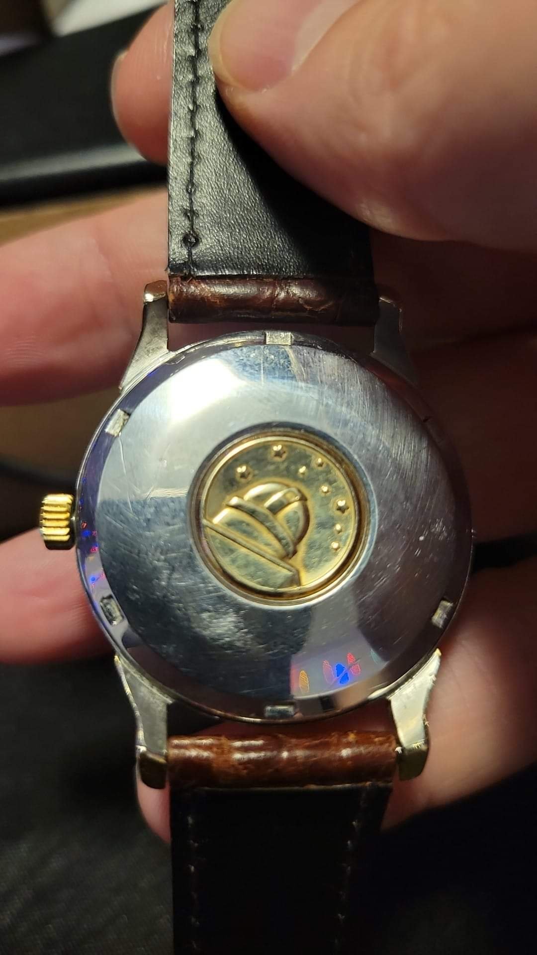

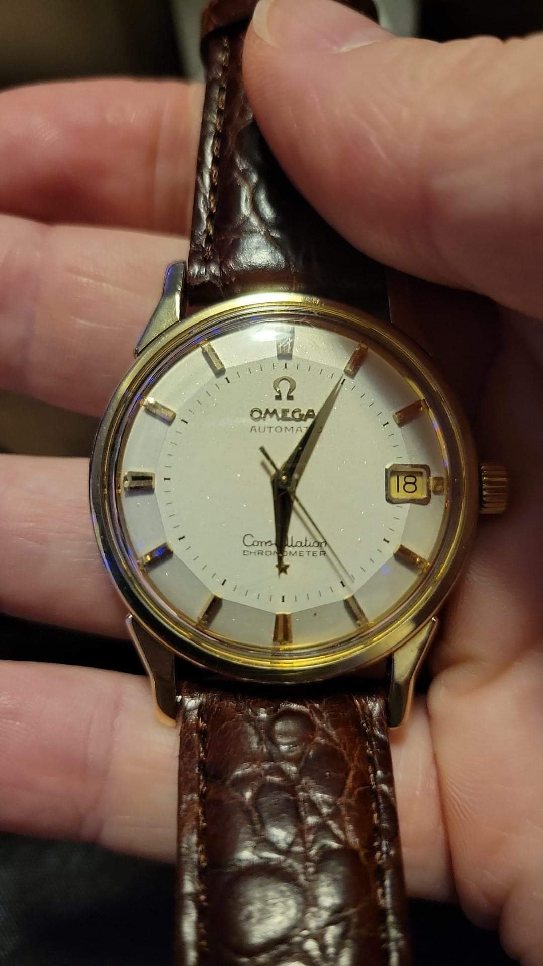

Trying to figure out of this is fake or a redial. I can't find ANY Constellation with the word Chronometer above the star. It also doesn't say Swiss Made at 6 oclock. Supposed to be a 1966. Any thoughts? Thanks!

How many of these have you actually looked at?
3
Alot. But mainly to find one that says Chronometer above the star. Can you elaborate?
562
2,731
Not need to talk about the text star positioning, just by looking at the font, I feel it is a horrible redial.
13,492
31,811
Nothing about the watch is good or correct. The dial is totally incorrect, the case is polished the crown is incorrect the date wheel is incorrect...
And you say you've looked at a lot of these.
8,877
62,873
But the positives: it seems to have a nice strap, and cool colored splotches.☕
89
90

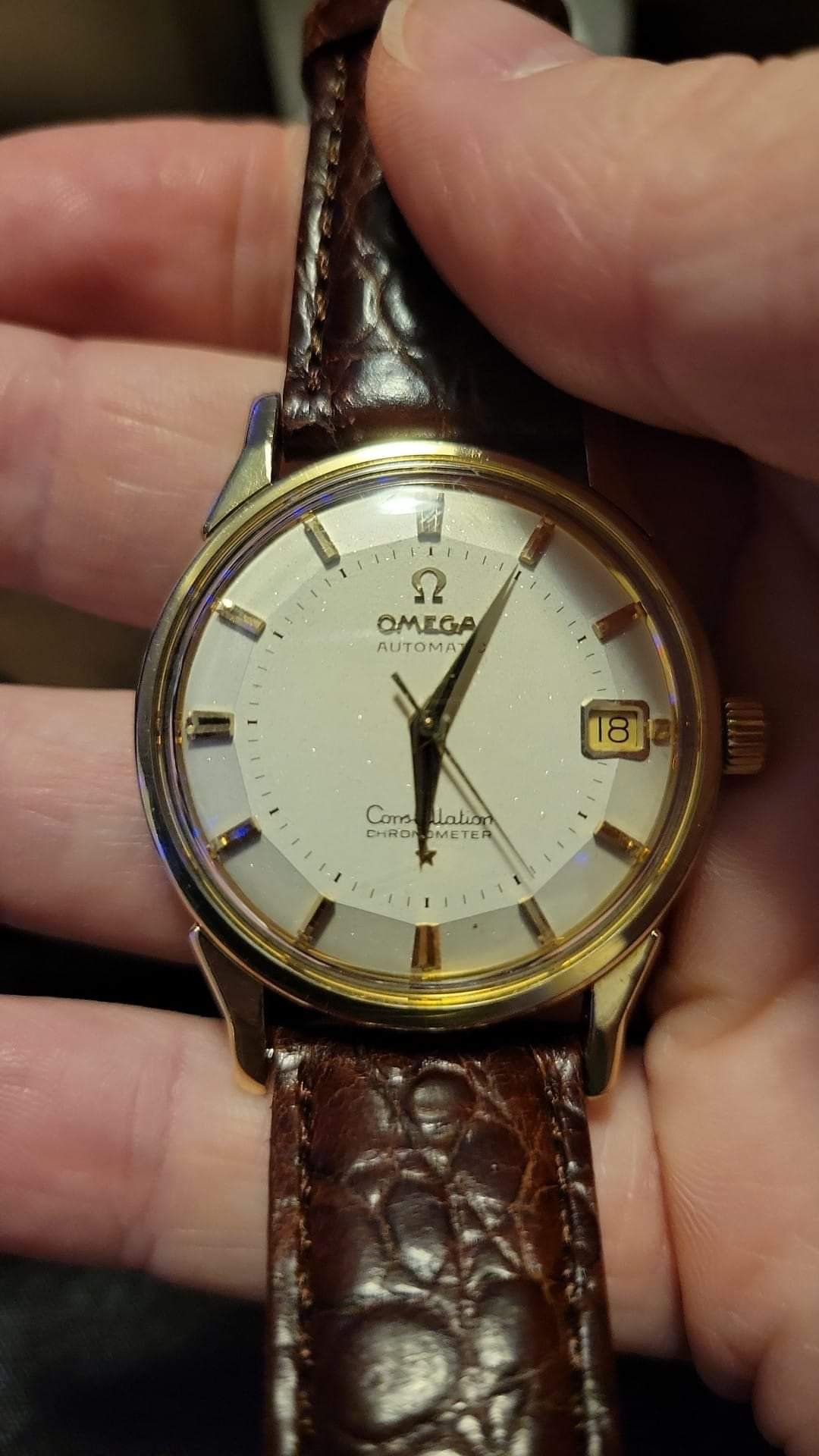

I smell redial, I just have this feeling that the font looks wrong
6,832
10,502
Welcome to Omega Forums @James8 !
Don’t be put of OF by the rather grumpy reception you’ve received.
I think the global IT outage must be affecting members mood today.
However, they are correct with comments about the watch you posted.
It’s not a good example and has had the dial repainted in an incorrect configuration - which is why you can’t find another like it.
If you haven’t found this site yet, you might like to spend some time delving into the information here:
http://omega-constellation-collectors.blogspot.com/
You will then be better placed to assess any watches you come across.
- but don’t be put off posting any watches you find in the future.
