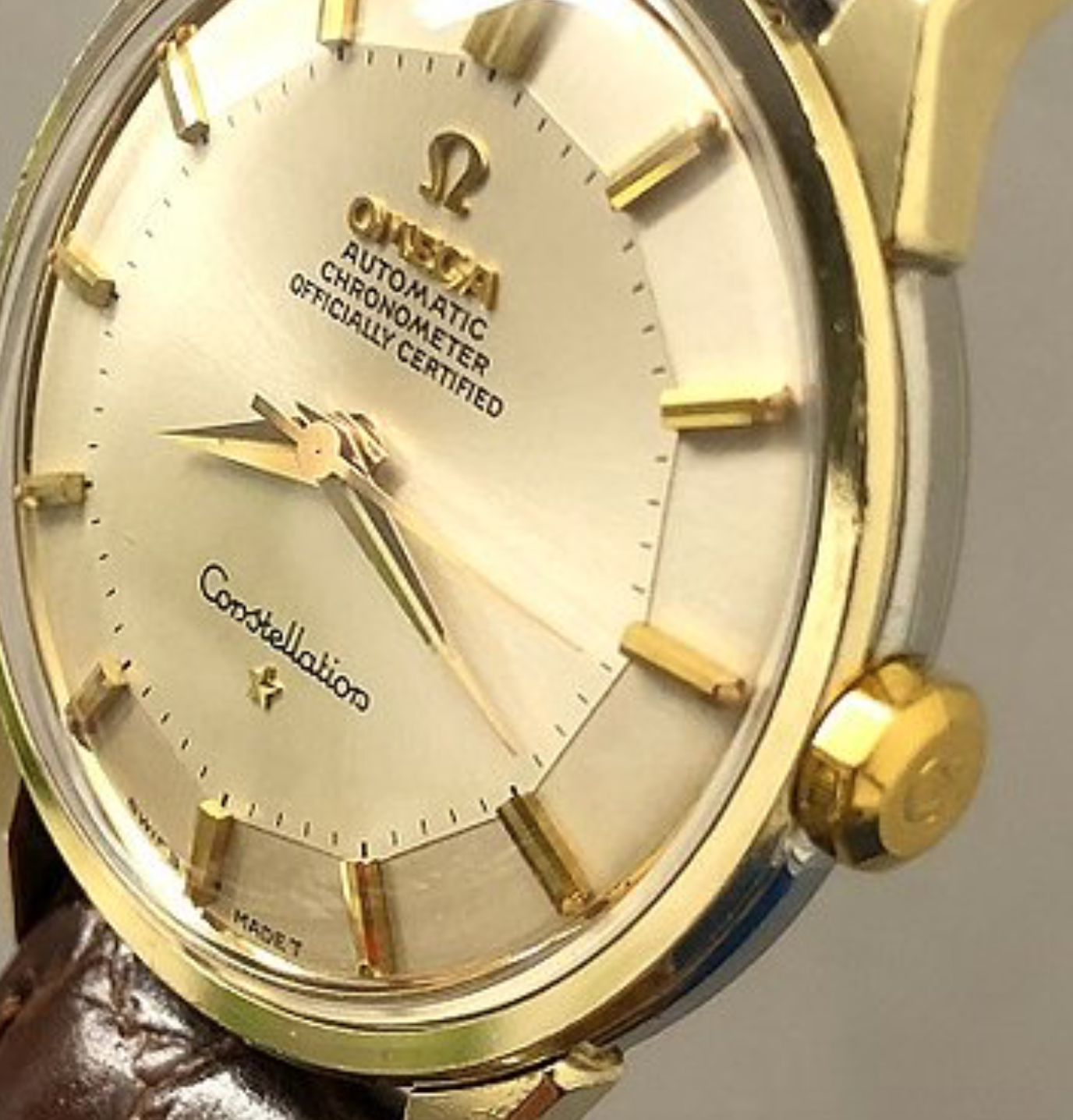

Is this a redial constellation piepan ?
50
85
I am not a Constellation expert, I am just using my eyes. The OP dial is not 12-sided, it has a paint job that makes it look 12-sided. @gbesq says that all 167.005 references should have a 12-sided dial. I don't know.
Wow I feel like i've got scammed then... I'm so confused right now .. haha
24,836
55,255
Wait wait, What is OP dial ? so this is not an original ?

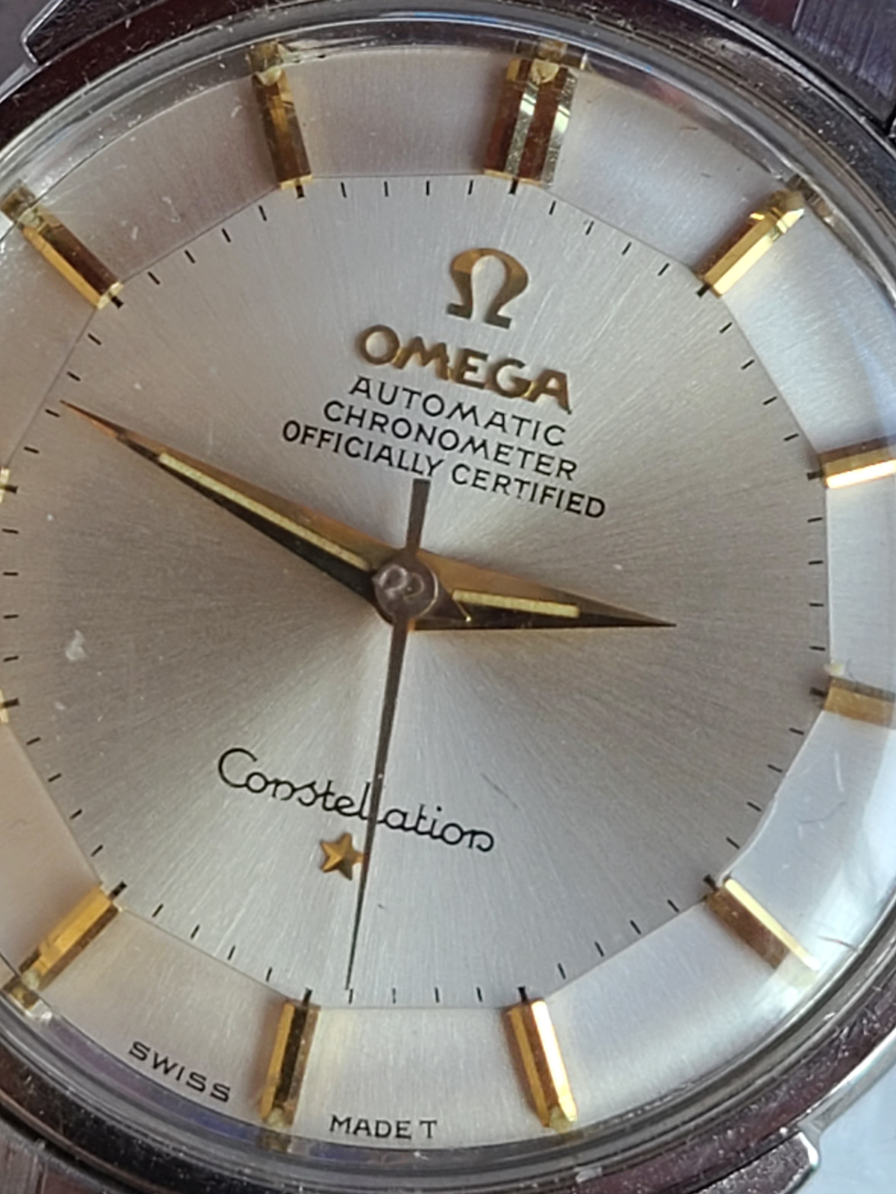

Here is other examples of 167.005 dials with actual steps.
24,836
55,255
My 167.005 with edges. It should be called a pie pan, I think.
Yes, you can clearly see an actual step in the shape of the dial. The shadow is the easiest way to see it, I think.
24,836
55,255
As I said, I am just using my eyes, and I am definitely no Constellation expert, so you shouldn't take drastic actions based on my amateur opinion.

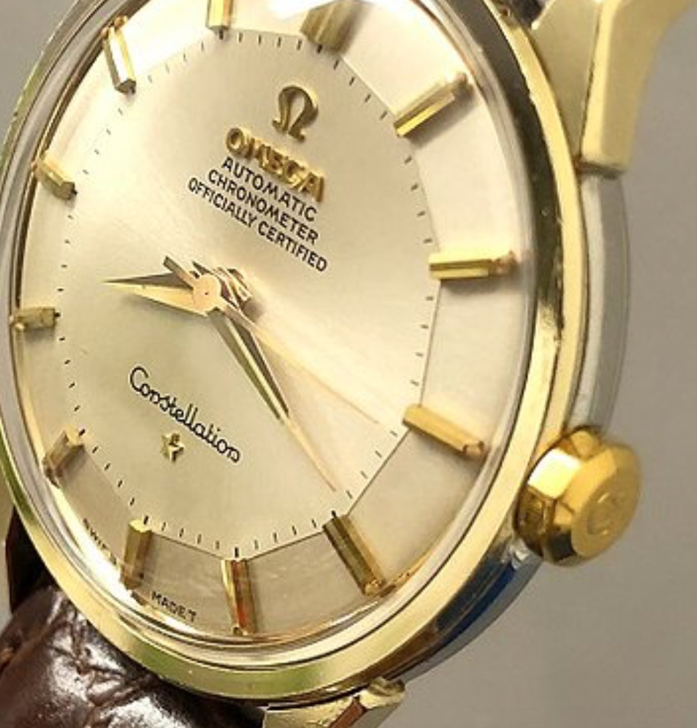

That one looks redial to me.
And the OP watch needs to be examined carefully, I see some signs of a redial on that dial.
50
85
So do you think mine is not a redial ?
3,790
6,452
I think yours is a redial but I am not very sure.
I need better photos.

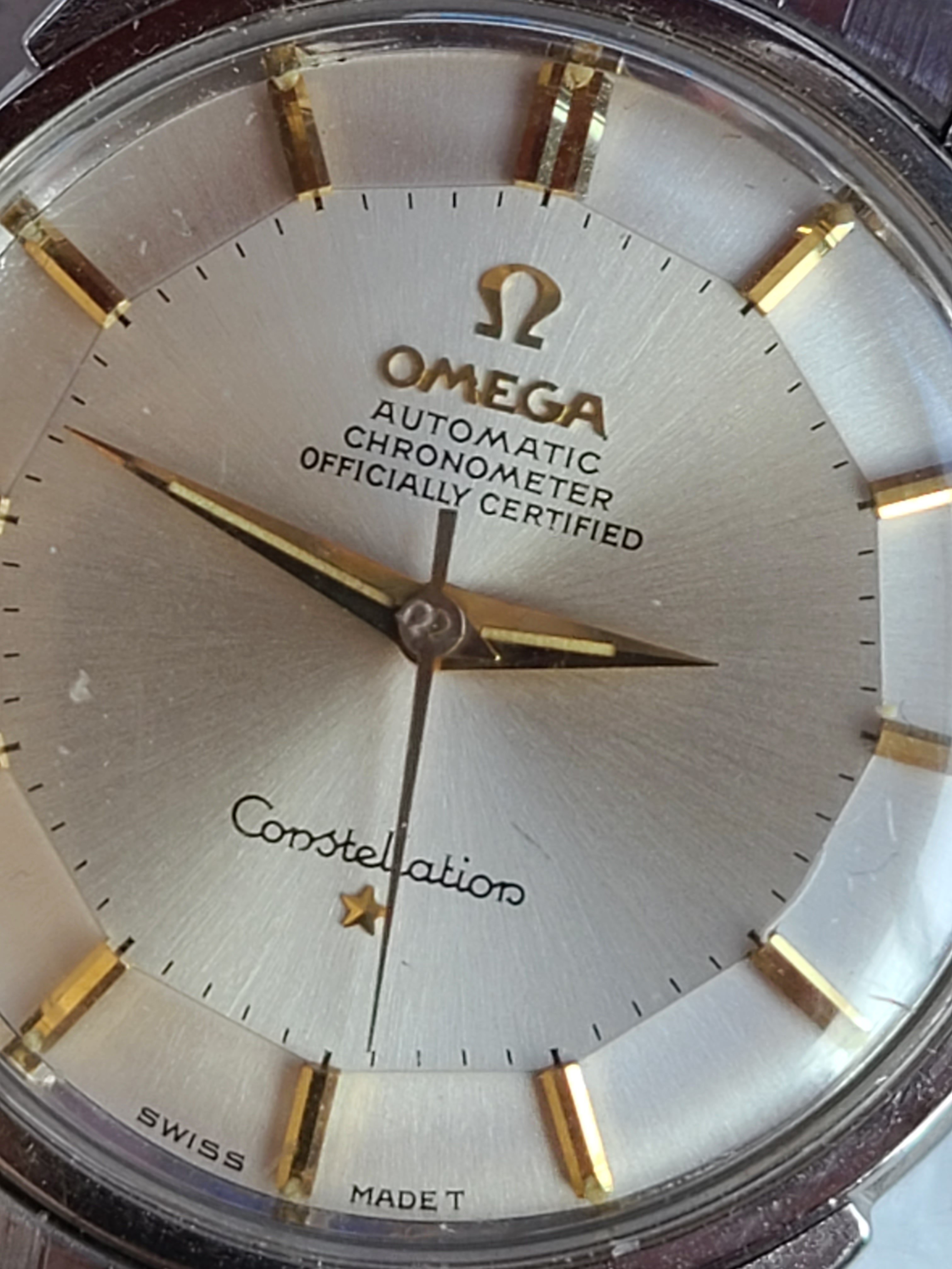

Okay. I’ve found some OP dial with this reference ...
https://www.ramsdensjewellery.co.uk...mega-constellation-pie-pan-ref-167-005-p19697
Yes, also no step on that one. Clearly you are able to identify these dials very well. 👍
https://omegaforums.net/threads/omega-constellation-ref-167-005-cb-pie-pan-dog-leg.75976/
What do u think of this one ? Some steps are clear and some are not.. maybe some steps has been faded away and that makes it look like an OP dial ? And if it could happen, is there a chance to mine you think ?
24,836
55,255
No, I don't think so. IMO, that step looks very clear. Again, the shadow is totally distinctive.
