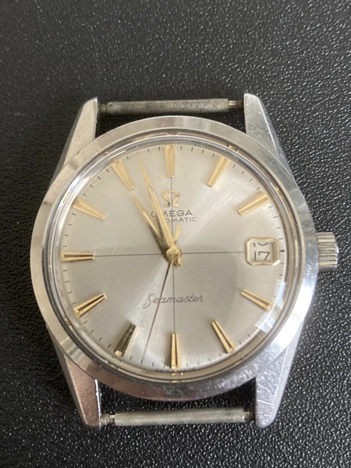

Is this a redial???

I have a few questions regarding this seamaster I have been offered and was wondering if anyone would be willing to share there opinions on it
1. is this a redial?
2. Is £490 a realistic asking price?
2. I’ve yet to see the movement but should there be a specific movement inside?
thanks in advance ladies & gents

Probably a reference 14701 with a 562 movement inside
Not an obvious redial, maybe others can say more here

Looks okay to me, and a fair price. Date wheel is probably in the middle of a change; you'd want to make sure it flips all the way by midnight.

I quite like that, nice honest case and the dial looks OK to me, coat-hanger S in Seamaster is always appealing, but bear in mind it will likely be in need of a service which will a couple of hundred to the total cost.
