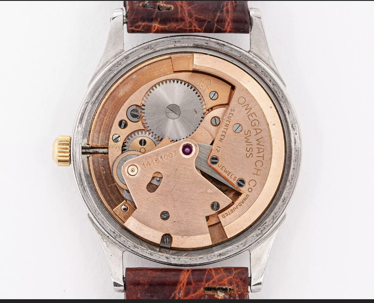

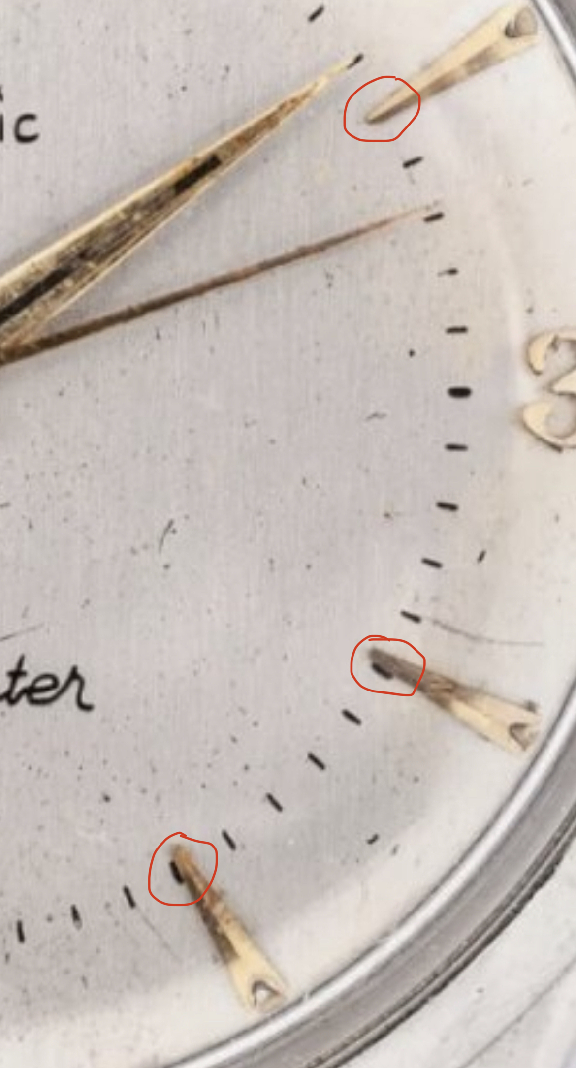

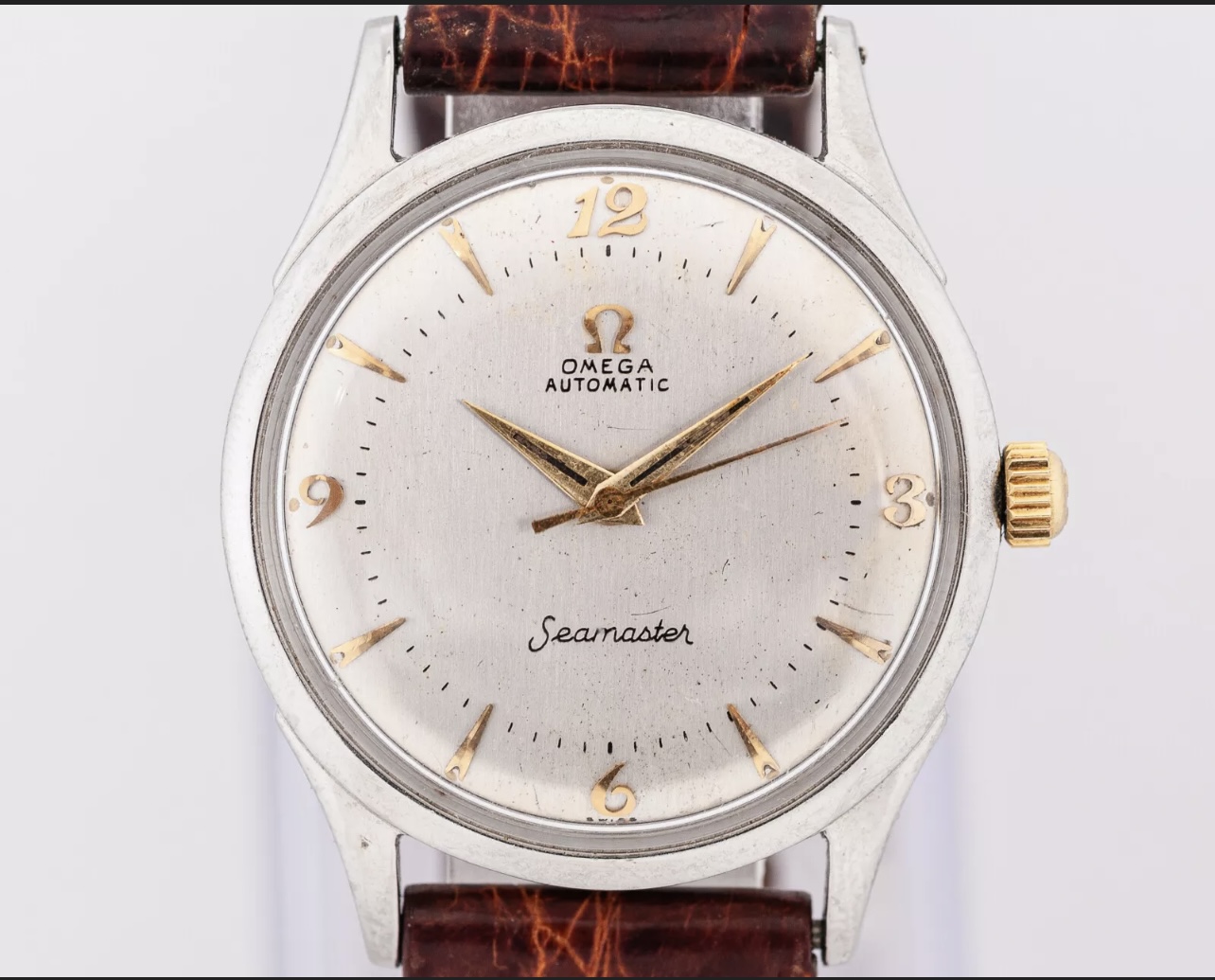

Omega Seamaster for sale that I’m interested in. Seller lists the watch as 1954 based on the 14181007 serial number. Case is 34MM, Cal. 354.
I’m new to vintage watches and want to get started buying one for daily wear. Been attempting to take the crash course but it is harder than I anticipated. As far as I can tell, the watch appears to be genuine but has obvious aging (but please correct if I’m wrong). It also looks like it is a redial. From what I have read on here, redials hurt the value but are also common on older watches.... That said, it is unclear to me from the forum how much this hurts the value of the watch and if I should even bother.
Can y’all first confirm if it is in fact a redial for my own sanity? If it is how bad is the redial job? Any other issues you see with it? Any help with this watch and just to simply advance my learning would be appreciated.
Yes, it’s a redial and it’s not good. Among the issues is the poor Omega Automatic Seamaster script, the minute marks aren’t even or radially aligned to the center of the dial, and the dagger hour furniture isn’t properly positioned.
Thanks man I appreciate it. Is there anything that looks wrong with the case or movement? Still trying to learn so it all helps. Thanks again.

This is a very poor dial refinish, it's pretty hard to source an authentic one from that period in good condition. I had just one Omega watch with badly refinished dial and to my luck found pretty rare authentic dial for Seamaster Calendar in Australia. Since then - no poor dials and specially for daily wear because every time you'll look at it - you'll be dissapointin more and more.

Nice movement tho, I guess if I had that watch, I'd spray paint the dial grey without masking, then sandpaper the indices to make them re-appear and act like it's a custom made 😀

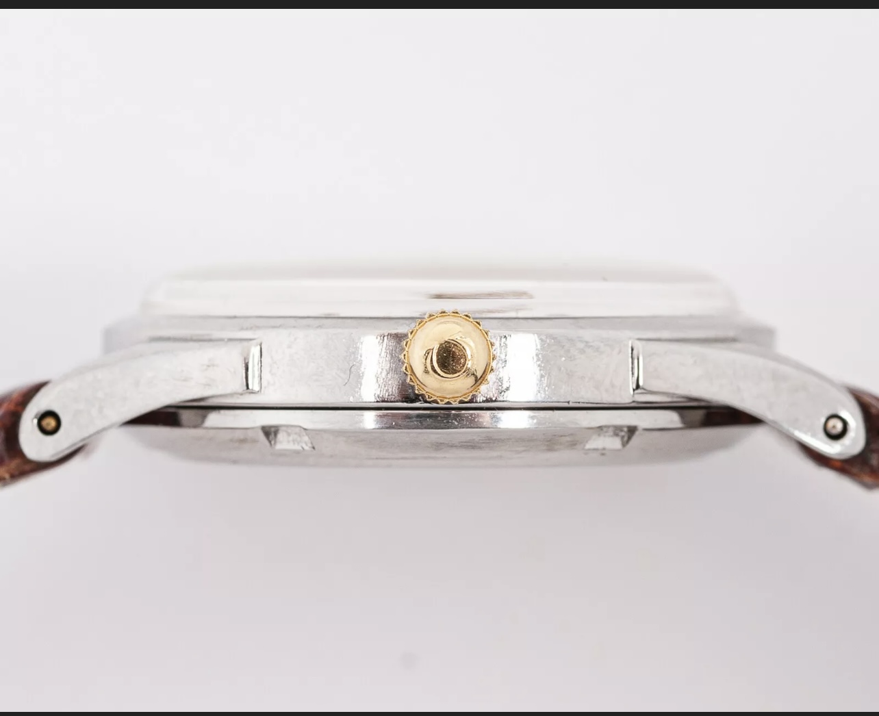

That crown is a fantasy also. When Omega, in that era, put gold markers and hands in a steel case, they also put a steel crown on.
