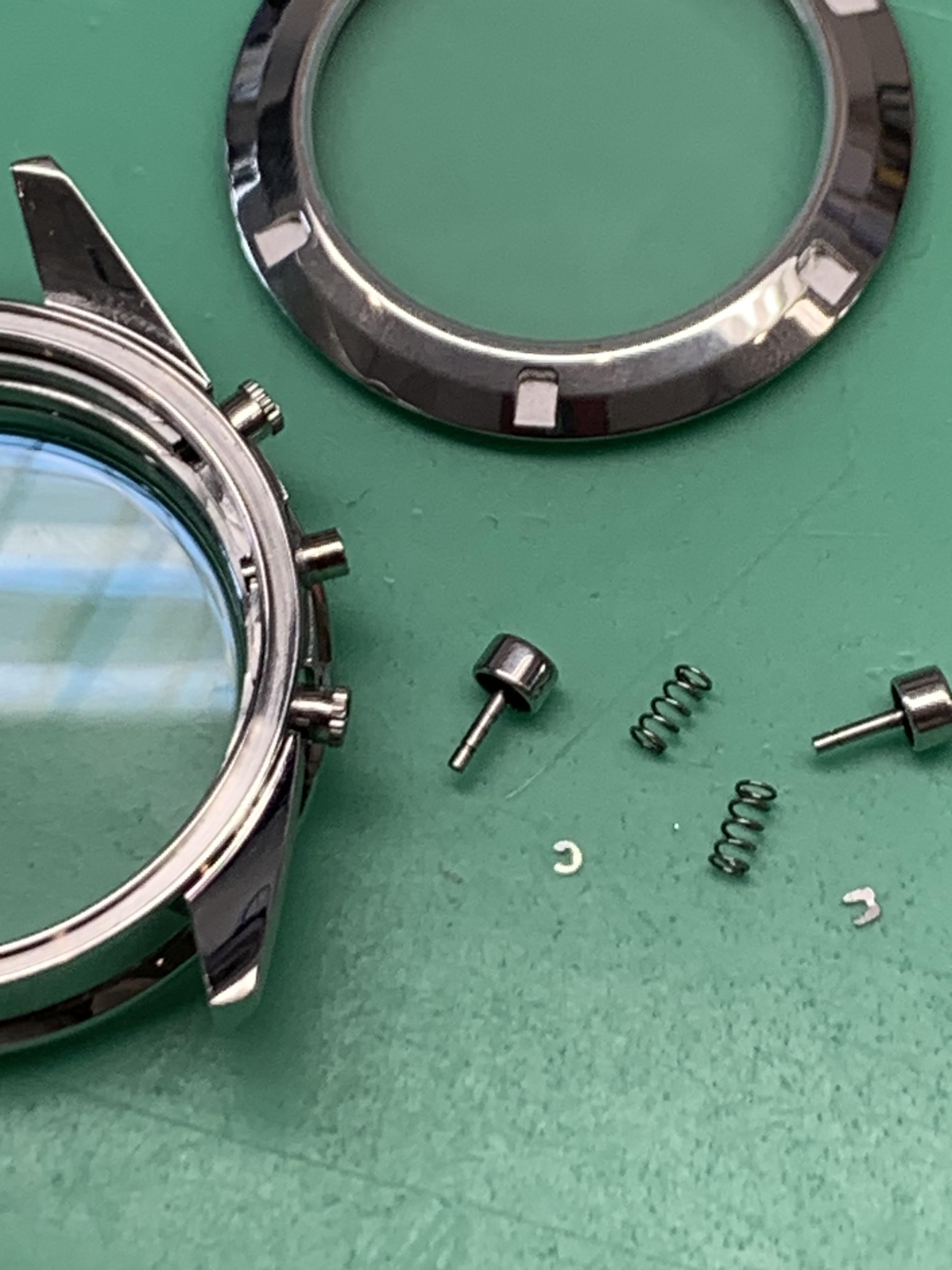

Currently getting my FOIS serviced at a local watchmaker after the crown and stem pulled out. The watch isn't passing the pressure test and appears to be leaking from the crown and pushers. They were going to look into replacing the c clip style pushers with screw in ones, has anyone had any luck with this?
is your watchmaker using a new crown and pushers or the old ones? Because these are meant to be replaced at each service by Omega. If reusing old parts to save money (or because he doesn’t have a parts account) that is the likely source of the problem.
They are replacing the parts. Water ingress seems much more common on the FOIS than other Speedmaster models. The biggest difference between the FOIS and other models in regards to possible water ingress seems to be the use of c clip vs screw in pushers.

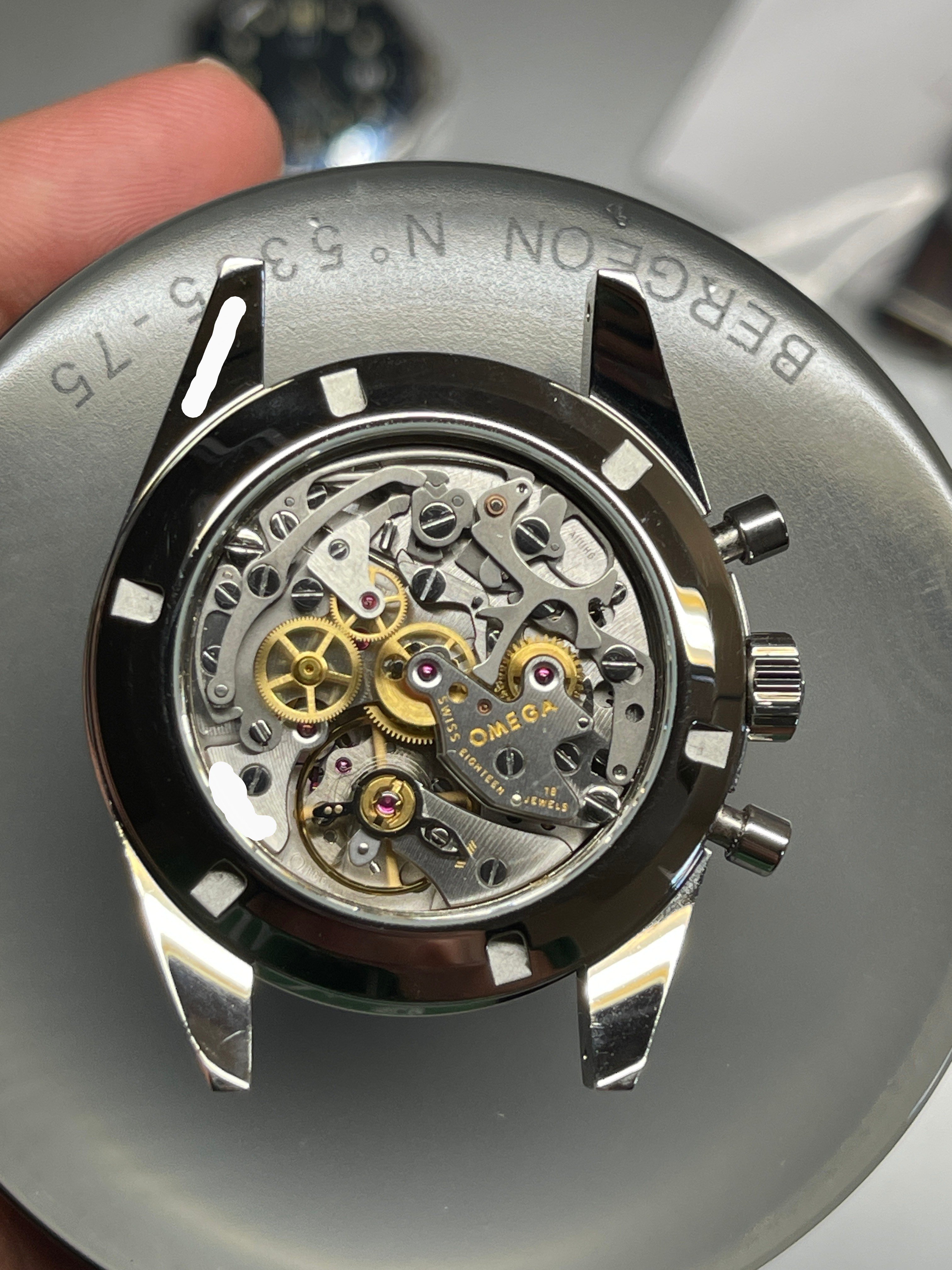

I've just experienced the same fogging issue with my 3 year old FOIS. Sent it in under warranty, fortunately I hadn't installed my Spiralwinder sapphire case back yet as this would presumably have voided it! Omega performed a "water resistance service" which included replacement of the pushers, crown tube and stem. Received it back after 4 weeks. These are the parts that were used (see below) - is anyone able to confirm that the chrono pusher part # is definitely the c-clip type rather than screw-in (can't find info via google search)? It would seem to me a terrible shame if the pusher design is inherently compromised, with Omega just replacing one failed part for the same item with a known fault, thereby dooming the watch to develop the same problem within a year or two ...

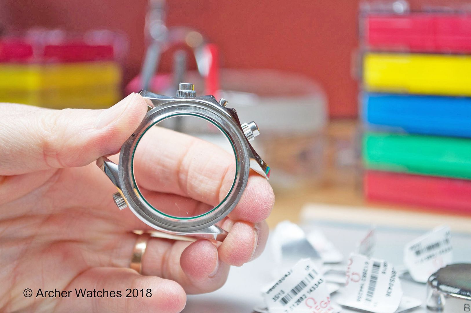

Here is a photo of the pushers that were installed on my watch, I would assume that they are the originals and that Omega would only service the watch with the original style parts.

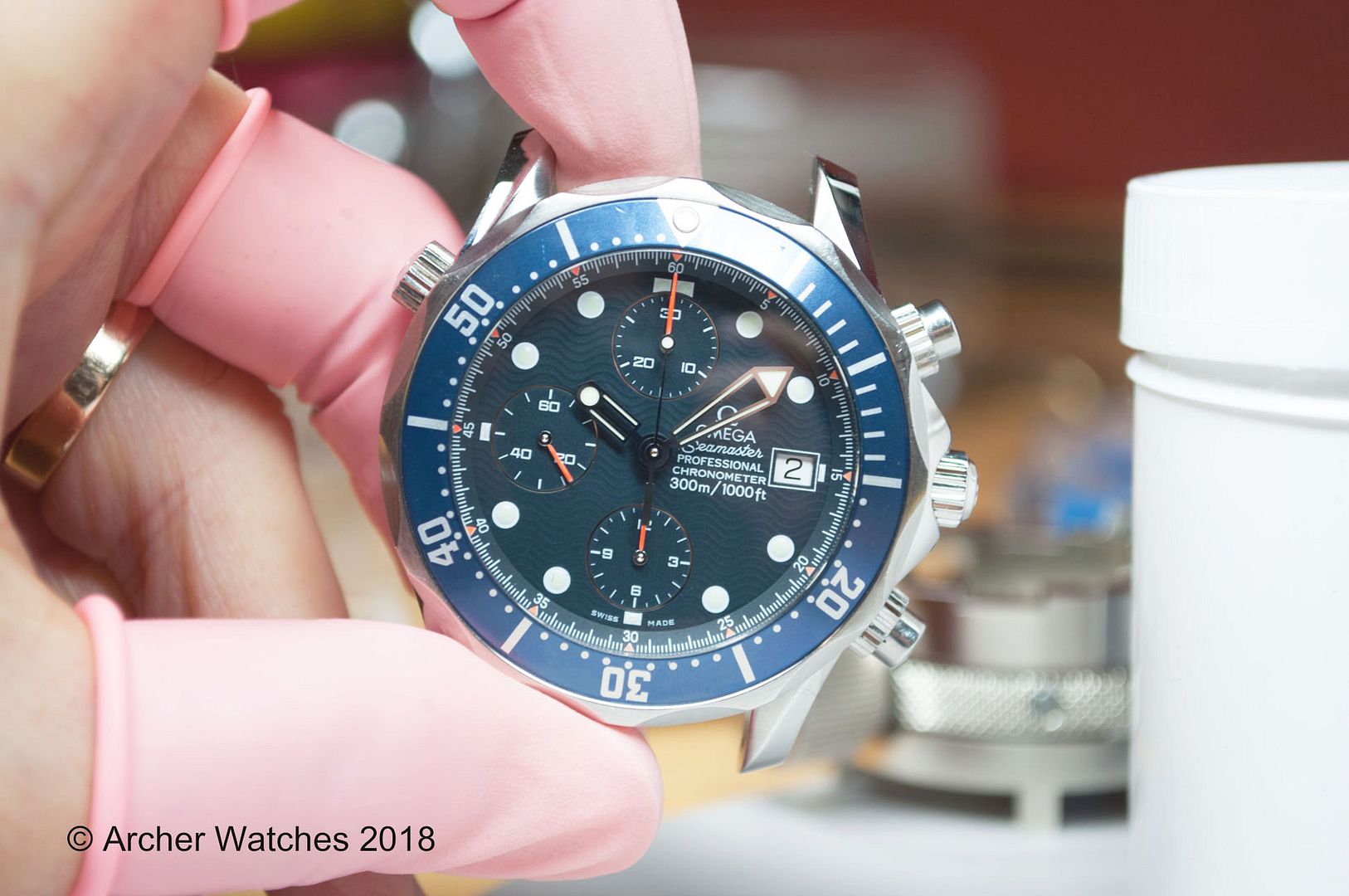

This really has nothing to do with it. The 3861 models use the type of pusher that the cap is held in place with a c-clip. Same for many of the diving chronographs that are rated to 600m.
It’s likely that the seals have gone bad, as they all do eventually...

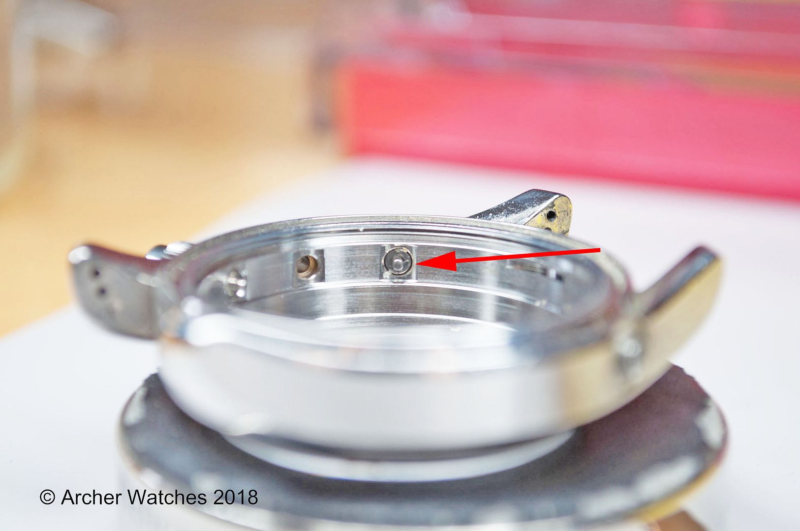

Seamaster Chronograph - you can see the clip at the red arrow:

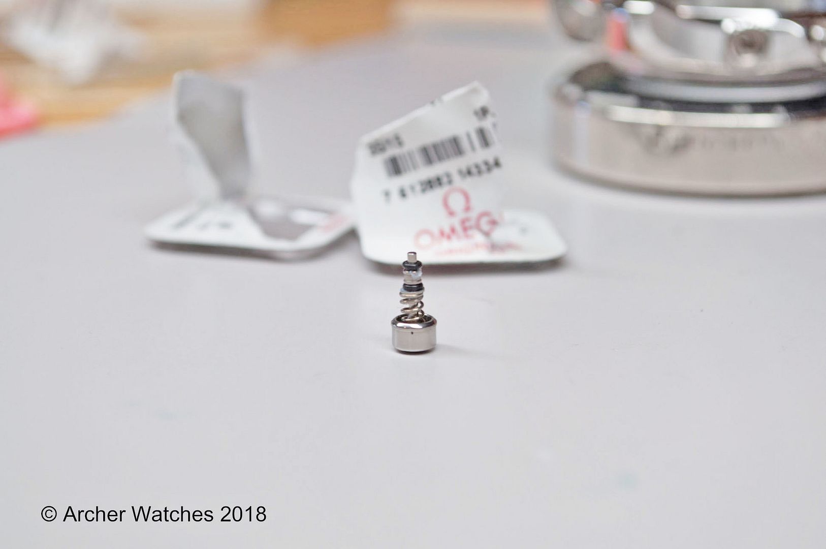

Pusher has 2 O-rings in each:
Very informative 👍
Do you by any chance have simmilar comparison photos of the Speedmaster professional and of the FOIS?
Thank you!

Had the pushers replaced with screw in type, slightly thicker crown, and all the tubes replaced. Finally passed the pressure test. Picking it up tomorrow, keeping all the original parts. I'm sure some will think I ruined it.

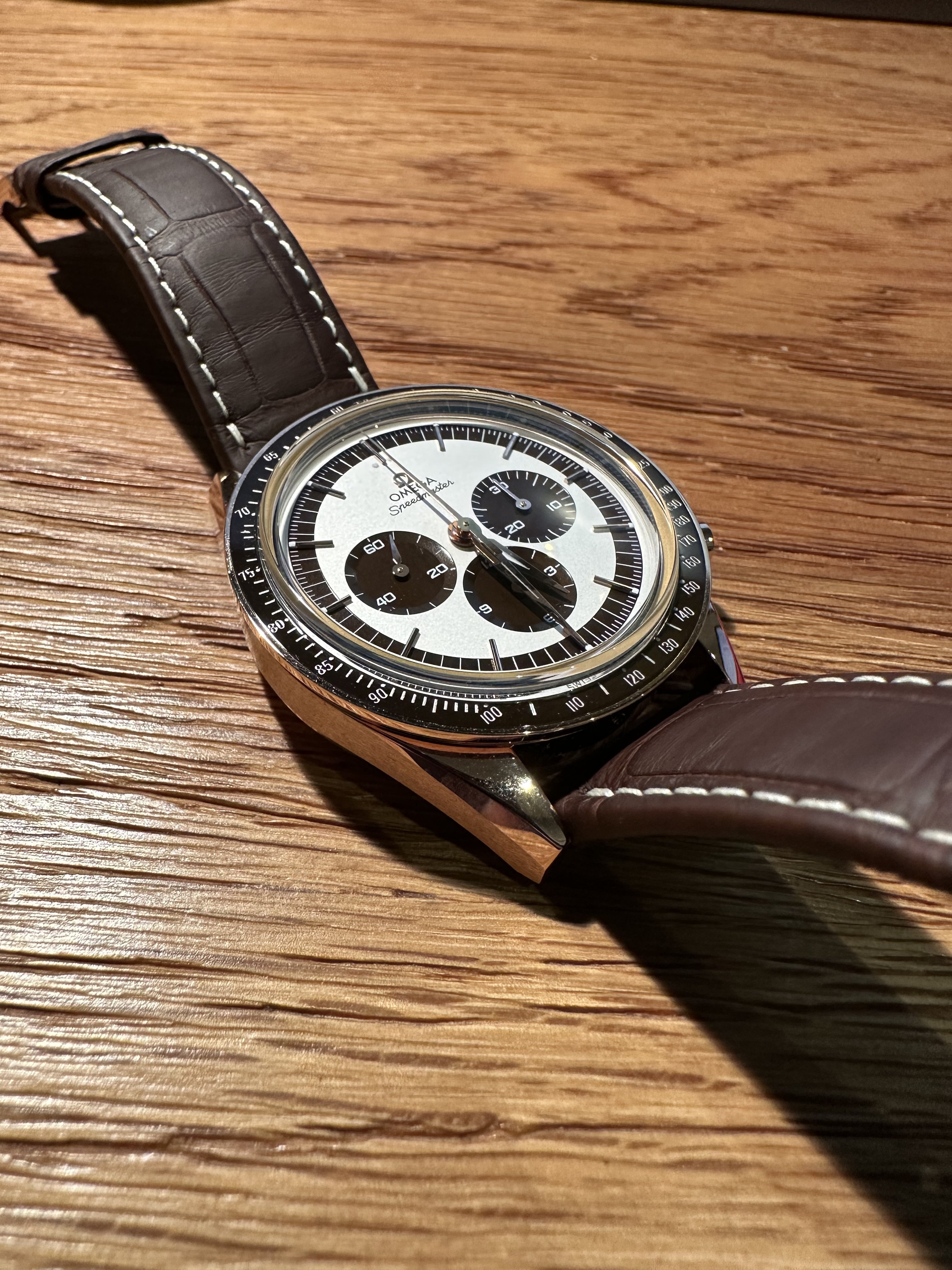

Picture day for me. Haven’t seen many of these in the thread. Found one of these lurking in my local OB and fell in love with it. I know it’s not a purist SM but I just love rose gold . Curious how many ever got made. This one is 9x. Think I’ve seen into the 200’s mentioned somewhere else.
