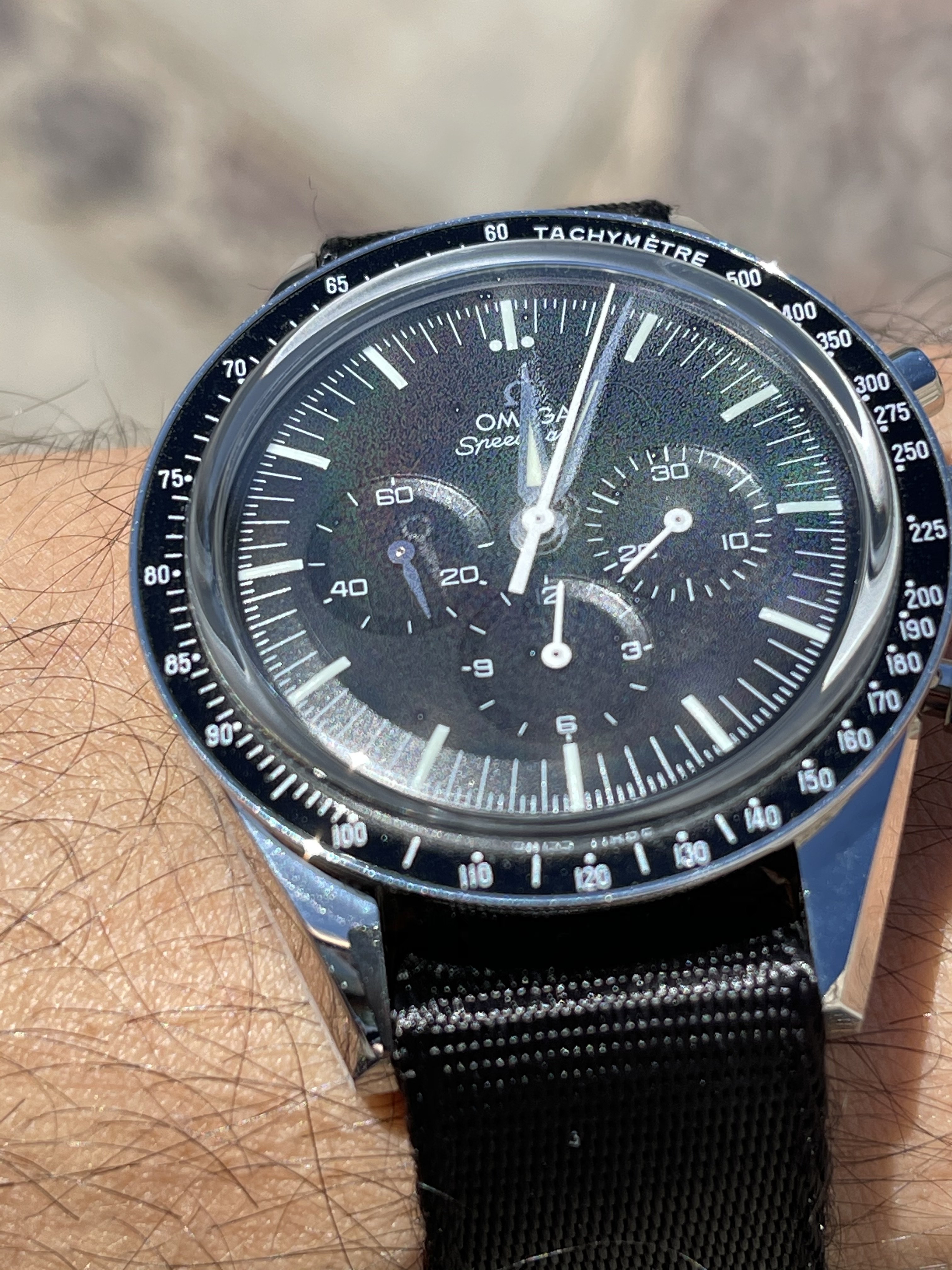

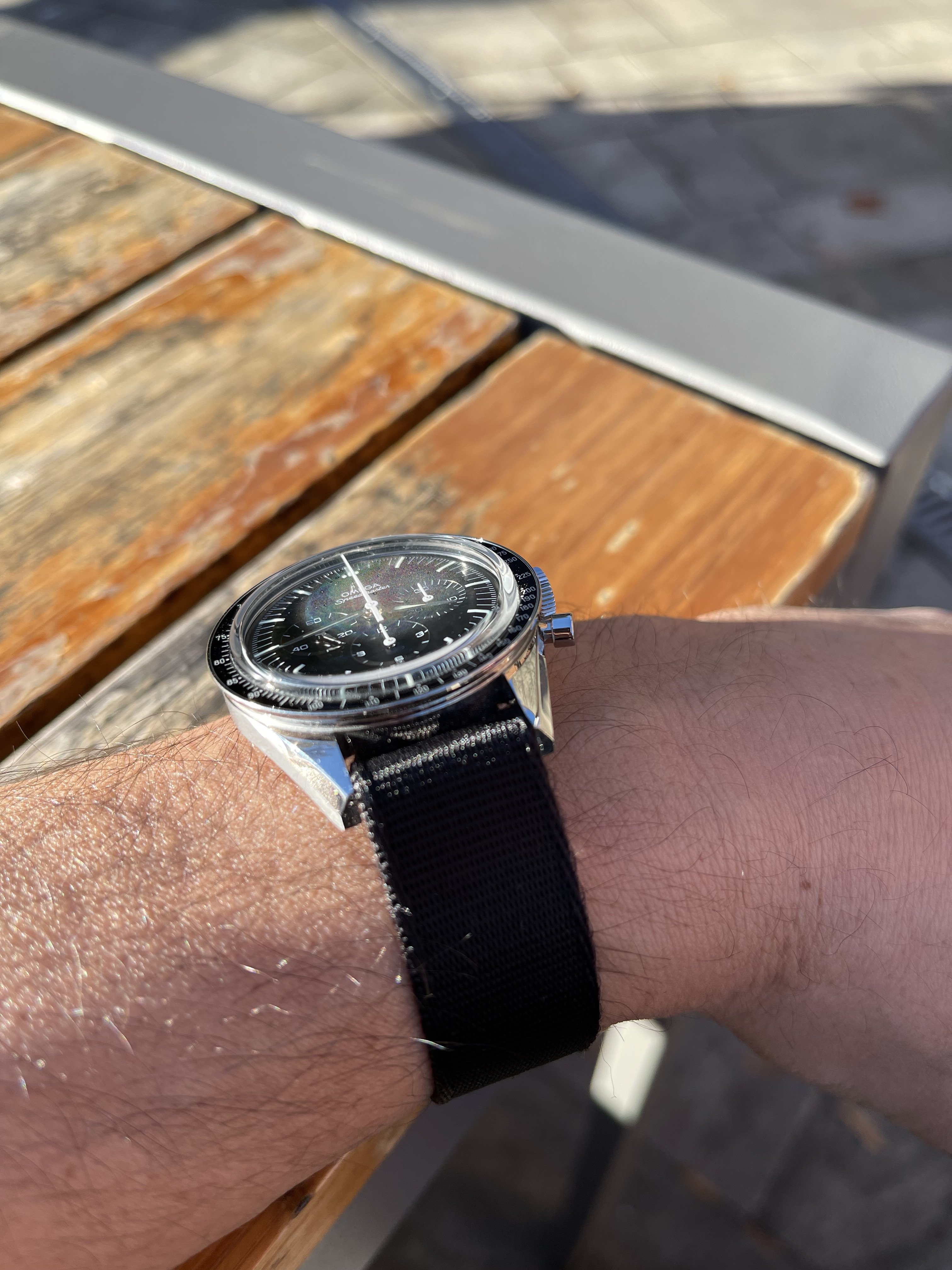

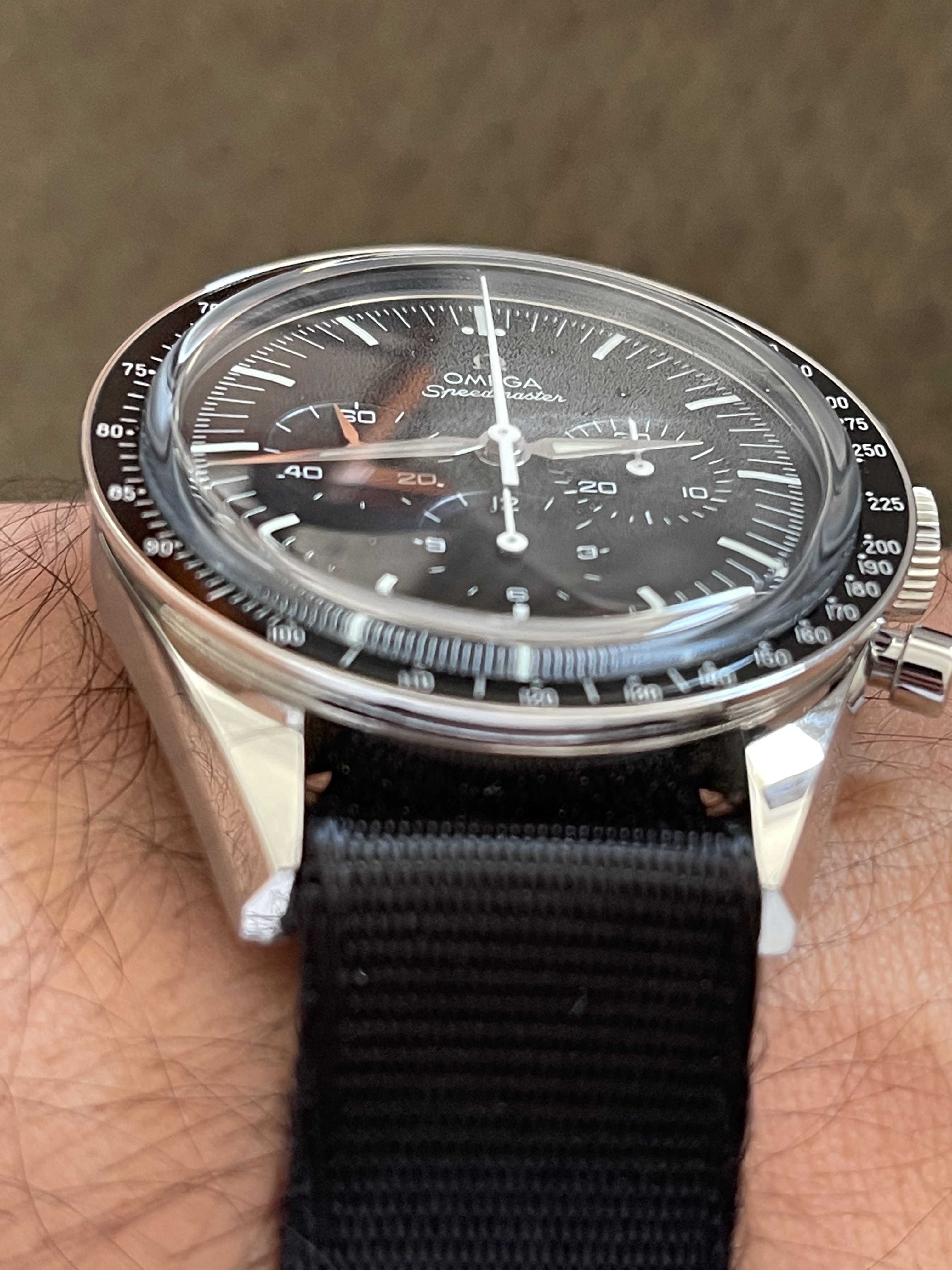

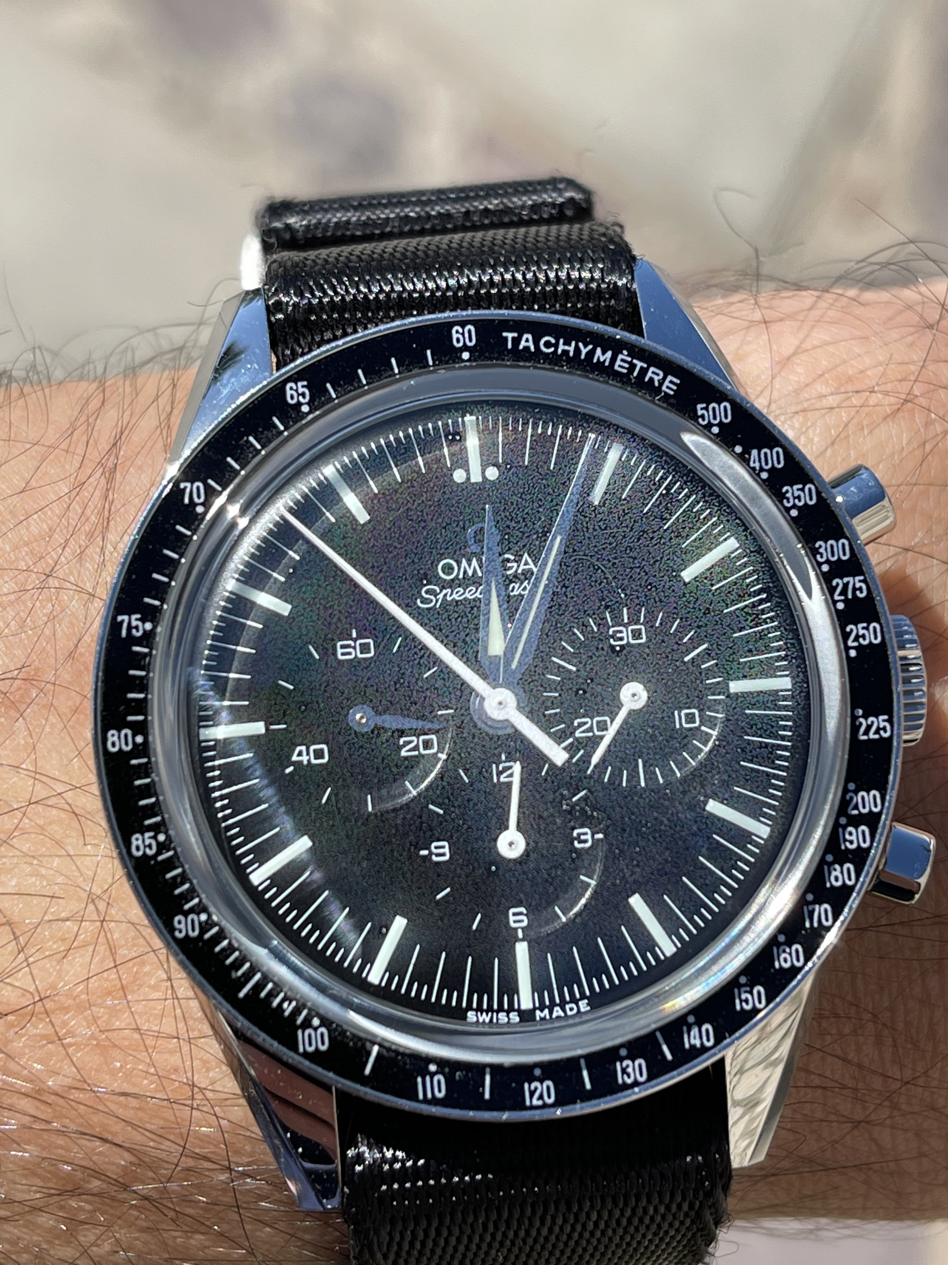

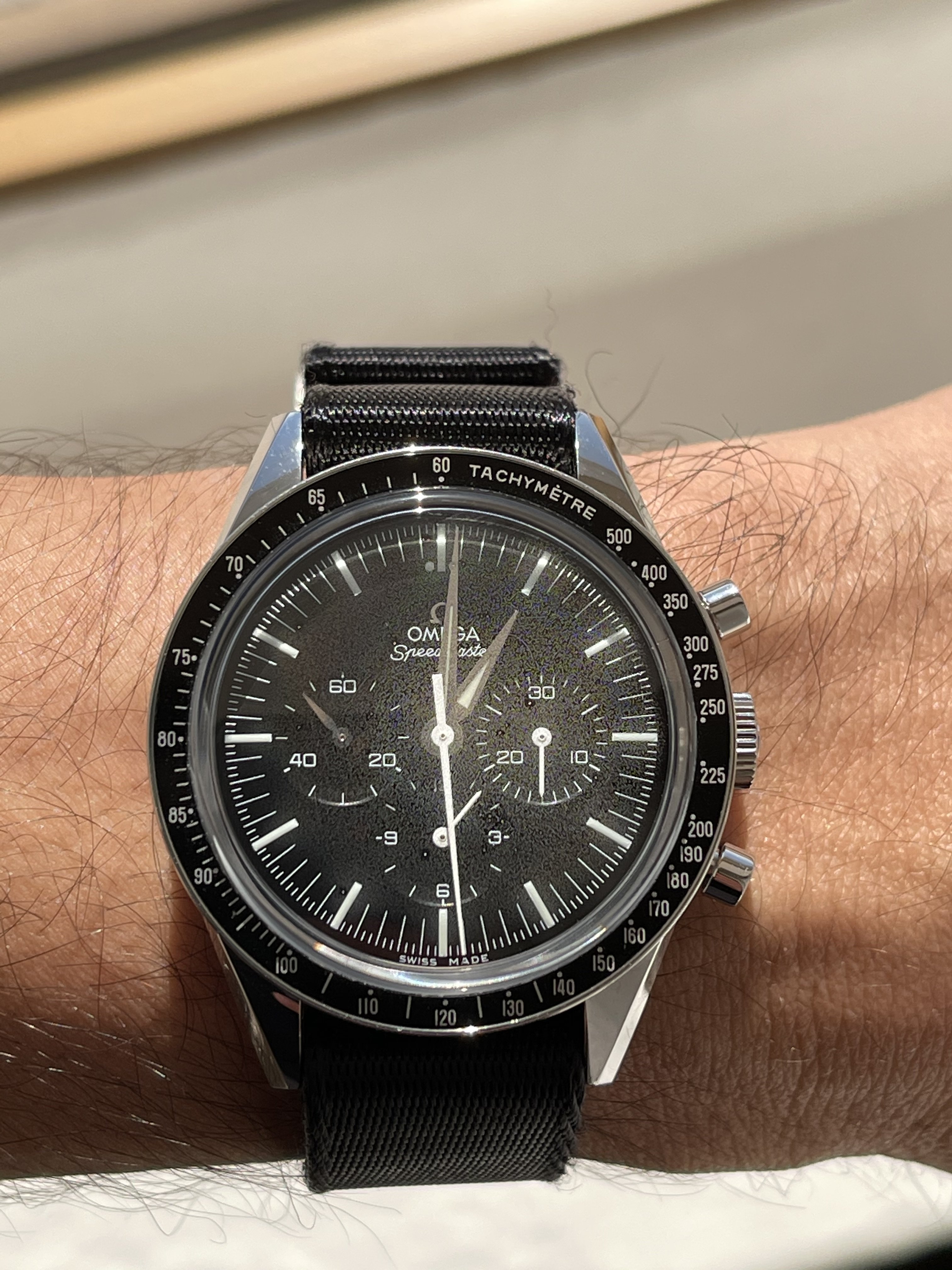

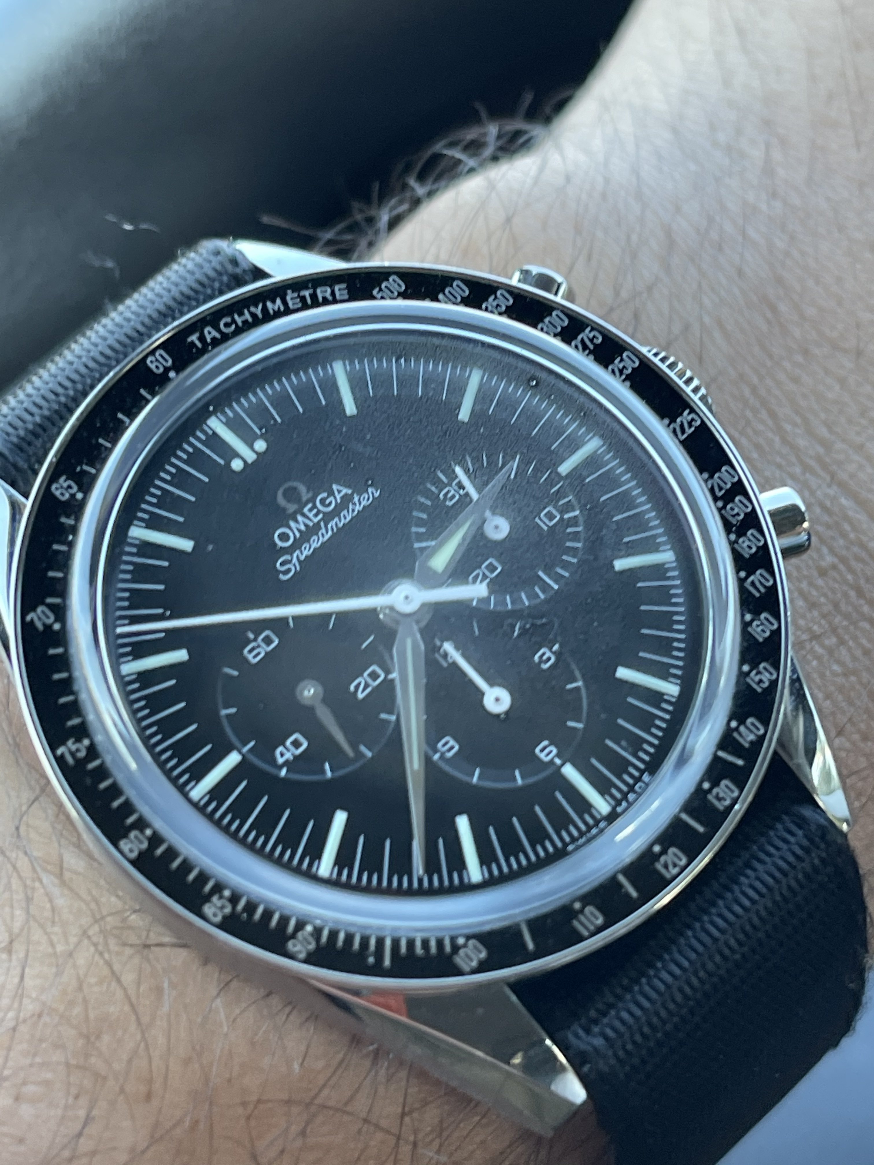

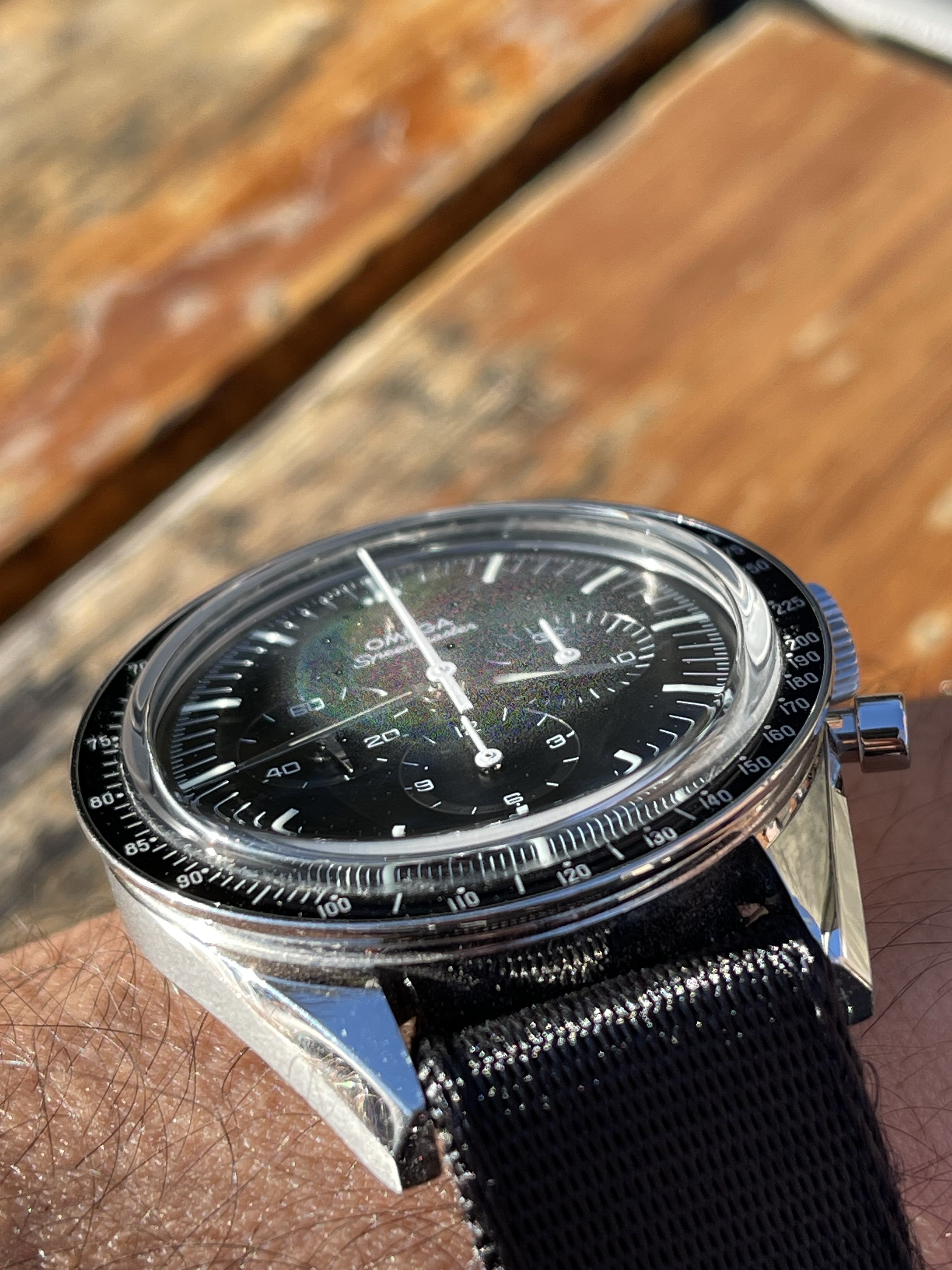

Hi All I was hoping you could help me understand wether condensation inside the sapphire crystal of my two year old Omega Speedmaster FIOS is:
  • Operator mistake
  • Faulty watch
  • Normal
My local Omega Boutique tech claims that condensation inside the crystal is normal/operator mistake.
  • I recently took my FOIS to have it serviced after noticing condensation inside the crystal for the second time.
    • The first time it happened was 11 months ago and it was also serviced/repaired.
  • During this recent visit, I was told, by an Omega boutique tech that humidity inside the crystal is normal when a user starts or stops or resets the chronograph function in a humid environment.
    • Like on a humid day in the city, or traveling by plane. This drives humid air into the watch by pushing those chronograph buttons.
  • Extra info: They claim that if they were to place the watch in a pressure test, (to test the gaskets) it would pass.
Is the tech at the Omega boutique correct? Does this mean that I should not engage the chronograph function when around environmental humidity or when traveling by plane?

Go direct to Omega and they will perform a service. Happened twice to me and they were very helpful. Quite a common issue with the FOIS by the looks of it and plenty of info on here if you do a quick search - it’s been covered a few times already 😀
*By that I mean give Omega a ring direct, cut out the boutique. They’ll send you a pack to post it to them.

Great tip, I thought I was dealing with Omega directly by going to their 5th Ave boutique in New York. I appreciate it.

The tech is full of s**t. If the gaskets are good, operating the chronograph functions in humid air will not cause moisture in the watch. I’ve owned my watch for 6 years in Florida and never had this issue - and it has travelled back and forth to Europe on planes and gone from sea level to 5000 feet elevation several times.
they are just trying to cover their mistake from the bad service 11 months ago, IMO. Bring the main office into it. That should not have happened in only 11 months.

I definitely wouldn’t want that particular tech to be doing a pressure test on my watch. But perhaps the OP misunderstood and the tech said operating the pushers UNDERWATER could cause water ingress and would be a user error. That is true. Being underwater is certainly a highly humid condition, but that’s not the same as operating on land with humidity in the air - there shouldn’t be a problem in this case.
got a feeling the tech was the one who “serviced” the watch 11 months previously and is trying to cover their ass because they know they obviously didn’t put a gasket on properly.

Omega considers "temporary fogging" inside the crystal to be normal. However this is very temporary, so in a situation where you are going from one temperature extreme to another and the air that is already inside the watch (that will have some moisture) condenses inside the crystal, and disappears within a minute.
The photos posted by the OP appear to be condensation that is far more than that, so to me this watch has failed.
