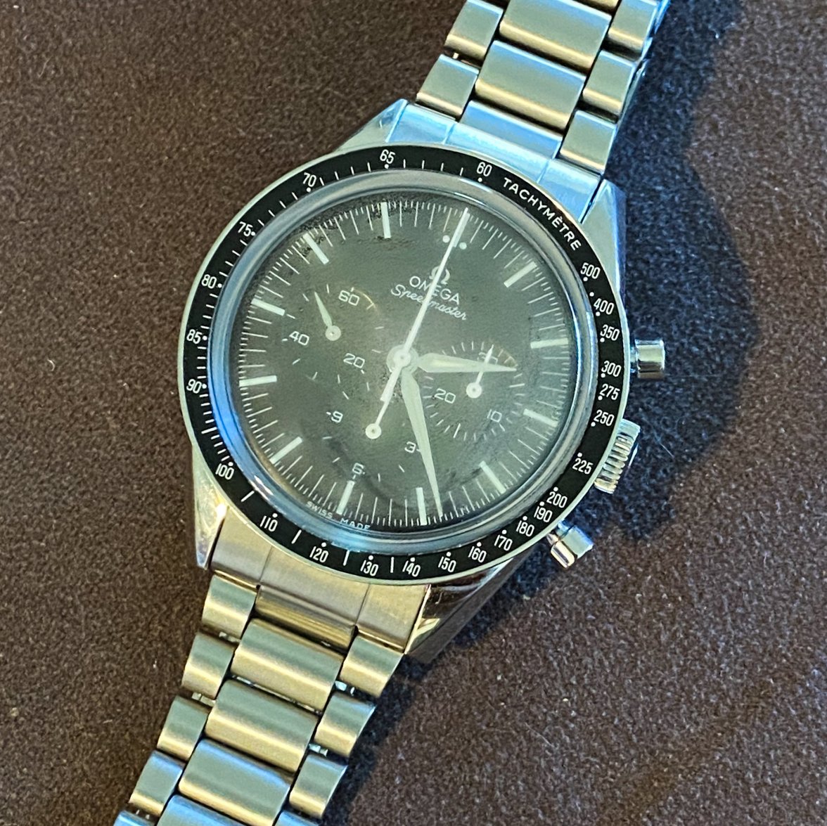

Condensation In An FOIS
315
1,570
.......... not a fan. 馃檨
I guess I got a bad gasket. It鈥檚 the only thing that makes sense since the only recent exposure to water was a quick crown-down swish under a low faucet trickle of warm water as I cleaned it before putting it back on its bracket.
Off to my appointment at Toppers.
2,809
3,739
sorry to hear that. Is this a new watch? If not, gaskets do go bad and yearly pressure tests are recommended even on non-dive watches.
not that I鈥檝e ever done it even on my dive watches. 馃榾

LMAO! That made my afternoon! 馃榾 As a similar type that doesn鈥檛 get the yearly pressure test, I feel less like a neglectful idiot!! LOL!
Five year old watch. Toppers was pretty much got straight to drying it out. Now the wait to see what their watchmaker says; he comes back to work on Tuesday.

oh, well. Probably will recommend a service, which I would do in this case. Mine is also approaching 5 years - better go get a pressure check! 馃榾

...weeks later I was checking the dial details under a loupe and noticed signs of corrosion on the hands.
YIKES! Well, that just may have settled things! Thanks for the insight!
